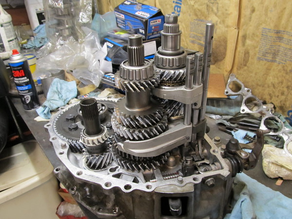

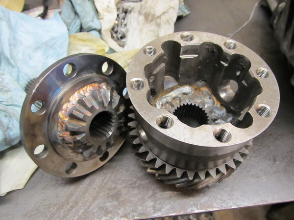

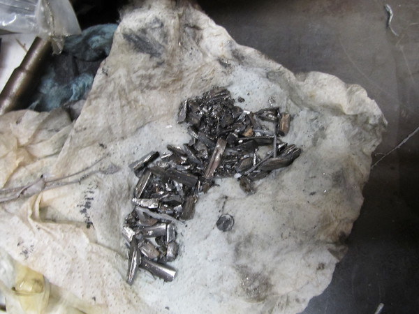

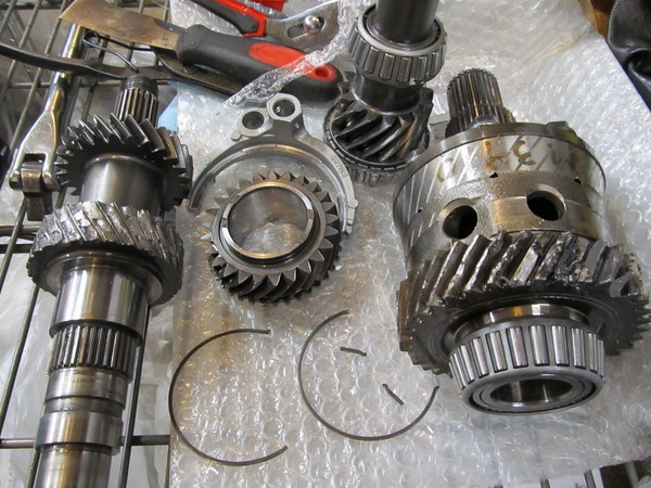

Just a little damage for 30', but the synchro dog springs were broken for a while.
Good as new, new intermediate shaft, new 3/4 shift fork, new evo 3 3rd gear.
Welded used center diff

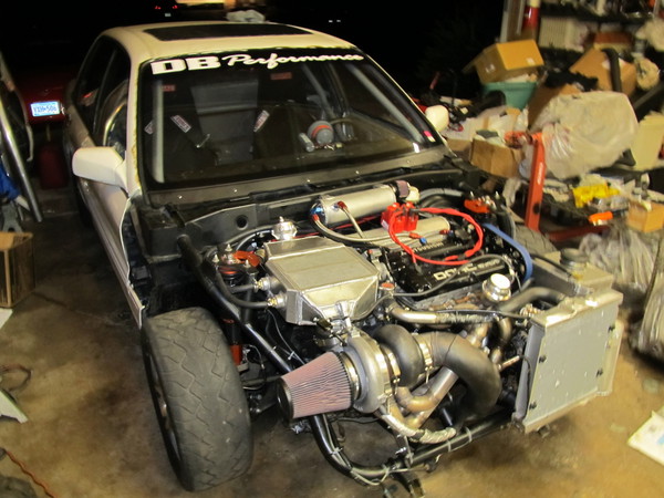

After a few hours or hard work the car is ready to take a short trip around the block the onto the trailer to head up to BIR early tomorrow morning.

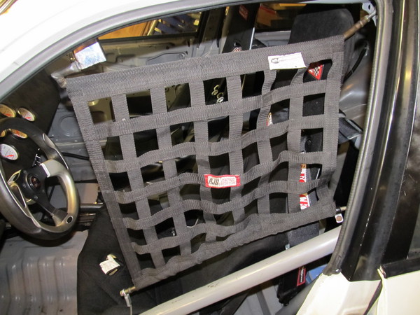

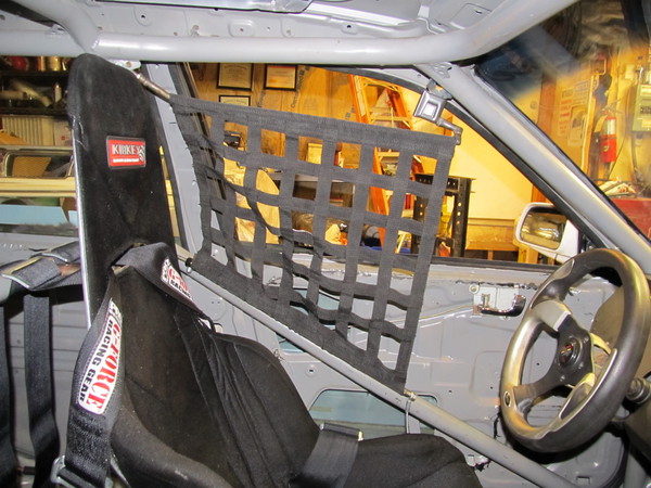

I finally installed the window net, wot.

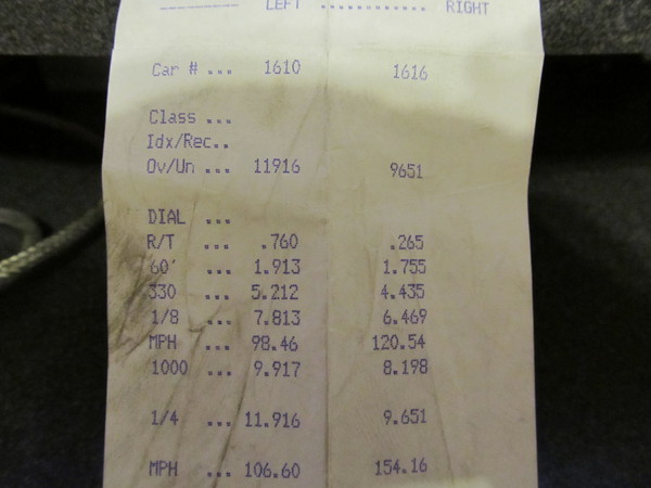

I had a fun and long weekend up at the MAP proving grounds, my car number was 1616.
We made 2 runs on saturday. The first run was just to see what the boost was at, look at the log, and see if the new tranny parts were happy shifting at almost 10,000rpm.
So we cooled the water to air down with 15lbs of ice, lowered the tire pressure from 28psi to 26psi, upped the boost a little, and I raised my slip launch rpm up to 6000rpm.
The track had good traction and the IAT started at 65deg F and at the end of the run were up to 100deg, boost was about 37.5 psi, but here is the time slip:
60' 1.755
330' 4.435
1/8th 6.469
MPH 120.54
1000 8.198
1/4 9.651
MPH 154.16
