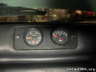

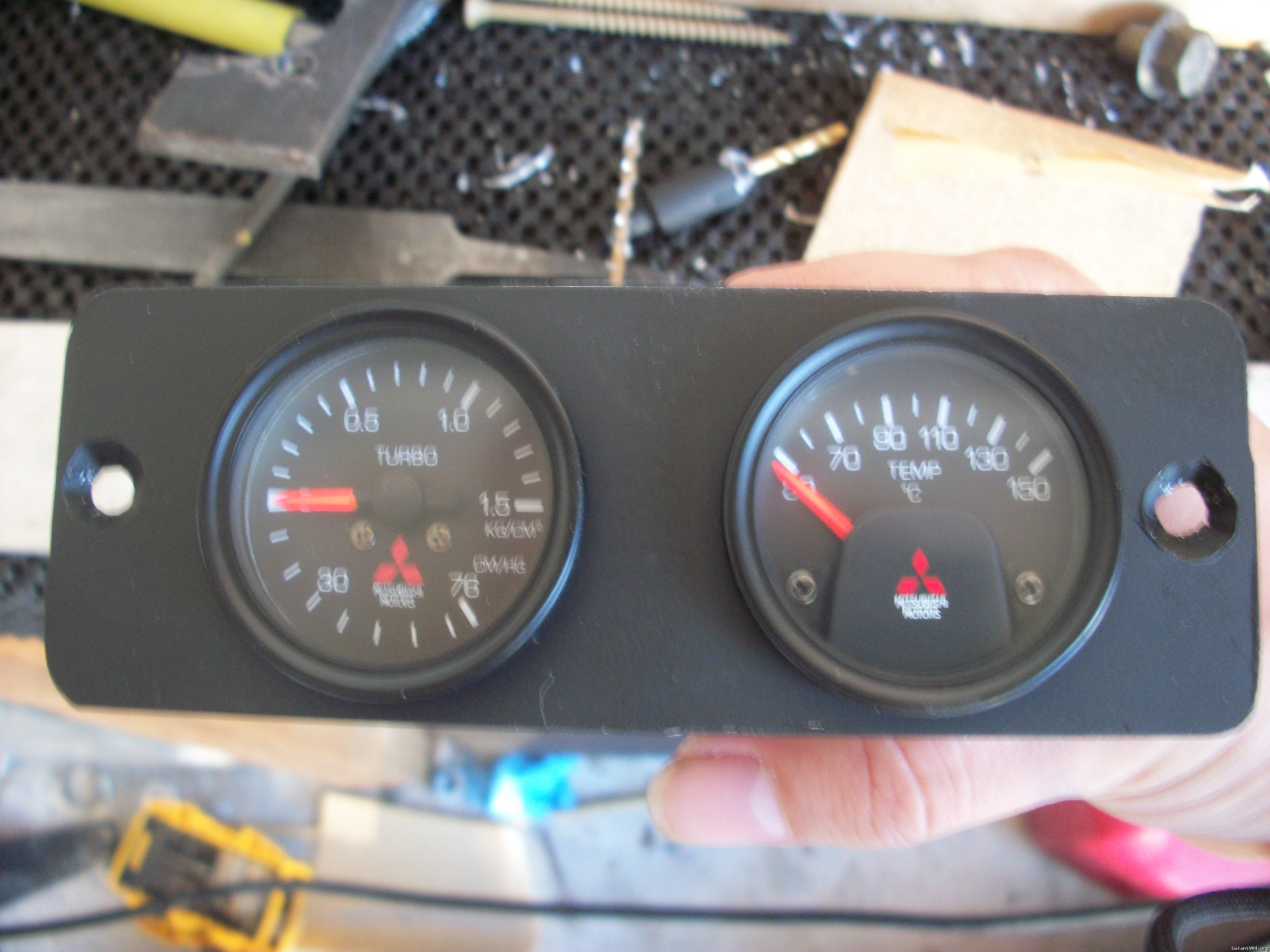

So this is what I actually did tonight. This was essentially spurred on by Steve(524of1000) due to his top notch work with the mini OEM Evo Gauges I gave him. Basically, I gave him the OEM boost and oil temp gauge that my Evo came with and he made a pretty badass little holder for them where his clock was. I'll get him to take pictures of it. Anyway, not wanting to feel left out but stuck with 52mm Prosport stuff. I went ahead and made this.

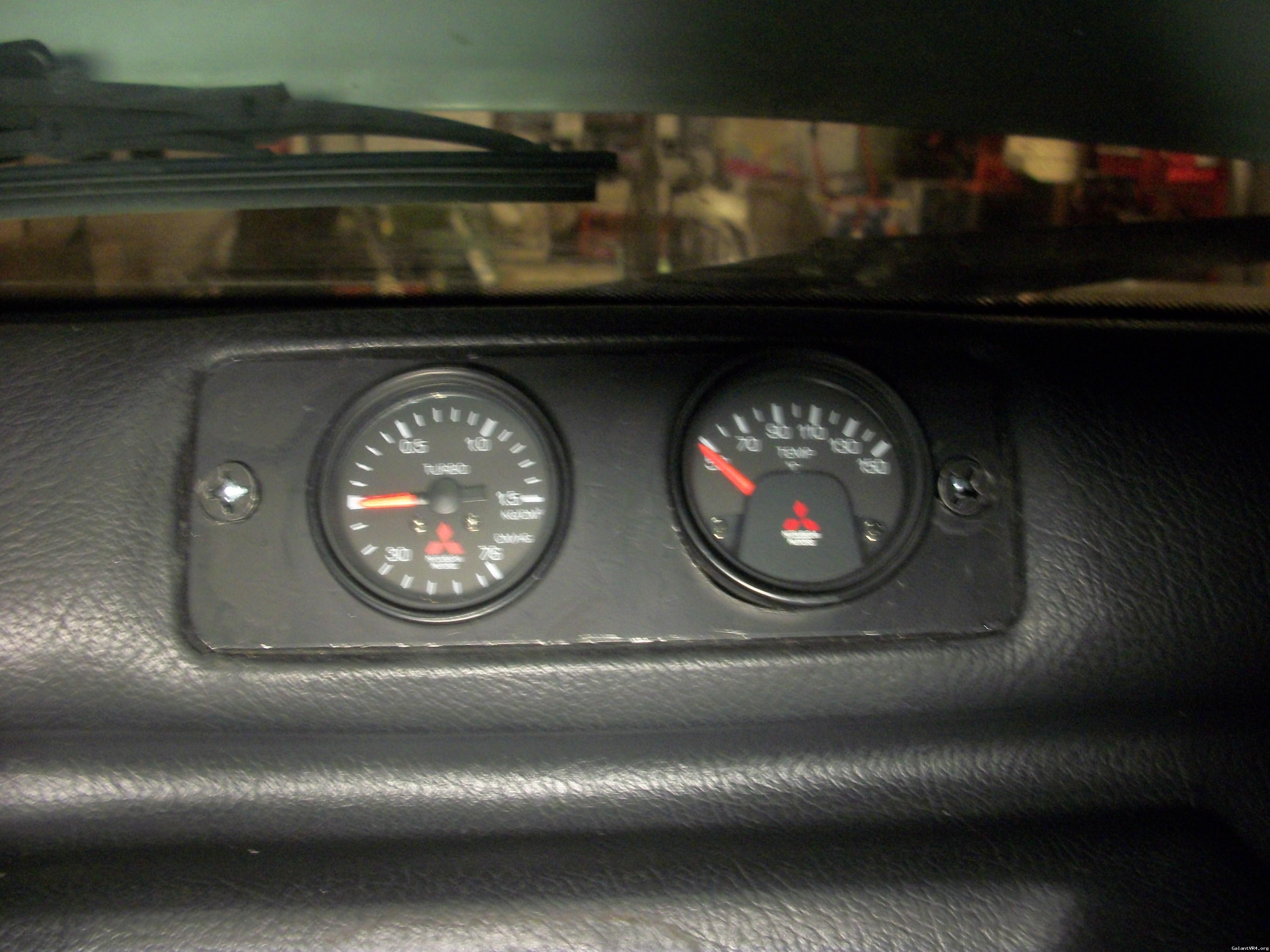

Unfortunately, the gauges don't sit flush. I have to either cut the bezel or build a spacer, but they fit nice and tight. I have the Boost and Wideband in there now but I'll probably drop the wideband for FP or OP since I can log the WB with my laptop.
Installed with the radio trim piece in place. Just need to find a solution to the flush sitting issue and it won't be too bad.
