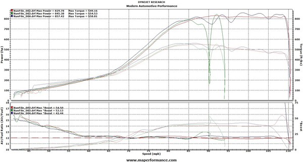

There was a local Dyno day here at MAP this weekend. I pulled the head off my car to replace some bent exhaust valves and drove it down there to see how the car did on an AWD DynoJet.
I replaced the 2mm oversized exhaust valves with 1mm over valves. I ended up lapping them in, which worked great and they sealed just fine.
We turned the boost down to 36psi and did some street runs on the way down there, everything looked good, if felt good on power for that boost level. We looked at the logs and made some changes, upped the boost to 40psi and the first run it miss fired a little and made just under 800AWHP at 40psi. So we added some timing where it was missing and the 2nd run was clean, 829AWHP and 554ft/lb at 40psi with a little less overall timing then it had when it was on the dyno early this year at DB Performance.
So we cooled the intercooler down and tried to up the boost again, shooting for 44psi, forgot to up the boost cut, fixed that and tried again, it missed a lot, and put down 860something.
At DB early this year at 40psi on the dyno dynamics it made 720 un corrected AWHP, and at the same boost level on the AWD Dyno Jet it made 829ahwp at the same boost, dang.
I figure a clean cooled down pull at 44psi the car would make low to mid 900's, which is right were it should be.

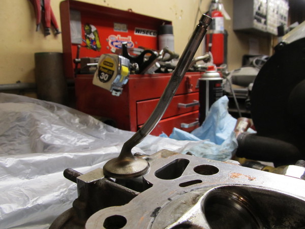

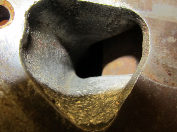

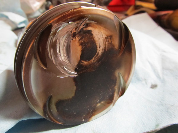

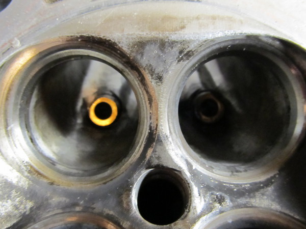

The car was running great. Then on the way home the keepers on the #4 cylinder #2 exhaust valve blew out. The valve dropped and some damage fallowed.
Here are the pics:
I am headed up to work to clean up the back up block and pick up my parts to finish assemble the back up motor. Then I will pull the tranny apart to fix 3rd/4th gear shifting and with any luck I will be at Cedar Falls the 9th.

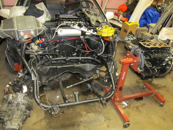

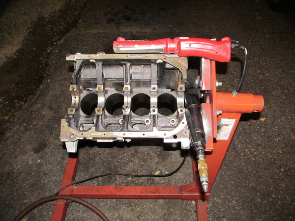

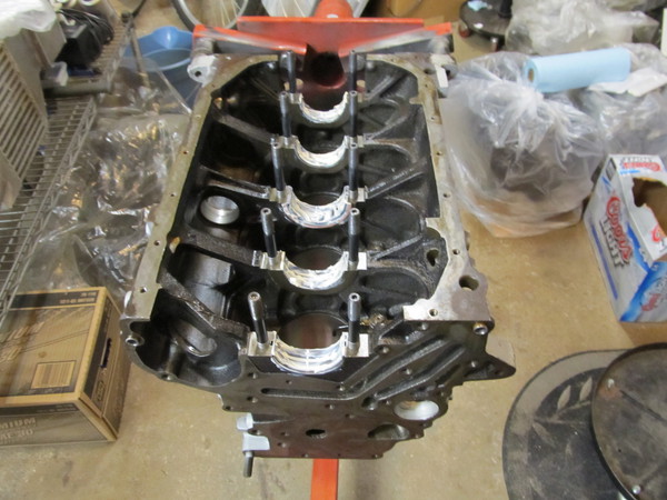

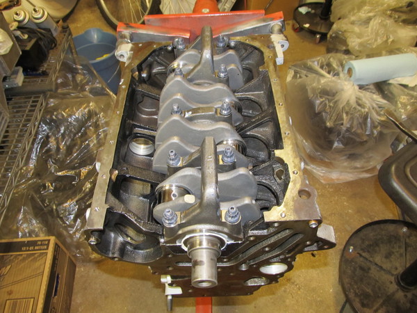

So the back up motor is a short block as of Sunday night. I have the head ready to bolt down, so when I get home tomorrow it will be a few more coats of copper spray on the head gasket, then I will tear the rest of the way into the tranny then bolt the head on before I go to bed.
~John
Galantvr41062
Aug 20, 2007
415
plymouth, MN
Well the back up motor did get finished minus the oil pan and manifolds, etc. Other factors came into play and the car did not get back together for 1 more outing before winter. So the chassis stays apart for the winter and my plans are this as of right now: Sell the back up motor, sell the tranny that is now fixed and with shift with no issues into 3rd and 4th, sell some other misc items to raise the needed funds to get a dog box and slicks on the car for next year. I am also doing a 5 lug swap with longer wheel studs and threw lug nuts, drive shaft safety loop, passenger door bar, scatter shield, full fire suit, new helmet, and I am talking with a guy to get some paint on the car over winter. The race motor with get 1 new piston from CP and a freshen up for next year, I will also be doing a new head with a copper head gasket, or something better then a felpro permatorque. I am looking at reducing the size of the water to air head exchanger and I might swap in a full sized radiator, or buy a better 1/2 size. This little cheap radiator has been leaking on and off the last 2 years, some due to the cracked cylinder wall in 2010, and some from this year and pushing coolant.

The rods/pistons are back at CP Carrillo.
I am getting a hole new set of pistons. They looked at the ones I sent back and there making some changes to the design, adding more gas ports for the top ring, polishing things, and changing the outer shape to help stability and reduce skirt scuffing.

The block with just get the glaze broken and new rings/bearings installed.

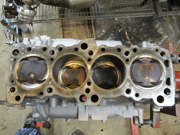

I have had 2 permafails in my car. The one that was in it for the first part of the season started to leak between the layers on the dyno, but it only pushed coolant at 42+psi so I left it alone as long as I could then after the record run at BIR it started to leak at 40psi. So I installed a new gasket and drove to the map dyno day and made 830 at 40psi and was already leaking after 14 miles.
And I want to turn the boost up this year so I need a gasket that should never leak.
The main issue is the permaleak has no ring or anything between the layers to seal cylinder pressure.
I like the older cometec better, but that's just me.
And when this 4202 lets the ghost out at 50+psi I will get a Borg Warner 4202 or the BW billet 80mm to replace it.

Yes I was using a-1 L19s torqued to 105ft/lbs with a ton of moly lube. I will post pics of the leaking gasket. If the copper does not work out I will try something else.
I would think when my car lifts the head its making more power then other people not having issues.
