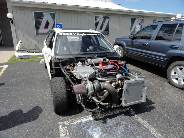

Here are some end of the year pics (2011) of the car driving down to the MAP fall dyno day, and driving up to Elk River for a car show at Broadway Bar and Grill. And prof that it did run and drive around, I estimate we ended up putting about 1500 miles on the car last year.
