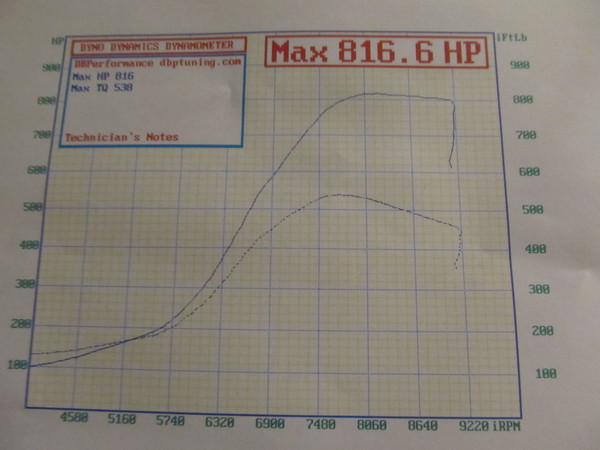

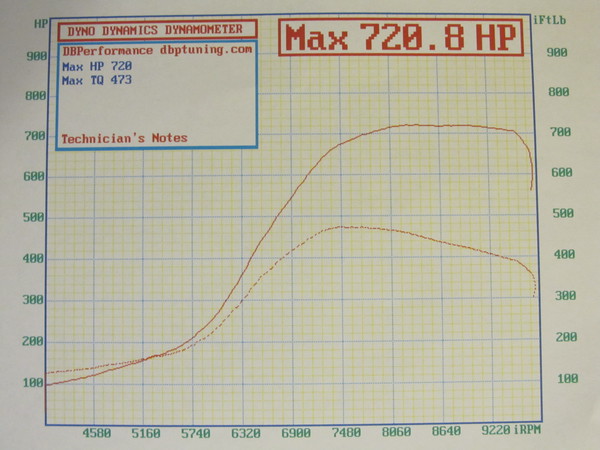

Tonight, was the big night on the dyno. And I wanted to engine dyno the thing but as it turns out the turbo setup would not fit without making a custom bell housing for the engine dyno. So good old AWD dynodynamincs is in order.
First off a big thanks to Shane and DB Performance for making this possible. The car did make Great power, then we found our wall, and it was 2 fold.
So I wanted to get the car back to the 650 or so it was last year so I could hammer out the 60'. Then if things were going well we could turn it up a little and see where the wall was, or the limiting factor.

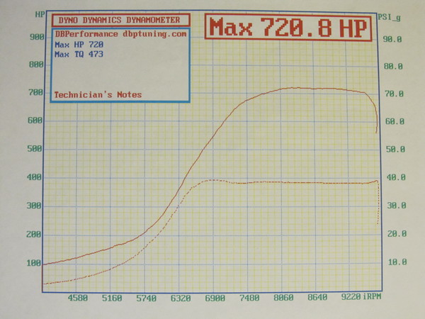

So we tried a few runs at base WG pressure, or what we thought was going to be WG pressure. It ended up running 40psi with a line from the compressor housing to both WG's. I do not know why that is but the WG springs are 24psi springs, so last year it would run 26psi, so I figured it would be about 26-28psi. Not the case, here it is at 39psi and reving to almost 10k, it just keeps going and going.
So we proceeded to up the boost cut, based on the psi graph I figured it was going to run 35-38psi on WG springs. We checked with an air gun and the WG valves did move just fine. And in the end it was almost 40psi for spool up then settled at 38-39psi. This made 720 awhp, so upping the boost about 1psi from last year made 70 more ahwp.

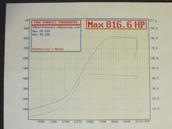

So after all this we put in the boost controller and upped it to 45psi, the ignition cut out like a rev limiter and the car made 789 or something, then after some poking we made the 816.6 AWHP and 538 ft/lb at 45psi tappering down to 43psi at the 816hp mark and 42psi at red line. But we had to run more ignition timing to get a clean pull then we wanted to, so it lifted the head on the end of this run. But we turned it back down to 36psi and it made 689ahwp, so that will be my new base PSI, and up it a little from there to around the 720awhp as traction permits.
Then if I want more power I need a better ignition system, and a head with more deck thickness then the one I have now. The head I have on there now is decked a lot, the oil passage up into the head from the head stud hole is not very thick, and I might need to drill and weld in some supports in the deck surface of the head in between the head studs to get this thing to hold enough cylinder pressure to make the power its capable of.
I would need to up the base fuel pressure from 38psi to about 45-50psi, not a big deal with the fuel pump I have. Then up the boost to 50 some PSI and I think the car could make just over 900AWHp. But the setup has a long way to go before I could use that power, but on a dyno day it would be fun.
I will update with a Shootout mode graph at some point, this number was at 976 awhp, this is supposed to simulate crank shaft HP, or a lot closer to a Dynoguess for power.

The custom CP Pistons and custom Carrillo rods are working great. We did the hard block and engine machine work up at Hitech Motorsport, this is where I work and the parts and labor involved show. The setup made 70 more AWHP on the same dyno with the same tuner as last year. The major changes were: Custom CP pistons (9:1 compression vs 9.25:1) and custom Carrillo rods which were a little heavier then the Crower rods last year, E98 race fuel was used vs the E85 from a local gas station last year, Aeromotive Eliminator fuel pump (up graded from an A1000 fuel pump and dropping fuel pressure last year, base fuel pressure this year was 40psi). The fuel injectors were upgraded from FAST 160lb injectors at 85% duty cycle to the FIC blue max high Z 2150's injectors at 90% duty cycle. The valve job on the intake side was changed from a choppy 3 angle to a free flowing 5 angle valve job, and I also went threw and took out all the sharp edges of the combustion chamber and smoothed the intake to exhaust valve face angle. And 1 more detail is taller deck surface of the block and the bigger valve reliefs on the exhaust side allowed the cams to be degreed in closer to what I wanted to run last year, but the exhaust valves would hit the pistons last year.
We did a fuel leak test to well over a 100psi fuel pressure at 12v w/o the engine running, so the system is more then able to run 100+ pounds of fuel pressure, which means if run a base fuel pressure or 50PSI and 50+ PSI of boost I have enough fuel to support the almost 1000AWHP the setup is more then capable of.

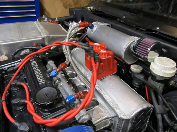

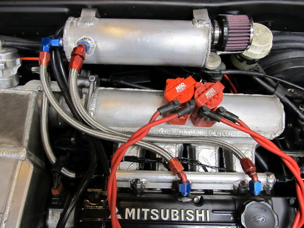

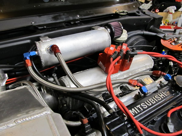

I just added 2 -8 lines from the valve cover to my catch can thing. Then I added a 1.5" inlet breather filter with chrome cover.
This should help with some of the crank pressure I was seeing on the dyno and my test drive.
I still plan to head to Grove Creek this saturday for 60' testing if its not raining, we will see.
