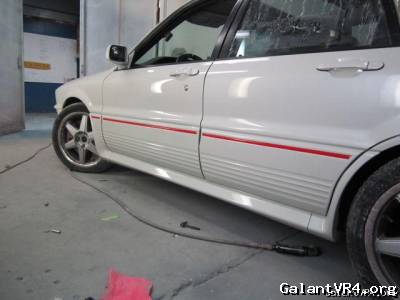

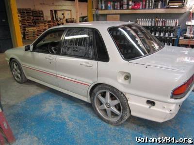

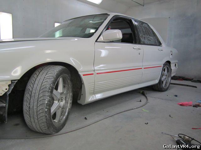

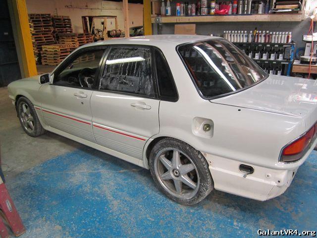

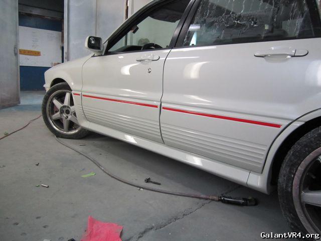

I can't decide if I like the red stripe! I think I do, but will have to wait to pull it outside with everything on it! I still have to paint the bumpers and filler panel below the headlights....And repaint the right rear door. I was training one of my employee's how to buff and he burnt thru the paint. Only one way to learn, doing it! Hopefully will have it done next week sometime. Just in time to install the Ohlin shocks that I purchased!!!!!

The red might look better if you accent some else in red on the car somewheres, A glossy black line would like nice aswell

I'm thinking about a red stripe around the wheels! It has Baer brakes on it that have red letters engraved in the calipers. Maybe some redline tires? Ok it's not a late 70's muscle car.

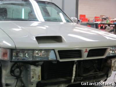

This is really cool! I like the hood scoop too. Congratulations on getting your business going. I'm still in the way early stages of getting a business together. Setting up an orchid nursery isn't easy. I think the red stripe would look sweet if you had black rims with a red lip. If I lived near you, I'd definitely support your business because I want my car restored.

I'm thinking of painting the wheels charcoal or something dark with a red stripe around them!
Running business is not easy and takes a lot of time when your not able to bill out for any work. We have employee's and even had a full time painter up till monday, but had to let him go. Makes for a stressful times. I bet setting up an orchid business is a lot of hard work. I wouldn't do well with that. I like metal....If you cut it off too short just weld it back on. Not exactly that way with plant's!

"I'm thinking of painting the wheels charcoal or something dark with a red stripe around them!"
Sounds like a good idea too me

My car in the UK got a red stripe from the factory /ubbthreads/images/graemlins/tongue.gif
White wheels with red lettering would also work on your car in my opinion.

I'm not into the chrome strip either....All I did was put a red pin stripe on my chrome strip. If I don't like it when I get it all together I will just pull it off and try a different color! Unfortunetly I am old enough to remember those cars! I guess I like the GVR4 because I started driving when they were new!

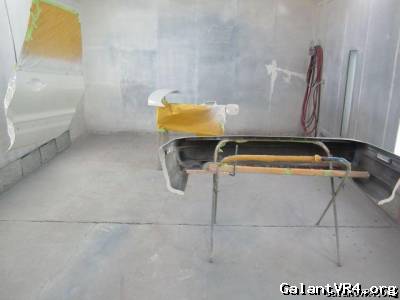

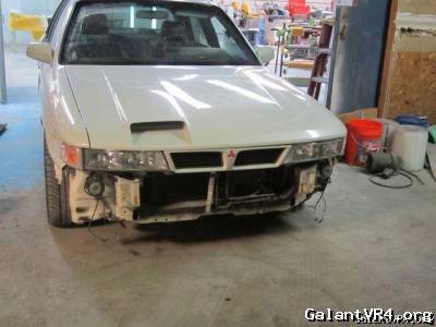

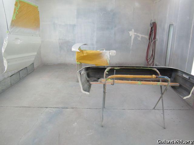

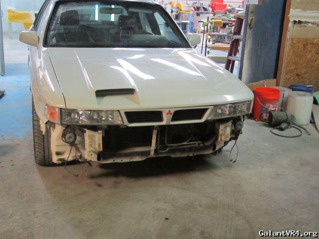

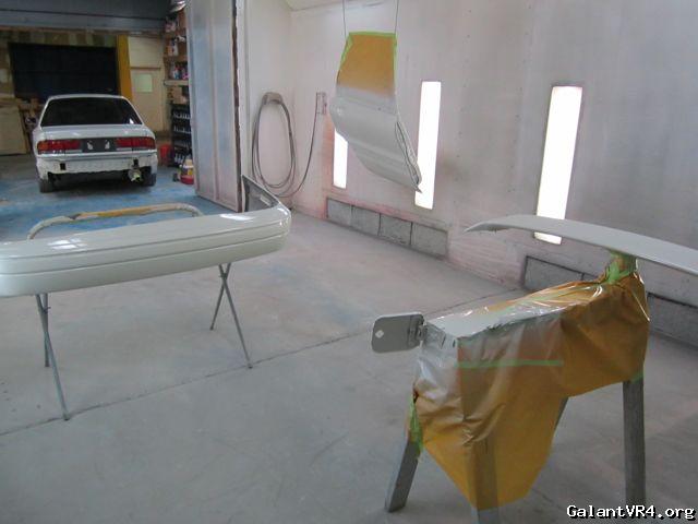

Got some stuff done today...Lights installed, grill installed, side skirt installed, etc. Had to repaint the right rear door, rear wing and door handle. Painted the rear bumper and gas door. Waiting on the glue to dry for the front bumper. Hopefully will prime that in the morning and sand and paint in the afternoon after installing the rear bumper, right rear door, and gas door.
It's coming along. My Ohlin shocks will be here monday. Just in time I think!

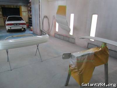

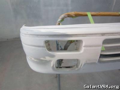

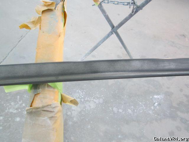

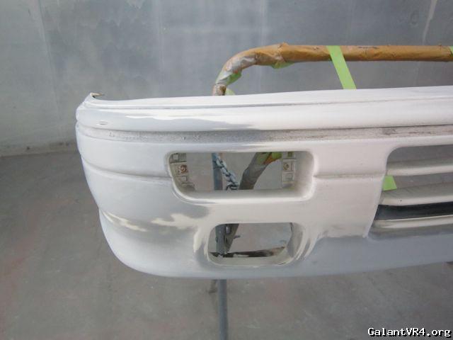

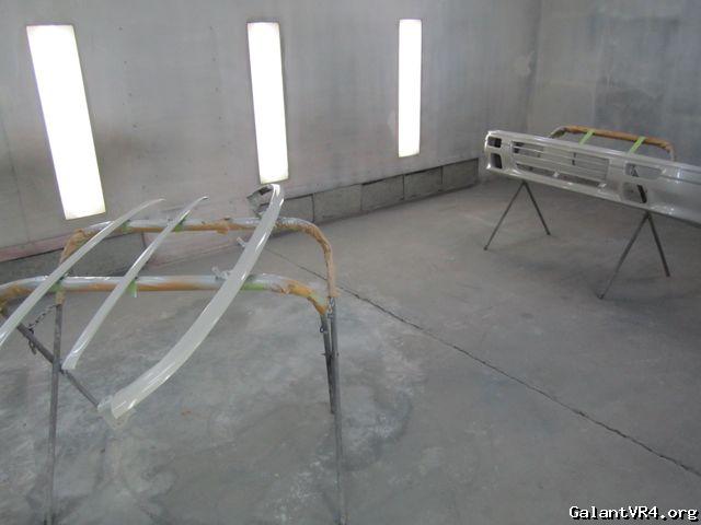

Below is a situation were I would want to use sealer. Any place that has a difference on products. I didn't want or need to prime and block the whole bumper so I just primed and blocked the area's were I did work! I was also able to pick up a set of roof molding's as mine were in bad shape. The paint was really thin so I wanted to put something (sealer) before I put the paint on! I also use a different catalyst for the DP40 sealer. It is DP401LF, it dries slower and is more flexible than the DP402LF and should be used on anything plastic or rubber.
I'm hoping t install the front bumper and filler strip in the morning and hopefully be ready when the Fedex guy shows up with my new shocks.

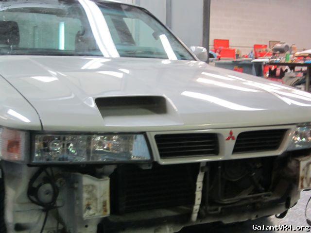

Very close on putting this thing back on the road. Everything is installed except for the window trim moulding's as I am waiting for the new clips to come in for them. Started on installing the new Ohlin shocks. I have only had enough time to pull the AGX off. I have some stuff coming to make the new shocks bolt up. Hopefully be driving it by the weekend! Will post up some pics once I get it back on the ground. All this just in time for the winter weather.......
