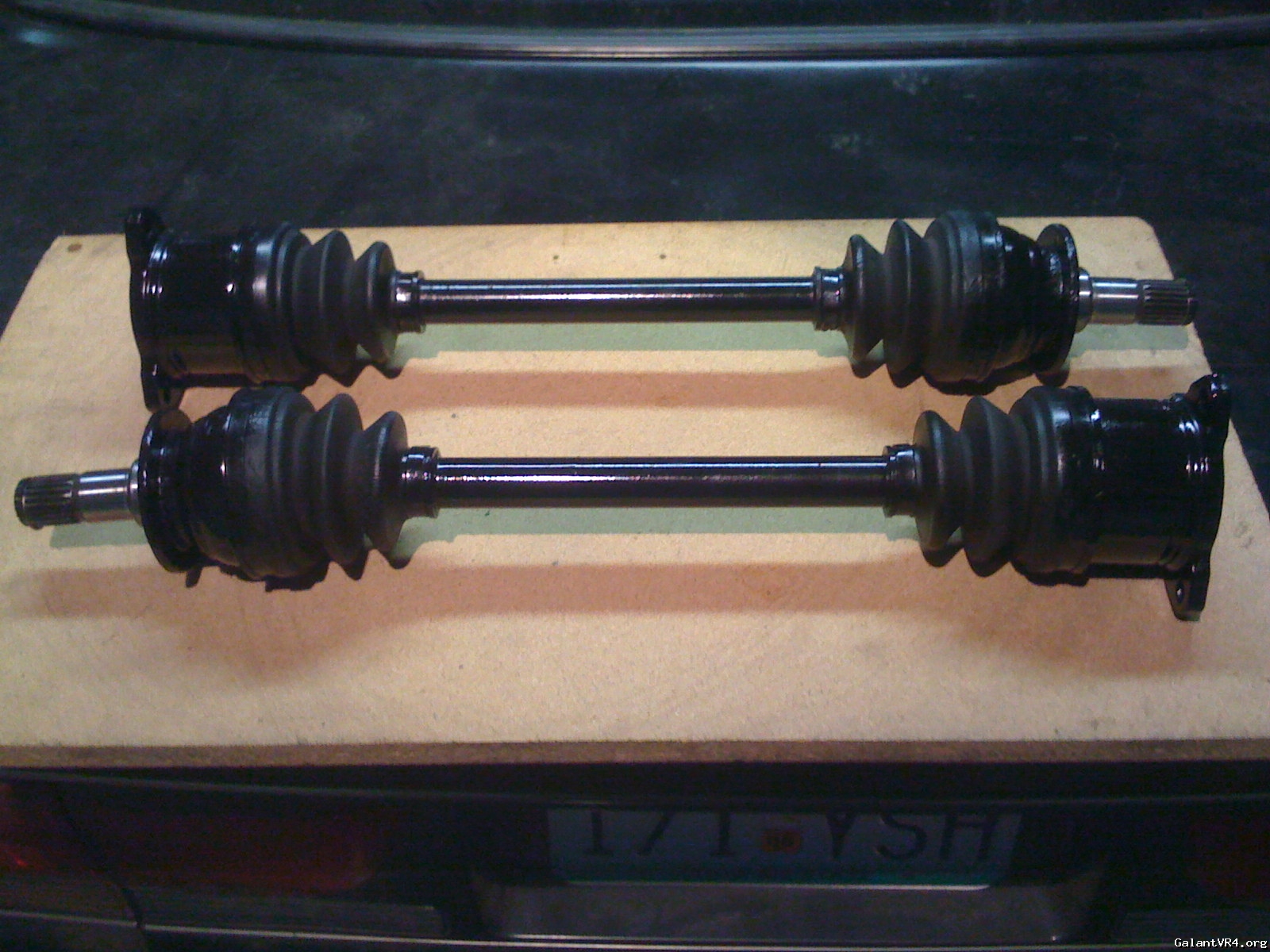

Have all the non-abs parts already (on the black car, to be donated) I have a 3" megan downpipe, tubular o2 housing, so I'm good there. All of the interior from the black car will be transplanted. I'm gonna try to make/modify my own wiring, to get rid of the crap I won't use and simplifiy it. Already have clear corners, 93 h/l's, led bulbs all around, pretty much everything,, though I want to replace some of it. I'm gonna work on the undercarriage all weekend, try to get the driveshaft all freshened up, new axles where needed,, blast and paint everything,, I'm thinking neon green. /ubbthreads/images/graemlins/hsugh.gif

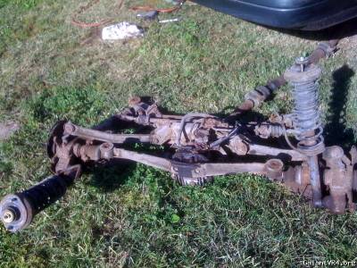

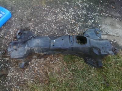

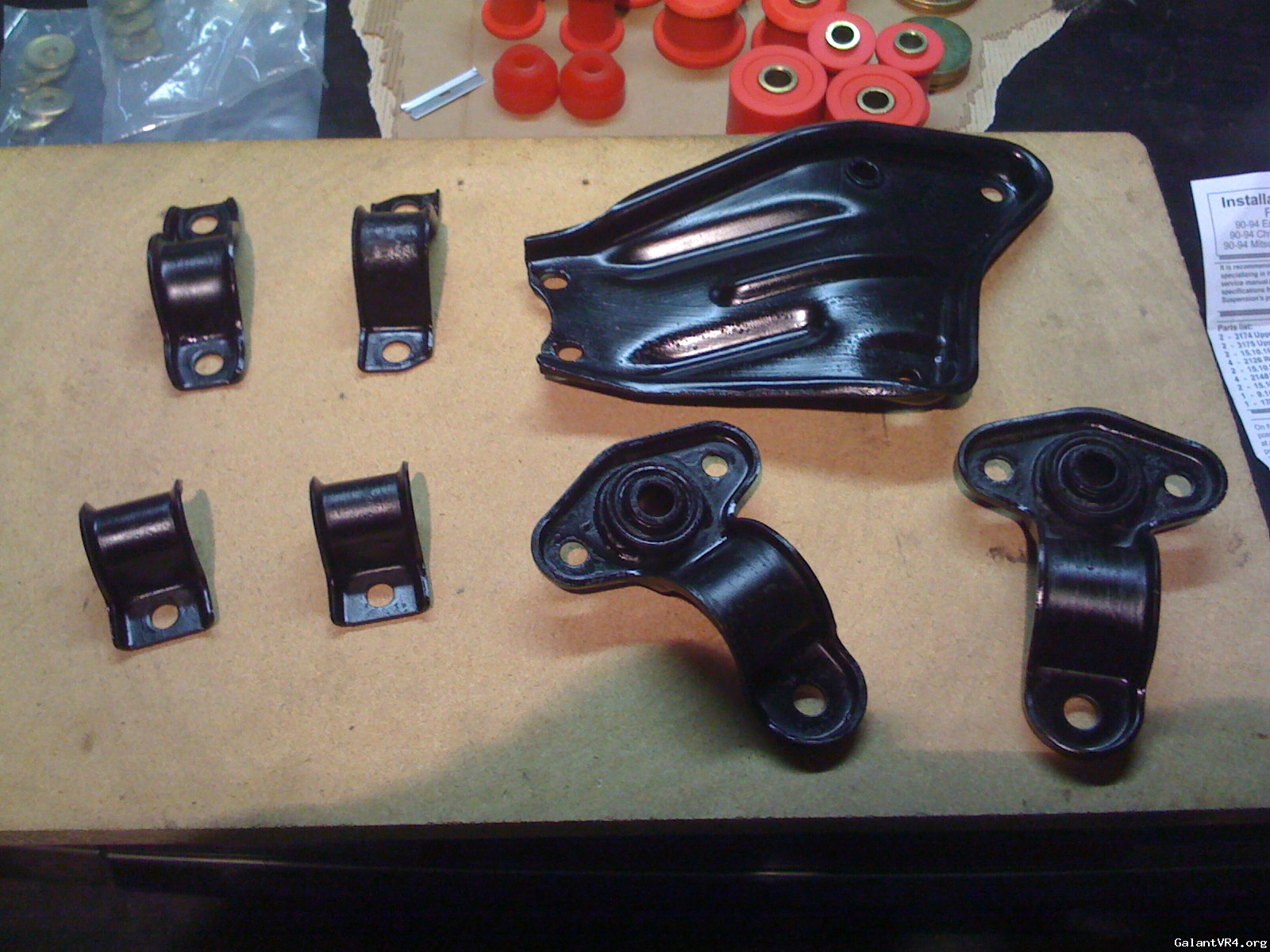

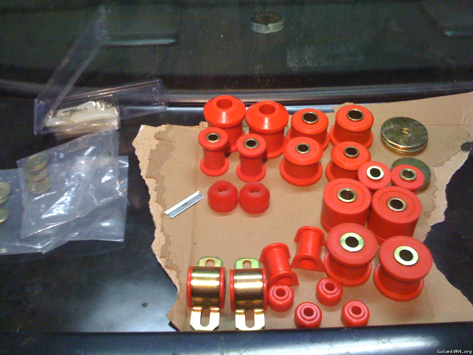

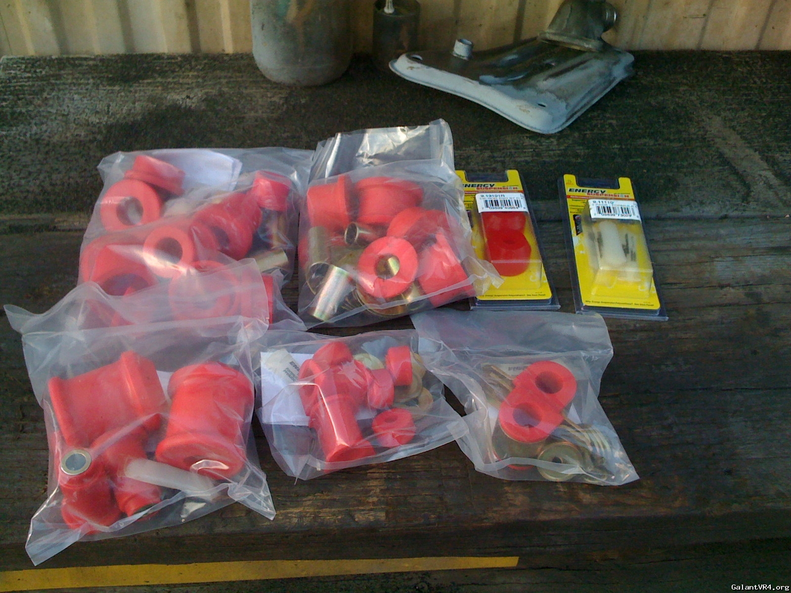

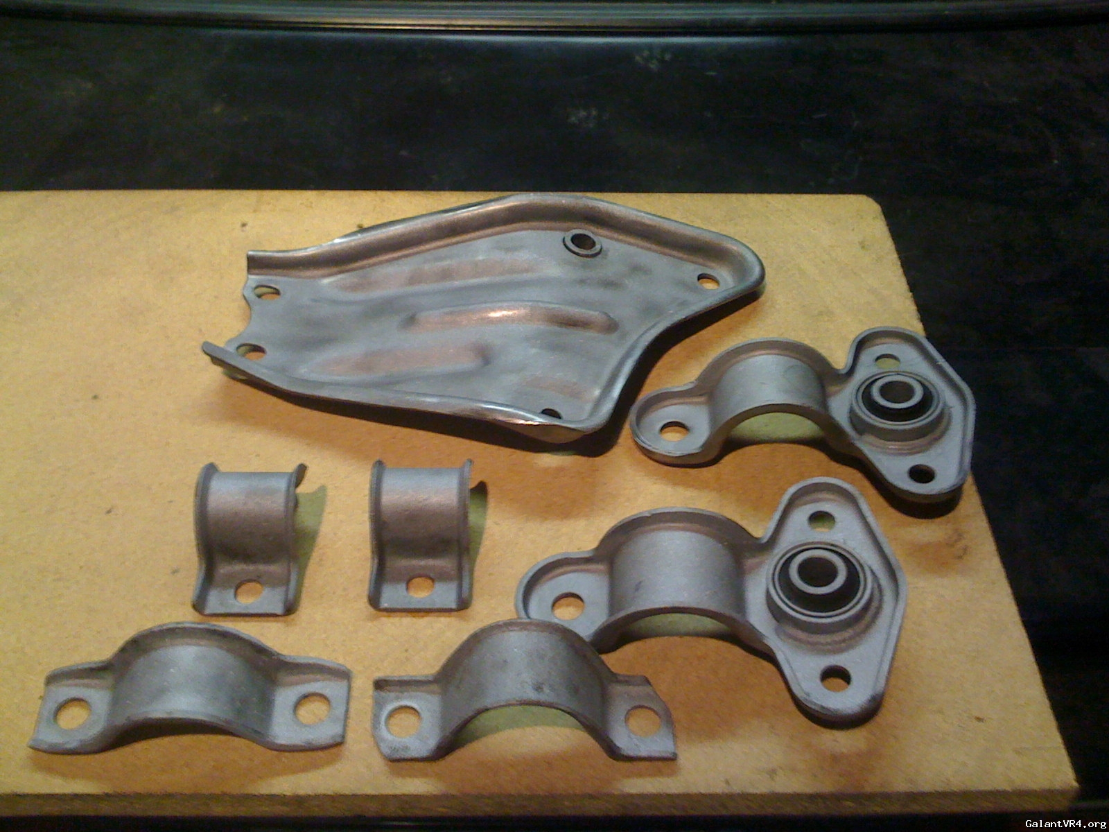

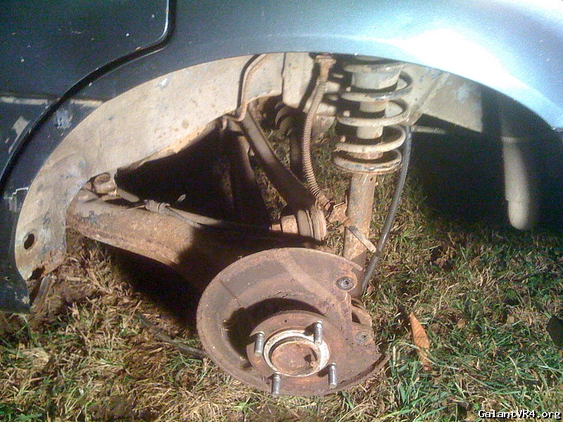

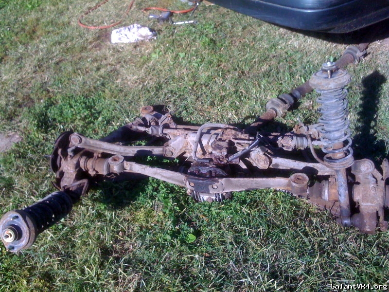

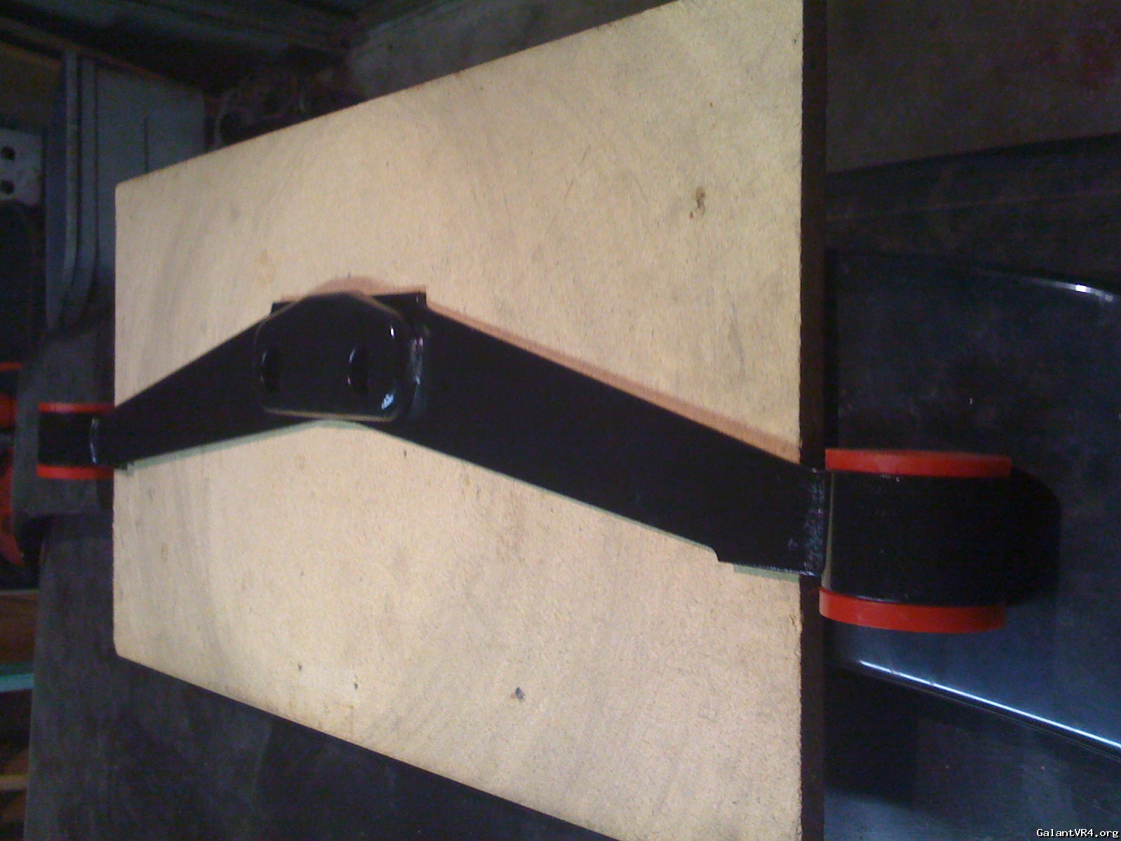

Finally getting some work done. Been working on suspension parts, finally got some of the bushings, and the rest are supposed to be here tomorrow. It's been slow going since it got cold. /ubbthreads/images/graemlins/frown.gif
14u2nV
Jul 22, 2004
9,398
Agency/St. Joe, MO

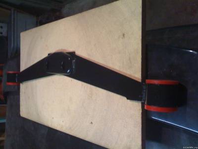

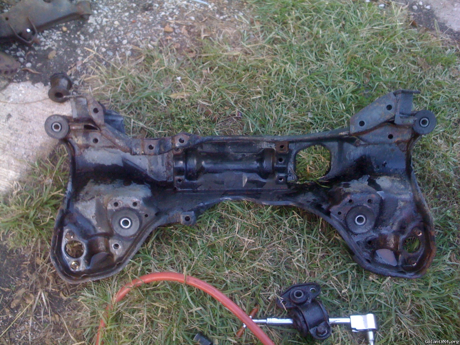

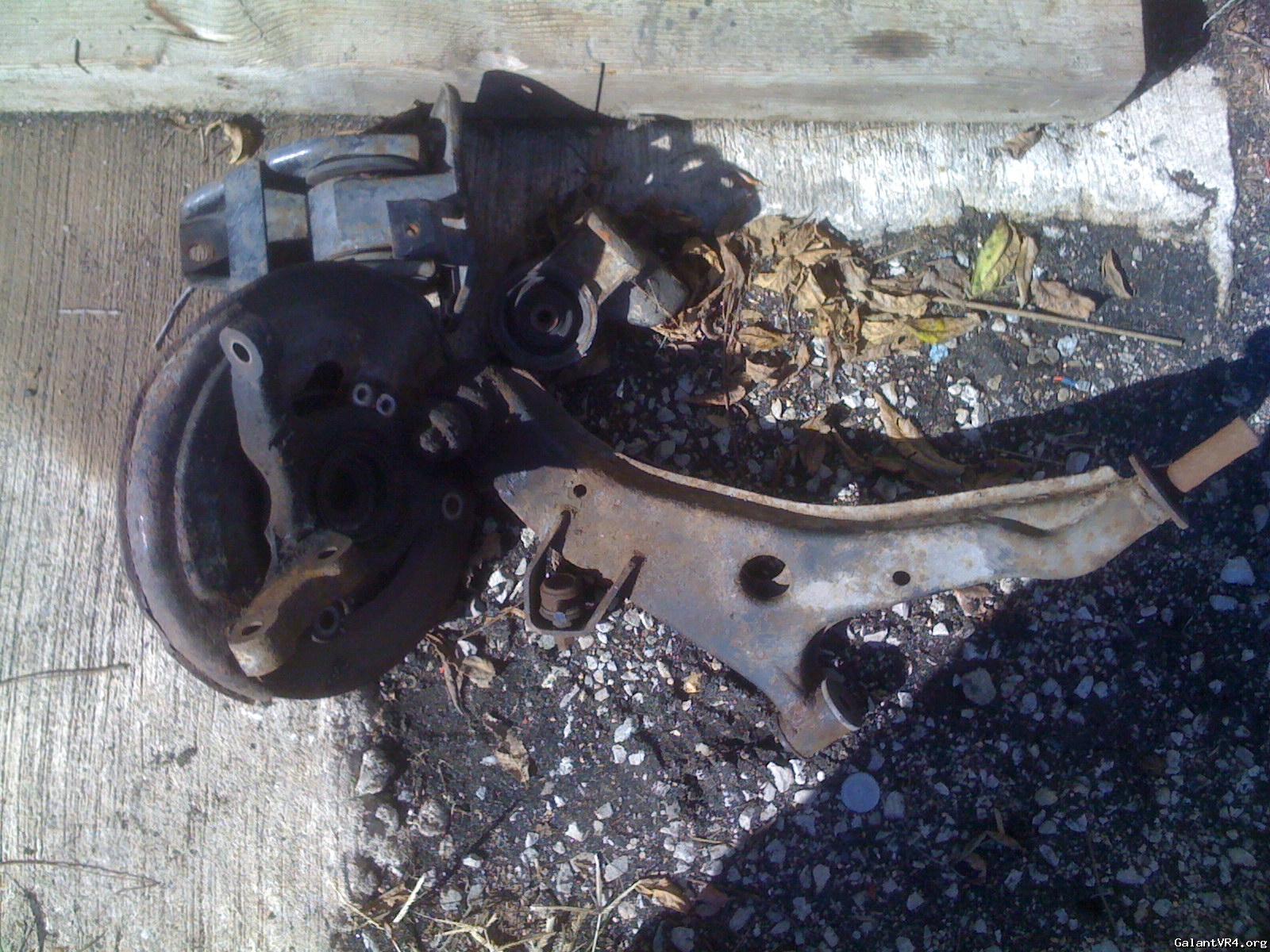

I've already got most of the old ones out, freezing the poly's makes it pretty easy to install. /ubbthreads/images/graemlins/wink.gif

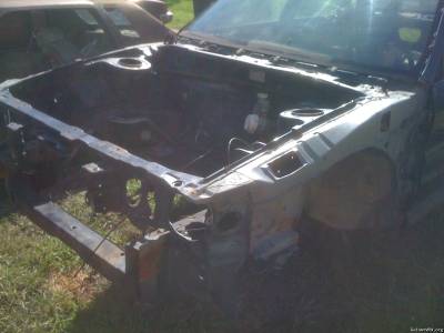

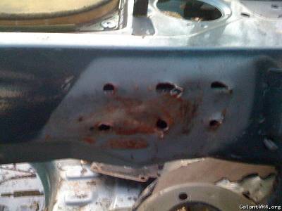

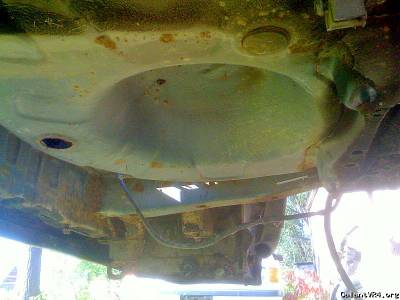

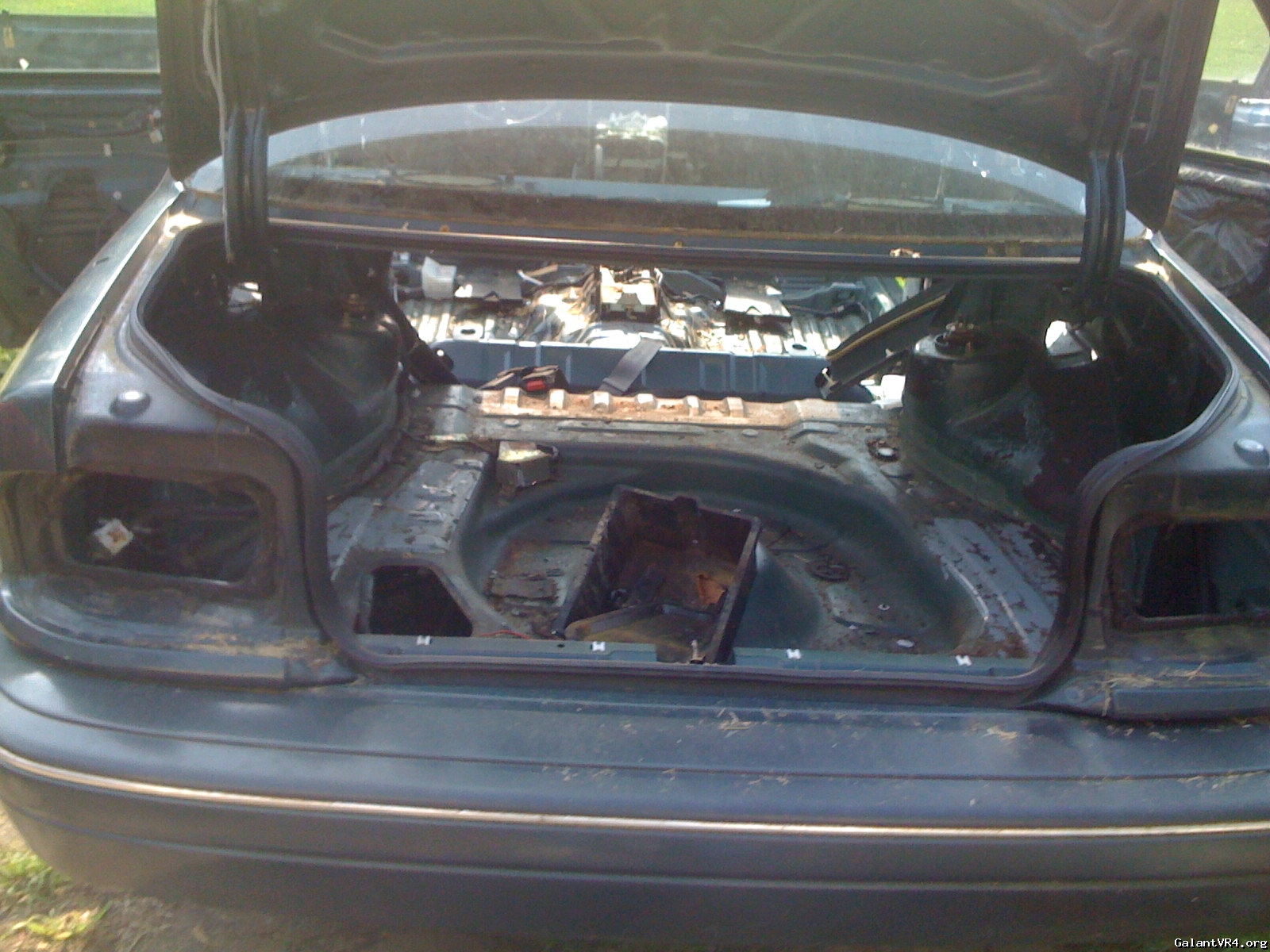

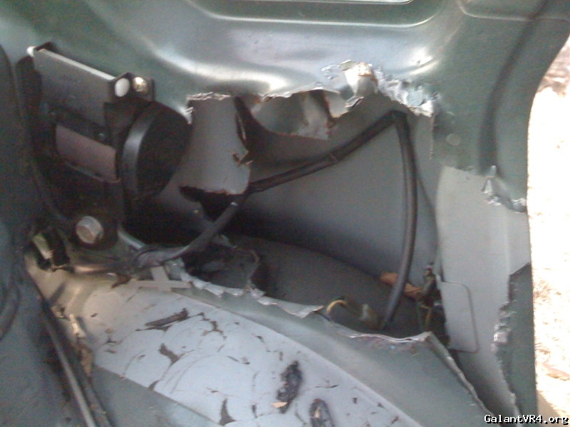

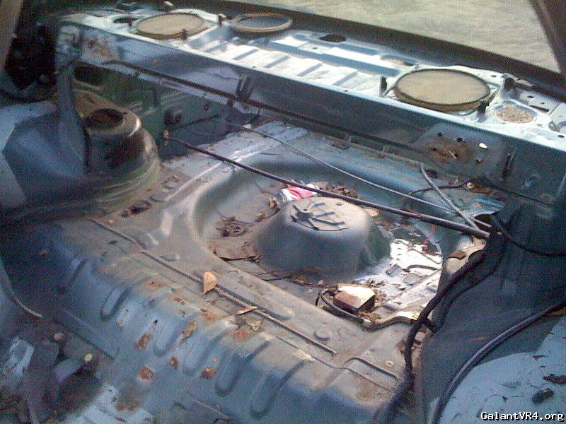

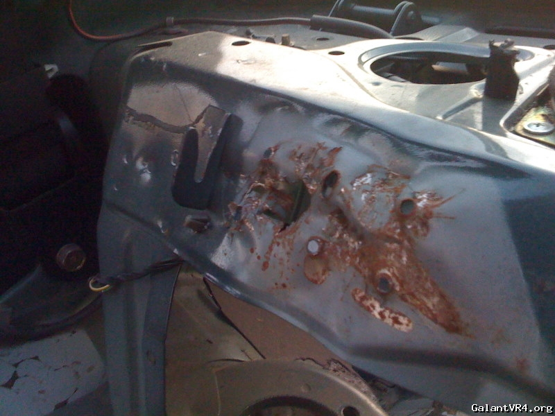

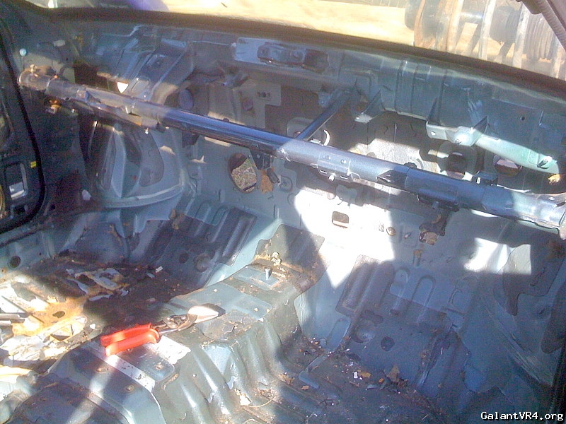

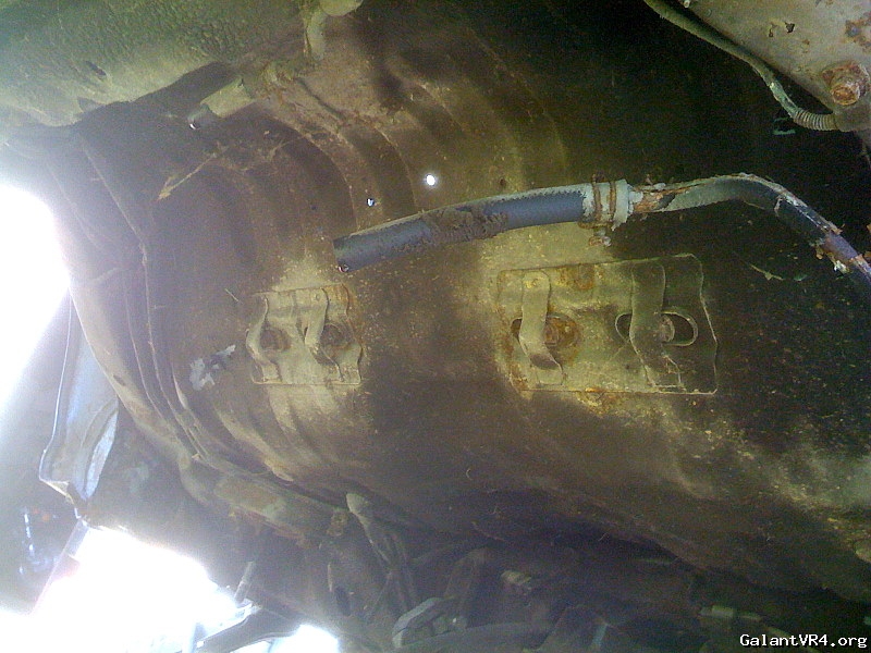

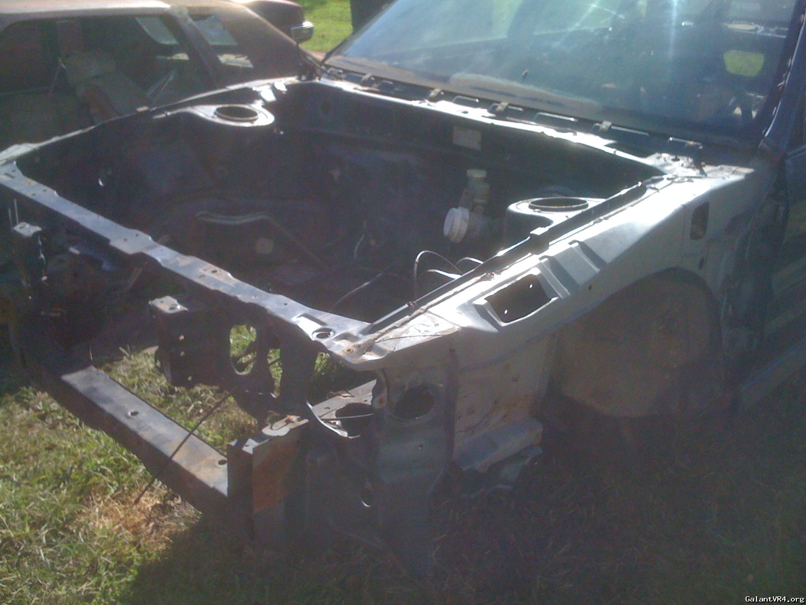

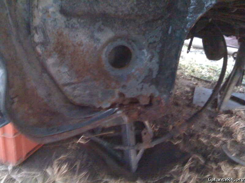

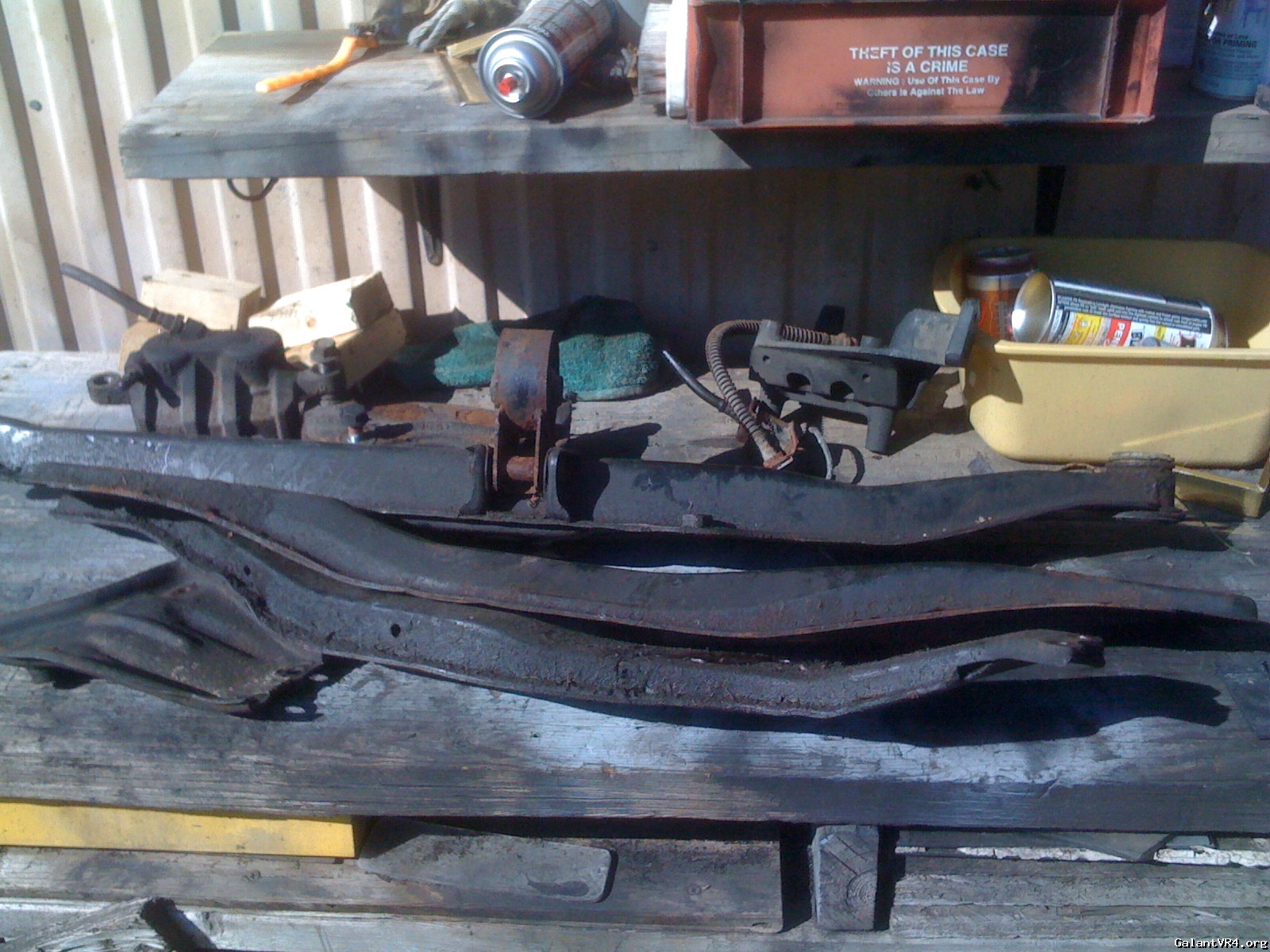

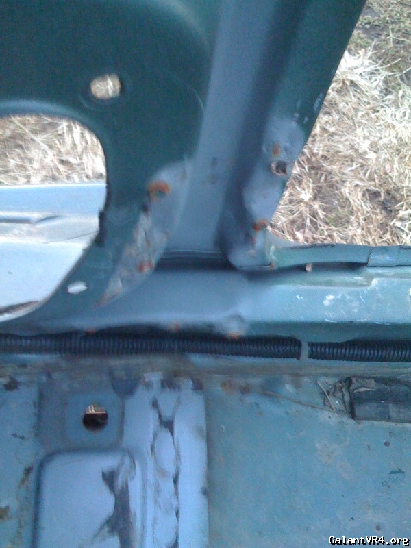

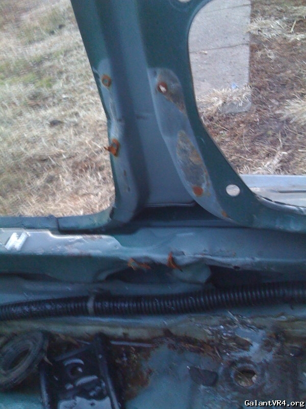

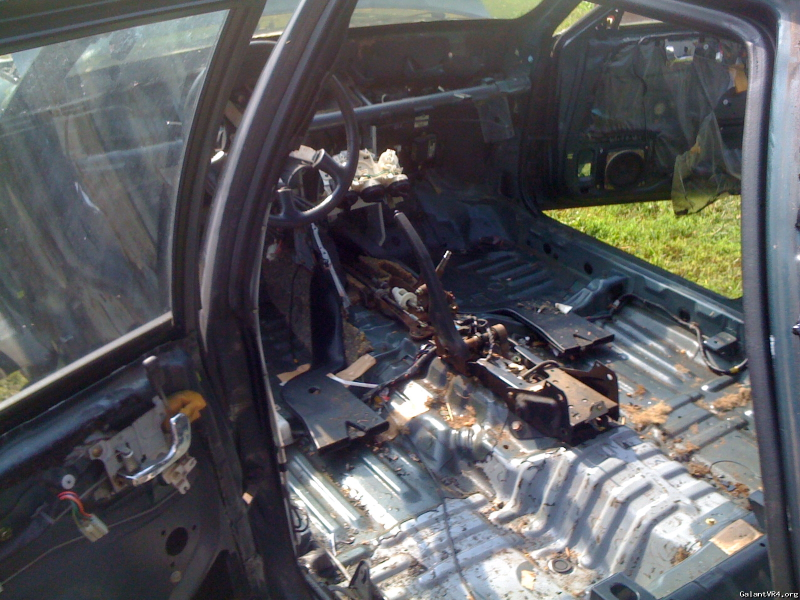

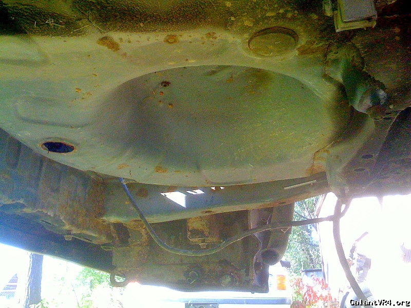

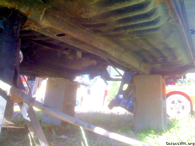

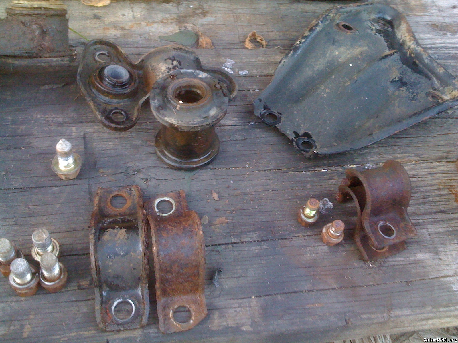

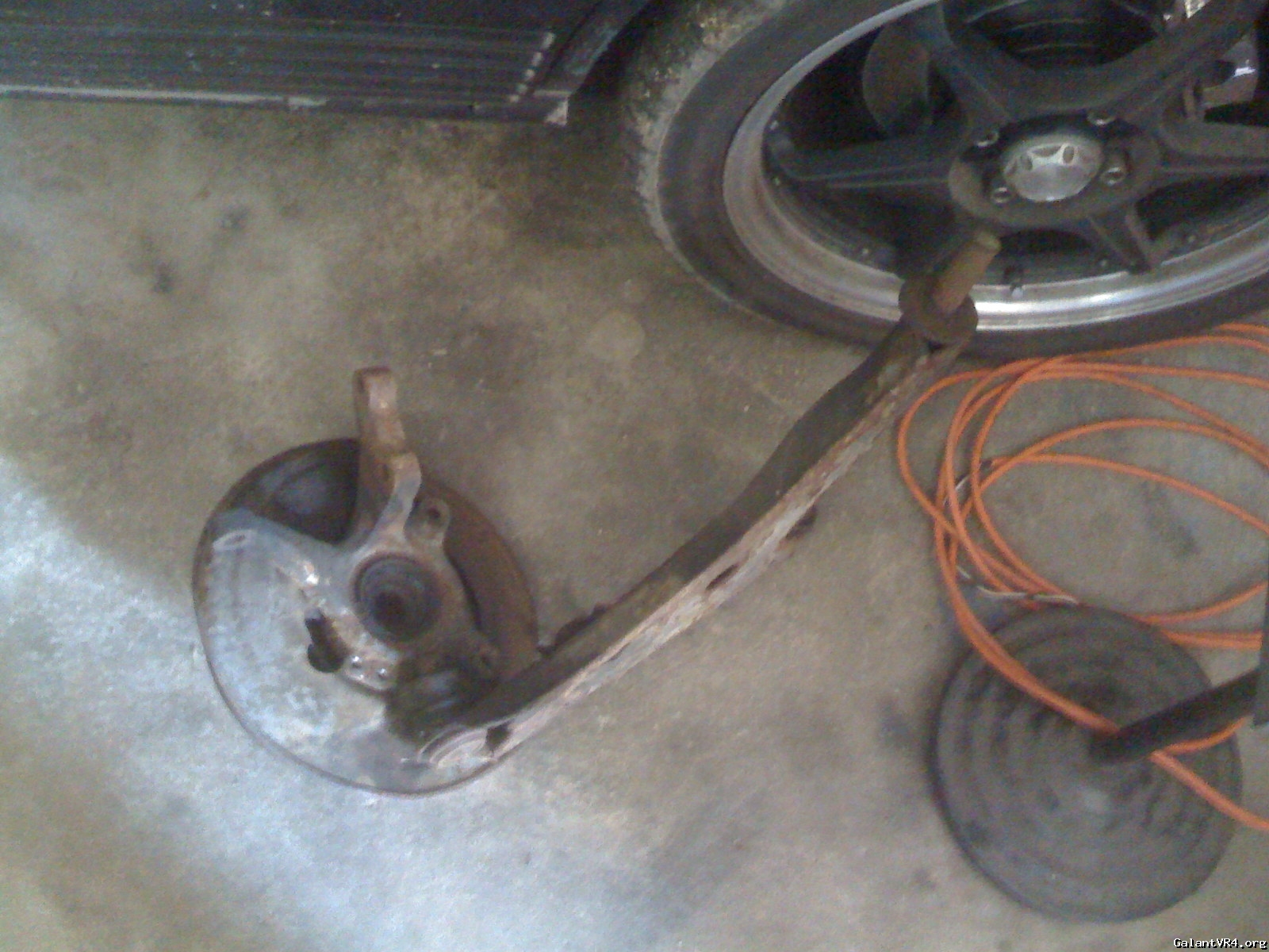

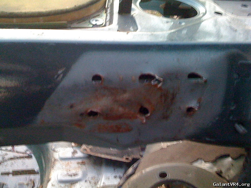

So much for saving 420. The more into it I get, the more bad things I find. First off, this thing seems like it sat underwater for a while, rust was worse than anything I've seen, broke dozens of bolts/screws. /ubbthreads/images/graemlins/frown.gif Now, look at the pix and see if you can find several things pushing me towards just scrapping the whole thing.
I cannot for the life of me figure out why the supports by the rear tails were cut out, nor the whole section by the rear seatbelt. I planned on removing the rear seat supports, but they are so hacked I don't even want to mess with it. The framerail under the driver side is pushed up like it's been dropped on a curb or something. I'd say the driver floor is pushed up almost an inch in the center. It really sux cuz the body is really in good shape, but I'm not gonna mess with it anymore. I'm keeping what I want, and pitching the rest.
* If anyone wants parts off the chassis, to repair wreck damage or something, let me know. Also, if anyone wants the whole chassis for anything, you can have it.
I'll keep the chassis till spring, then it gets cut up and scrapped. I'm gonna get another roller to do my rebuild on.

well, considering even once I fix it all, I'm not sure if I can even get the title, it's not a hard decision to scrap it. Has to be inspectable before I can go to the HP and apply for a lost title/etc.
No gas tank, didn't come with it. /ubbthreads/images/graemlins/crazy.gif
**I may have changed my mind. The problems can be fixed, and it would be quicker than starting over,, dunno. Gonna talk to my dad about the issues and see what he thinks. He's the bodyman around here. /ubbthreads/images/graemlins/crazy.gif
