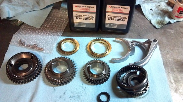

I tore the rest of the tranny apart and ordered anothezr: 3/4 synchro a new 1/2 hub and slider, new cut engagement 2nd gear, new 1/2 and 3/4 synchro dog keys and lucky for me I found a almost new 3/4 hub and slider in my parts pile.
So for sure my trans will be up to snuff for proving grounds 1 and 2.

All my new tranny parts showed up, and I picked up a used tranny with evo 3 stuff in side, it hurt the intermediate shaft and 4th gear so I have some extra parts and will buy a new intermediate shaft to fix this tranny for a back up this year.

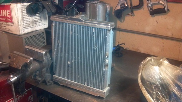

I am going to re make my heat exchanger tank and use my old radiator as my heat exchanger up front.
Here are the new tranny parts, I am going to run 2 quarts Mitsu MTF 75w 85 and the rest shock proof light gear oil.
