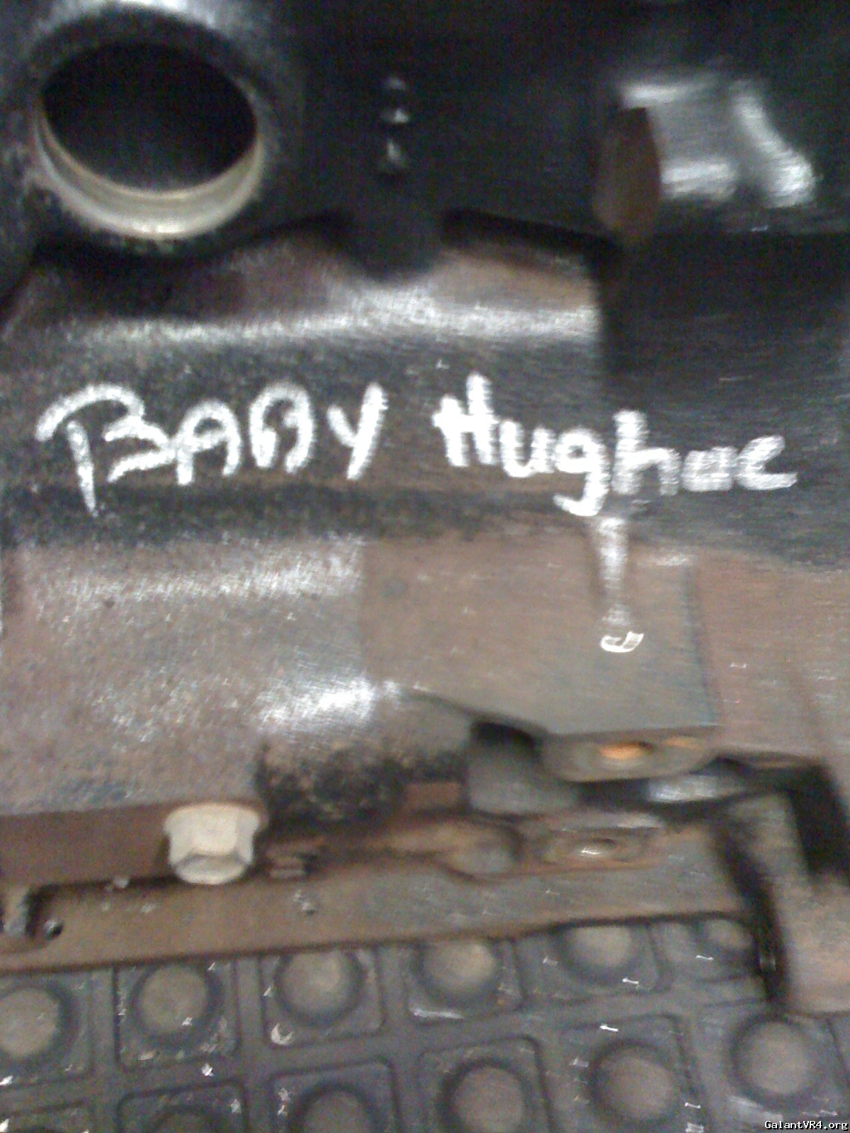

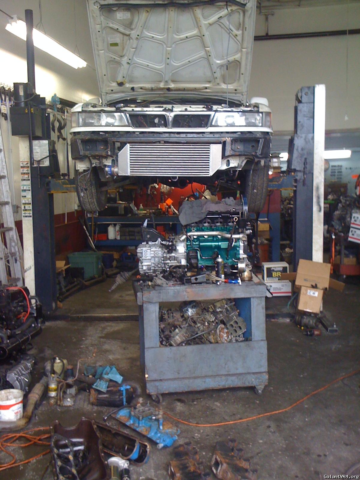

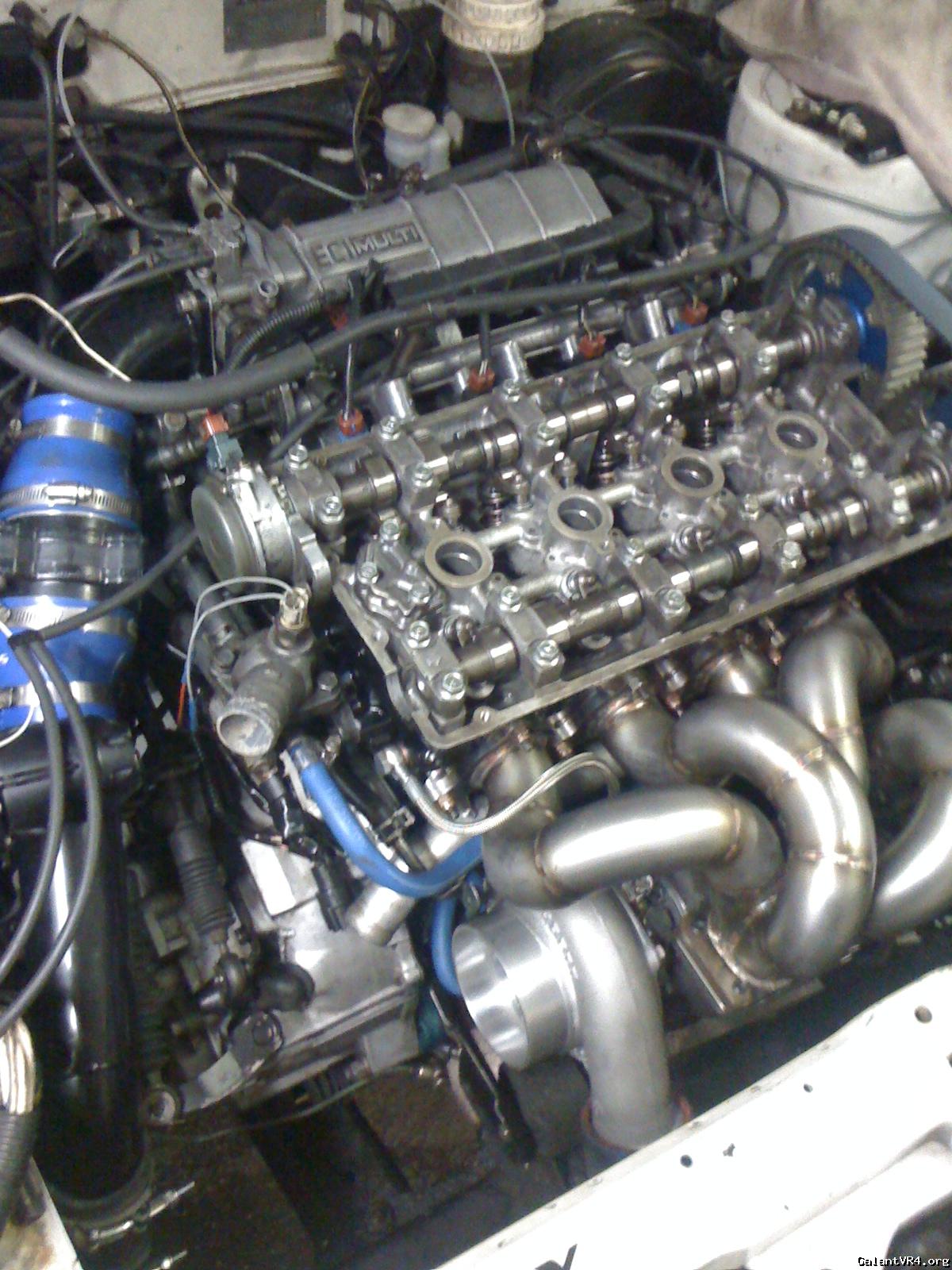

So my 2.3 build is on the way.

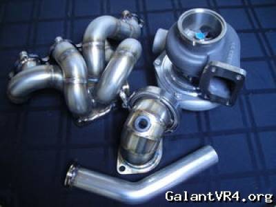

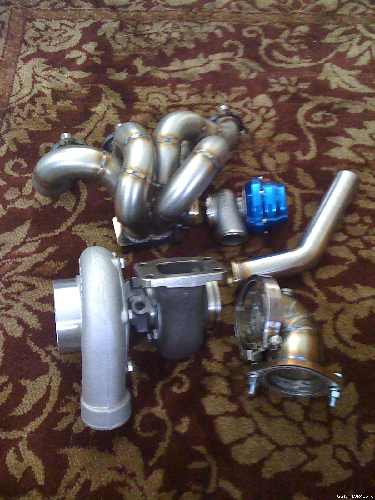

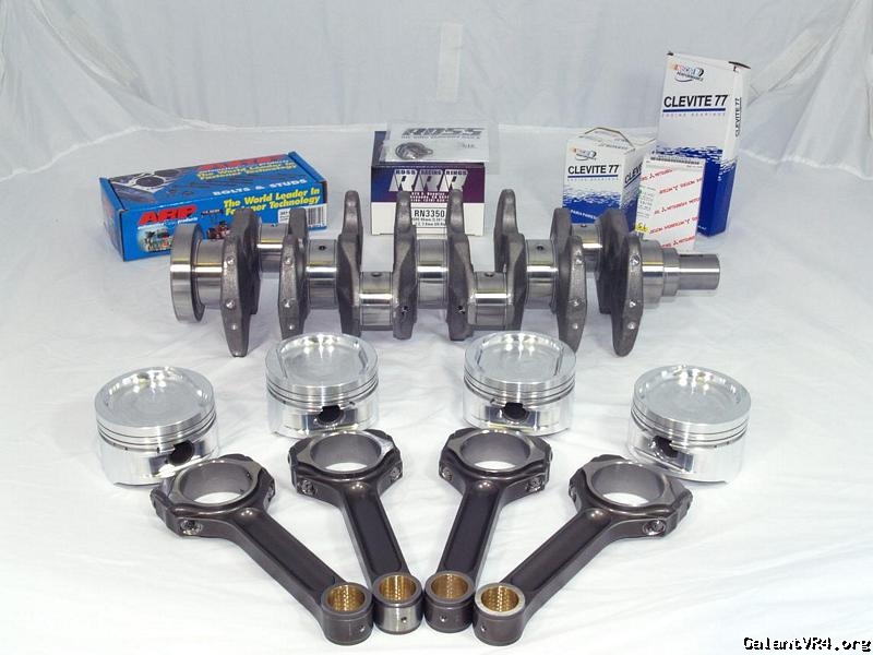

ordered the ams 2.3 storker kits

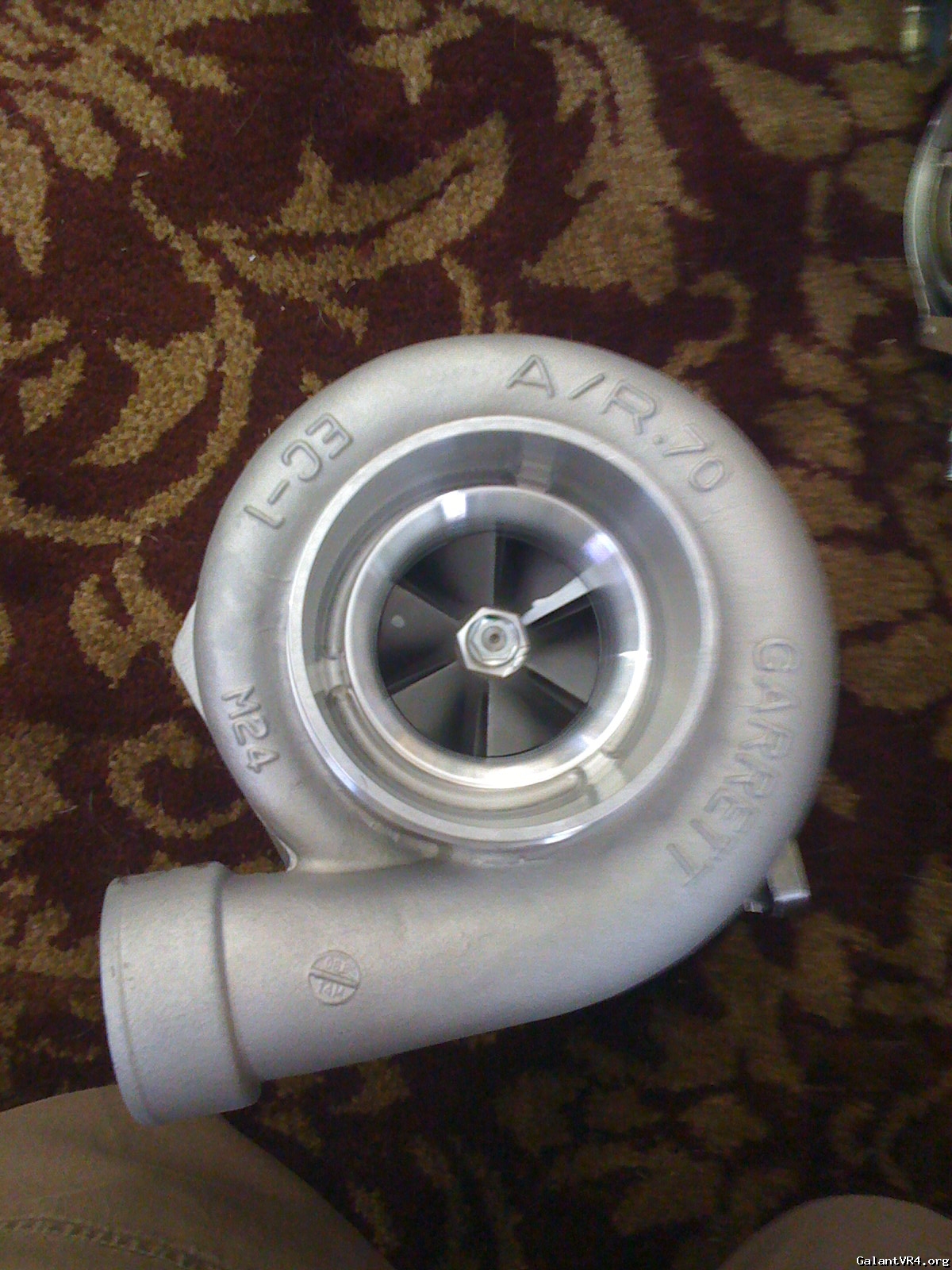

and punishment racing gt35r with a 44mm tail wastegate

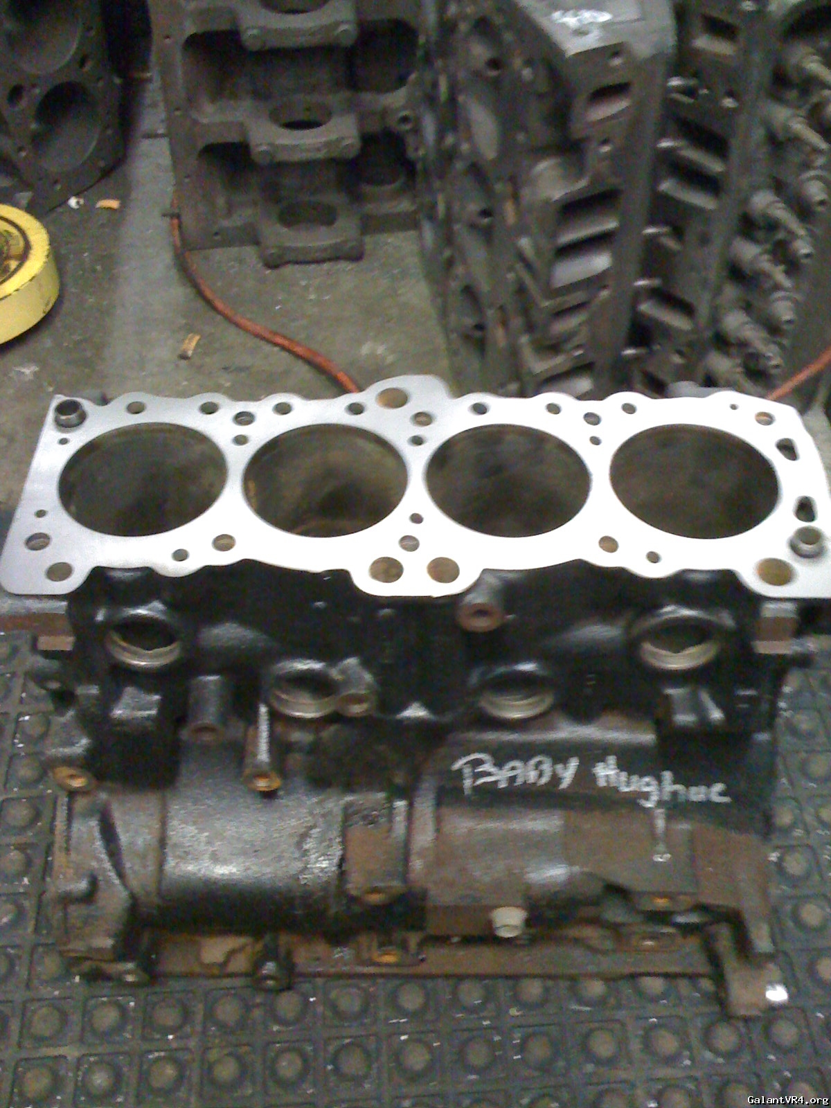

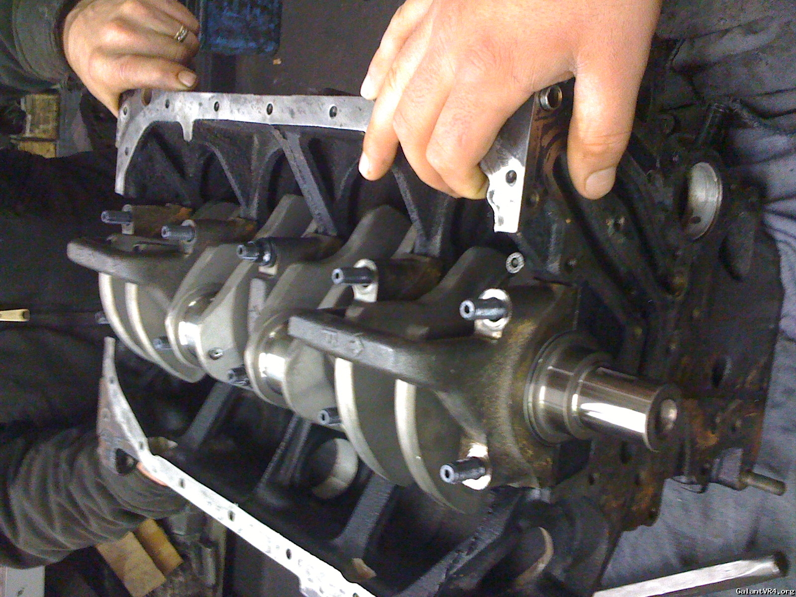

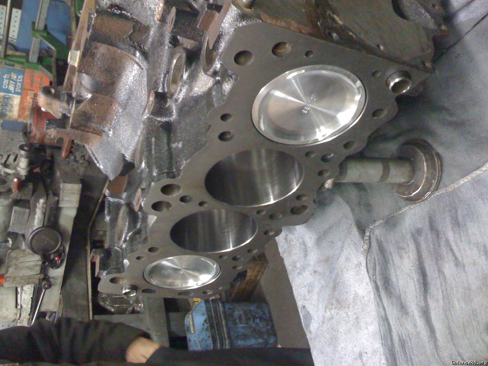

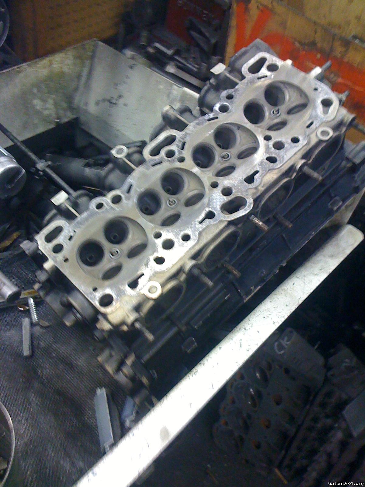

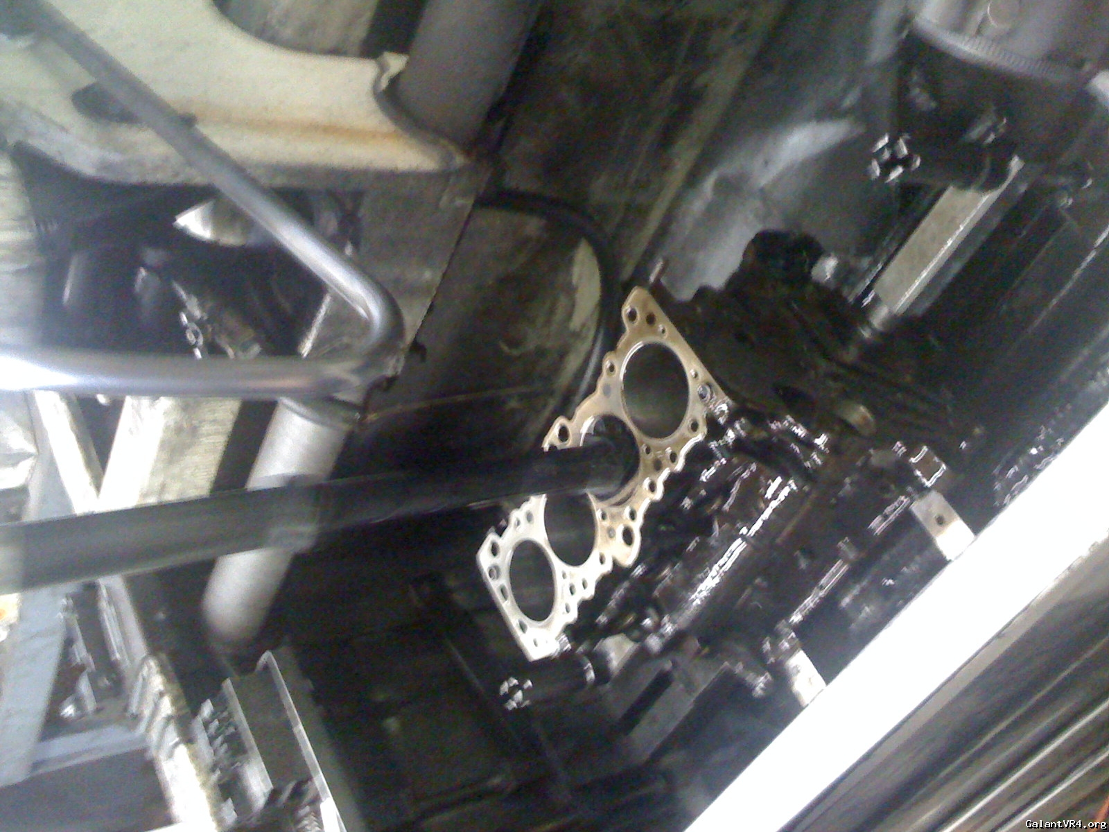

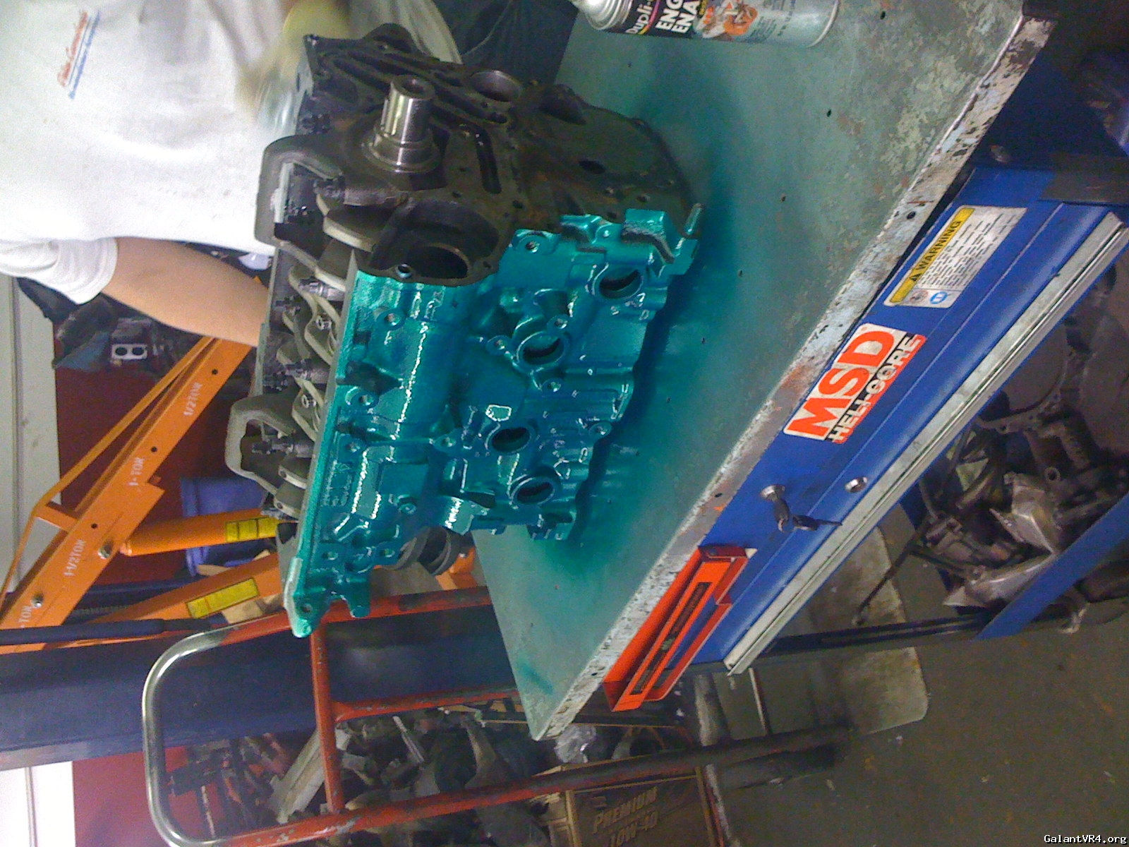

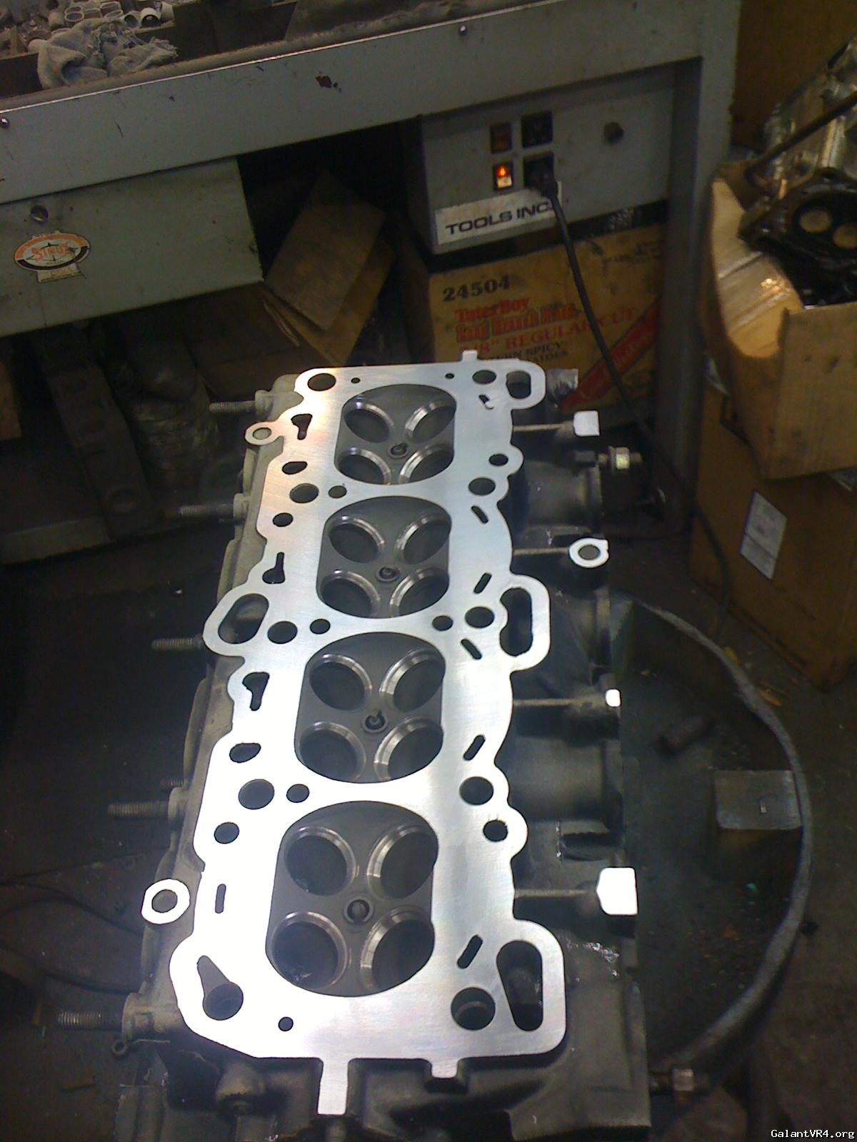

block is in the shop right now is honed and waiting on the stroker kit to get here, to be bored and put together.
i didnt name the build my machinist did
looking for big power
mods already done:
shep stage 2 trans
272 hks cams
greddy cam gears
ported intake
1mm o/s intake valves
exhaust is stock
255 walbros
850cc fic injectors
dsm link
3 gm maft
3in custom exhaust no cat
act fly wheel and clutch
i think thats it
will post more pics as they come

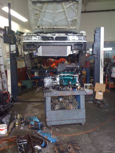

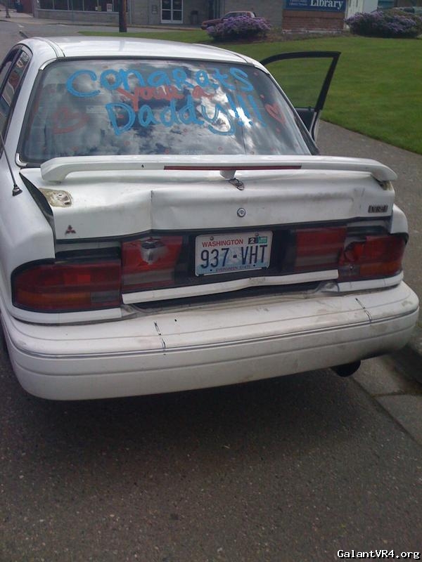

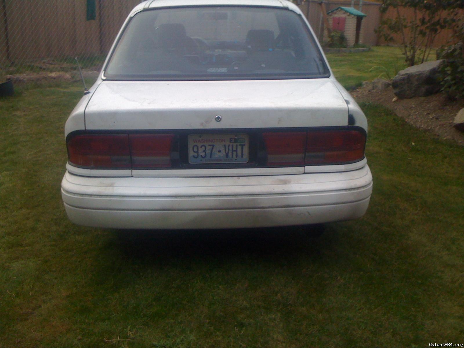

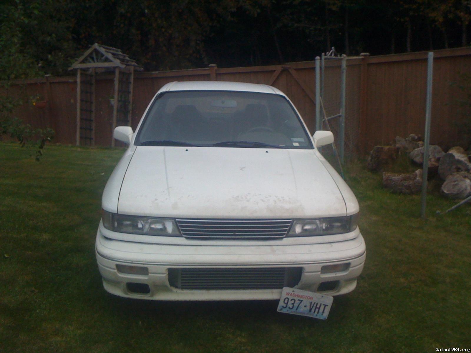

update was rearended by a f250 wit a brush guard last weekend just found out that there going to fix her all back to new and the bottom end is all done just have to wait on the turbo to get here and the rear to be fix and she will be back on the road wit a new paint and motor =)

Sweetbuild man! I almost wish someone would rear end me ever so slightly like that so I could get a new paint job! Haha I bet we all do..

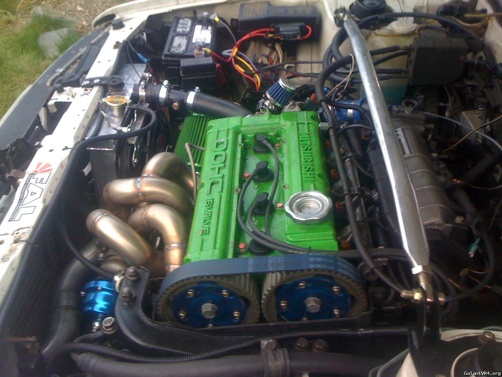

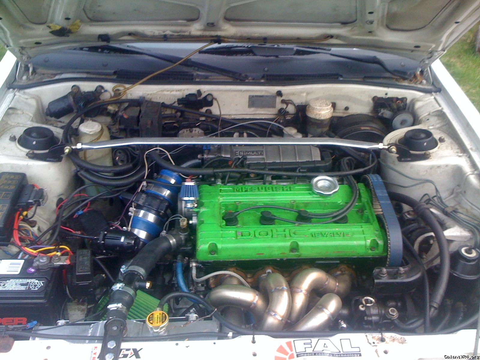

That's a good idea I'll do that and keep the parts. I painted the block green cause I want my car to be different and the other fact that I just don't pop my hood for just anyone to see.

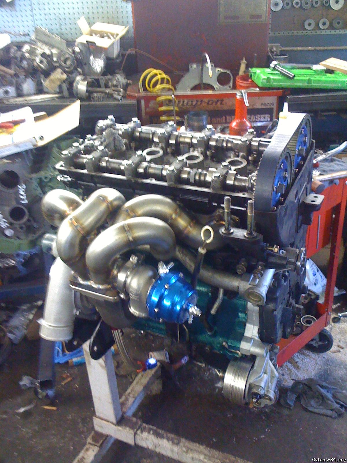

yeah i got my turbo in finally just waiting on the clutch and head gasket then the block will be done now just waiting on the dumba** who hit me to get his act together to i can get it fix

Quoting 91gvr4gsr:
2.4 block?????i want a stroker so bad lol
2.4l is not a stroker.
Compared to the stroke of the mostly common 2.0 4g63, I'd say it is.
Nice build!
slugsgomoo
Oct 16, 2003
3,781
Tacoma, WA
by definition, a 2.4L is not a stroker, as it's using the correct crank. a 2.4 crank in a 2.0 block becomes a 2.3 stroker. A 400 crank in a 350 block becomes a 383 stroker...
The point is increasing stroke without increase to deck height or bore. /ubbthreads/images/graemlins/wink.gif

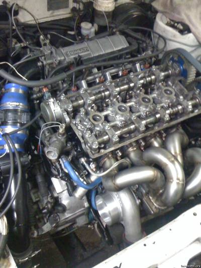

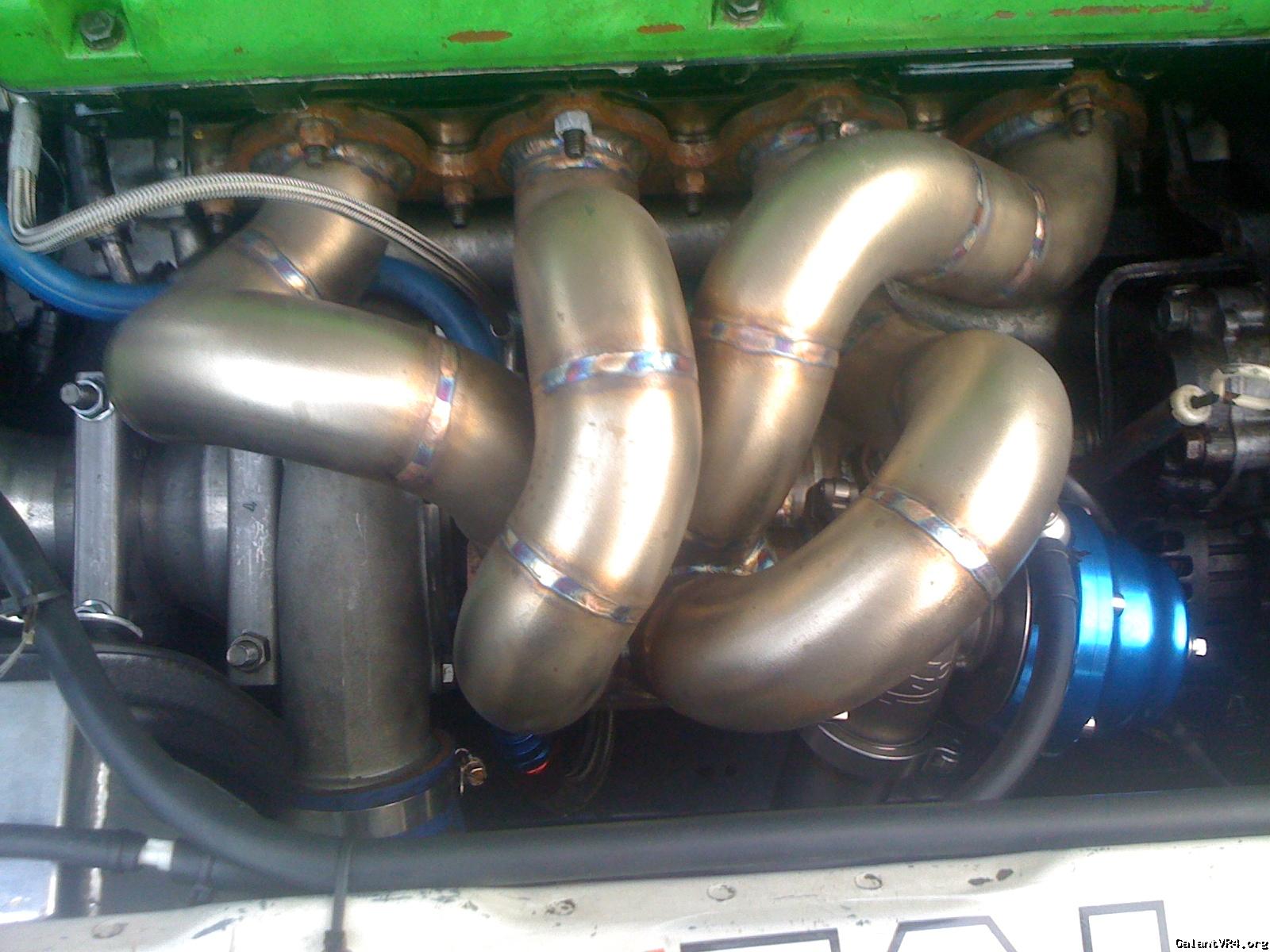

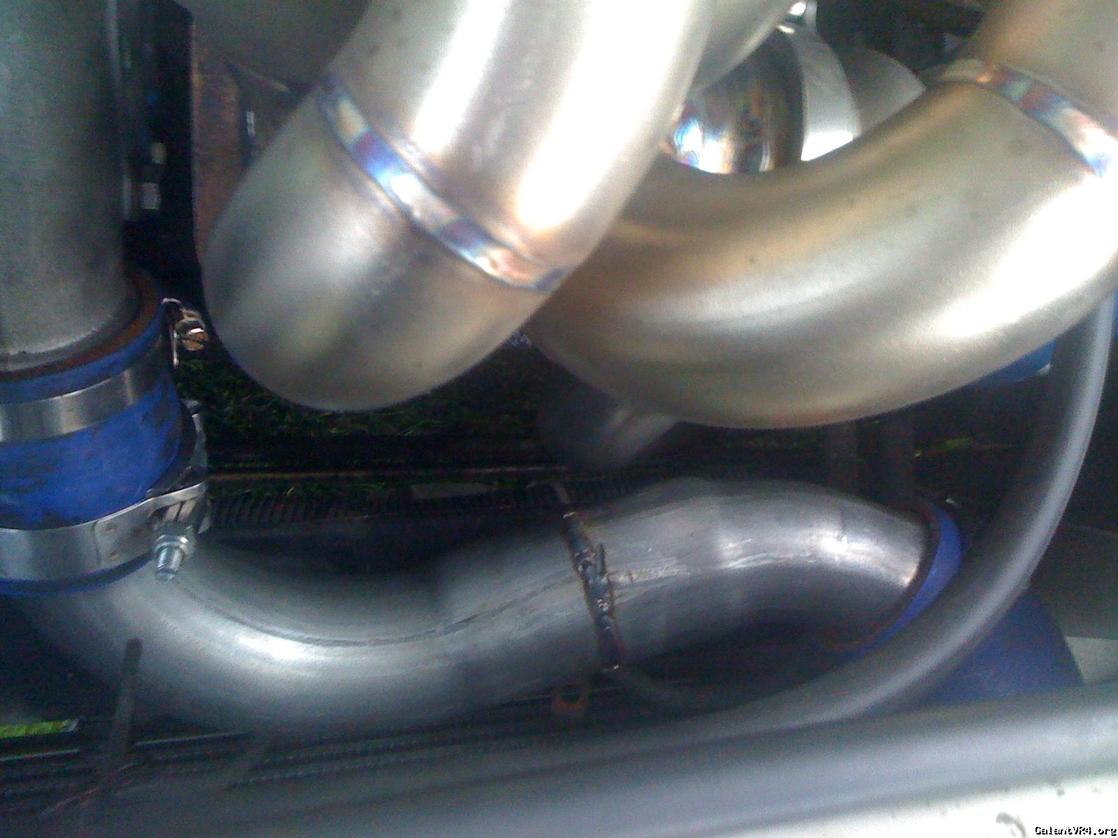

finally after all this time of waiting my car is finally done had to do some custom work cause of the big turbo half core radiator new charge pipe all thanks to my friend scott who did an amazing job... the car fired right up first try break it went better than ever no overheating no leaks car it doing great on the road runs so smooth but only got 10 miles on it i need to get someone to tune it probably going to english racing to get done
The green and blue reminds me of the first fast and the furious...not that I've seen it...but I heard /ubbthreads/images/graemlins/uhh.gif
Very nice looking build. I want to see numbers
