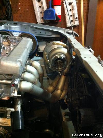

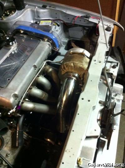

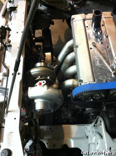

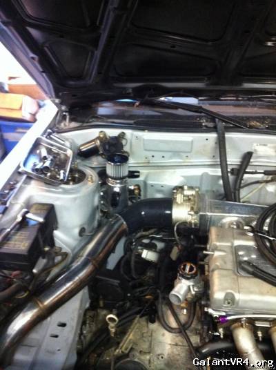

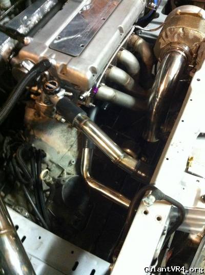

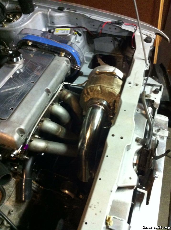

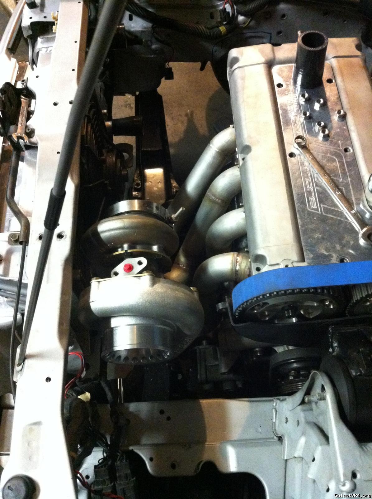

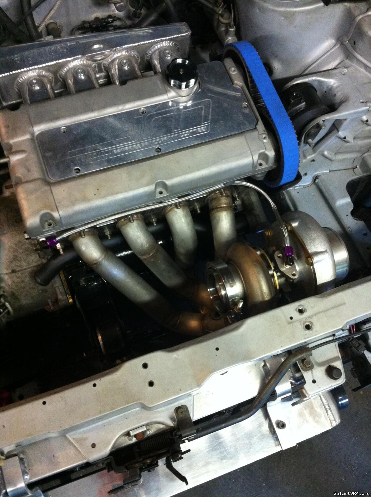

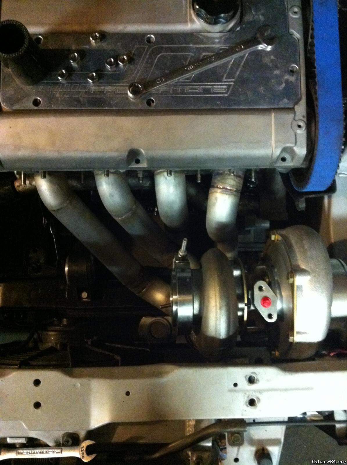

All the fab works look great, but I had a thought. It looks like you are running solid engine mounts in the front, but You engine is still going to move back and for under load. I'm not sure how long those pretty pipes are going to hold up if your turbo is mounted to the rad support. Just a thought. Looks nice though.
rexwagon1909
Jan 22, 2012
165
Hurricane, WV

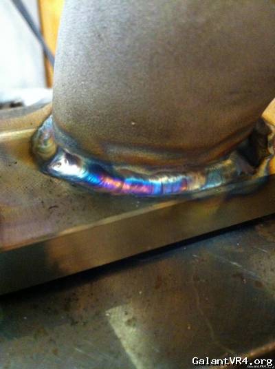

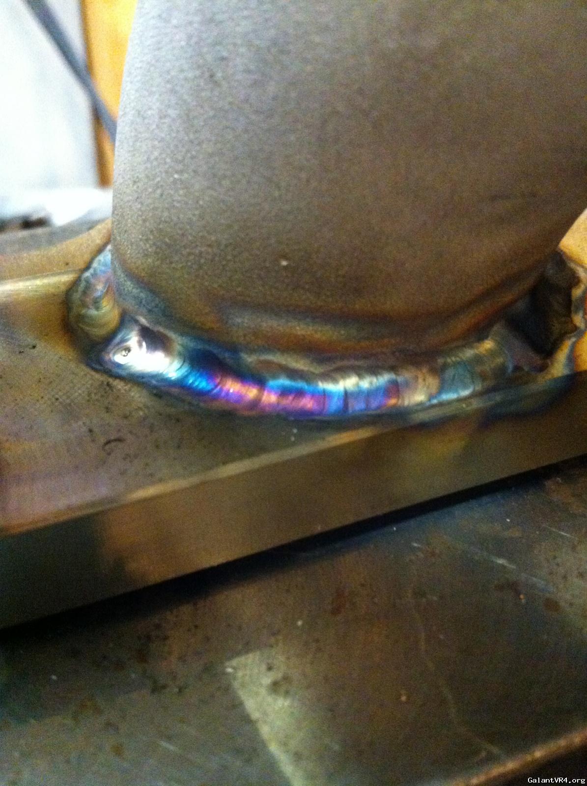

Thanks for all the good feedback so far guys. As far as turbo location we used the bracket connected to rad support for manifold fabbing. If you look at the pic with the three runners done its gone lol. Manifold should be done this week, next is fuel lines and custom coolant pipes

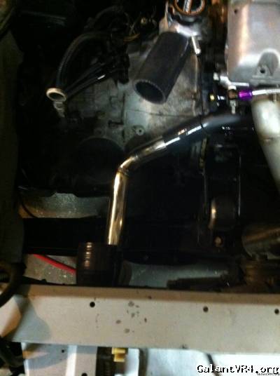

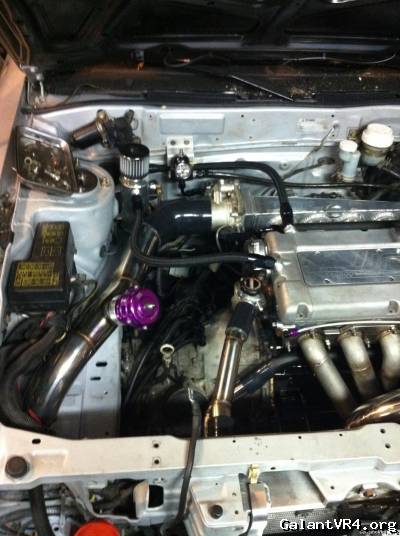

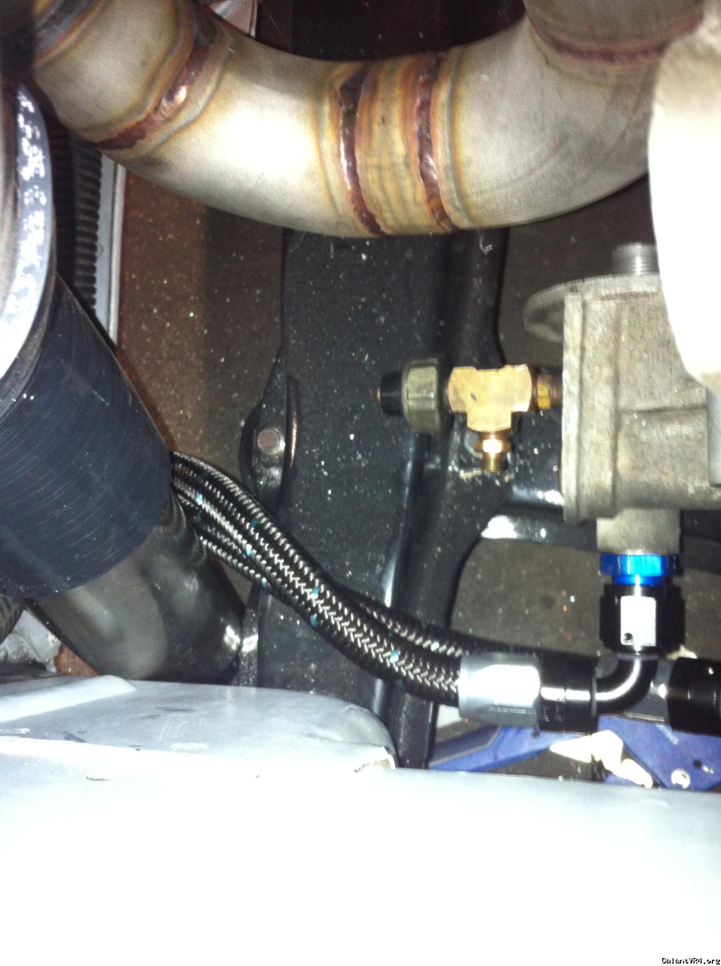

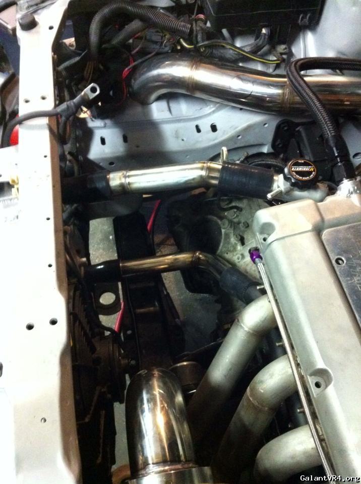

Been some set backs on the car. My builder (motor, trans, turbo setup, FMIC, and fuel system) fell behind due to too much work etc. Finally getting things finished up hopefully done very soon. I am using a purple tial bov and waste gate, to match this for oil feed line I found a 24 inch 4AN PTFE braided N20 Line from NEX systems. Looks great and matches my color theme.

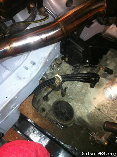

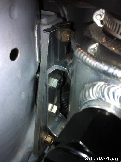

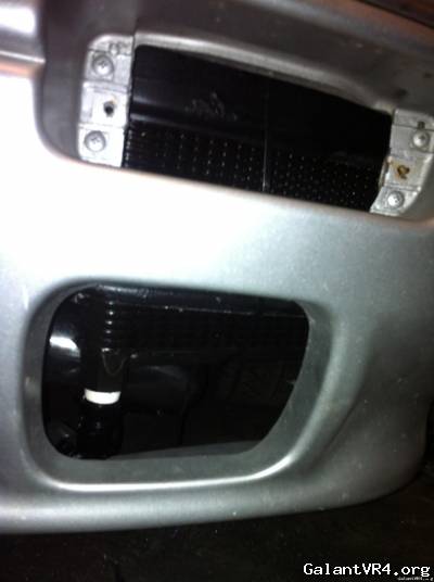

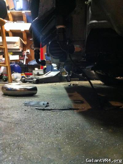

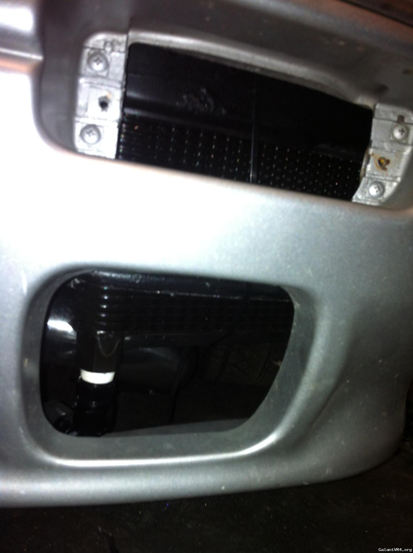

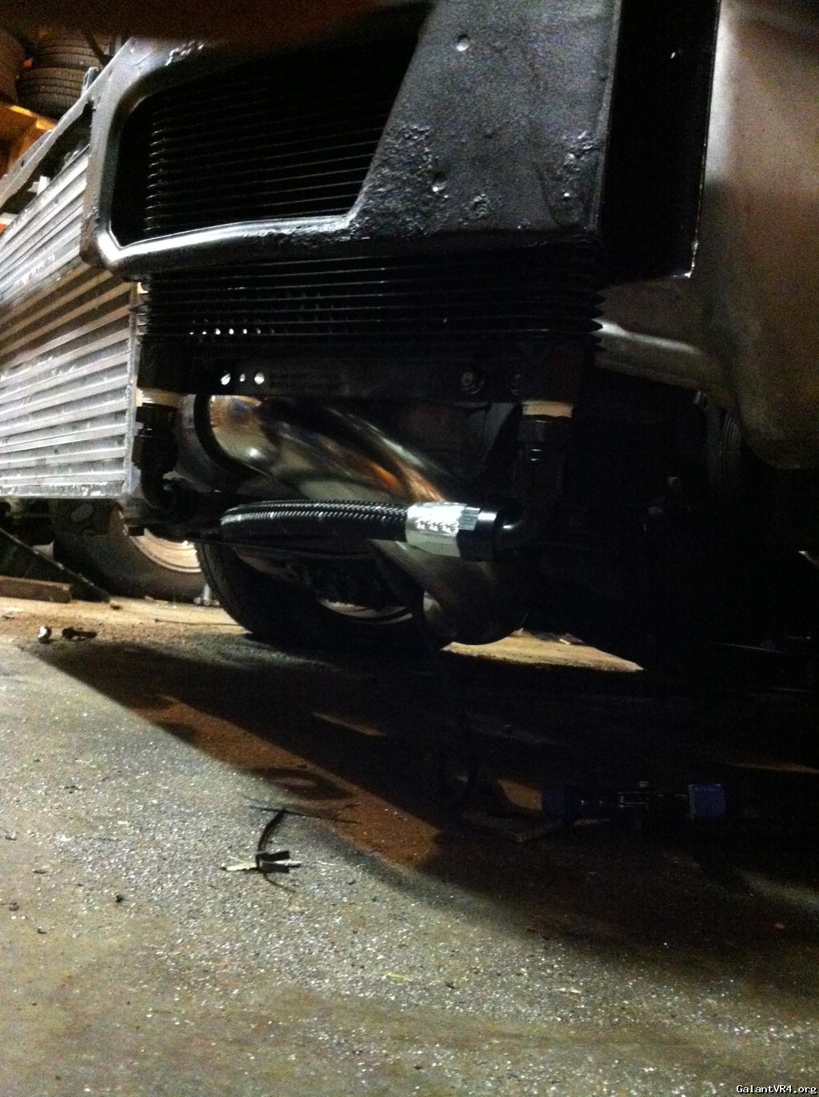

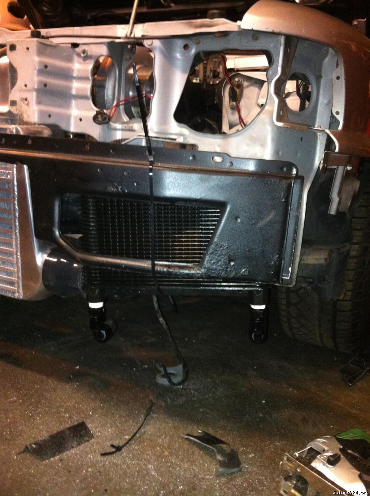

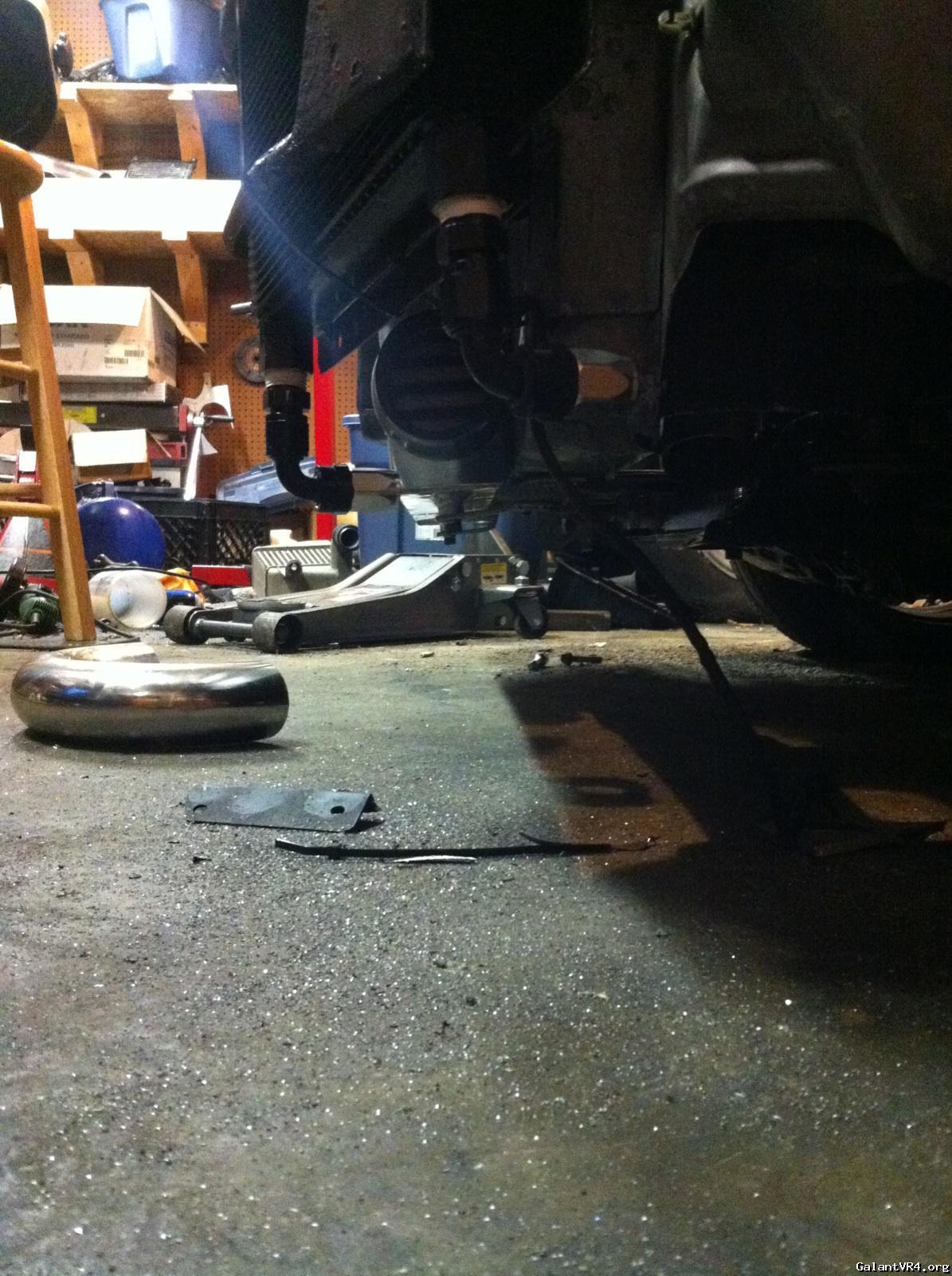

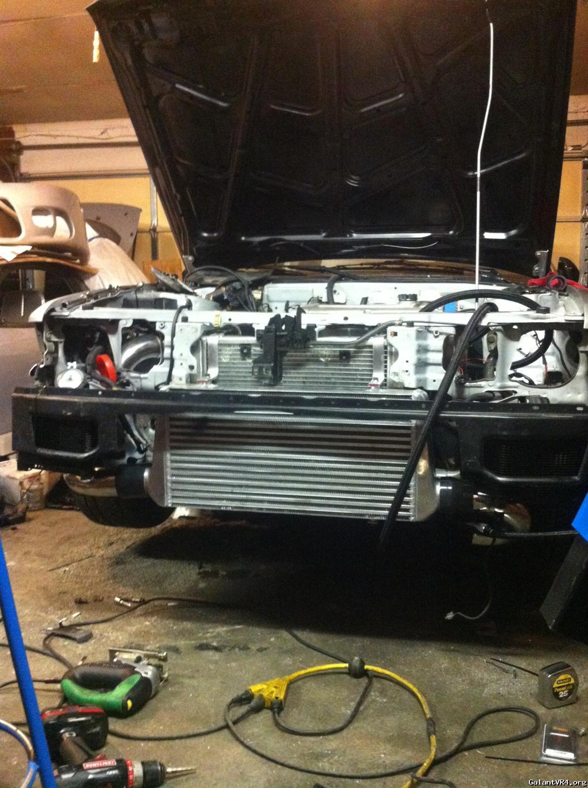

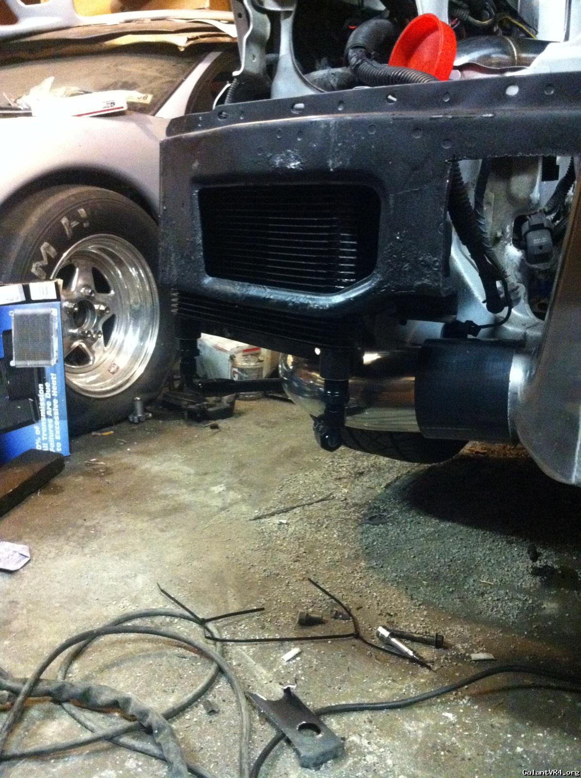

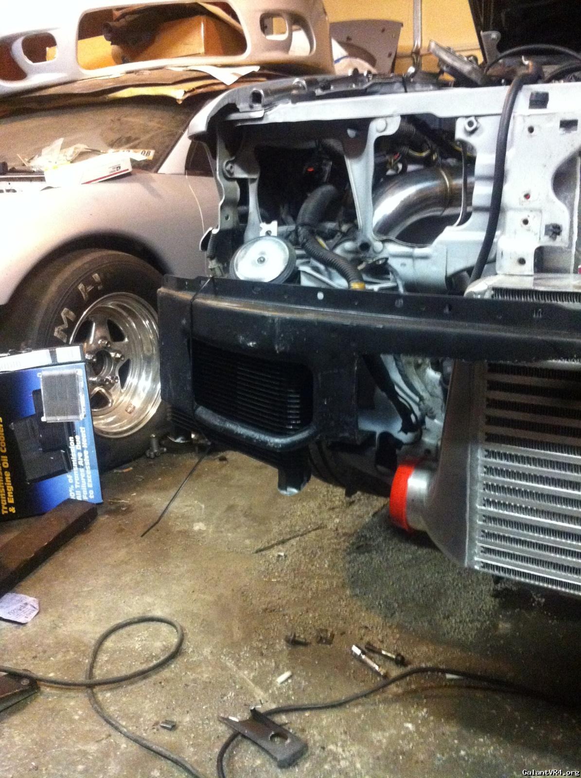

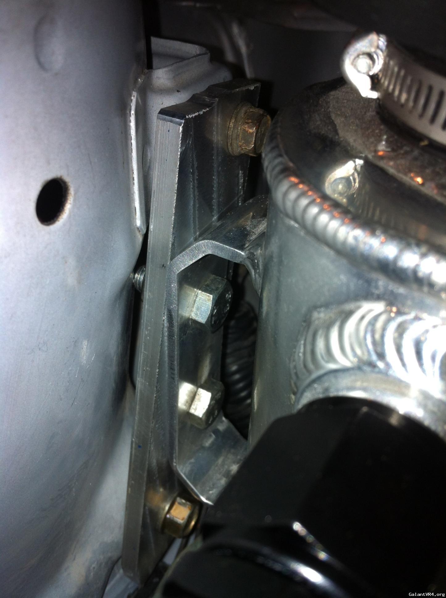

To run Oil cooler lines and trans cooler lines, we had to find a solution due to the lack of room due to afco radiator and large FMIC. Solution has to modify bumper supports and make removable brackets to hold an oiler cooler on one side and trans on other. So far oil cooler has plenty of room and clearance (almost 8 inches from lines to ground even with car low from coil overs). Using all russell pro classic lines and fittings.

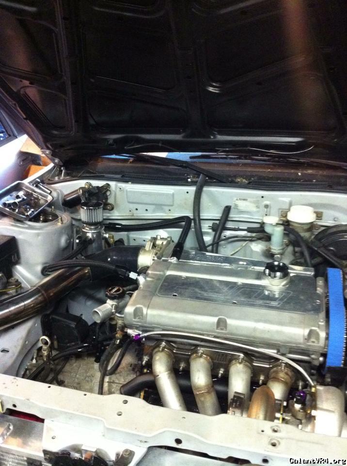

More Pics More Progress>>

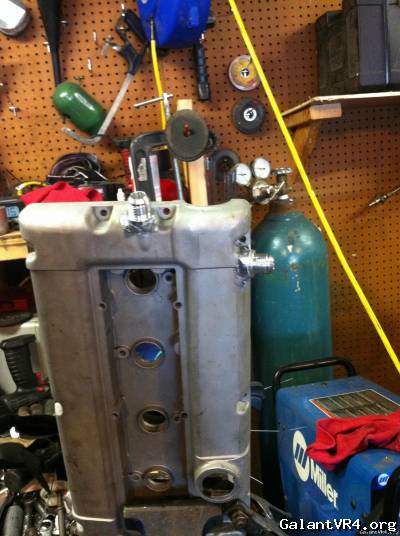

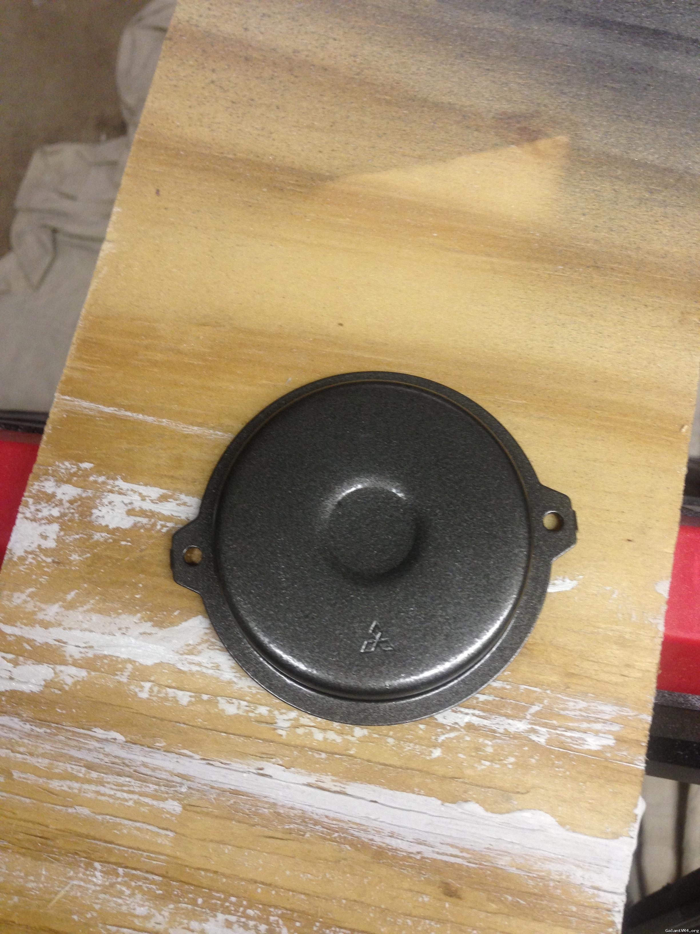

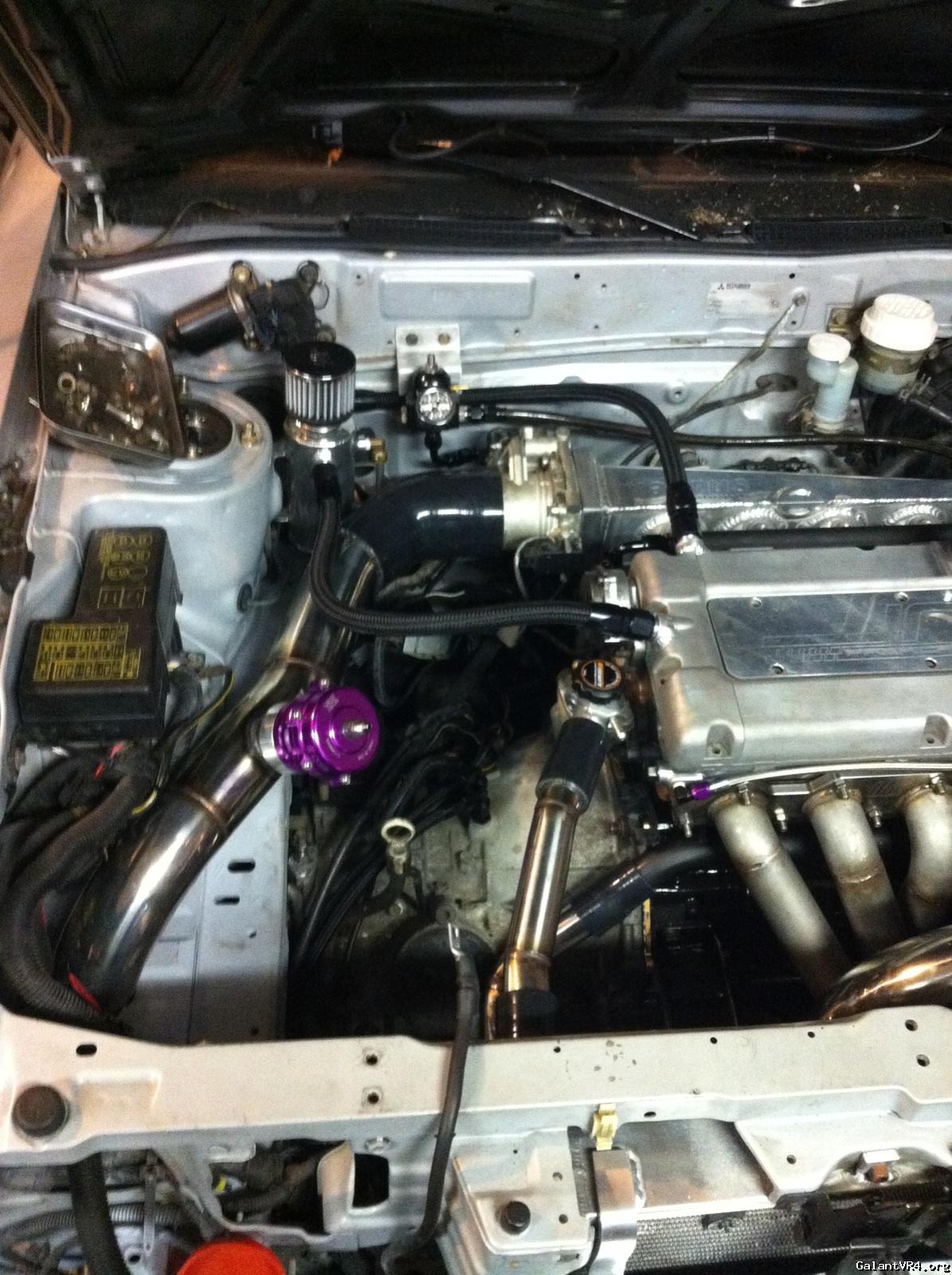

Valve Cover is done, 10an bungs welded on
JMF deluxe Catch Can mounted with custom mount and lines ran

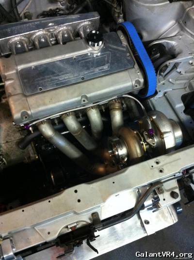

Turbo blanket from Real Street Performance (Thanks Fernando for a sweet deal) put on for fitment, and custom downpipe being made by Dee at DmF in Huntington, WV.

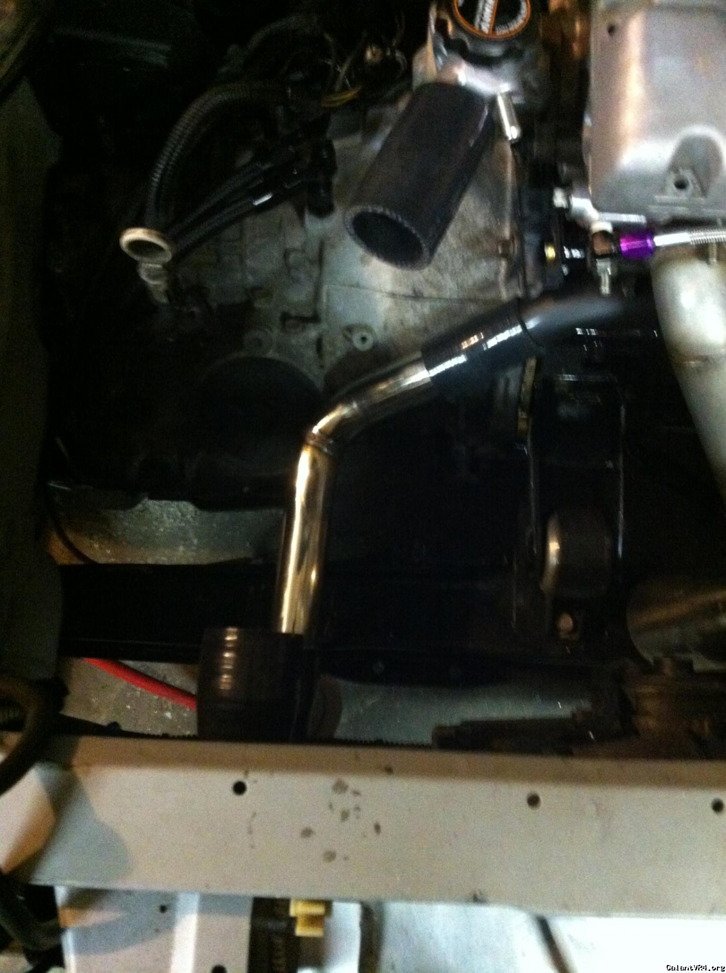

I like the stainless radiator hoses, are you going to keep it with couplers holding them or are you eventually gonna do like a -20an on them?
