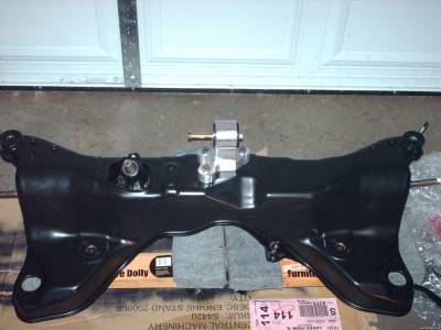

I've had this car for awhile now. I built the block once already, with some minor upgrades. The car sat for a few months with trans issues, which is what started the snowball effect,leading to where I am now. Turns out that it was a '90 trans, but thats not all. The VC was not secured, 5th gear was on backwards, and the output shaft could be pulled out by hand,with the trans still installed.
So, after deciding to change setups while the trans was out, I started with one set up and then another, and another. When I started working the midnight shift this build slowed down significantly. I just have no motivation after work.
I'm sure I'll hear "you don't need that" for this, that, and the other, but whatever, its my build. Here's the rundown.

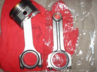

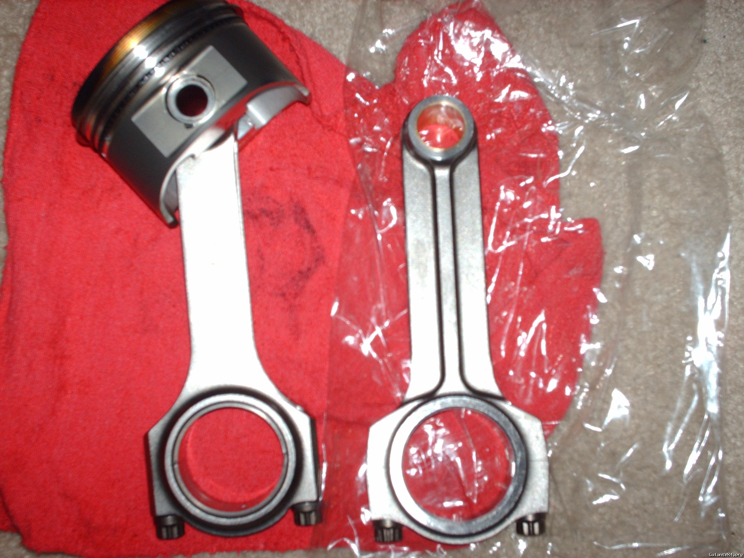

CP coated pistons
Pauter rods

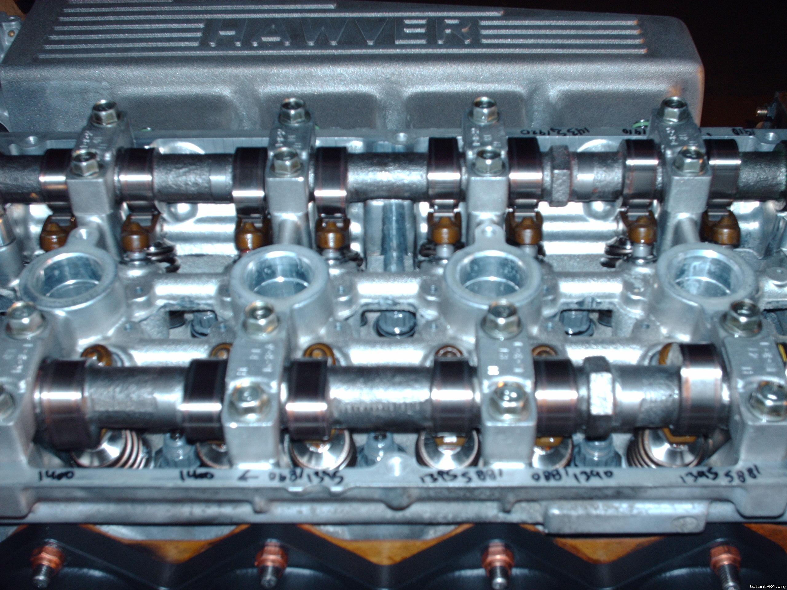

HEAD-
Mild port and polish
Ferrea Comp. Plus 1mm oversize valves
Kiggly beehive springs/retainers
Kelford 272s
Kiggly HLA
3g lifters
HKS cam gears
HKS T-belt

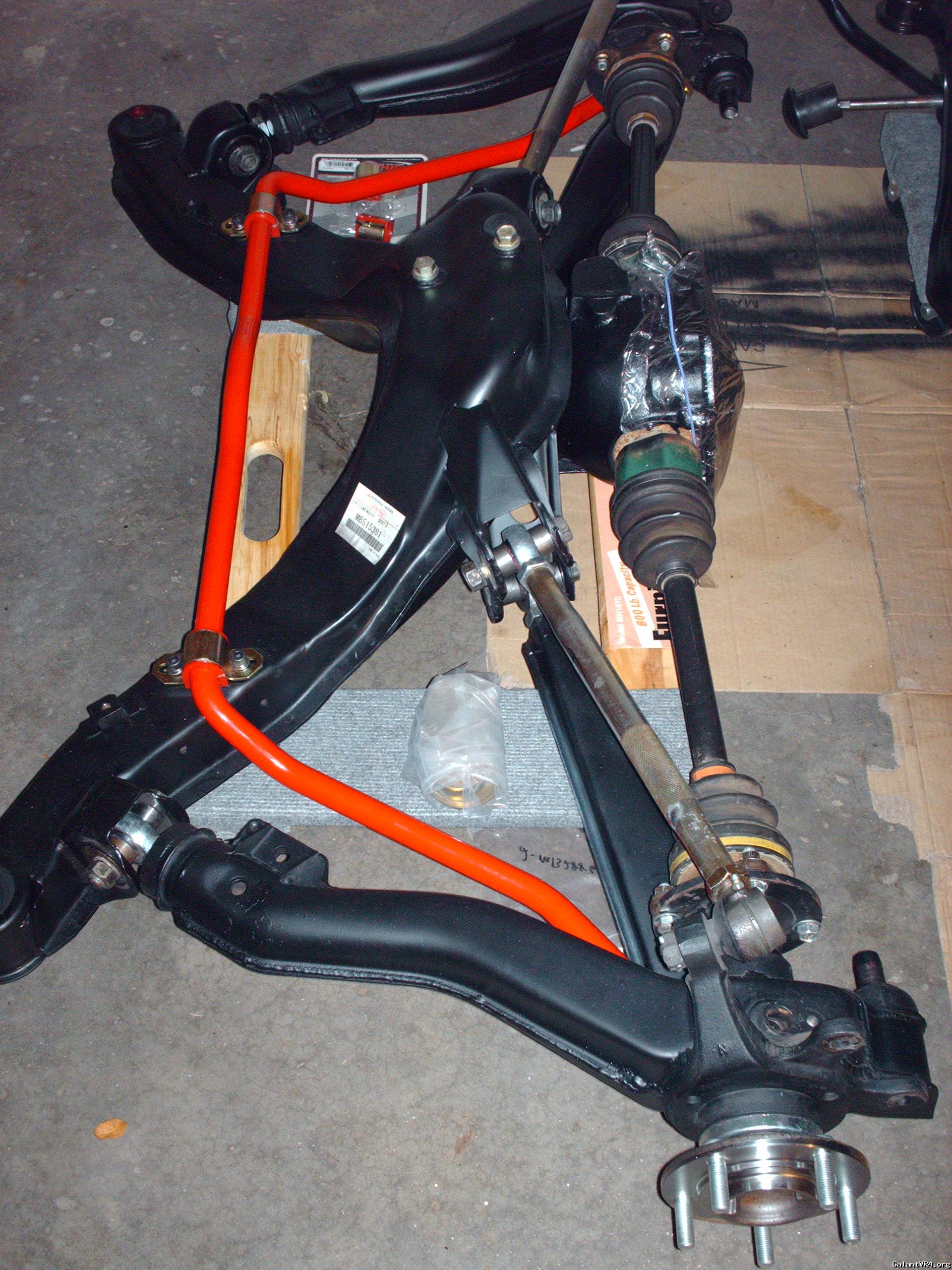

Custom hiem joint upper and lower rear control arms and trailing arms (kcpaz)
Raxles "race" front axles
RM rear sway bar

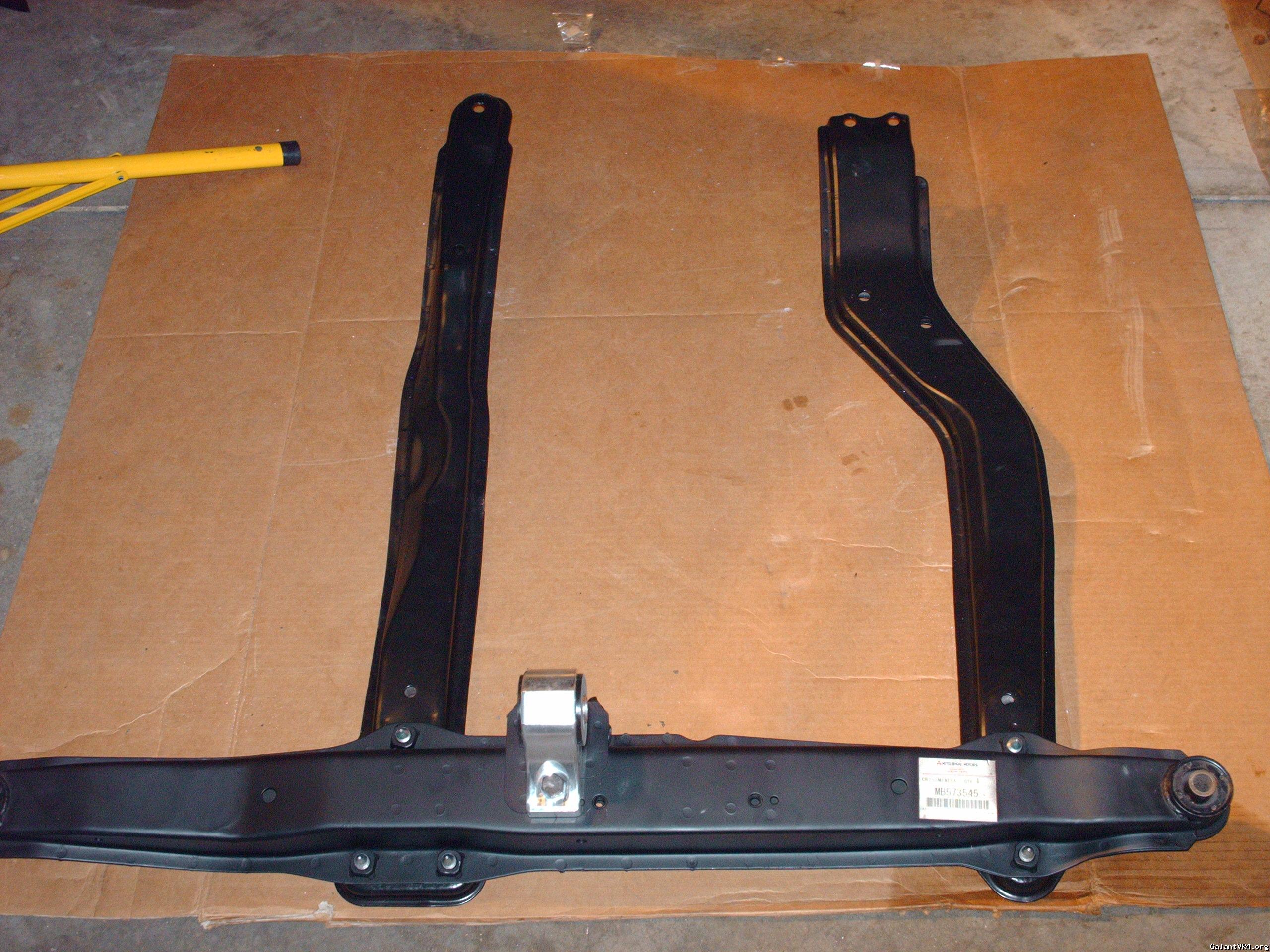

Subframe connectors (Curtis)
Poly bushings
Avid motor mounts
New rear subframe and front crossmember
