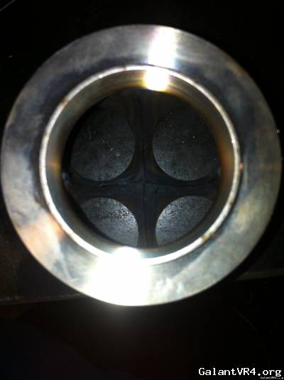

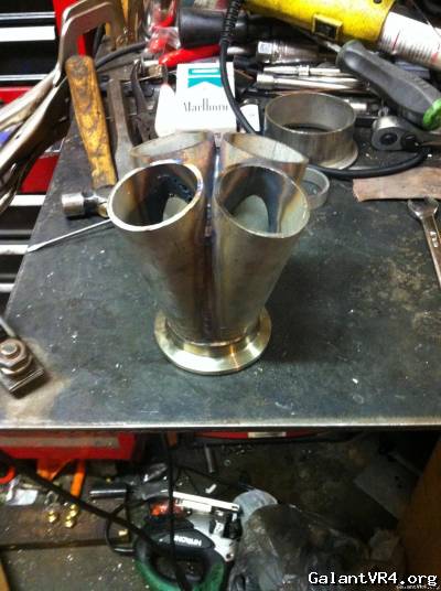

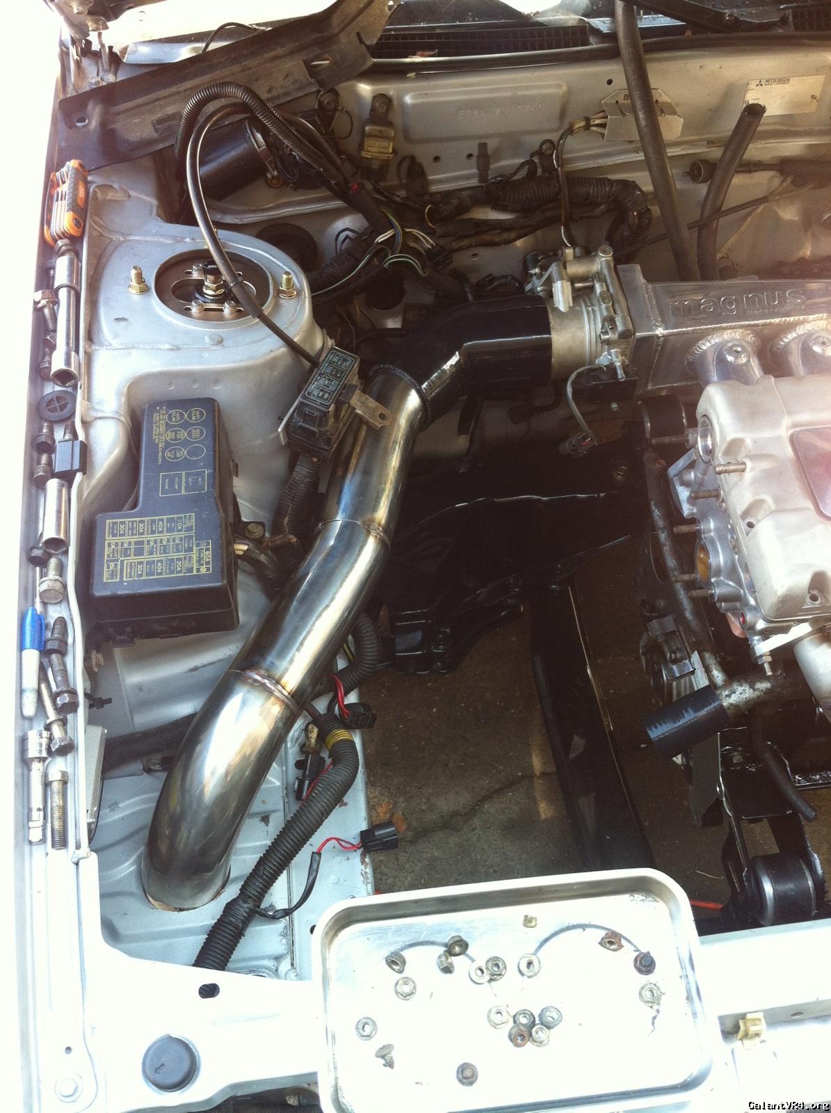

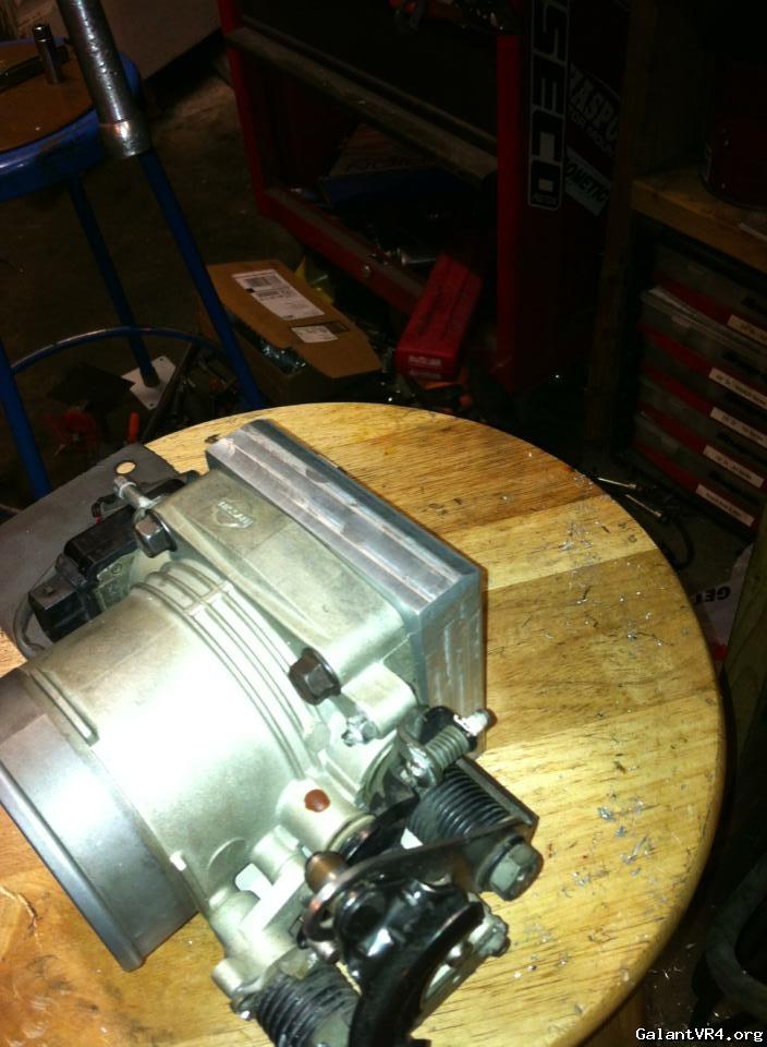

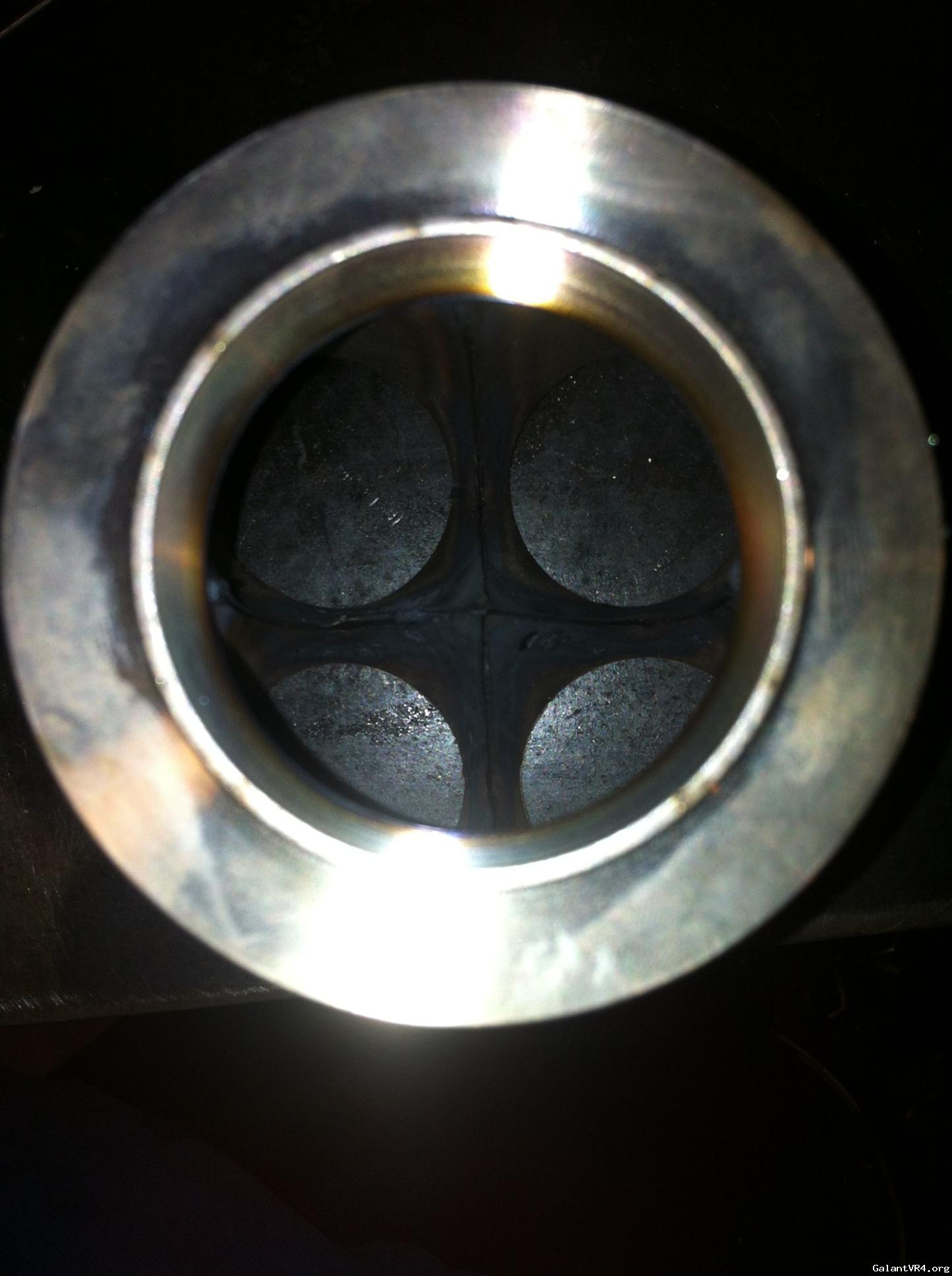

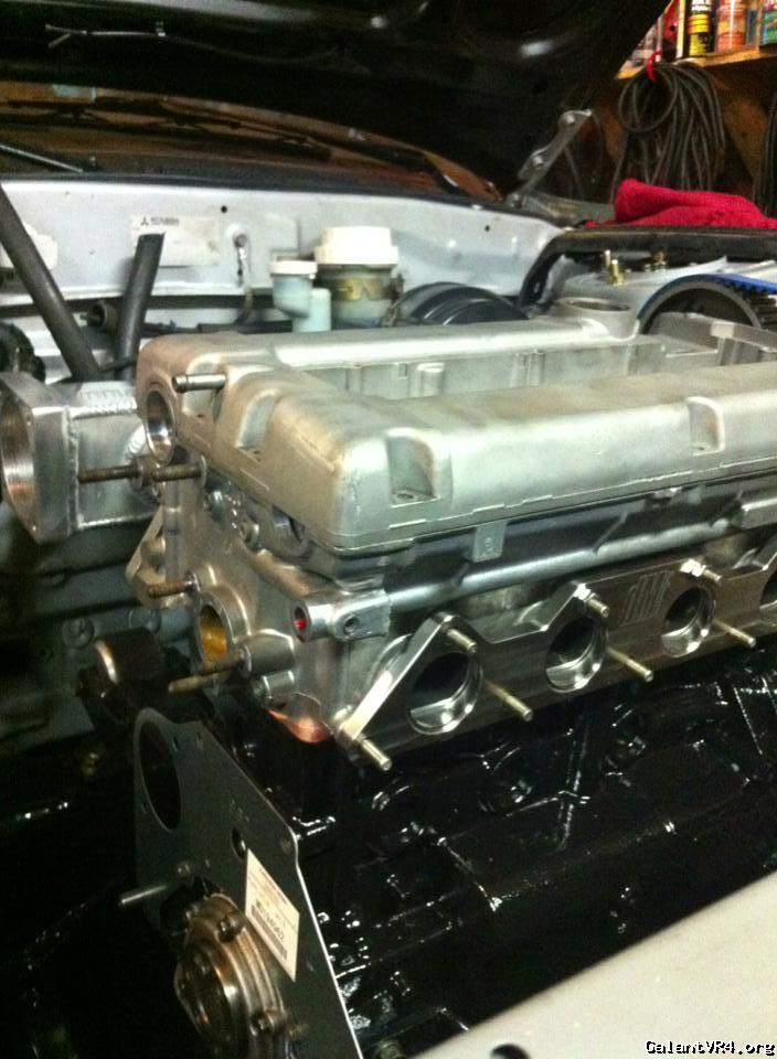

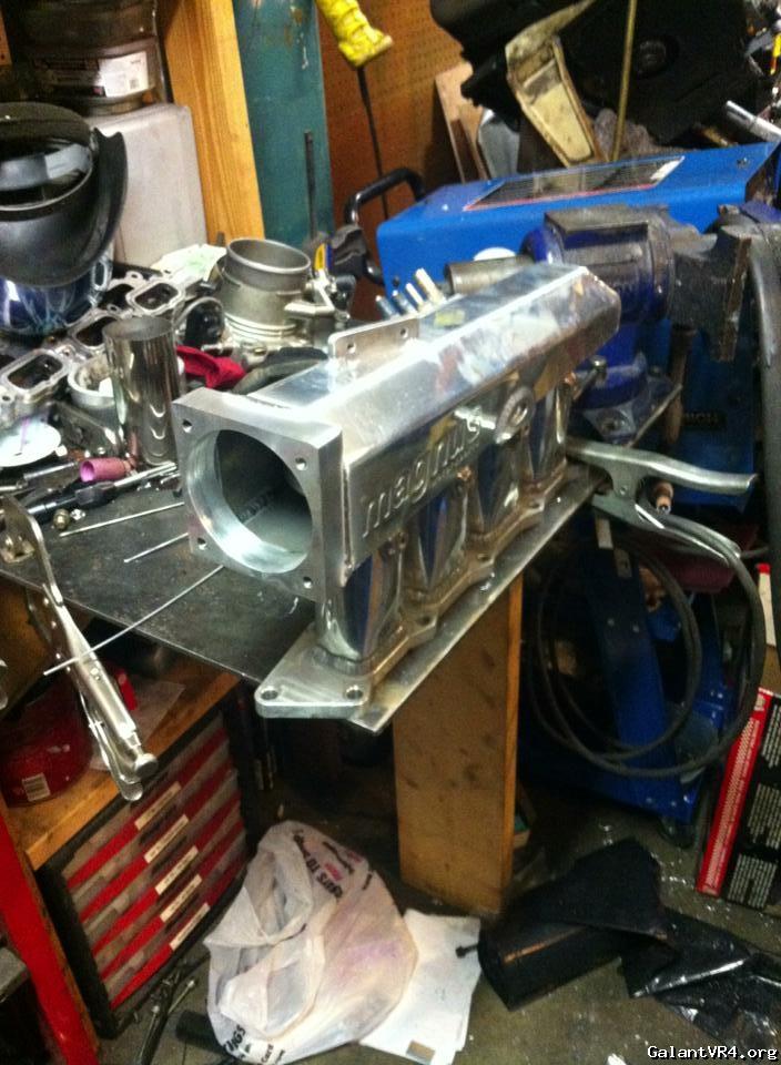

Time for some more updates: My friend and builder/fab guy Dee from dMf welded on the Q45 TB flange that he made onto my Magnus intake manifold

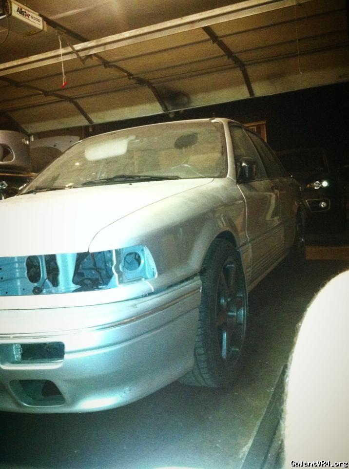

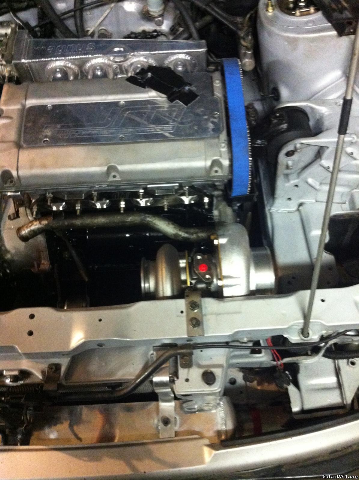

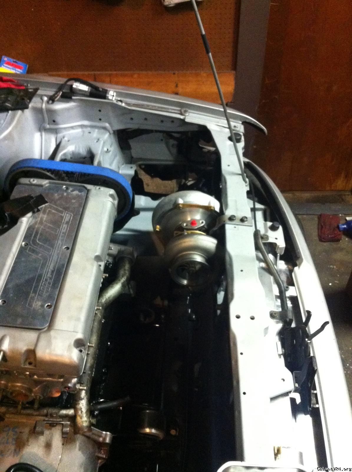

Due to all the dust on the car from its days sitting in my garage waiting for my buddies shop to open, what I referred to as project "grocery getter" to my friends has been renamed the "Dustbuster" by those same friends lol. After this pic was posted on facebook it was given a new name which I guess has stuck.

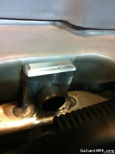

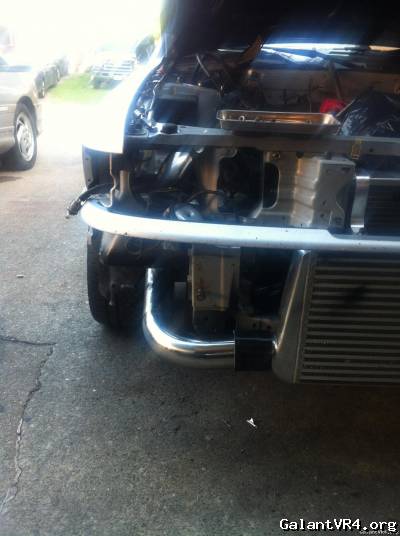

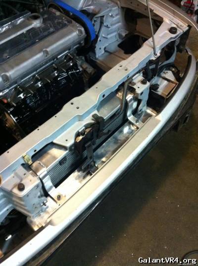

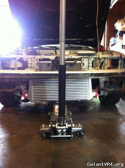

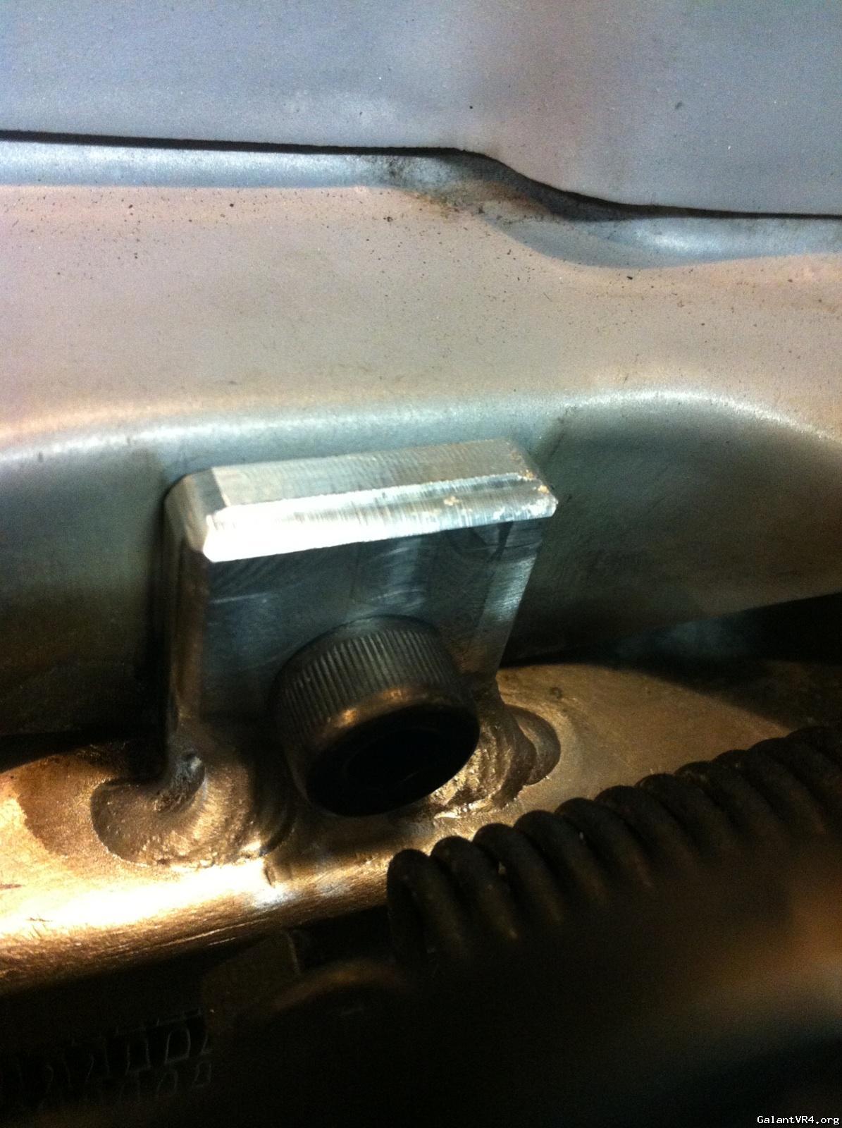

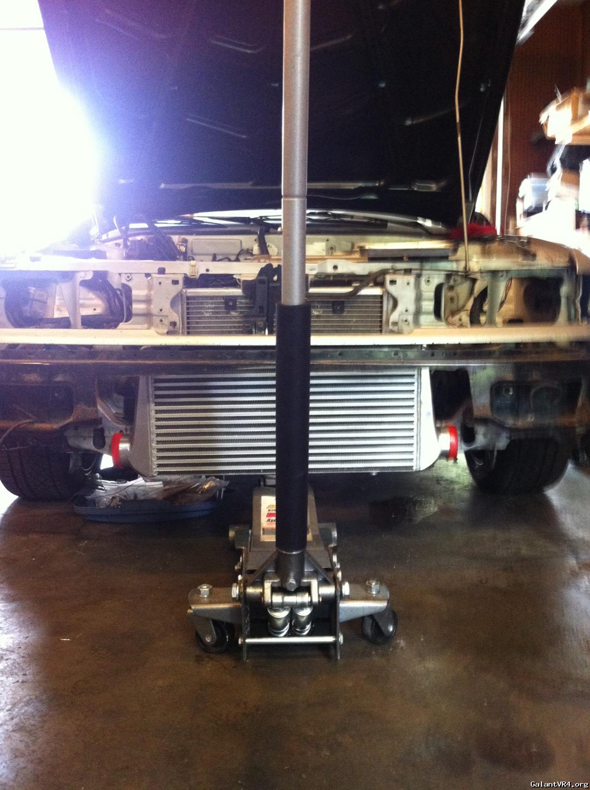

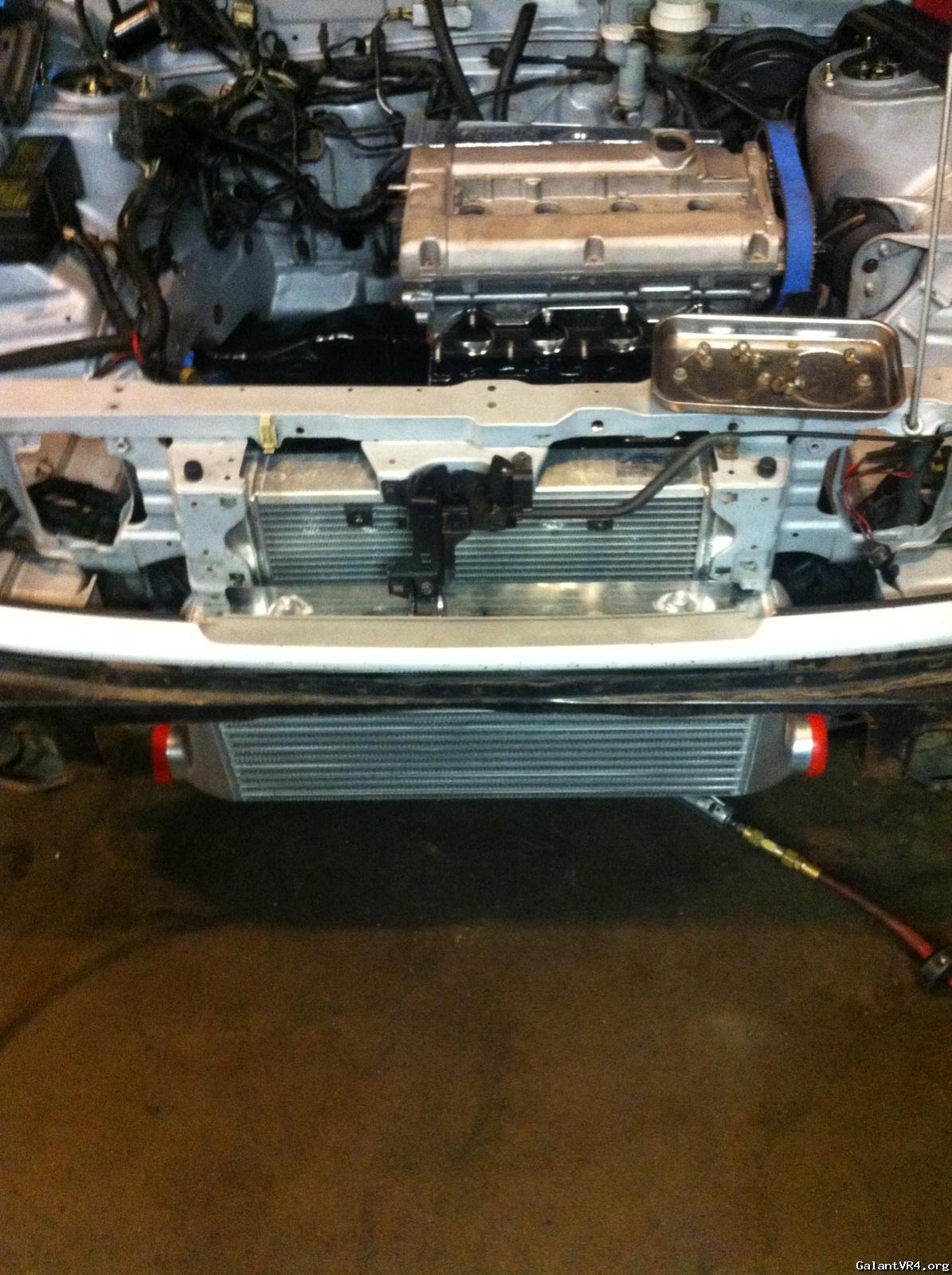

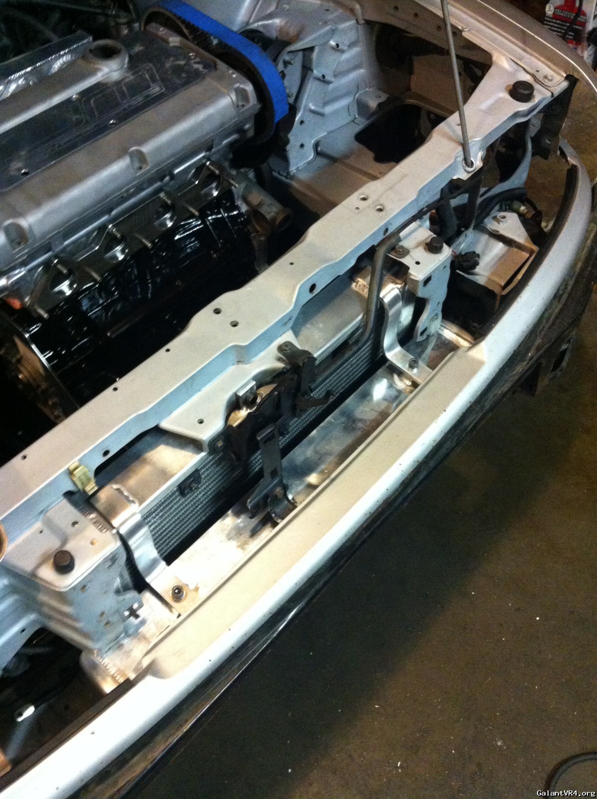

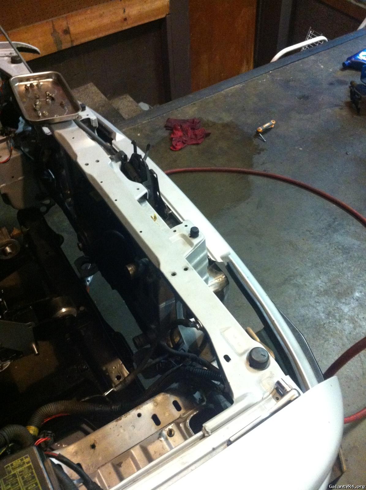

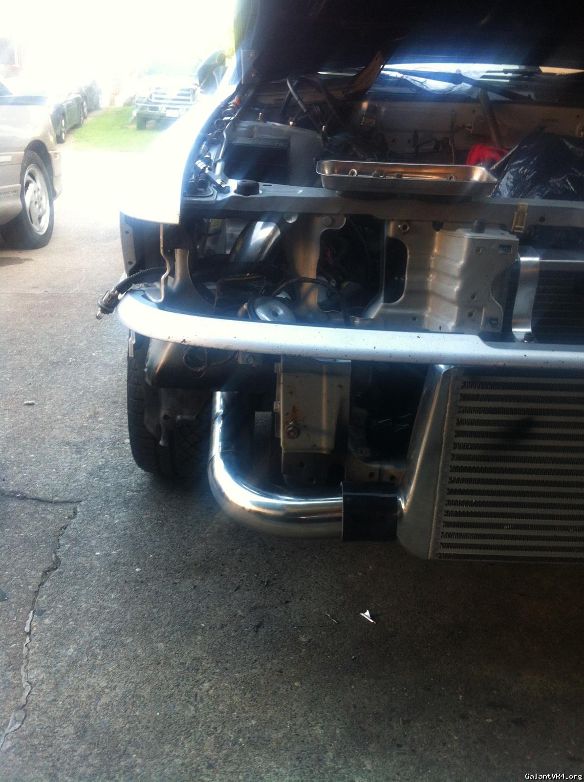

Here are some more pics of the intercooler mounts that my buddy came up with. They will be a little hard to take off but very solid mounts.

rex - this thing is coming along great. everything looks real clean and nice. i like how you were able to have brackets welded onto the radiator so you could attach the intercooler to it and have way better support. what does the underside of the intercooler and its brackets look like?

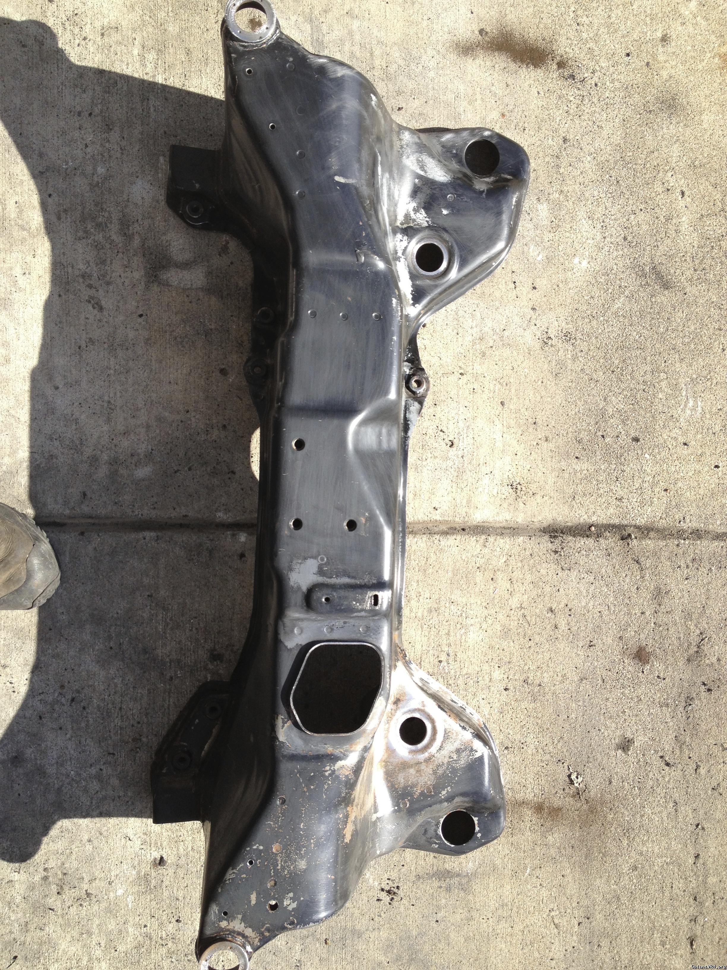

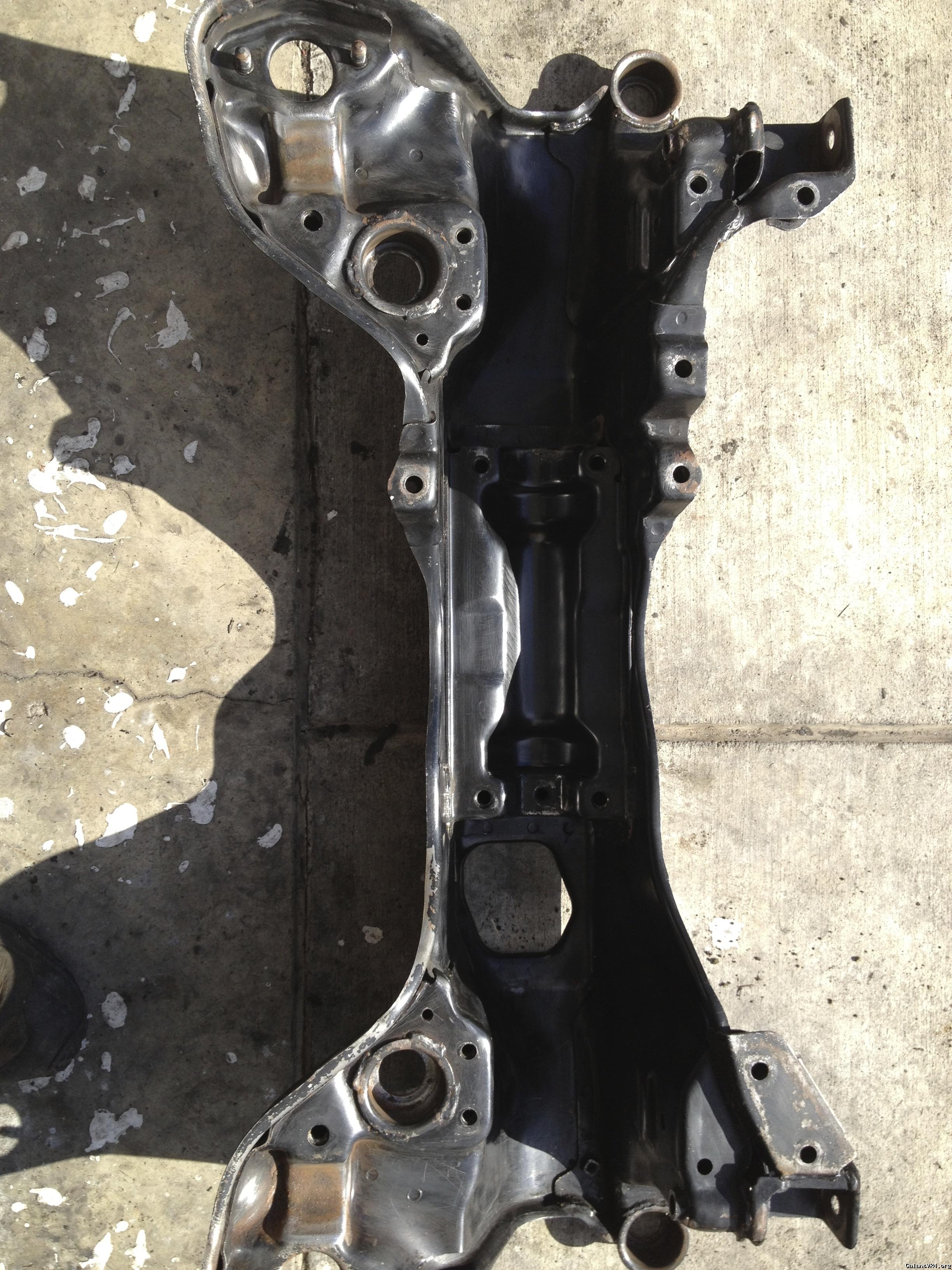

I admit, I posted while I was reading in catchup mode. and yes afterwards i saw it was forgotton, however the job to drop the rack is much more difficult once it's all back together.
Sorry, did you fix the boots in the end? and I thought I saw the rack was leaking. I have been through this on more than just the galant.. Form me if i'd found it i would have rolled back, or been doing a spare rack to swap in.
Would be shame to have done all the work underneath and have the steering dropping hydraulic oil all over the underside of the car again.
On the galant's they tend to have good rack seals (stronger than most) what I have done on 3 different galants now is had to swap the hard lines from the valve to the power cylinder as they rotted out where they pass through the rubber mounting thingy. First time i saw it my rack was covered in crap like that and it was confusing as it wasn't coming from one end.

As far as mounting point I'm not sure about under neath, I have not been to my buddies shop in a few days, just closed on my house been crazy busy lol. As far as the boots, yes I have new ones I will install them soon. The rack has a leak so I decided to drain it and go manually rack to shed some weight and make more usable room. Everything is going together well so far hopefully done and tuned for this years shootout.

Cool, Just didn't want to see the underside all messed up again. I wish I'd done to mine what you have done to the underside of your car as soon as I got my VR-4. It'll see you good for a long time to come. Mine is very sorry for itself and will require a long thread to get it right again.
