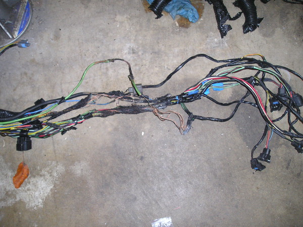

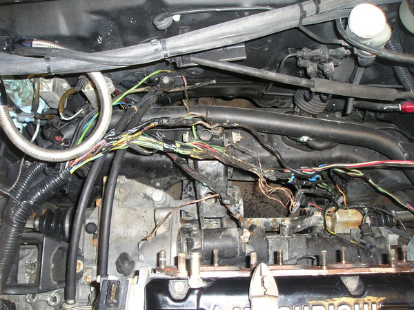

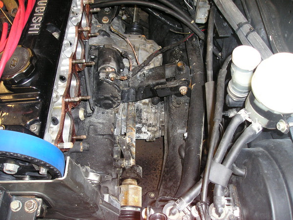

Here is the after math of the fire.
The fire started around the starter in the main harness.

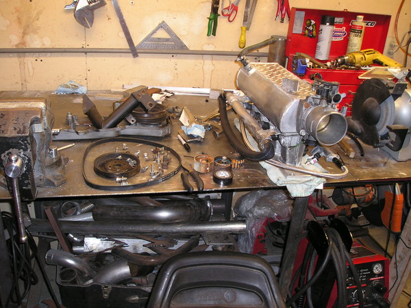

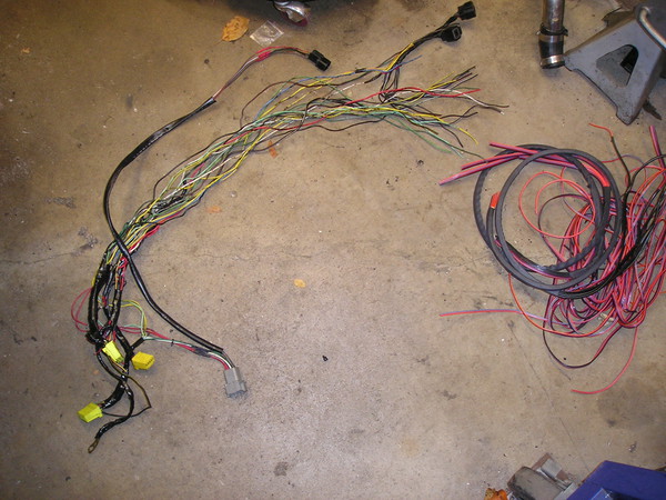

Here is what was left that is still good.

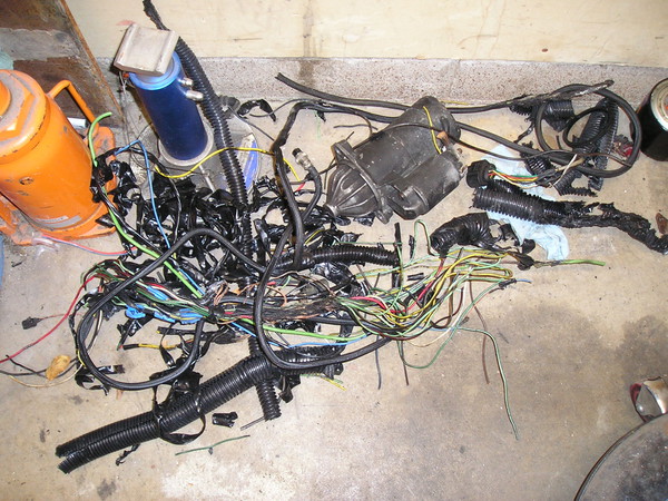

Here is all the stuff I had to cut out.

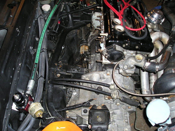

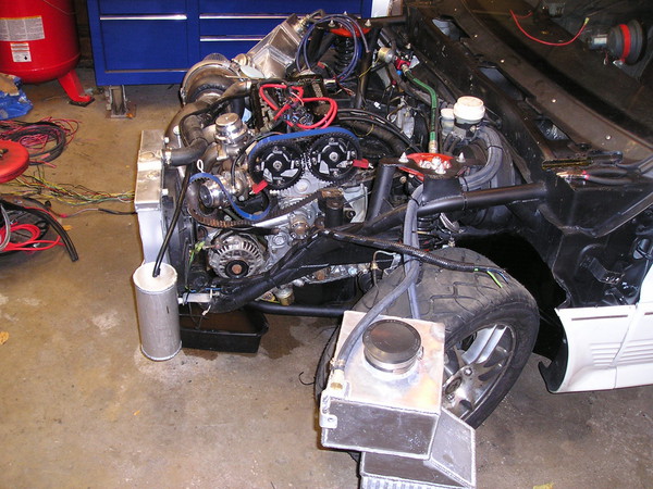

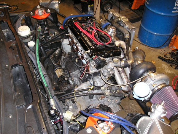

The clean up process, sulfur and water do not make a good mix. I still have a lot of clean up to go, but that will take place over this winter.

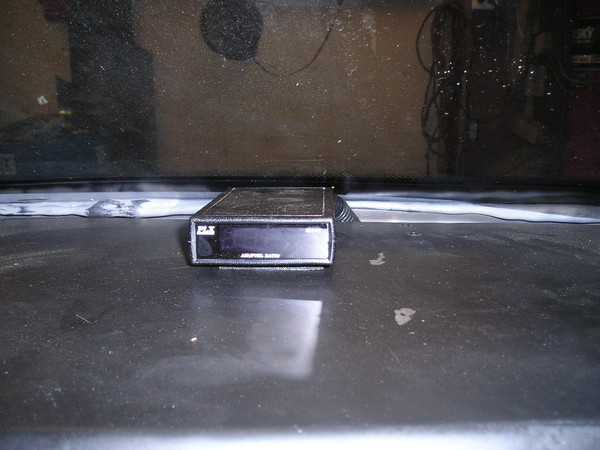

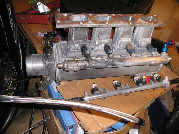

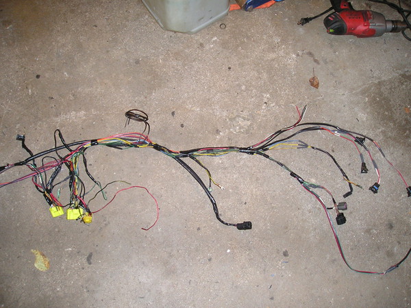

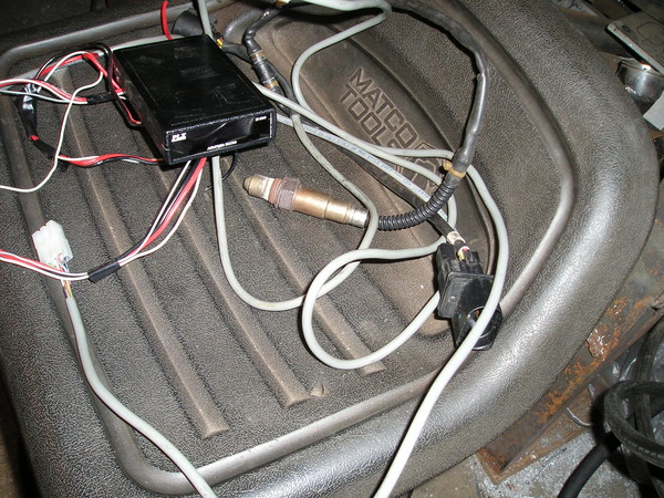

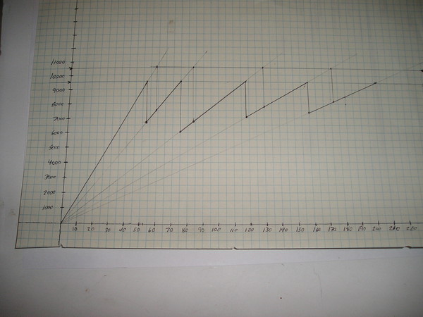

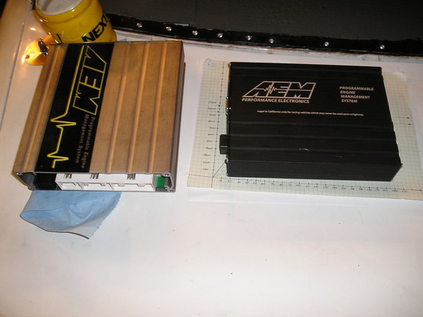

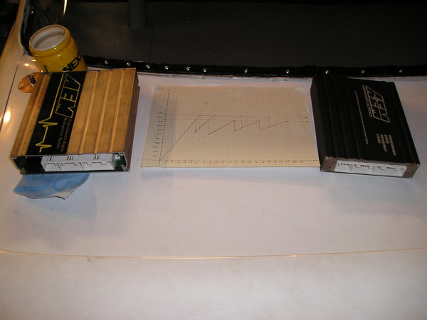

And the new stuff, I picked up a V2 AEM EMS. I remade the engine bay harness, and will be using the peak/hold injector drivers to run the 1600's as the primary injectors. Then over the winter I will go back to 1 fuel rail and buy some Injector Dynamics 2150's. I also made a gear/rpm/mph graph. Even though the splits look bad for 2nd/3rd the car has little to no lag between gears. I also picked up a wide band that will be wired in.
The car should be done and up at the cookout this weekend. Then its to the track to see what this car can do.

Its hard to say where or what started the fire. My first thoughts if it was a fuel fire the car would be a melted pile of stuff. All I smelled was electrical fire and when we pulled the hood of the only thing of fire was the main wiring harness, just burning away. It was not getting any bigger and was slow, so just plastic and wire insulation burning. The car was in an enclosed trailer over night and did leak some fuel, I guessed it was the #4 injector started to leak after the fire was put out. So I am moving the 1600's up to the factory location and going down to 1 fuel rail and the 4 injectors. I still plan for this thing to be at the cook out, see you saturday.

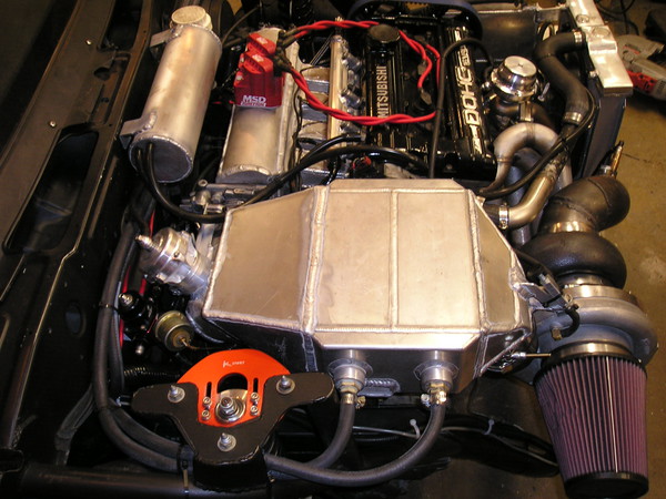

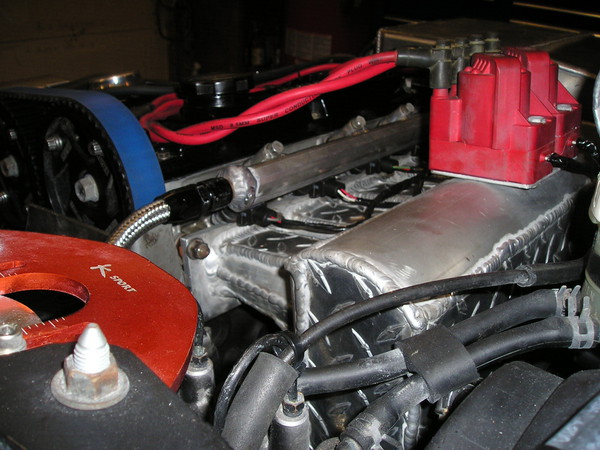

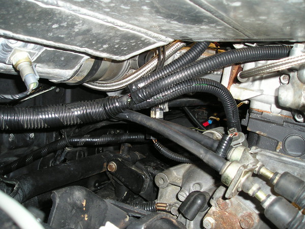

Thanks. Here is the up date:

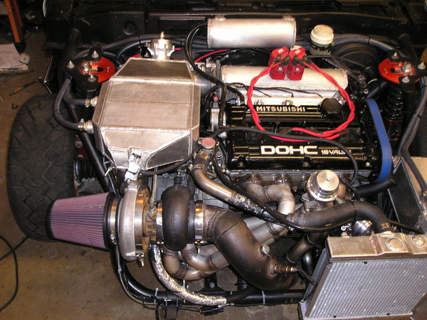

I did not make it to the All Mitsu Cookout this weekend It came down my computers, lap top or desk top, not wanting to talk with the new EMS v2. But I now have that sorted out and the car ran tonight. I ended up making a fuel rail and moving the 1600's up top, so now I just need the ID for next year.

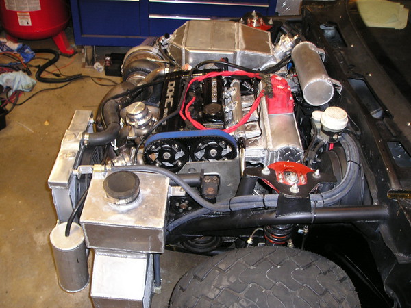

Here are some pics of the work done on the car post fire.

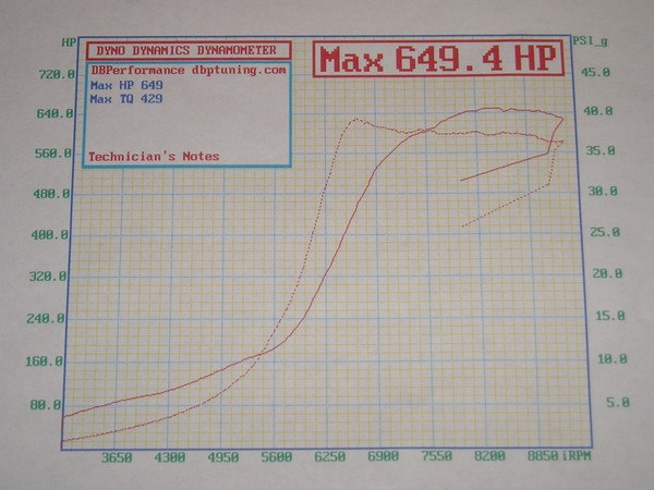

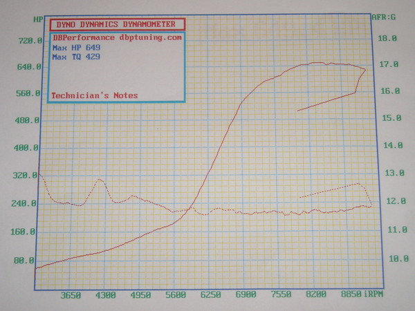

I put 30 miles on the car yesterday. I have dyno time setup later this week and I do plan to go to Rock Falls sep 11th for some shake down runs.
~John
Galantvr41062
Aug 20, 2007
415
plymouth, MN

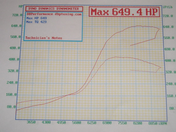

I had to turn the boost controller up 1/4 turn to get it back to the boost it was running before. It looks like the clutch broke in a little sense the last dyno session. The car spools up about 400rpm sooner. The only things to changer were moving the 1600's to the stock location with a custom, but smaller fuel rail, the new AEM EMS, a green top CAS, and the new wiring harness. Other then that the plug gap was the same and the injector duty cycles are lower then before, but I did not want to push the setup any further until it hits the track.

Sweet jeebus that thing is a monster! Must be interesting on the street. Nice numbers for a dyno dynamics, that's got to be in the 850+ bhp neighborhood.
