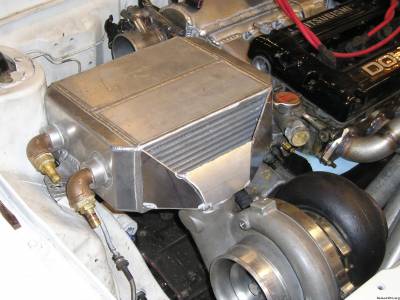

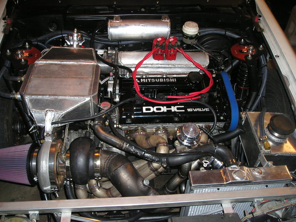

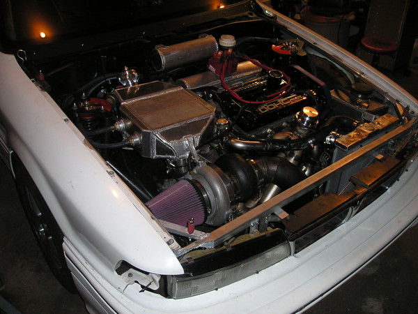

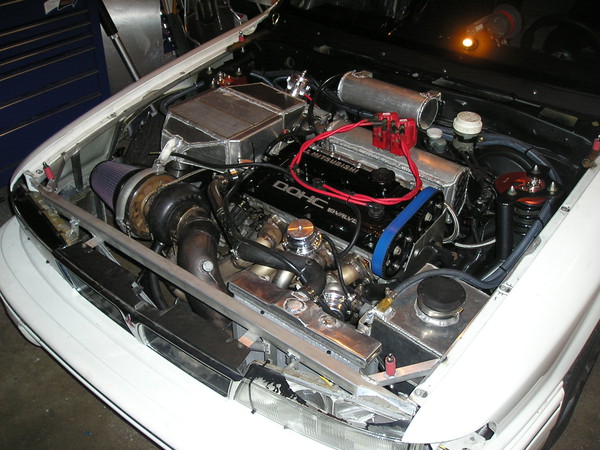

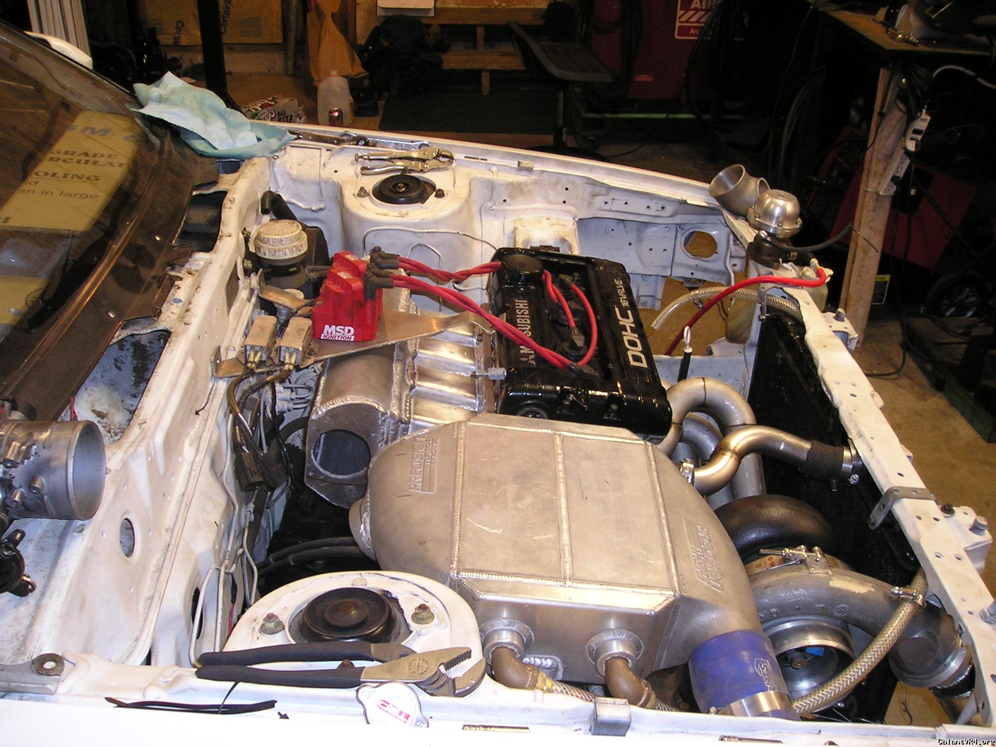

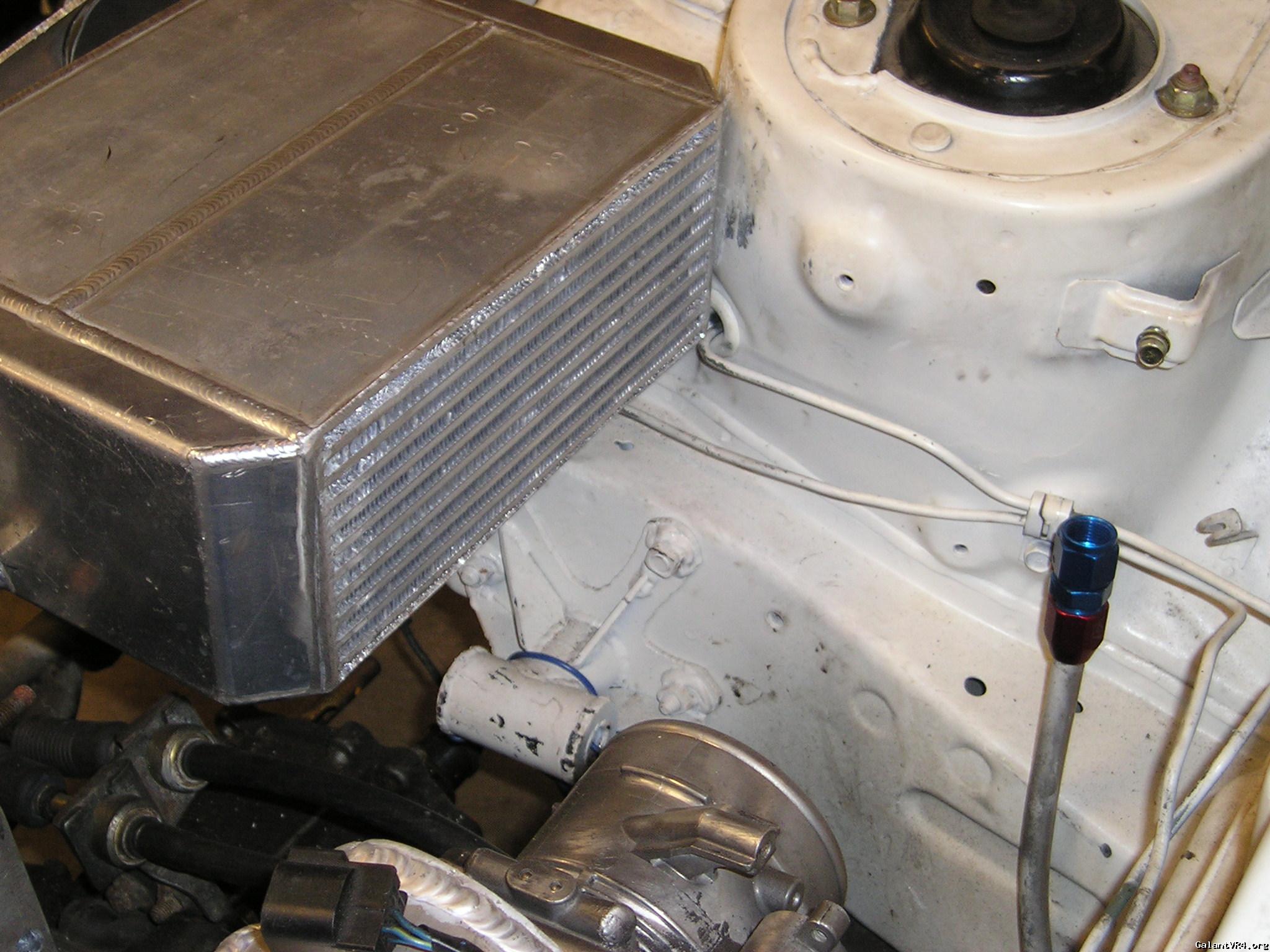

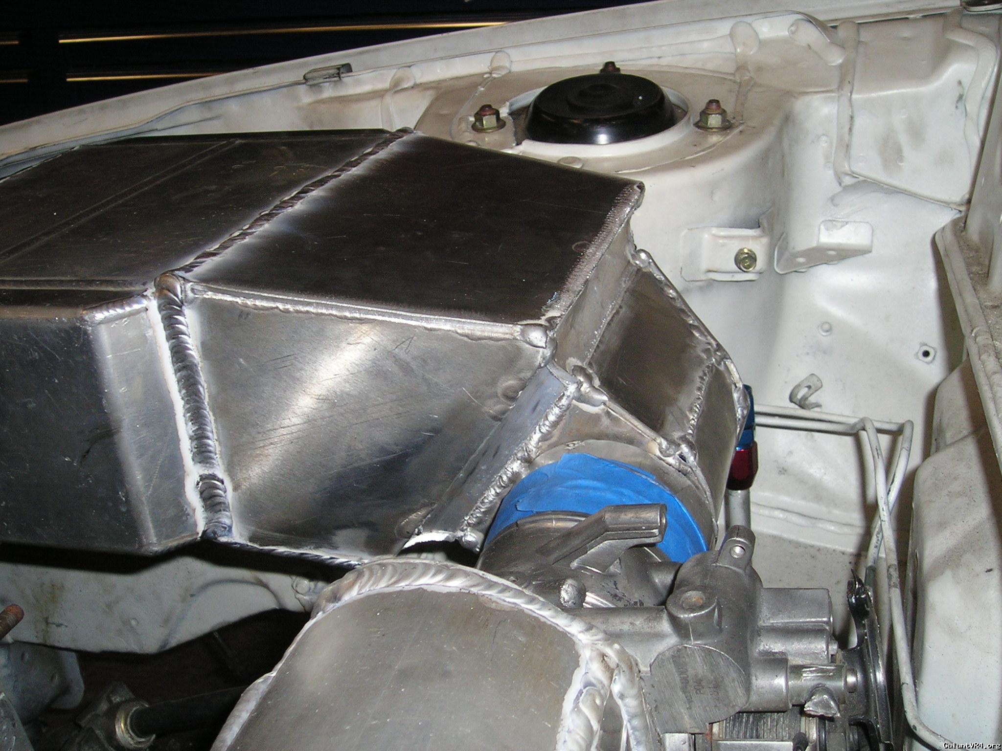

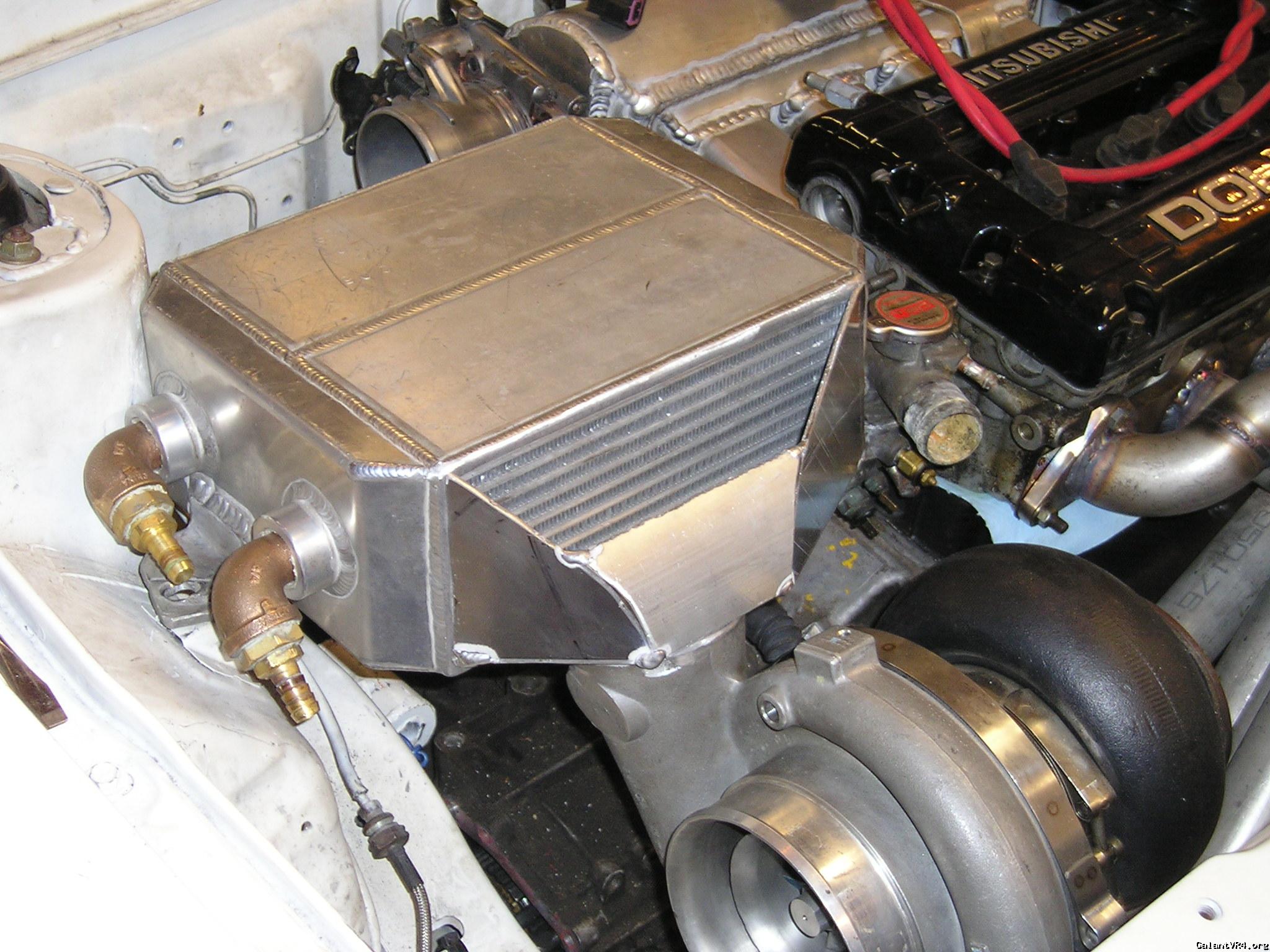

Here are the "final" engine bay shoots. I have dyno time again, now I just need to finish up the head lights and turn signals, just the switches and relays left.
To quote two guys from work, one that road in it and the other that saw it driving down road.
"Its so quiet you can barley tell its running, ow I found that rattle."
"Its funny to look in the front end and see nothing, look in the front end and out the wheel well."
~John

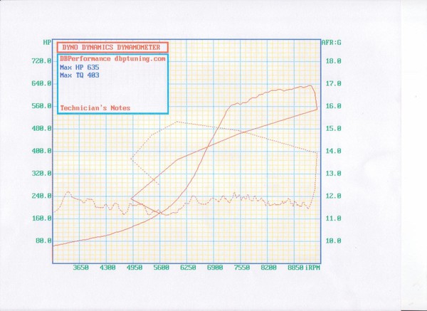

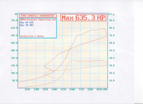

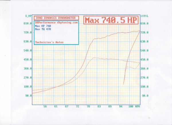

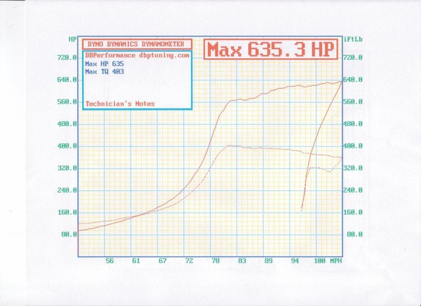

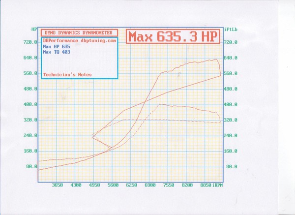

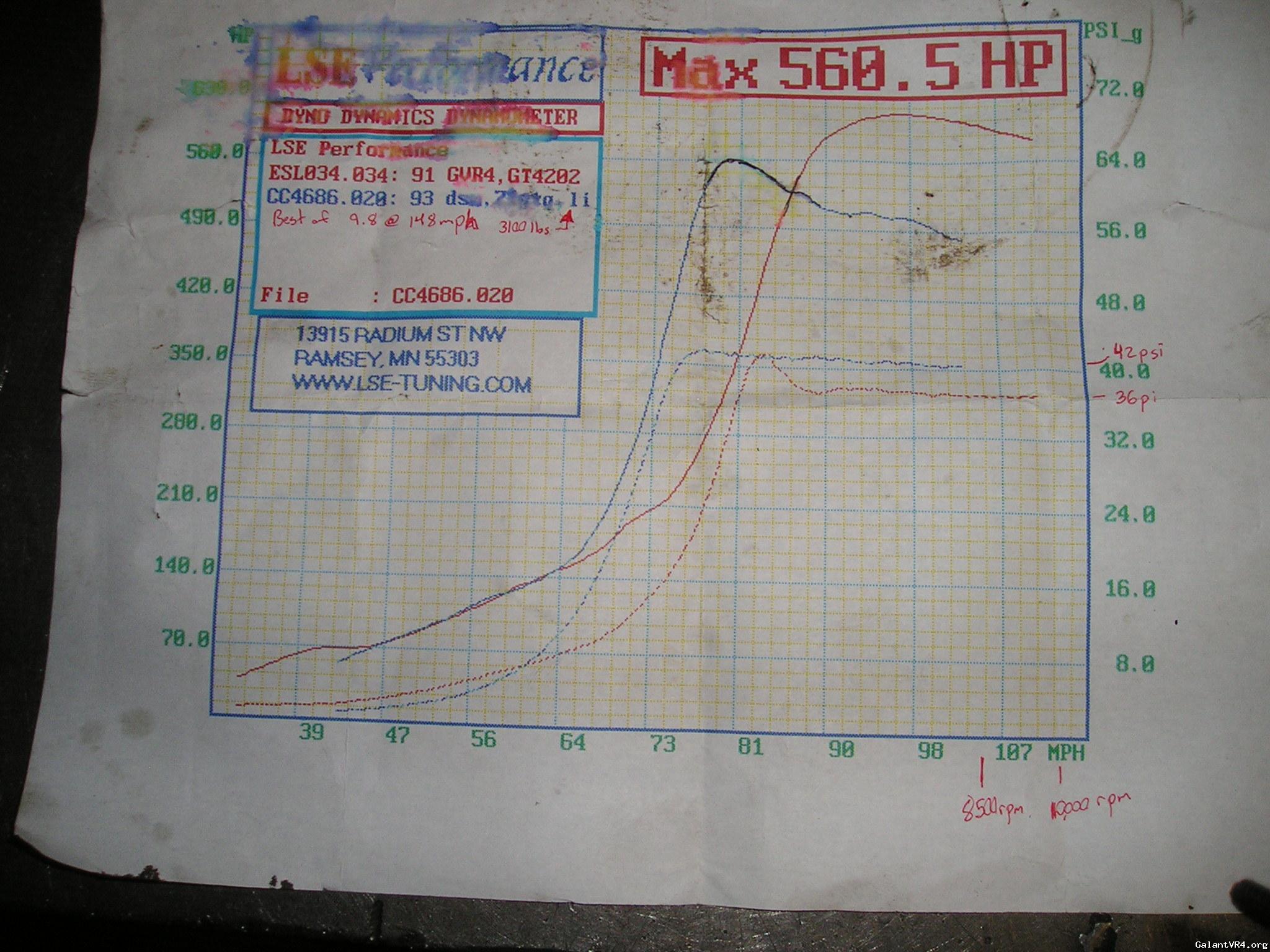

The below pic was in SHOOT OUT mode, thus the highter number.
The above pic is a SHOOT OUT run.
I will post a few more details and what not tomorrow.
~John
Galantvr41062
Aug 20, 2007
415
plymouth, MN

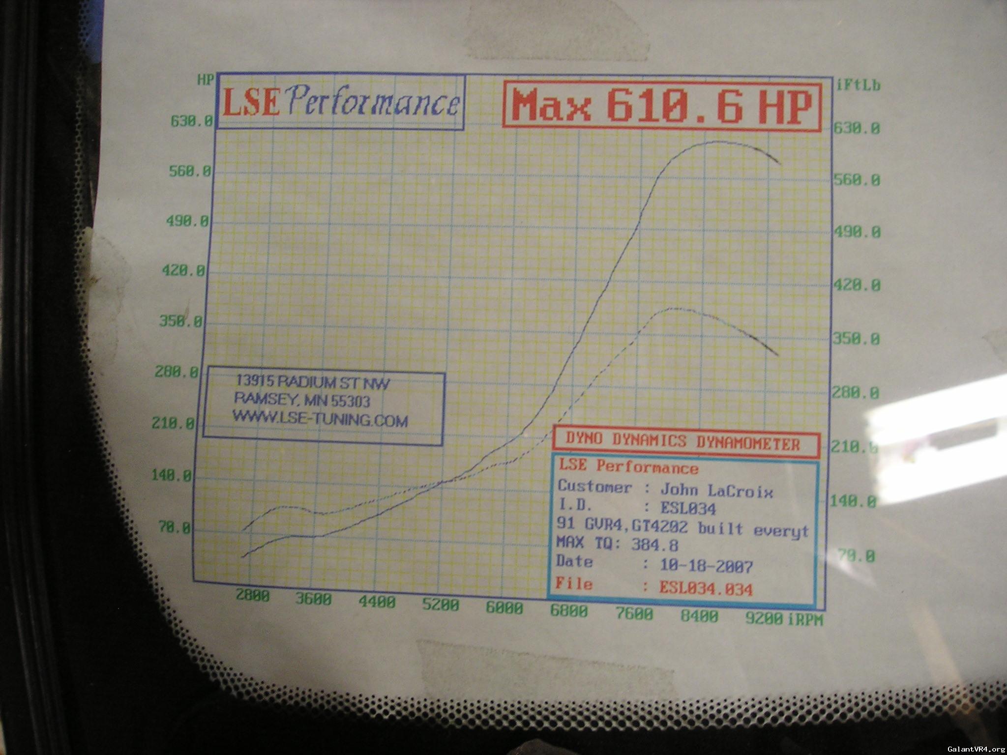

This was done with the 4 1600's as the primarys, and no secondary injectors were used. The EMS is not the issue, I tried another EMS and still no #8 injector, so they either need to wired up in a batch fire or I found 2 EMS's that will not run 8 injectors. The boost on WG pressure was 25psi, the 635 run was at 37psi. I am reving to 9500rpm, with how the power is still going up I could rev higher but I am at 90 some % duty cycle on the 1600's and I loose about 6psi of fuel pressure by redline. The intake air temps would only go up about 9deg over the run, but after a few back to back runs the temps would start at 120deg, so we added ice to get that down below 100 before the start of the run. I will see how it does on the street/track IAT wise. Coolant temps were nice and rock solid. The ramp rate was set to 100 and the AM2 correction was around 3-4% most of the night

The good news: The car has plenty of traction with the drag radials, the tranny shifts at 9500rpm with no effort, the car has no noticable lag between gears if I do not hit the rev limiter, even then I just need to play with the settings so it comes clean off the revlimiter. And to quote the passanger, Kyle "you will have no issue with your cousins CBR 1000rr, that with a good rider can run a 9.5@150". The car gets up on power nice and smooth and just goes, if I see the big tach get much past 8k its on the rev limiter (9500). I had the car up to the top of 4th gear a few times and by the math that is 159mph.
