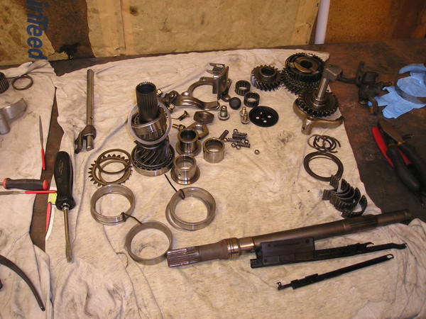

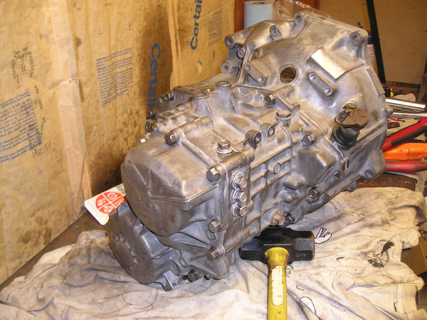

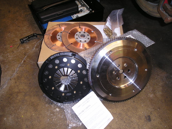

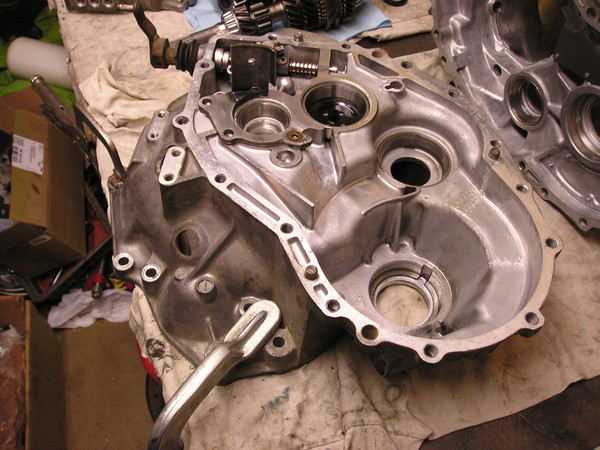

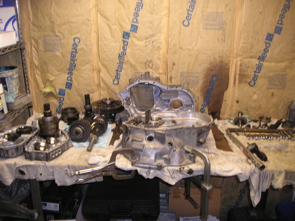

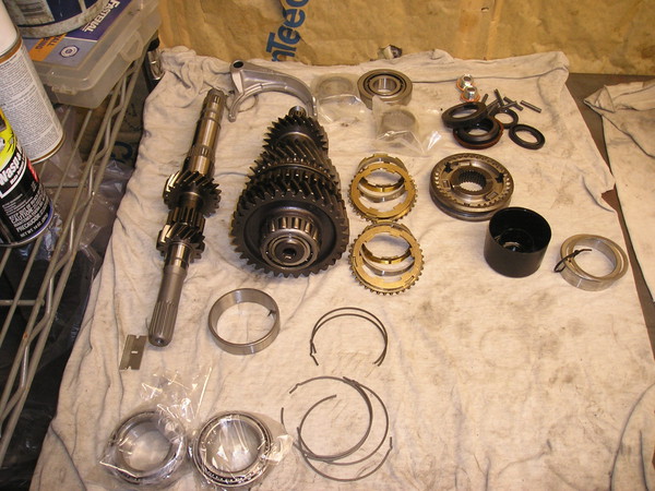

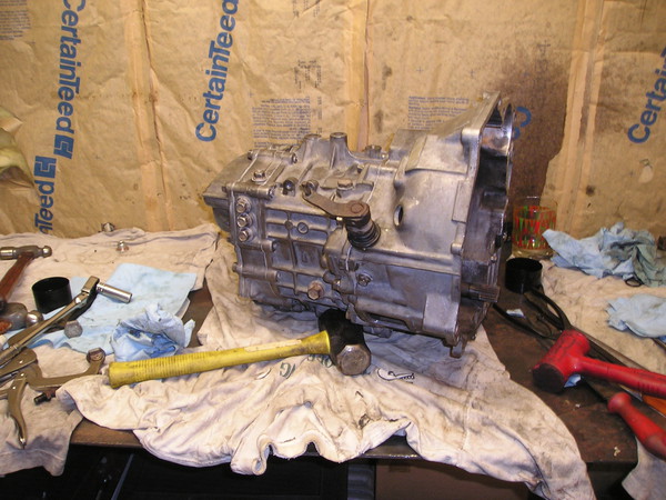

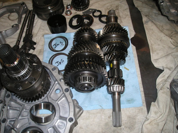

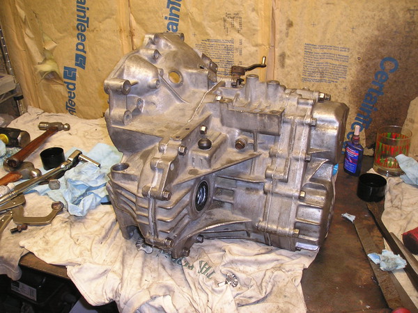

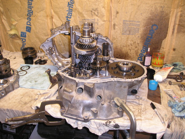

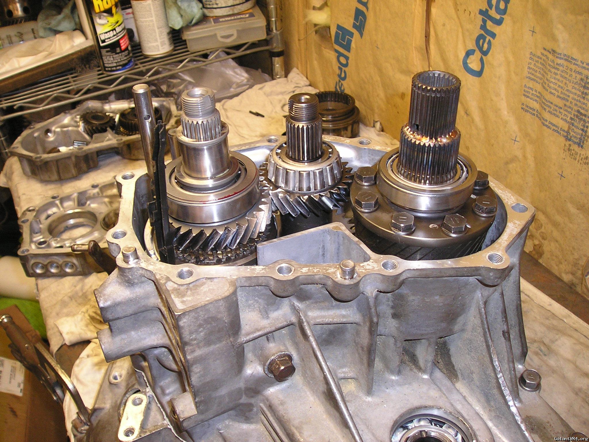

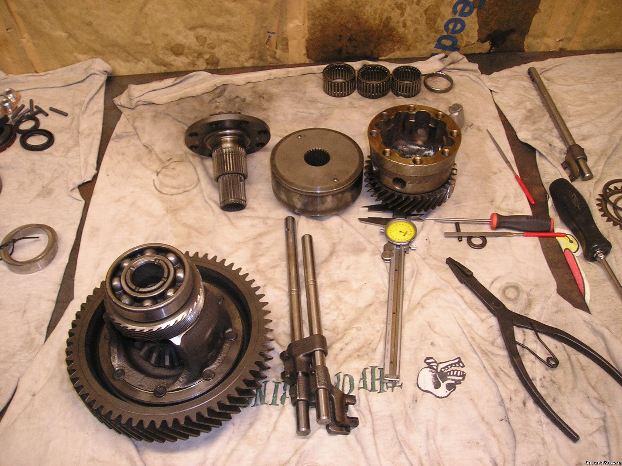

My gears shipped last friday, and I received them Wednesday this week. So here is the update, not much left then its off to the dyno and the track to see what this thing can do at "low" power.
Thanks for looking
~John

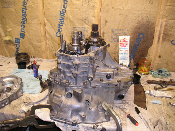

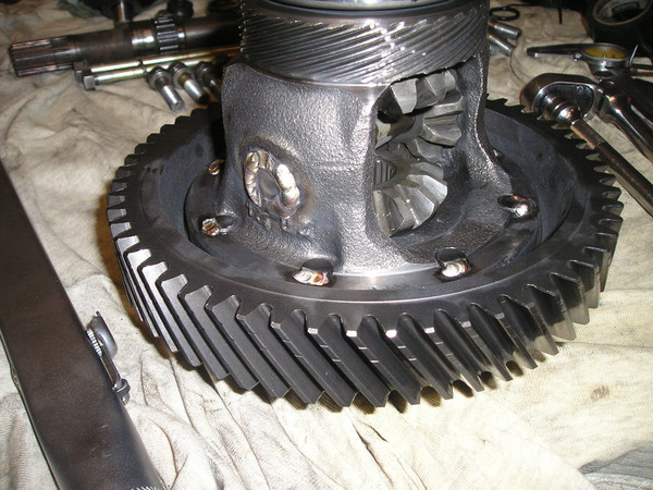

makes the diff a lot stronger, and distributes the power up 50% to the front and back wheels.
Barnes
Feb 9, 2003
6,249
Richland, WA
Dsmgst, the diff Norway asked about is the front diff. This does not affect power split. I suspect that welding is insurance to keep the bolts that hold the 'ring' gear to the diff from loosening. Also, with the pinion cross shaft welded there is no chance it could fall out of the diff housing. Looks like extreme measures in insurance to me.
Not a bad idea when overhaulin the box /ubbthreads/images/graemlins/smile.gif
Very nice build by the way /ubbthreads/images/graemlins/worthy.gif !!!
Galantvr41062
Aug 20, 2007
415
plymouth, MN
Thanks. The front diff is welded to ensure nothing lets loose and breaks important parts in the tranny. I did weld my center diff for a 50/50 split and to make sure it does not break either.
~John

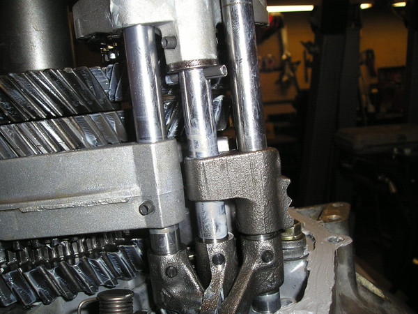

Looks great! I'd love to do this with my gvr4 thats been sitting around forever drivetrainless.
Do you have any pictures of the welding on the center diff ?? /ubbthreads/images/graemlins/smile.gif

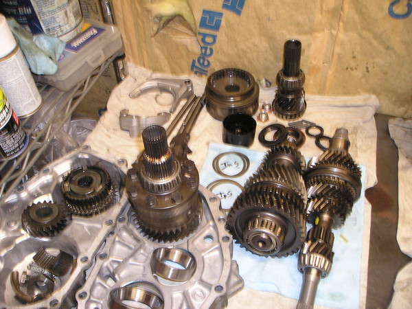

Here are the best 2 shots I have. I use a MIG welder to weld the lower spider gear to the diff housing, this is what drives the front pinion. Then I use a TIG welder to weld the top spider gear to the top of the diff, I weld the bottom and the top of the gear to give this as much strength as possible. It is the top of the center diff that drives the output shaft going to the transfer case.

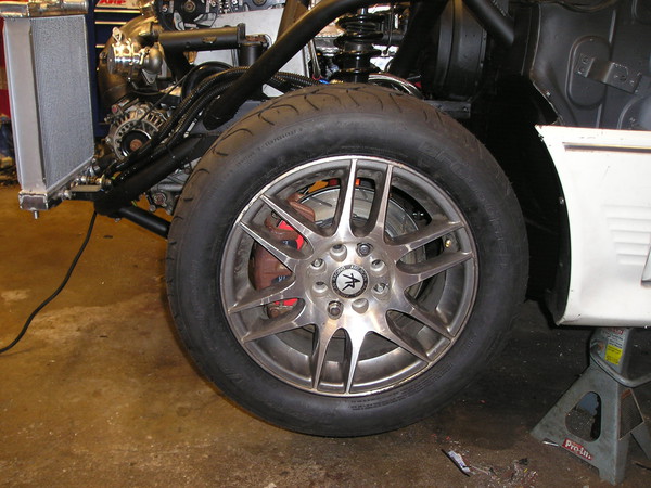

What are you doing for brakes for staging? Im thinking of going with dual line locks once I delete my abs lines. Car looks to be getting close to done, cant wait to see more pictures...
Galantvr41062
Aug 20, 2007
415
plymouth, MN
I will either put the parking break cables back in, or wire up for a line lock on the front breaks. I will try it at the track to see how it goes first. I drove the car up and down the street a few times, now I just have some finish up work and take it for a full test drive.

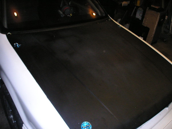

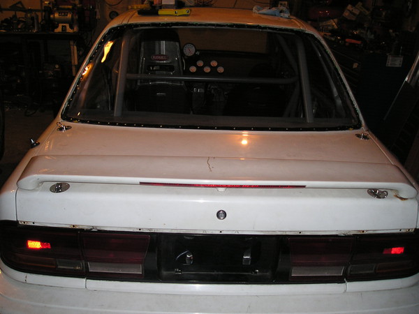

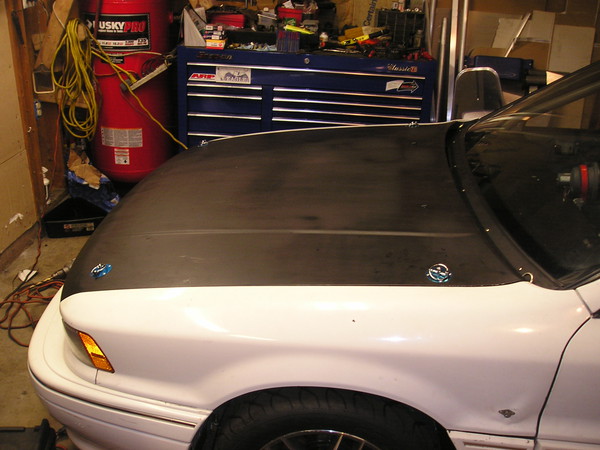

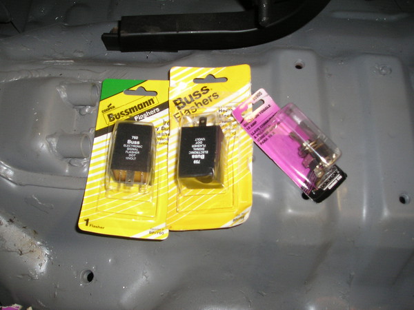

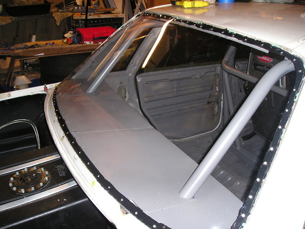

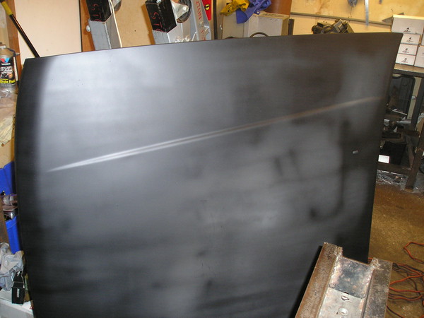

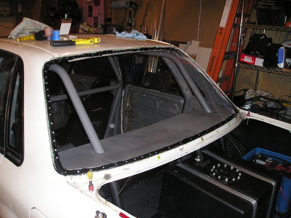

Rear window is done, hood is fitted, break lights, turn signals, and running lights are wired up in the back.
I have dyno time setup, then after that its off to a track to see what it can do.
~John
