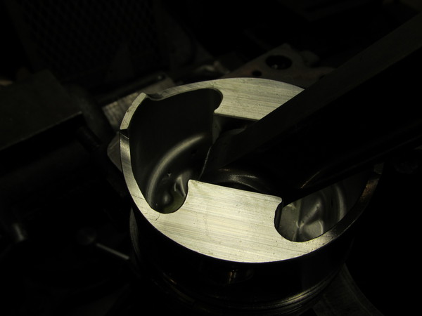

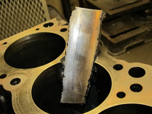

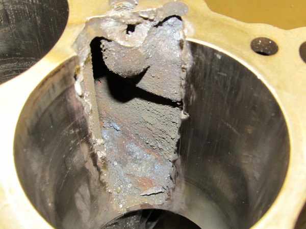

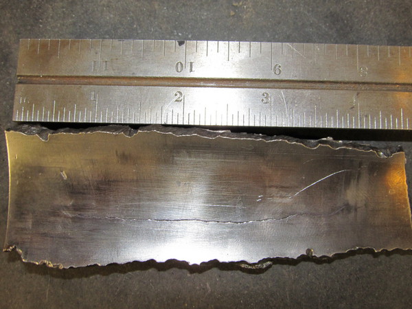

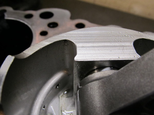

Here is the damage. It looks to me like some casting lines on the water jacket side of the #2 cylinder wall caused the crack. The cylinder wall measures about .175-.195". So with the 5" of un supported cylinder wall they were moving all over and the casting line made the cylinder wall a little thinner and had stress risers, thus the crack.

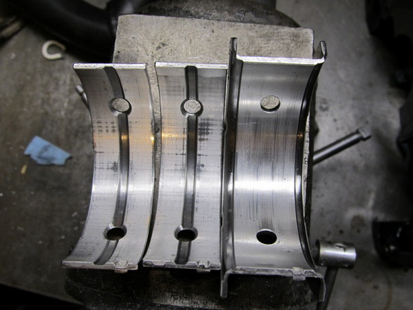

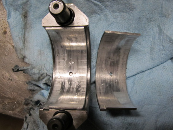

It looks like the #3 and #4 were doing the same thing. The pistons have cracks where the piston skirt blend into the wrist pin boss. The Rod bearings have seen better days, but they were standard Kings, I will be running ACL race series with a special coating with the new motor. The main bearings look great, and the oil pump/front cover is junk after 300miles.
It looks like I am getting air in the oil, so I will be doing some oil control around the crank and oil pan, and I will port the oil pressure releaf hole a little more.
Now I have the parts needed to put the hard block in, then I need to make a parts list then start machining.
~John

It looks like the piston cracking and cylinder wall cracking are not that un common...
I just re checked and my piston to wall clearance was .005-.006". I my build sheet on the motor, so I do not know the exact specs on the main or rod bearing clearance, but I would guess it was .0010-.0012", spec is .0008-.0020" on both.
Here are the pics of the cracks and bearings, the mains look good:
~John

I actually had the exact same problem! Pistons were cracked in the same areas (wiseco). The block I used had a hair line crack in cylinder 2 or 3. It made approx 500 wheel hp when this happened. It too had 5 thou piston to bore......
JB
Aug 15, 2004
5,836
MA
^ /ubbthreads/images/graemlins/applause.gif /ubbthreads/images/graemlins/rofl.gif
This is one of the reasons we don't like to bore these blocks on a high hp application. .0020 over is OK but that's where we draw the line.
