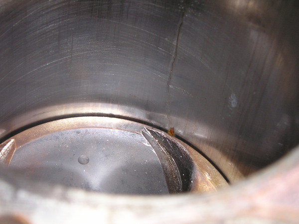

After the last run of the day I noticed the coolant temps were hotter then normal, they stayed at 210 all the way back to the pits. We looked the car over and found a radiator leak, so the coolant system was not holding pressure thus the higher water temp. So we packed up and headed home.

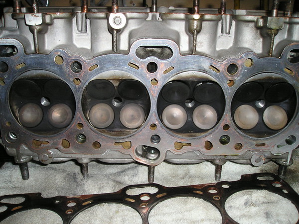

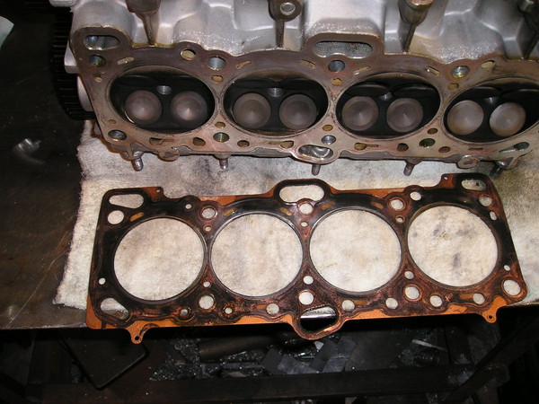

I had a busy week at work and was un able to fix the radiator until saturday. So I fixed everything and got the car running, only to find it pressurizing the cooling system right away, and I was getting water in my oil. I pulled plugs to find the #2 plug was wet, and there was water in the cylinder. So I figured head gasket and pulled the head off Saturday night, it took about 1 1/2 hours only to find it was not the head gasket.

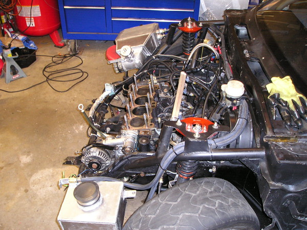

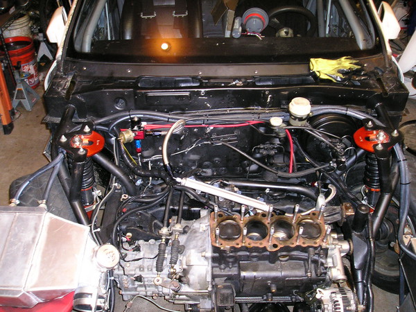

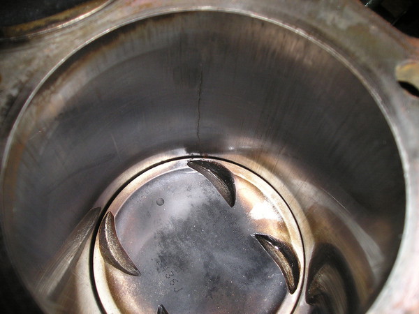

I had this sinking feeling after we pulled the head and saw nothing wrong with the cylinder head, or the gasket. Then I looked in the #2 cylinder to find the issue. There is a 3-4" long vertical crack in the cylinder wall, so my season is done for, and I do not know if I can have it up and running until late next season.
I will take the motor out this week and finish the tear down and come up with a game plan. Here are some pics.

It had to be a bad block from the word go, I will tear into more and find out if it was a thin cylinder wall. I did not see any thing in the log, I did not feel anything during or after the run, it just happened that is all I know for now.
