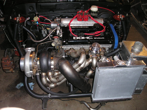

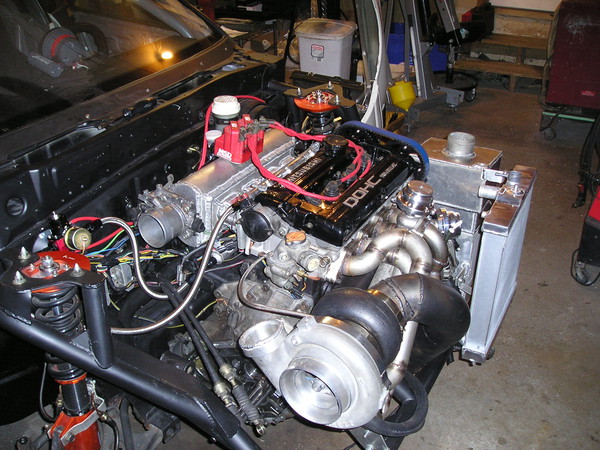

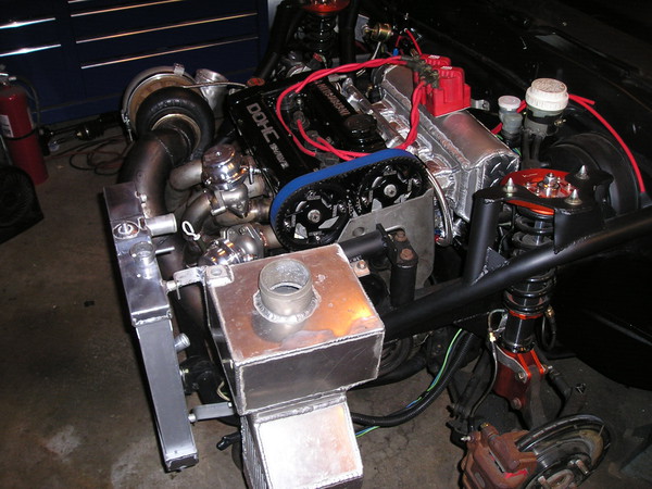

Thanks, well in a few pics you will notice the front lower cross member is still factory mounted, and there is a weird looking metal frame deal that was fabricated to locate the strut tower mounts. This is in the rule book for NHRA for the class I plan to run, that you need to retain the factor strut mount location up front, but they do not say you need to retain the factor structure to do so. And I built a solid rear motor mount that would locate the motor from side to side and front and back in the chassis. Before I started cutting I took a lot of time to level out the chassis on jack stands. Then with a few drawings and tape measure I located vital parts like the frame rails, tranny mount, front motor mount to name a few. Then I did not move the car, and check a few time to make sure it did not move as I was fabricating the new frame pieces. Then after the motor and tranny were back in the right spot it was onto the hard part, the removable front end. In this case I retained the factor mounts for the fenders off the fire wall/a pillar, then with the metal front trim piece above the bumper cover and some measuring to get the fenders square off the body. Then I made the frame to hold the fenders together and slide onto the chassis, then mounted the front bumber cover and the hood pins.

The car runs, it would have fired right up but I forgot to mark which coil was what, so after 10min of poking it starts and cams at 1400rpm on E-85 with an old map I had converted to 550cc primary injectors and E-85.
Now for the bad news, to make a long story short I was trying to get the car on the dyno and up to the MAP shoot out this weekend. But the Evo 3 3rd and 4th gears I bought for the home made Stage 4 tranny are on national back order and I will not have them for a few weeks.
I would ask to buy or borrow a tranny or just the gears from a tranny but I think I can wait a little longer for my parts to show up. So for now here is a small look at what we have been up to for the past 2 months.
Here is a run down of the new shinny parts:
- Tranny, everything to make a stage 4 tranny: evo 3 1st gear, cut double syncro 2nd, evo 3 3rd and 4th gear conversion, new bearings threw out, welded center diff, welded parts on the front diff you help keep it in 1 piece, new shift forks, new magnetic drain plugs, new throw out fork and throw out bearing, etc
- Quarter master twin disk clutch
- Tial 38mm WG with 1.6bar springs x2
-Tial 50mm bov

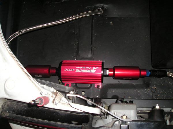

-A1000 fuel pump, filters, and FPR
-PTE 550s primary and ford 1600cc secondary injectors
-civic 1/2 sized radiator
-17" wide Kirkey race seat and 5 point harness for the passanger side

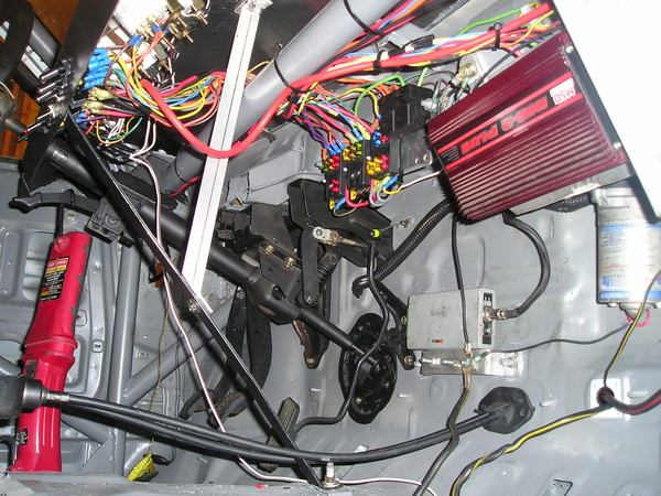

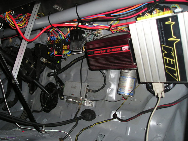

-A ton of electrical stuff to make everything work
-BF goodrich T/A drag radials 225 50 15's this should give me a 9.2" contact patch at all 4 corners
-etc
So I hope to get it down the track this season yet, but as the title goes on the galantvr4.org post, the never ending project.
~John

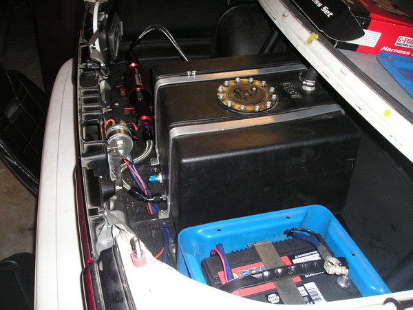

Do you have any more detailed pictures of your trunk? I'm thinking about ditching the stock rusted tank and putting my fuel cell in their but haven't really seen any others to inspire me.

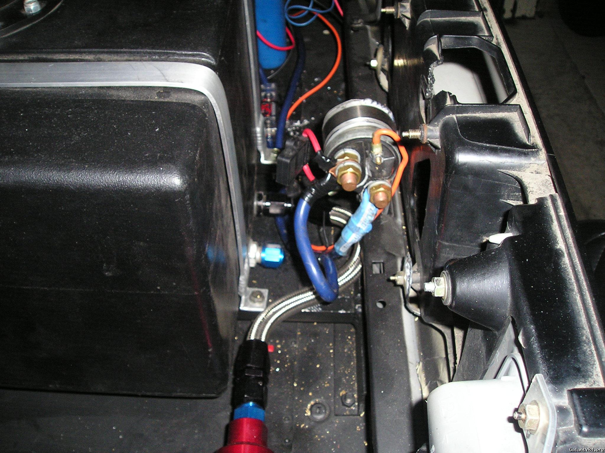

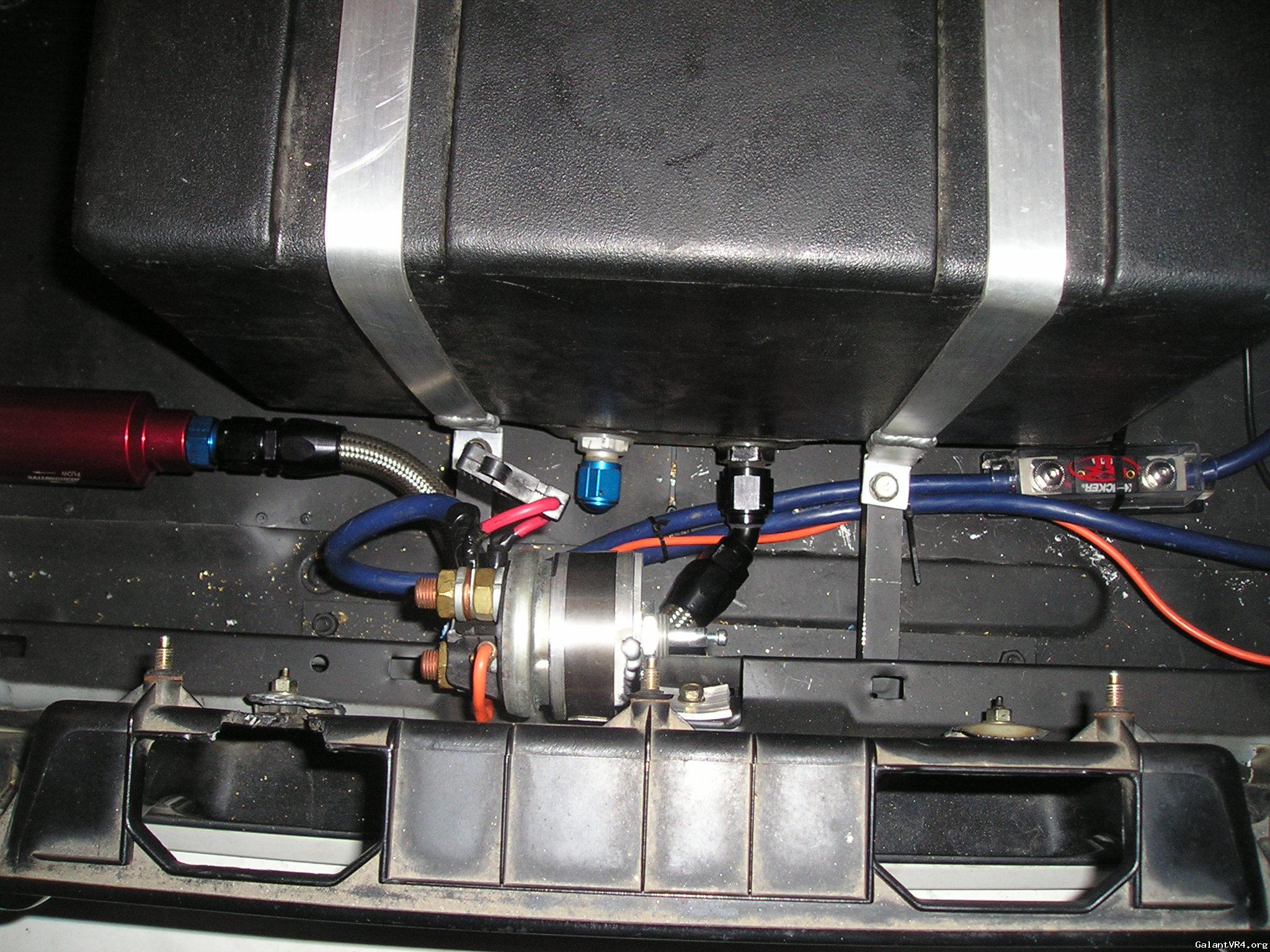

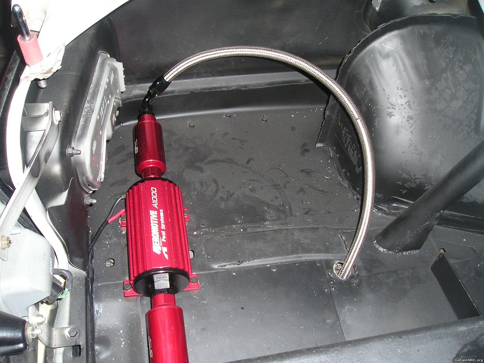

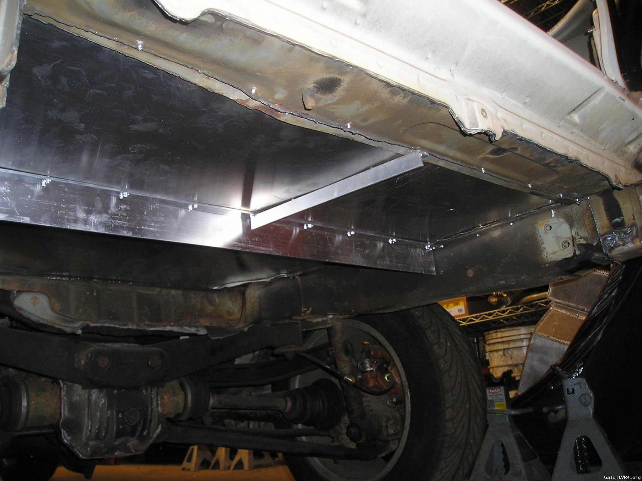

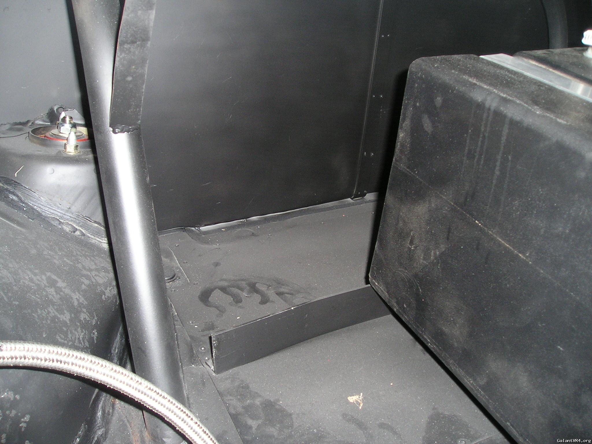

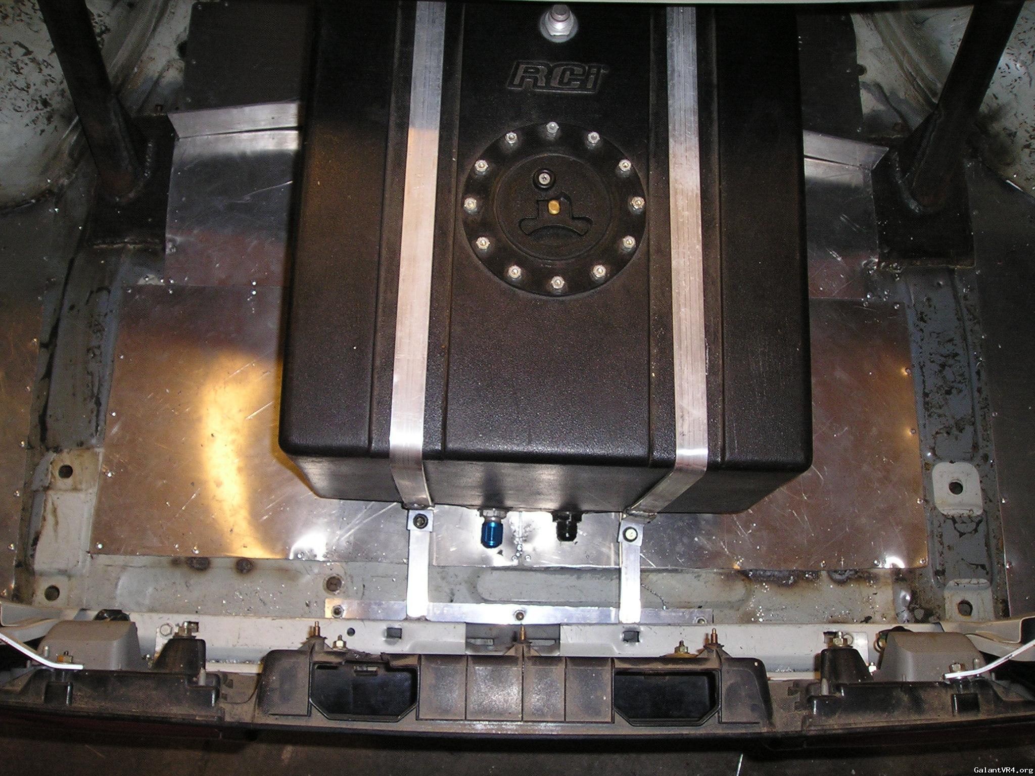

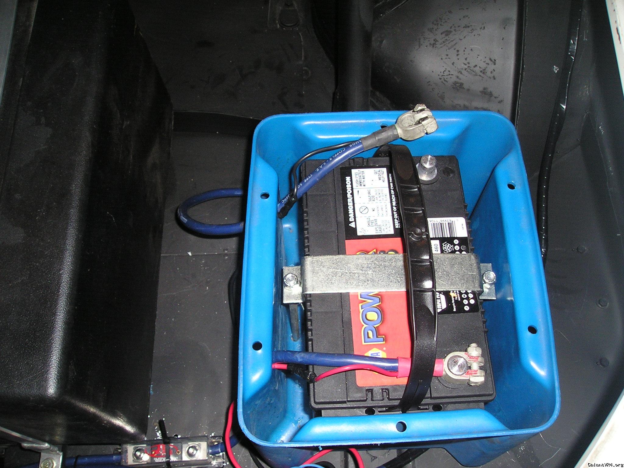

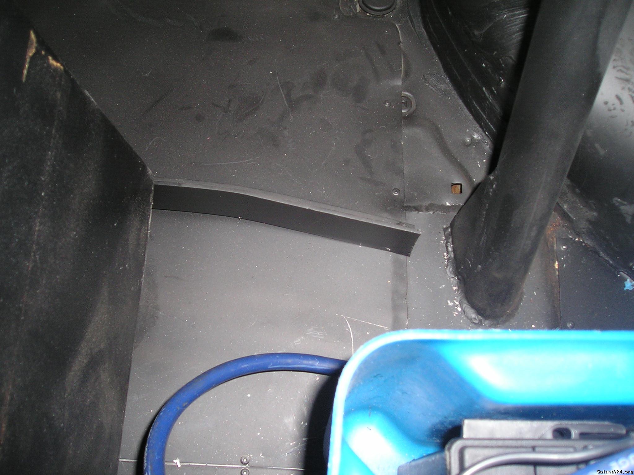

I plan to race the car in the NHRA hot rod class or bracket race if I go to the track for a "normal" day. I have some pics of the trunk area on pages 1 and 2 of this thread and a few more on mitsu style. Here a few more of the finished trunk area:
I will post some more pics when it is closer to running down the track.

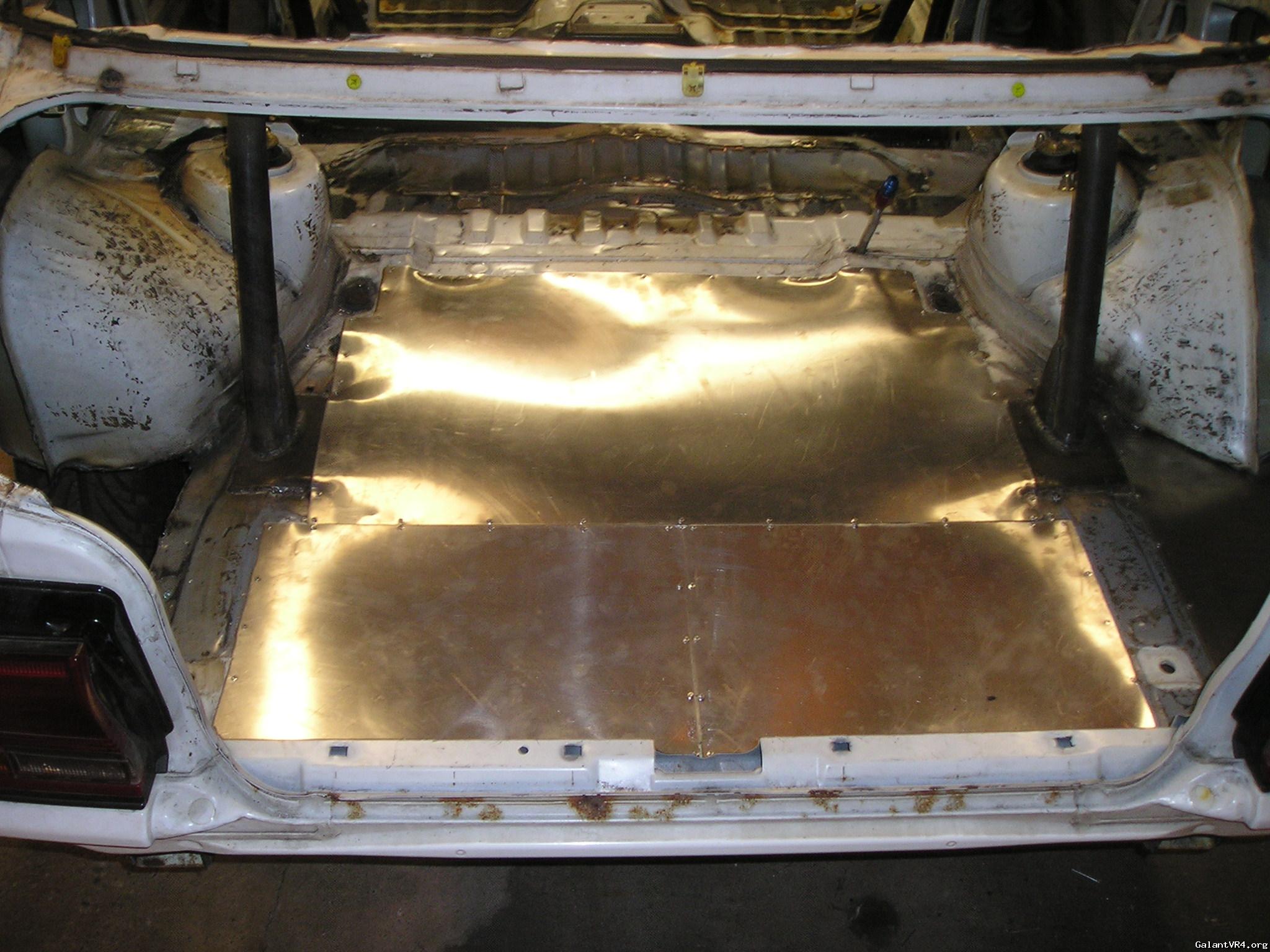

John, thanks for more pictures of the trunk area. I guess my only question is, did you cut the spare tire well out and tin the trunk or is it still in tact and just modified slightly to bolt the cell down?
Galantvr41062
Aug 20, 2007
415
plymouth, MN
I cut most of the trunk area off the car. I left the 2 "frame" rails that go to the back and the rear wheel wells/shock mounts alone. The fuel cell is mounted to a aluminum frame that is bolted to the chassis. I also cut all the factory sheet metal from the rear deck lid and fabricated my own fire wall for the trunk. I also cut the side pockets out of the trunk area and made that flat and made new mounts for the rear bumper cover.
