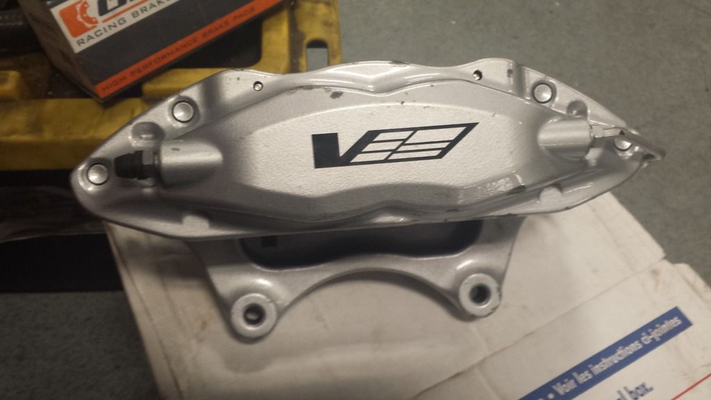

Here you are. CTS-V calipers. See if I can't get these mocked up this weekend They are a little scratched up being tossed around in a bin. I bought them off of a guy at work.
jeverts
Jul 14, 2011
305
Hartford, WI
I check the bolt spread to the stock calipers and it matches up but I have a feeling I am going to need to extend them out from the knuckle a bit.

There are a few threads out there with people attempting to use these calipers on DSMs. So far I haven't seem anyone pull it off completely or at least update their threads if they did. Yes, the bolt spacing is the same but offset seems to be way off and when offset is corrected, the rotors seem to be an issue.
Hopefully you can get passed this and figure out an easy way to make it work. I've wanted to pay with these myself for a while now but have yet to try. Good luck and post your findings!

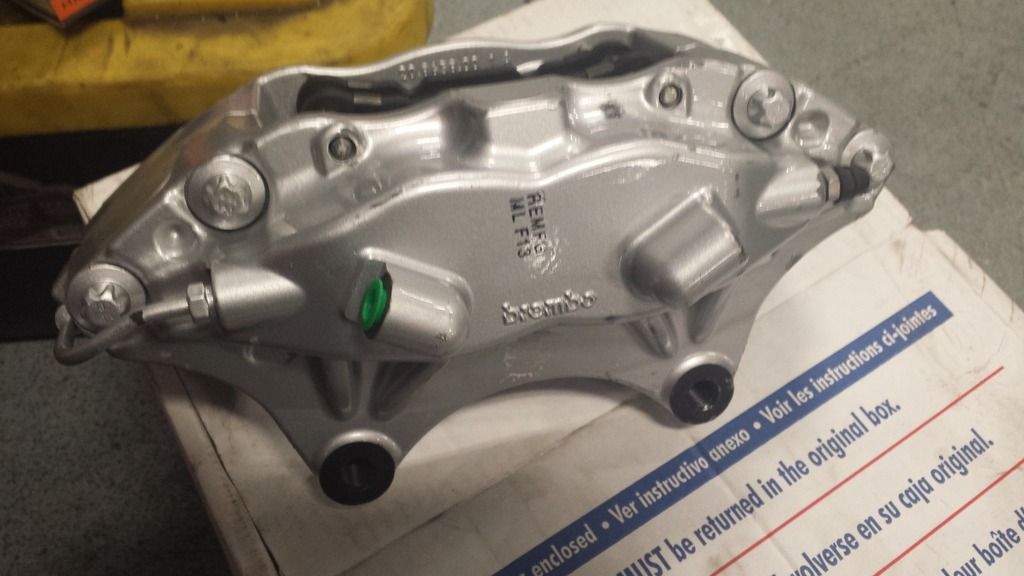

I'd be interested to see which type of wheel offset would be need to clear that setup. When bolting them to the hub without modification, the caliper sits roughly 0.5" farther out towards the wheel than an evo brembo caliper.

If its the case of just wheel spacers this is going to be easy peasy. Thanks for the link. This might work out better than I had thought.

I can't imagine they stick out any farther than the 3KGT calipers.
They definitely do.
Wheel spacers will most likely be needed, which isn't an issue to me depending on how much of a spacer is needed. When you start getting a lot of wheel poke and having to add camber, etc just to fit a set of calipers is when I start looking at other alternatives.
