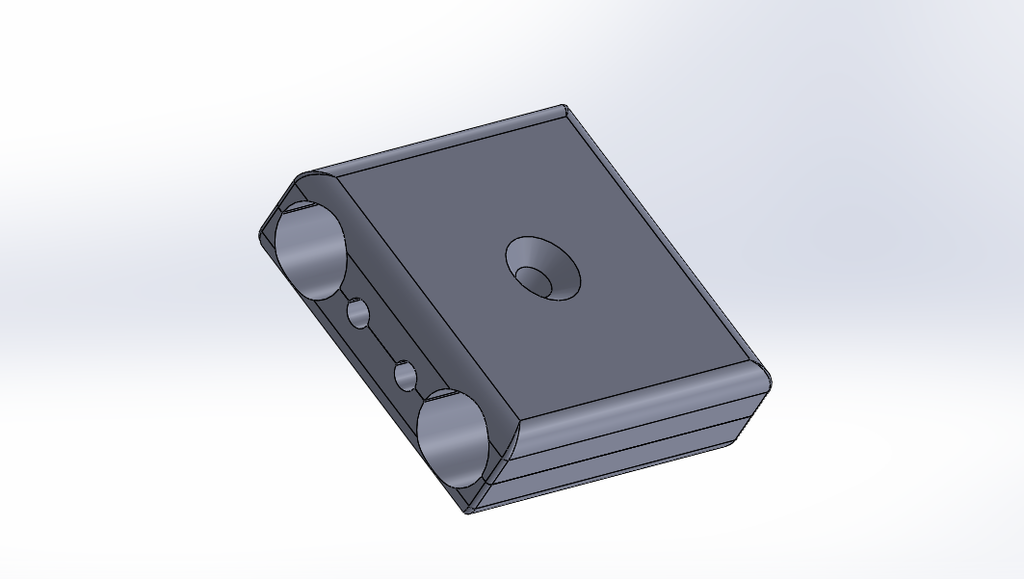

That is it's parking spot. I am just glad they are not making me park it outside. When did you come in? I have been here all day. LOL these cars run. I'm about 75% there. If I would quit coming up with sh*t to machine for it I would probably have it done by now. Just need to make time to work on it.
This is my next project Fuel and brake line mounts

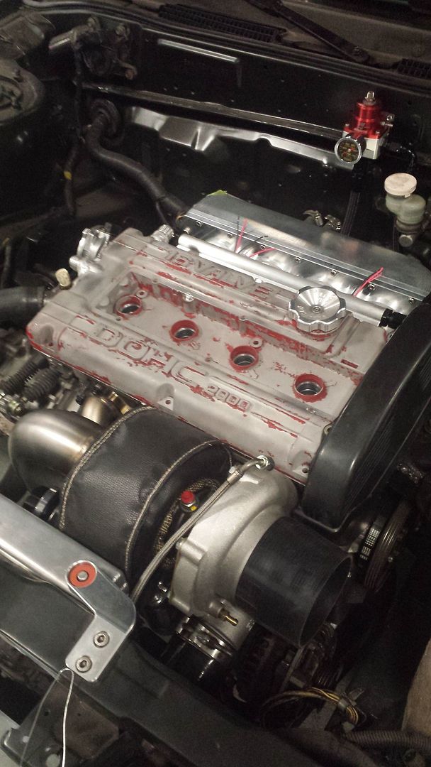

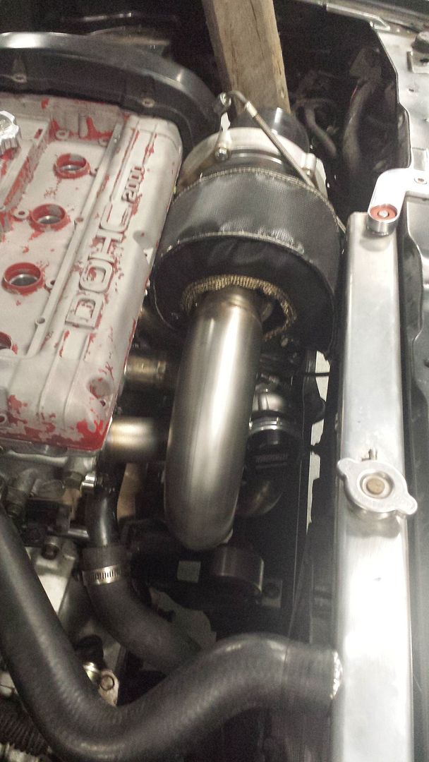

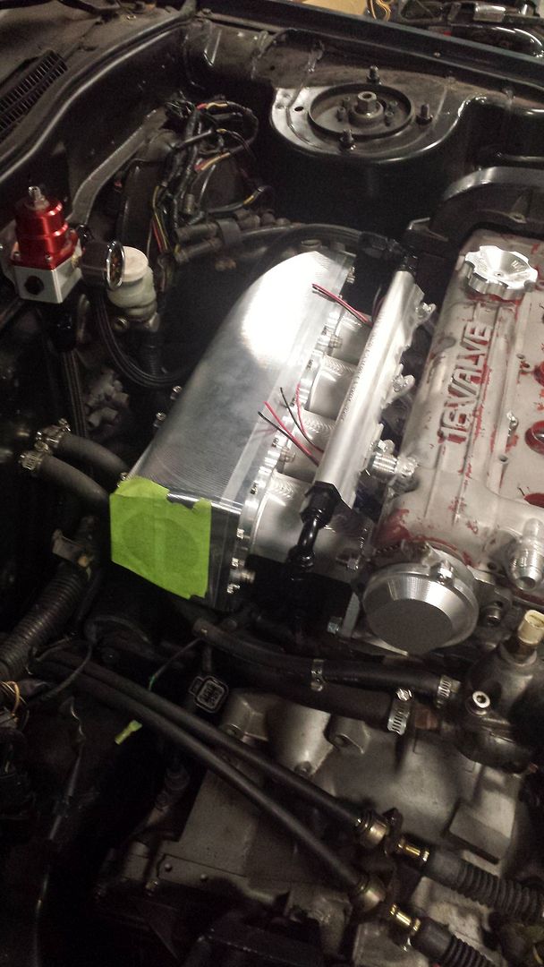

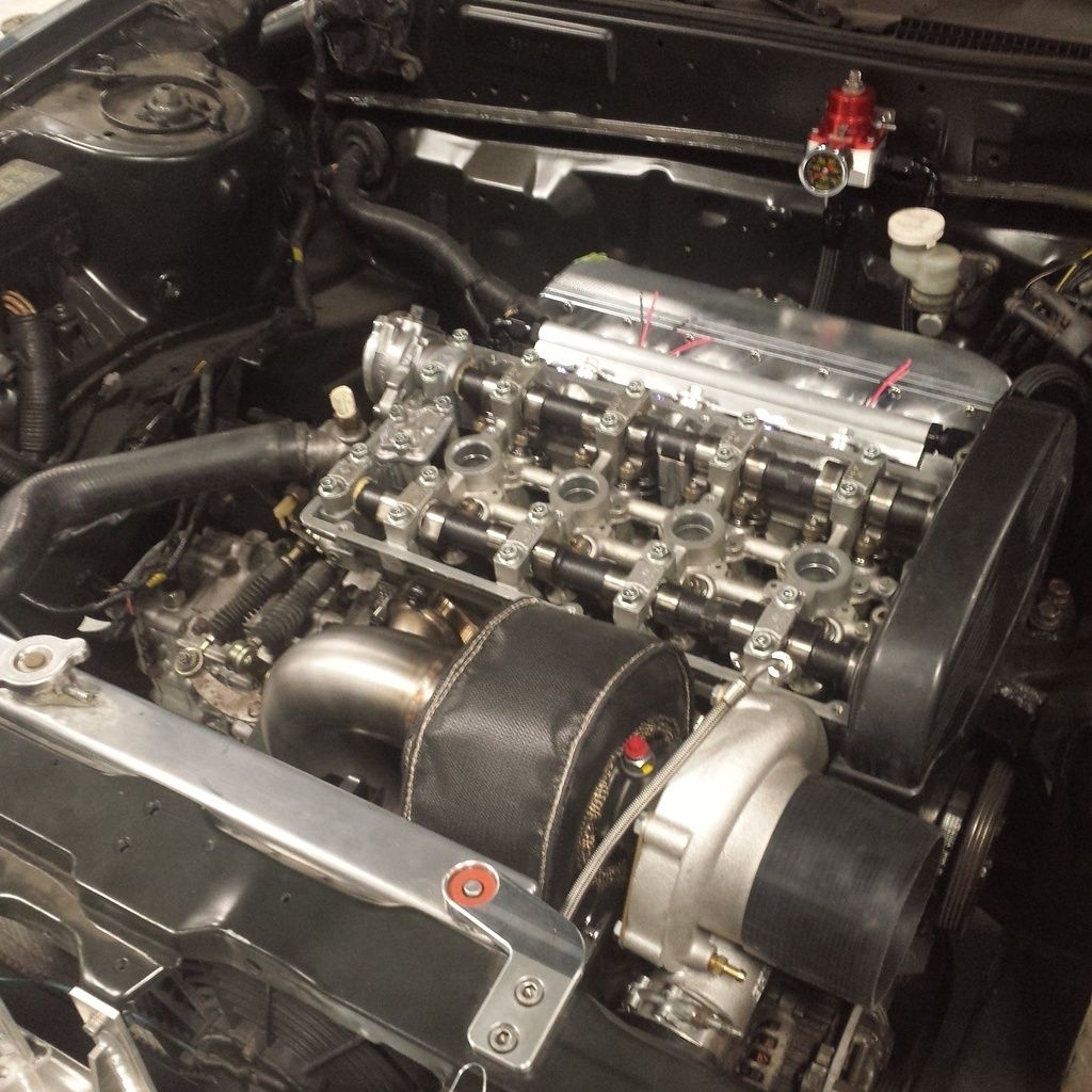

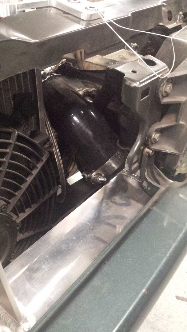

Haven't posted progress in a while. Got the turbo in manifold ported started on the fuel lines. Probably going to be ordering a TB this week and then I can finish up the pipeing.
