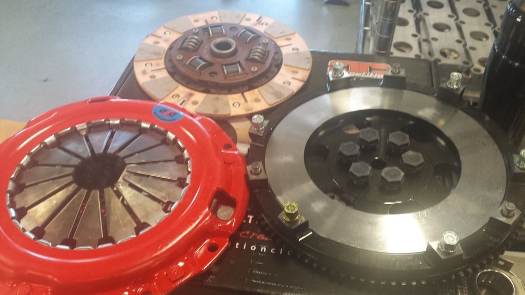

Its the SSX pressure plate with the ceramic disk. I dont know what stage that is. The flywheel is just a standard comp clutch lightweight steel flywheel.

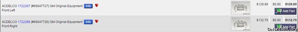

Found the Front Calipers that I am going with. They are 4 pot brembo calipers off of an 05 CTS-V. I would say that is a good price on calipers.

Let us know about the appearance when you get them. I don't believe that Rock Auto powdercoats the rebuilds on Brembo calipers.

Yeah they have remans on there for $30 cheaper. Had a guy buy these for his truck and they came in looking brand new.
