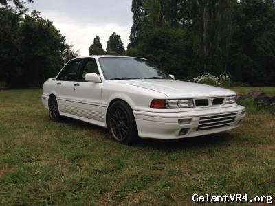

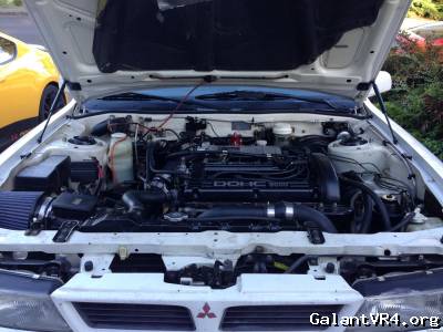

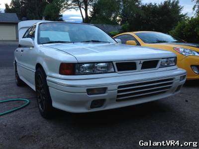

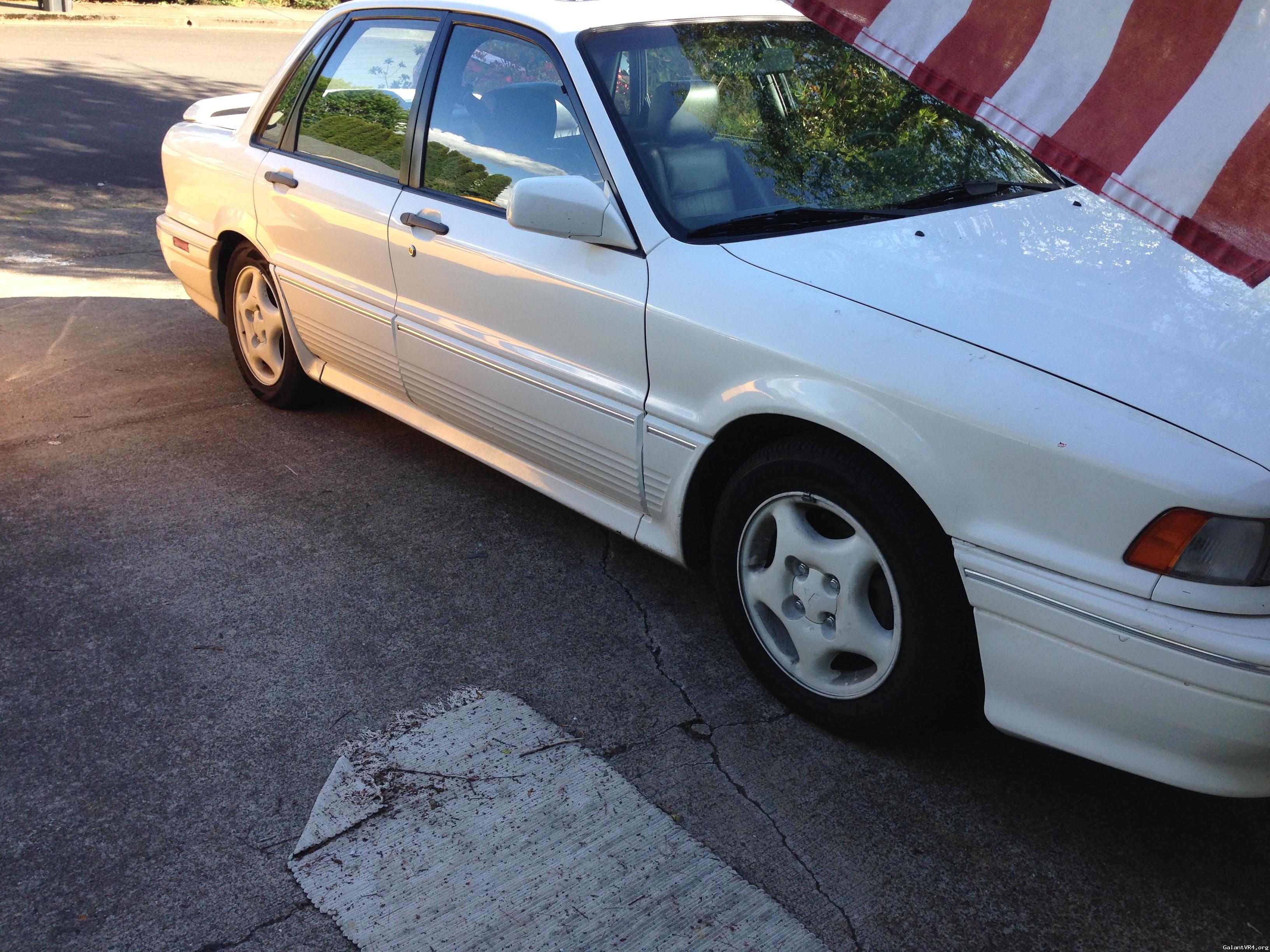

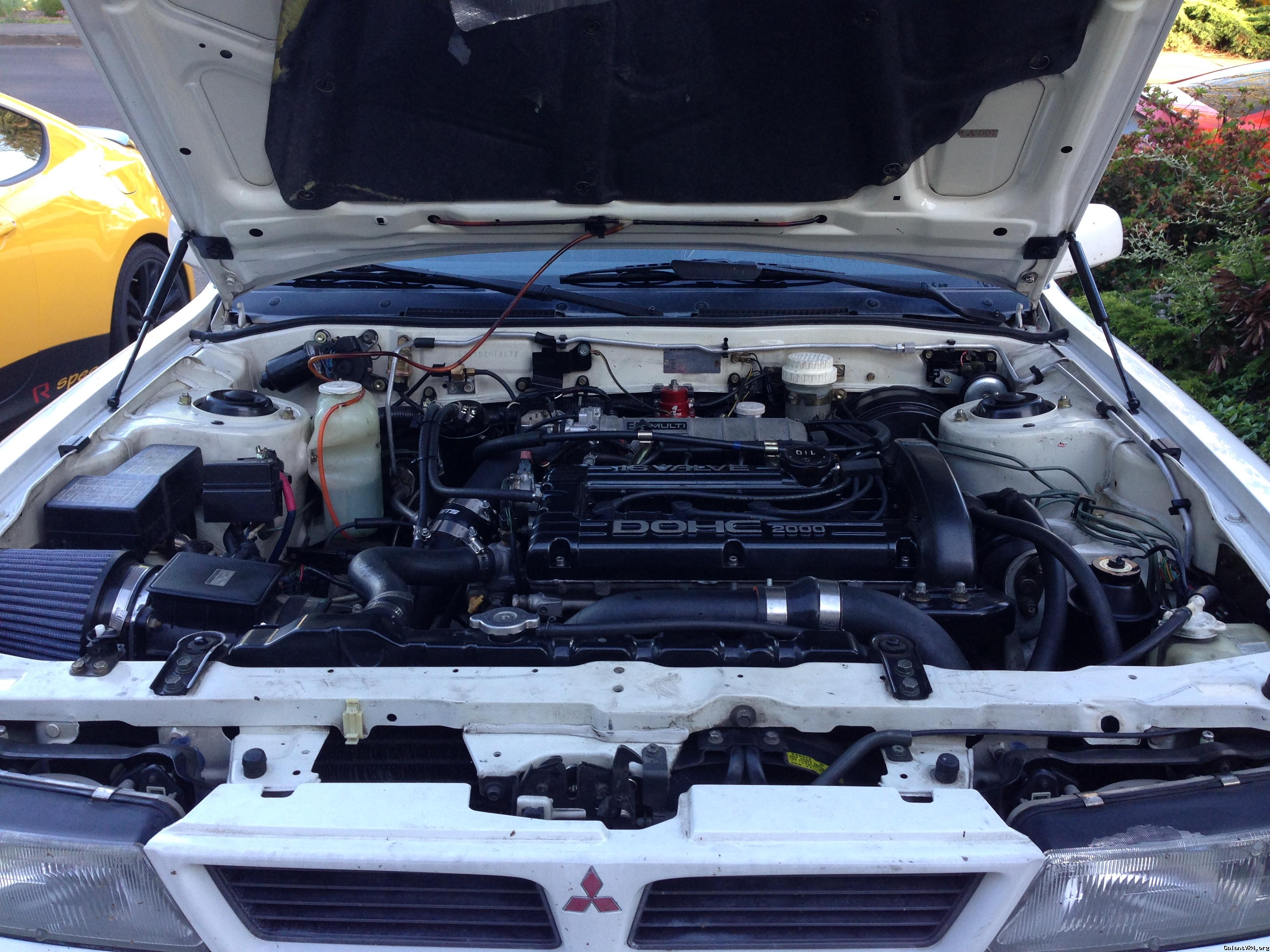

I haven't updated my thread in a while, so I figured I would do so...With a few pictures!

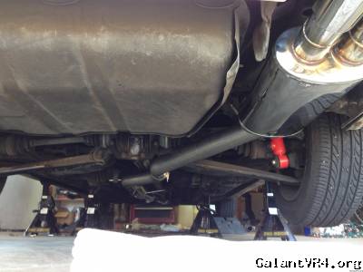

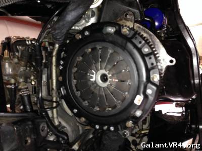

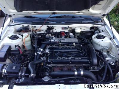

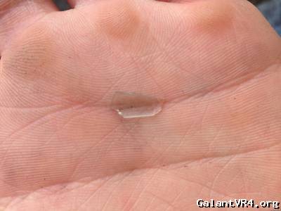

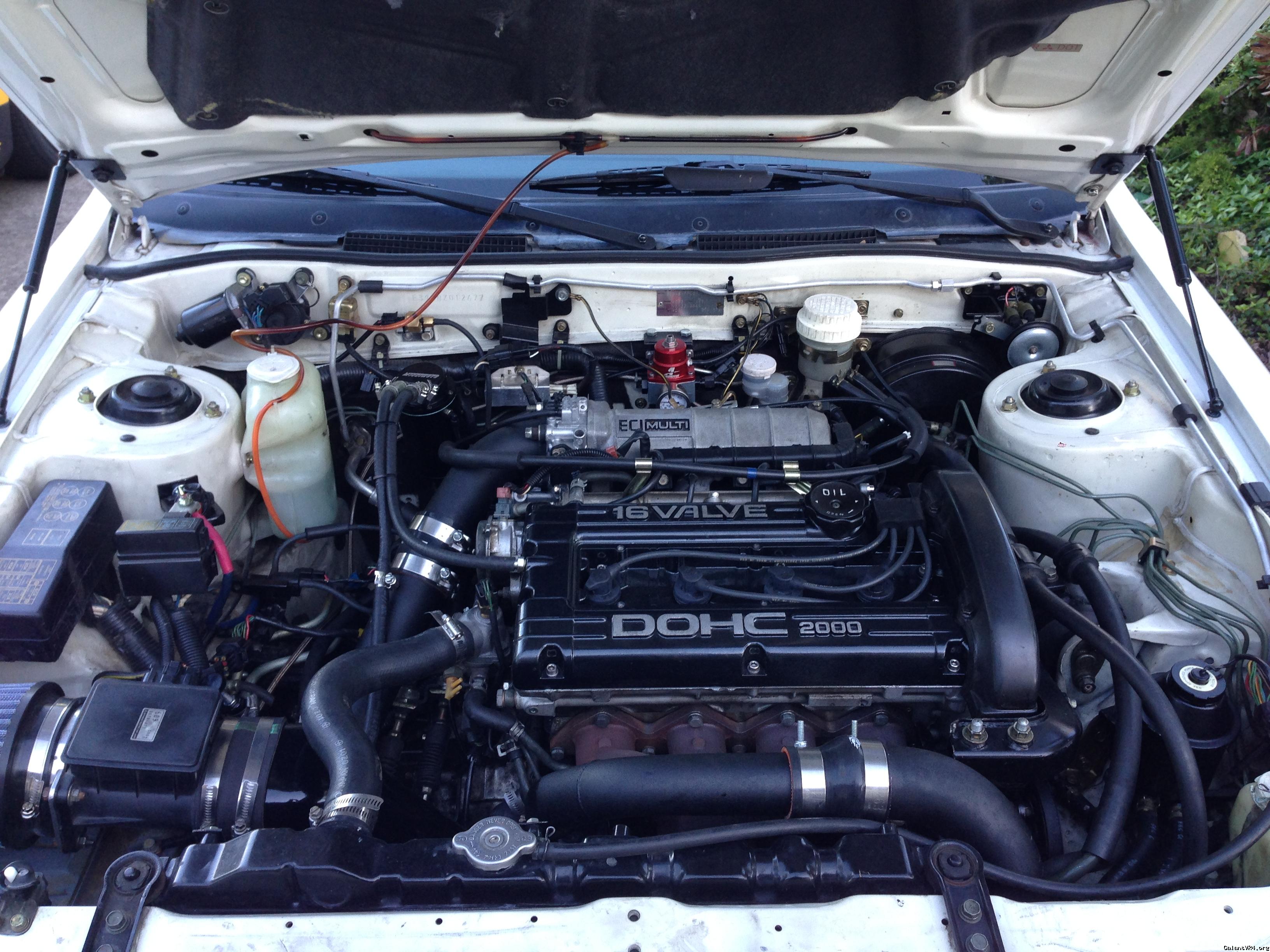

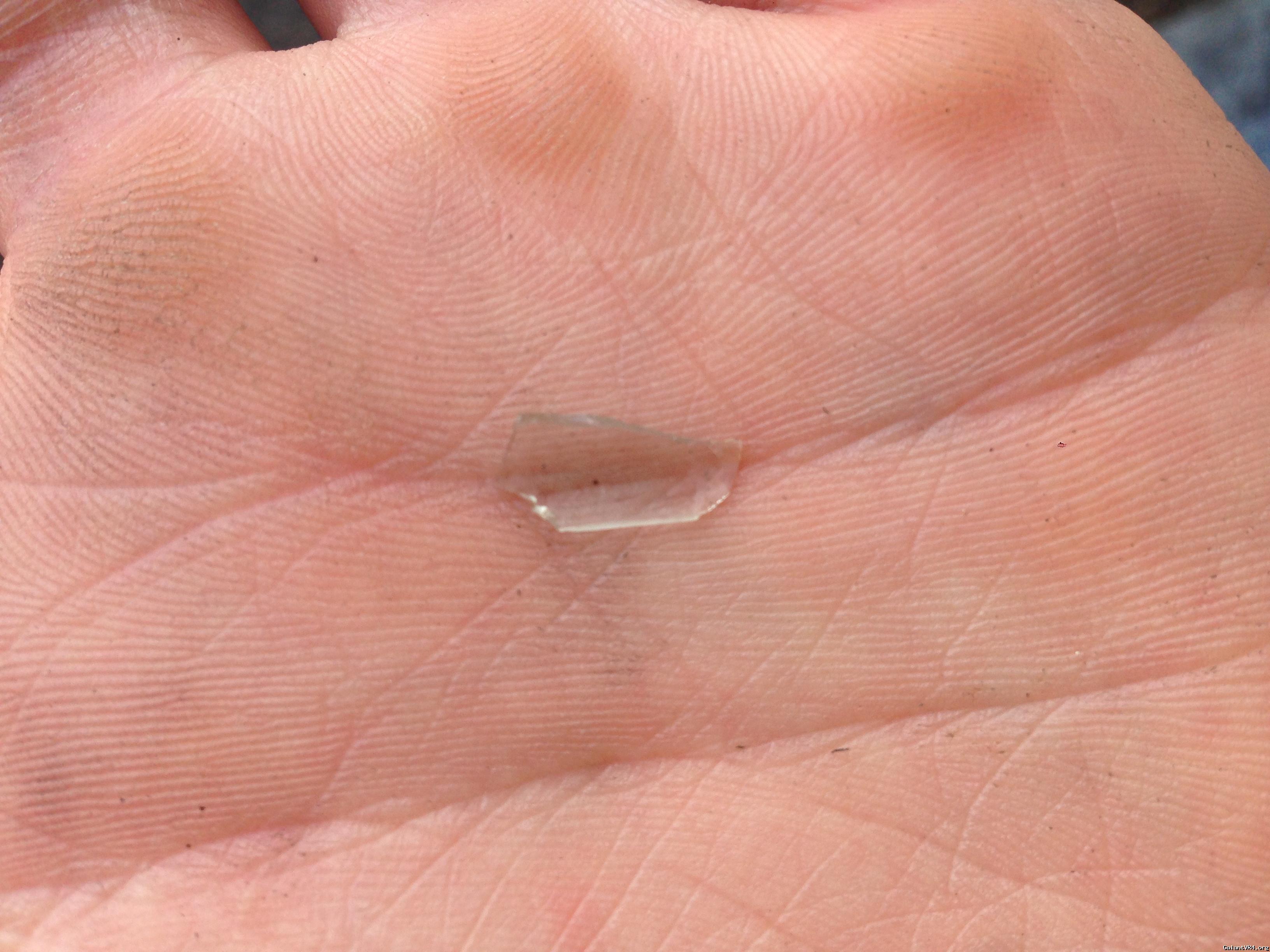

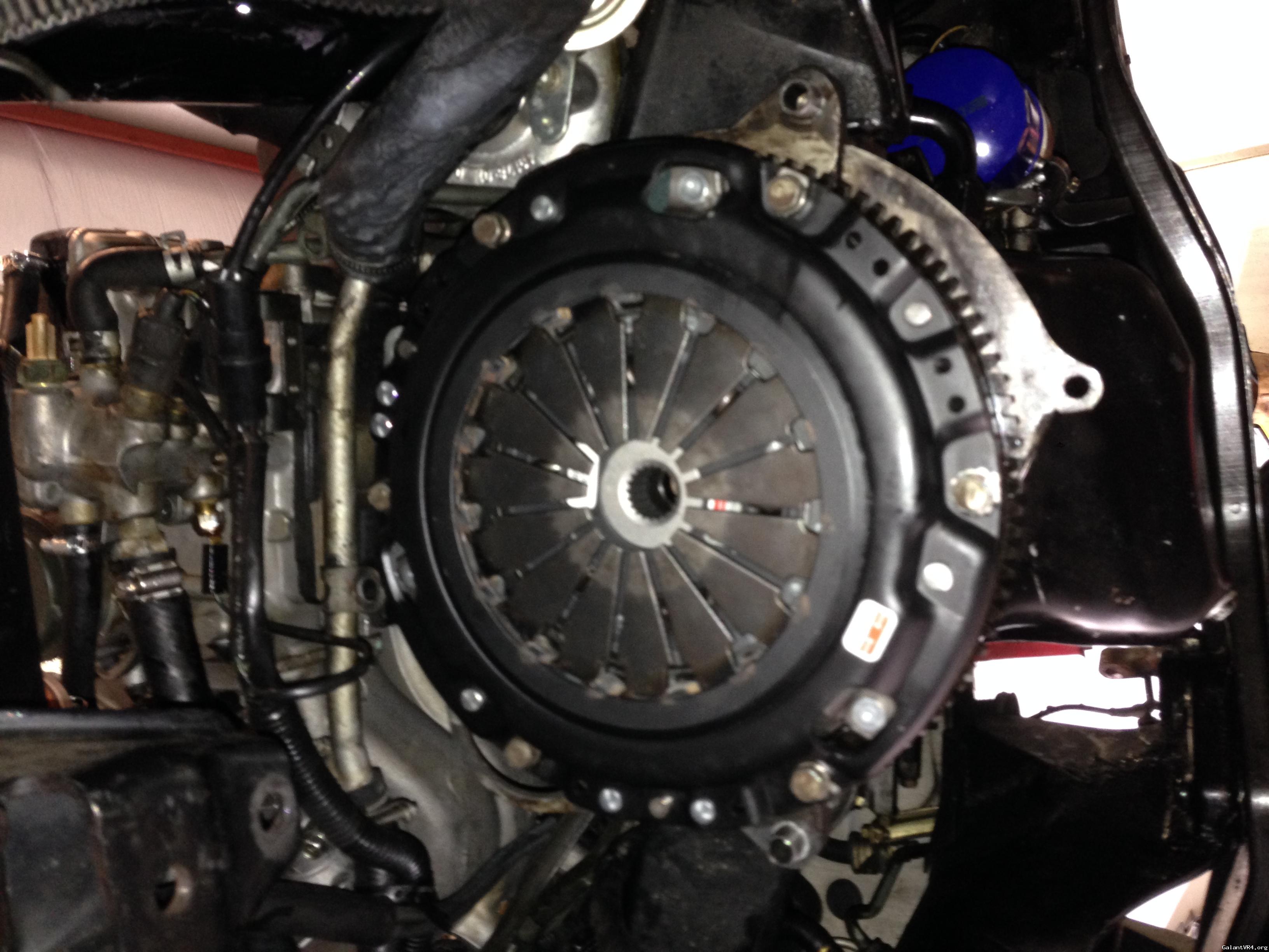

Swapped over a black powdercoated valve cover when I was putting in a new VC gasket, put in a CMP 3" Catless Exhaust, FP manifold, freshly rebuilt E316G (much thanks to Bell turbo), boost controller, Injen Intake, 2g Maf, Competition Stage 3 clutch kit (ceramic not kevlar), and put my new wheels on! I still need to build a cold air box and I am going to pull the trans back out to shim the clutch pivot ball (this weekend before Import Face off). Also found a random piece of glass in my oil pan when doing the seal (wtf) and painted my window trim. I also have amber corners and 93 Headlights on the way!
On a side note, I need to adjust my GCs...or just buy some True coilovers off of Bobdole...
Now for the part everyone actually cares about...

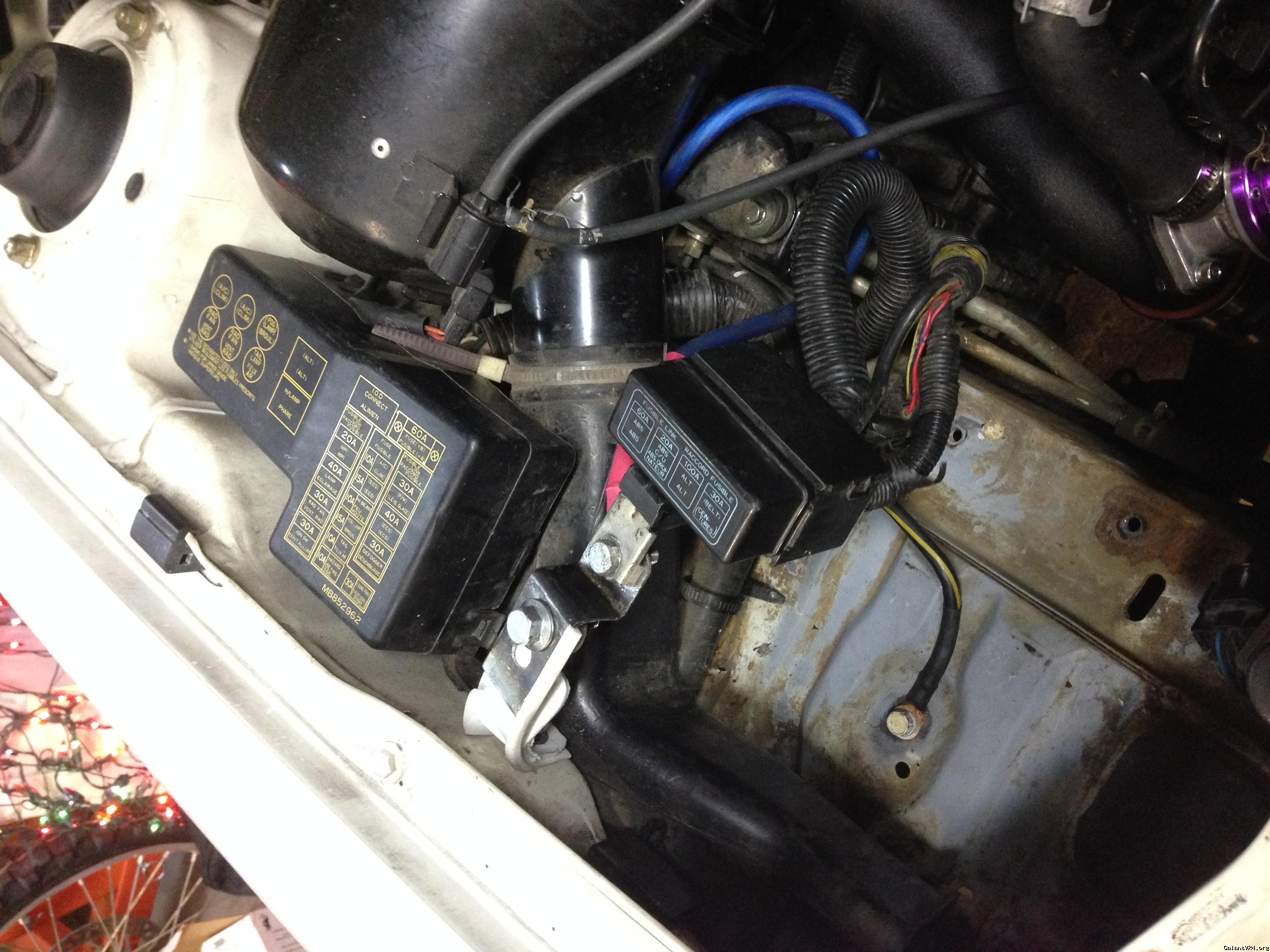

Had to get a little creative on the mounting for the fuseblock and starter cable...
Manik, I think I would figure out another solution for mounting the fuse block if I were you. That looks like a short to ground waiting to happen. I would try and make a bracket that actually holds the plastic cover on the fuse block. What are you insulating that with?

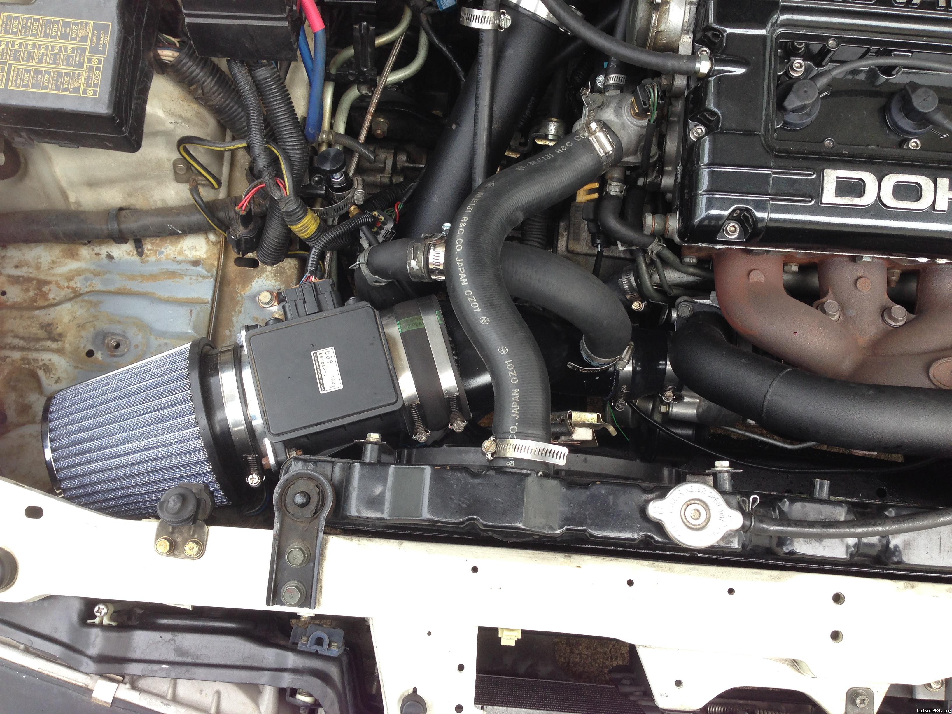

Hey manik, nice build. Can you take a pic of how you routed your BOV recirc hose? I asked Robert to relocate the flange for me on the kit because it was in such a bad spot at the stock location. You posted in my thread and are similarly using a GReddy BOV, 2G Dejon intake, and ETS like myself. Would be nice to see how you did it. I'm having a hard time finding a hose that's flexible enough to do an "S" bend in such a tight spot. Tried stainless flexible radiator hose and the wire supported hoses, but nothing. Only Home Depot spa hose can make the bend I want, but I don't trust the thin walls against puncturing. Been considering getting a hard pipe fabbed up or turning my BOV around and routing the long way. Thanks.

Thanks for the support TNegro. GSTWithPSI, I have since changed that. I only did it as a temporary fix. I built a new mounting block that utilizes non-conducting material and has much more space to prevent arcing.
Well, Originally I had a dejon shorty 2g intake, and with that I used the stock hose and a chunk of rad hose I had laying around. The stock hose got the Recirc up and over the intake and the second section made the bend back to the Recirc flange. Unfortunately I thought this looked terrible and was a really long path for the recirc charge.
Currently, I have a modified Injen intake that has the recirc tube much closer to the ETS BOV location, so I used a small section of hose to do it. As far as your setup goes, I would recommend modifying your intake tube recirc location or having that hard pipe fabbed up. The shortest route is almost always the best IMHO. If that is not an option, I liked the idea of using braided stainless line as a recirc line. I don't like the idea of having the hose be too flexible because it ends up getting kinked and not flowing properly.

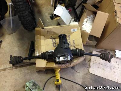

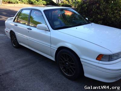

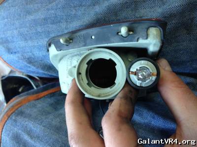

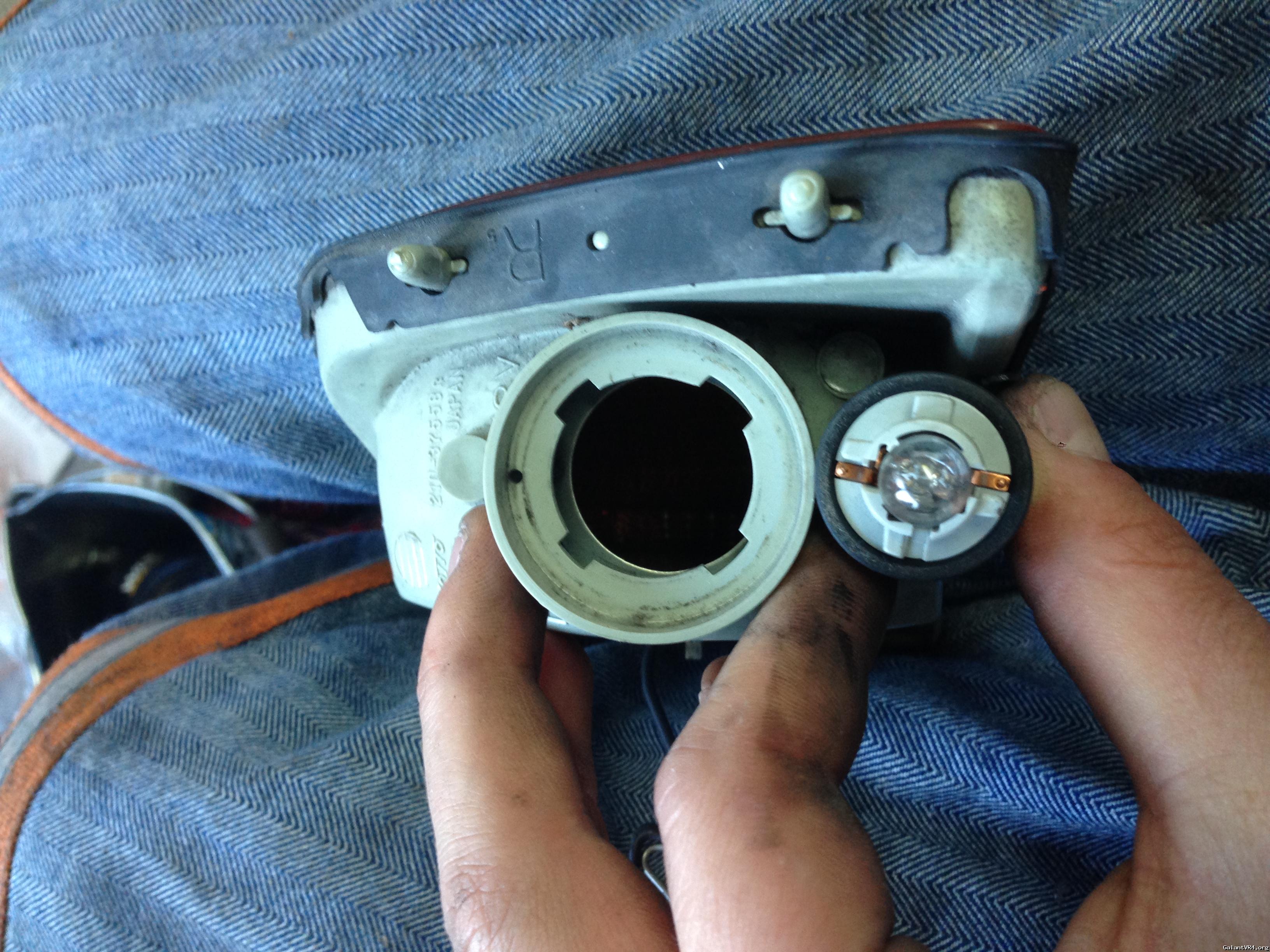

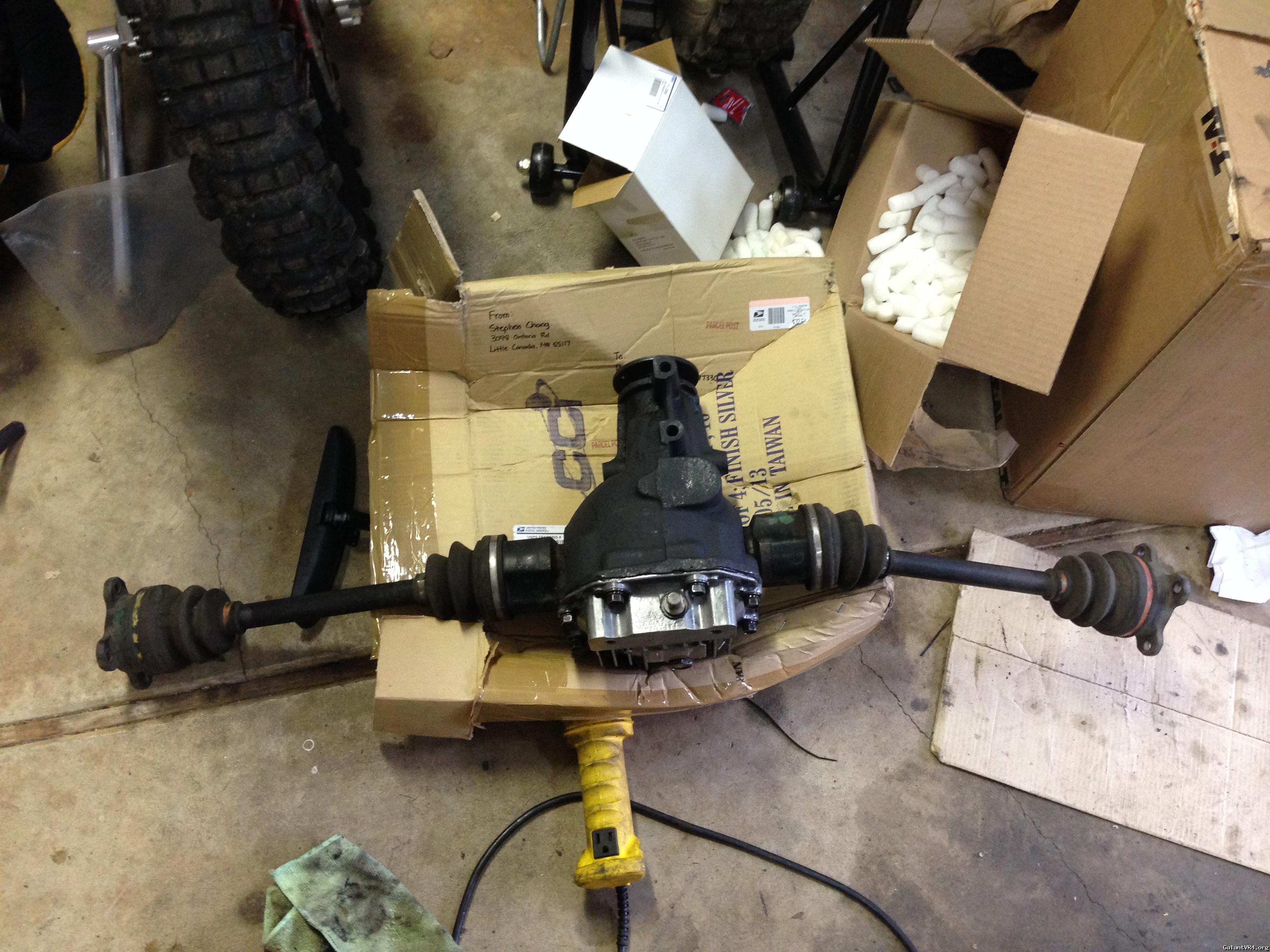

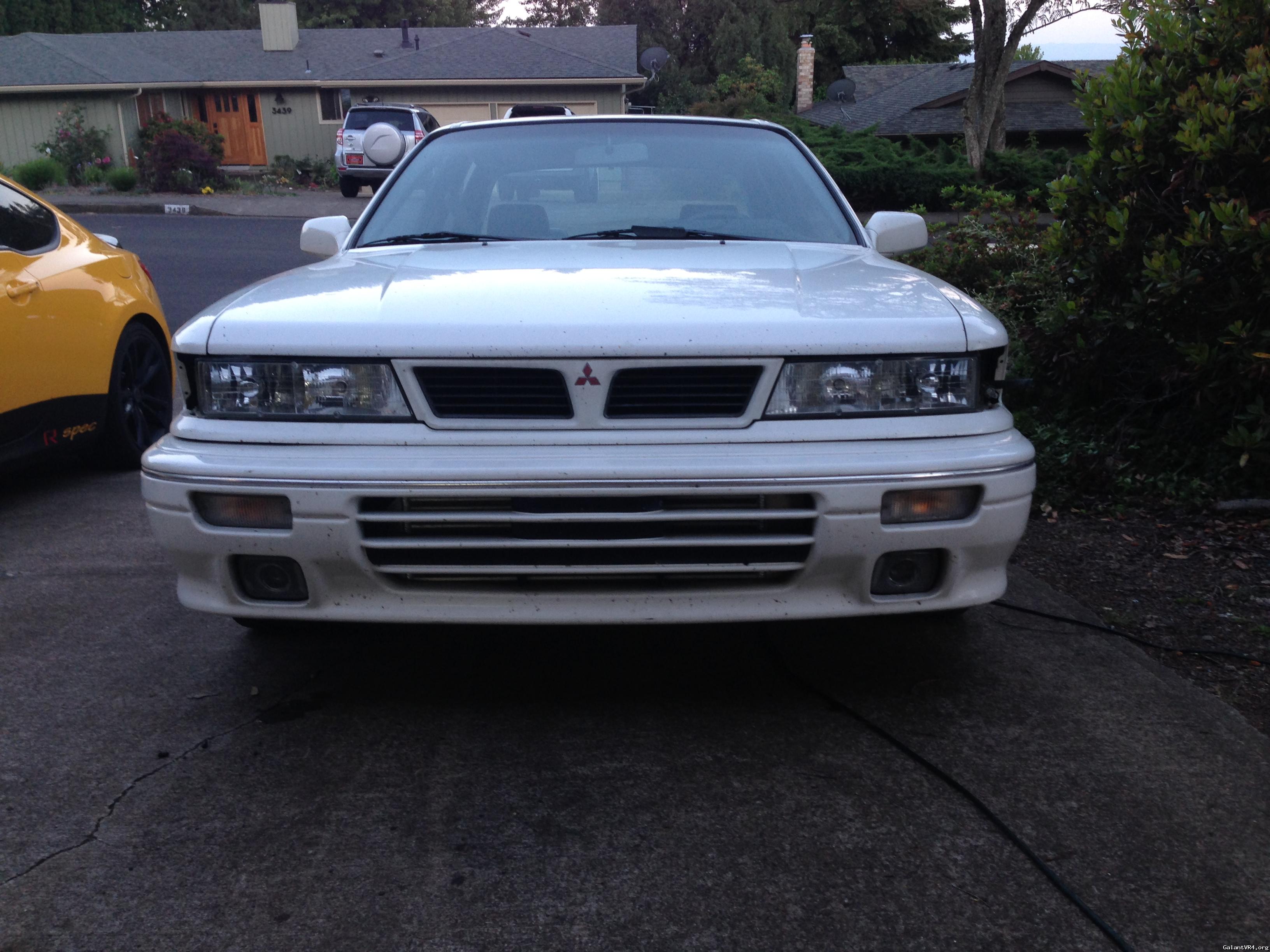

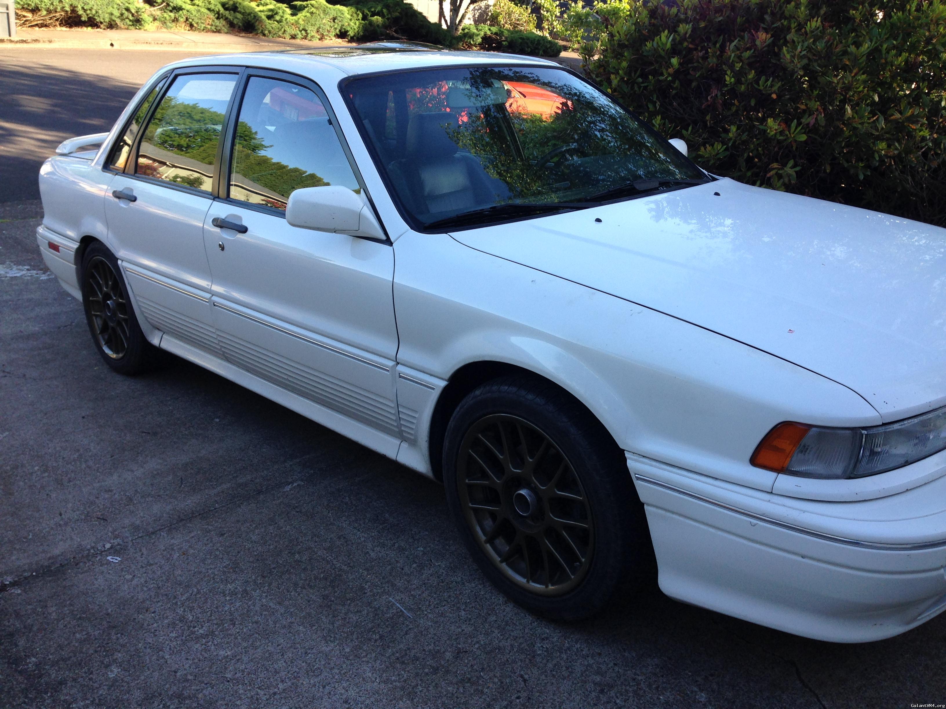

Got my 93 headlights in. Ran into a problem with the amber corners. The stupid pigtail end is different for the ambers...grrrrrr...Also broke my rear axle, looking to get a 4bolt rear with sway bar and poly bushings from TheDSMGuy...Hopefully this week and going in this weekend. For now here is a pic!

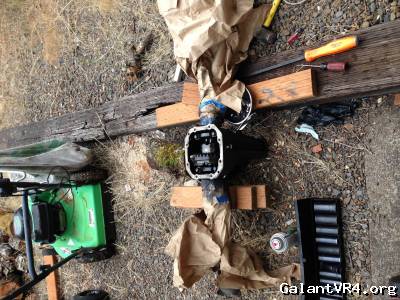

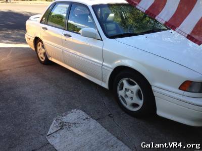

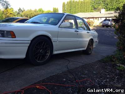

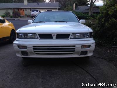

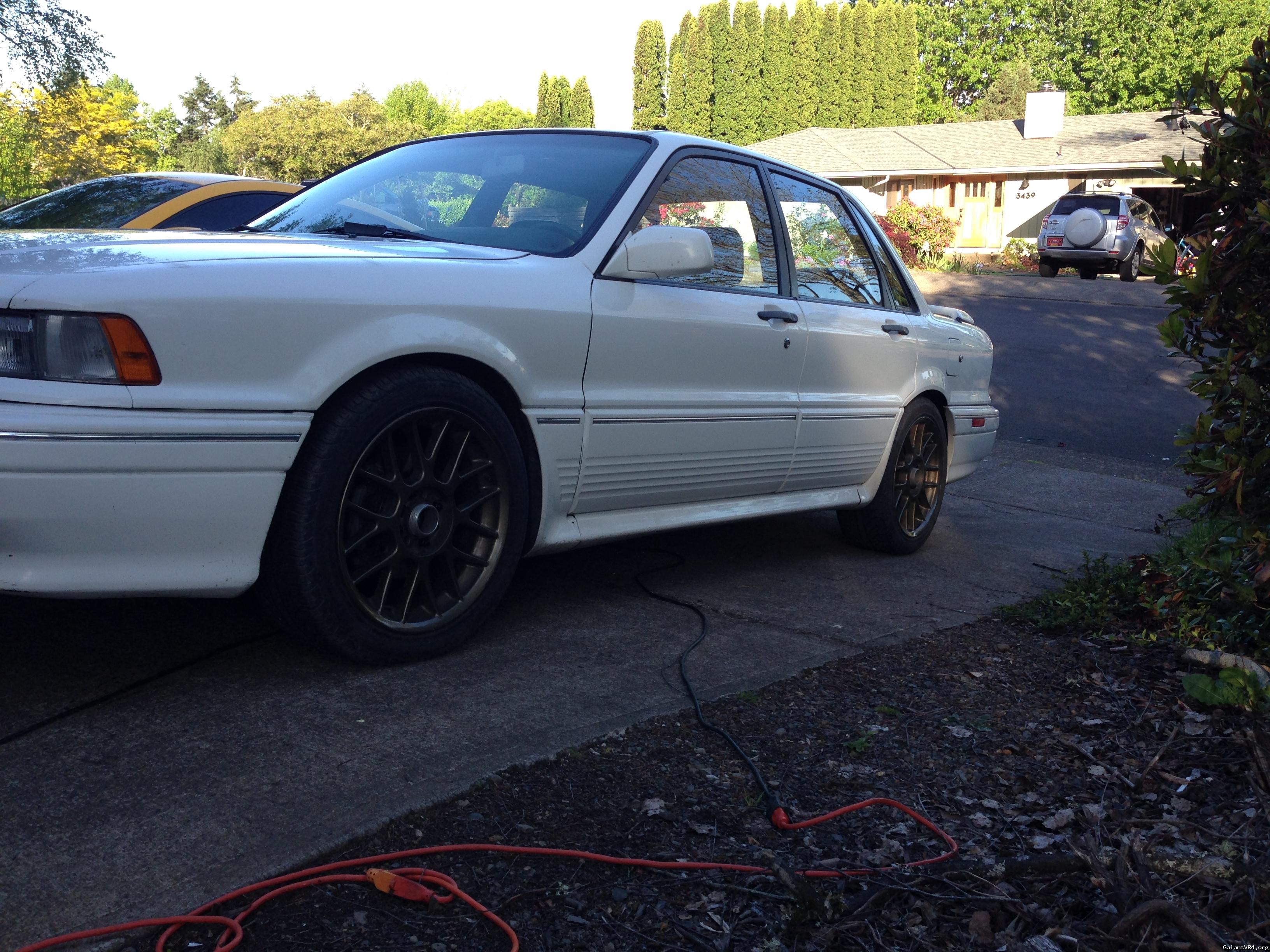

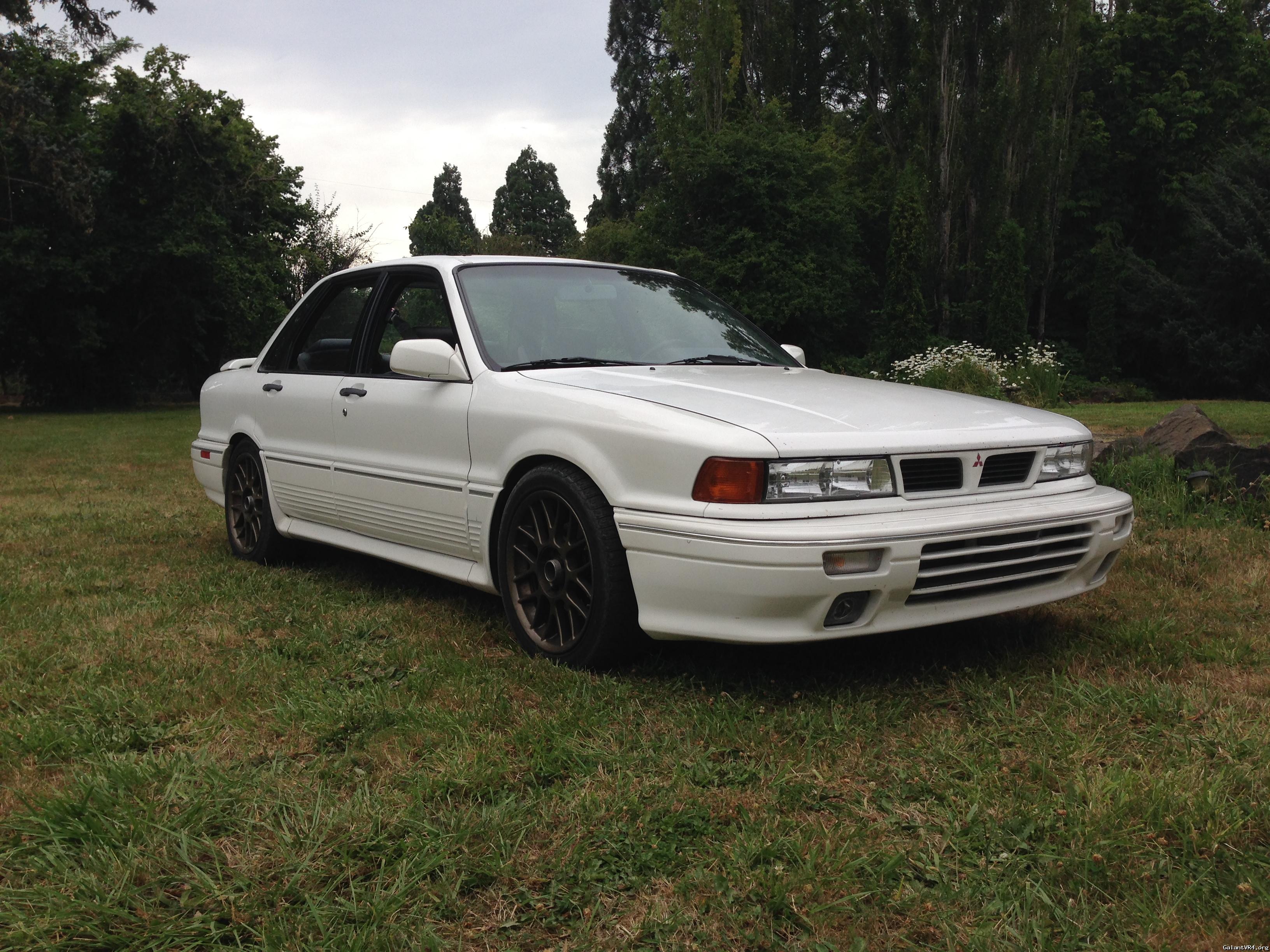

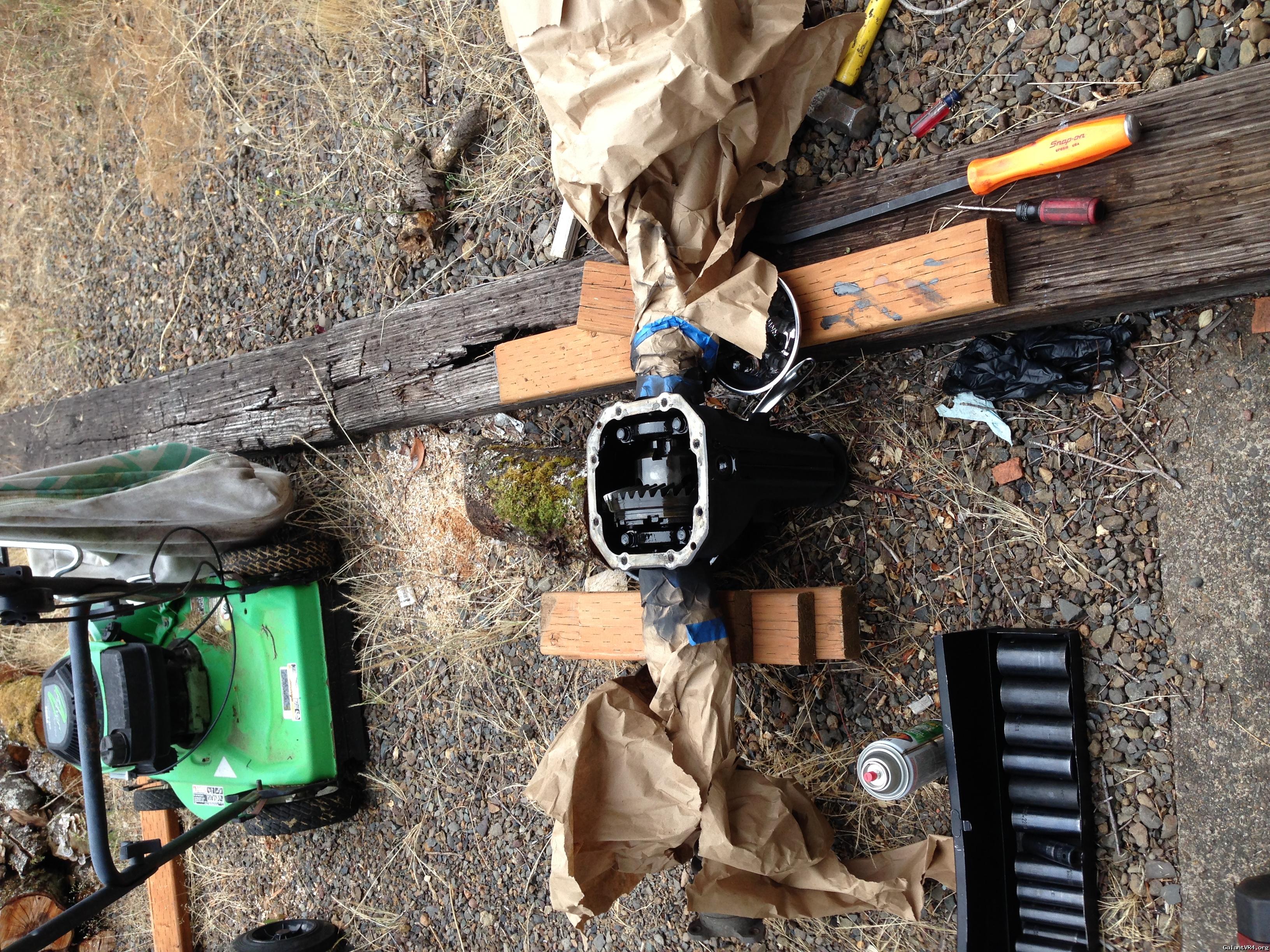

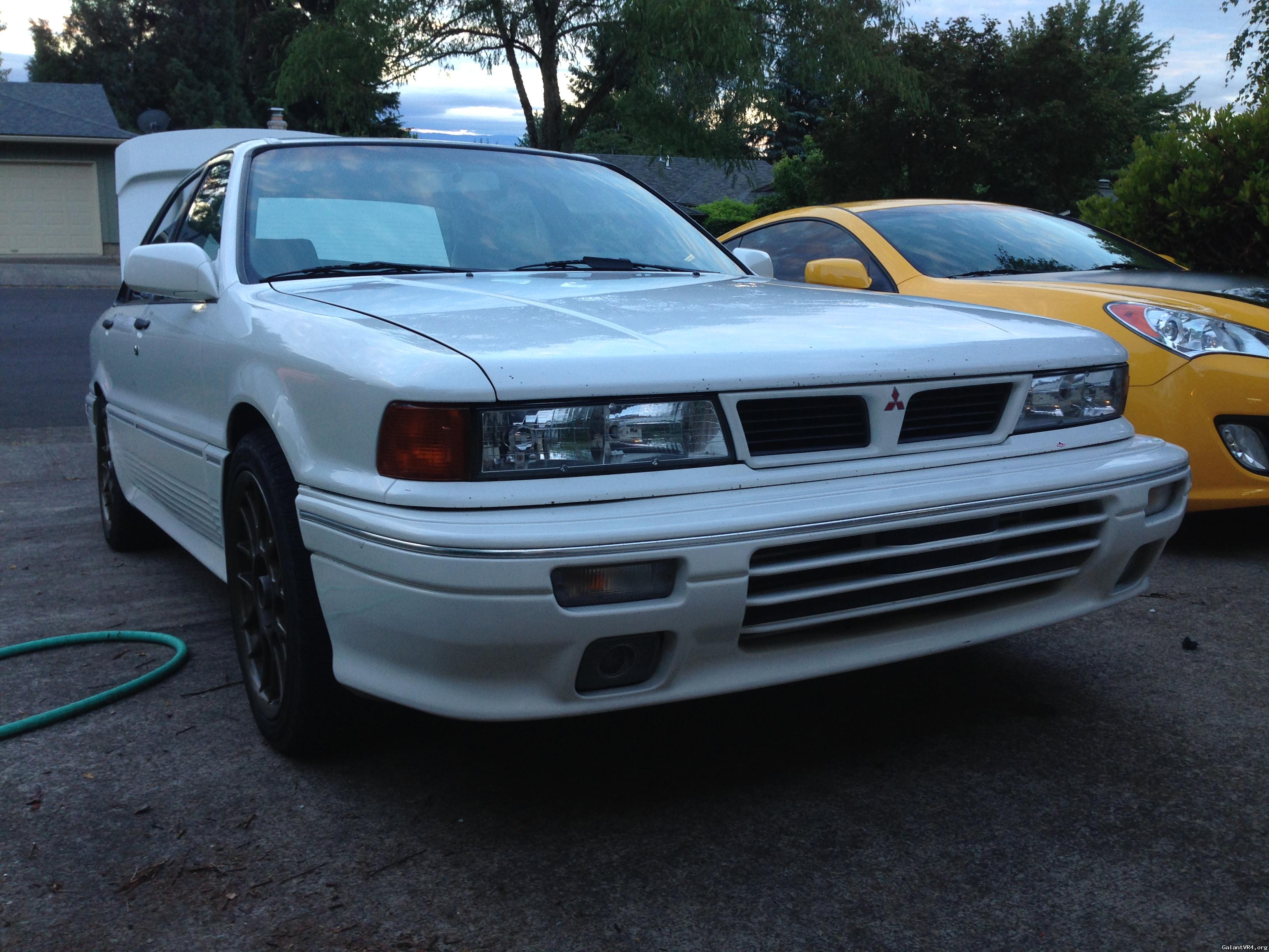

So that brand new set of BCs that just sold...yeah I bought them. I don't mind the GCs but I am excited to have true Coilovers. Also, since I broke an axle a few weeks ago (since replaced) I decided that a 4 bolt was in order. Got the diff, cleaned it up and just need to install it...this weekend perhaps? I also got my 93 headlights and amber corners installed. I am very happy with how the car is coming together. I wish I knew how to tune because that is the one thing that is holding me back right now. I just have a very basic street tune on her right now. Either way, here are some pics!
Took her top off to clean and paint
Painted and back together
New lights

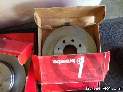

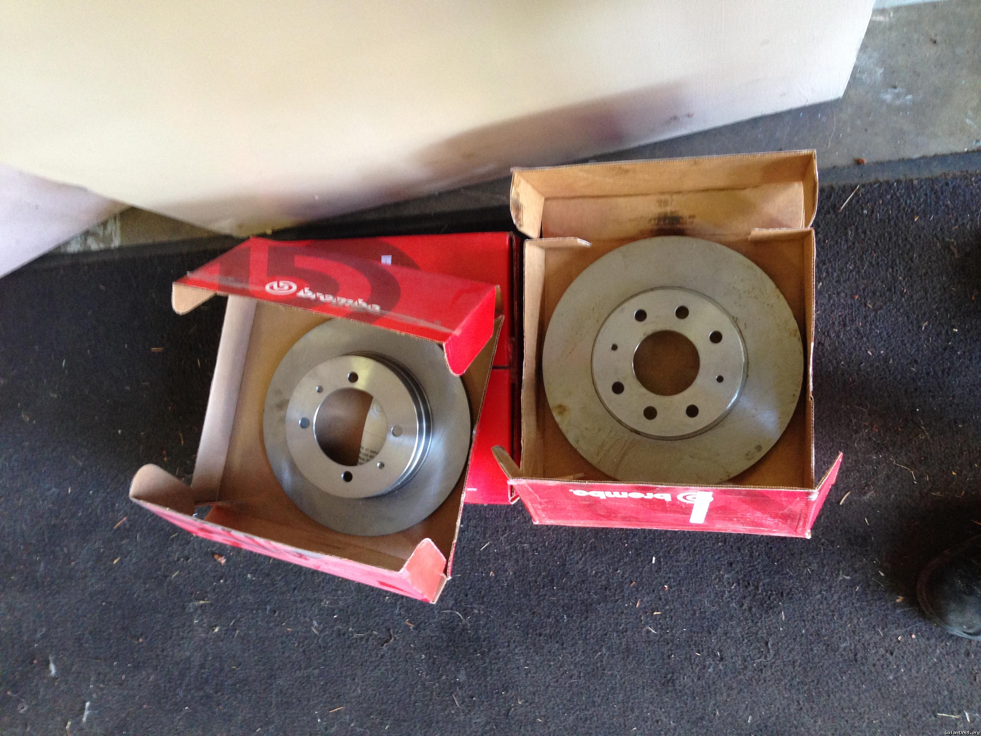

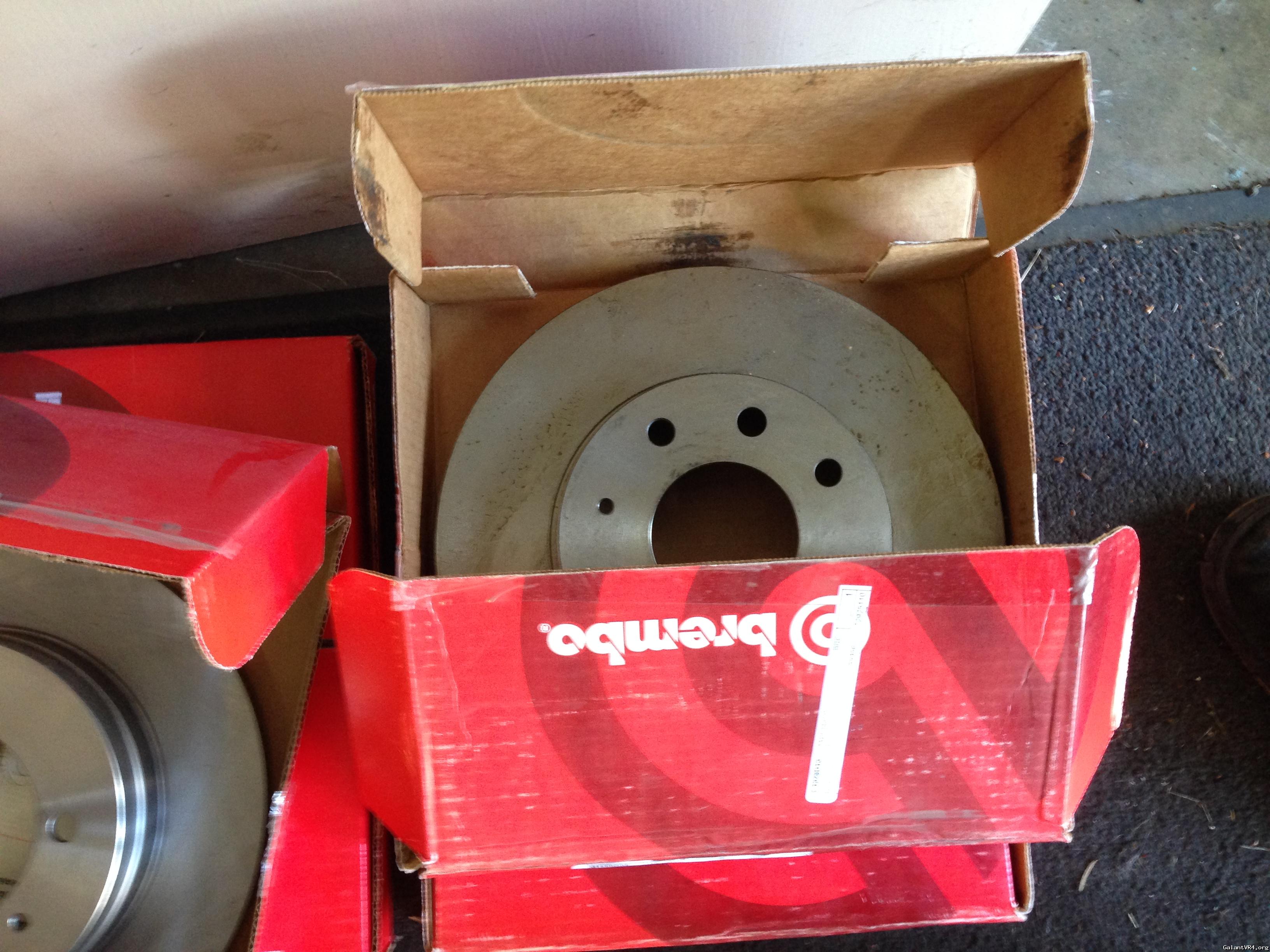

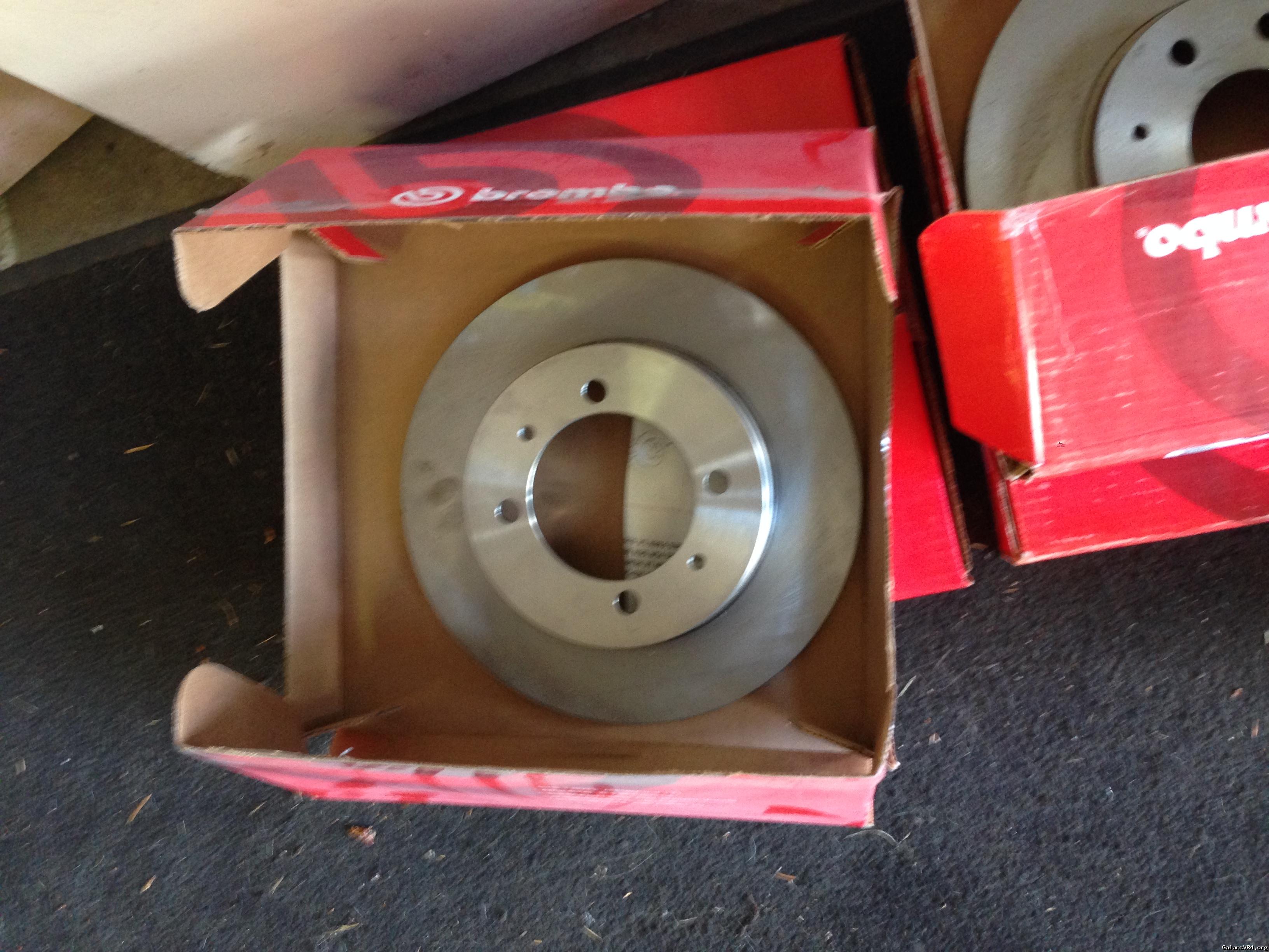

Parts are arriving hehehe, looks like all my being poor for the last 2 weeks will finally pay off. New brakes on all four corners. Brembo OEM replacements and EBC Yellowstuff to go with the stainless lines.

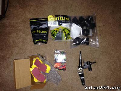

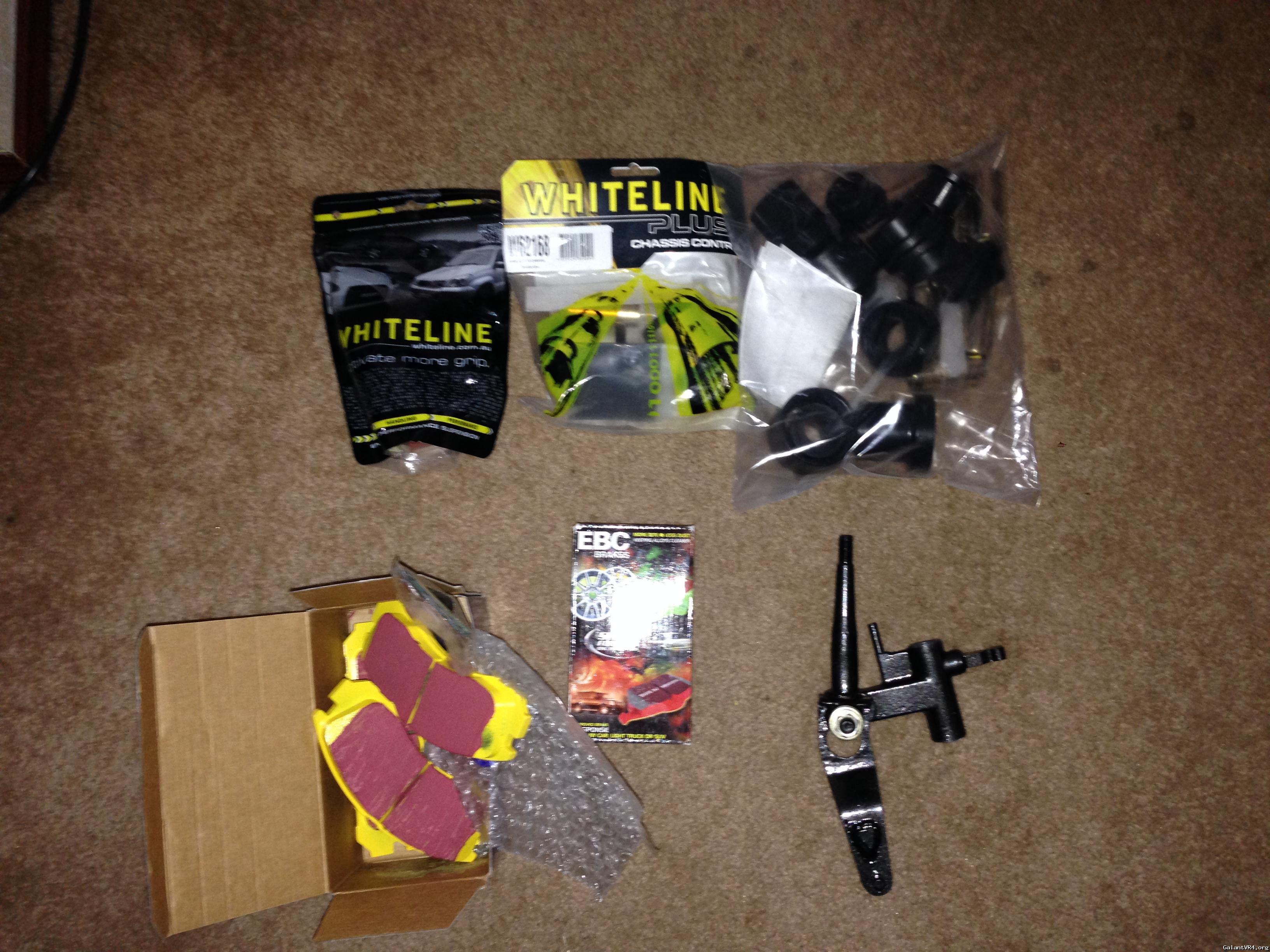

Just got home to a bunch more parts!
EBC Yellowstuff pads
Energy Rear Control arm bushings
Whiteline Rear Sway links
Whiteline Rear Stub Axle Bushings
EH Motorsports Short Shifter

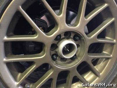

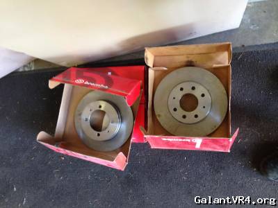

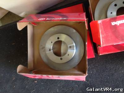

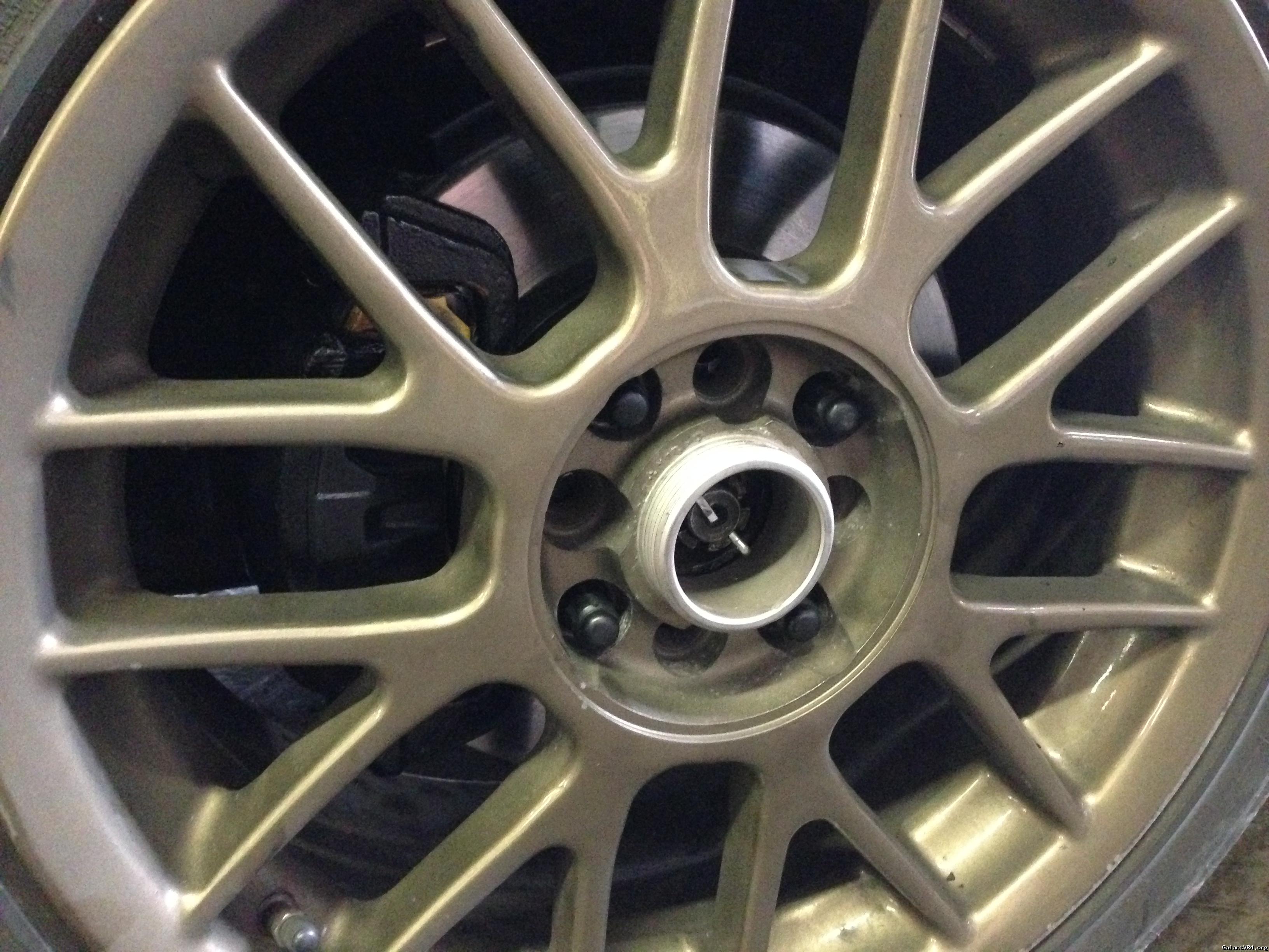

Installed Brembo Rotors and EBC yellowstuff pads. Definite Improvement over stock, but overall I am not super impressed. I think I need to splurge on a bigger brake package...Maybe Wilwoods on all four corners is in my future...
New pics today after work.
