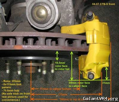

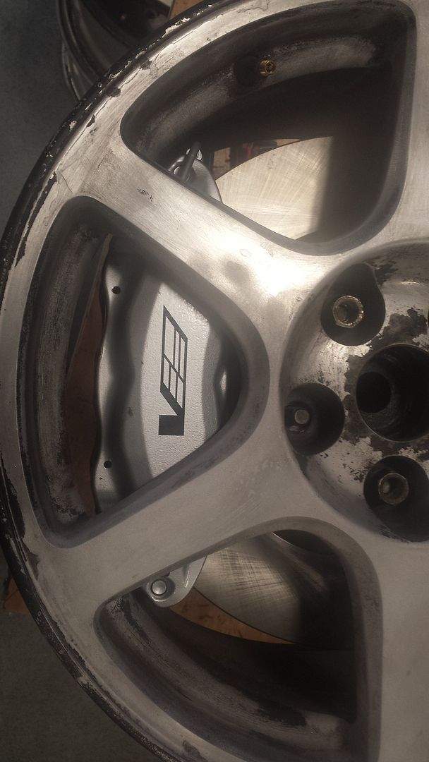

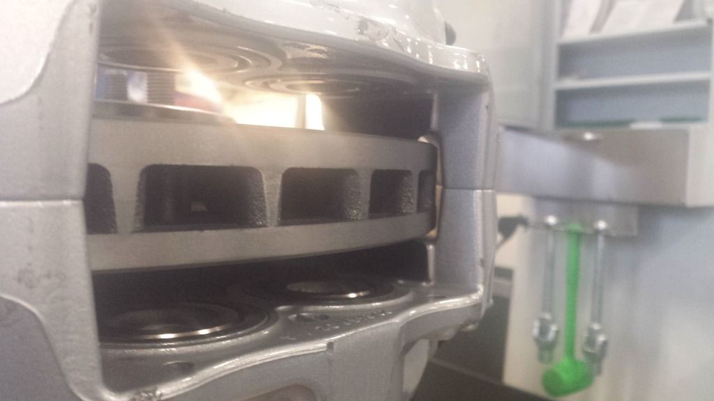

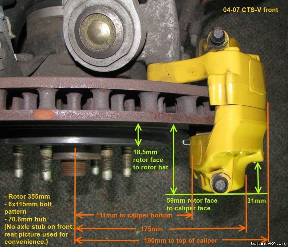

I should have taken a picture of it last night. They caliper didn't quite bolt on it was like .03 to .04 of interference on the inside of the caliper. I will just chuck it up in the lathe and take some off the outside and it will fit. I am just waiting to get paid tomorrow so I can pick up a pair. It looks kinda of awesome it so much stuffed inside a 17" wheel. Look into it and all you see is rotor and caliper.

Any updates? I'm gonna try some cobra rotors and see how far off they are from fitting

I was able to cut the rotors last night and get the proper offset for the rotor.I had to cut the OD of the rotor to 13.400 and add a 4mm (.157) between the hub and the rotor. And it fits perfect with good clearance on a EVO 8 Enkei.
TurboDSM What I would do if you go with the Cobra rotors is get some washers that will fit over the studs and stack them up until you get the proper offset. Then let me know what that offset is. I can make some spacers for the Cobra rotors. 4mm might be the magic number but I would just make sure. Like Patches said 13" will work just fine with plenty of pad contact.
It was kind hard to get a picture of the offset but it even on both sides.

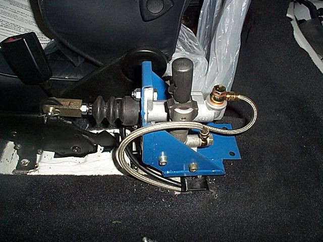

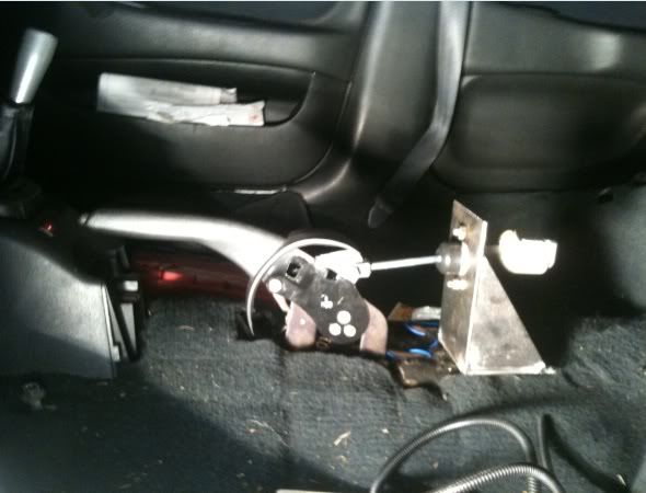

I was going to mod the stock ebrake handle/mount to a hydraulic master, so you can still lock the rear brakes like stock. Eliminates the shitty cable setup. I know it's "not legal" but when you get inspected all they care about is when the hand brake is applied the car doesn't move. I just need to find some brembo's for the rear and I'll probably go ahead with it.
Here's some pic's of what I am talking about.

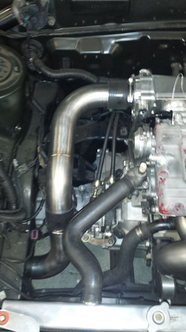

Our Fabricator Finished up a crash beam for me this weekend and also the rest of my intercooler piping. Got the bumper cover on which I have not seen a about 4 years

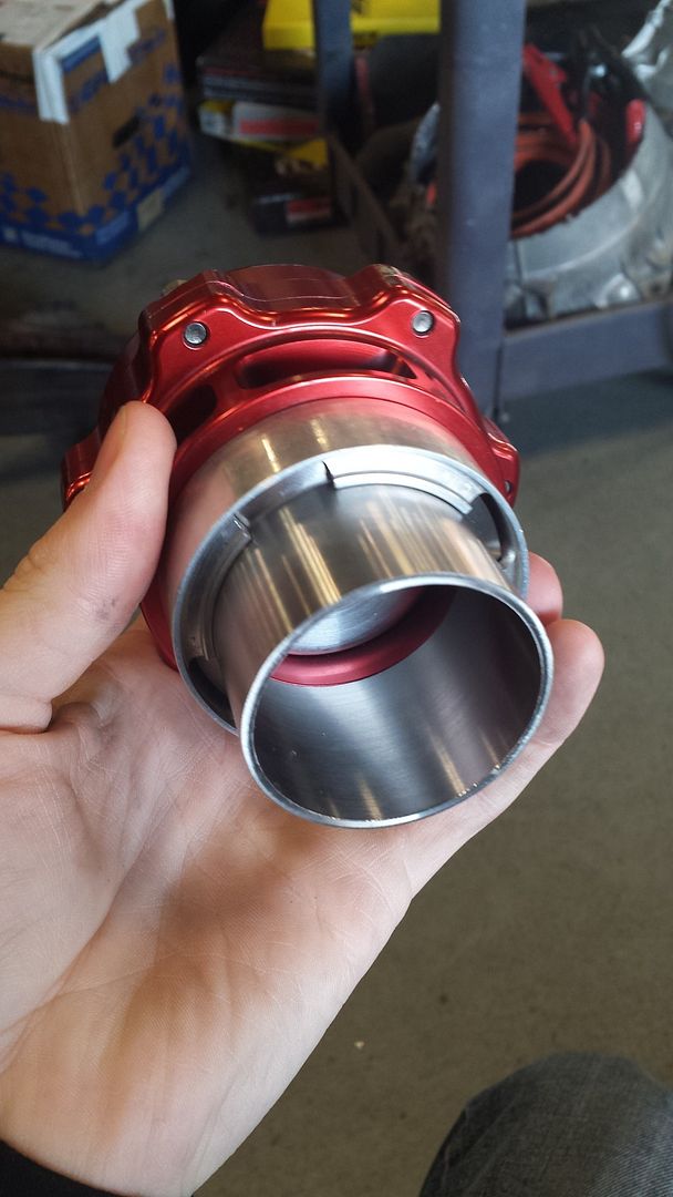

I didn't feel like waiting for a BOV flange so I ended up making one.

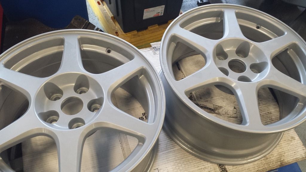

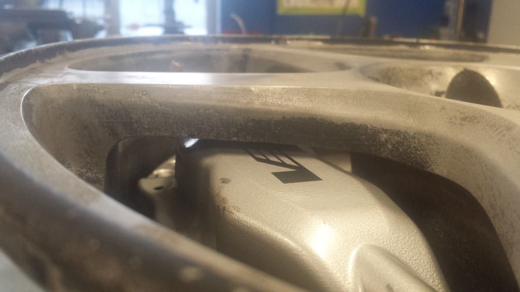

Anyone on here have a sticker cutter that can cut me the Enkei logo for these wheels? The Dimension are 3/4" x 3" long. I don't need them to be the 2 tone color all black would be fine.
