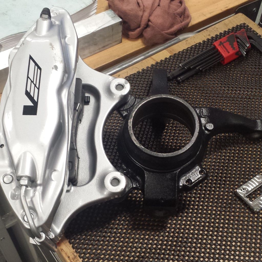

OE Evo 8/9 rotors. I put the wheel bearings and seals in last night. I did some measurements off of a stock Evo 8/9 hub and knuckle and right now it looks like im going to need a .07 spacer between the rotor and hub but i am going to get a set of rotors and confirm this. I also checked clearance between the caliper and Evo 8 enkeis and it looks like it will have no problem clearing.

Quoting jeverts:
So am I interpreting this picture correctly? The mount spacing of the caliper is identical to a GVR4/1g knuckle spacing?
