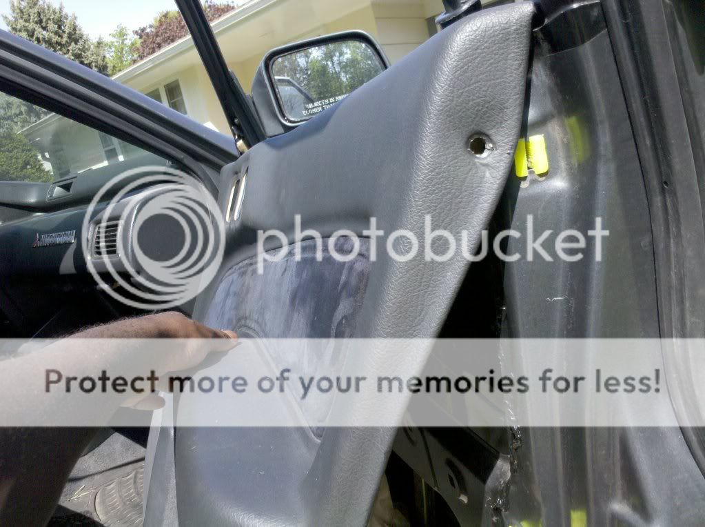

In the process of replacing this. I'm having problems removing the door panel without breaking anything. It's almost of but something along the silver strip/trim by the window is keep it secure. I felt like ripping it out but I'm gonna need to reuse it. What am I doing wrong?
jepherz
Aug 8, 2004
7,878
KC, Missouri
It helps to push the top of the panel outwards, towards the glass. Sometimes you have to jar it up from the bottom pretty hard.
Muskrat
Jun 13, 2004
2,107
Lexington, KY
A socket extension or large screw driver going through the handle hole and tapping with a hammer helps me. Just be careful.
