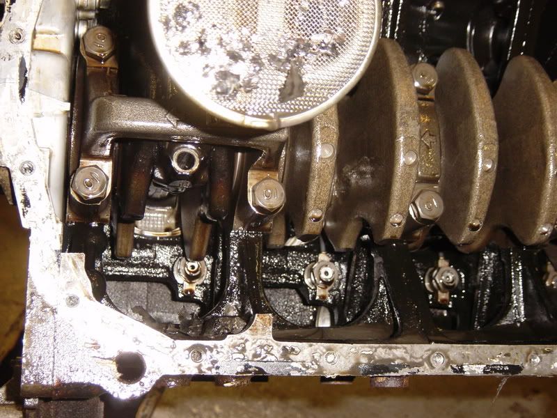

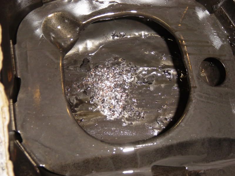

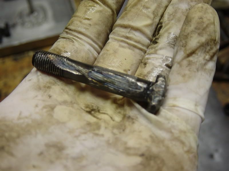

So as it has been mentioned in a couple of the road racing threads that I spun a bearing at NHIS on 7/7/07.

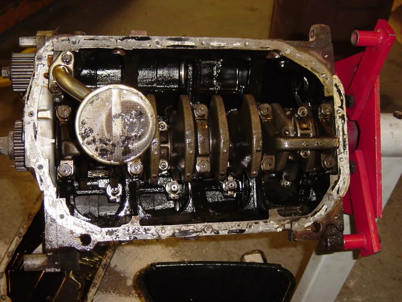

I pulled the motor yesterday, and just got through pulling most of the motor apart just now. I havent pulled the crank out yet, but Ive got the head off and the oil pan off.
Carnage pics:

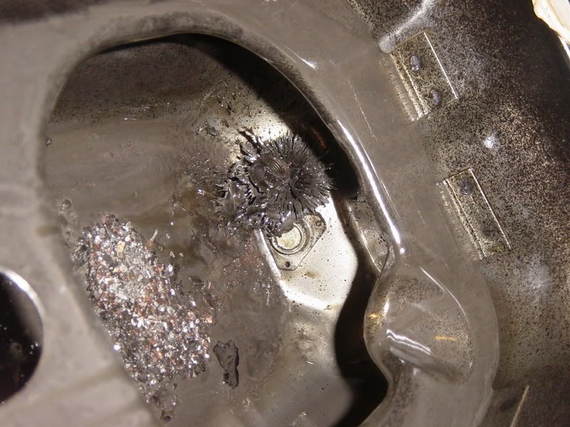

Some nice bearing material all over the oil pick up.
A nice little pile of gold. Gee, dont I feel lucky.
There is a really strong magnet right next to the oil drain. This explains why there wasnt more metallic substance in the oil when I drained it. If you look closely you can see a nut in that pile.
But where did it come from? And where is the bolt?

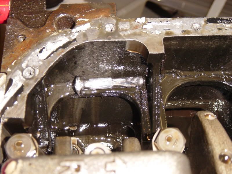

There's the bolt! It appears one of the conrod bolts came loose, and somehow un-splined itself from the rod.

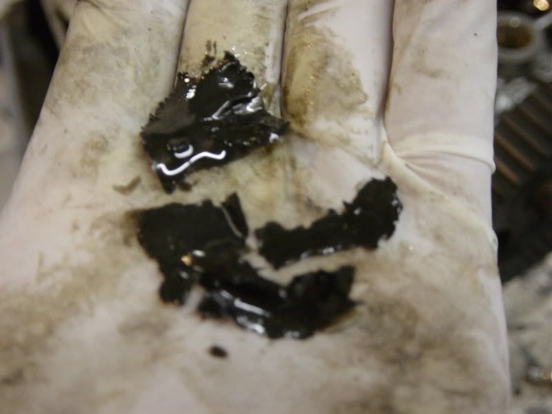

Some nice little oily cornflakes.

Doh /ubbthreads/images/graemlins/blush.gif The car didn't sound so hot after this initially happened, but Nick was still able to drive it up on to the trailer for the ride home. Bummer dude. Good luck with the repair. Time to start whoring yourself out in Boston so that you can afford to properly build up that bottom end /ubbthreads/images/graemlins/grin.gif

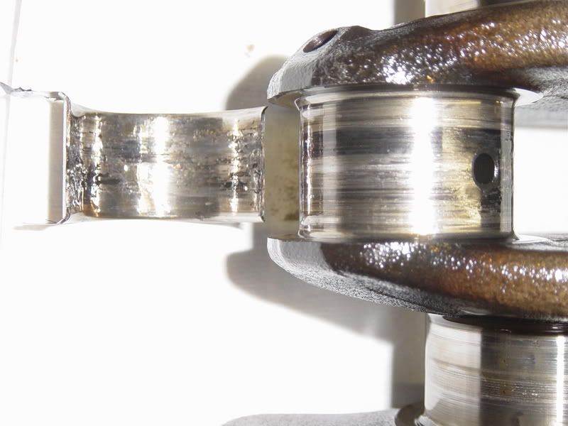

After I got the crank out I discovered the true damage.

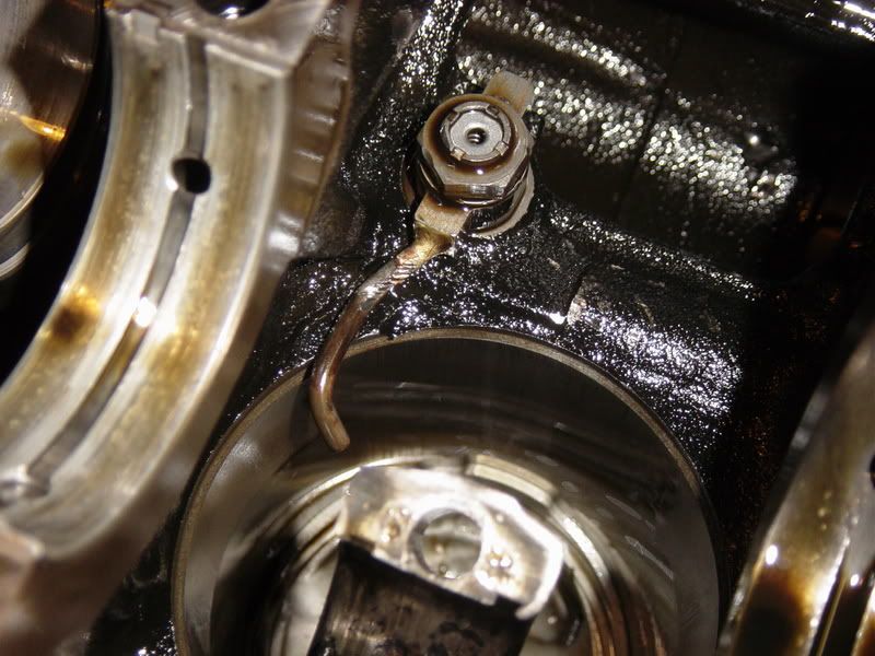

The conrod bolt hit the oil squiter a efw times.

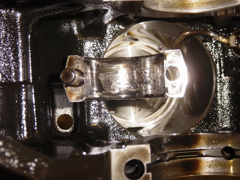

Cyl 1 rod, minus one bolt

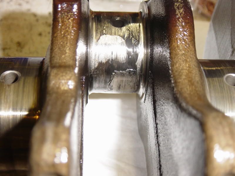

Cyl 1 rod journal

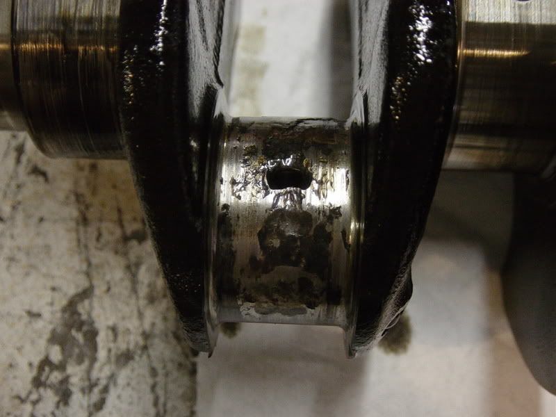

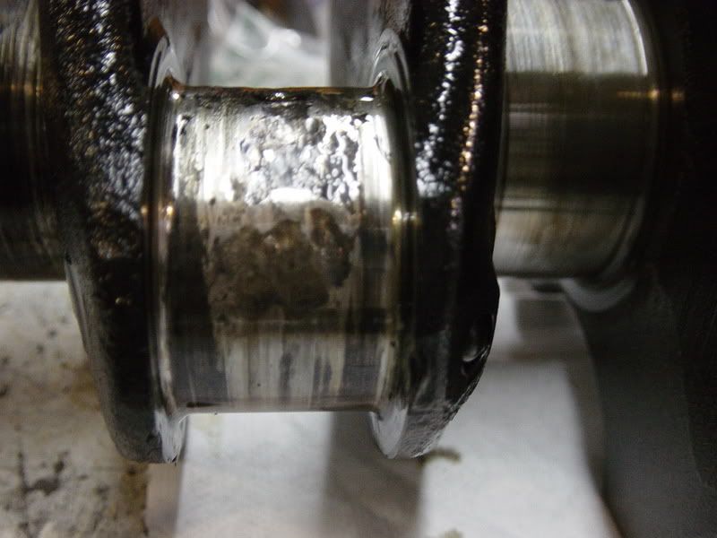

Cyl 3 showed some damage too.
There is a little bit of scoring on the front main area, Im going to take the block to the machine shop today and see if it can be salvaged.
Thanks for editing my most Minjin.
Unfortunately I cant afford a stroker kit right now. But luckily for me Alex had another crank for me to use. I dropped the block off at the machine shop earlier to day and hopefully I'll get the good news that it can be salvaged. (There was some scoring done to the 1st main cap too). My Arias pistons and Scat rods should be in the mail right now, and a bunch of my mitsu oem parts arrived today. (IE, oil pump, oil filter housing, etc.)
Hopefully I can have her race ready by 8/20, the next event.
