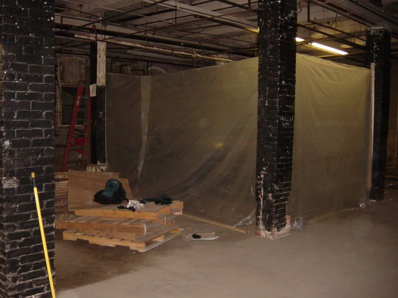

I have another little update about my project GVR4. As promised way back in november and december I had decided to give the car a facelift. The multi-colored rainbow that was, is no longer.

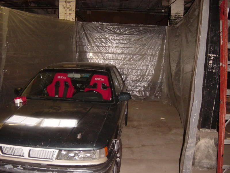

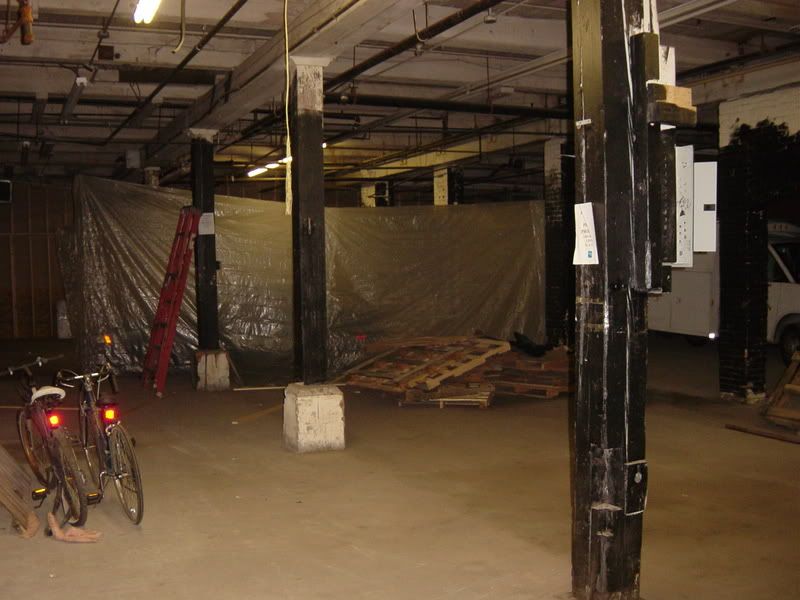

I setup a make-shift paint booth in a warehouse that no one was renting by DSG. Its not exactly a cleanroom, but it did the trick.

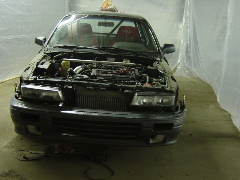

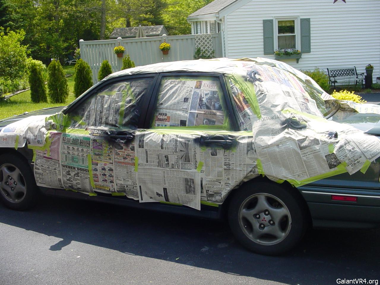

After the booth was setup I worked on dissambely, sanding and taping the entire car. It is tedious job that I dont want to do again for a long time.
Once she was fully sanded and prepped I got to work with the rattle can primer and paint.

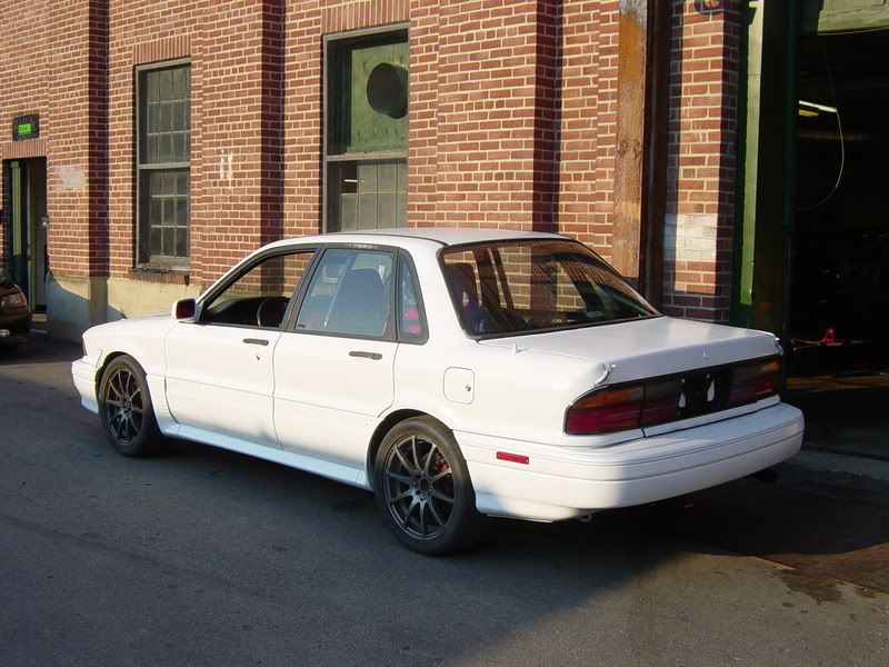

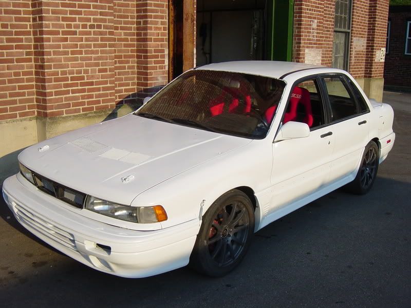

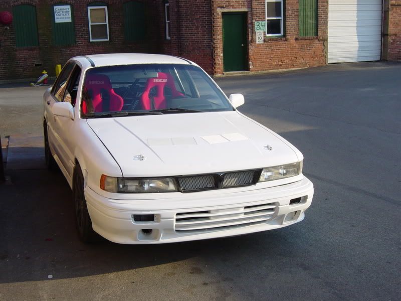

This is the final result.
If I were to do it again, I would have sanded between primer and paint. I was a bit anxious to get the white down. I am very pleased with the results though, it being all one color is a huge improvement.

to bad it's not green anymore /ubbthreads/images/graemlins/frown.gif looks good though!
~Brian

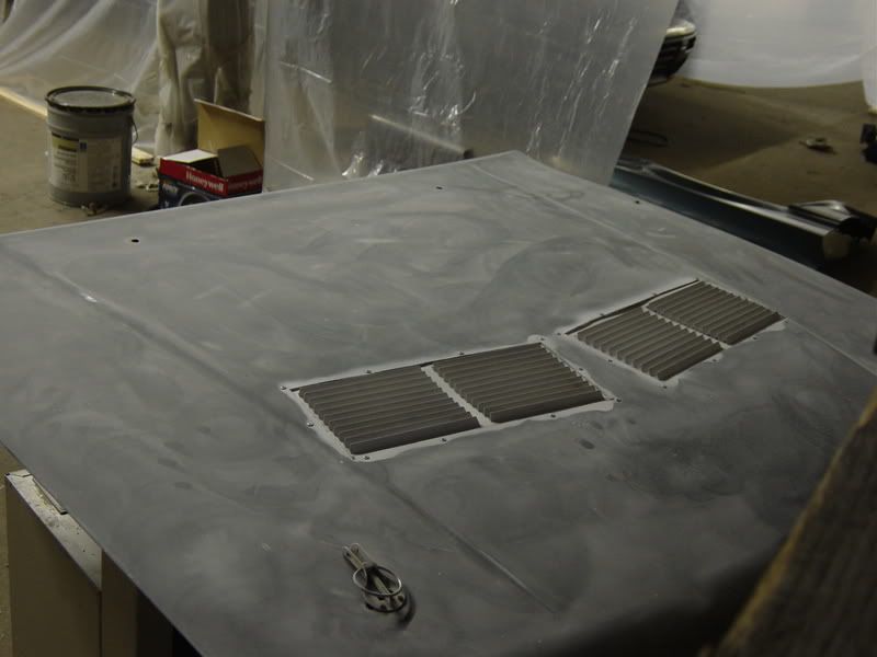

Are those actually air registers in your hood? /ubbthreads/images/graemlins/uhh.gif
/ubbthreads/images/graemlins/applause.gif looking great, man.

Looks good Nick. I like the hood vents. Did you hit all the door jams too?
I painted with the doors closed. So the door jams are still green. I dont really care though. I'd rather be driving the car than using all my time to make the paint look perfect. I need to start prepping the car for NHIS anyway.

I'm sorry. I know you must be partial to green. The green looks great on car with matching body panels. Mine was not one of those. And now it matches the rest of the DSG race cars. Im in the club!!
Why yes. . . Yes they are. And they vent a ton of air, especially with the fan on. Best $10 Ive spent on the car so far.
Future plans include painting the door trims. But as I had mentioned before, the car was sitting in the warehouse for too long. I needed to finish the paint so I can begin to prep the car for the next event. If I were to repaint the car, like next season for instance, it will come out a lot better knowing what I know now.
