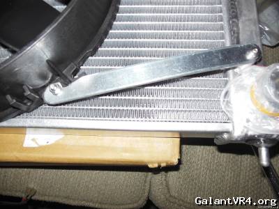

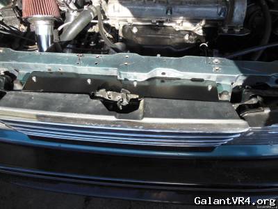

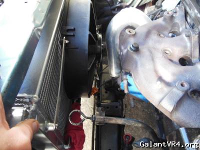

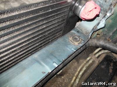

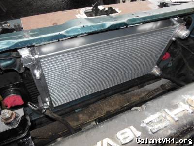

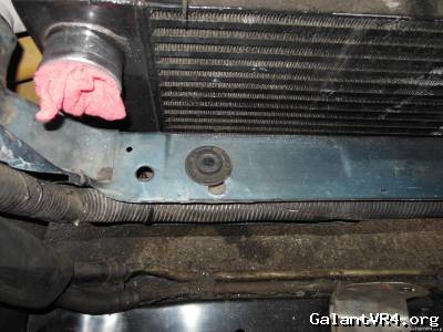

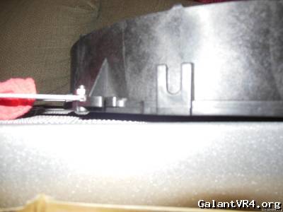

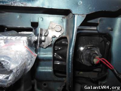

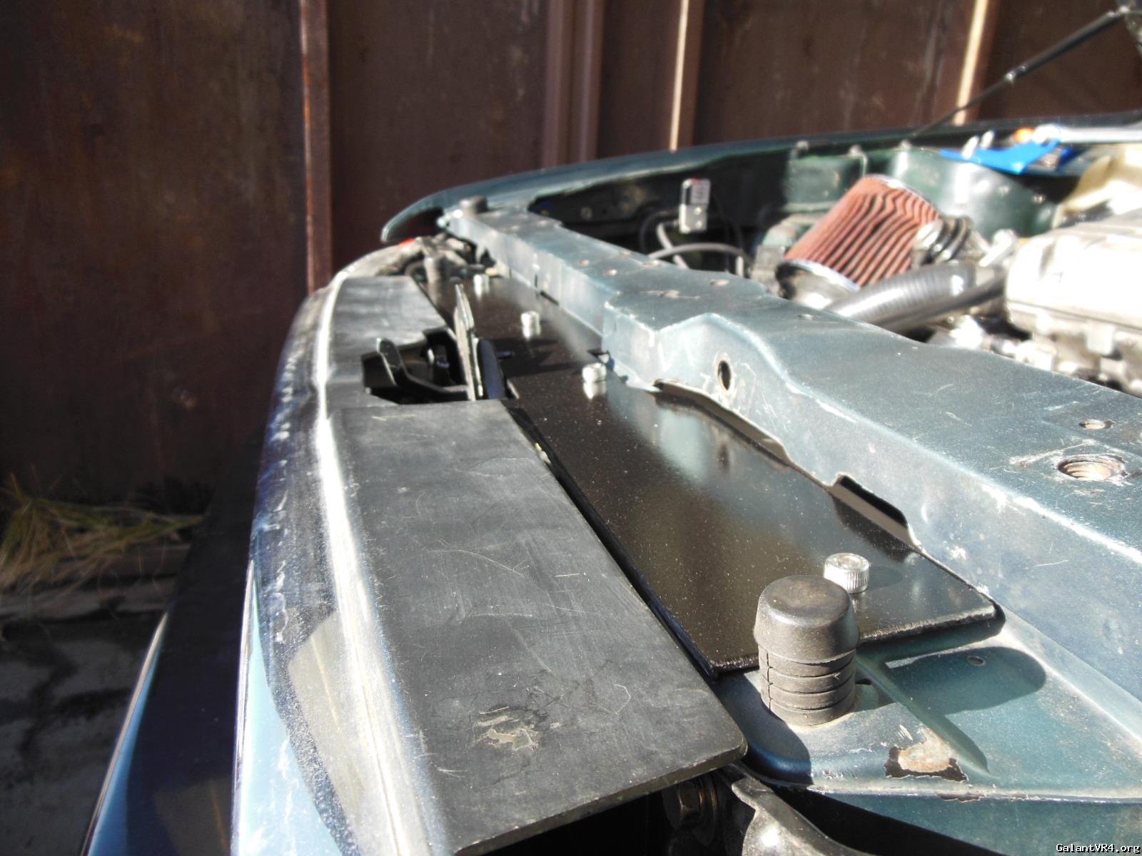

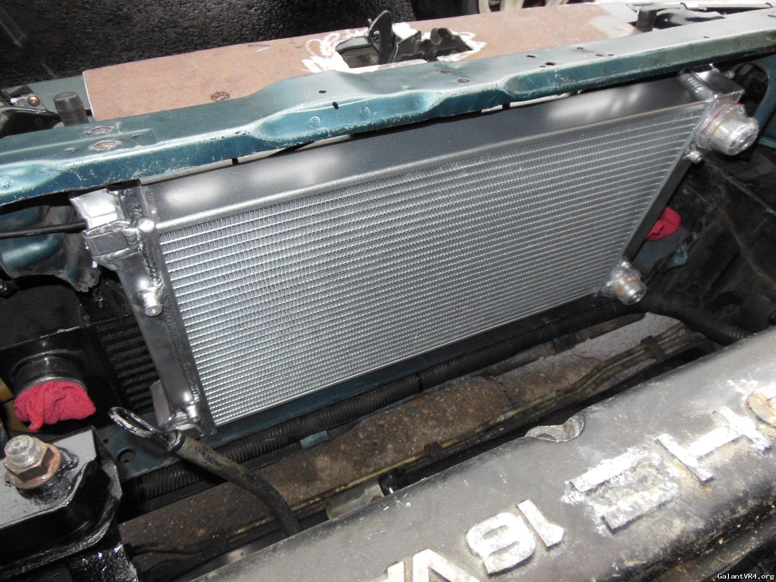

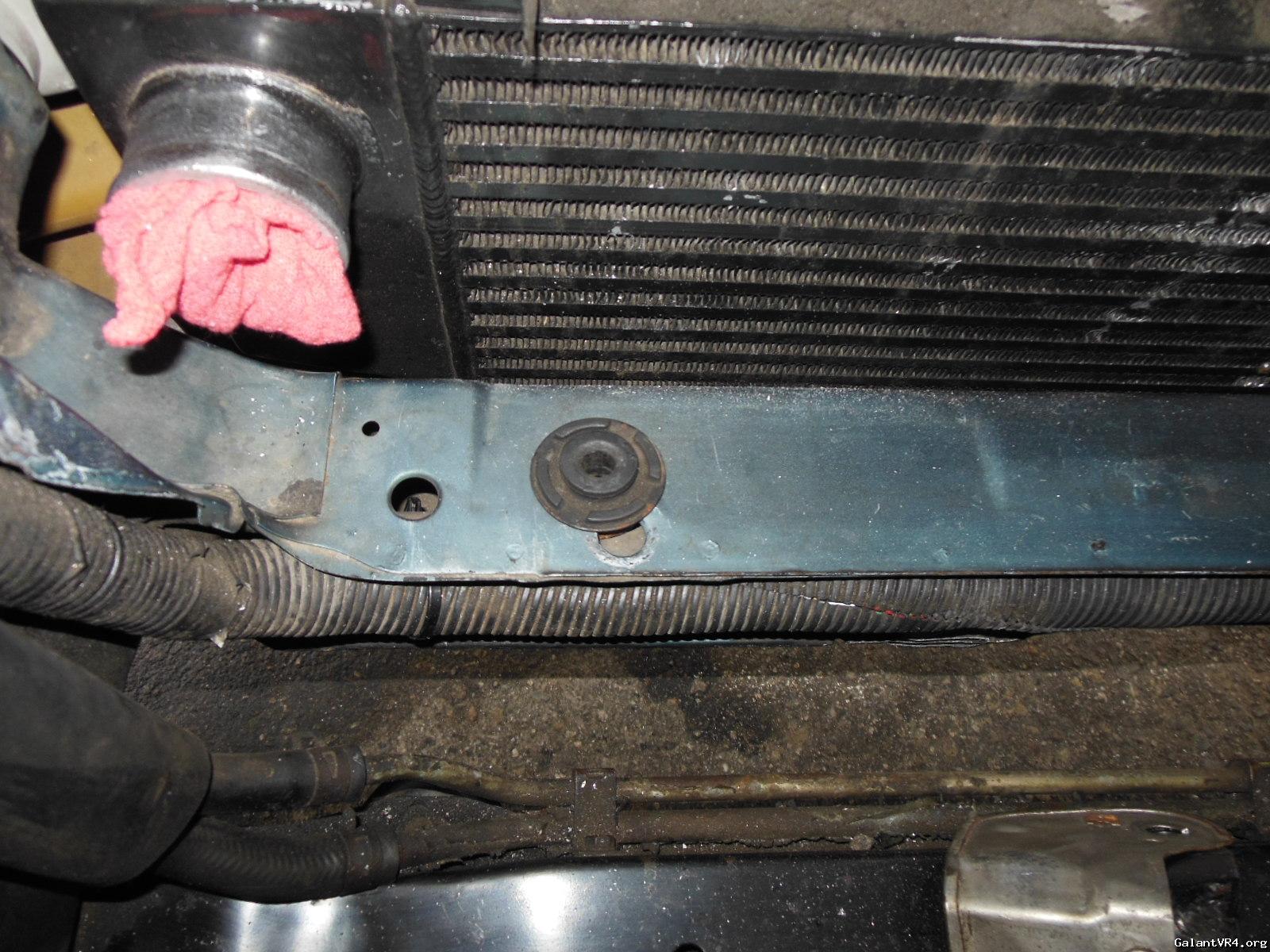

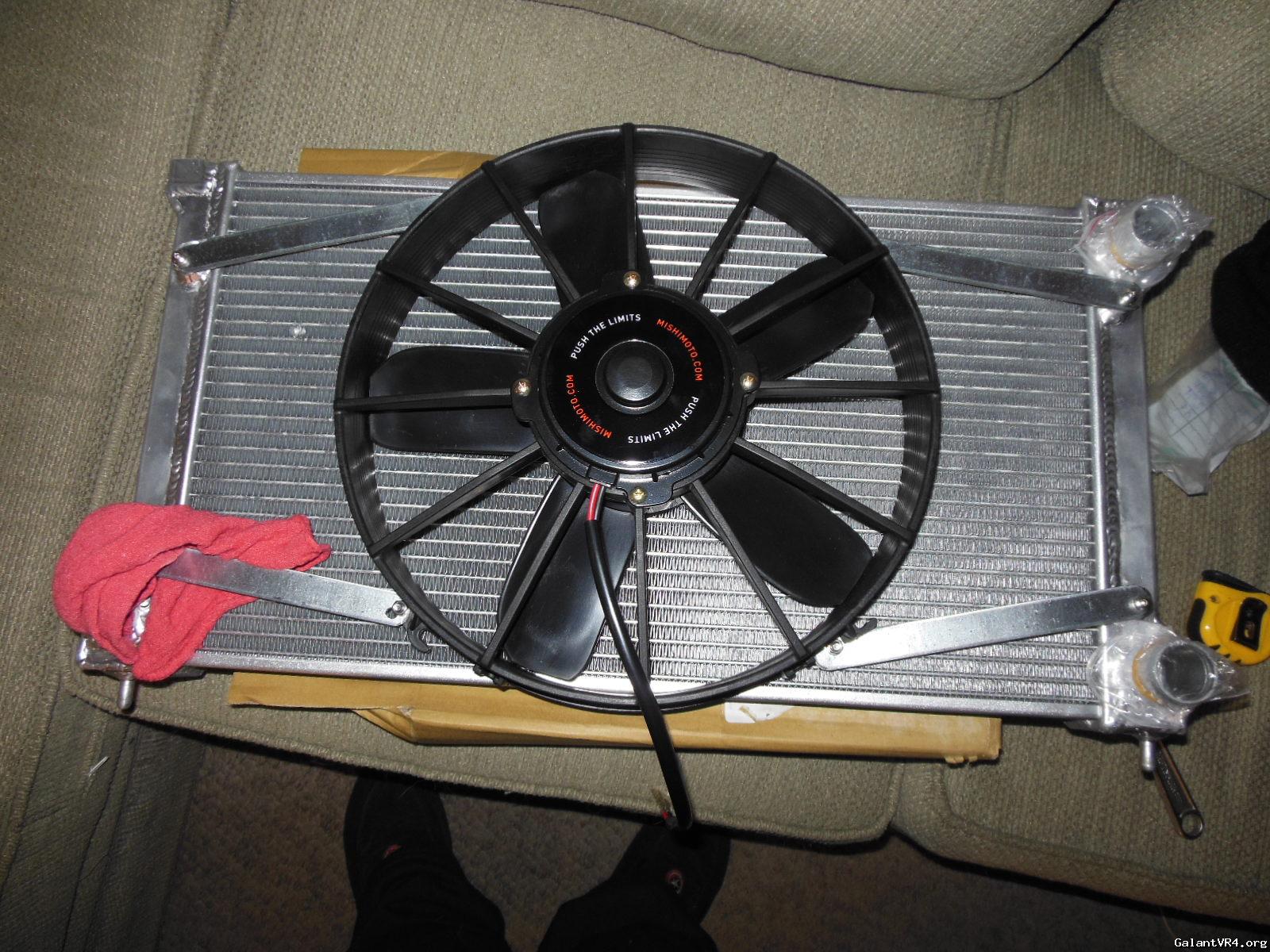

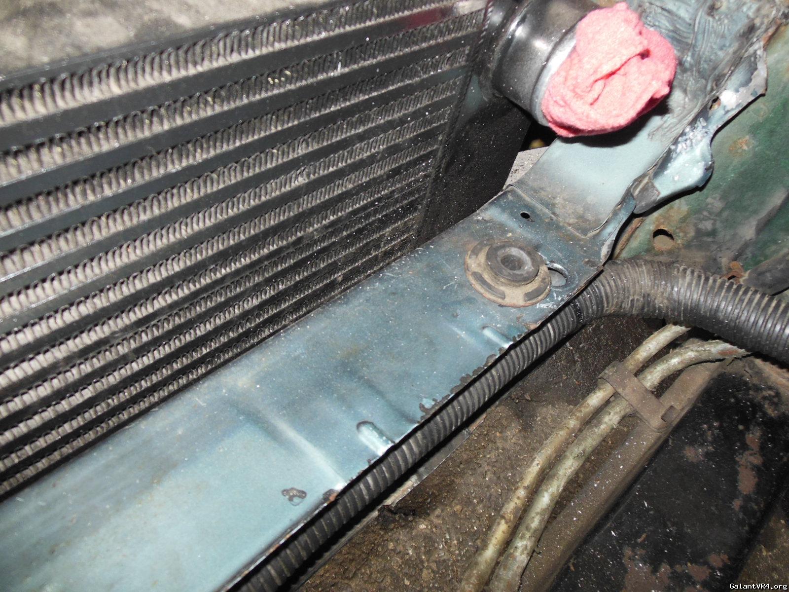

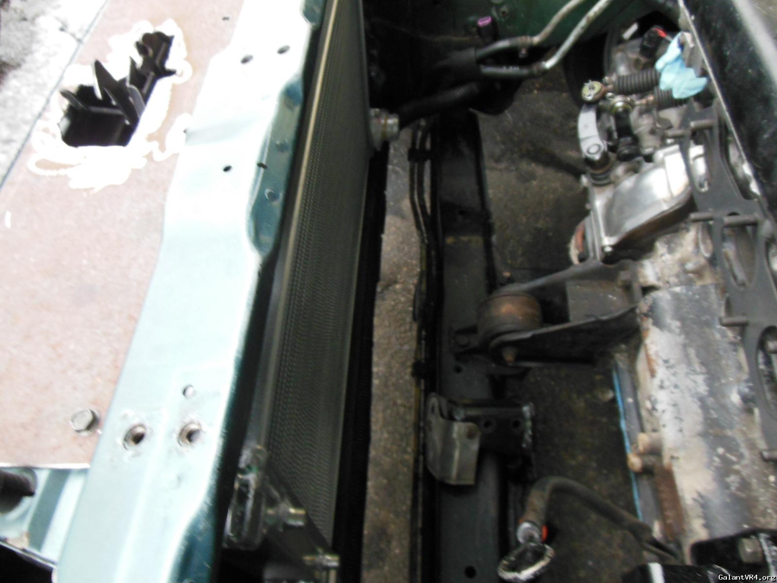

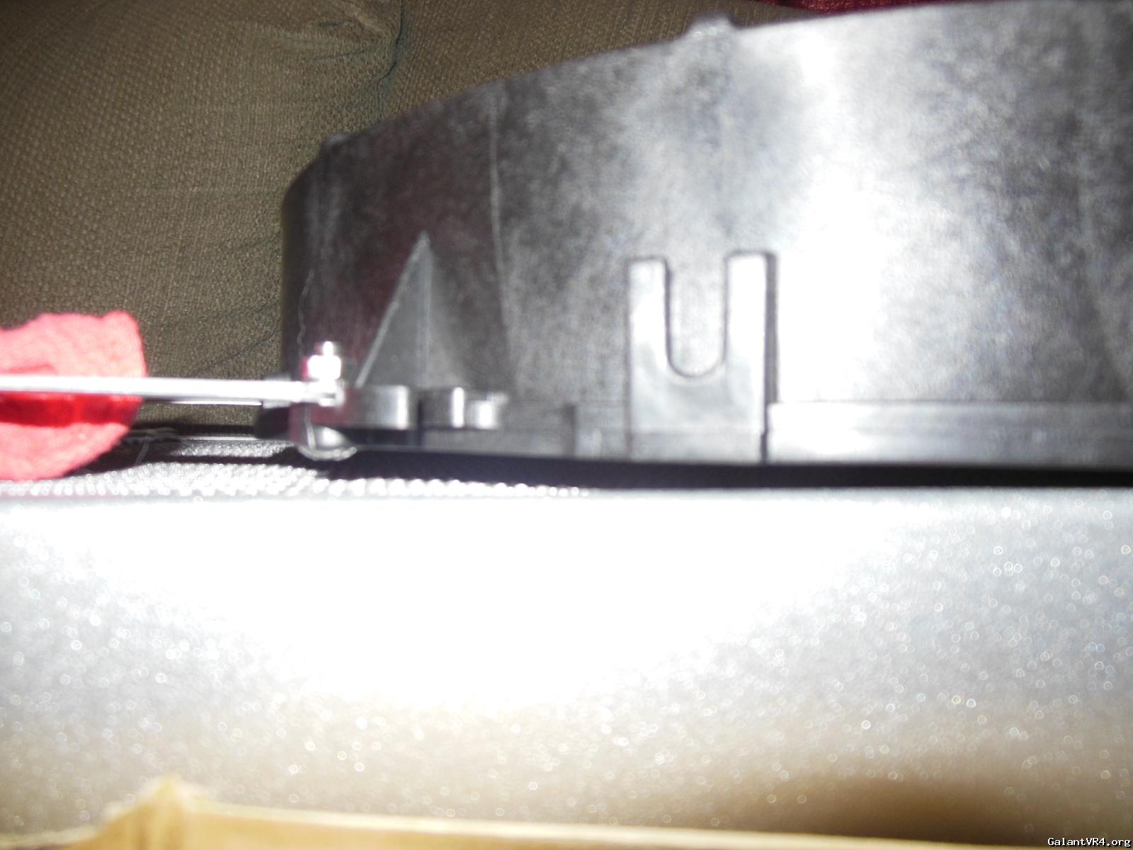

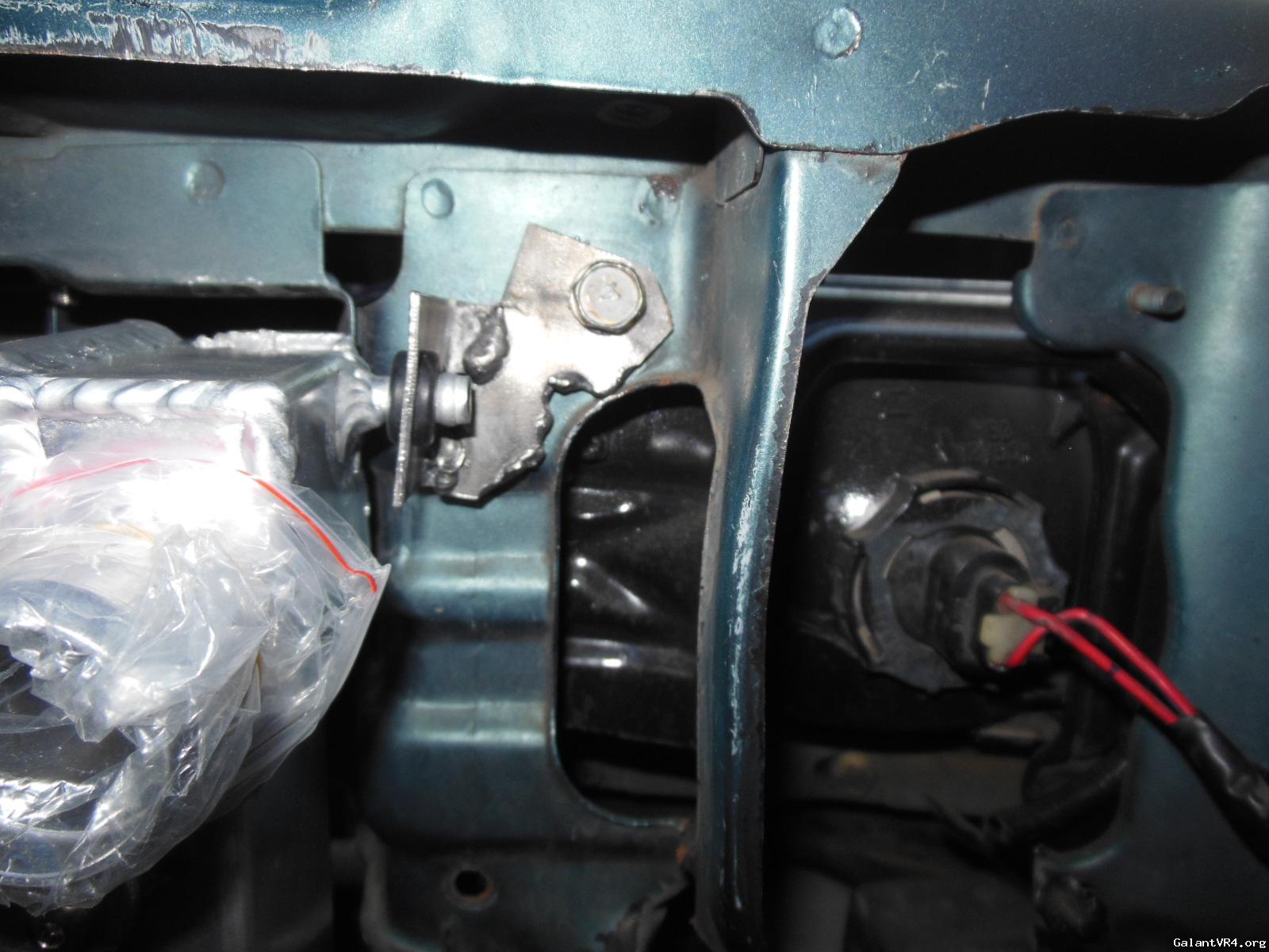

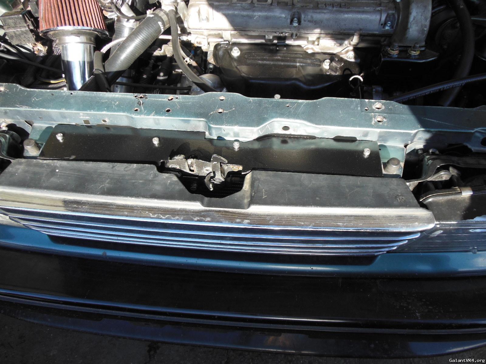

got my radiator mounted, not sure wat others have done for a bottom mounting point, but i took the stock mounts and drilled 1 3/8" holes and set them in there and it worked out pretty well. the fan should be here today and ill be going to powder coat everything sometime this week. hopefully a week or 2 and she will be on the road again.

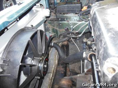

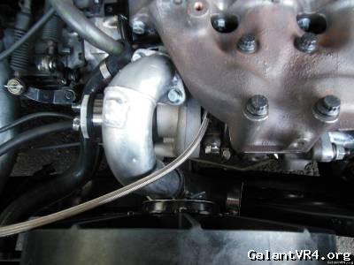

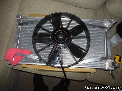

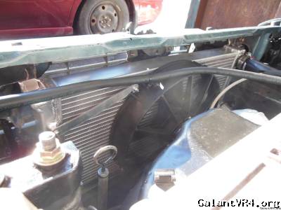

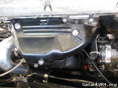

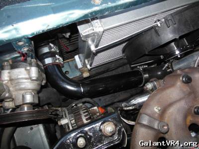

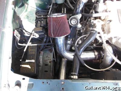

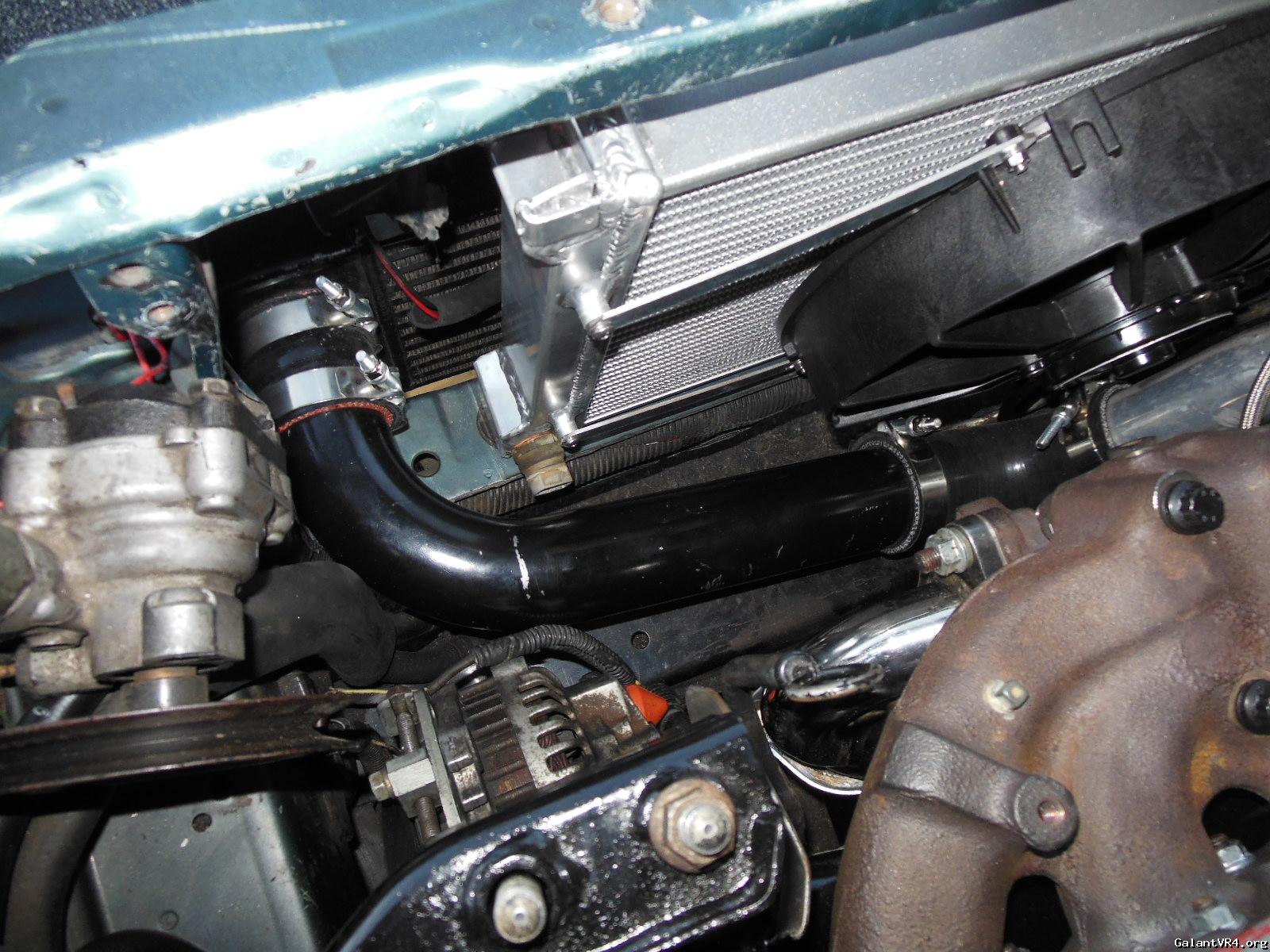

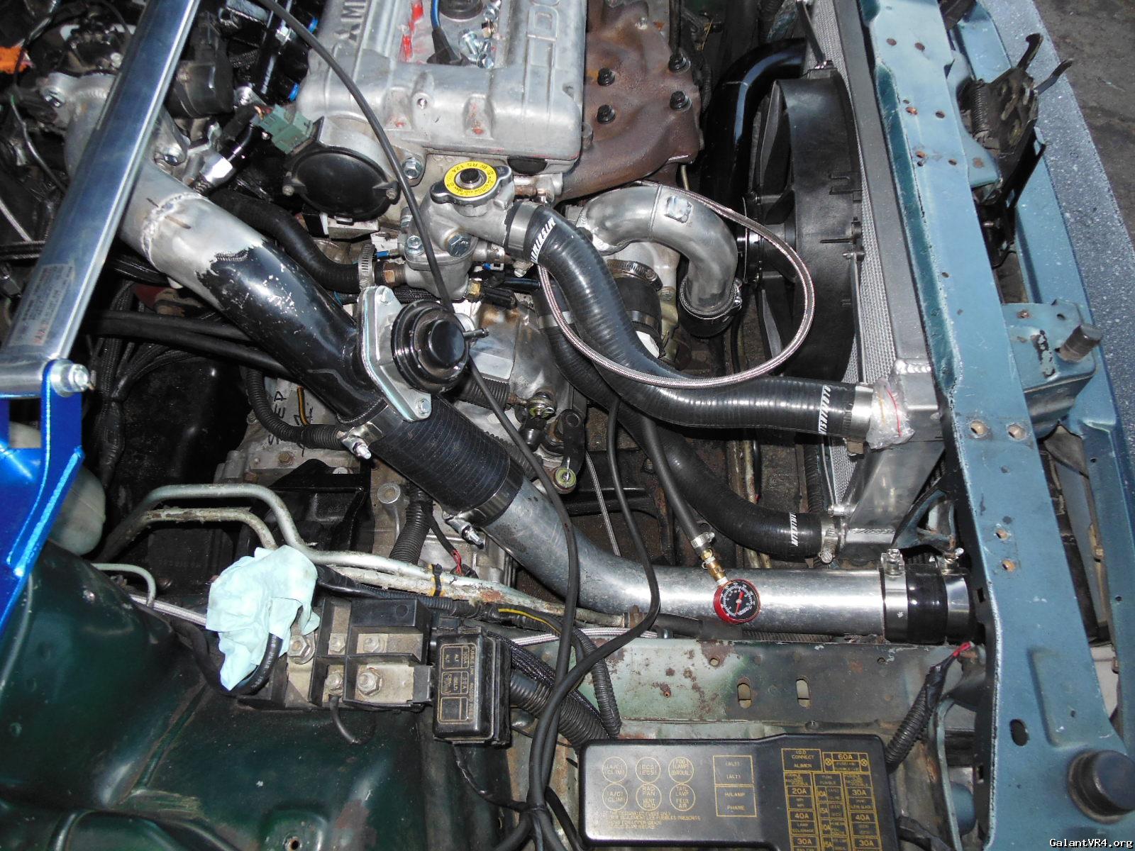

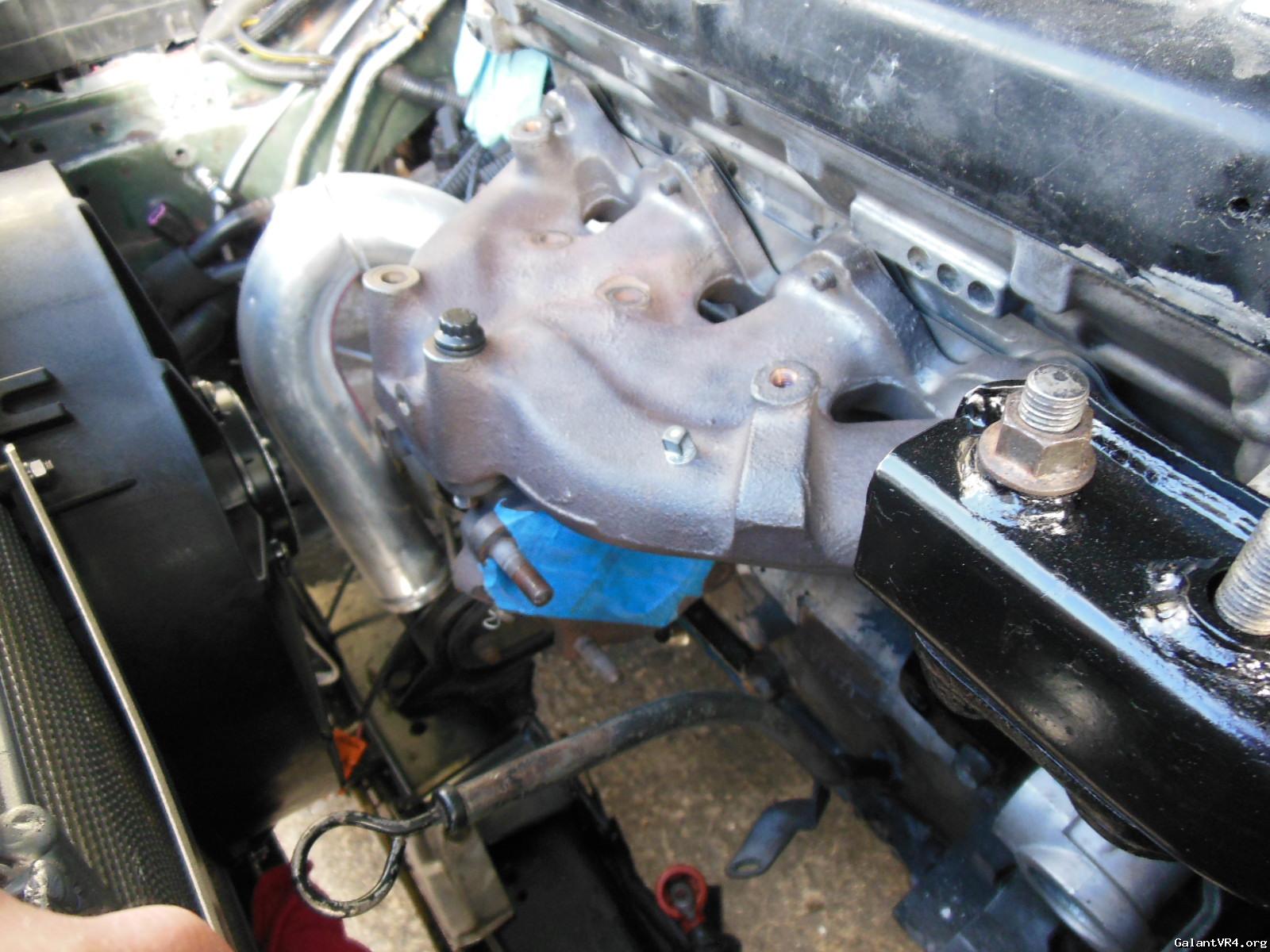

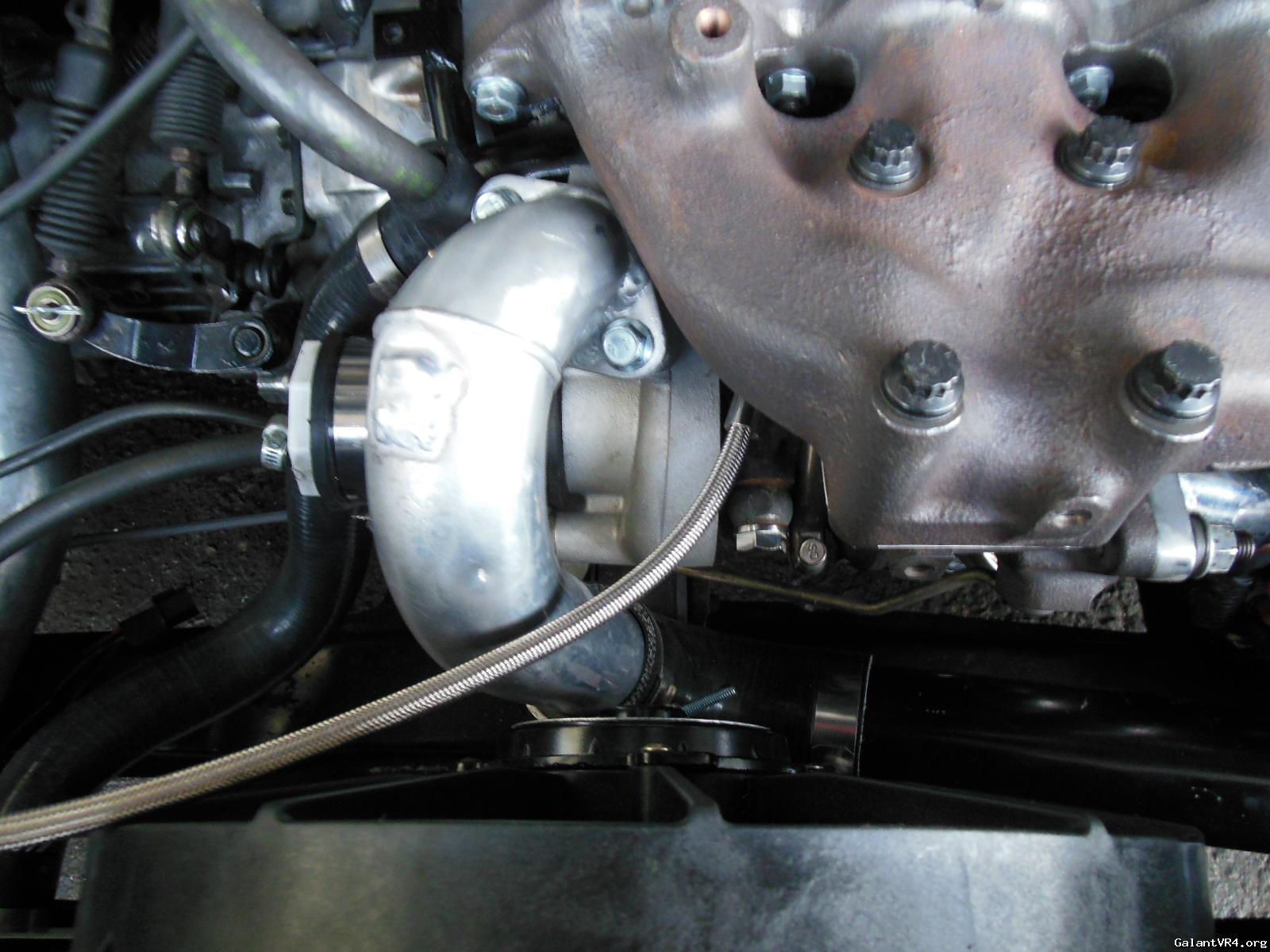

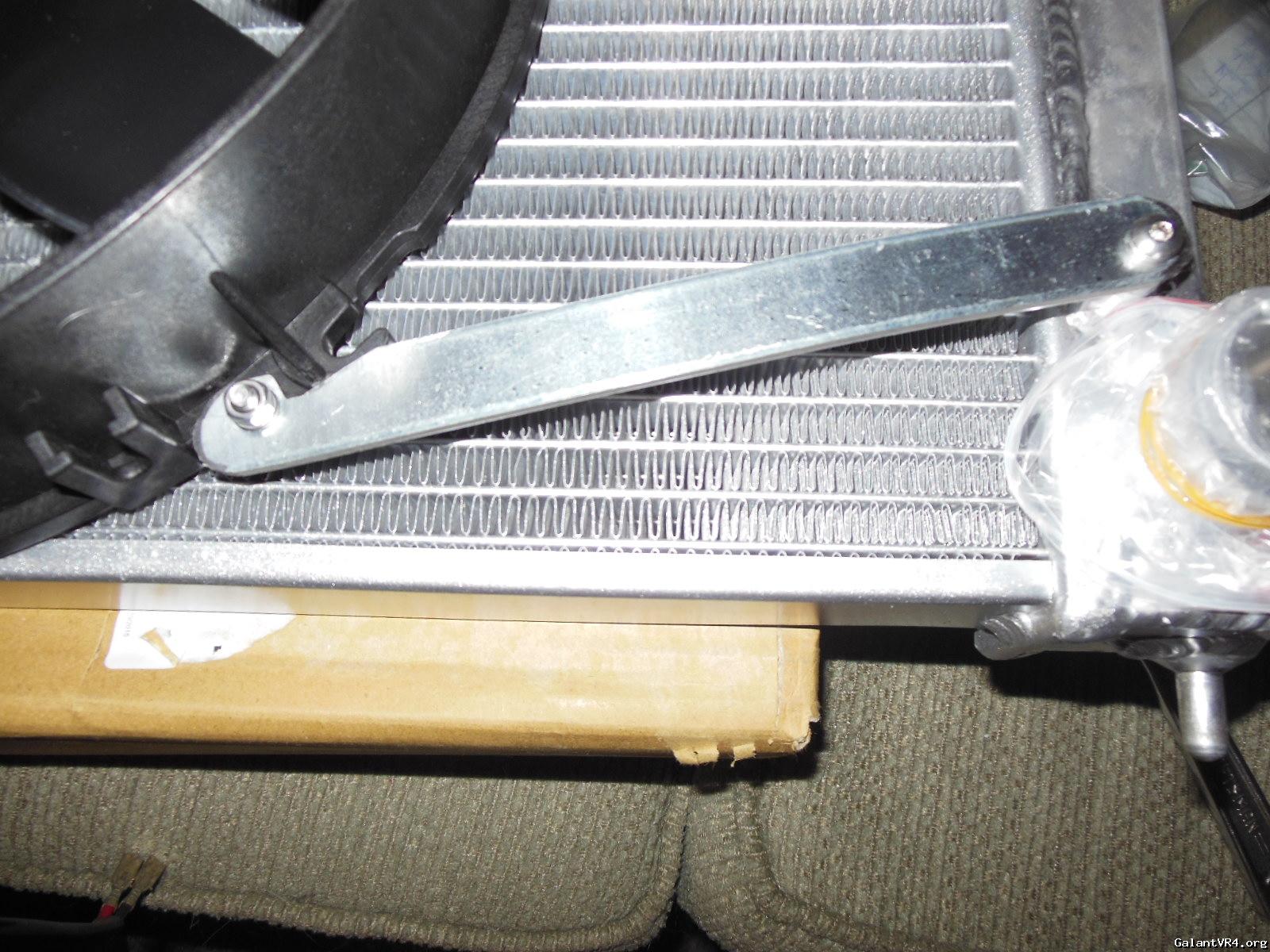

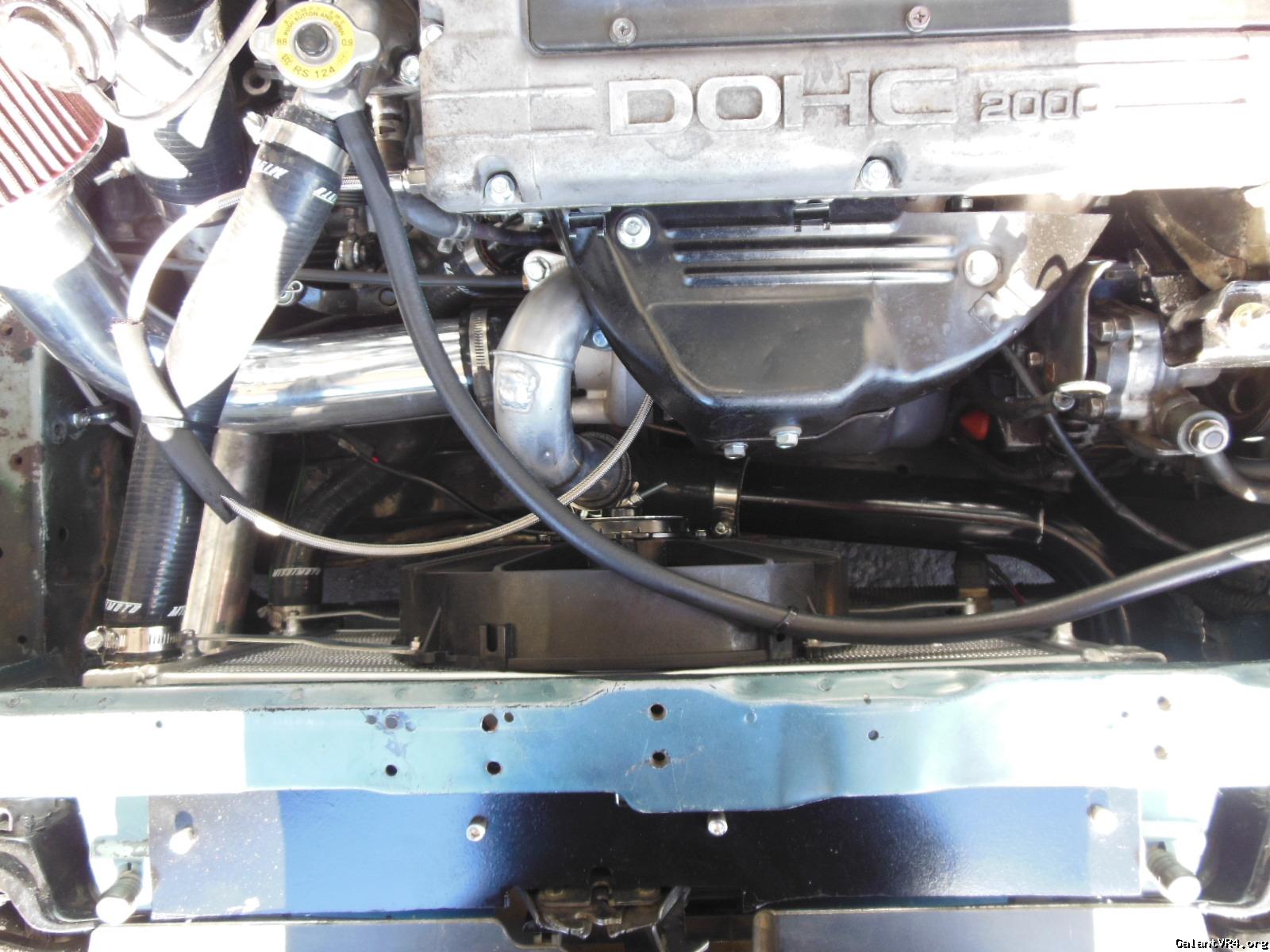

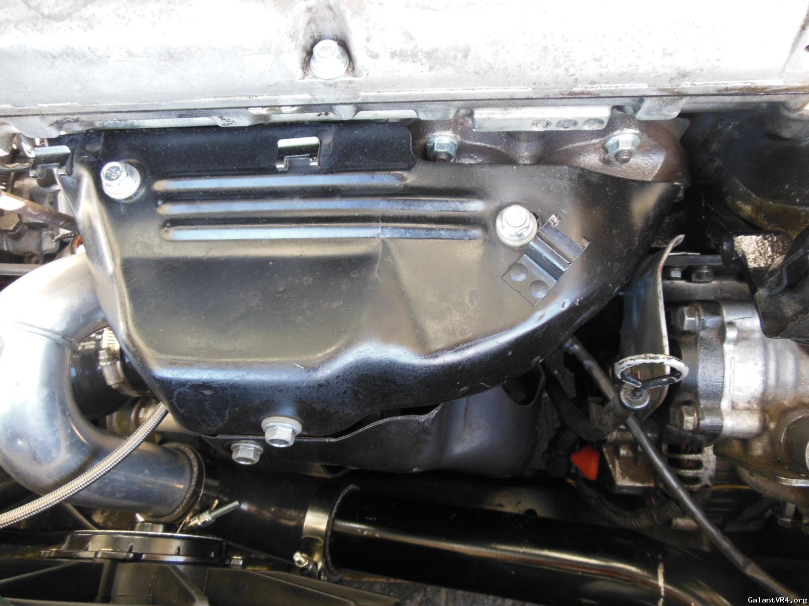

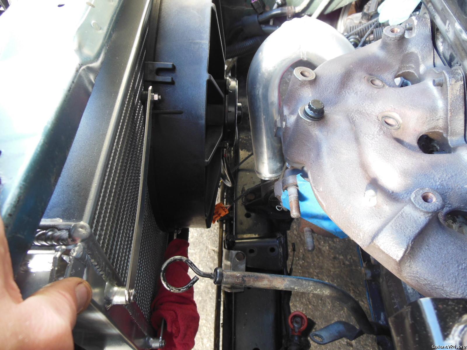

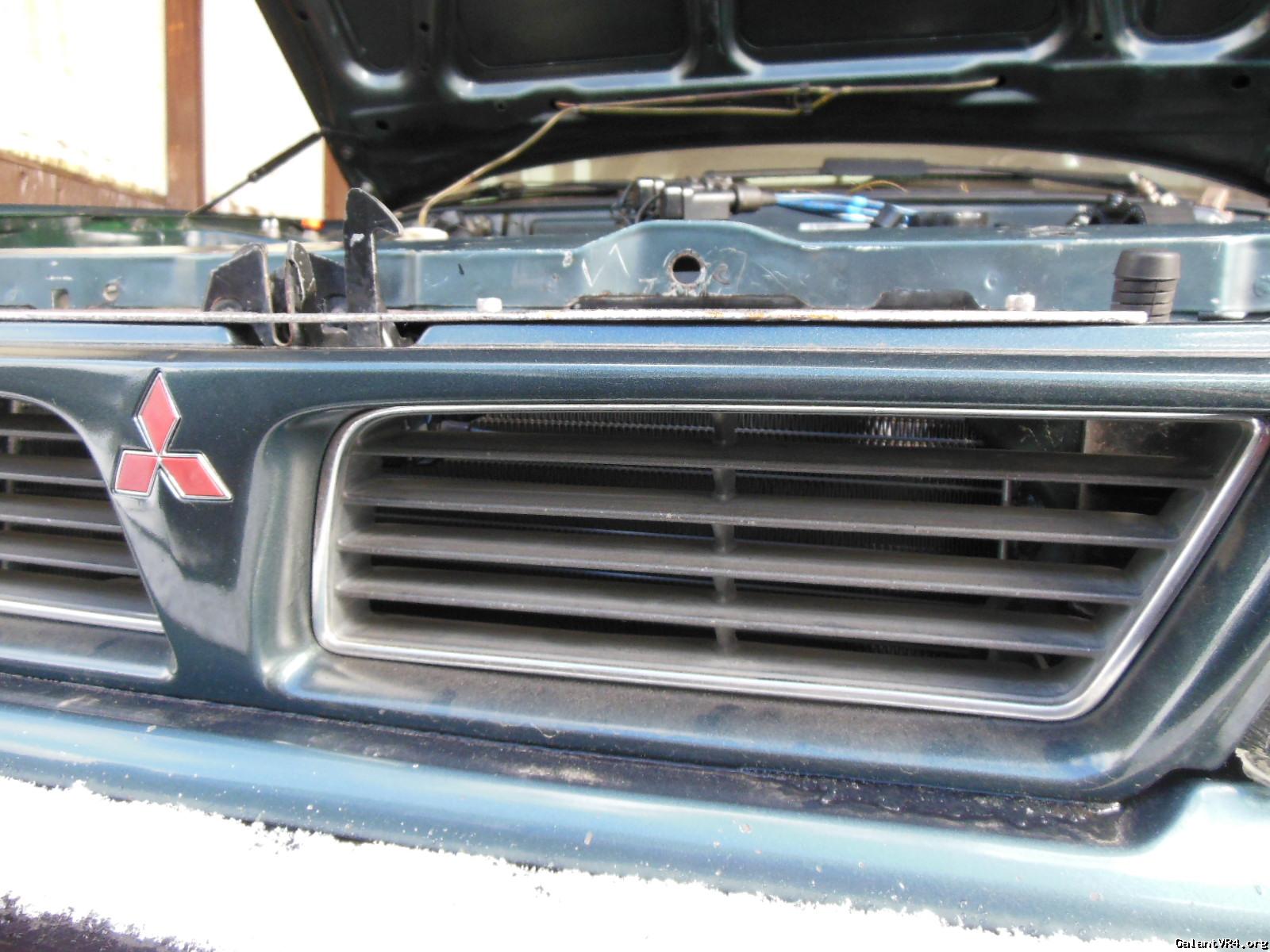

placed the rad, fans, turbo, manifold and some pipe in there and with it all loose i have a ton of room. also decided to make my own air divider for the rad. not finished but working on it.

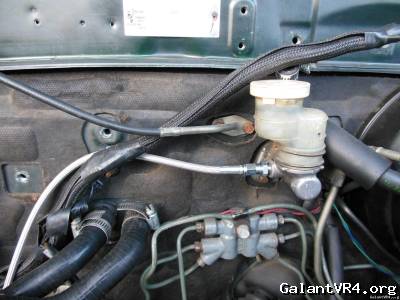

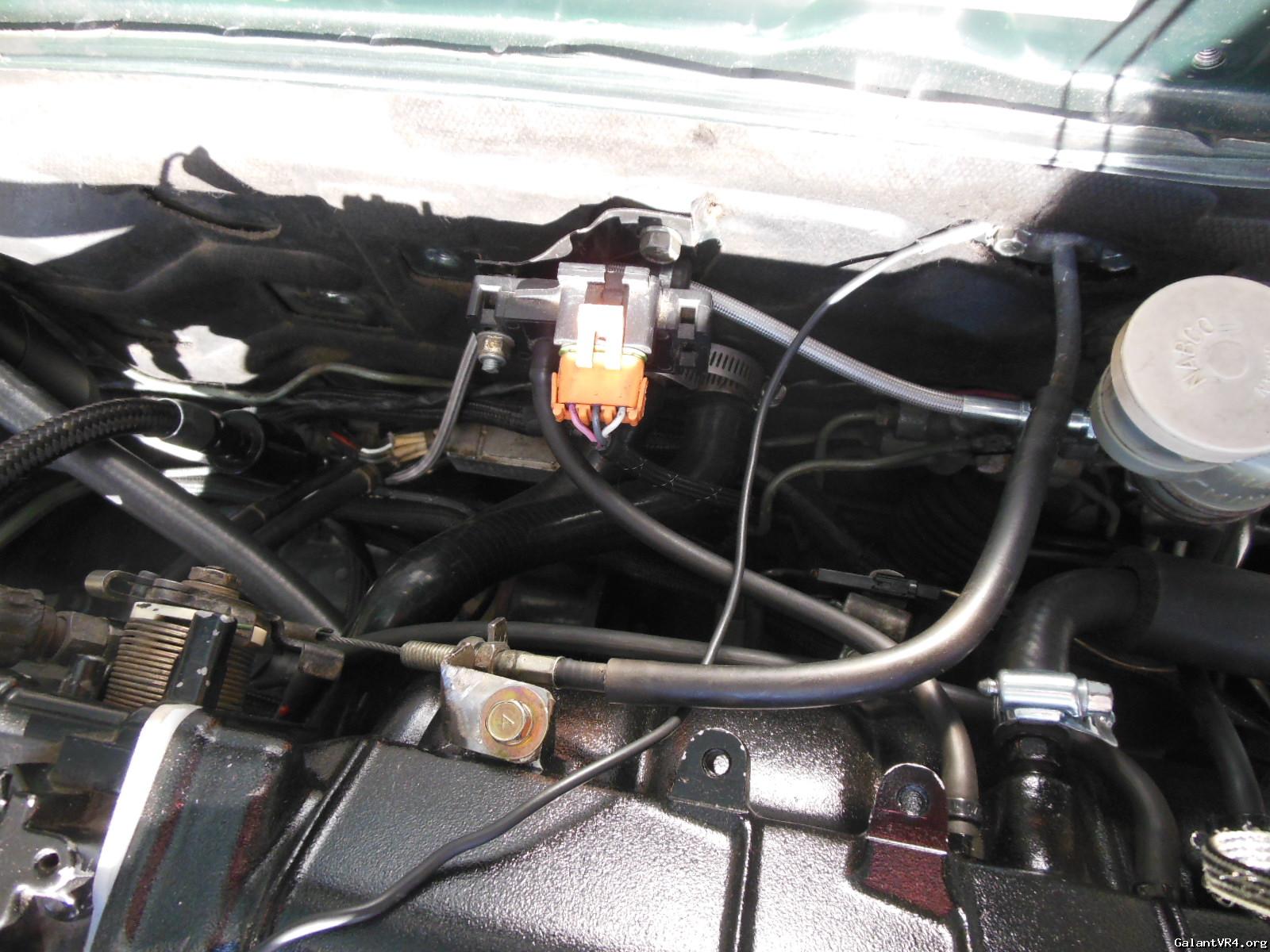

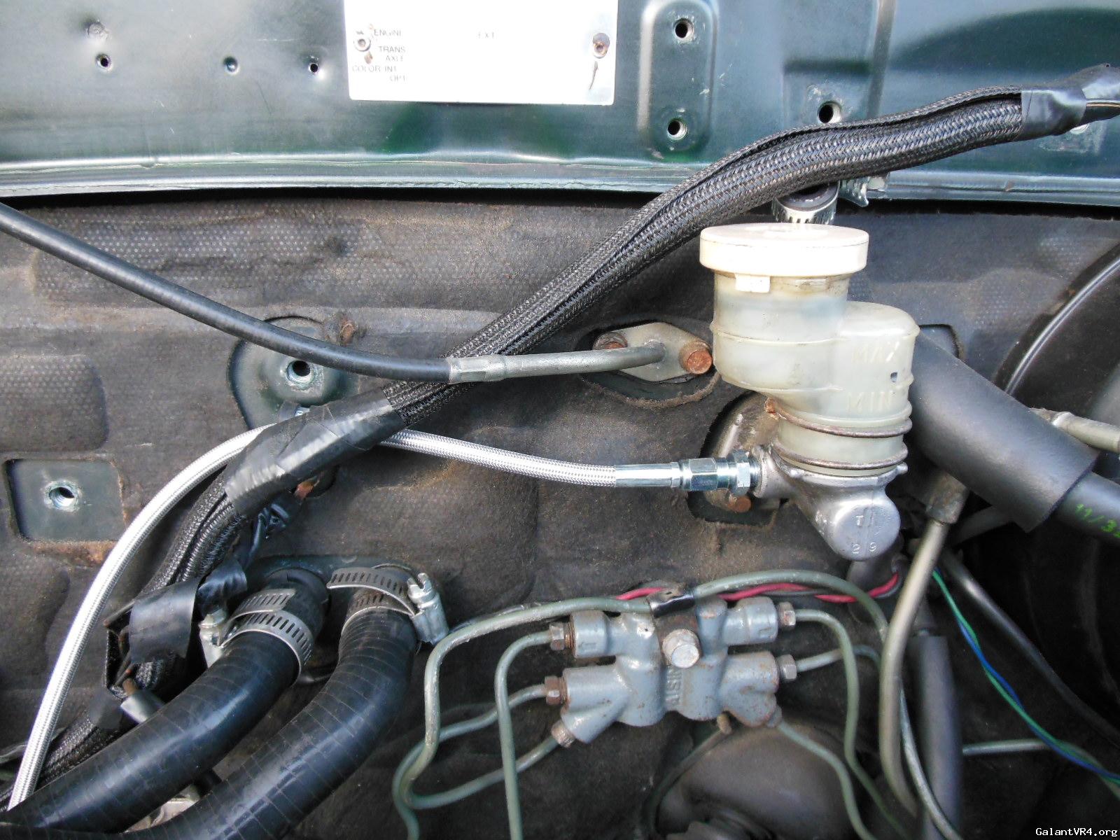

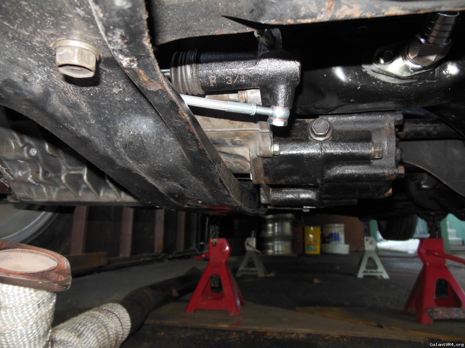

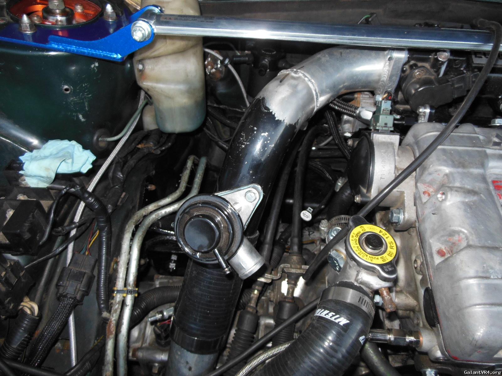

got my stainless clutch line and fresh rebuilt slave installed.

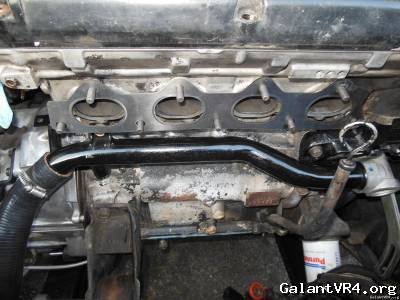

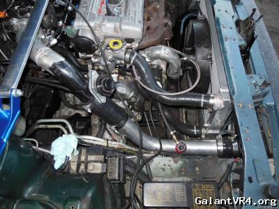

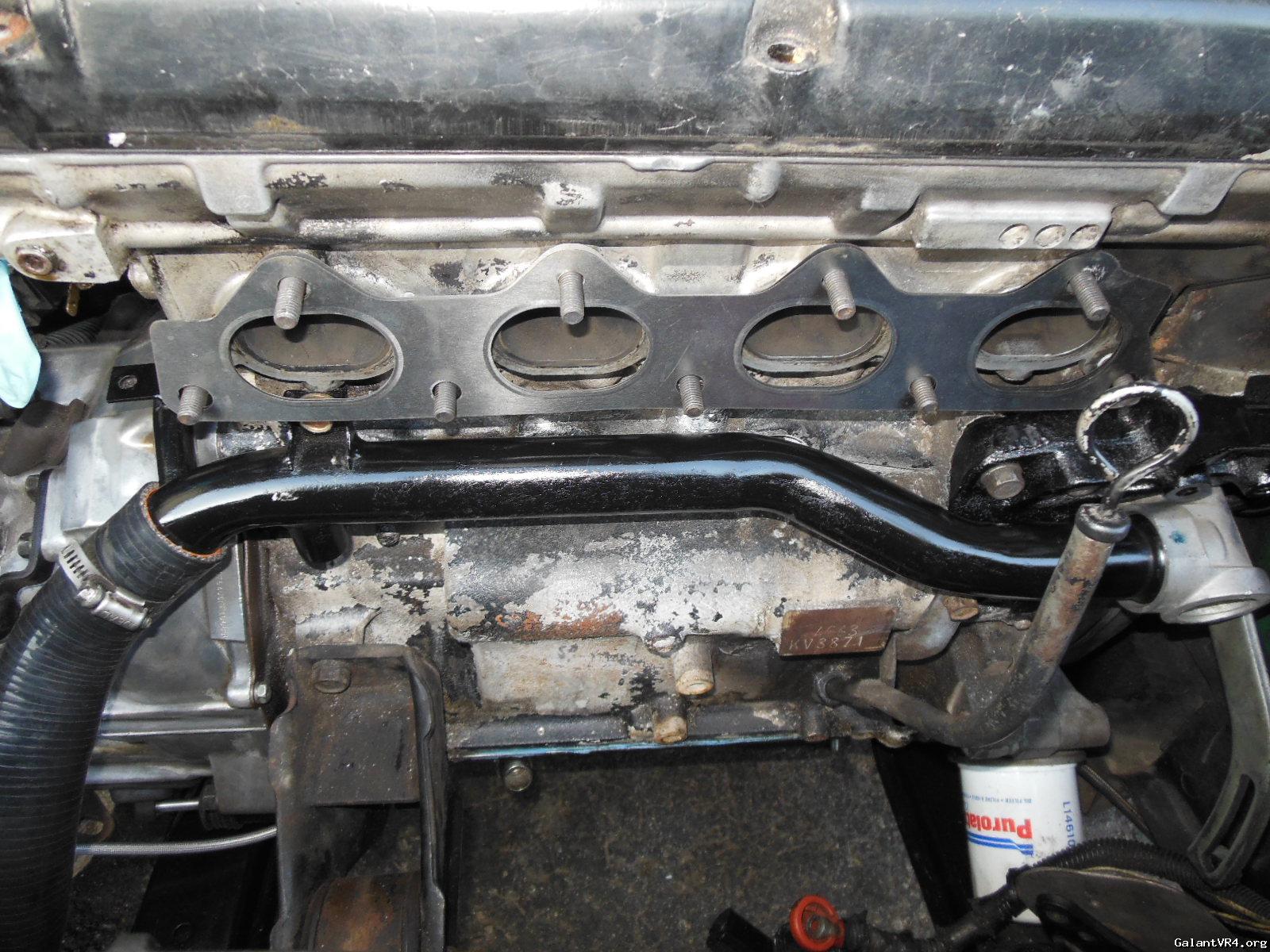

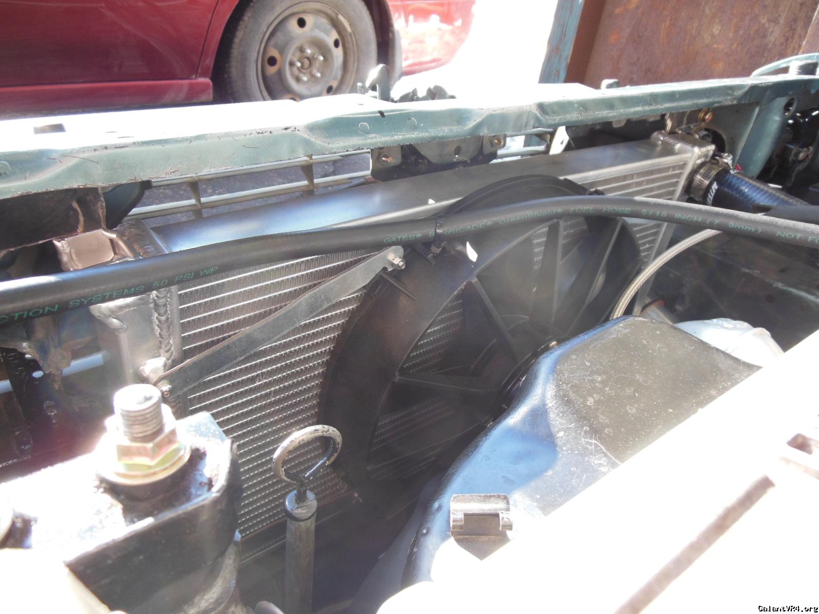

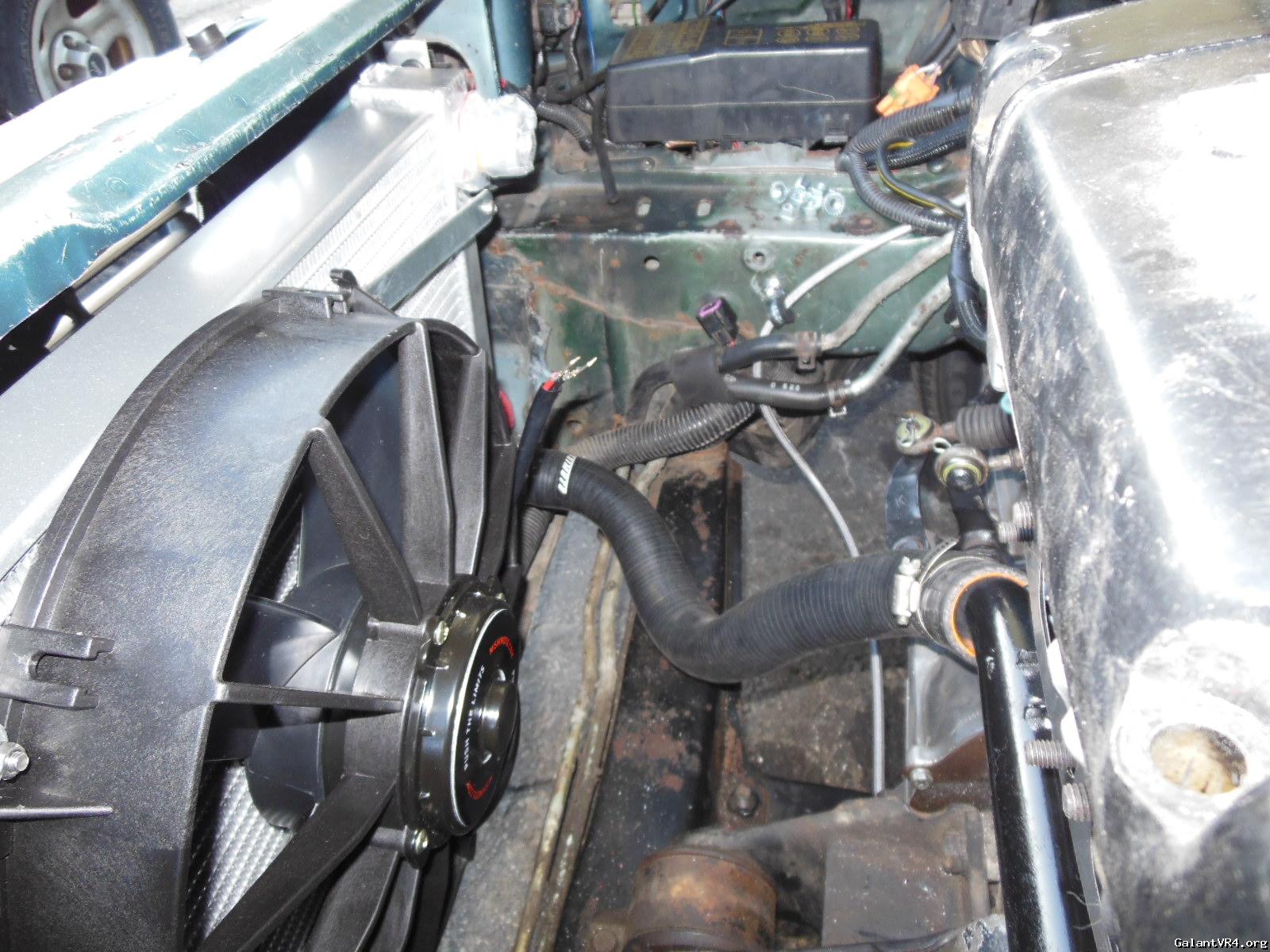

welded up radiator bracket, installed water pipe and connected lower rad hose.

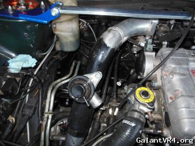

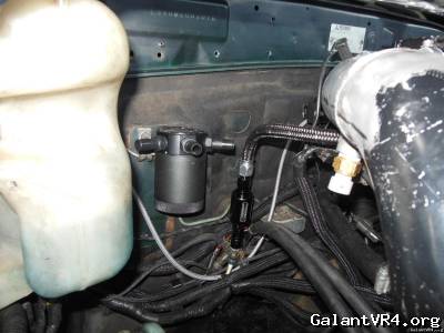

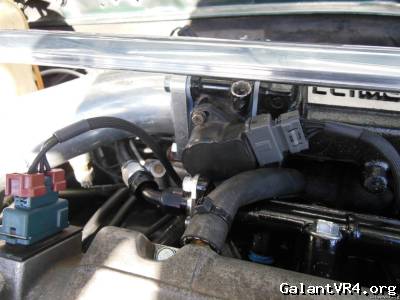

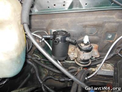

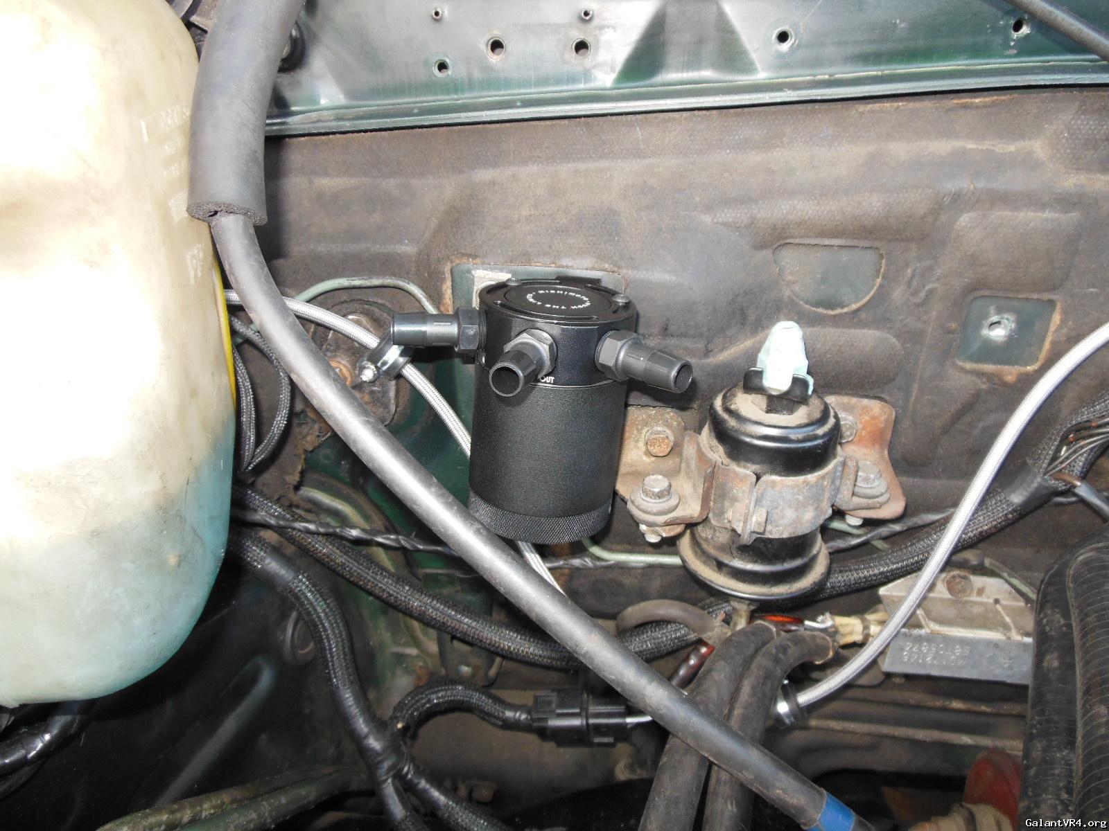

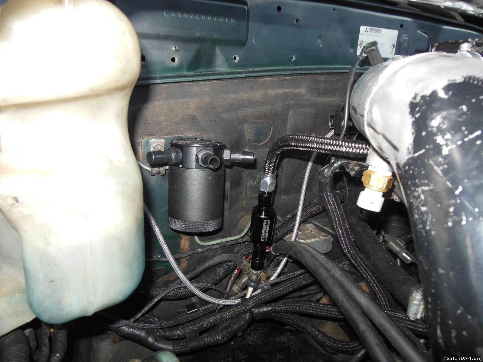

mounted a mishimoto catch can
i also put some MT-85 in the shep stage 1 trans i installed. waiting on a few more parts in the mail, looking for a set of 264 cams and just need to powder and ceramic coat a few parts.

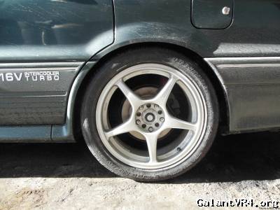

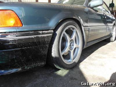

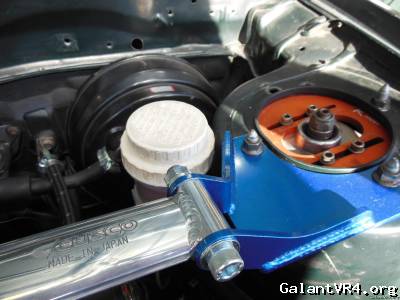

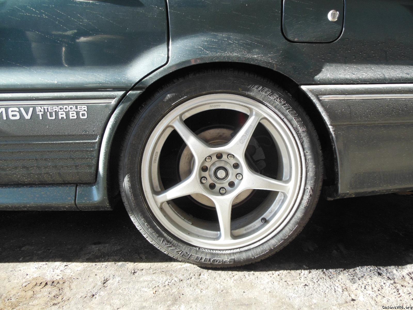

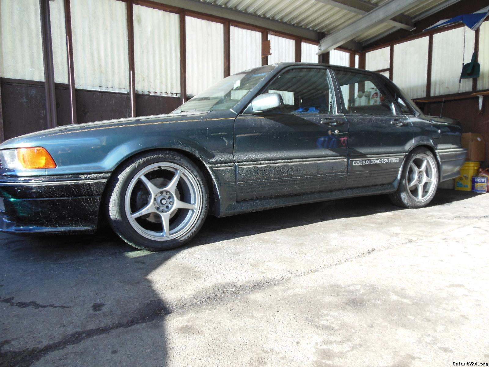

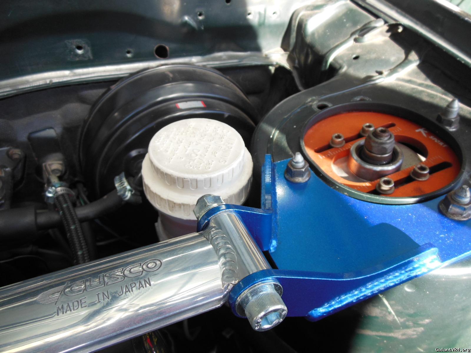

finishing my 5 lug swap, whiteline 26mm sway bar and 4 bolt rear in 4ws housing and put the car down on its wheels. waiting to powder and ceramic coat things still.

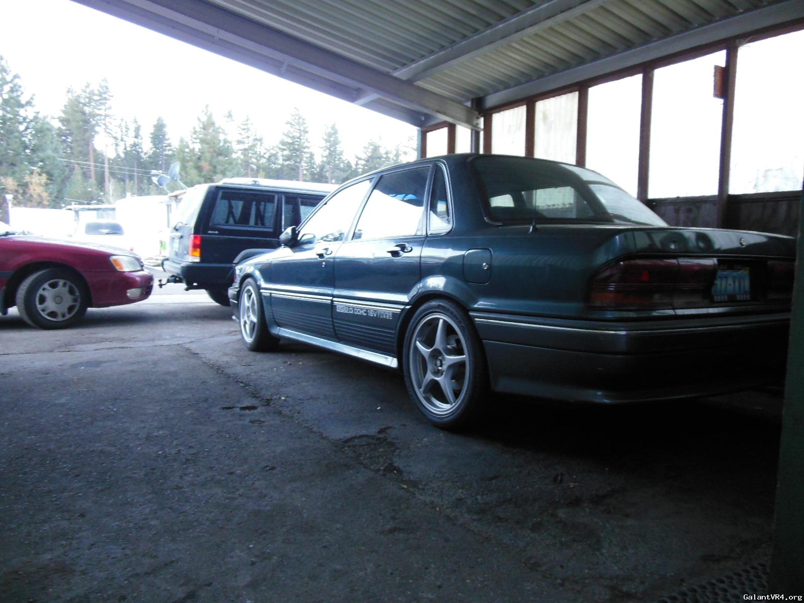

Well its been a while. Snow started to fly and my priorities changed fast. I began to train for snowboarding and get my body ready for winter. Christmas eve i had some friends over and we got a foot of snow. We decided to pull the sled out and while pulling it off the trailer, my foot slipped and twisted on the ice and i partially tore my ACL. So i got myself motivated and started to slowly install everything, it's back together almost. boost leak testing it this week and then finish the cooling system, change oil and i can turn it on.

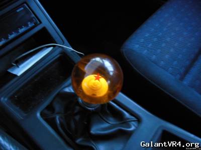

I'm also a huge Dragon Ball Z fan and i got this for christmas. pretty pumped on it.

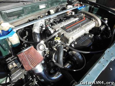

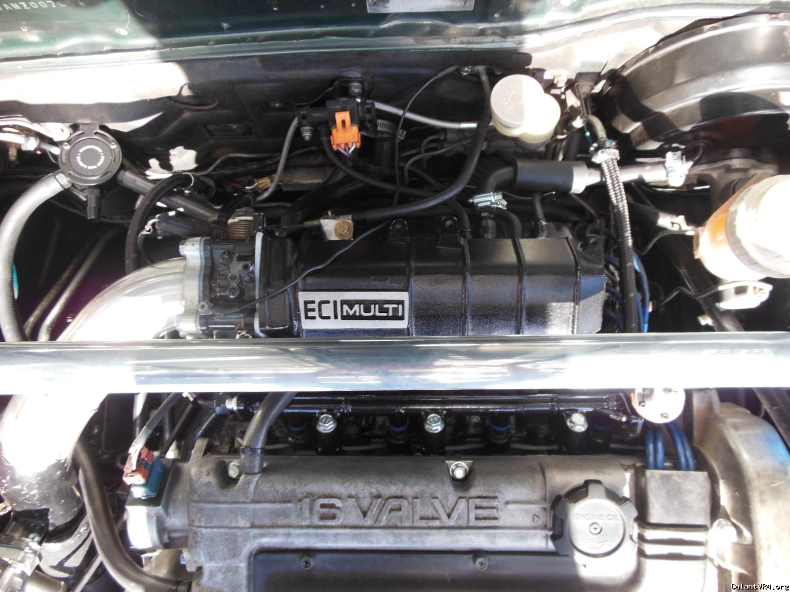

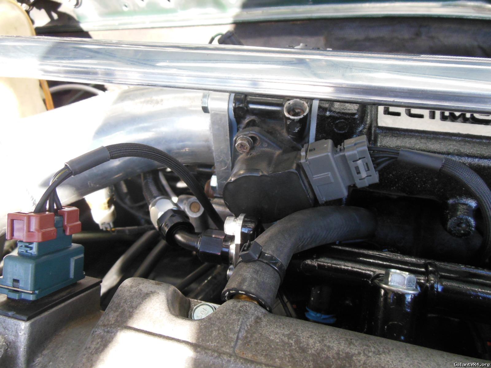

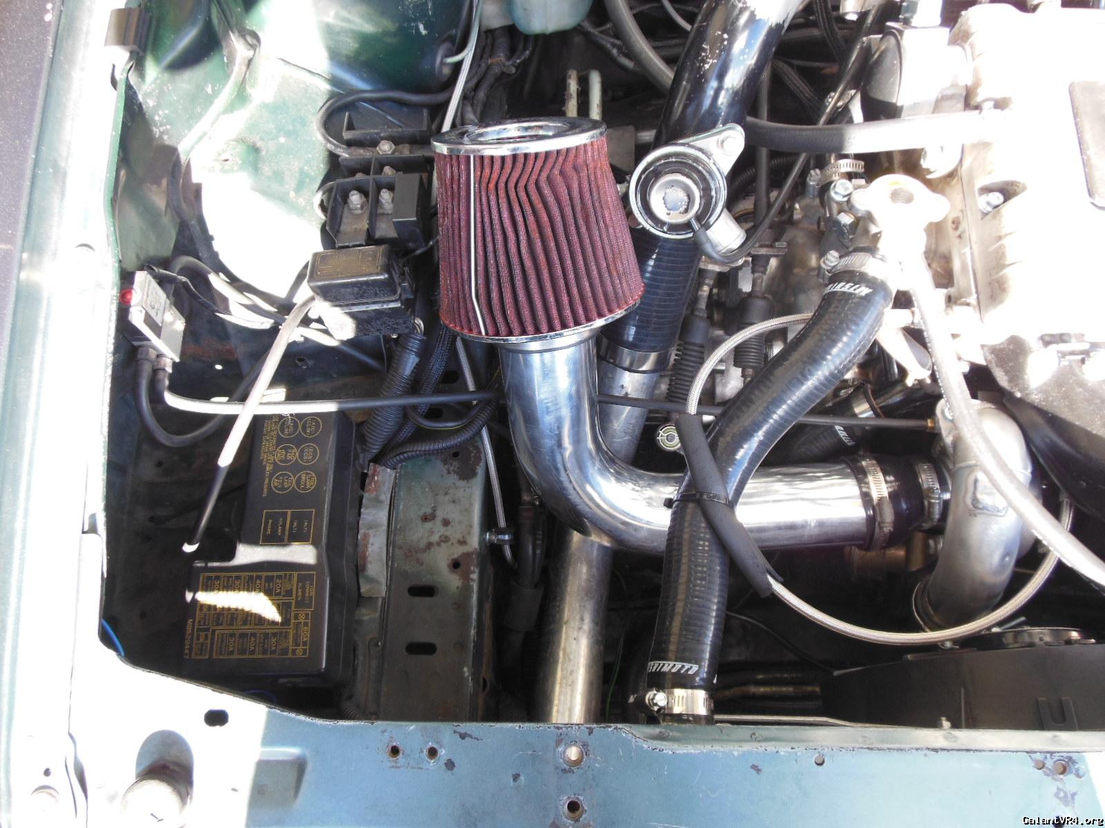

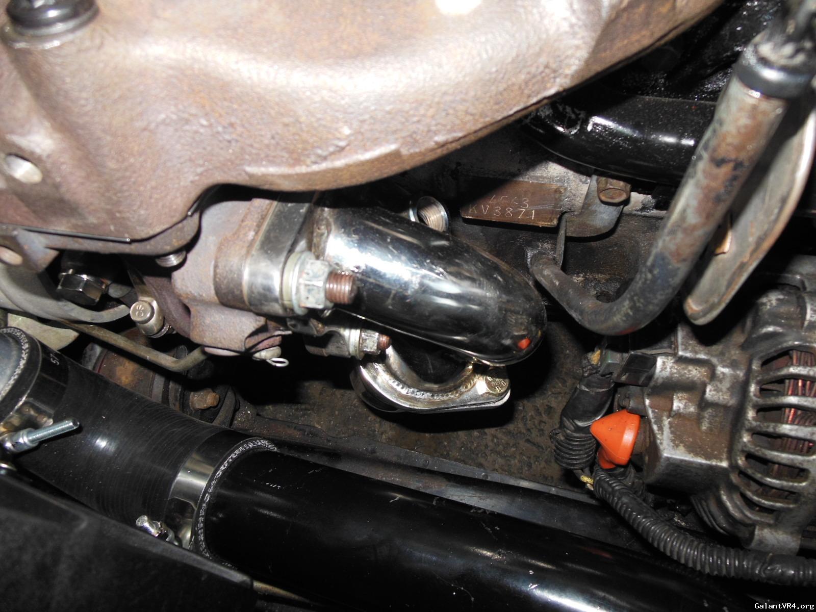

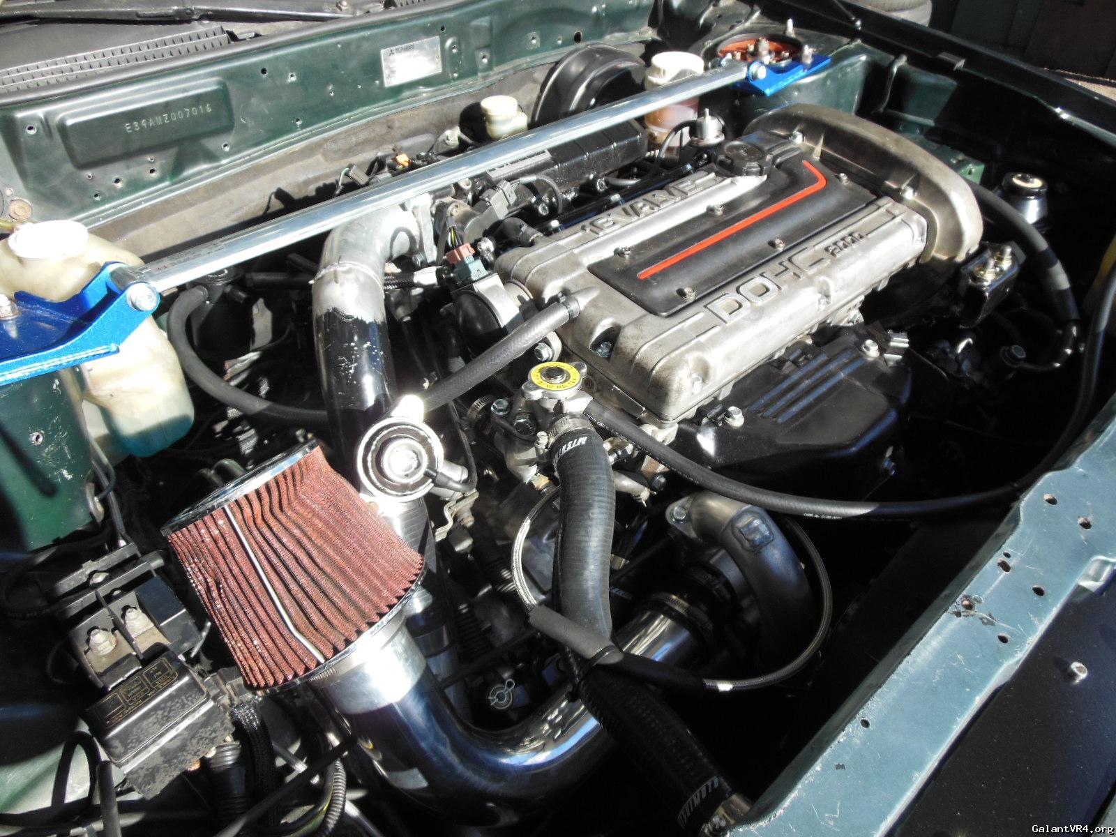

Well, yesterday was a triumph!! I finished putting my motor back together, started it up, did a leak check, cooling cycle check, torque check, 10 psi initial drive just to build pressure everywhere and then again one more time check for leaks. mostly leak free. oil return has a light coating of fresh oil and i guess when i put my trans back together i hit my output shaft seal for the TC and i have a very very small amount of trans fluid building up. both of these i will be addressing soon, but for now i am going to drive the car around a little bit. the leaks are there, but there not leaving any fluid on the ground, yet. i figure next oil change ill do both.
Now for today, i have to finish up the exhaust, radiator brackets, boost controller, front end installation, catch can routing, 3" intake, brake line brackets and then i can tune the car and turn up the wick.
