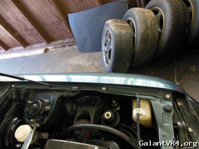

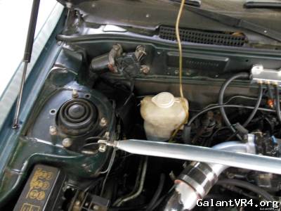

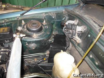

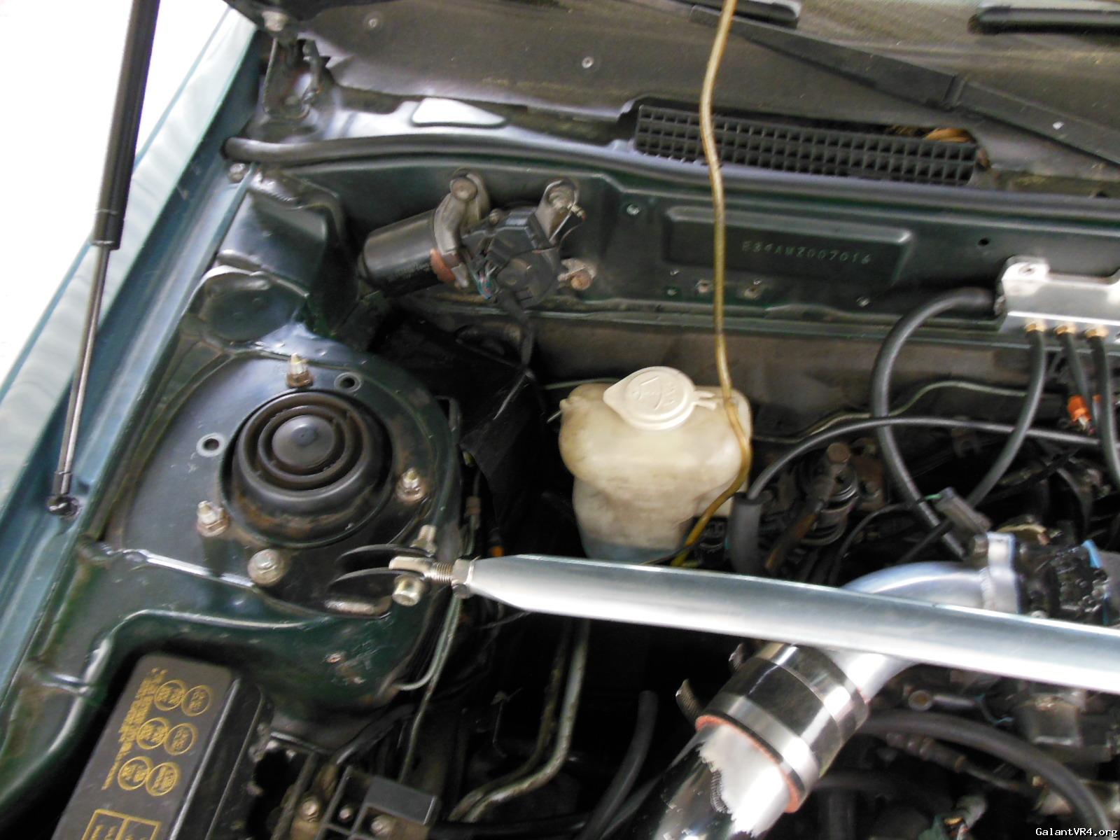

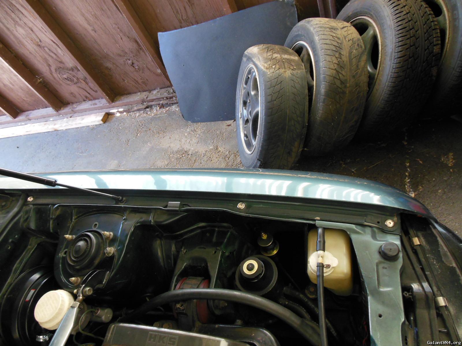

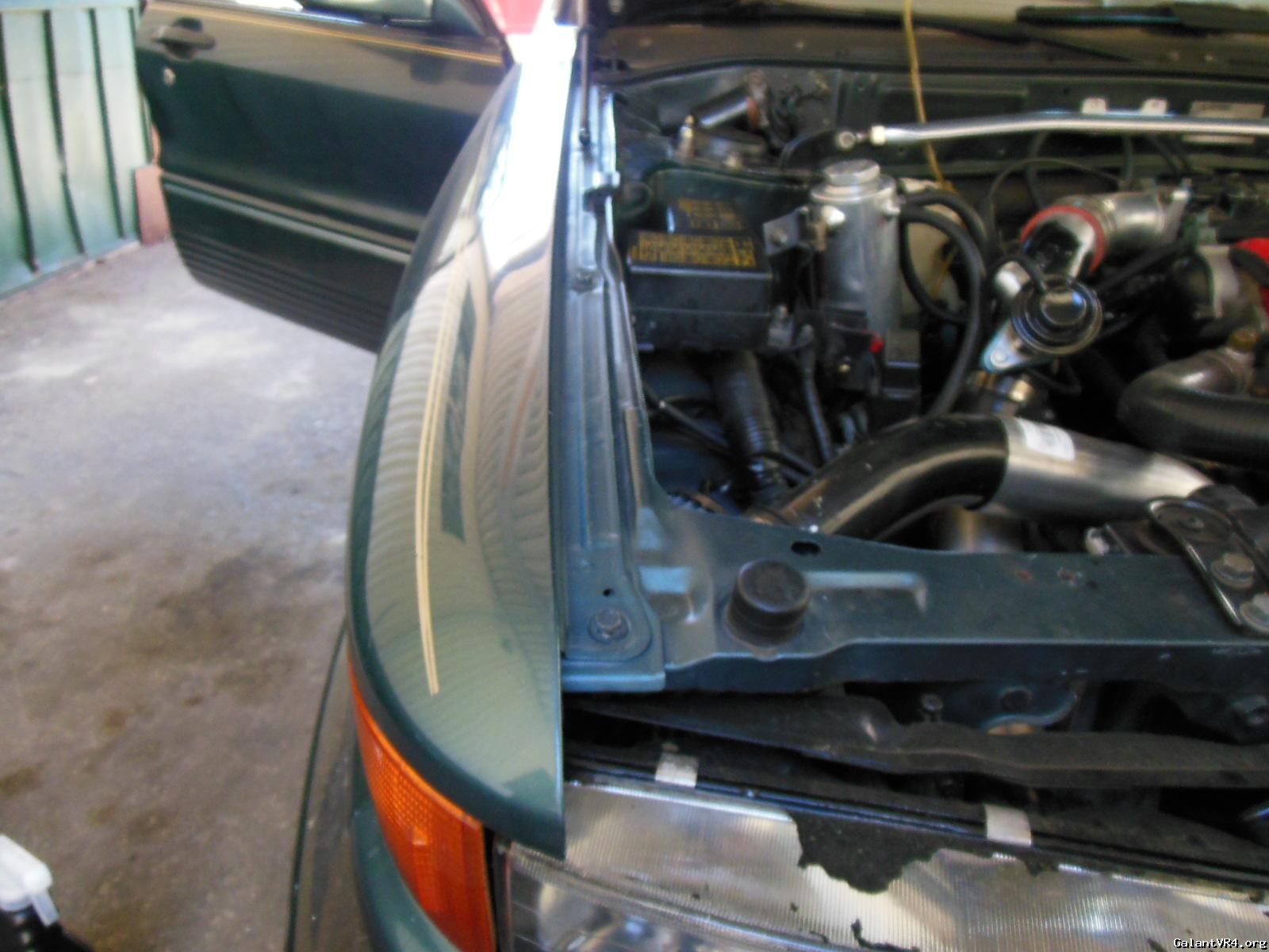

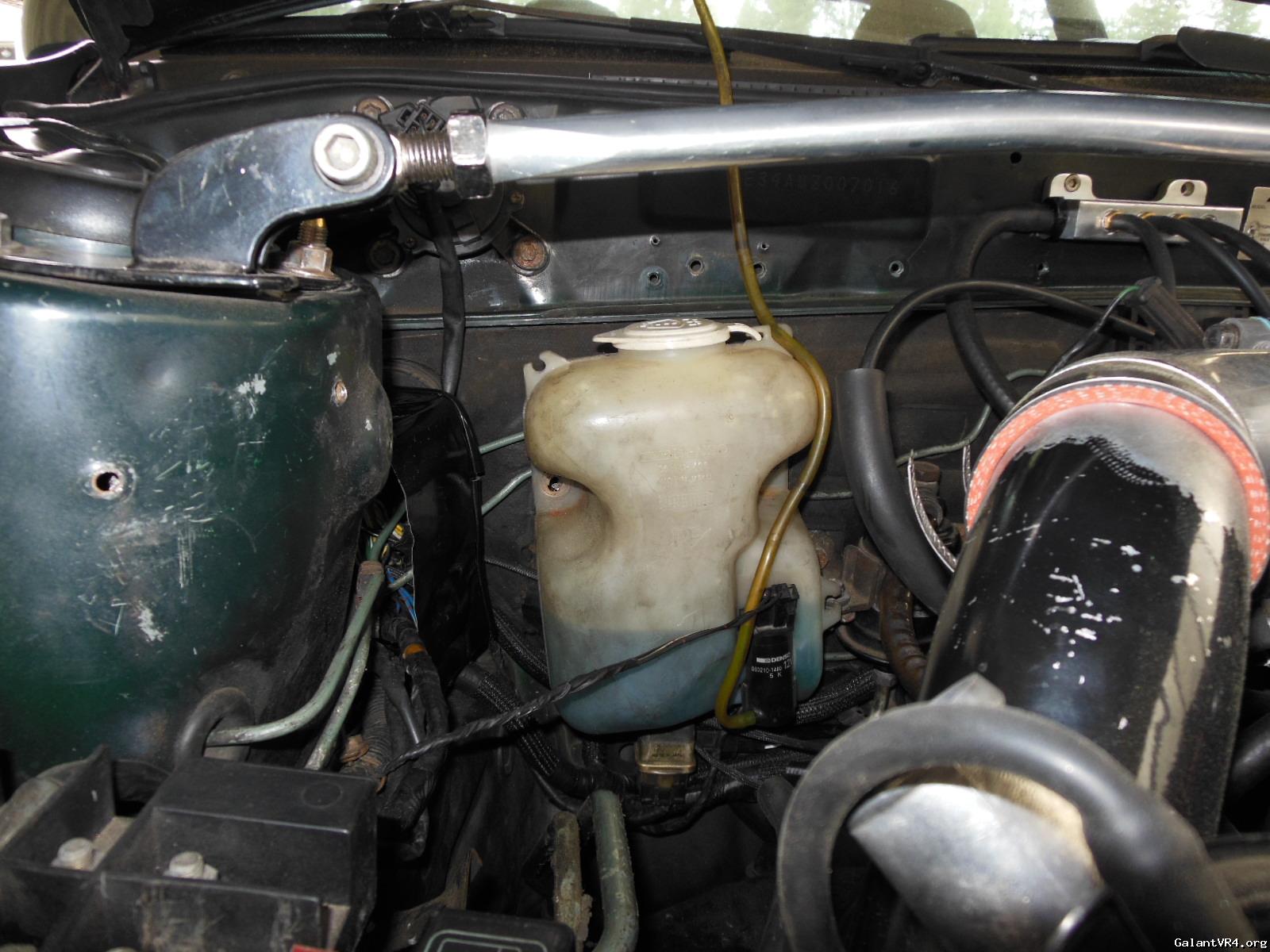

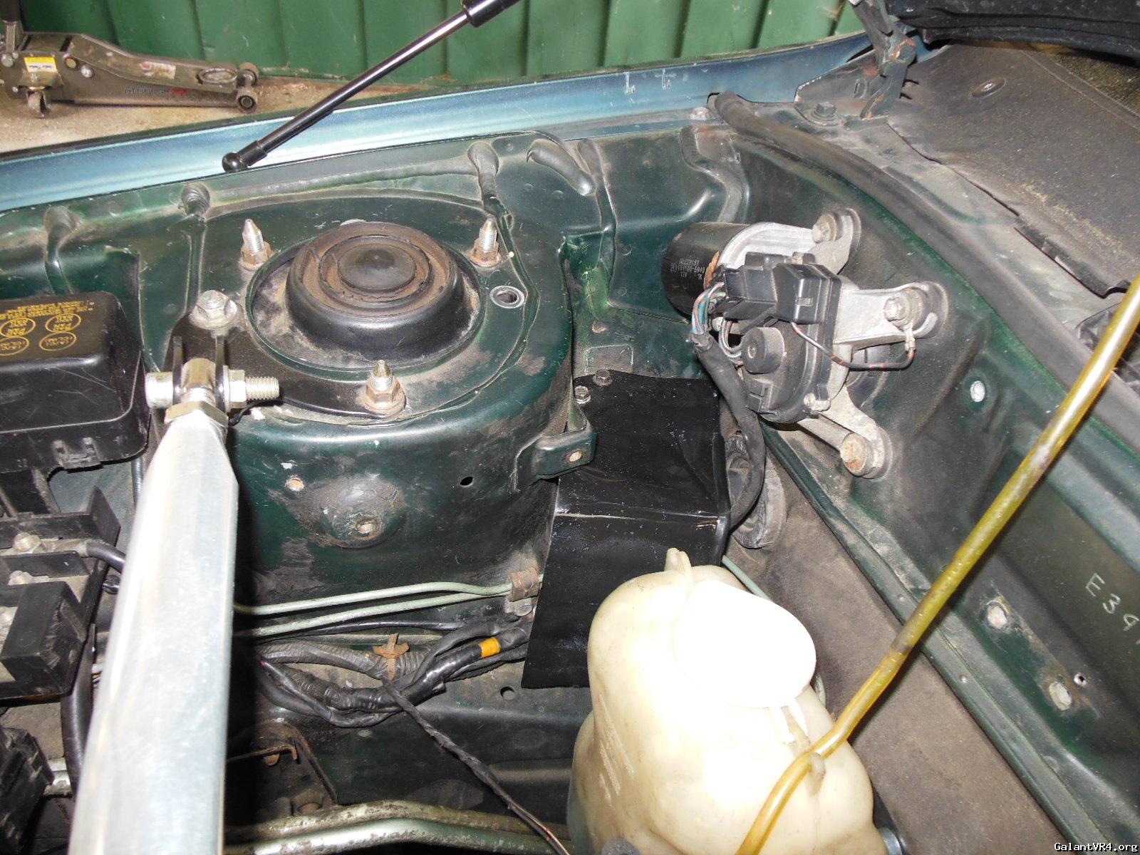

so i haven't been doing much work to the car, just enjoying the heck out of it. as of recent i decided to move my washer bottle to the firewall and finish my tin shield i made for the wires i dont need in the harness.

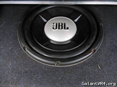

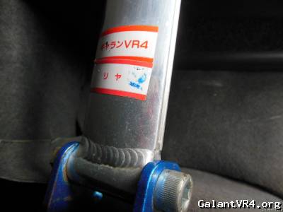

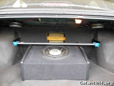

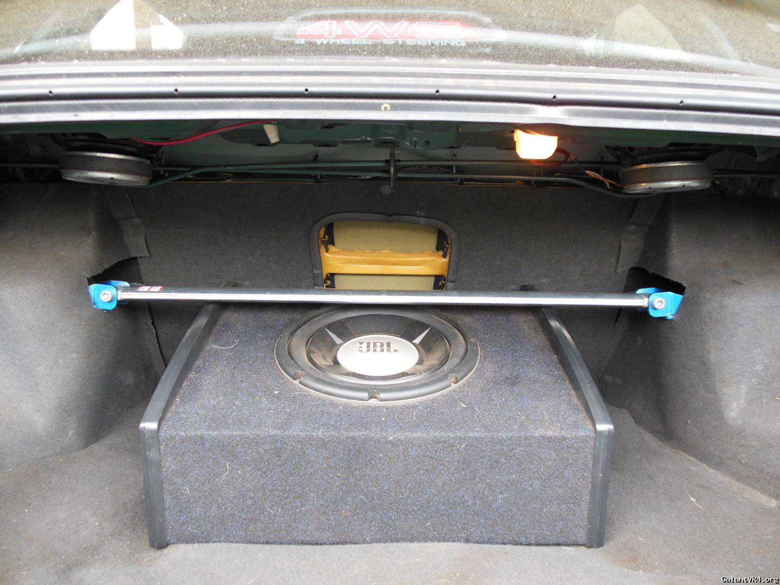

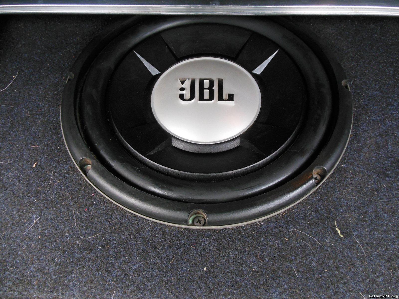

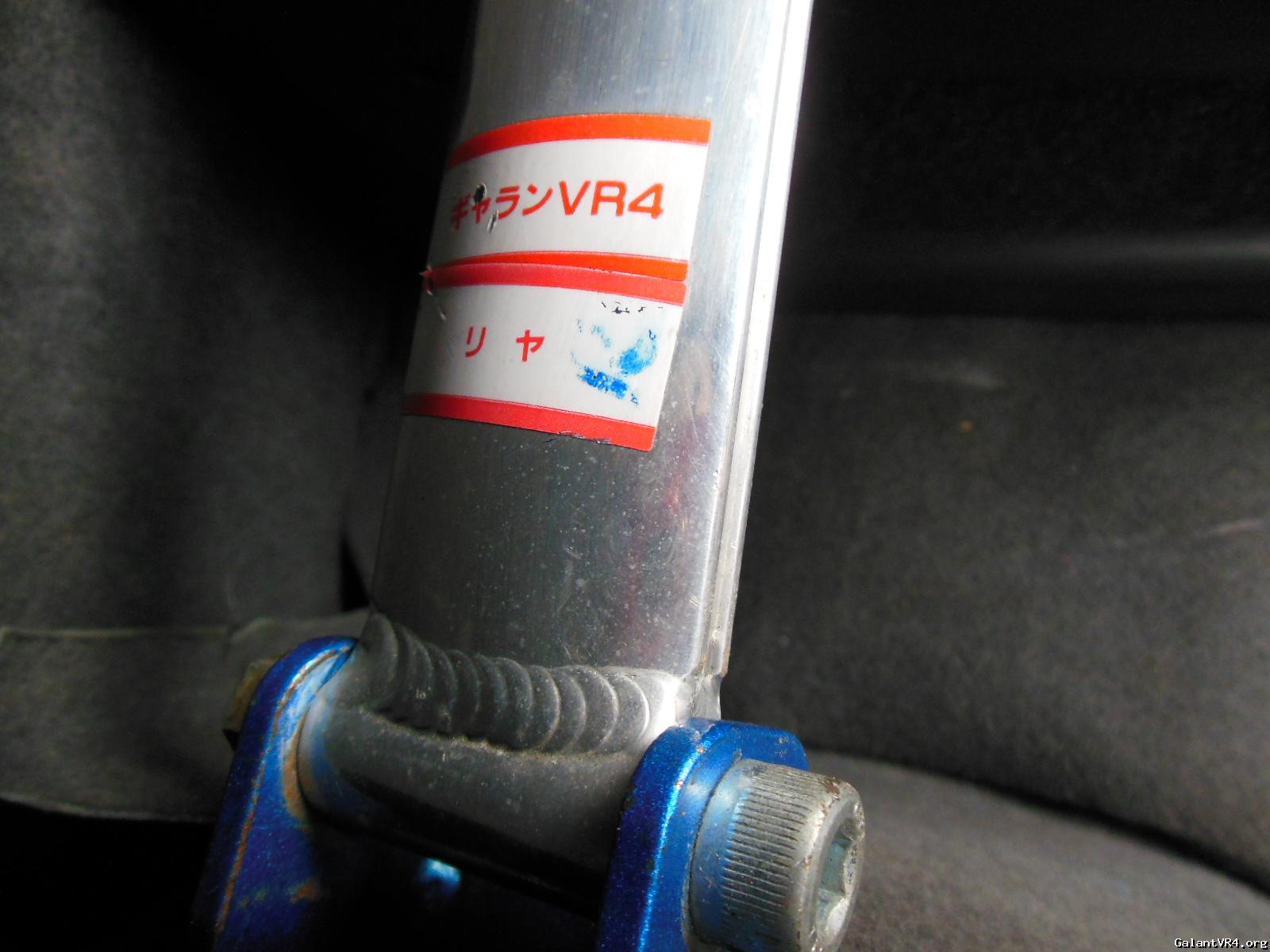

i also got myself a Cusco rear strut tower bar and i had this 10" JBL speaker laying around so i added it in the trunk as a 5th speaker. sounds pretty nice.

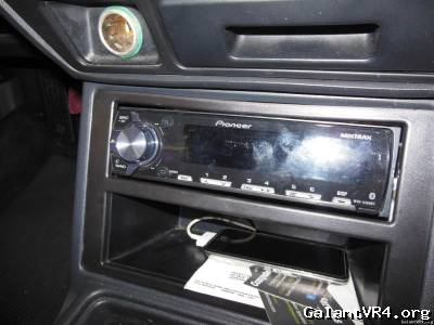

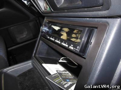

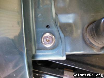

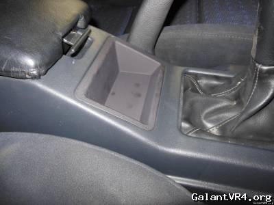

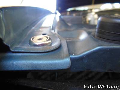

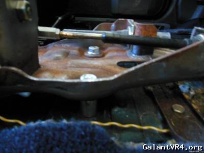

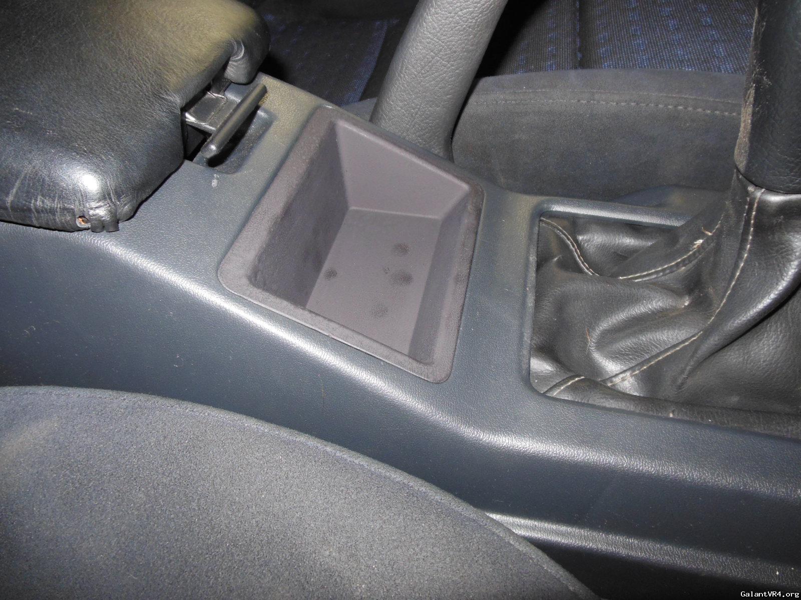

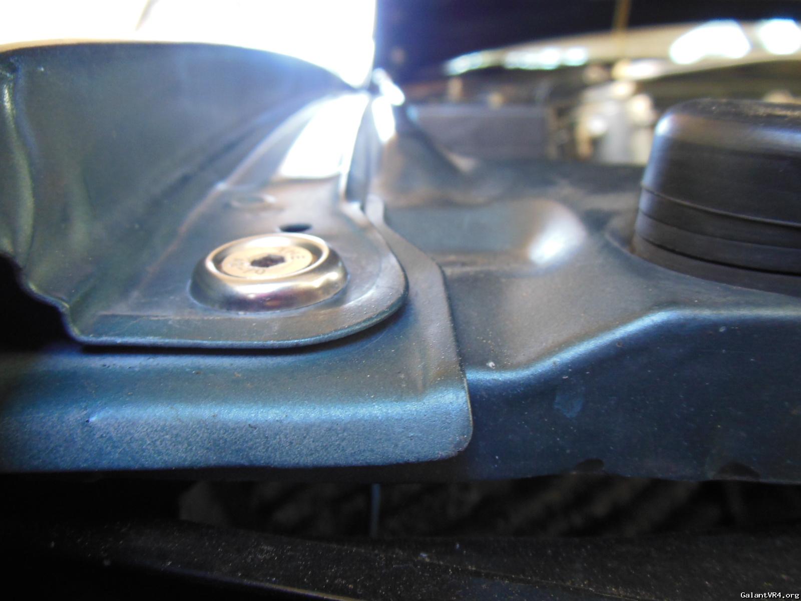

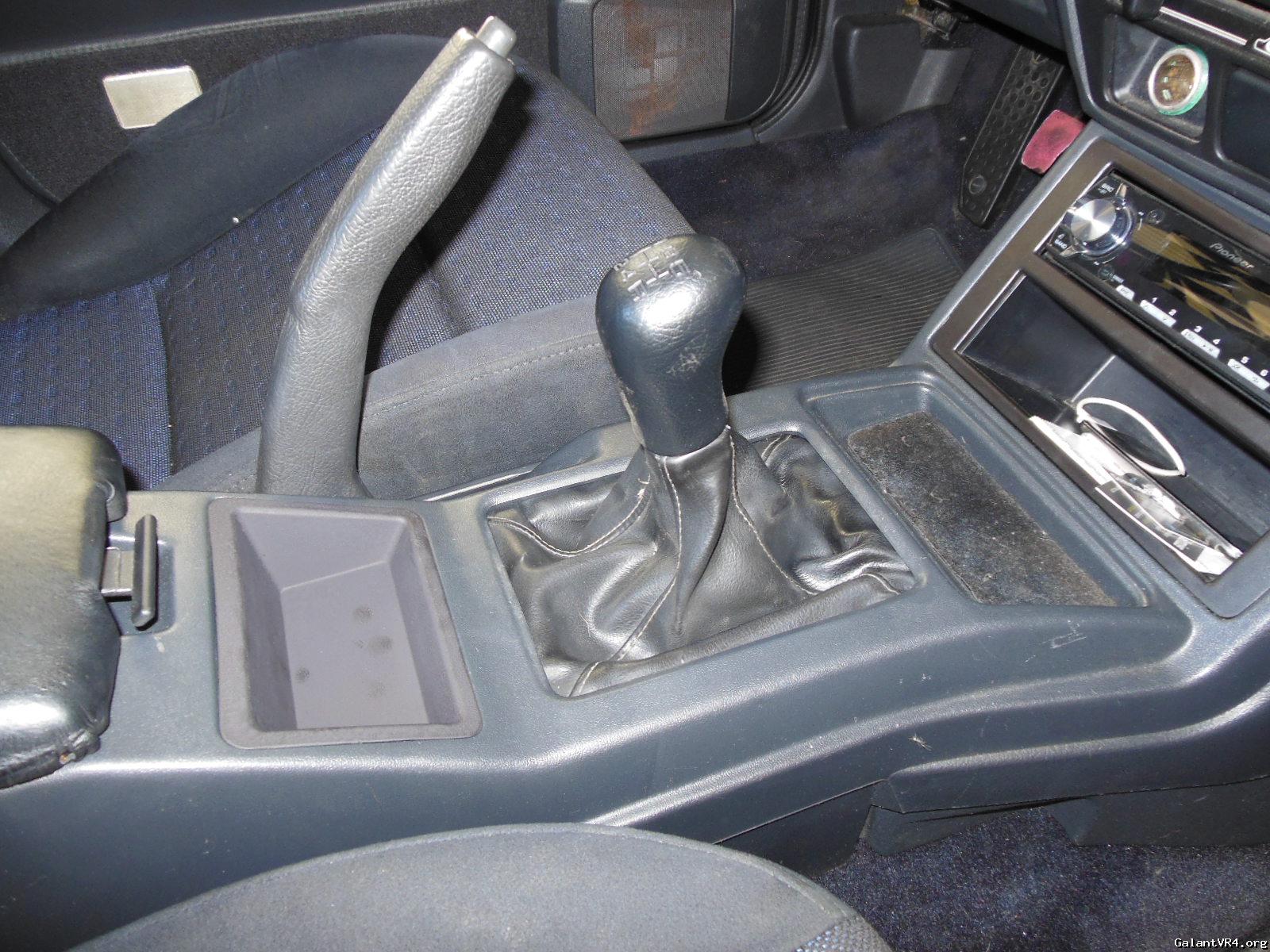

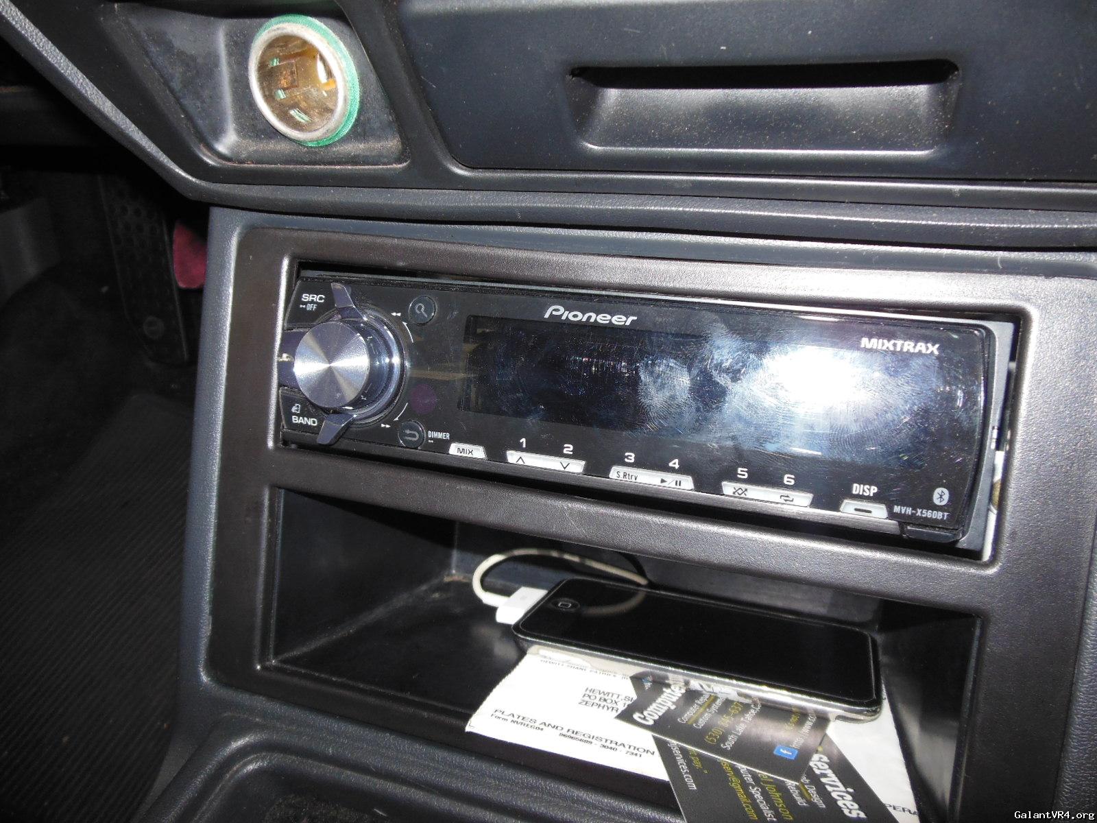

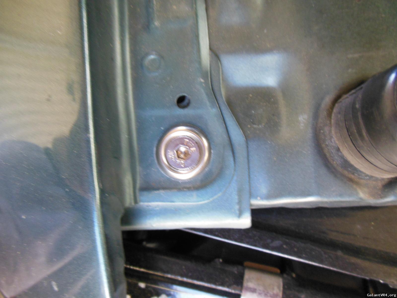

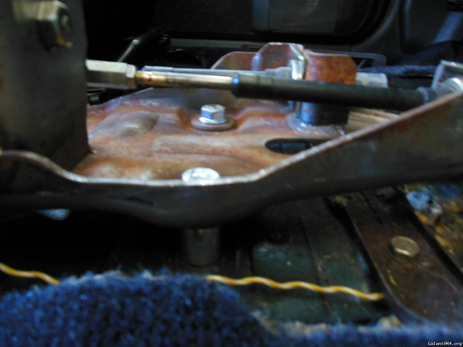

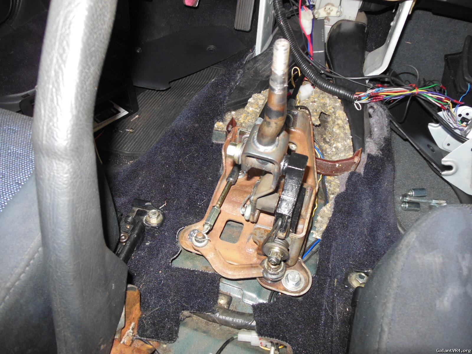

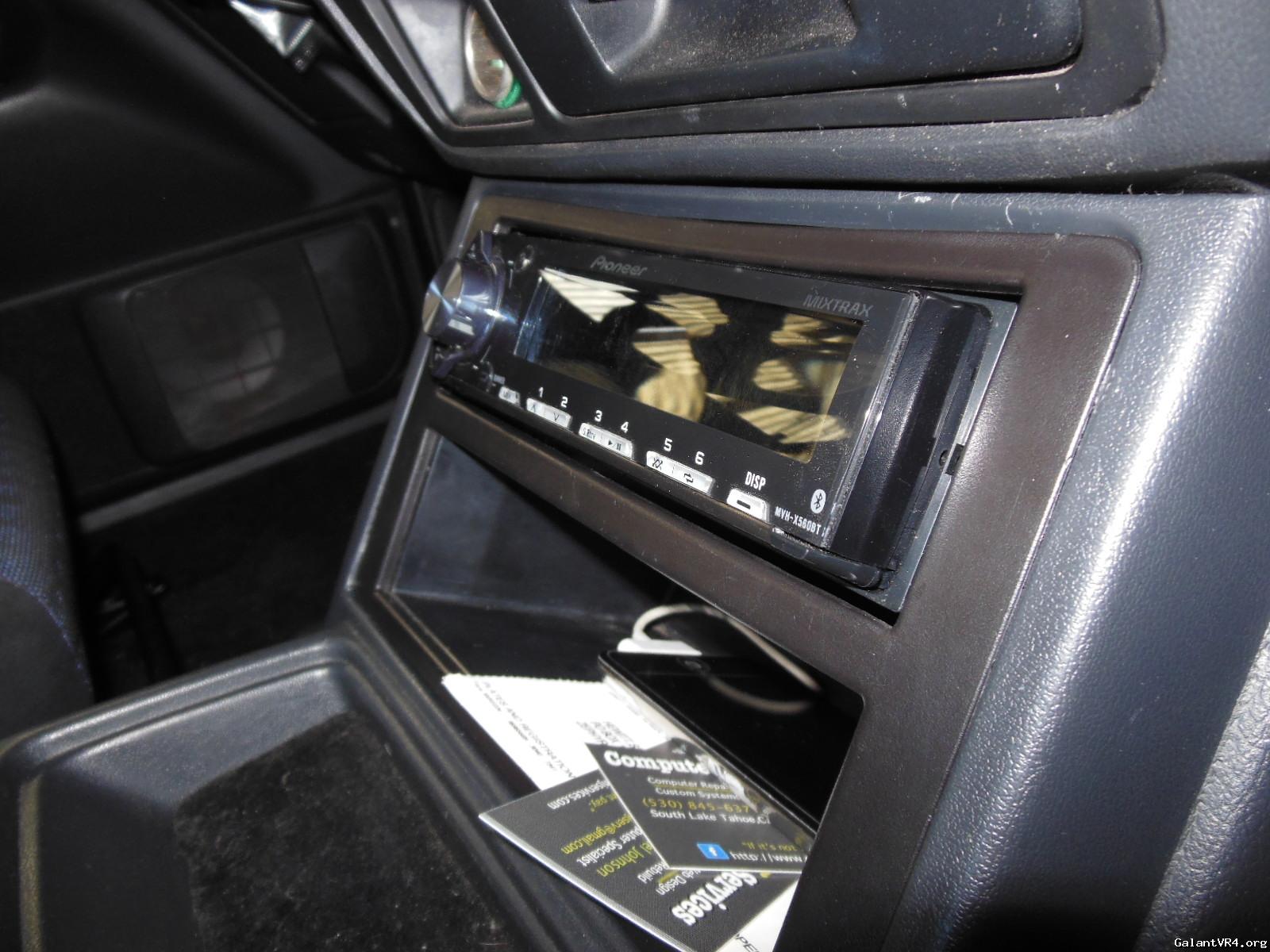

and today i got a little bit of the itch again and started to play. i adjusted my shifter base hight, added a 1g shifter, 1g shift boot, coin tray out of an 89 with no power mirrors, adjusted radio to sit nicer and i changed my fender bolts out. nothing crazy, but some nice little touches.

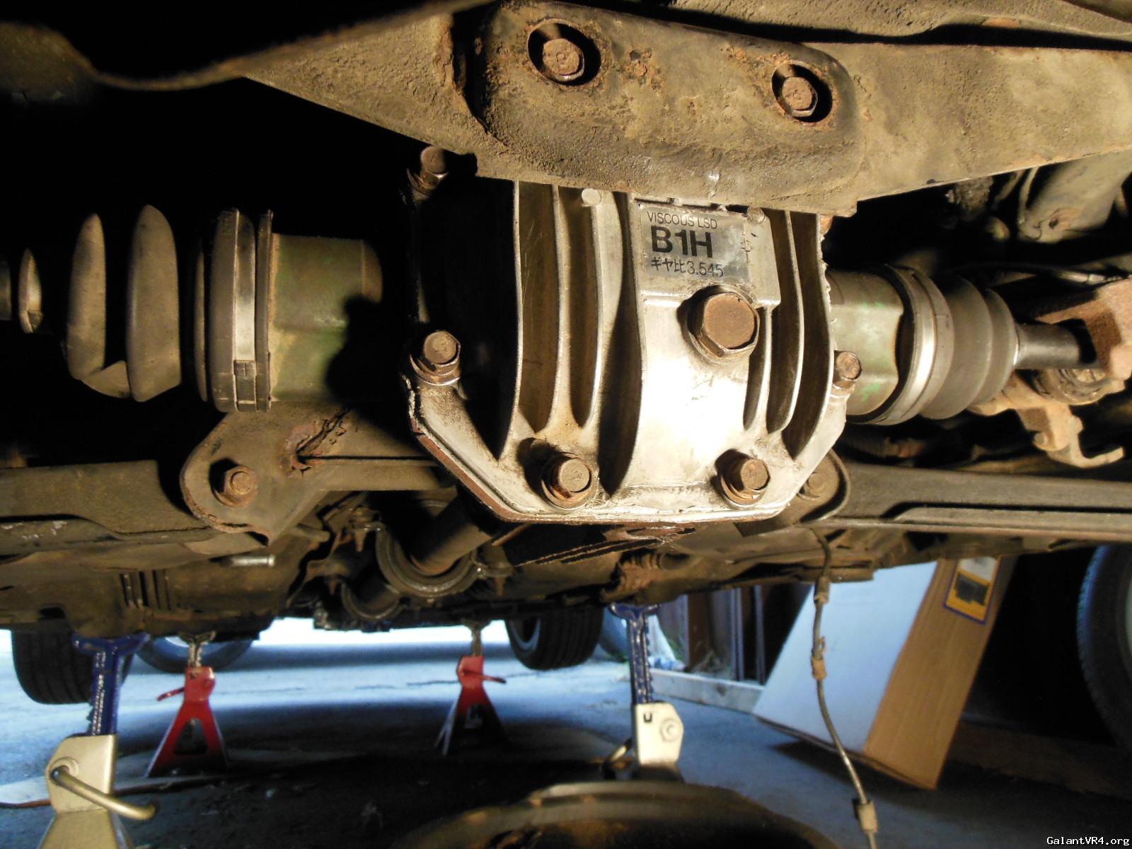

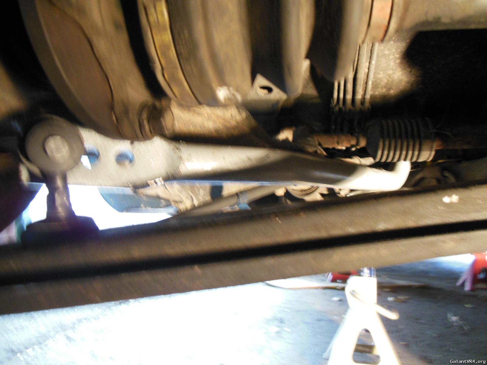

zompton

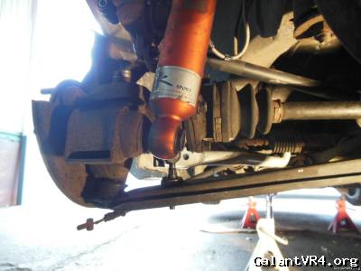

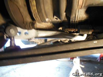

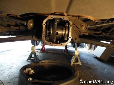

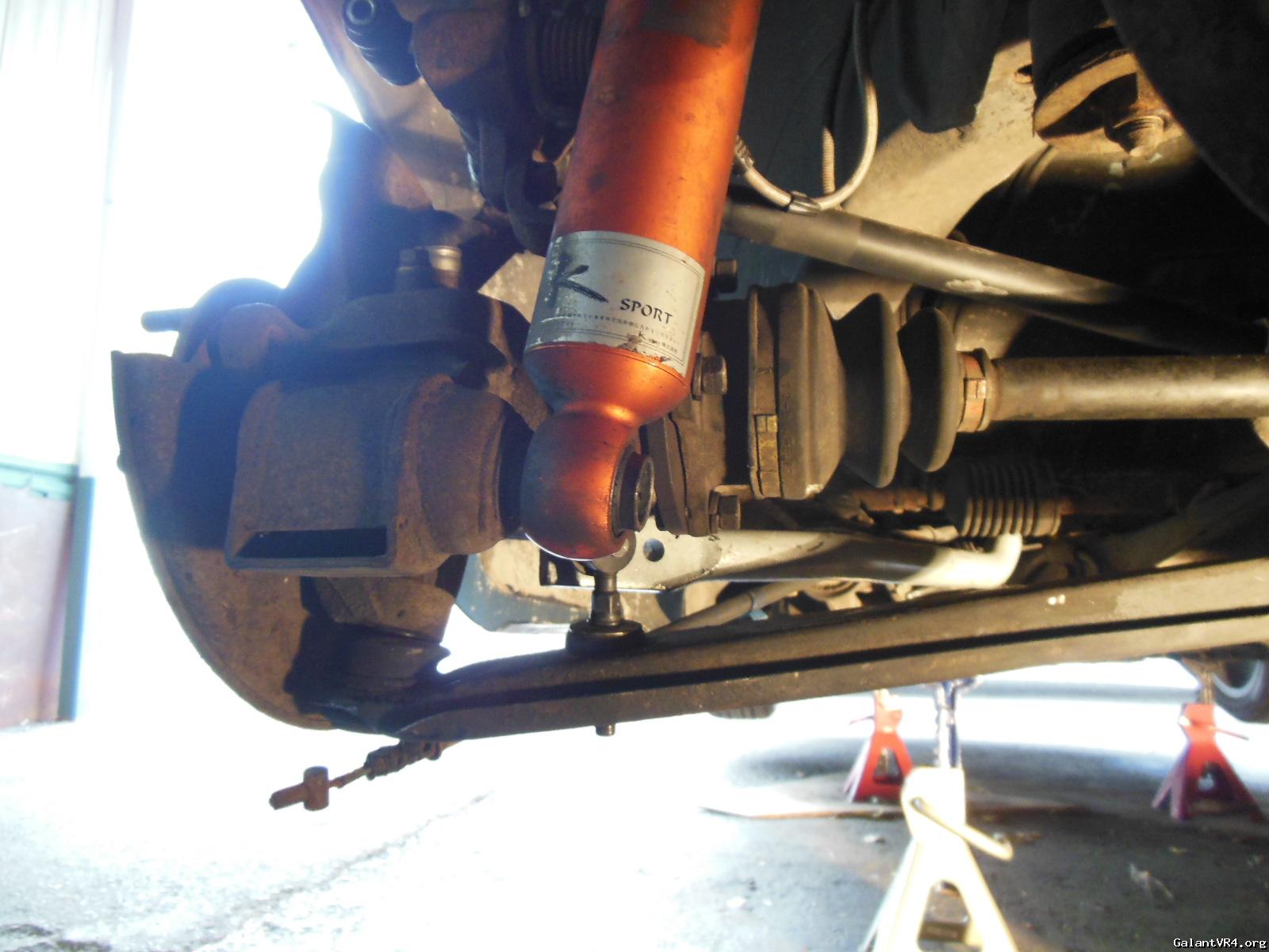

After looking at those control arms, it looks like someone used them as a jacking point.
transparentdsm
Jul 27, 2011
3,690
Cherry Hill, NJ
thats what i assumed happened, there is no damage to the underbody. it actually looks like they used the sway bar end links as the jacking point, hard to tell from photos, but easy to tell when in your hands.

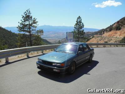

washed the car for the first time in a while, went for a nice long drive, got to the top of a pass and took some pictures. had a lot of fun driving up Geiger Grade. here is what the road looks like. click

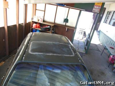

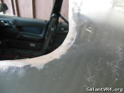

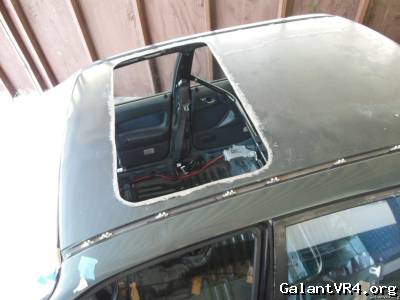

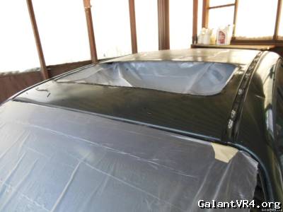

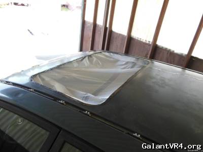

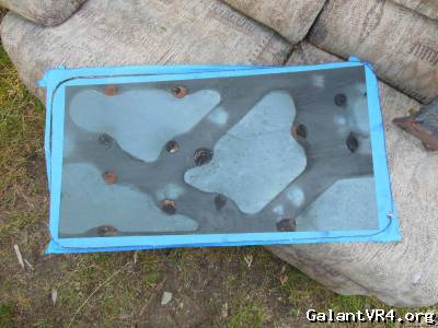

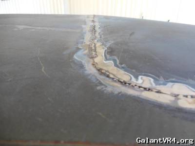

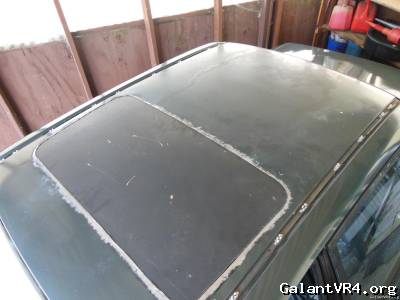

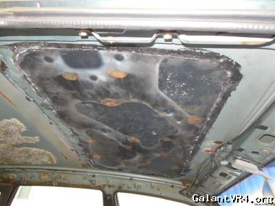

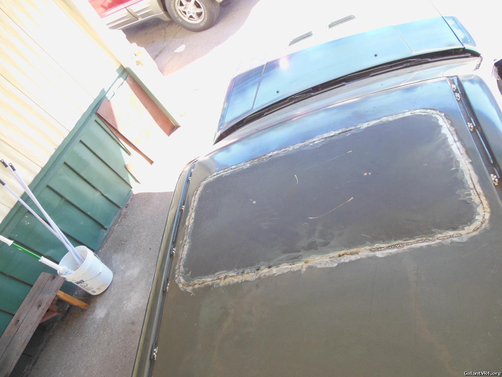

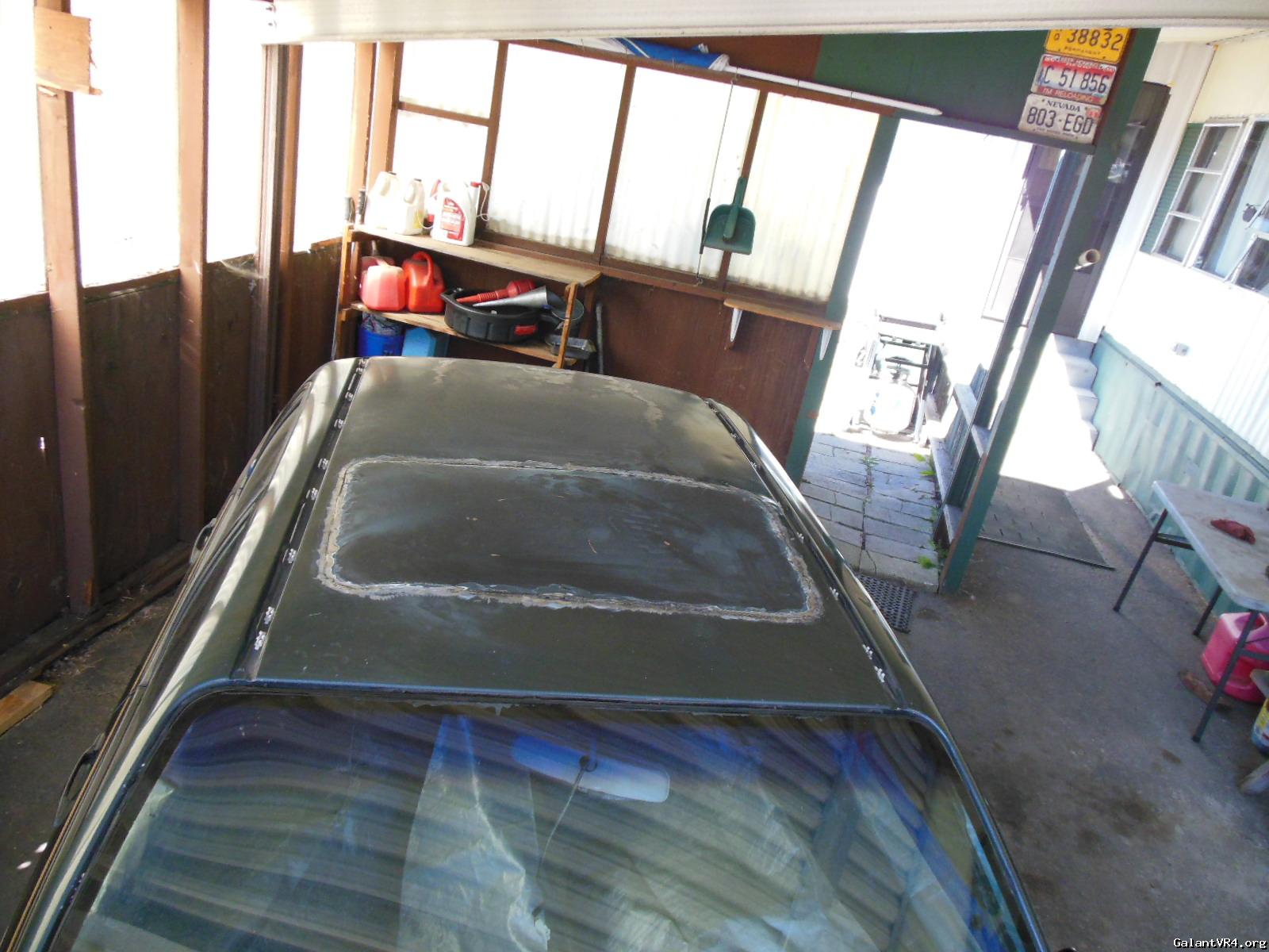

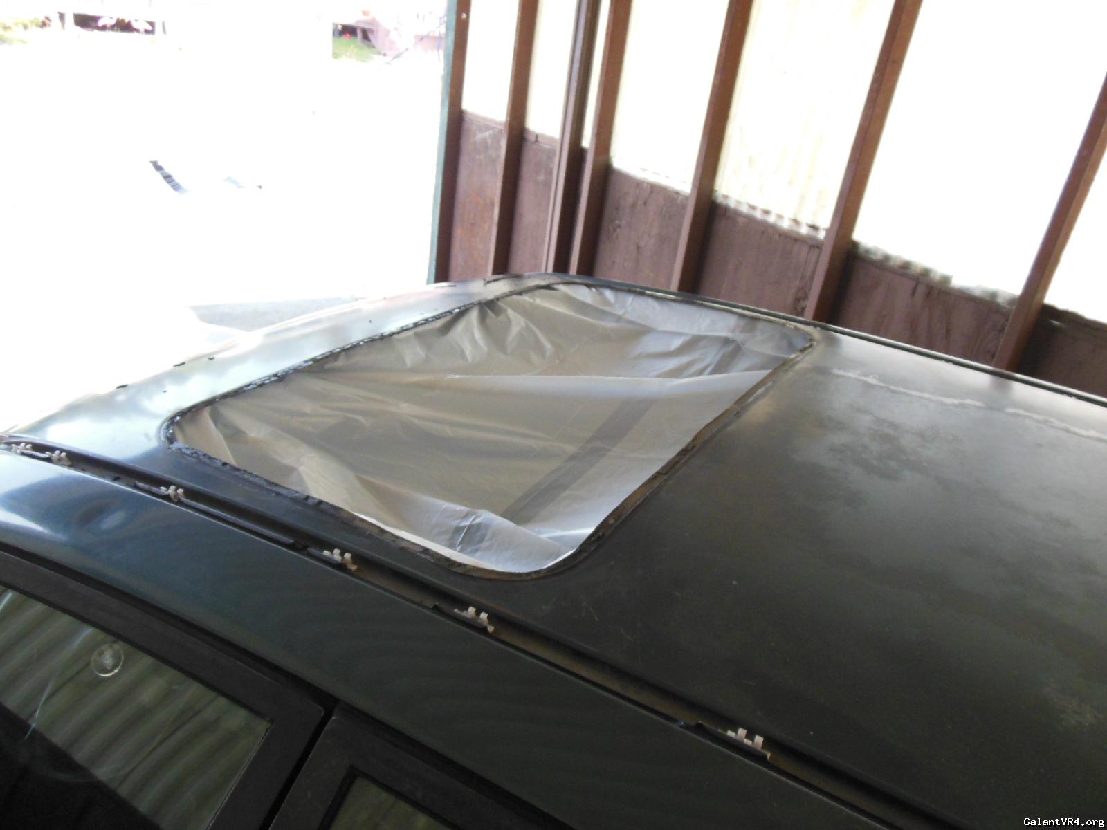

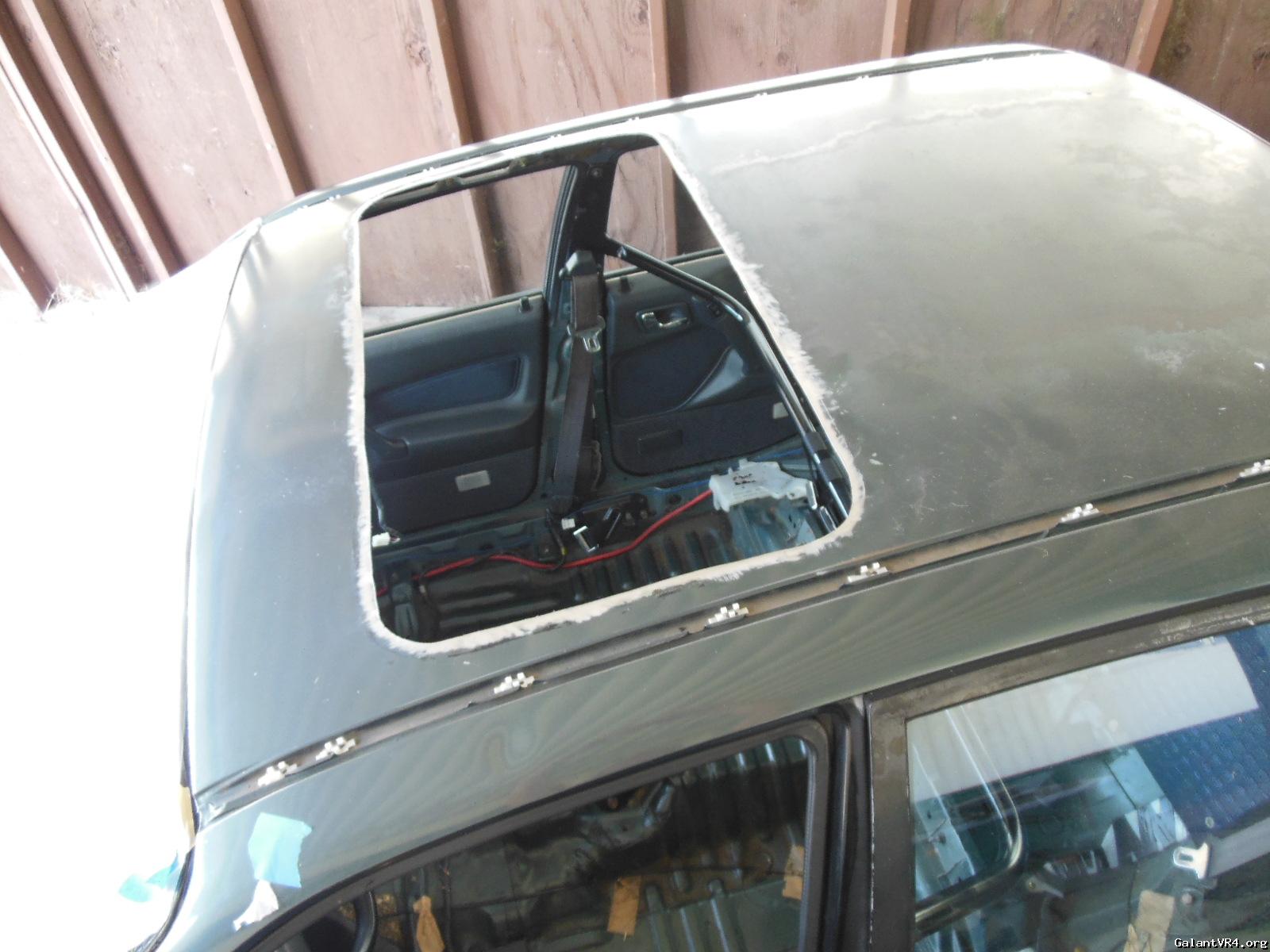

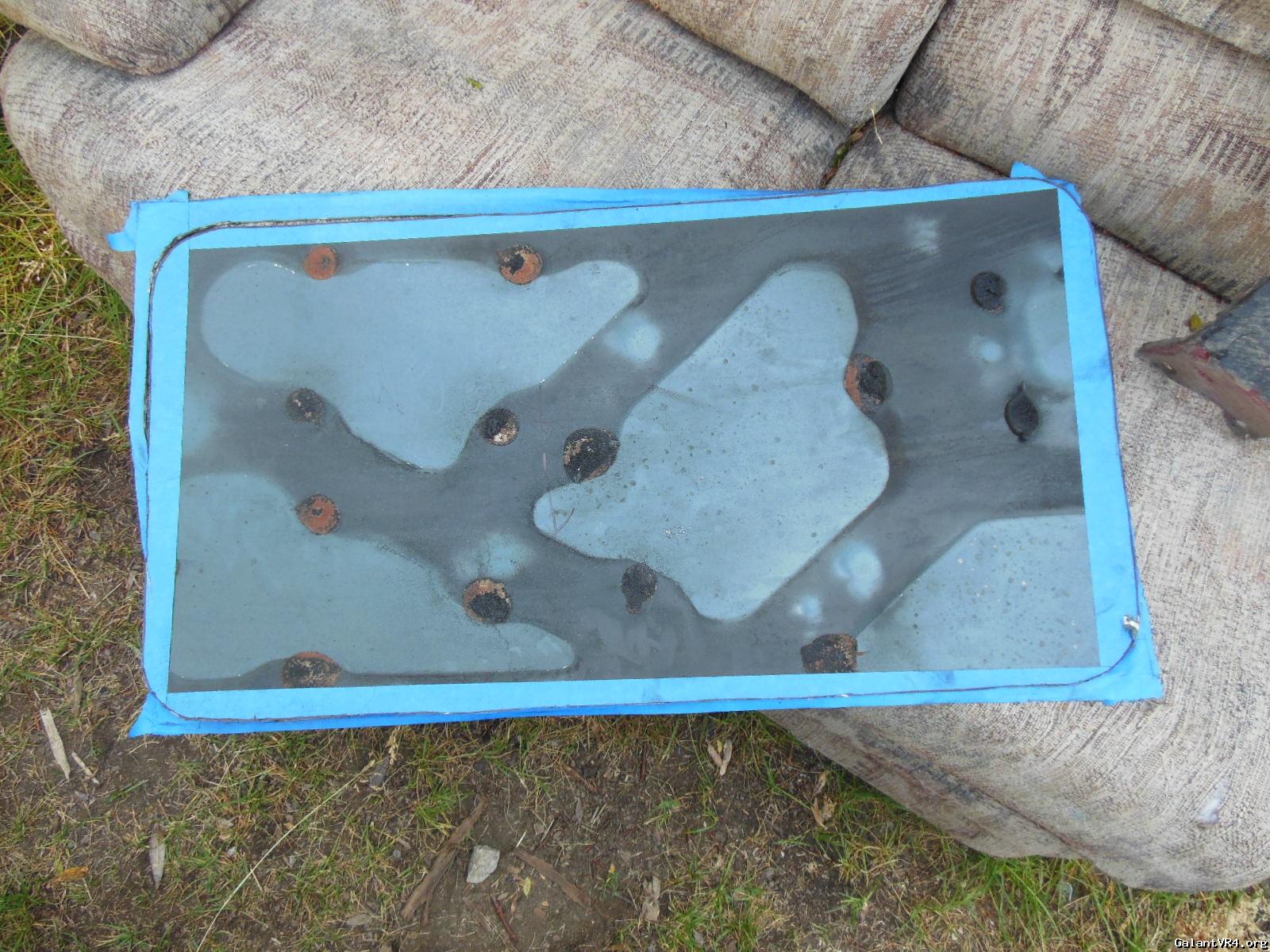

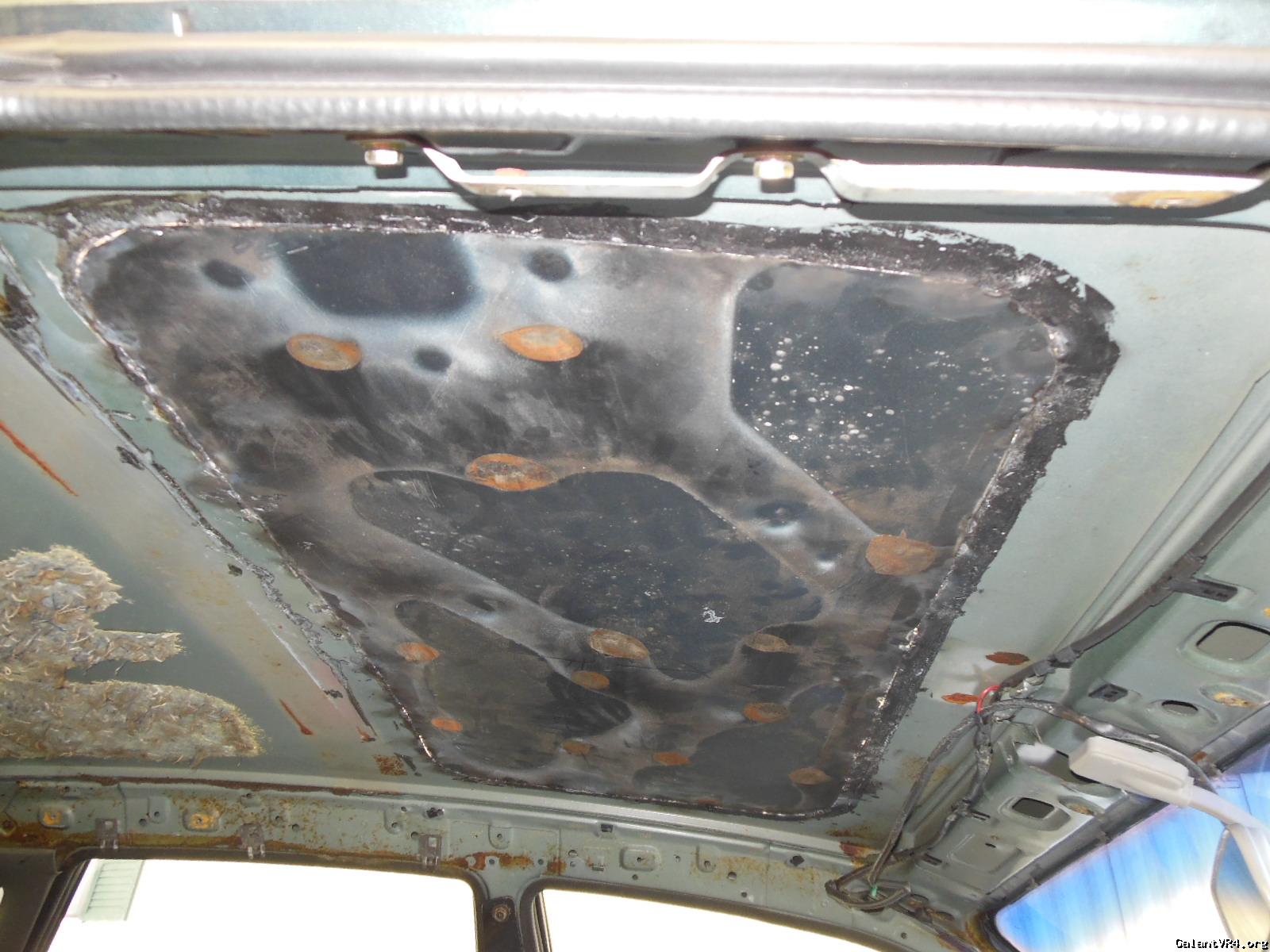

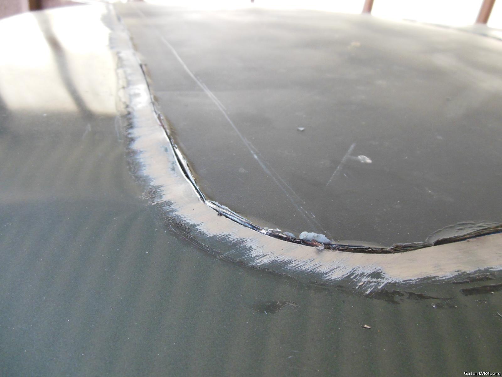

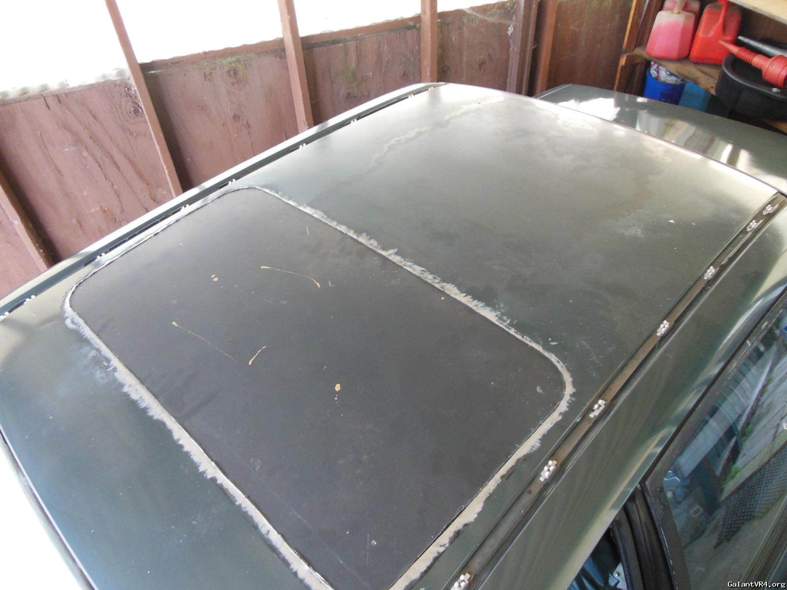

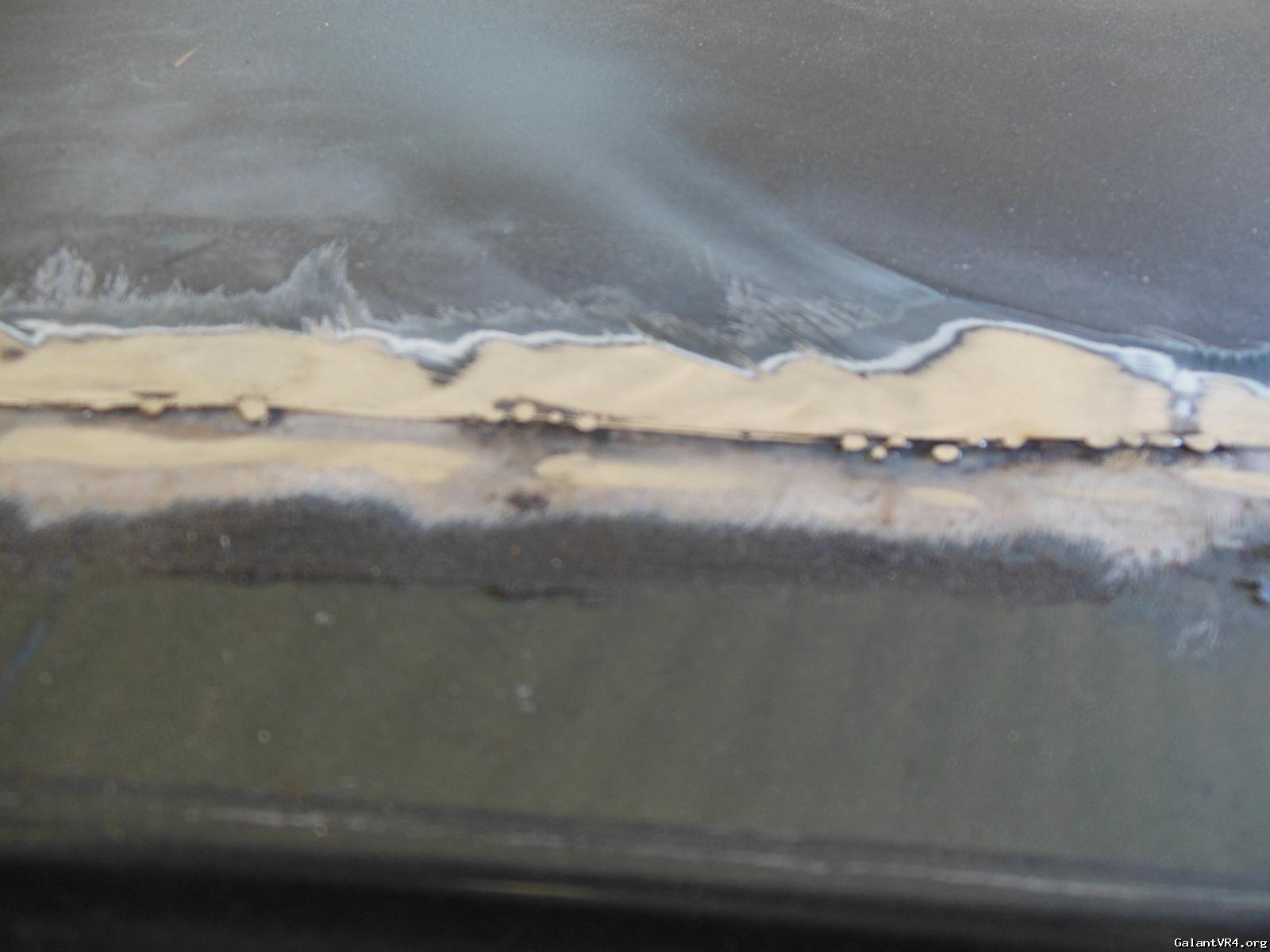

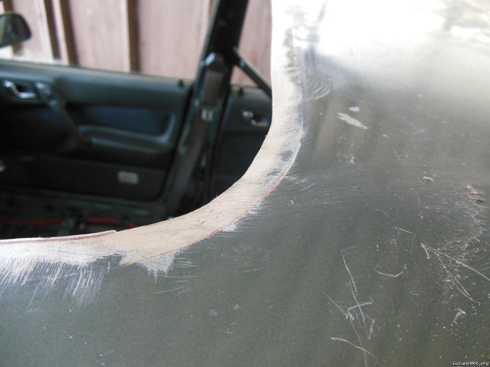

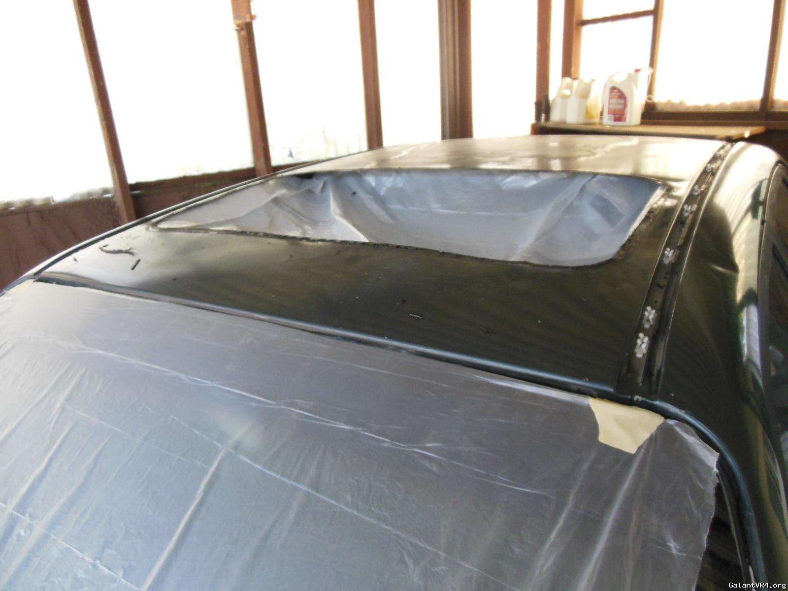

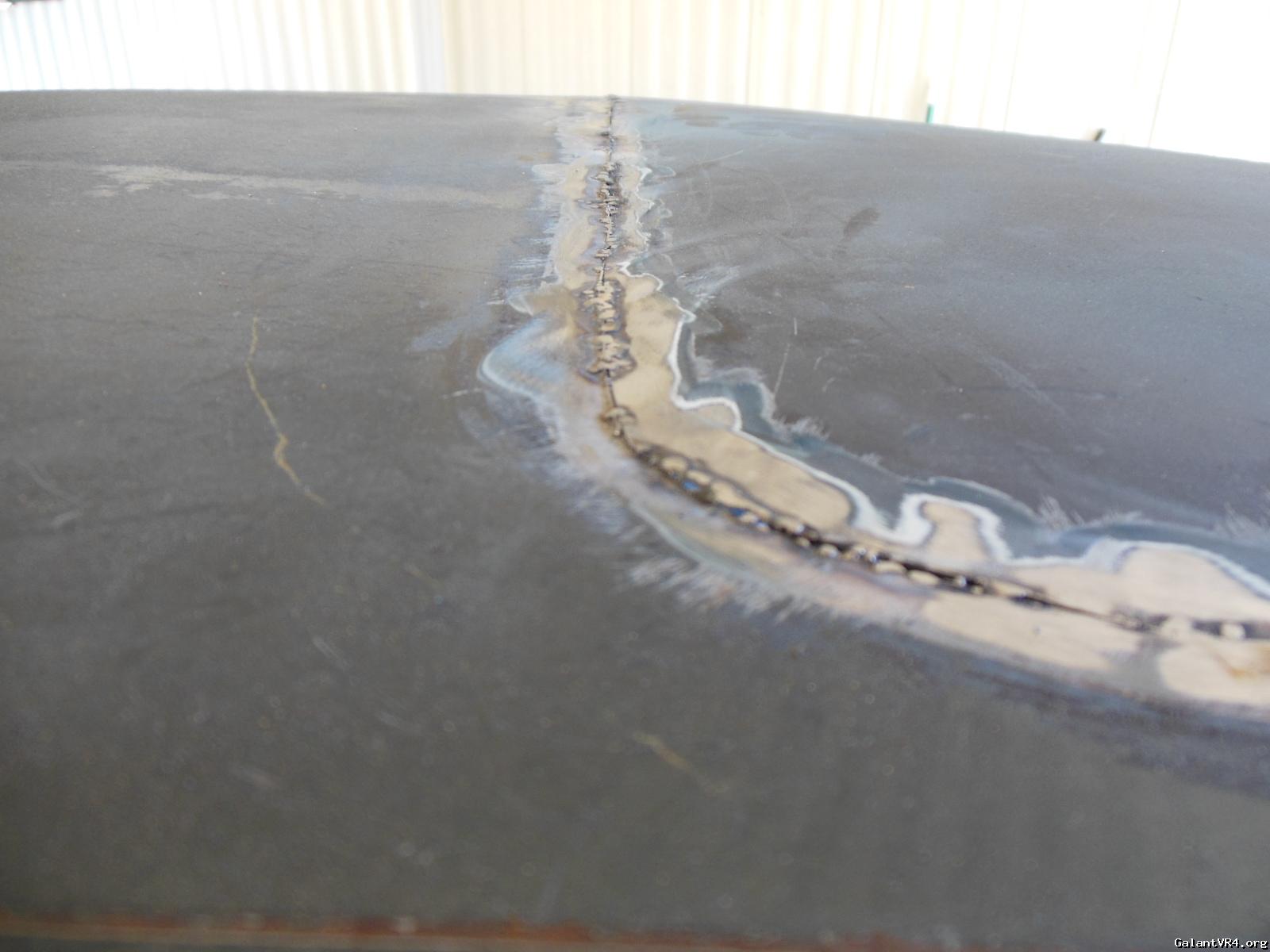

So on the way home from Reno a day or two later i hit a bump on the highway at 85ish and i hear a load thud. i look up and the after market sunroof collapsed in on me. i was just happy that it didn't shatter the glass all over me and the interior of the car. After this happened i took it slow the next 60 miles home and started to gut the car and come up with a solution. i really only have 1 option and thats to put a new roof skin on, only problem nothing close enough. i still use my car and drive it a bunch so i decided to weld the roof shut. i know its a horrible idea and blah blah blah, but the roof was destroyed when the sunroof collapsed. there was nothing supporting the sunroof in the car and when it came down it buckled and waved the roof, so it lead me to weld it shut, put it out of your mind and start looking for a galant in a junkyard close enough and pull the skin from that.
this is just the start i still have a lot of work to do and a long, long way to go. it also doesn't help that im not all that good at welding. i can do an exhaust,but its not pretty.

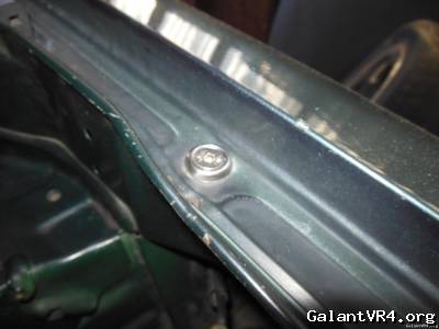

that is how i feel and thanks for approving this! i thought and still think im gonna get sh*t for this. i think one thing that saved me from the glass breaking was the fact that i have a threespeed harness bar in the car and it prevents the B pillars from flexing.
11,009
Most of the aftermarket sunroof installs I have seen are absolute crap, with no thought to strength retention. I think it is a good idea to remove it.
strokin4dr
Aug 30, 2005
2,773
Savannah, GA
My first VR4 had one of the dealer installed sunroofs in it. Pure junk. The cut of the center roof support to install it and botched the headliner.
If you end up getting a new skin for it, make sure to grab that center support too!

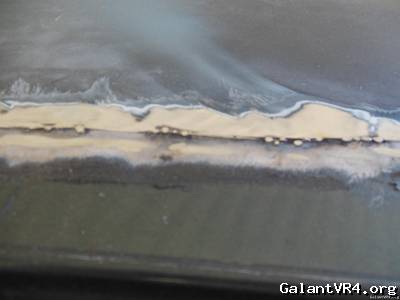

I'm sure the patch panel will be fine for now. It looks much better than I was expecting before I saw the pics, haha.
3,479
That sucks about the sunroof, Shane. Fill, sand, rinse, repeat. Eventually, you'll get it flat.

So glad it didn't come apart and fall on you at interstate speeds. You might not be here to tell us about it if it did.
I remember my wife and I looking at a car a while back and it didn't have a sunroof. The sales person said we can add one for you and you'd never know it didn't come with it from the factory. I quickly said no thanks and told him we'd wait to find one with a factory sunroof, no aftermarket junk.
May I suggest you using a fiberglass or aluminum reinforced body filler for the first coat? They are quite a bit stronger and water proof. Then go back with a standard body filler to get it perfect.
