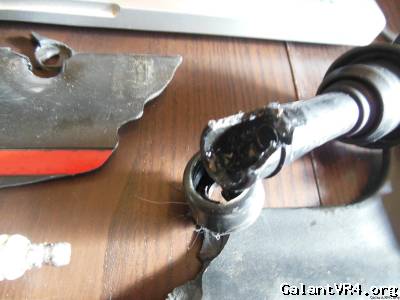

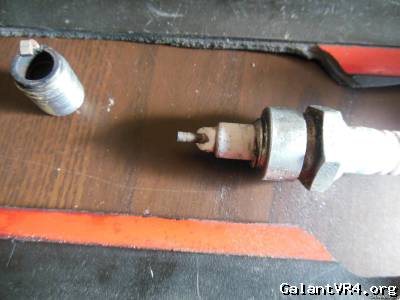

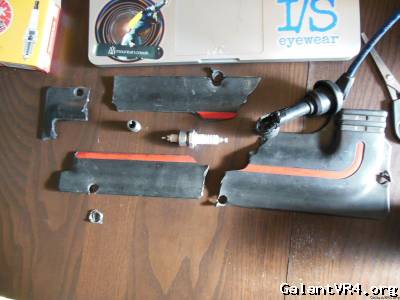

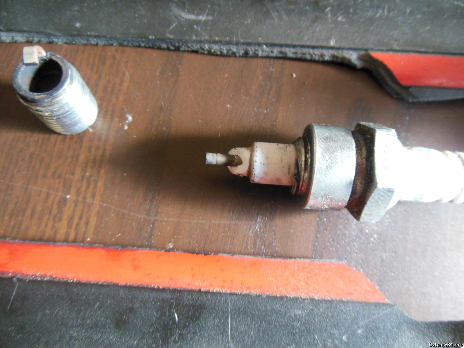

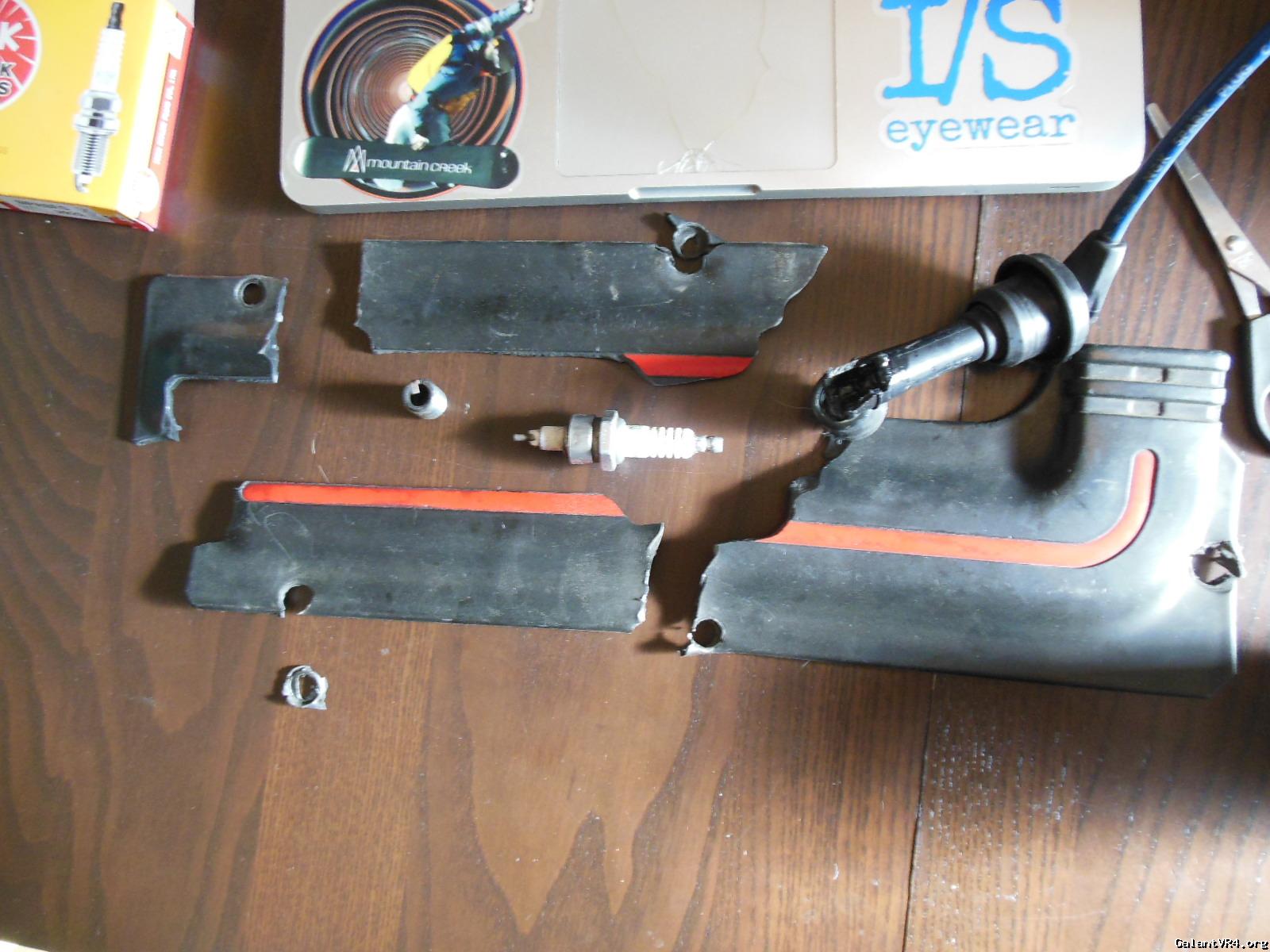

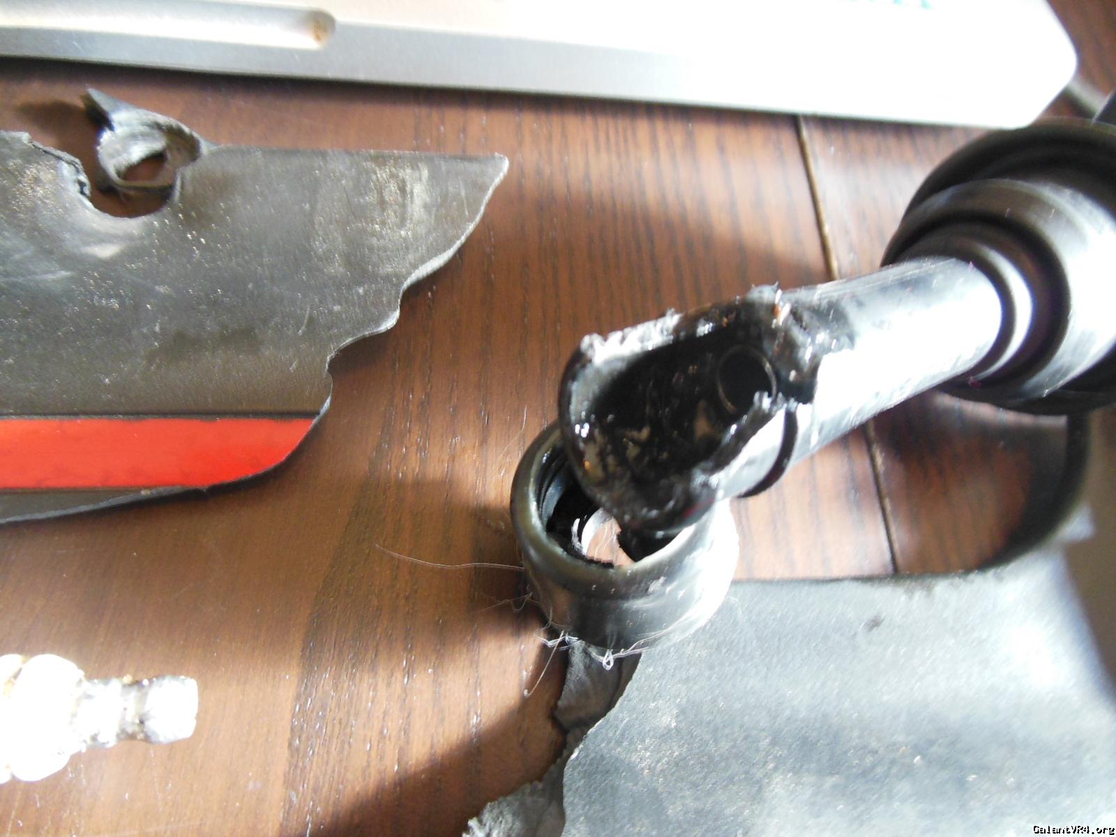

last night i was out and i made a second gear pull and this happened. im just super happy i was able to remove it with ease.

I think i might have over torqued them, but they have been in the car for over 1000 miles, so im baffled as to how it happened so far down the road. i thankfully had a set of new plugs laying around and a local DSM'er had a set of MSD 8.5mm wires so i got those and the car is up and running again and happier then when it was on the 7mm wires. i might go out today and do some light tuning on the car.

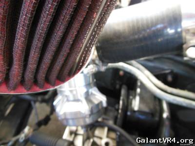

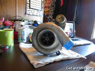

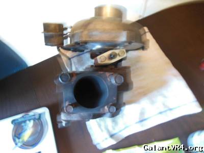

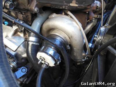

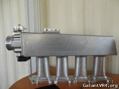

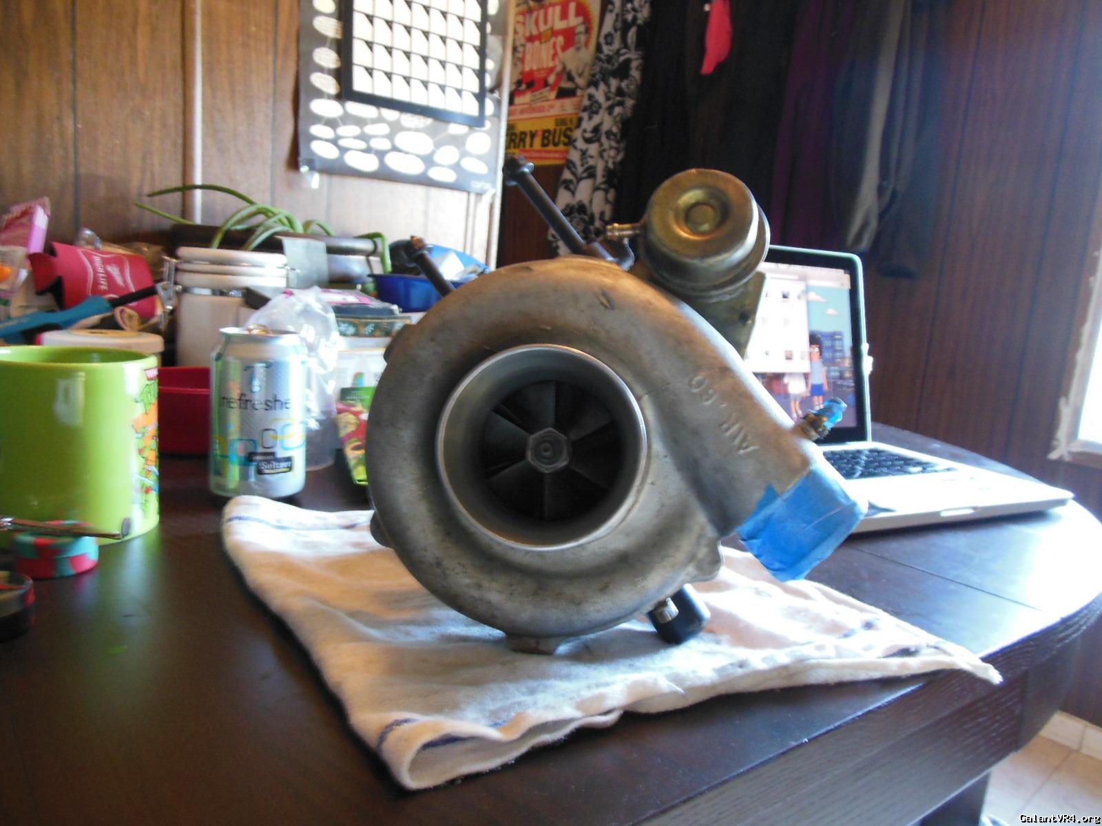

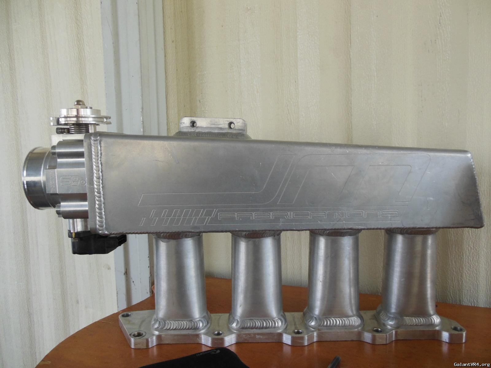

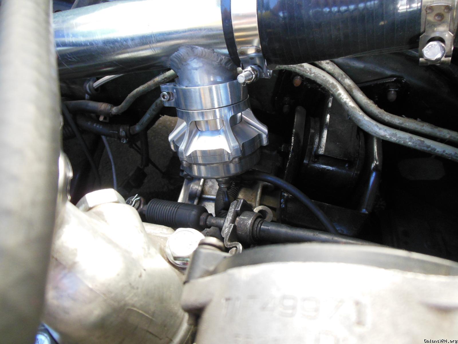

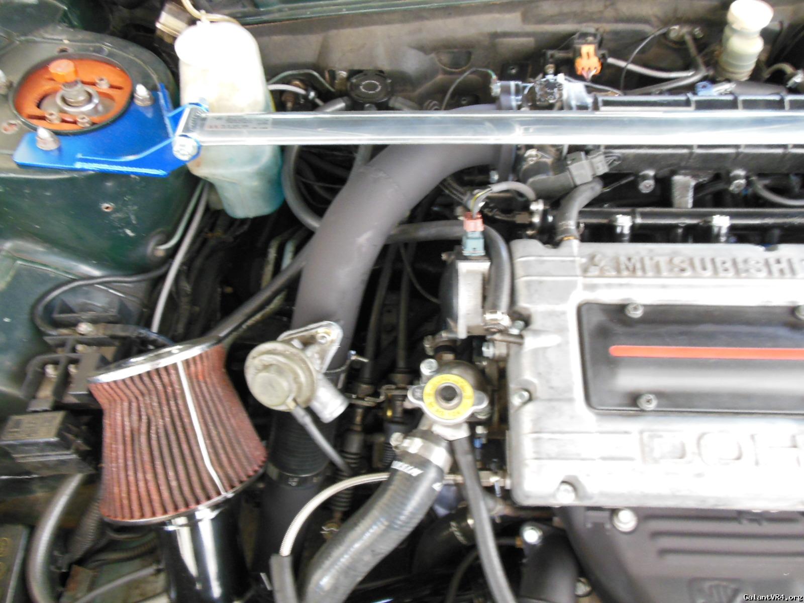

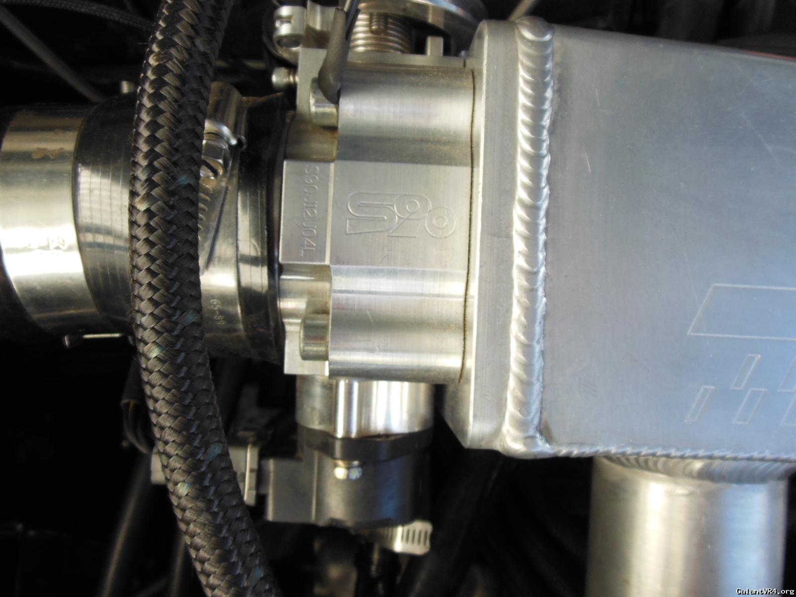

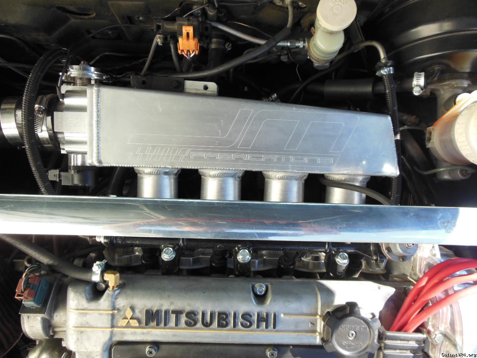

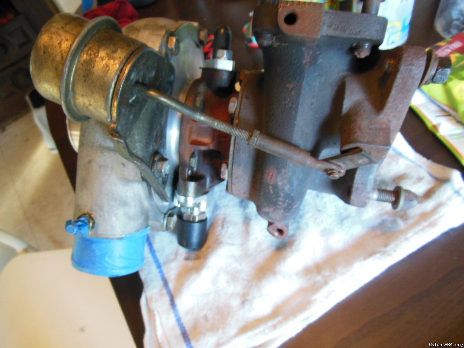

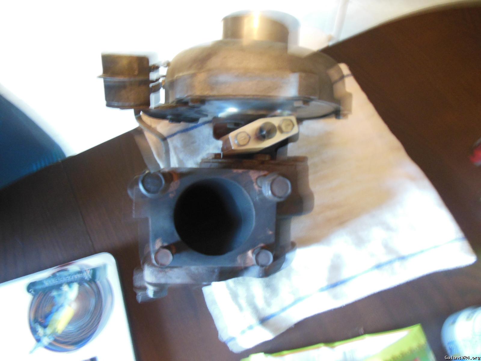

things have been great with the car till the other day when i went out and the turbo sounded like a super charger from -3 to 5 psi then normal till full boost. no smoke, no leaks, a lot of in and out and side to side shaft play. car still runs fine and turbo hasn't hit anything and all the fins look good. so i have had a little pile of parts off to the side and i think its time for them. JMF SMIM, S90 3" throttle body, tial 50mm Q bov, PTE SCM6152E, BC 272 cams, Gates kevlar timing belt with all new timing components and i might do my meth kit and a 90 OFH and add an oil cooler into the car. should have most of it done today, pictures will come later.
well starting point

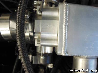

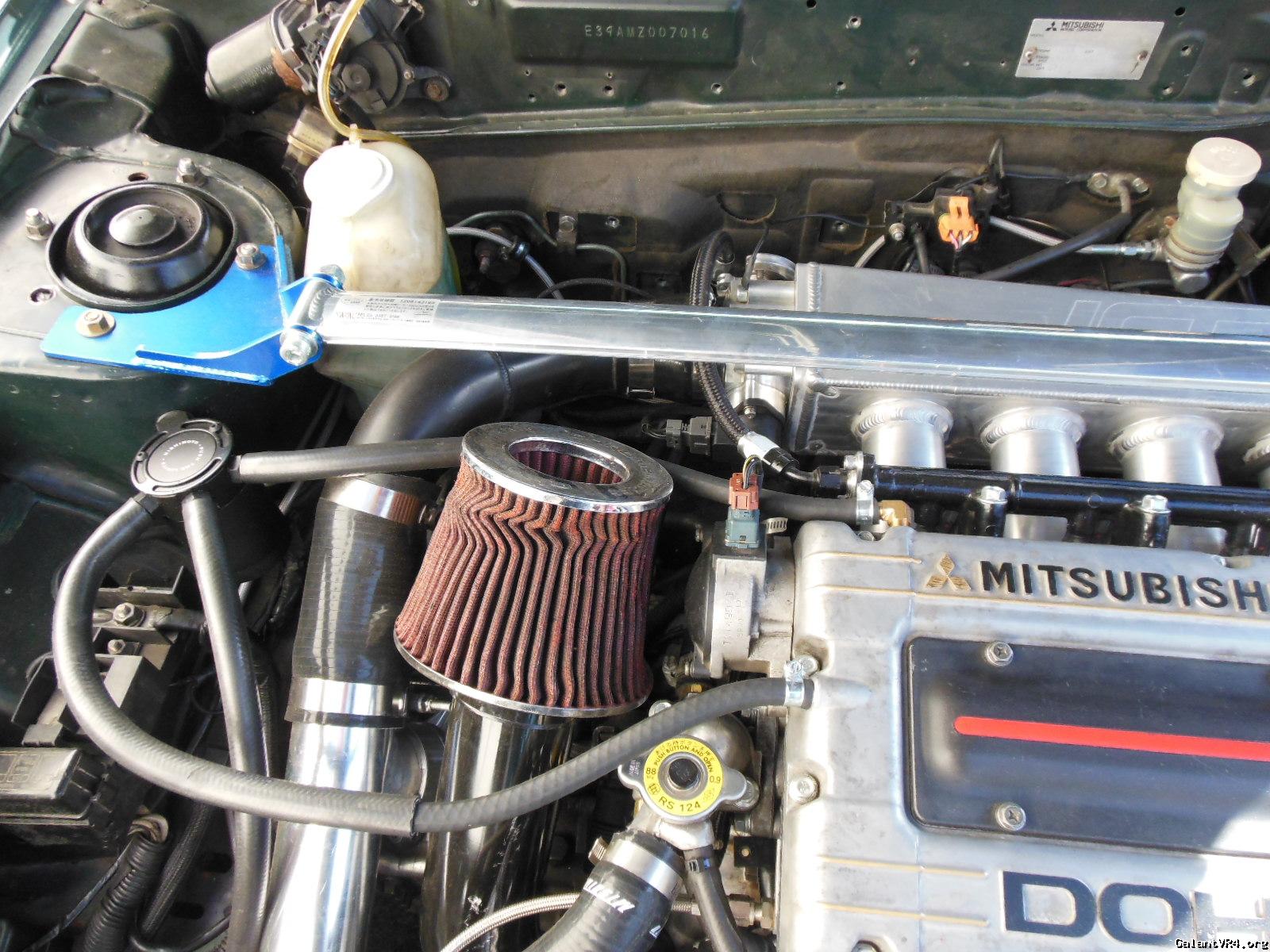

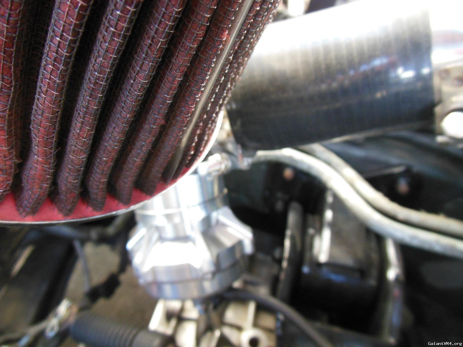

intake and TB
transparentdsm
Jul 27, 2011
3,690
Cherry Hill, NJ

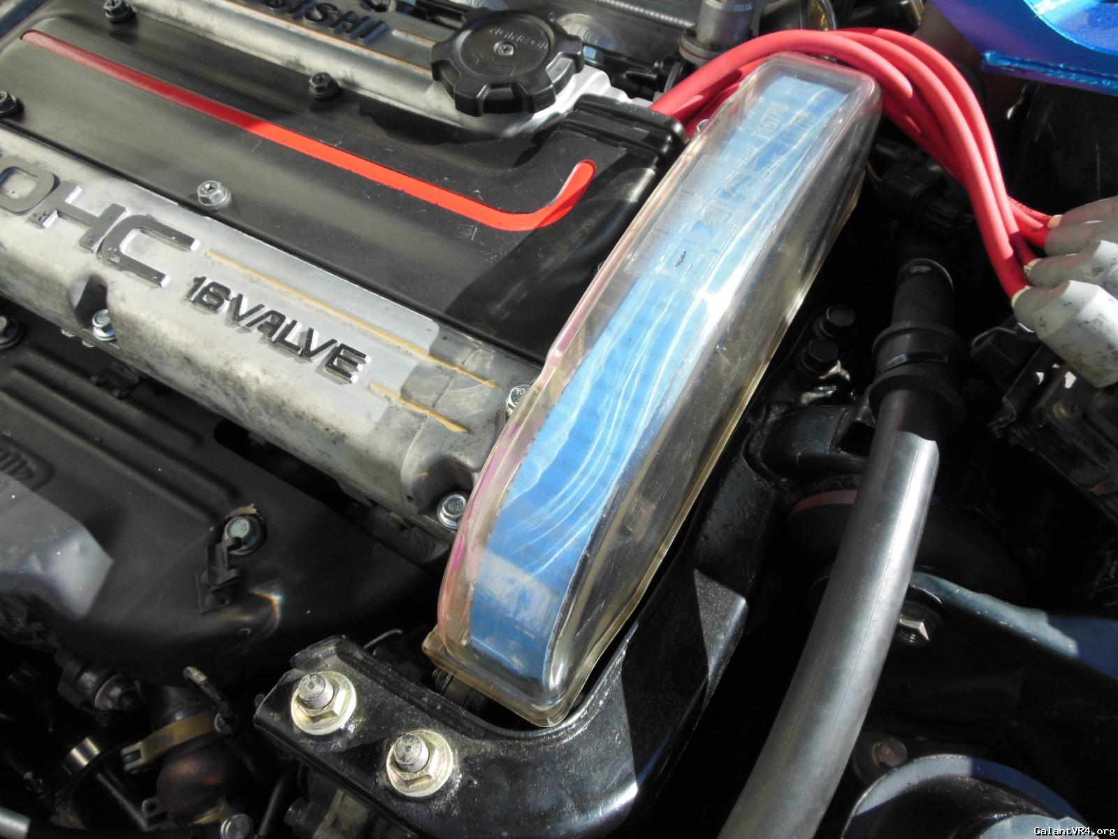

and i ended today without doing the turbo, ofh or meth kit.

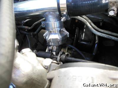

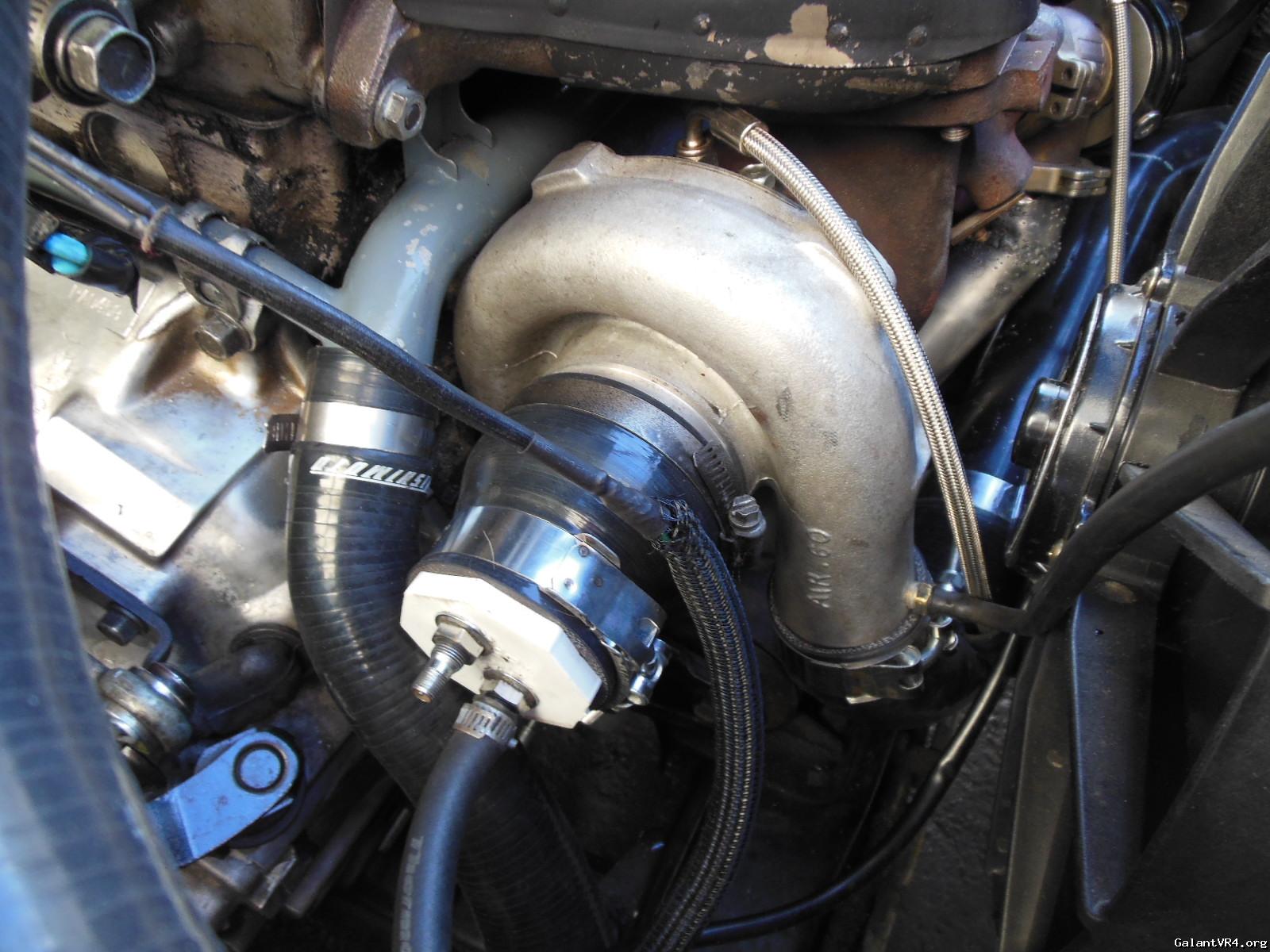

here is the new turbo

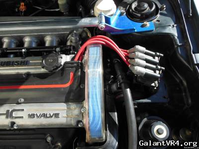

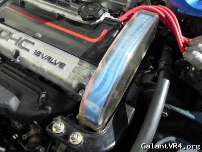

and everything i did today, i also went back to my HKS clear timing cover

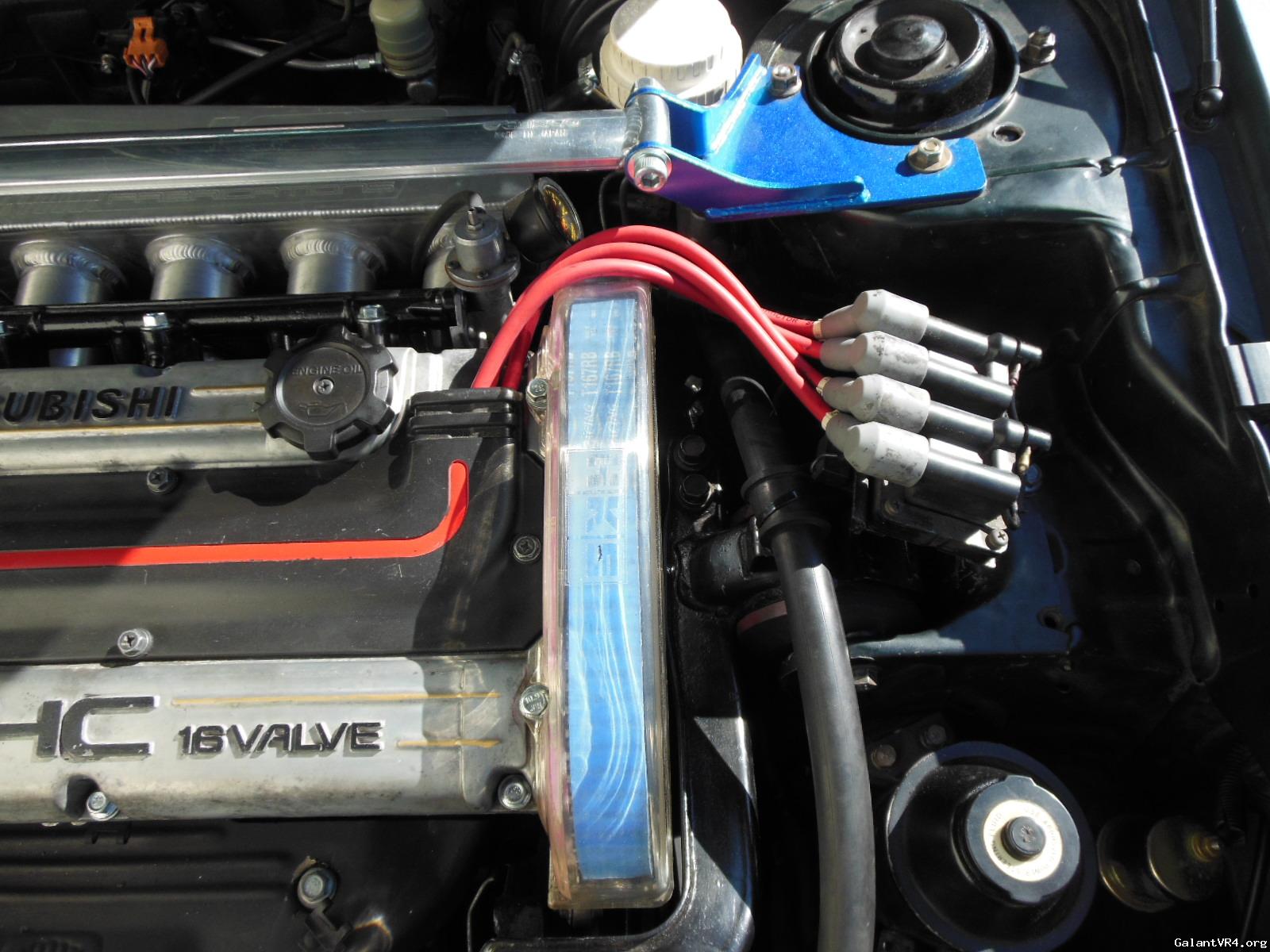

so i tried out using a COP set-up because of the SMIM, but the car ran like crap on it. i had 8.5mm wires laying around and they made the car run nice.

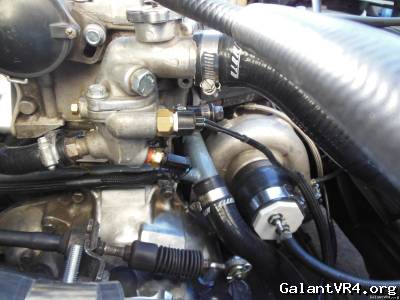

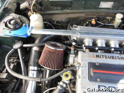

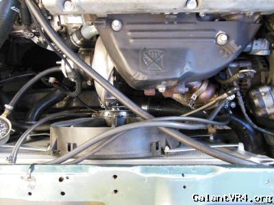

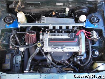

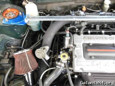

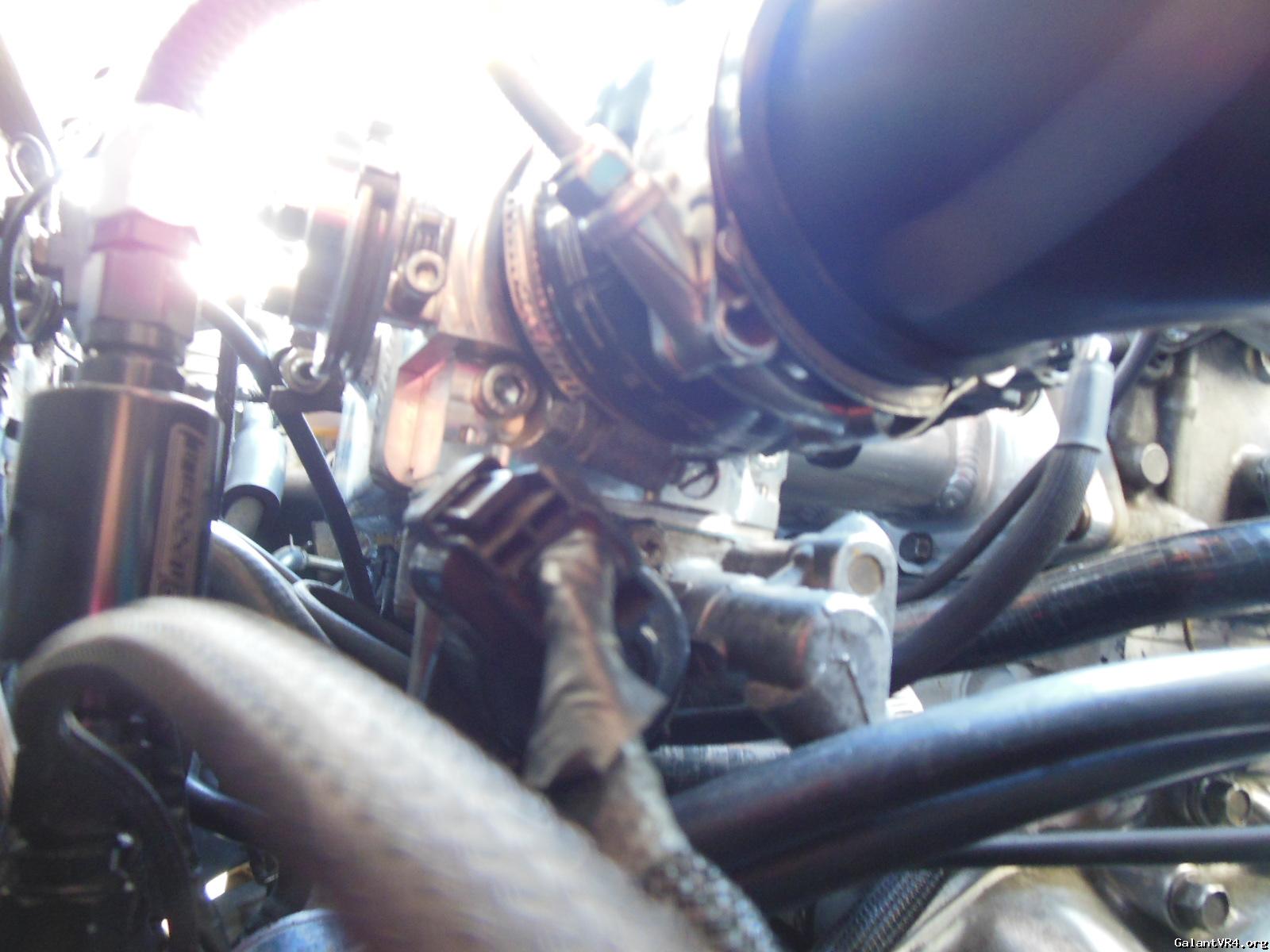

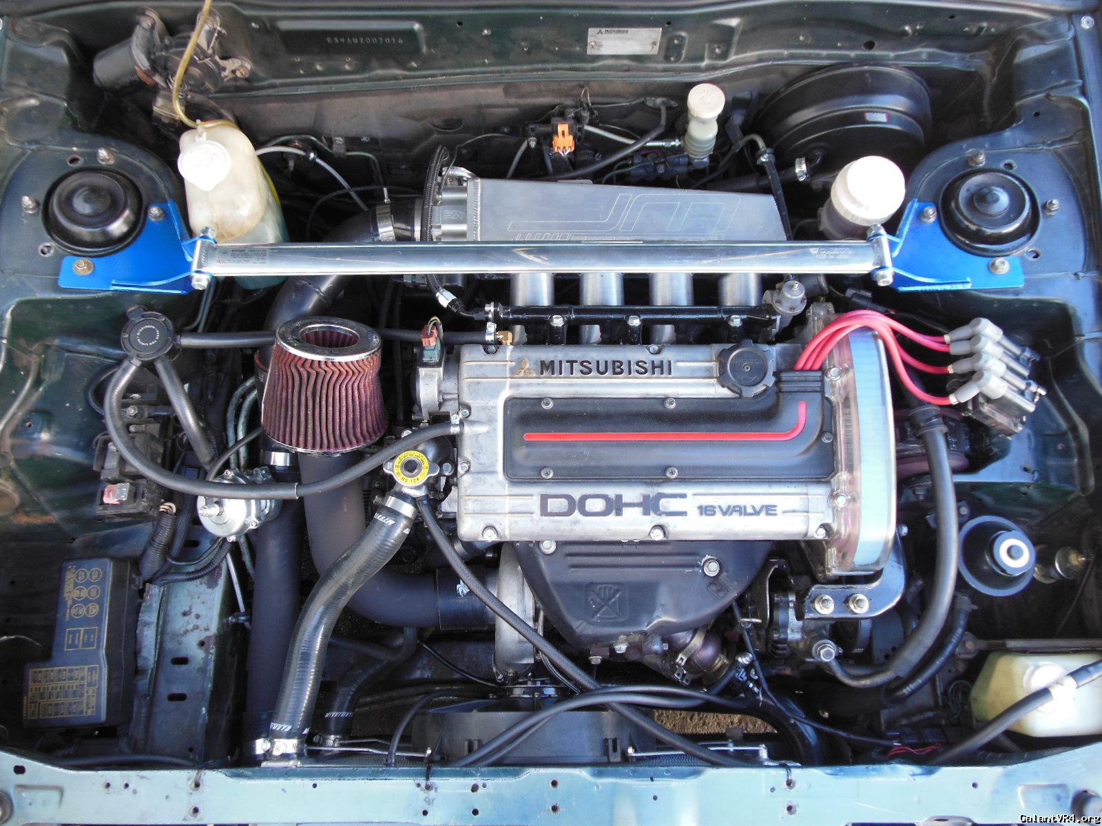

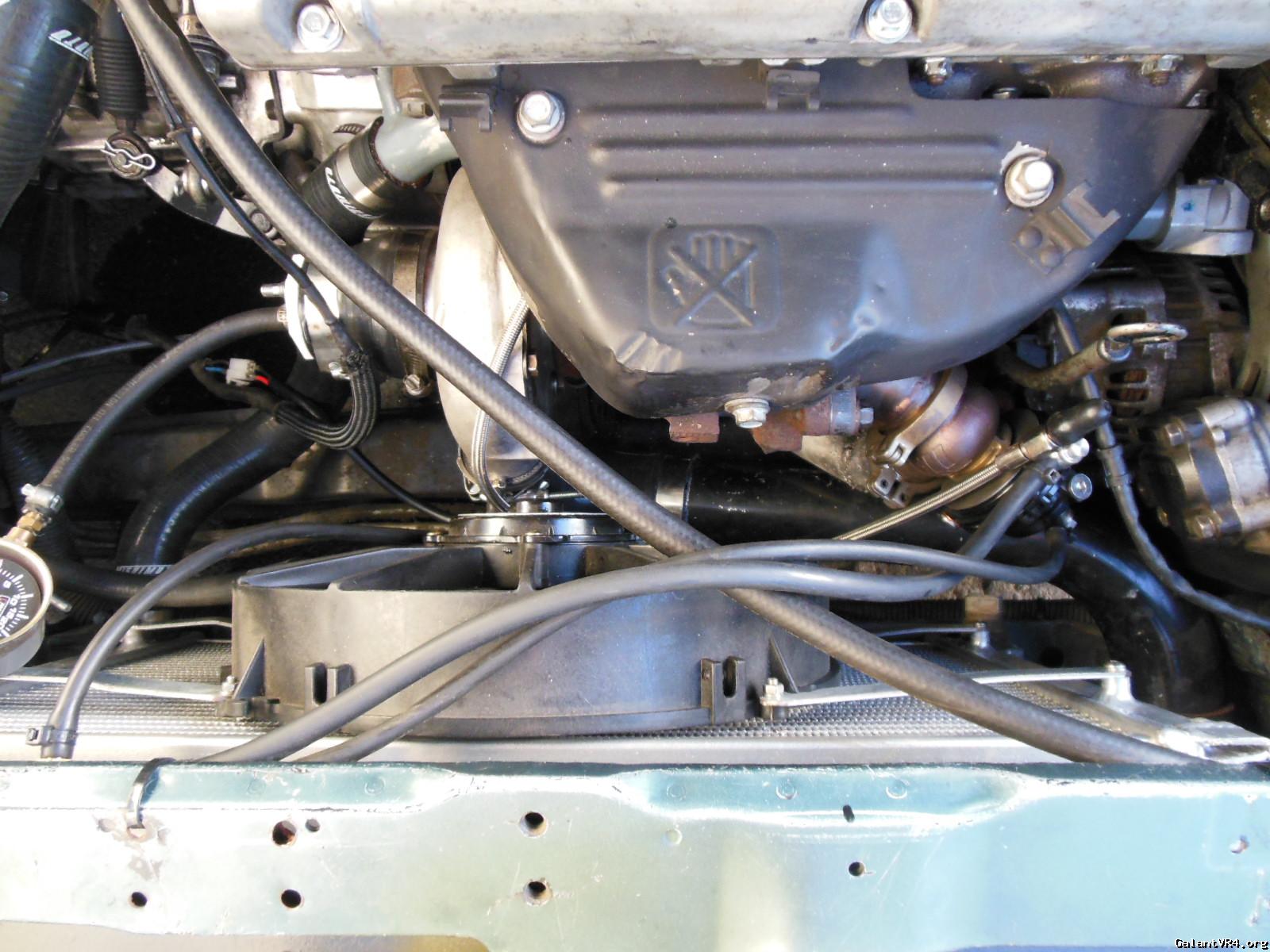

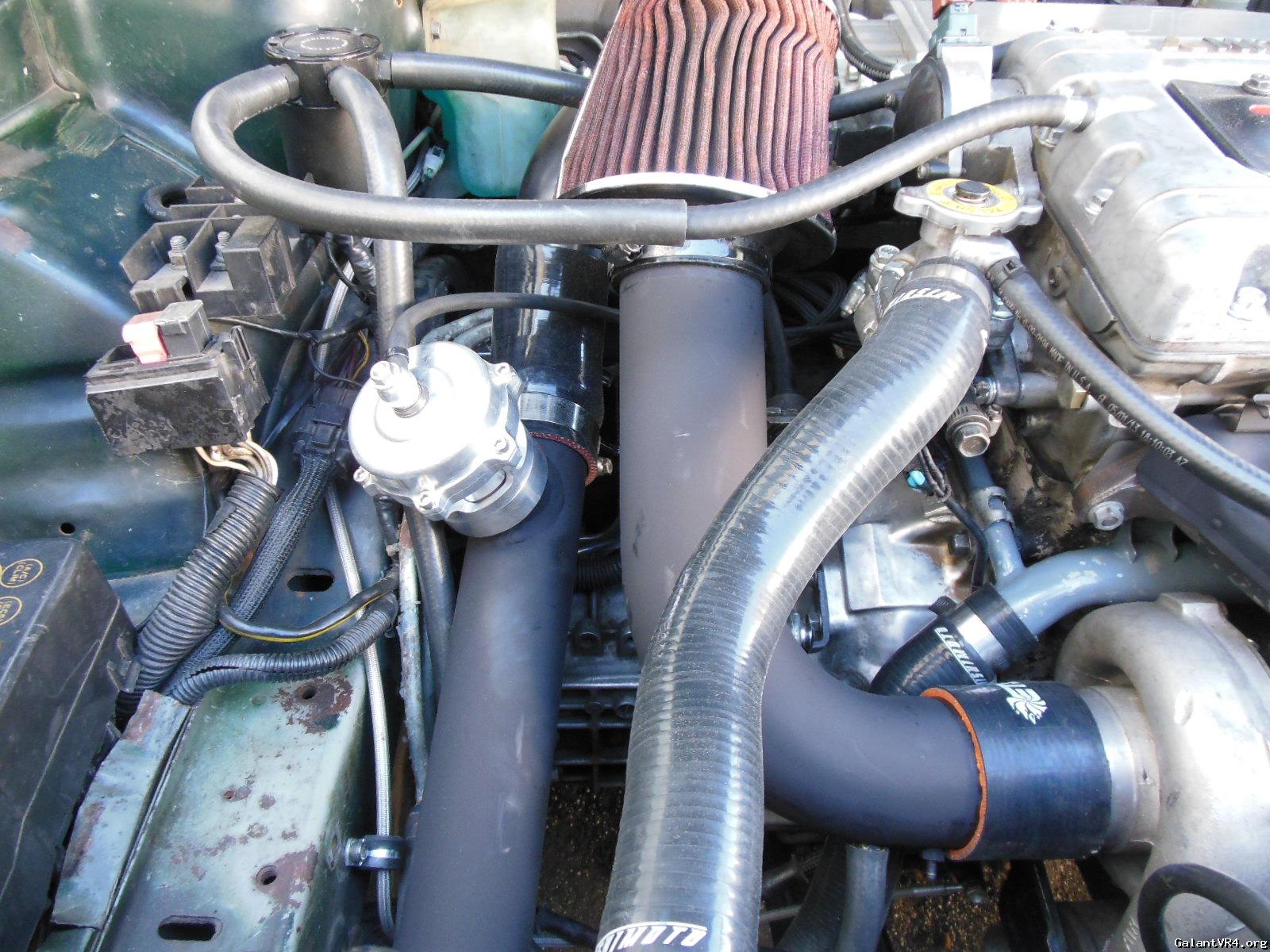

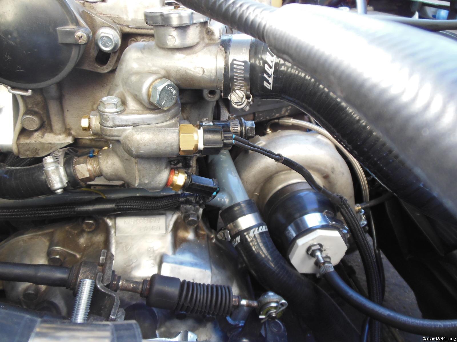

got everything in and together, started the car up and its leaking a little coolant from the water pipe right at the water pump. it leaks about a 1/2 and ounce and then stops once warm. i ran 5 heating cycles all with the same results. took the car on a light drive and it didn't leak at all. I then went on a 70 mile drive, no leak, no overheating. still need to address the water pipe issue. after boost leak testing i decided i didn't like how things were configured for the intercooler piping and that it was half chrome/half painted so i took it apart, cleaned and painted it all, reinstalled and then boost leak tested again. this is currently how the car sits and i hope i can leave it this way for a little while.
while i had the intercooler piping off i thought about how much i disliked having to hold the throttle for a few seconds when first starting due to there being no ISC, so i pulled it off and put on in.

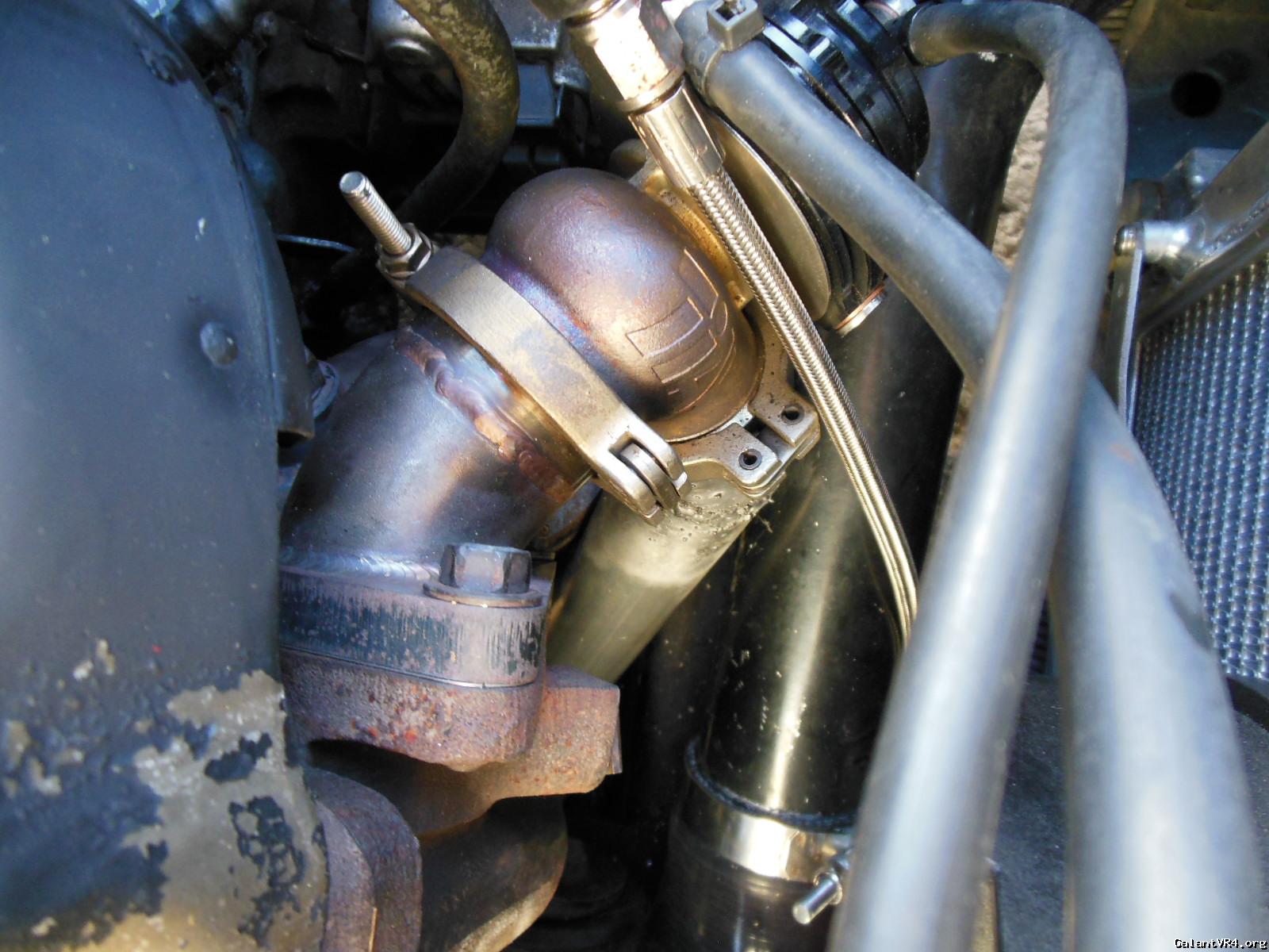

2 things came into factor. 1 im no longer running a FP race manifold, im now using a evo 3 ported manifold. 2 after a few thousand miles all the fiberglass and heat packing started to break apart and leave dust and fibers everywhere in the engine bay, after seeing this i decided i no longer wanted to use it. i pulled the manifold off and compared it to the evo 3 and decided the evo 3 would be more then suitable for my needs. i made these discoveries and decisions while removing the 16g and installing the 18g.
