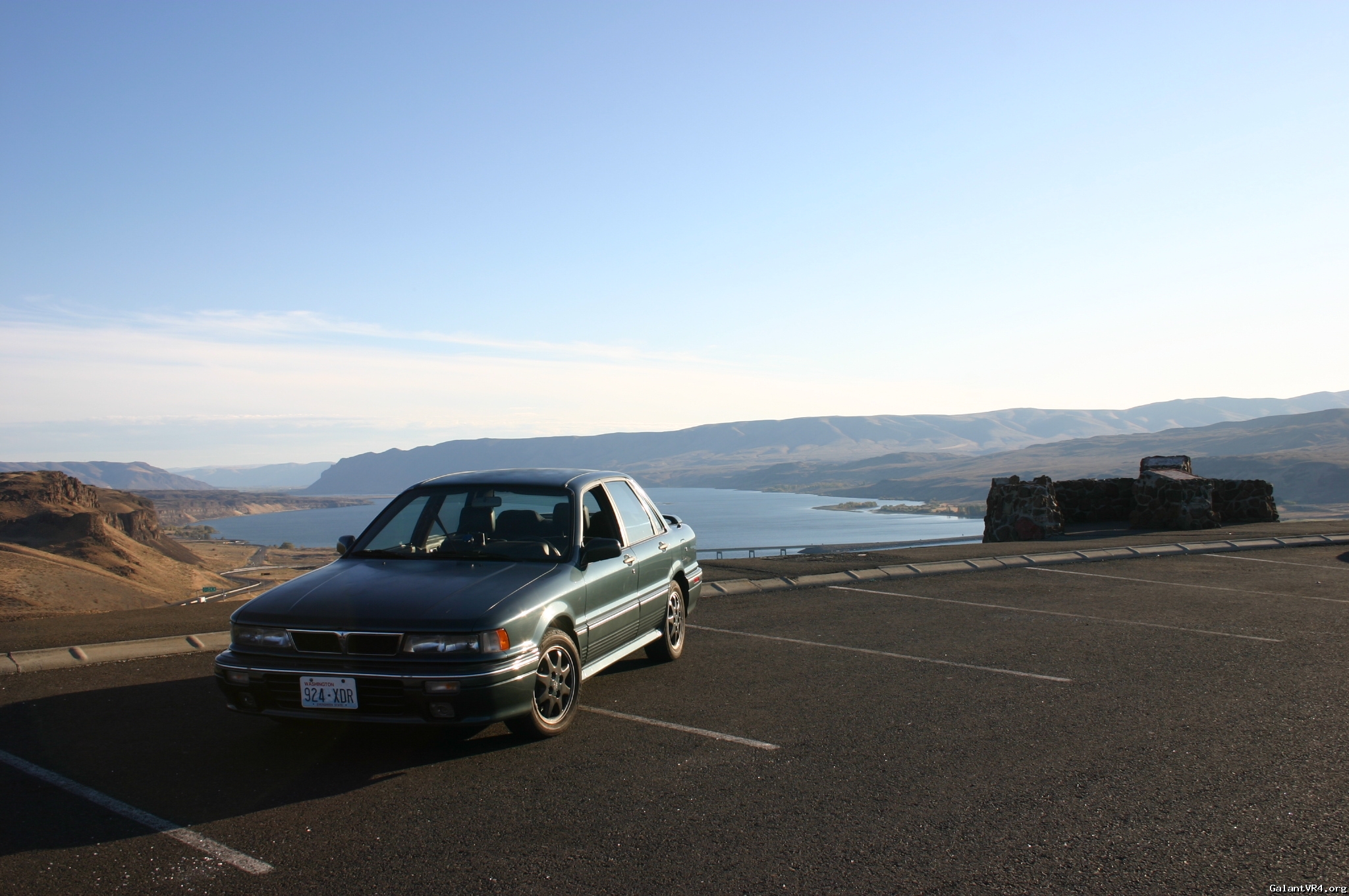

Shortly after I picked it up. Drove from Vancouver, WA to Bellevue (near Seattle), to Post Falls, ID (near Spokane, WA), back home. 2 day trip, around 900 miles. Kind of a brave thing to do. This was taken somewhere in central Washington.

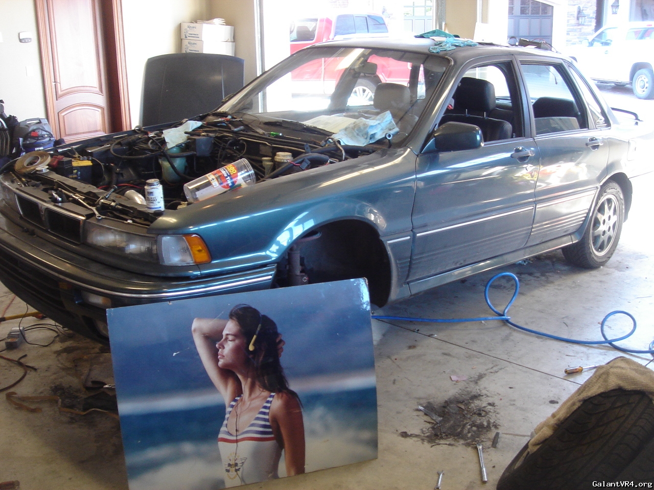

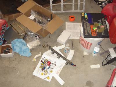

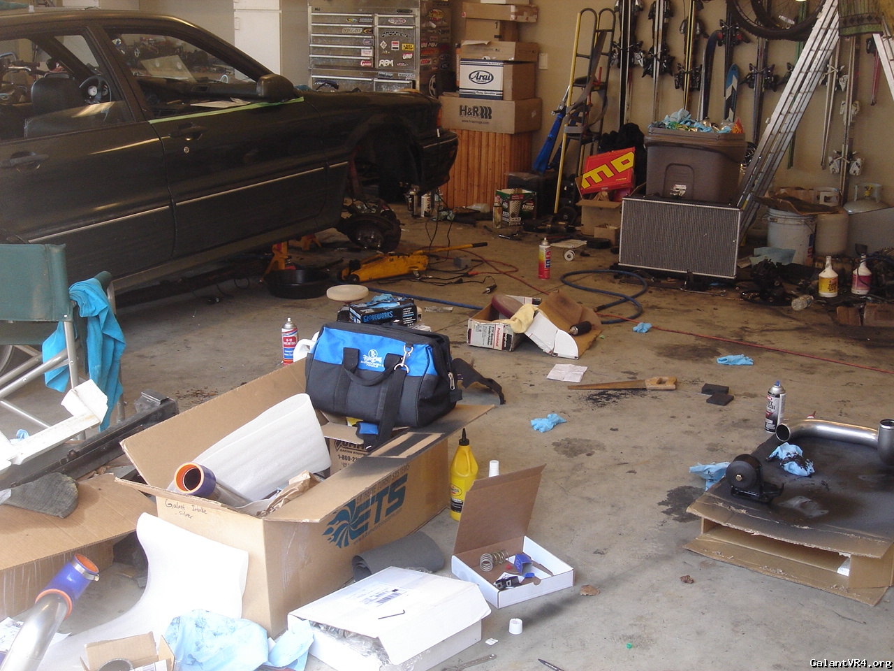

Some of the mess
From the recent group buy

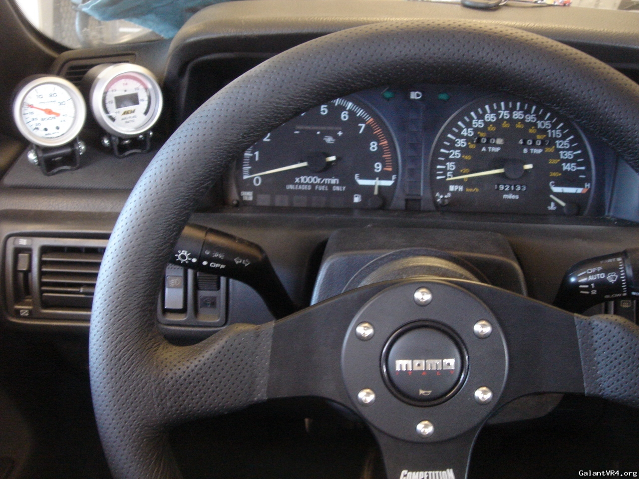

The cockpit

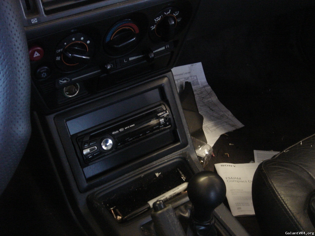

Radio, DSG knob, TEL shifter

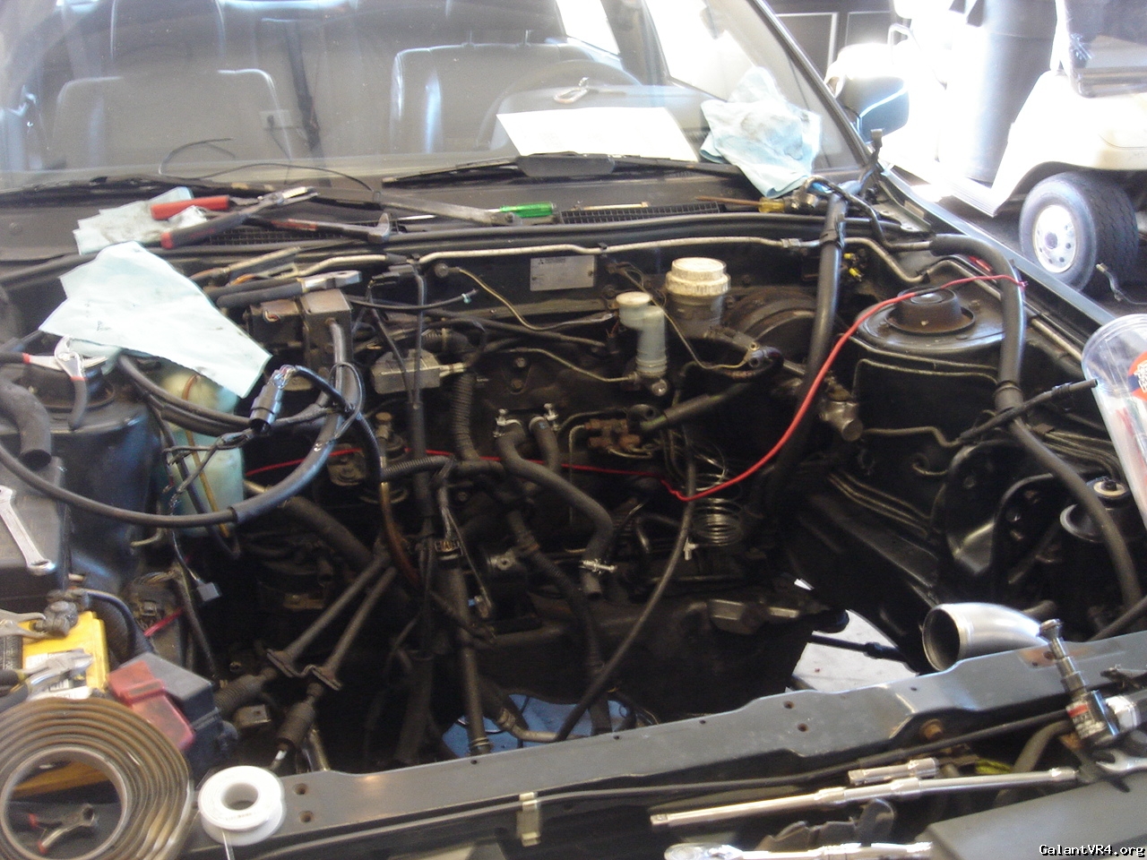

Empty bay

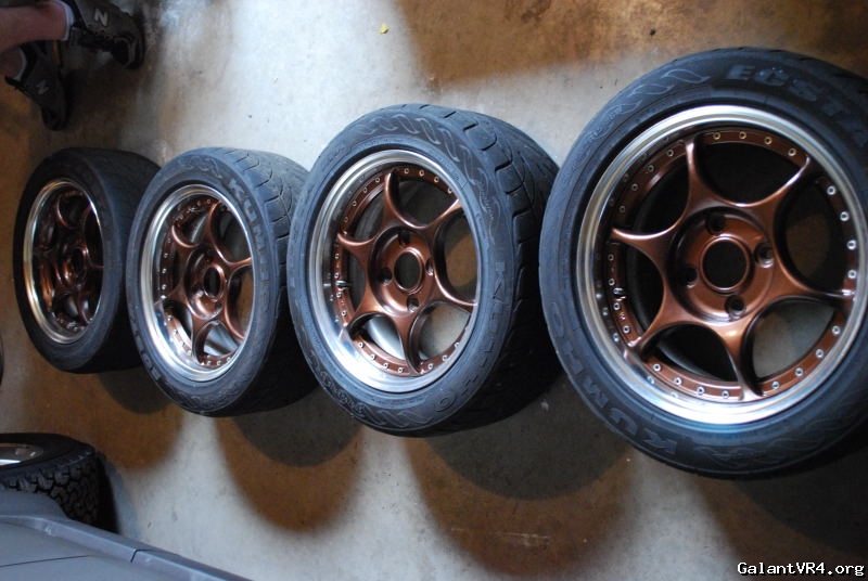

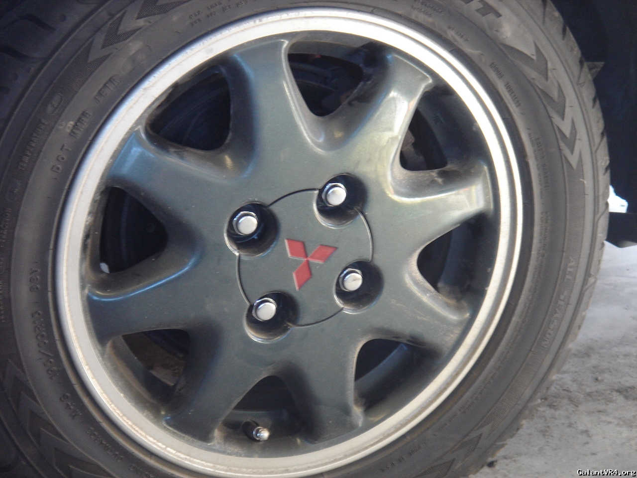

Reconditioned wheels, just dirty - pretty happy with the outcome

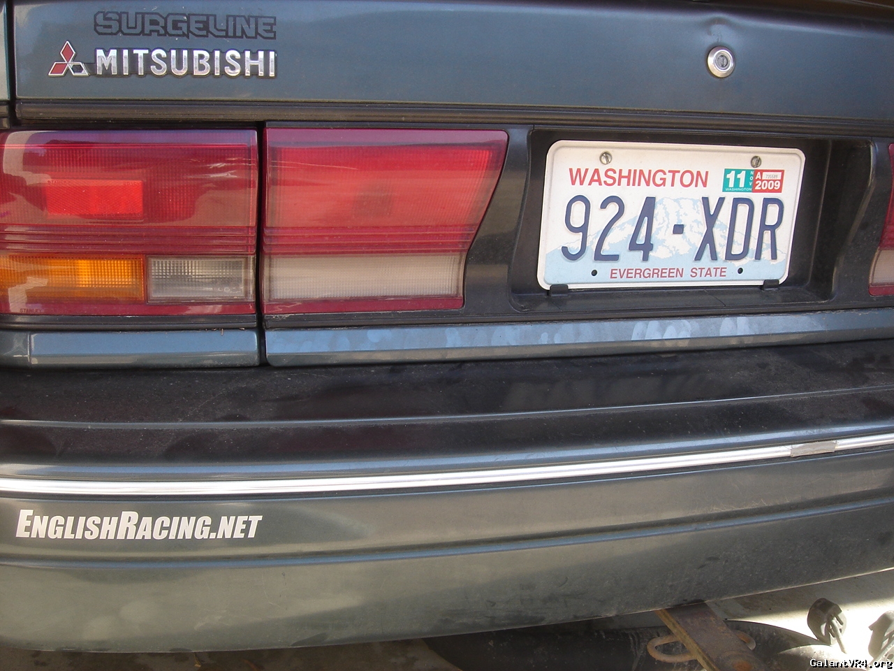

English and Surgeline, need to get a decal from Jesse. Im going to finish off that hitch with a ball for kicks and giggles

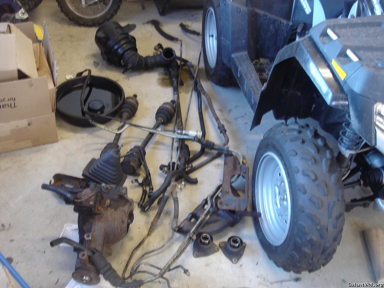

some of the parts that were ripped out. The stock turbo, intercooler, and piping was sold to my cousin, he turbod his jeep /ubbthreads/images/graemlins/dunno.gif

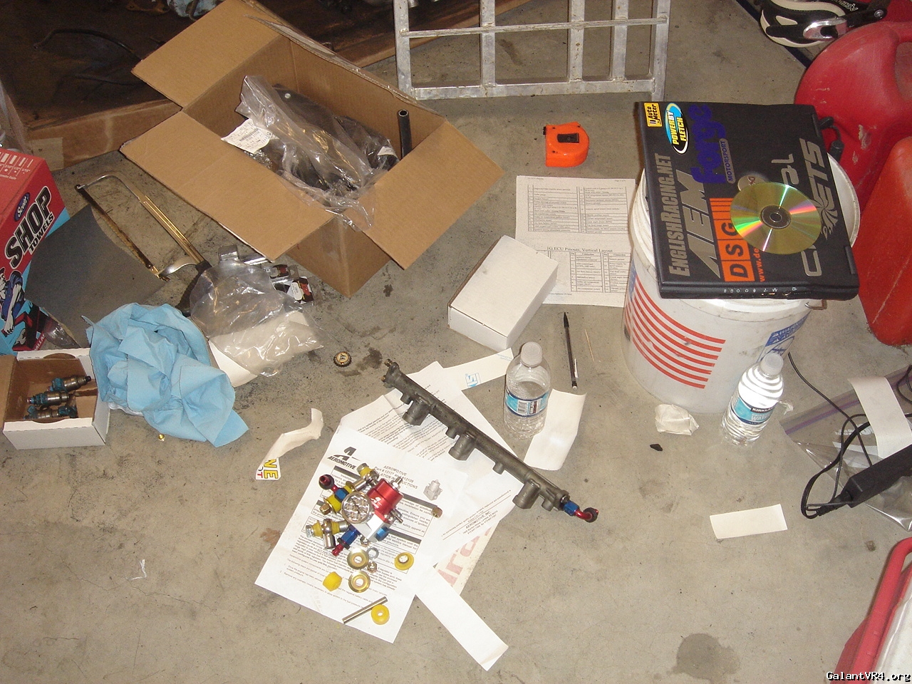

Fuel sytem goodies, and then some. This is an E85 build, 1250cc FICs. inline and intank 255s. Aero AFPR, ect. Rear Whiteline endlinks to compliment the 26mm rear bar. Box of coolant and fuel hoses. All the collant lines are getting replaced.

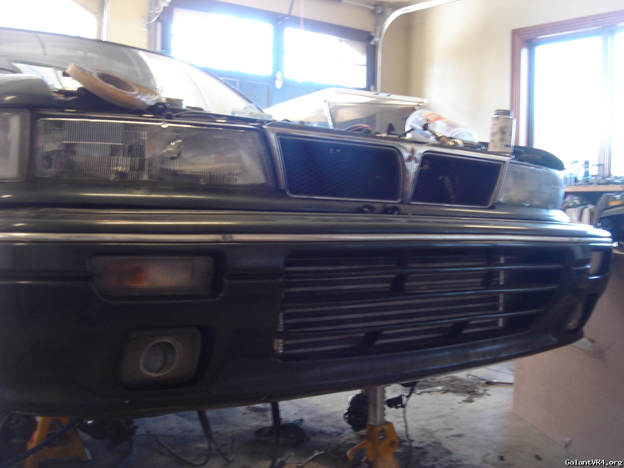

ETS FMIC

Ive been thinkin abnout buying these, but I should spend the money elsewhere - 1991 Advan RRS 15x7. Fresh bronze PC, new stainless hardware. From my understanding, theyre pretty tough to find.

Nice pic of the Columbia River. That's overlooking Vantage, but you blocked the view of the bridge with your car. /ubbthreads/images/graemlins/rofl.gif
Nice gauge mount. That's exactly how I did the gauges in 503.

Thats not the Columbia, It was off of 90, just before it darts north for a short while. It was a rest/scenic stop off of I-90, probably not far from you (well, as close as I-90 is to Yakima).
Im not a fan of A-pillar mounts, I had planned on mounting them there from the start. I saw your ski trip thread and saw your gauges mounted there and that set it in stone. I wish there was a nice mount for that spot (nice as in not carbon fiber). Theyre switched at the ignition on source for the hazards, I used the blank plate right next to the rear defrost to mount a rocker style switch, it turned out pretty clean. I dont like bright gauge lights at night.

Dude, I hate to tell you, but that is the Columbia. In fact, as you drove over the bridge you may have seen a sign telling you so. /ubbthreads/images/graemlins/rofl.gif I know the exact lookout point you stopped at and drive that section of I90 all the time. Hell, I waterskied at Vantage every weekend as a kid.

I see it now. /ubbthreads/images/graemlins/grin.gif
I didnt realize it was still the Columbia up there. Its the same body I was refering to, I just never think of the Columbia flowing through central WA.
How far is that from your place?

It's about an hour away from my house.

If you want them I can let the guy know. He told me $650 for them. Fresh PC and new stainless hardware. Theyre pretty sweet wheels.
I think I'll be going with something larger when funds allow. My account is pretty dry right now.

You get those from Dustin?

1457, those are Dustins, I believe he still has them. Thats his photo from northwestnissans, there werent any hits on them over there and I think thats the only place he had them listed. I like the wheels, I just wish they were a little bigger.
Dustin spent a sh*t-load of money on those wheels. Re-powder coat, polish and all new hardware. I'd try and pick those up if I was you.
