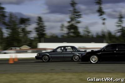

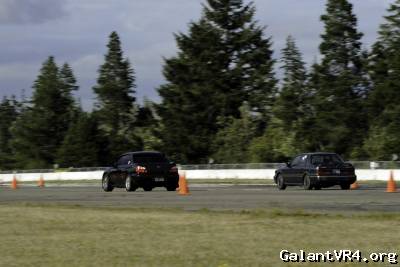

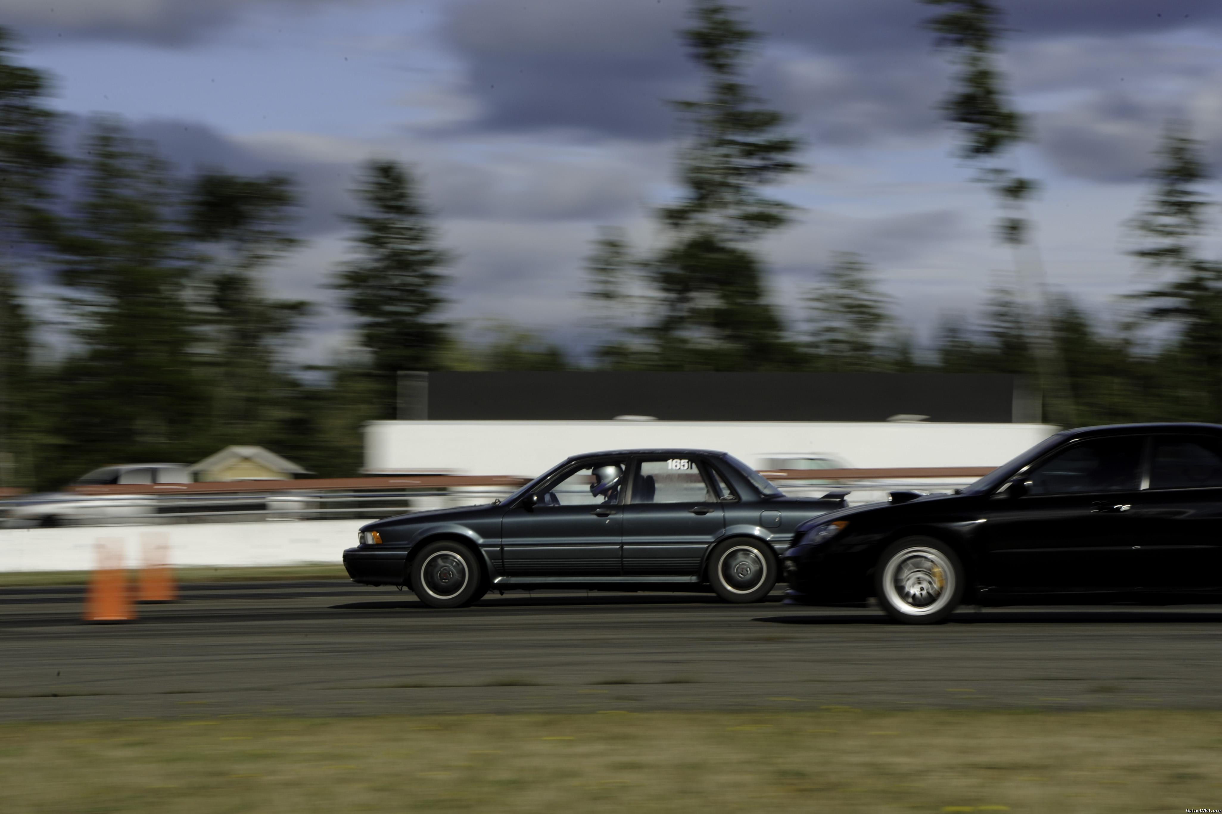

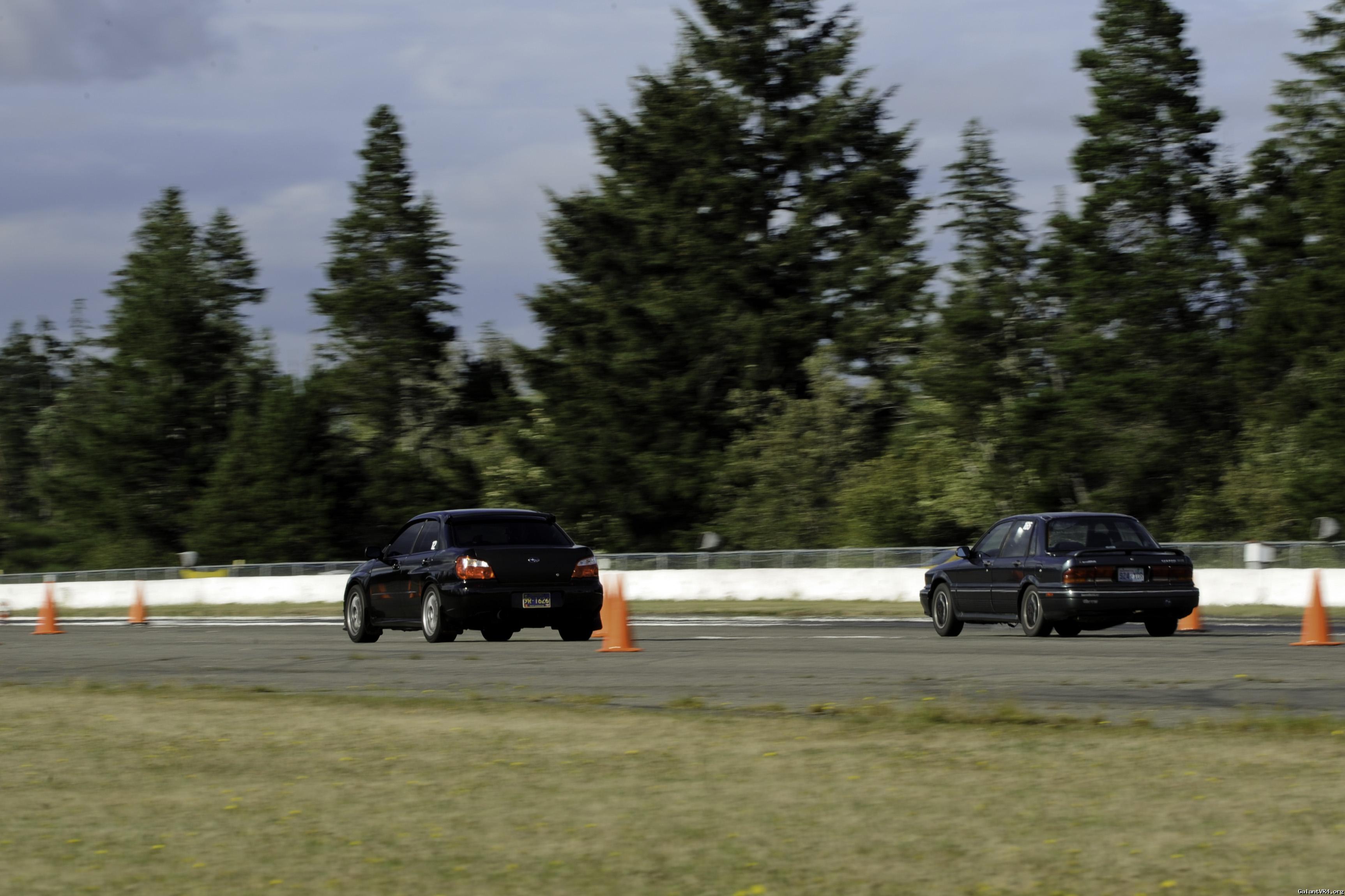

Soooo... i took the car out for some 1600ft roll racing today. Maxed out my little bolt on 30R at 39psi (doesn't hold that out the top, obviously). Take it with a grain of salt, but it logged 60lb/min today for a moment. I suspected it was time for some new plugs and took a spare set with me. I made a pass, and sure enough, it broke up. Threw some new plugs in and made 4 more passes that were absolutely flawless. Not a single issue with the car today. That 39psi spike comes on hard and I went into the day not ruling out it wouldn't load back into the trailer under its own power. I was wrong. The tranny doesn't like to shift and I pissed the clutch off as well. My shifts were .8+ second, so I spent more time off the throttle than I should have. But... its still driving just like it did when I dropped it off last night.
From a 40mph roll, I logged 146.6mph at the 1600' mark. Roll racing like this can be a bit deceiving. The ETS GTR for instance, was only 3.x mph faster in the half mile at speeds well over 200mph from a roll at the shift sector events.
slugs has some video and stills from today. More videos should surface, I'll post them up when they pop up.
I need to get the car on the dyno and see what it's actually making for power.

It might be the broken air vents, they clank around from time to time, but I've learned to tune them out.
Thanks for posting up the pictures and video, Andrew.
