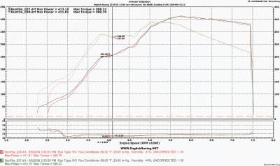

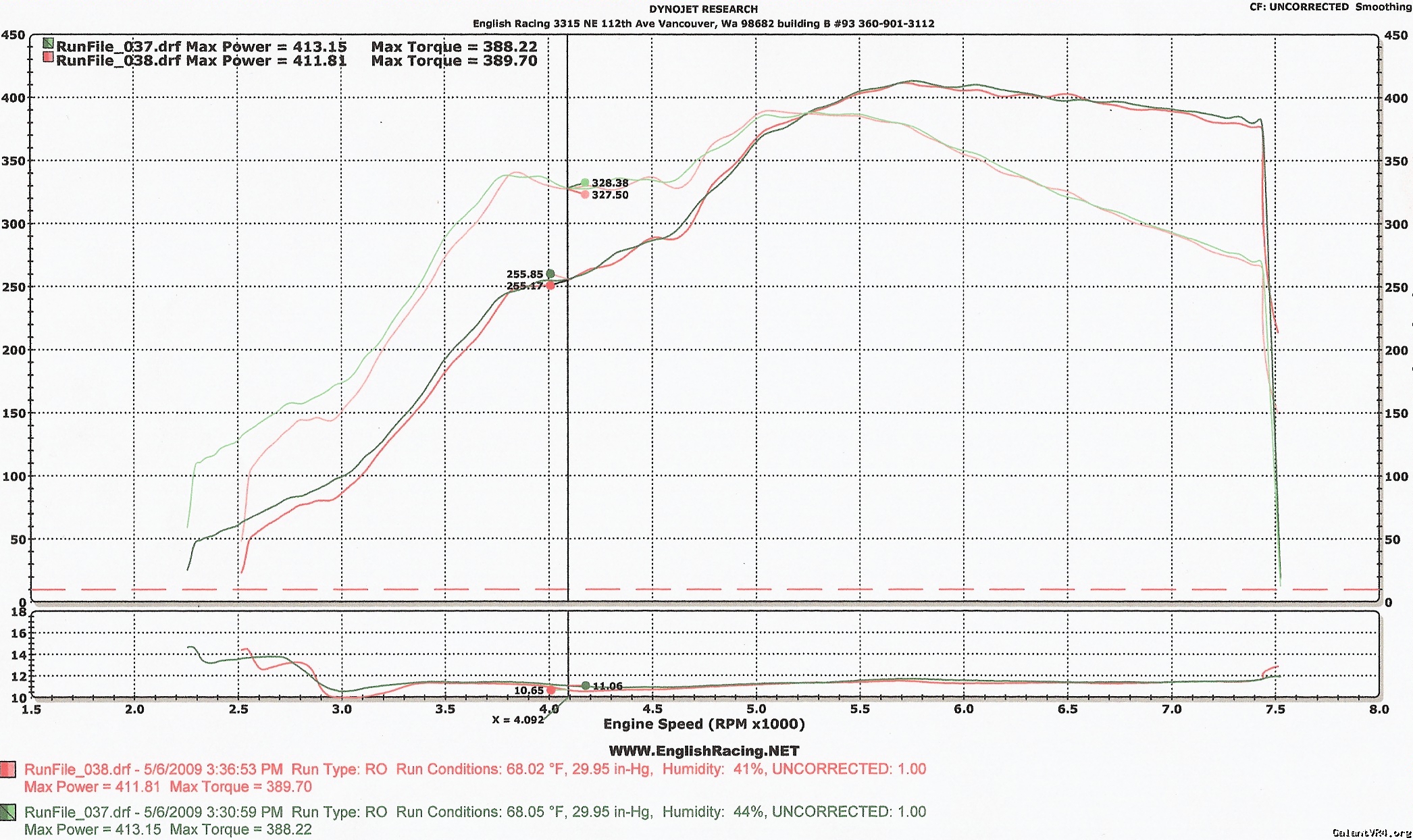

We got that ugly dip out of there today. Added a few degrees of timing. The car is now making 430hp, 417tq. /ubbthreads/images/graemlins/grin.gif

Spiking 37psi, tapering down to 22psi. I forgot that tidbit of info /ubbthreads/images/graemlins/blush.gif
Went 12.0 a few times tonight at 117. A little upset I didnt break 11s.

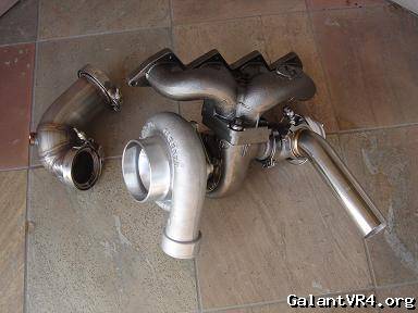

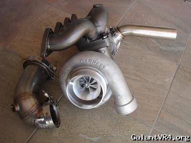

Some of you may know, the 16G seized up on me. 2 months later I finally received my FP DSM76. Its a GT3076R HTA with the FP DSM hotside. I got some eBya strut tower bars as well today, but those arent much to look at so Ill spare the photos.

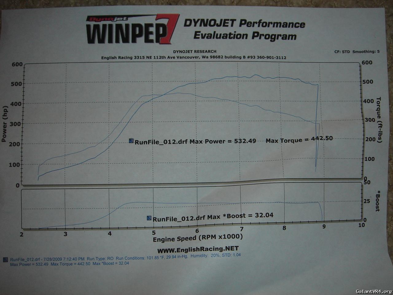

We played on the dyno a little today. With Bluemax 1250s and a stock 2g MAF, we got 530hp at 32psi and we were running out of fuel. We still have work to do and get it set up on speed density. I have never driven anything this quick before, what a trip. Its currently at 513hp and 30psi. It was over 100 degrees today, too, which didnt help the numbers at all.
