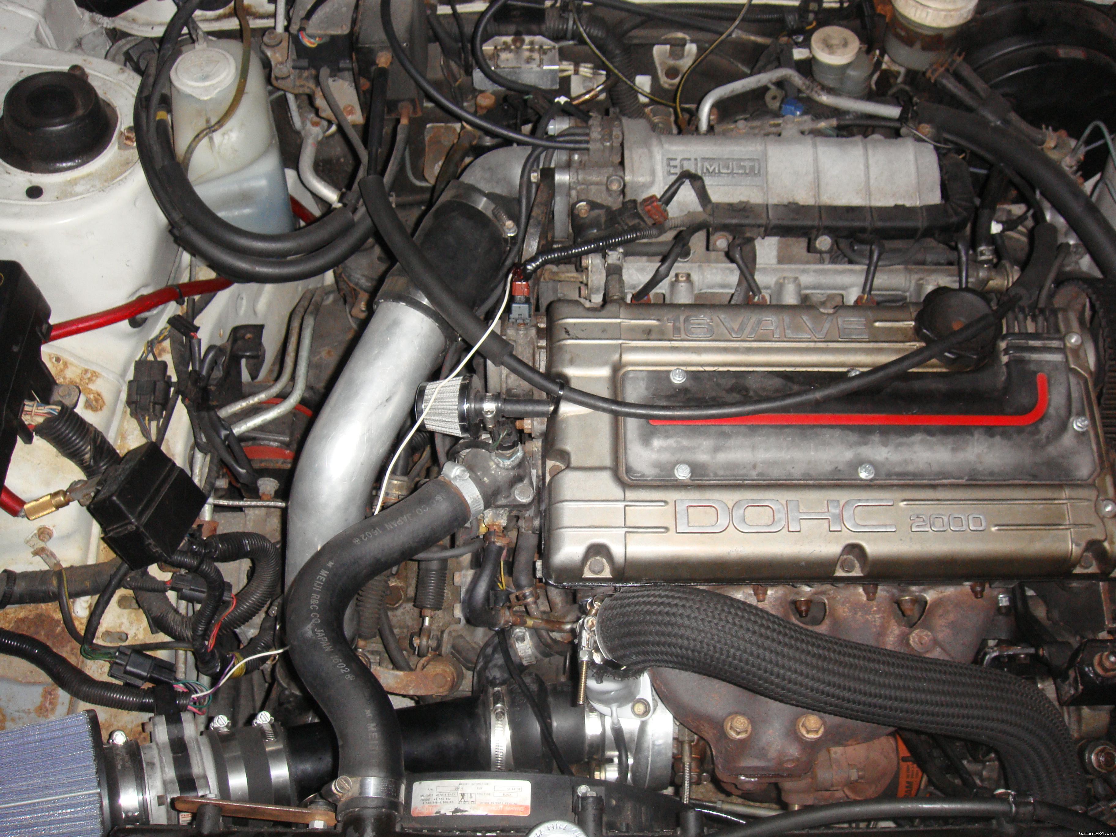

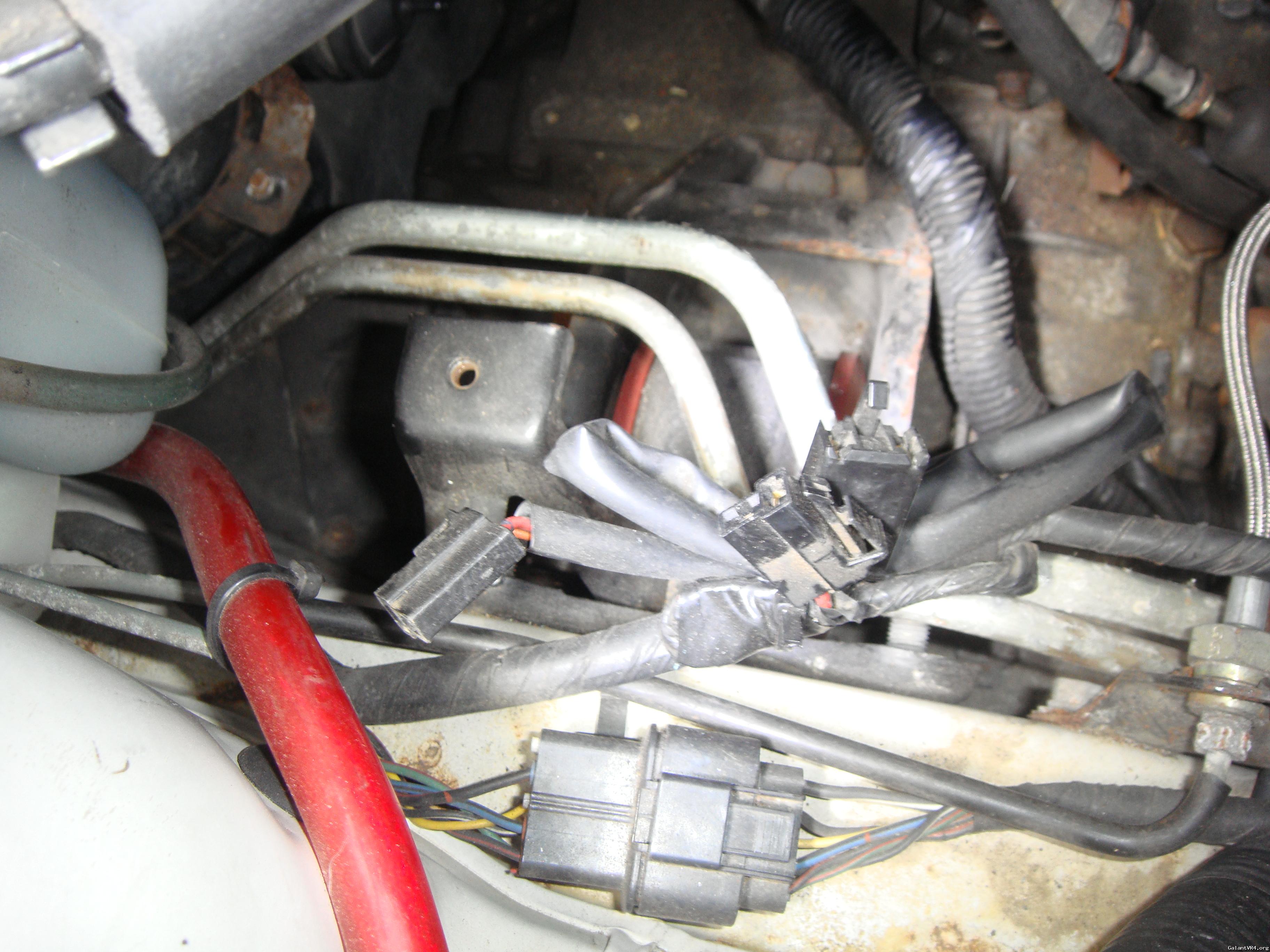

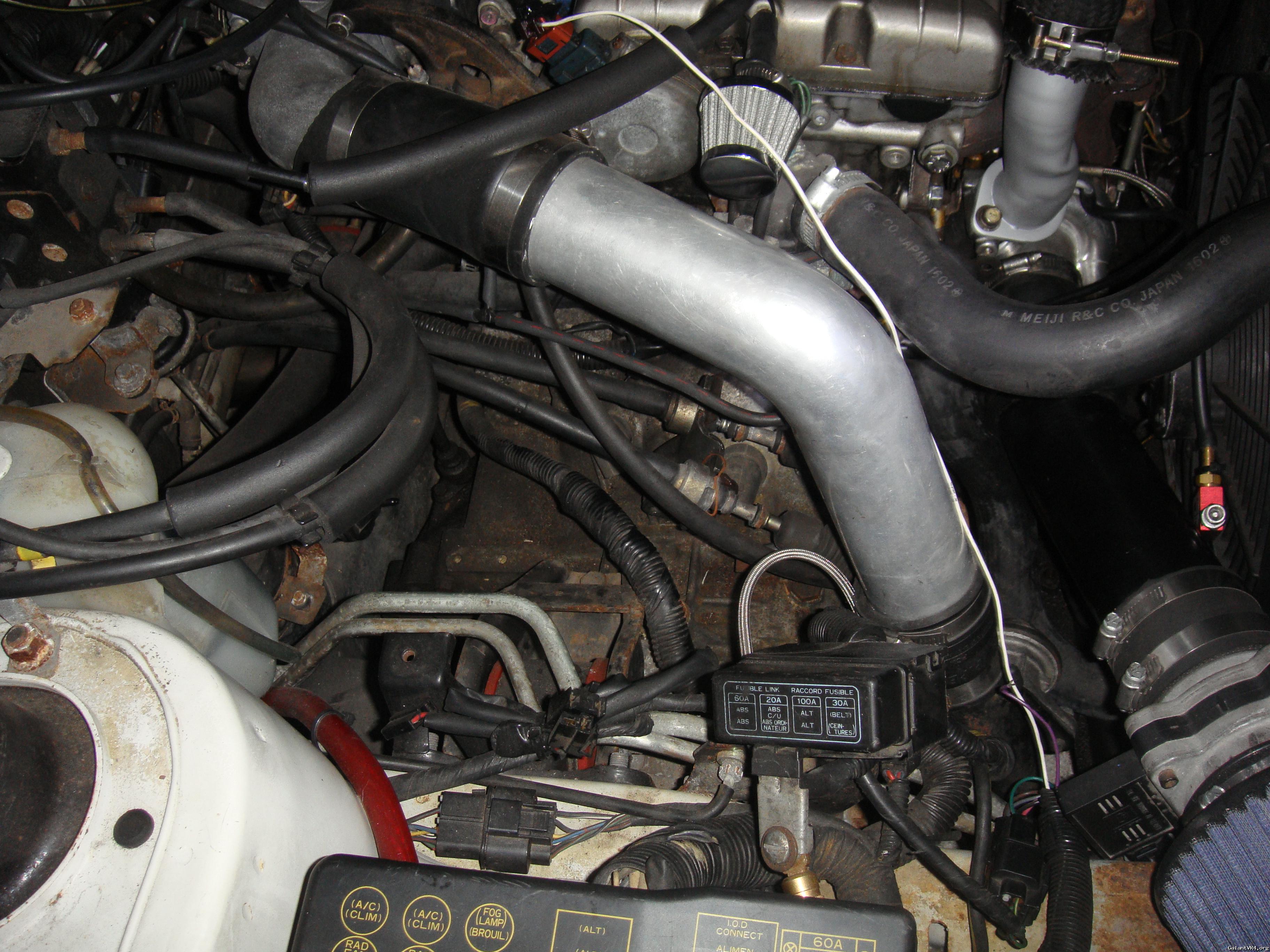

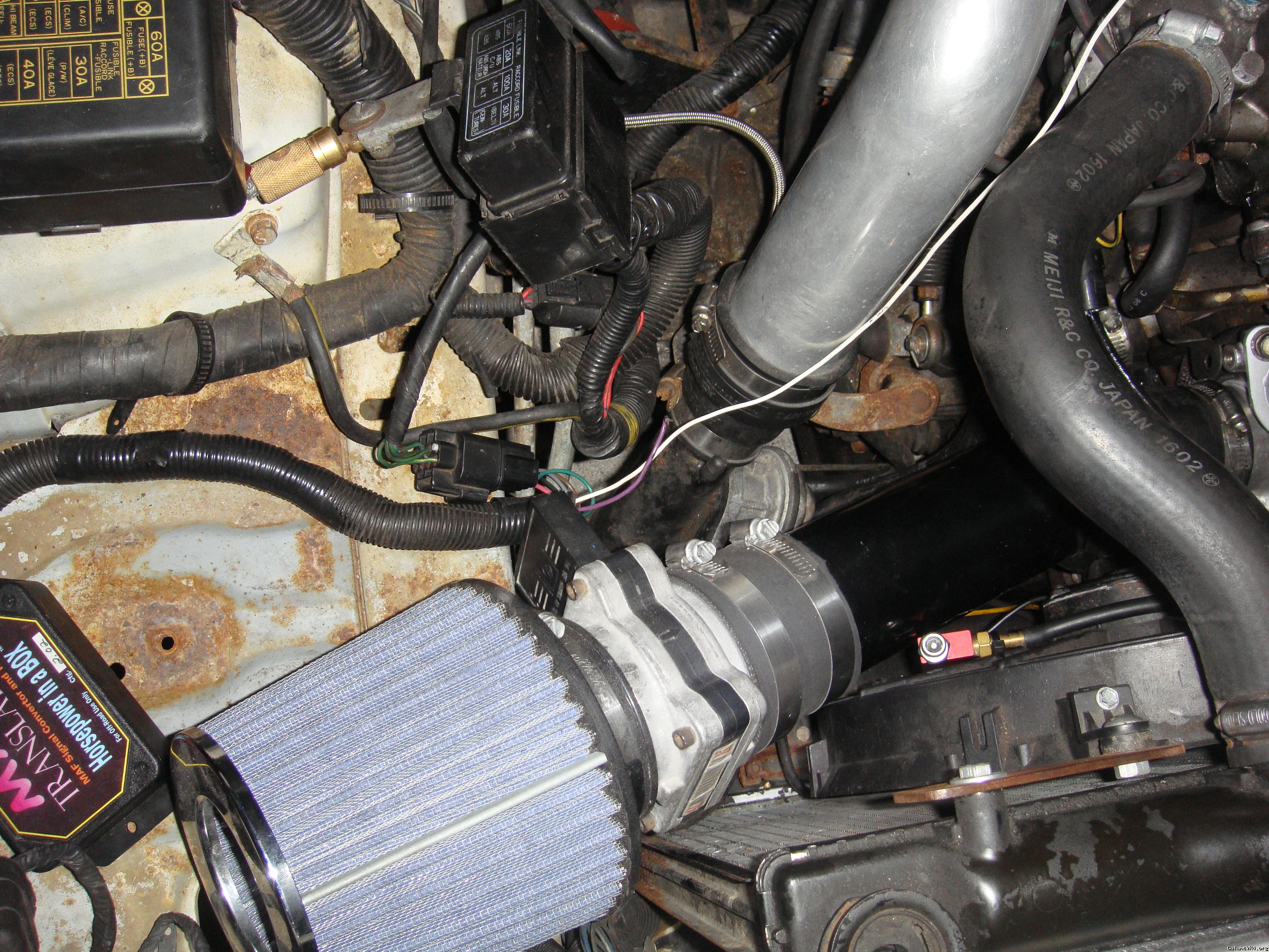

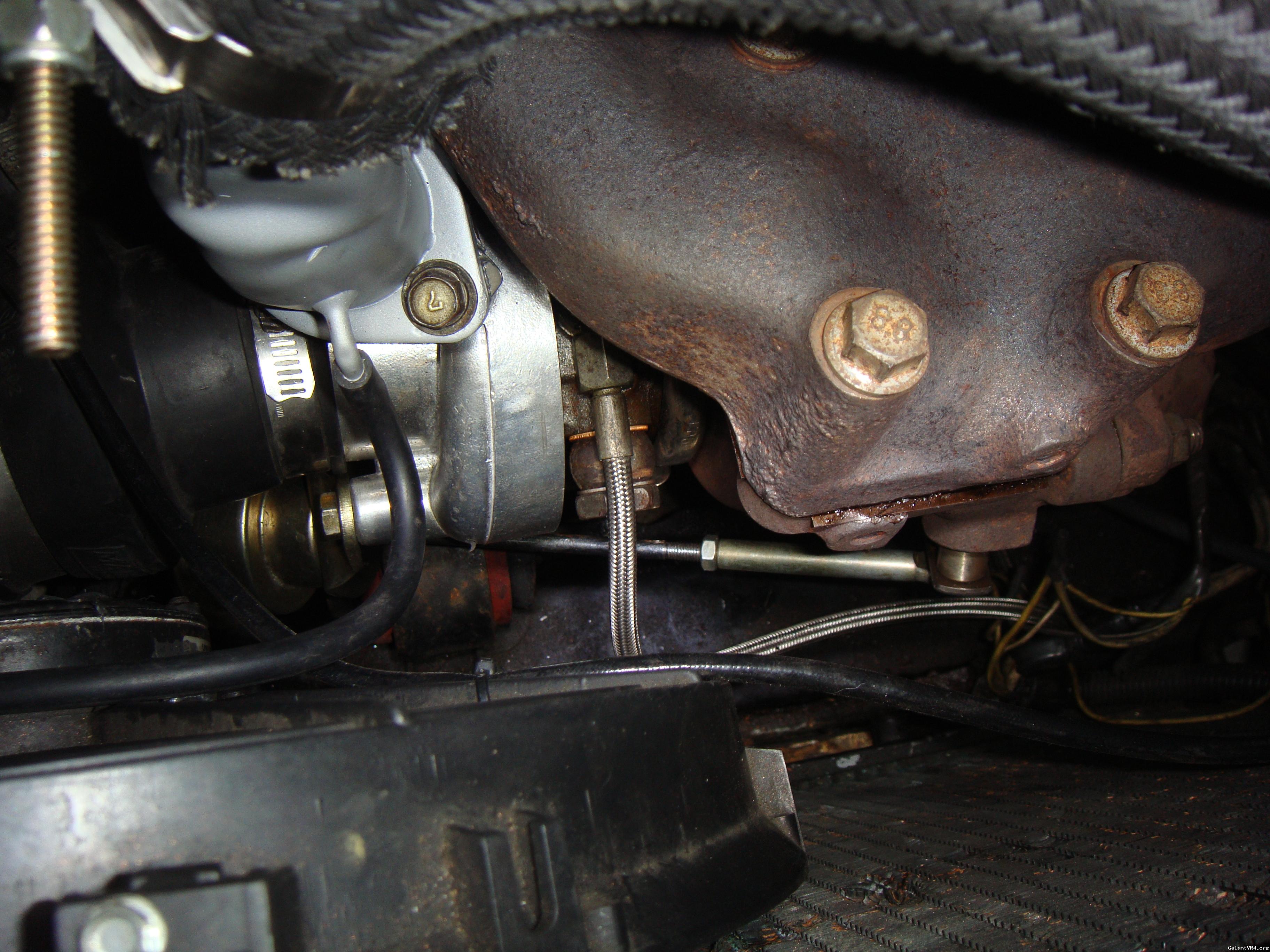

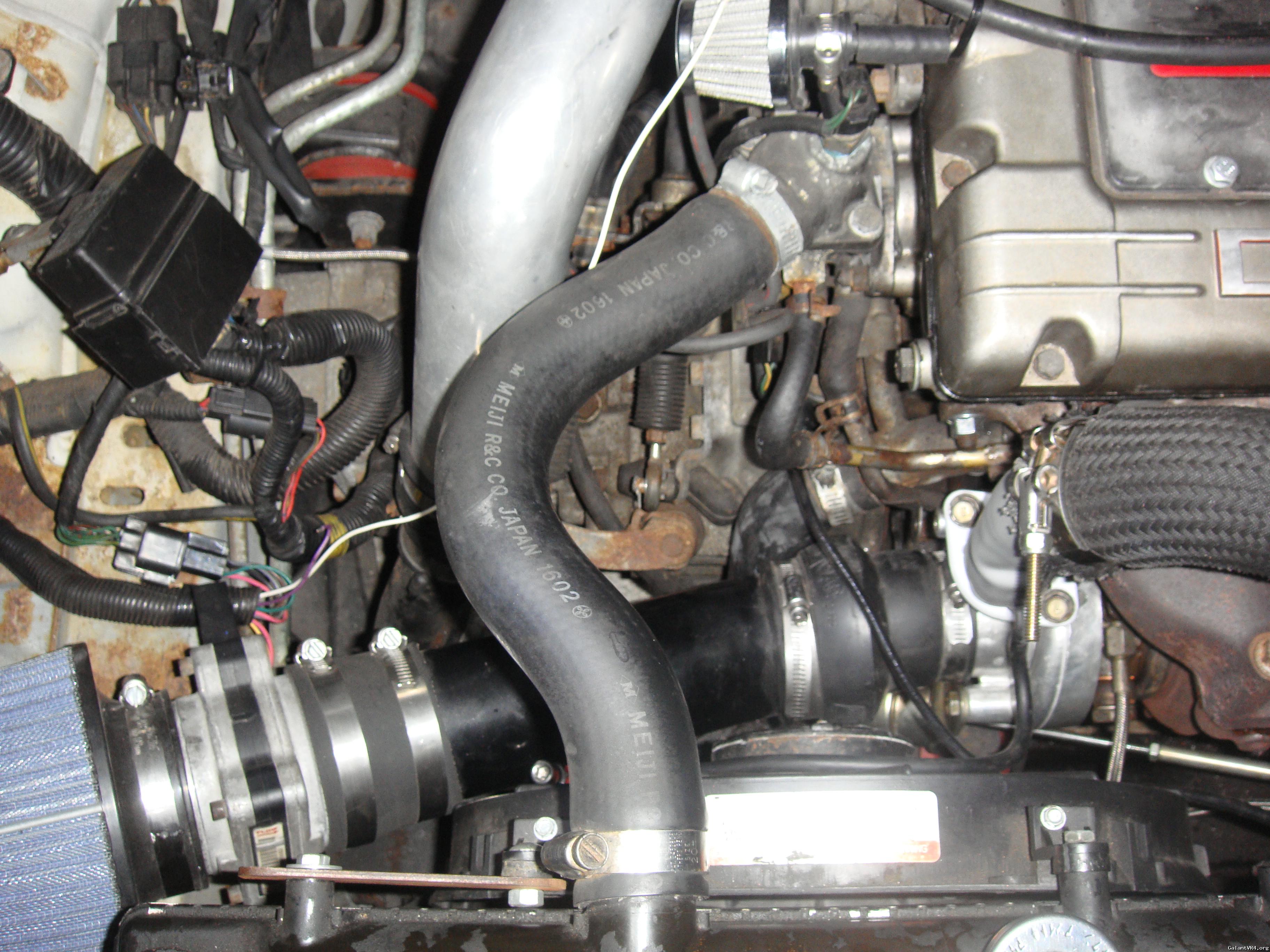

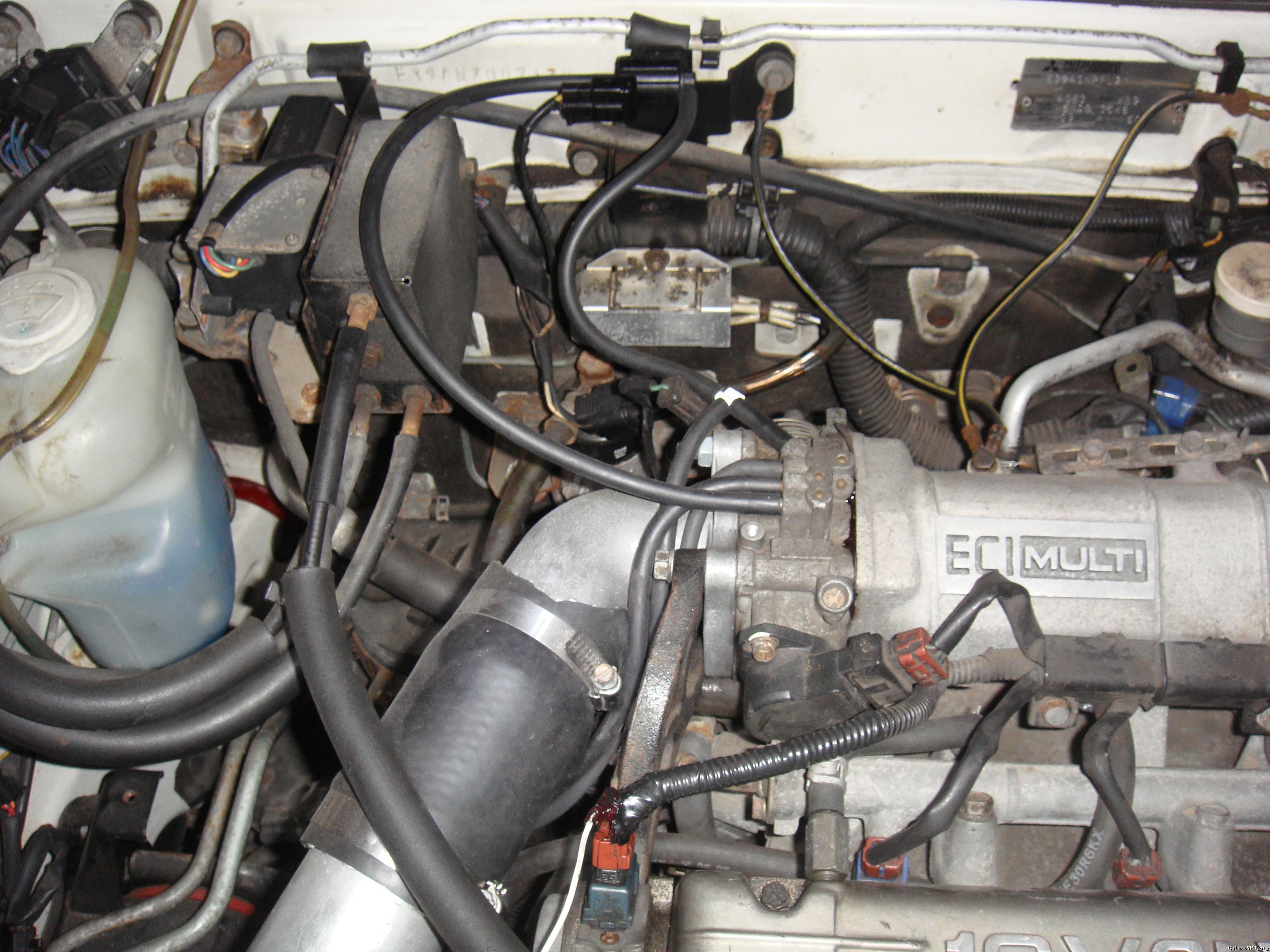

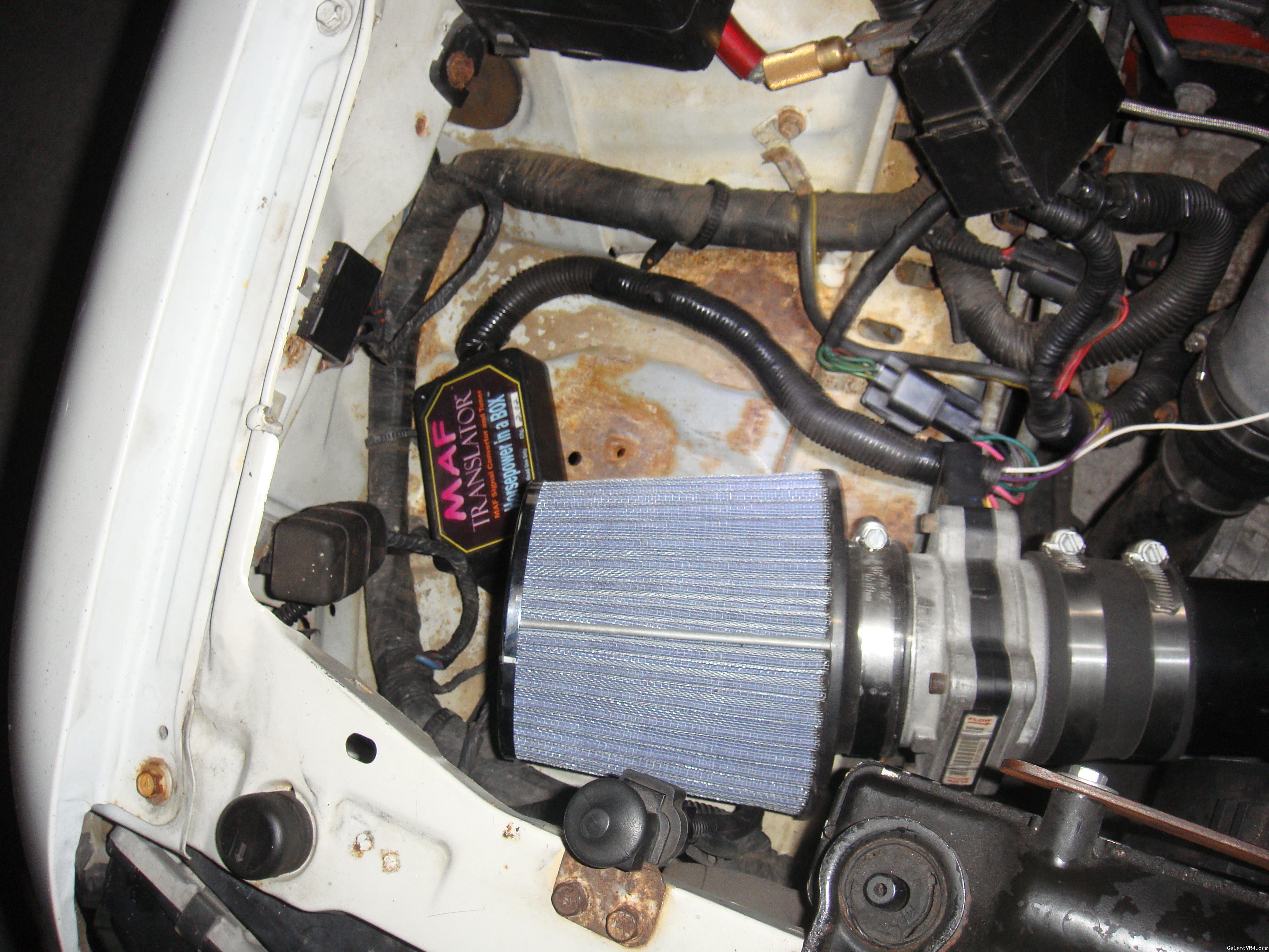

Ok just got home and had a chance to snap some shots /ubbthreads/images/graemlins/banghead.gif Please do not judge me or my mechanical skill by these pics as this was not my doing lol /ubbthreads/images/graemlins/grin.gif If you guys can point out some things that you see need correcting (what dosn't need correcting /ubbthreads/images/graemlins/bawling.gif). the close up of the plugs are the ones I mentioned earlier, they are just ziptied out of the way /ubbthreads/images/graemlins/dunno.gif Let me know what you guys think
Thanks a million /ubbthreads/images/graemlins/smile.gif

Okay, I see a stock hotside IC pipe... that thing is probably split (the nylon covered rubber). Also, Fernco plumbing couplers/transitions... okay on the intake, BAD on the compressed side.
That unplugged stuff is for various solenoids and crap that was removed. Shouldn't be a problem there.
you're missing the ground the throttle body, it goes from the support bracket to the open bolt hold on the TB.
I'm confused by the purple wire just hanging out off the MAFT... MAYBE that was an Aux trigger output, but I'm not sure, I don't remember having loose wires on mine.

Why are you running the MAFT? Have you had it tuned? Have you tried the stock MAS?

just something else incase you didnt take notice, that POS battery cable is damn close to grounding out on the brass connector to the fenderwell...maybe not yet but as soon as it touches any bare metal, atleast wrap it in electrical tape for now so nothing happens by accident, some of these cars dont need help having a shorted wire lol..

Good looking out /ubbthreads/images/graemlins/grin.gif but I already handled that potential catastrophe!

I'll second what someone else said about what appears to be a Fernco coupler (near the intake pipe). Now that it's making boost,that thing is going to split and blow out.
