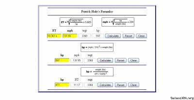

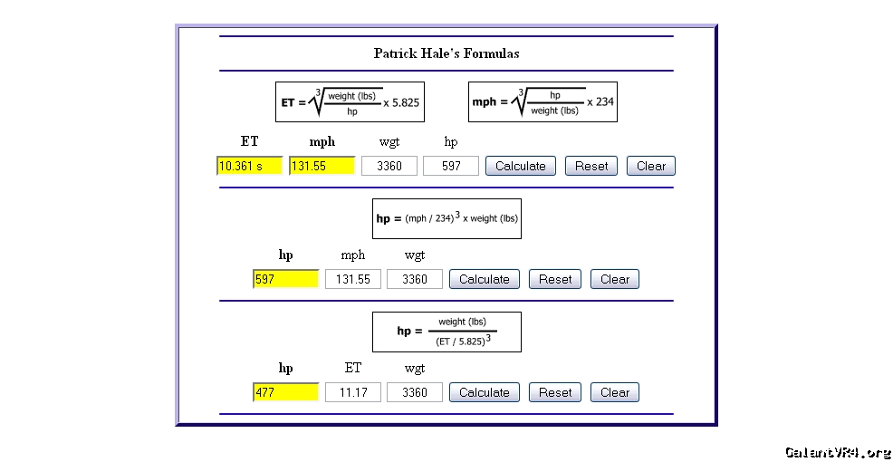

Your turbo couldn't even hold to redline the boost required to make such horsepower
Are you f***ing joking me. My car weighs 3360 with me in it and traps 131.55mph. Go do the math and tell me what my FWHP is. Oh and I pick up 31.5mph in the last 1/8 so that should tell you its making power all the way to red line(8500rpm). Once I get my car up and running I will post up a log of my car showing full boost (29)psi at 3400rpms doing a 3rd gear roll on starting at 2000rpms.
Are you joking me? Since when does 131 mph trap speed with that weight equal more than 600*crank* hp. Patric Hale's formula is the most accurate for an AWD drive train. Your powerband goes althe way to your redline. Yes, and your turbo still can't support the boost it takes to make 100whp more.
You know that your spool speed is out of the ordinary. Most report the 3052 spooling to 20psi in a lighter 1g car (less load) by 3800-4000 rpms. I have a log of the hx40 doing the same thing.

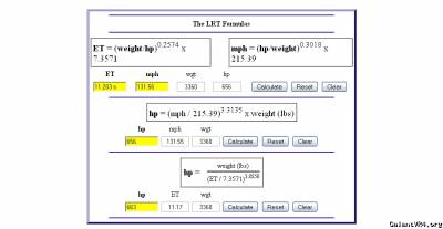

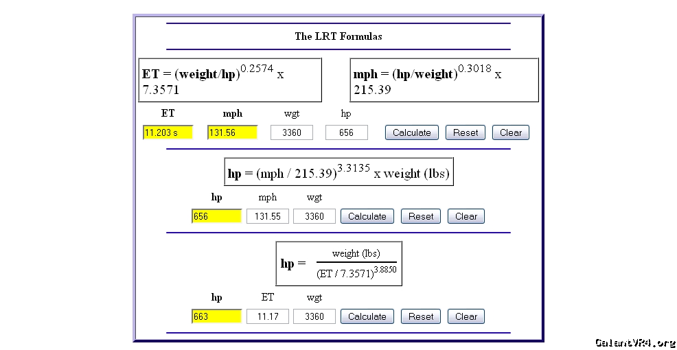

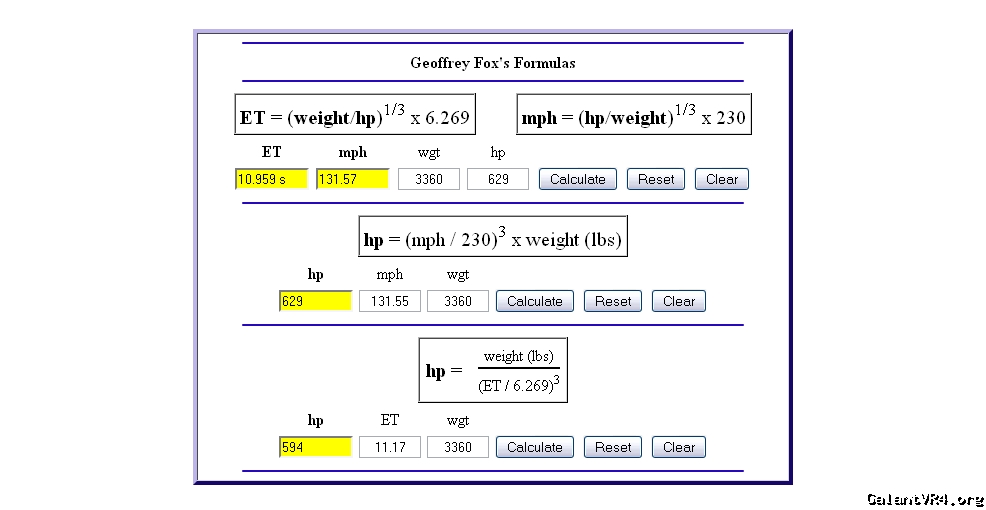

Those are calculating RWHP not crank HP.
Its the same things as using on like this
So I willing to bet money that I am over 600crank hp
where
-"MPH" is the terminal speed (trap speed),
-"ET" is the elapsed time,
-"224" is the empirically determined coefficient that includes the necessary unit conversion factors,
-"hp" is the peak engine horsepower output at the clutch (net power), and
-"weight" is the the total weight of the vehicle (with driver) in pounds.

The hp to trap ratio is just about correct providing there were no major weight reductions.
It takes 550-600 whp to dip in to mid the 10's.
My friend who had the first gvr4 in the 10's only had 510 whp and ran 10.80's eith a 1.5 60ft.

Funny because all the other HP calculators show RWHP. I know my car is making close to 600awhp. I know that because I have walked my friends 2g that weighs about the same as my car and makes 550awhp. Now are you going to tell me that I walked him because of some force field that was holding his car back. /ubbthreads/images/graemlins/hsugh.gif

No they don't. It's not mentioned anywhere in that page. Just the statement I quoted. Those formulas are spitting out crank hp.
Now, I can see how a dyno can read high and your friend could have a high reading dyno spit out 550whp. It happens. A full weight AWD dsm weighs about the same and a 500whp dynoed car can do similar.
