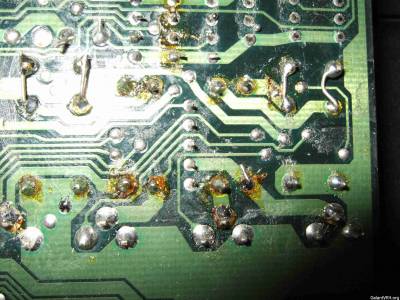

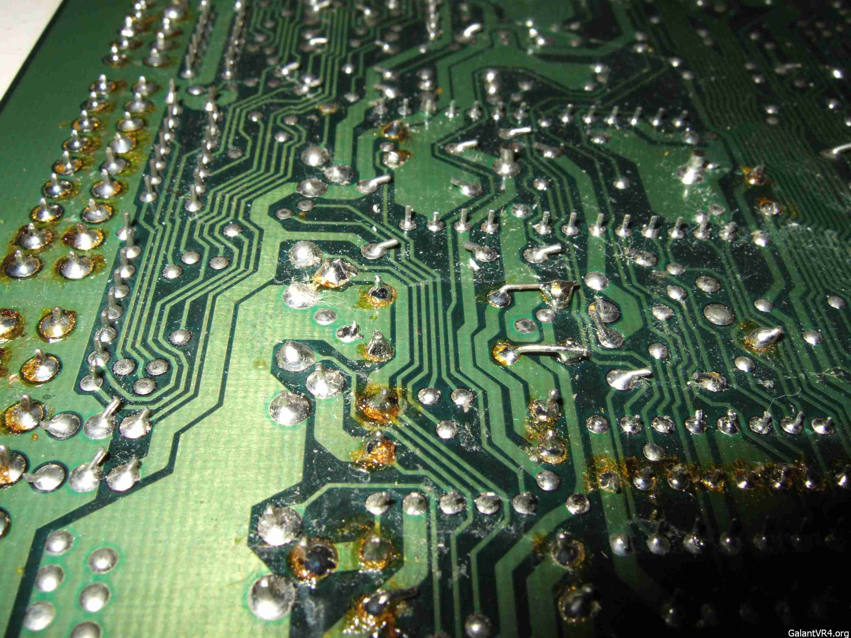

I often find that code 41 (if the car runs fine) is caused by a bad trace to RM101, a resistor matrix that looks at all 4 injector outputs.
The car doesn't run fine. Does the resistor matrix consist four black boxes with three legs that stick out towards the green boxes?
Quote:
Some of the traces are very easy to damage. Look for RM101 between the green injector caps, and trace each of the 4 lines to the center pin of each injector driver transistor.

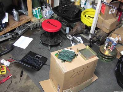

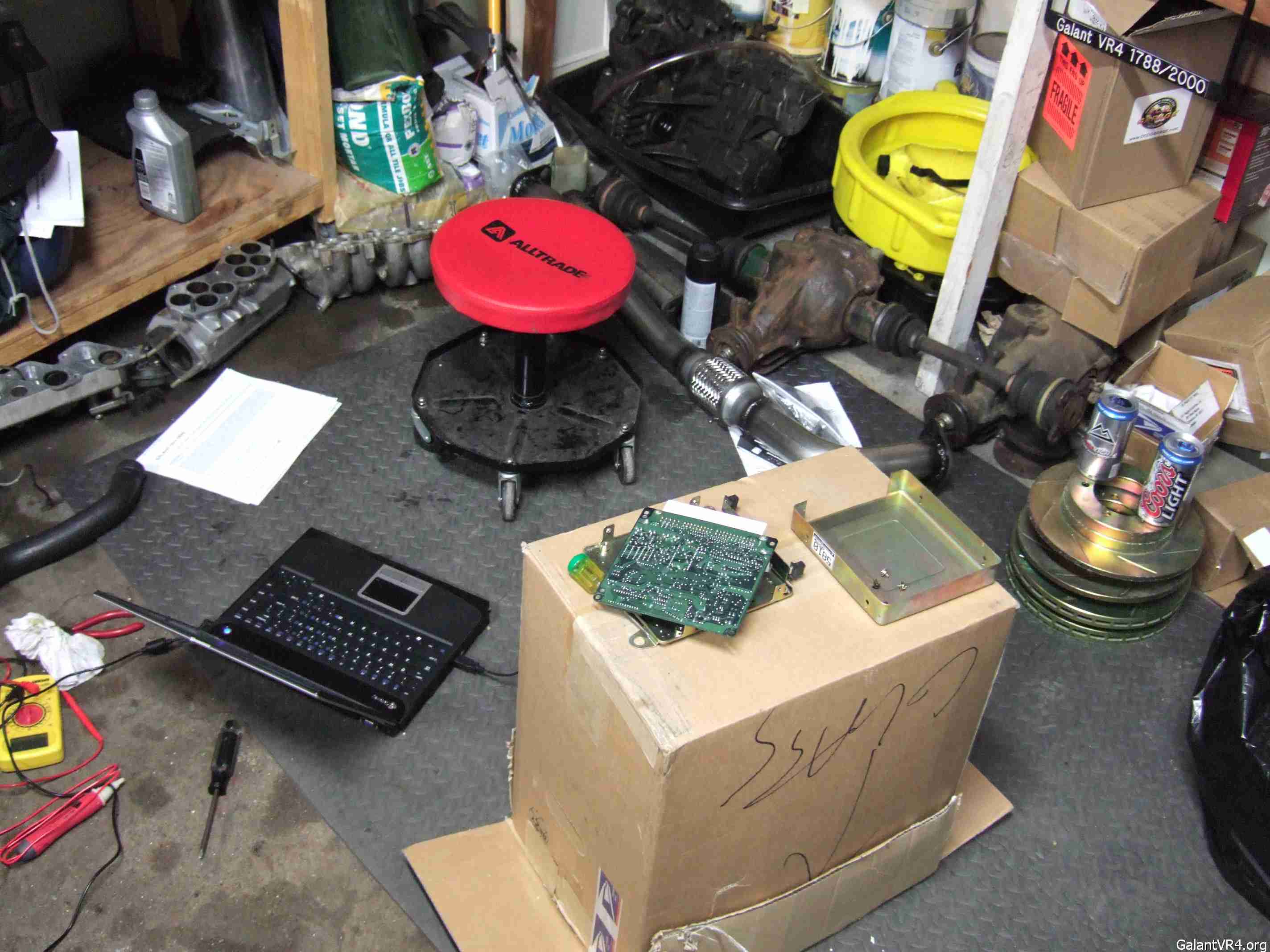

The workshop:

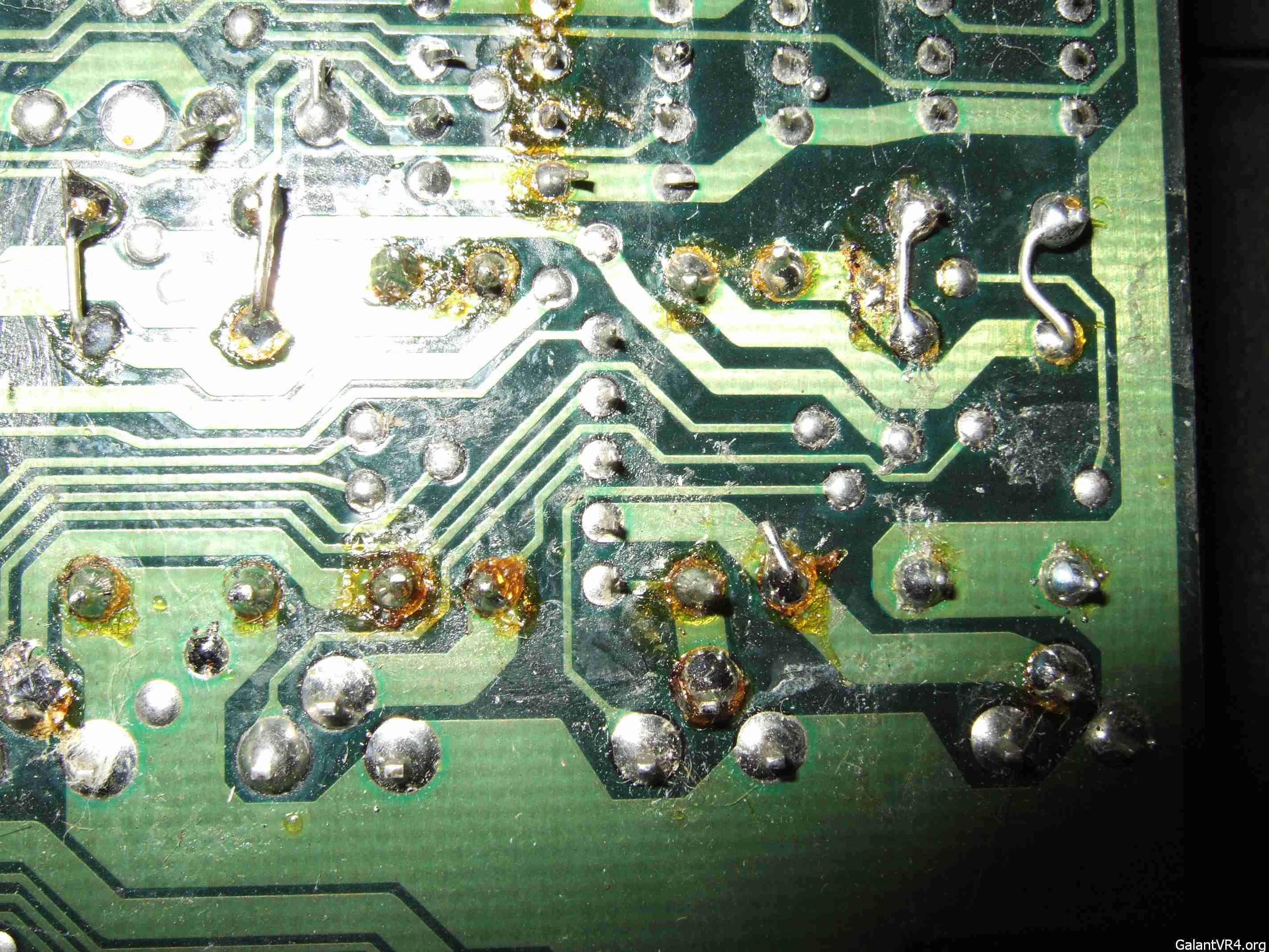

Quote:
The common lead of RM101 is the bottom one, and you can trace it as it heads across the board to TR12.
The one on the far right that heads off into the distance, looking at the five horizontal pins near the bottom of this picture...
What I think you're talking about is the bottom four pins (of that verticle row of 5) that follow the fat traces to the tops of those triangular fat blobs:
Quote:
I've also seen acid damage around the caps cause a loss of the bias voltage and cause code 41.
My caps are a few years old (7378E) "Paul"

Yes, exactly! Use an ohmmeter to check for continuity (
CP
Aug 30, 2004
8,938
West Simsbury, CT
The fourth one up (2nd from top) is dead. I tested all 5 from pin to pin, and that's the only one I don't get anything for. It doesn't read at that first pin it appears to go through either. But it does read from that pin to the driver. So my problem is from RM101 to R112. What's my next step given this new information? Is there anything else I can test that may be code 41 related? Please advise...
Oh, my trims were looking better when I got home after putting in 50 miles today: 139, 117, 107 (LMH). And I've upped the pressure to 43.5psi.
Well, that makes it easy! Just solder a small jumper wire from the transistor's pin directly to the RM101. No more code 41! /ubbthreads/images/graemlins/laugh.gif
