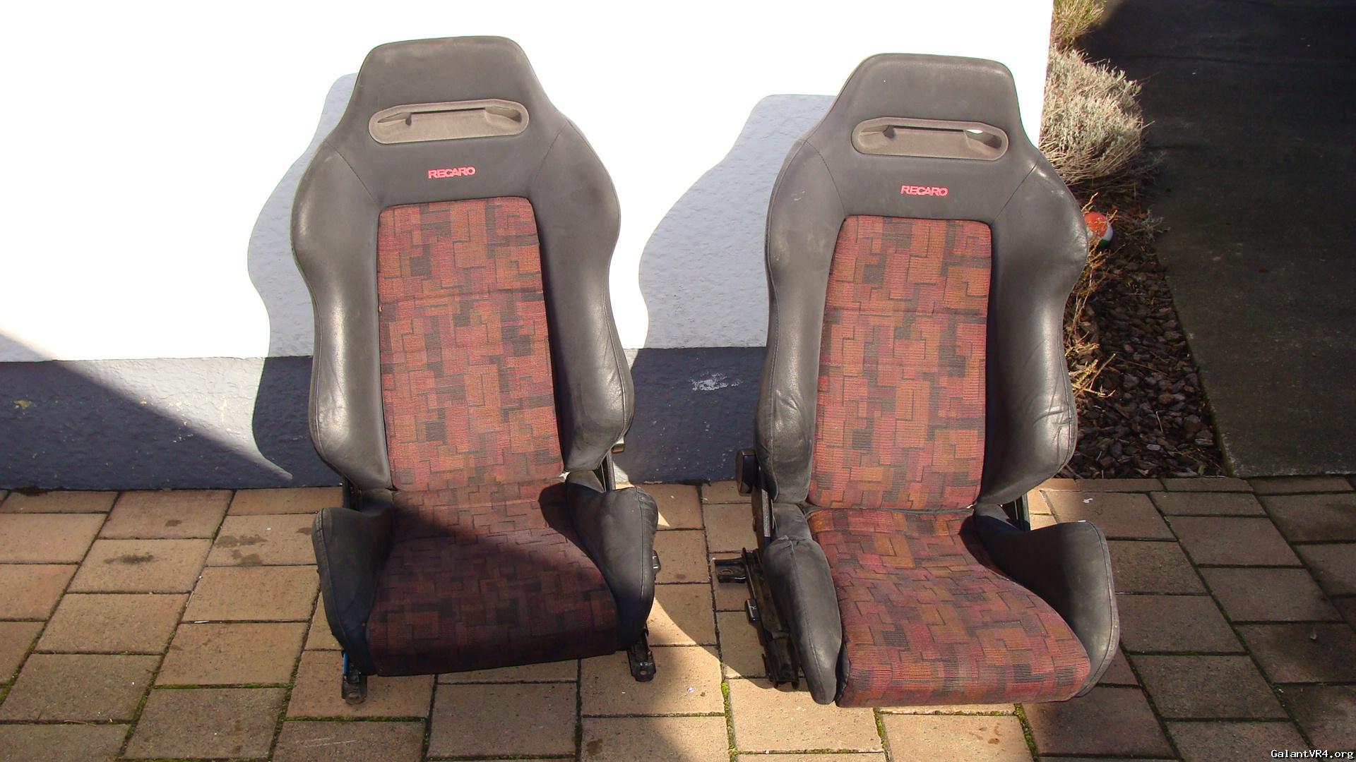

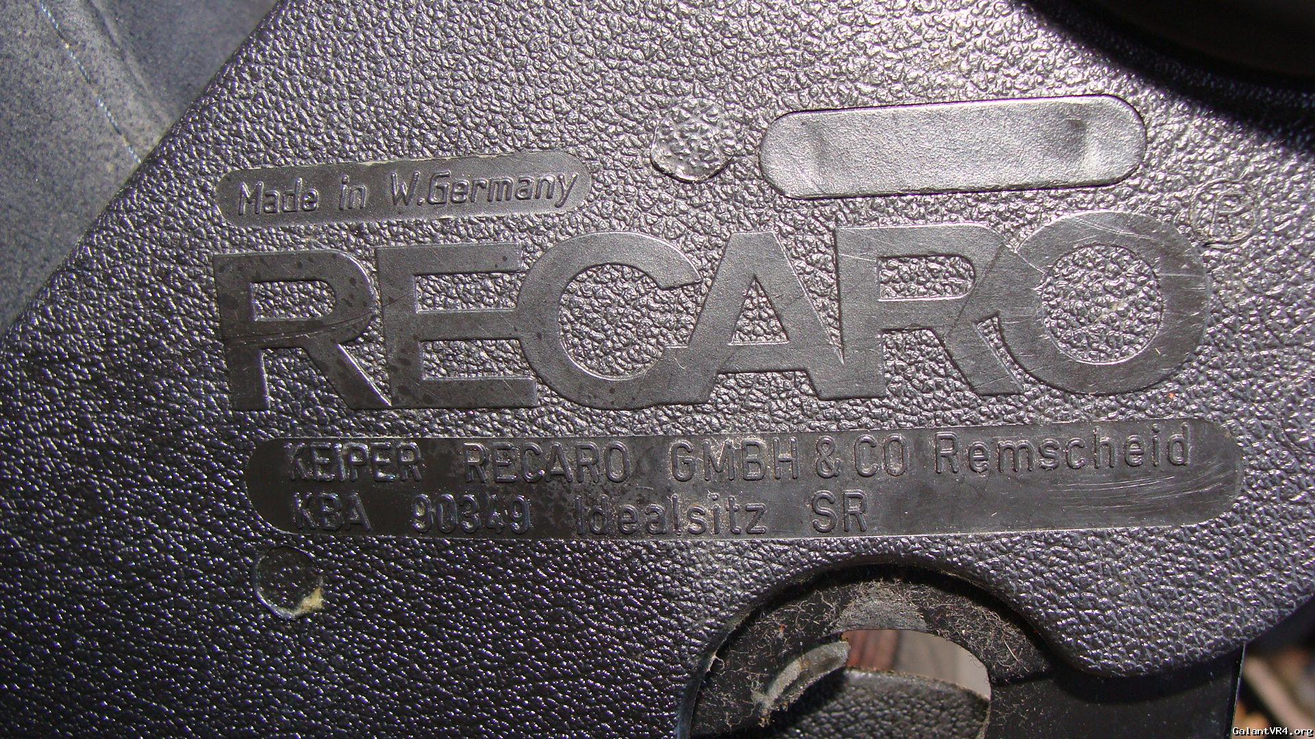

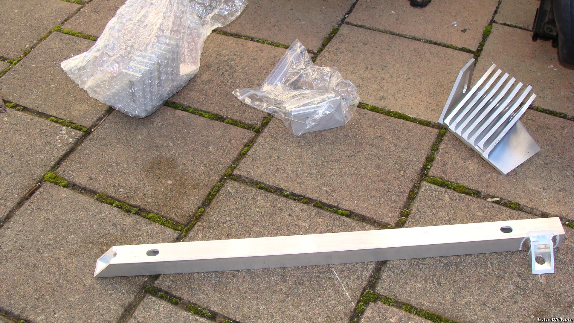

Busted out some of these from Curtis...
...So I could fit some of these. Originally from an Evo 4. Same shape as Evo 2 and 3 but red insert rather than light grey.
I'm considering grabbing a pair of rear seats to re-trim mine with - I have 4 individual folding components (ie each seat bottom and seat back folds independently! And clock in at around 60kg!) so I will need some more material than just one set.
The came from a Evo 2 with a shattered windscreen, so I'm still finding little shards even after busting out the vacuum a few times.

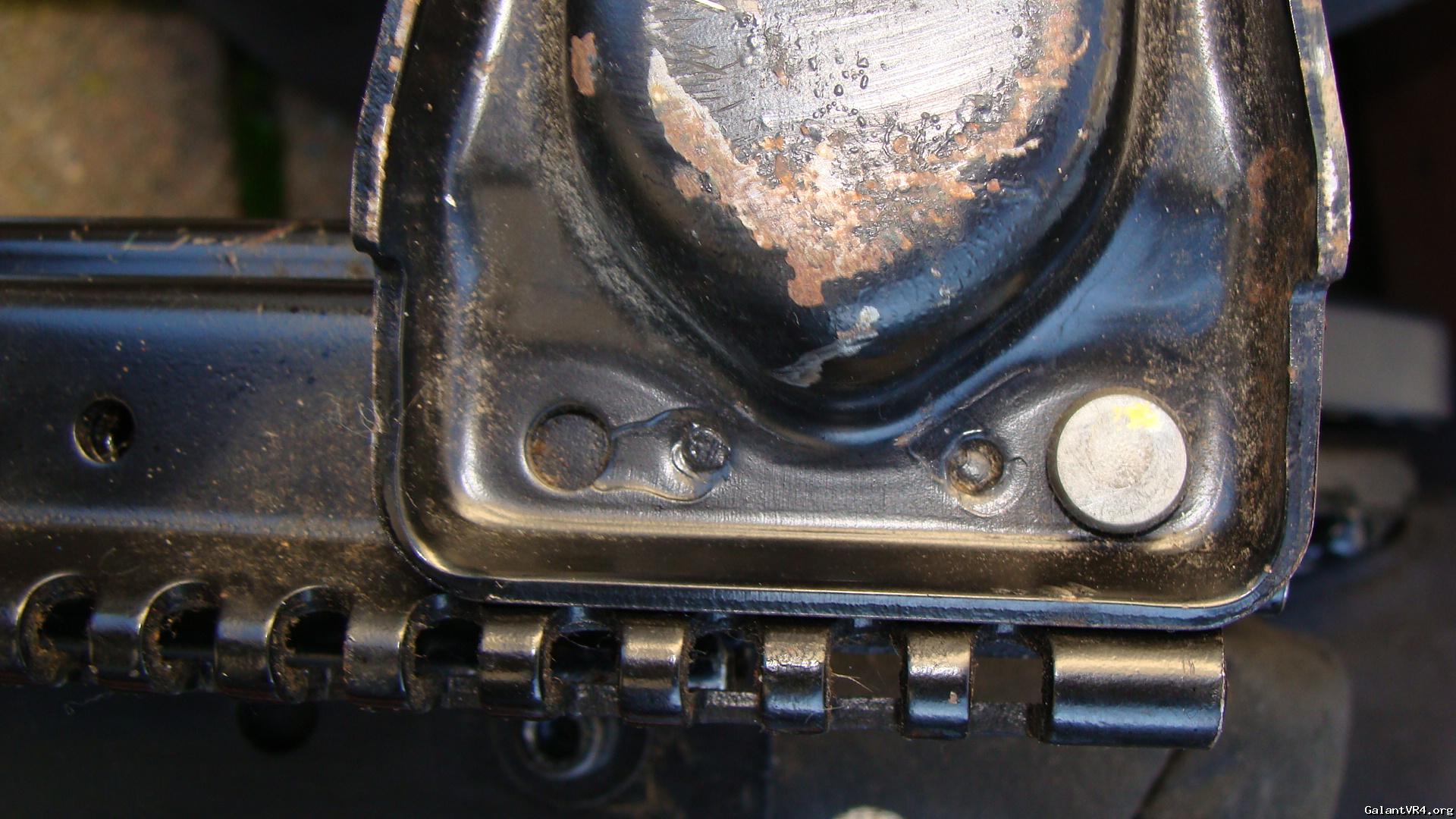

Things are a touch different to the Evo 9 seats the yanks are messing with. The Evo 9s only have socket head screws holding the tabs on but I'm going to have to drill out these studs on both sides - 3 per seat.

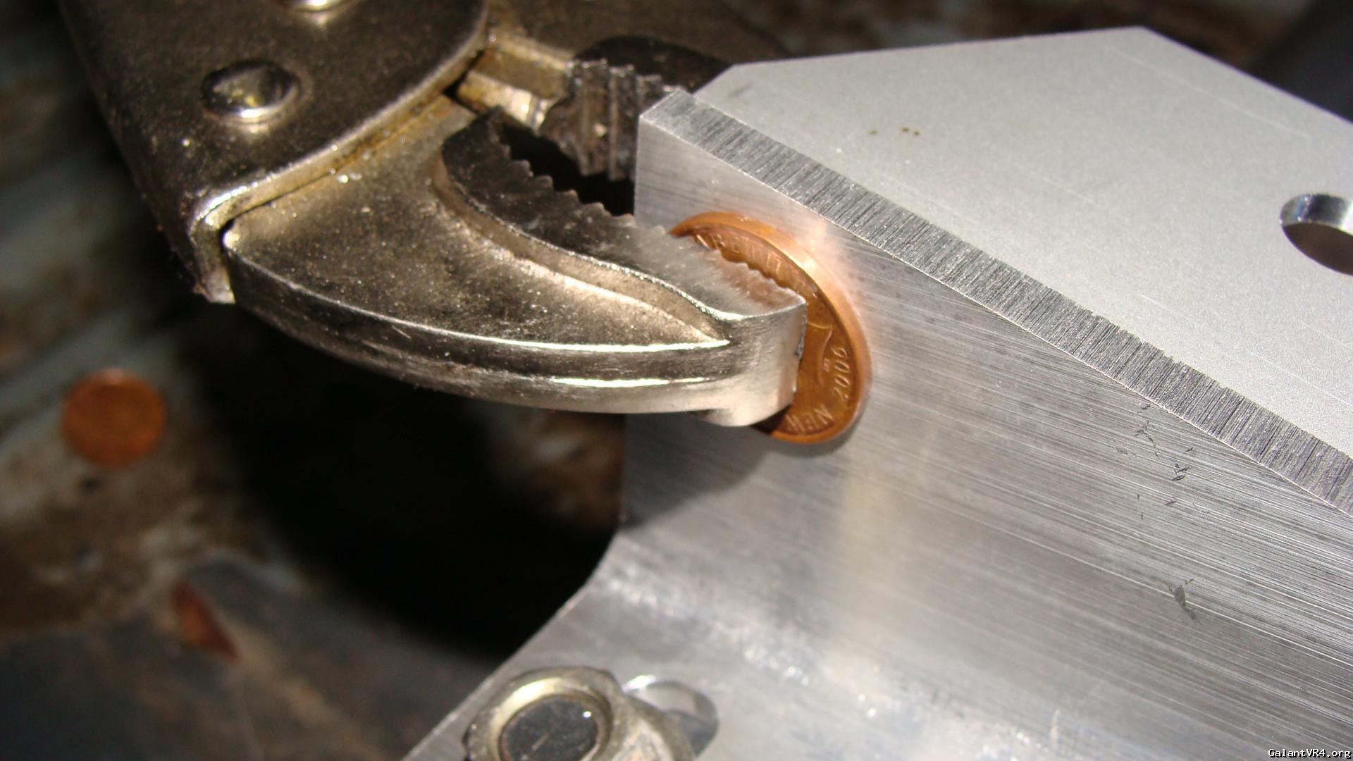

Coin clamp photo for Curtis - can't change my title for this /ubbthreads/images/graemlins/laugh.gif
Could have sworn the Evo 4 was made after the fall of the Berlin Wall...

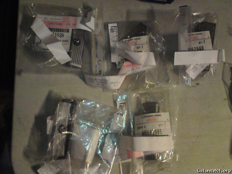

I received some bits from MITSU!
Facelift Fog light covers & some suspension bushes etc

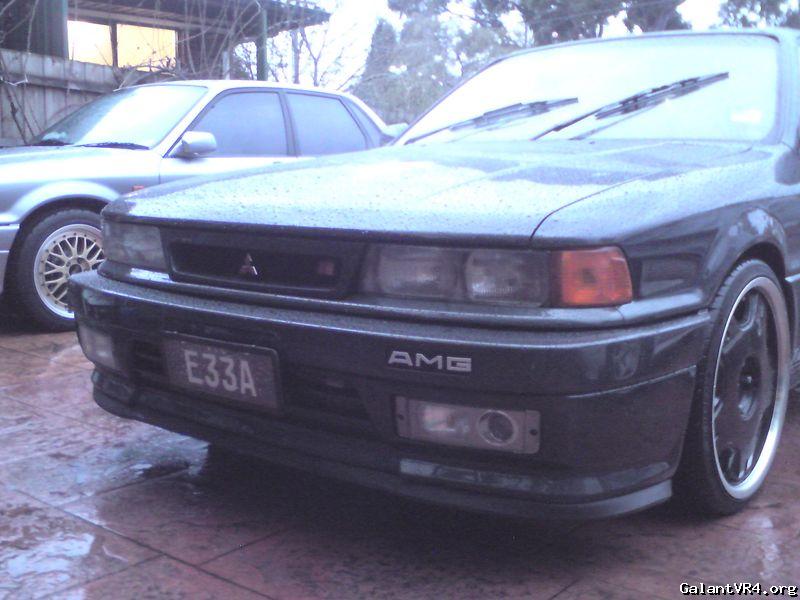

I also took the AMG out for a drive!
It's off the JACKSTANDS!!! WOOHOO!! It was out of action for one month! So it was a JSB for a short period...

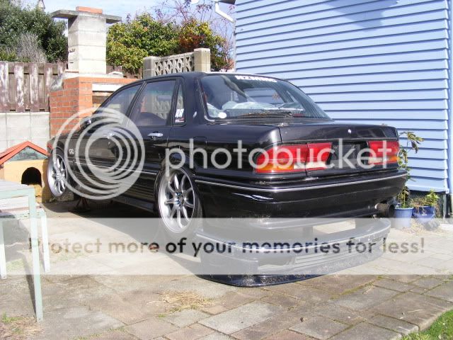

I purchased some universal lips from the US of A and it turned out alright.
What do you guys think?
