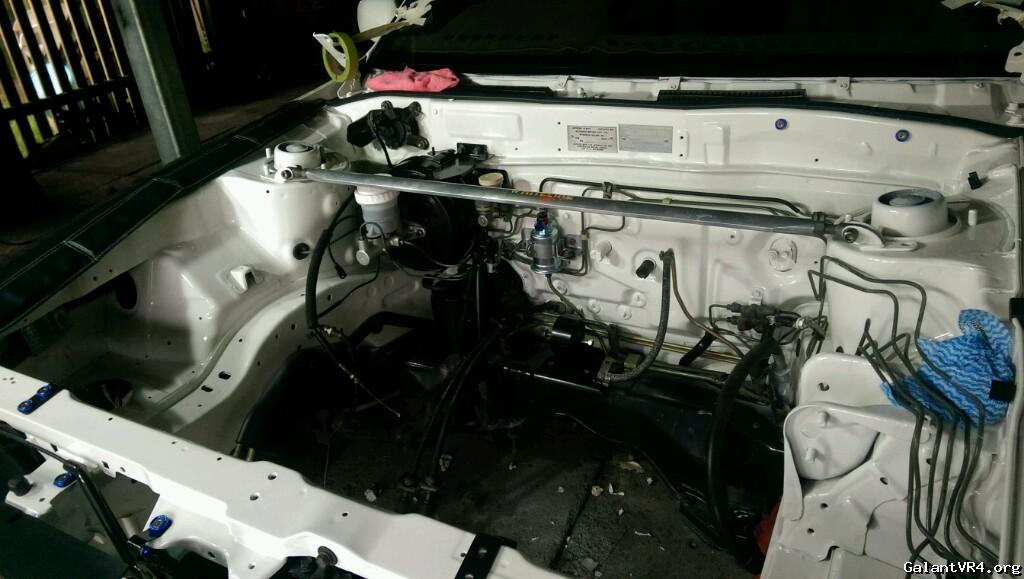

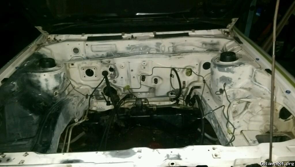

Things happen slow in Brisbane. It's finally time to get my VR4 going again. The engine has been removed and stripped for a freshen up with new rings, bearings, head gasket and BC valve springs .

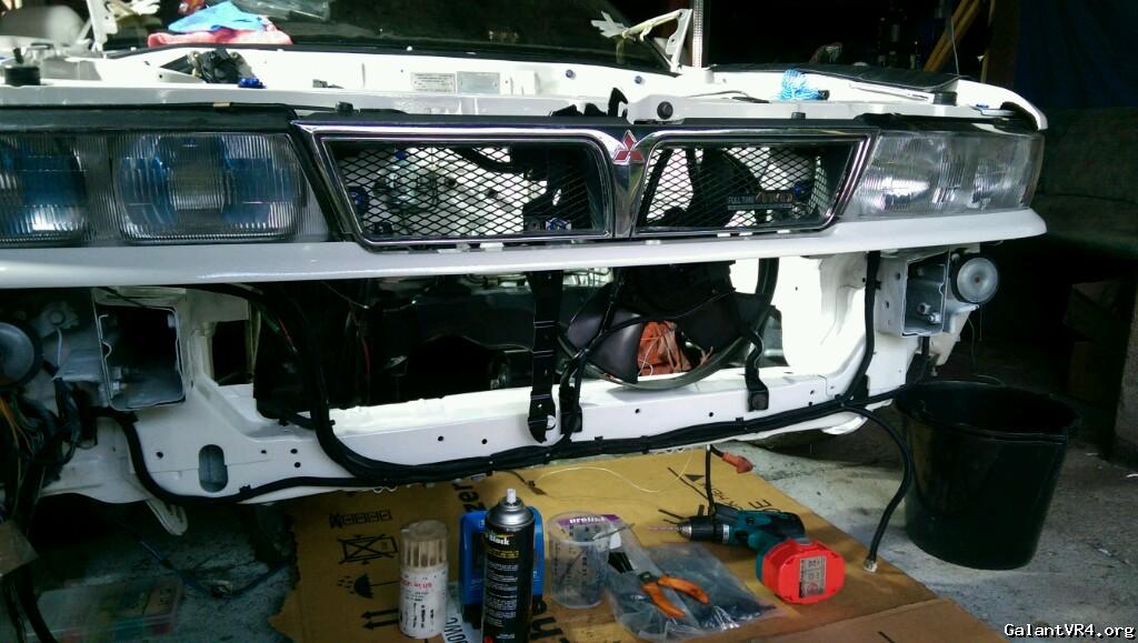

Engine bay has been stripped and painted. It's now time to clean everything and put back together. I have also started my engine bay wire tuck. It's coming along . Once the engines back in I can finish it off.
ozyvr4
Mar 5, 2007
160
Brisbane, Australia
The direction of the new wiring . Will be all hidden in the bay.

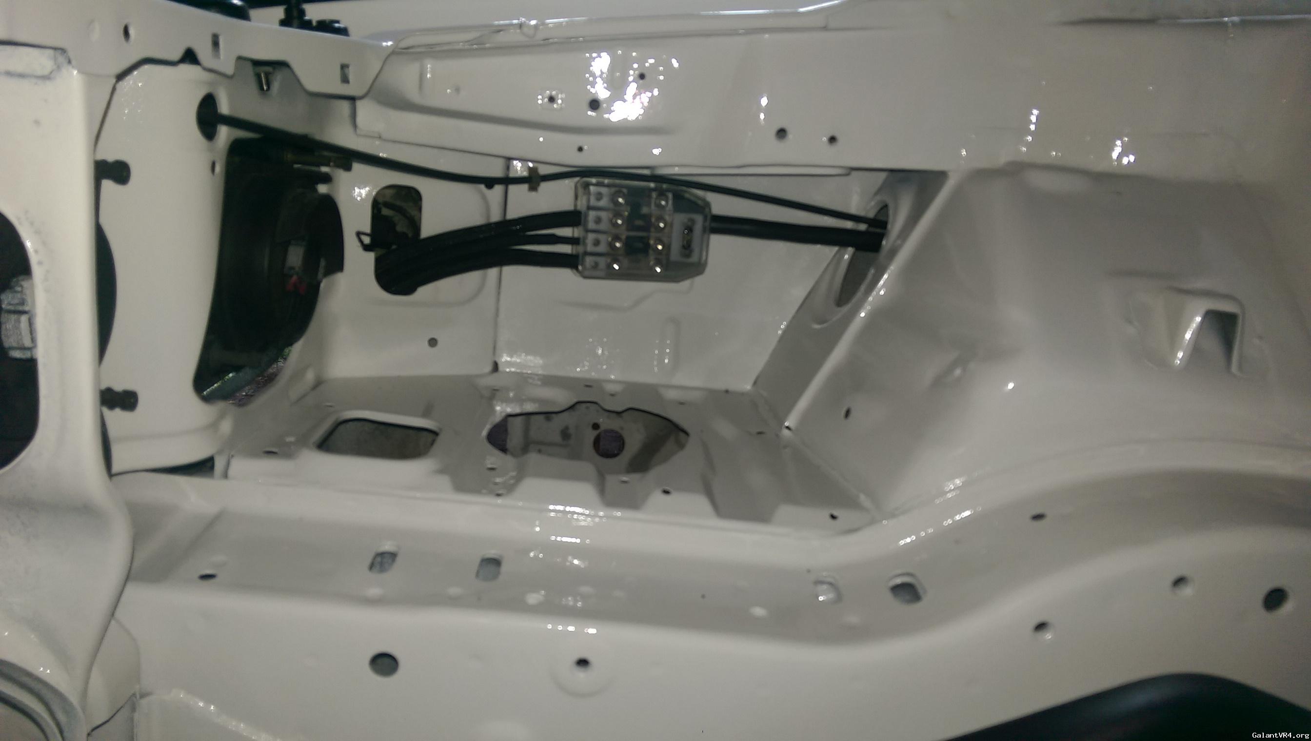

The fuse holder I have instasled to replace the 1 on the battery post as battery is in the boot.
