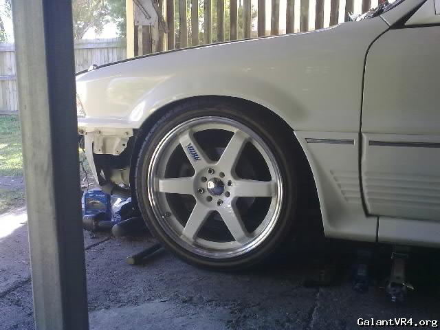

Spent several nights working in the dark to get everything ready for a trackday the Saturday just gone - ended up having the raise the car quite alot to stop it rubbing (seems a jack under the wheel when the car is on stands will not approximate how it will sit once on the ground - also filling the "trunk" with tools/jack/jerry can will cause it to ride lower than it did on the test run.
After a huge amount of f*cking about with the ride height my g/f and I left for the ~400km (~250 miles) trip to the track hours later than planned, car ran really well with no leaks/smoke and minimal rattles, only minor tire rub on full lock and thanks to refitting the rear seat and adding a ball of steel wool the size of my head to the pipe through the muffler, without too much noise either.
About 3/4 of an hour into the trip a truck pulls out infront of us causing me to have to brake very hard to avoid it - after which the car feels sluggish and pulls to the left somewhat, I find a suitable place to stop and investigate and it's pretty quickly evident the left front caliper is stuck on! @$*%!
After letting it cool down I managed to limp it home stopping 3 or 4 times along the way to allow it to cool again.
So here's some pics of the car at an actual functional ride height - it still needs abit of tweaking as it's not quite even at all corners, but this is pretty much how it will stay until I get around to making some custom bits to correct the geometry and taking a hammer to the inside of the rear guards (where the top of the guard meets the outer skin).

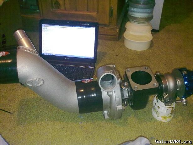

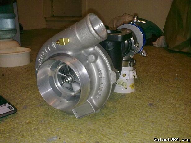

Hi guys. I thought I would give an update on my machine.
I just recieved my new turbo ( Forced Performance FP3052 )
Tial MVR 44mm wastegate ( 20 psi spring)
Forced Performance 4" intake pipe
Forced Performance SS oil feed & filter , restrictor
Weapon R 4" filter
Stainless Steel 02 housing recirculated wastegate
I also recieved my 3.5 LSD 4 bolt. Just have to start fitting now. First I have to swap the centre to a housing with the provision for the power steering pump to keep the 4WS..

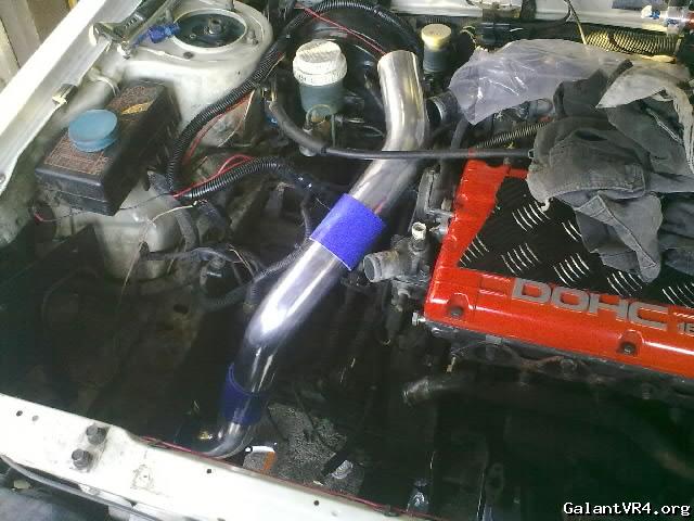

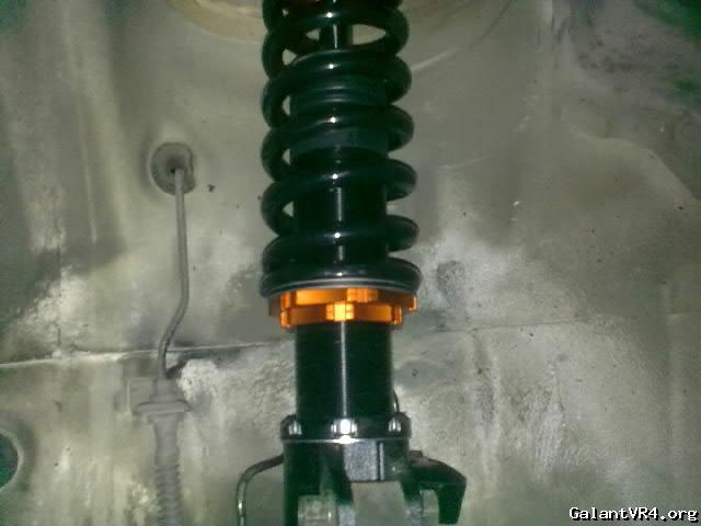

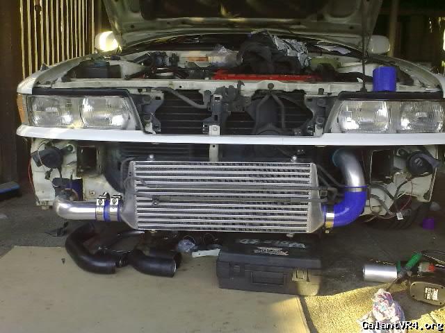

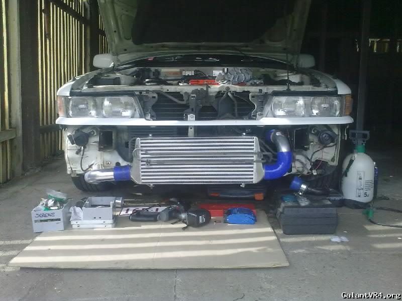

I thought I would also post some details of another car I am doing this month. It started as a standard E38 RS VR4.
I am fitting an Evo 3 turbo, Evo 3 manifold, Evo 3 dump, 500 x 240 x 75 FMIC with 2.5" alloy piping, Walbro 255 pump, SARD AFPR, 660cc injectors, rechipped ecu, K-sport coilovers, Ingalls adjustable rear cambers arms, Gates Racing timing belt kit etc. etc.
A few pics
