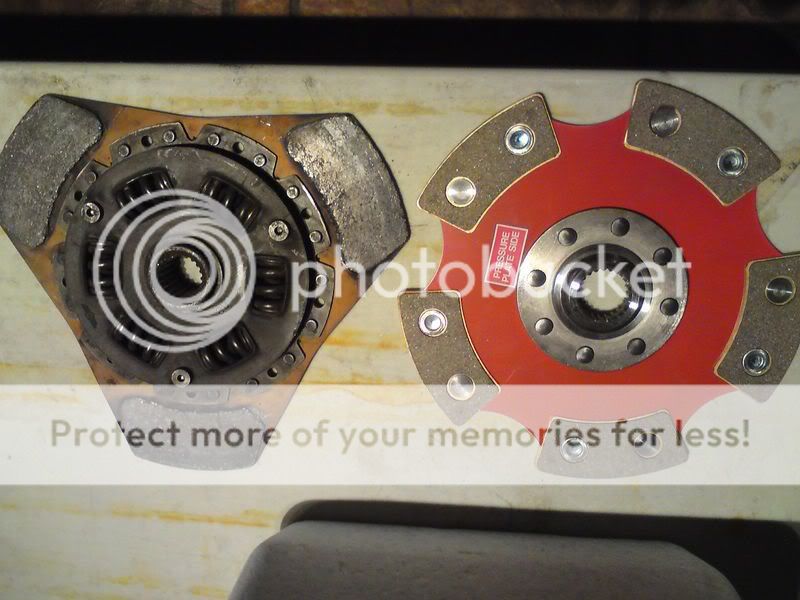

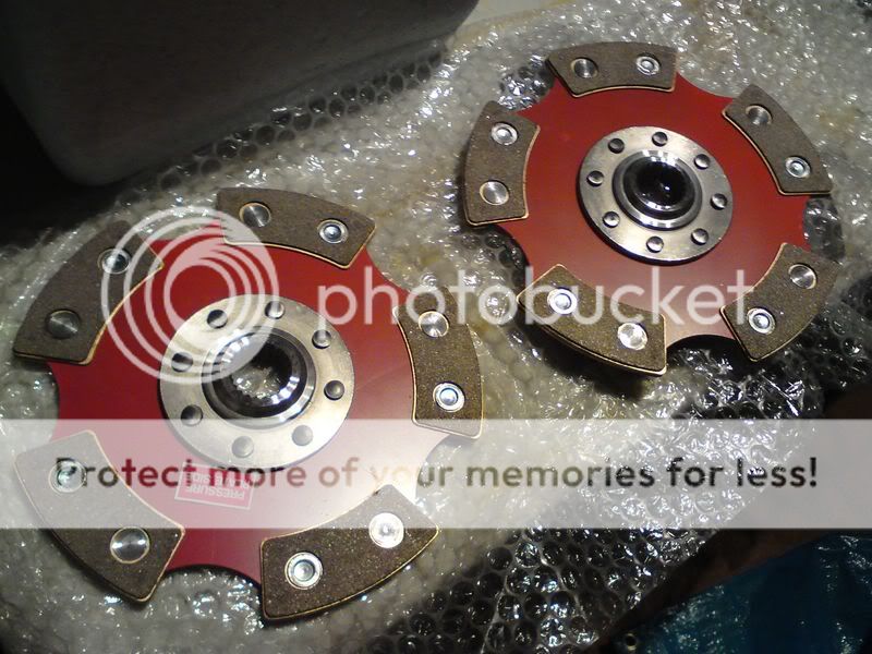

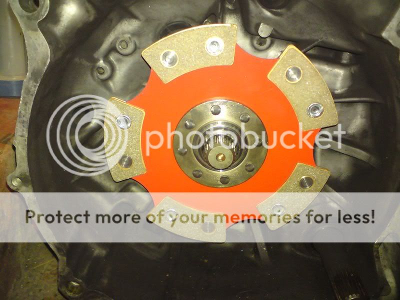

I just got my twin plate discs to suit the new DOG BOX!!
EVO7 input shaft vs VR4 input shaft

Baz, have you run a twin plate before? How drivable/nose to tail 5pm traffic drivable are they?
cheekychimp
Apr 19, 2004
7,333
East Sussex, U.K.
Driveability on twin plate clutches varies in my opinion. The Greddy twin plate I had in my 8G VR4 was the biggest PITA mod I ever did to the car and I cursed it daily. That said, it wasn't THAT bad in stop and go traffic on the flat and I could live with it. What made it unbearable was the inability to slip it on the slightest slope. Here in Hong Kong 80% of the car park ticket barriers are placed ON the ramps out of the car parks and the inclines are ridiculous. To make it worse the Mercedez Benz waiting behind was always 6" off the rear bumper. God I hated that clutch.
Now in contrast, the carbon twin plate is very liveable, but stupidly expensive! I really think that this clutch with the 2G accumulator mod will prove to be extremely streetable whilst holding a lot of power.
What power levels are you looking at Red? I looked around recently for a relatively lightweight single plate clutch that could handle everything an EVO III 16G could throw at it, and it looks like about 500 ft/lbs torque can be held using kevlar disks on PP only slightly heavier than stock. Once you get over that figure you start to need a really heavy PP on a single plate or you need pucks rather than full face disks. Some people say pucks are as hard to drive as multiplates, others seem to get on okay with them.
bazeng
Feb 6, 2003
2,520
Melbourne, Australia
Quoting RedTwo:
They're either 225/45R16 or 225/50R16. I assume it's from this new set up because I haven't noticed it before - I'll have to take a photo of the patches I've rubbed down to the bare metal with the forward edge of the tyres just from 4x 3 point turns/U-turns.
*grumble grumble* one of the Evo 9 wheels may be buckled /ubbthreads/images/graemlins/frown.gif
I can honestly say that the twin plates I use (DIRECT CLUTCH SERVICES) is very very good. Very light on the pedal and is slippable yet doesn't slip during shifts and has held 350kw's at the wheels without any issues.
The only annoying thing about it is the noise it makes with the clutch in. That is about all! I highly recommend it. I have been put of single plates simply because of the increased pressure on the pressure plate which means increased wear on the thrust bearing (crank).
I've heard good things about the quarter master twin plates also and with the price, you can't go wrong!
