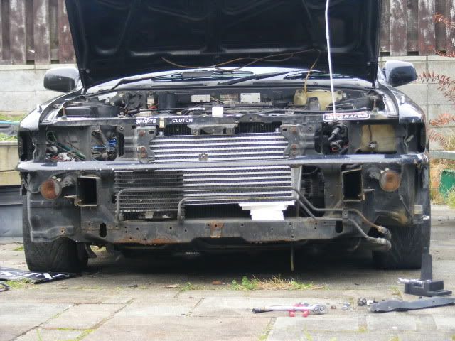

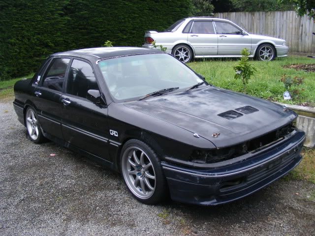

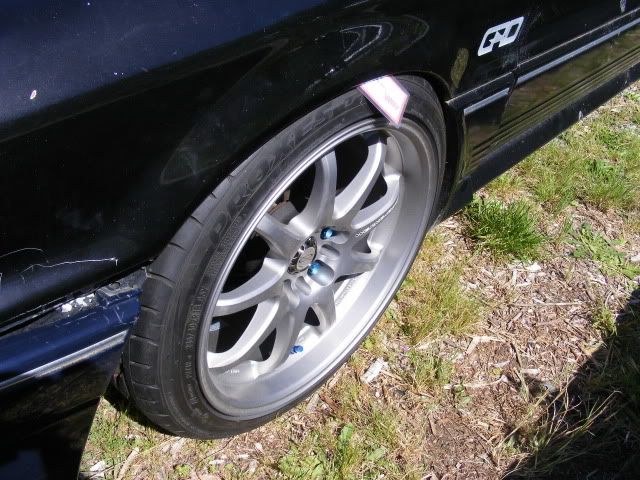

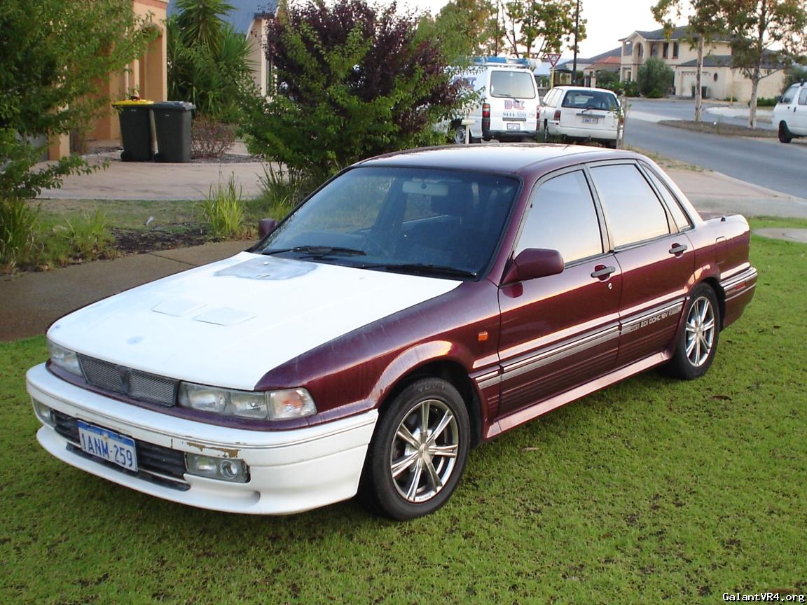

anyway here's some pictures of my lack of progress :p
The silver vr4 in the background is waiting for me to pull the steering rack out and overhaul it, did the cambelt/etc not long ago.
Looking at the pic it's really obvious the door surrounds need repainting!
As for the other one...
I need to build some intercooler piping to suit the new location of the core, plumb the 38mm wastegate back into the exhaust, fit a muffler of some sort (probably), fit the reground 264º cams I picked up for $100 (kiwi $, er, that's about $3.75 American I think), redrill the original discs to suit the new 5stud from hubs then add some coolant, petrol, fresh oil/filter.
With abit of luck it'll be ready for a burnout comp at the end of the month.
Almost forgot, need to roll the guards a wee bit too
It's currently back to rwd until I get around to converting the rear to 5stud and fitting the other pair of work's.
I also need to modify the rear Cusco Evo5 coilovers I have and fit them (in place of the current Tein type HA's) to match the front Cusco's.
Interior needs some tidying up too (particularly the birds nest of wiring where the alarm is) - dash shell is back in place.

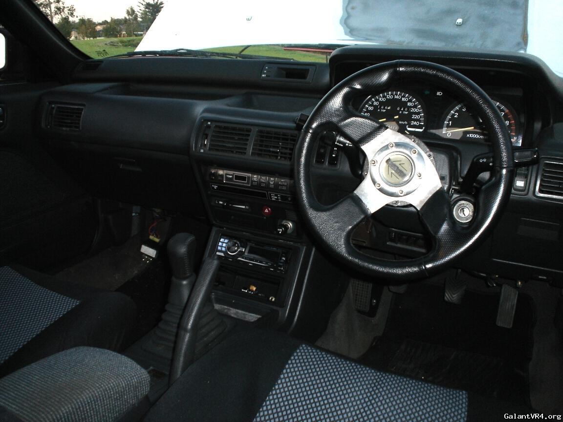

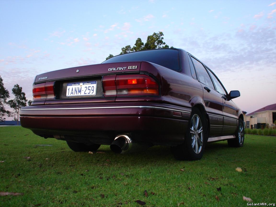

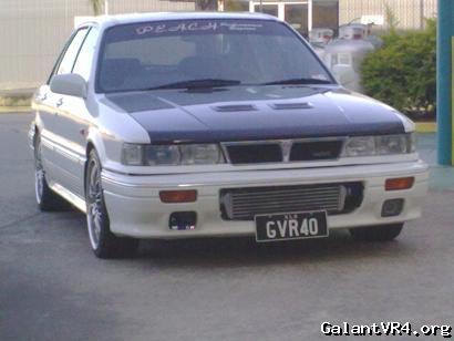

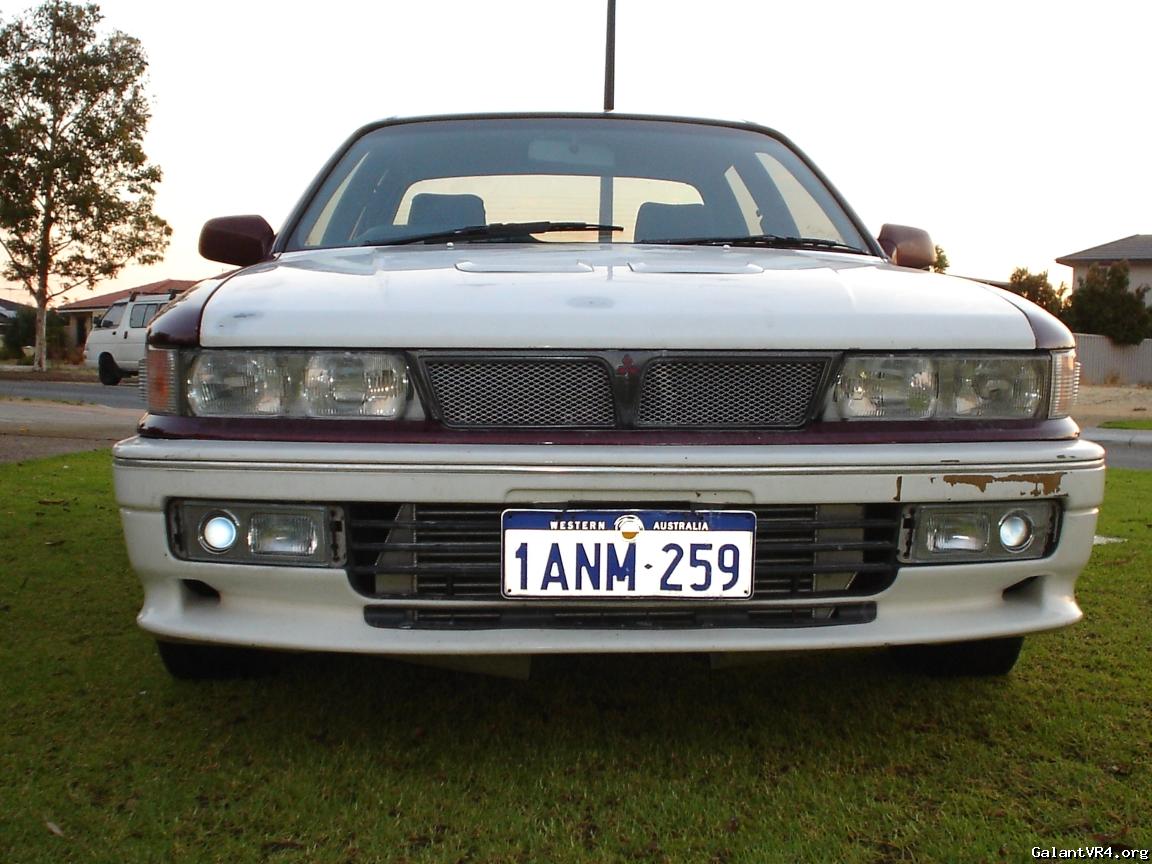

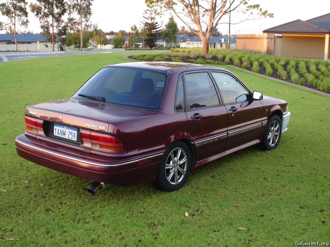

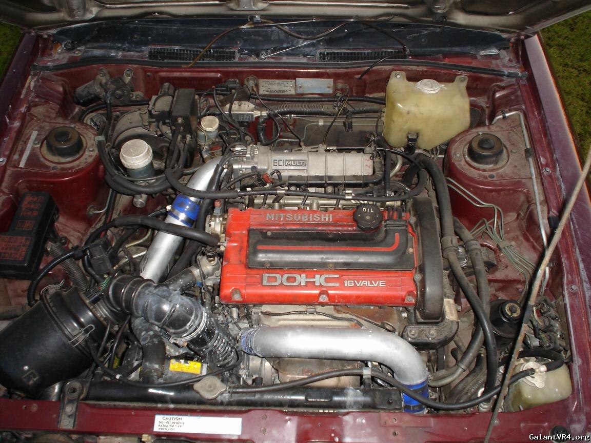

Hey guys this is my immaculate Aus Spec VR4 (Note the excellent condition of the paint work) /ubbthreads/images/graemlins/smile.gif
Still fairly stock so far only have 3 inch dump back exhaust, custom pwr front mount and piping with turbosmart bov, small 16G turbo, king springs, koni rears and some sort of rally shocks in the front and walbro intank fuel pump. Mods to come are bigger injectors, 609 MAF, chipped ecu, fix the body and paint and chuck in some subs.

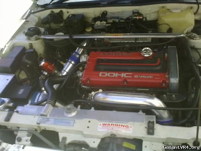

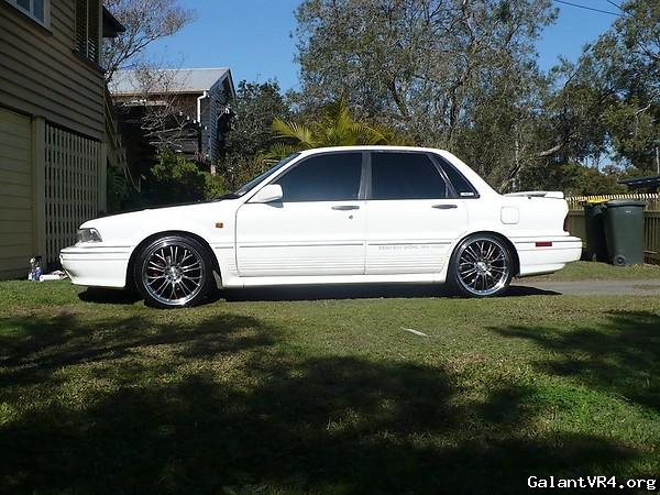

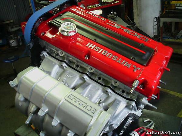

This is my 1990 A-spec.

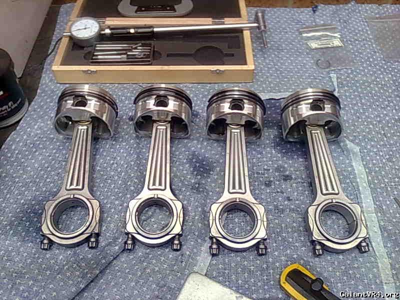

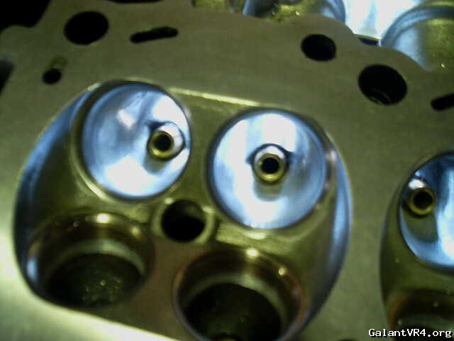

Built motor , Wiseco pistons 8.3:1, scat rods, BC 272/272 cam, ported head, 1mm oversized valves, ACL race bearings, balanced shaft removed (mitsu kit) ARP rod/main & head studs, Rochester 660cc, Walbro 255 rewired, FP Race mani, FP 18g 6sl2, 3" exhaust, Lukey muffler, 550x140x75 FMIC, 2'5" IC piping & TB elbow, ECMLink V3 (soon to be SD), Apexi AVCR (22psi) Innovate LC1 XD16 etc.
In the middle of tuning (pushing 40lb/min)

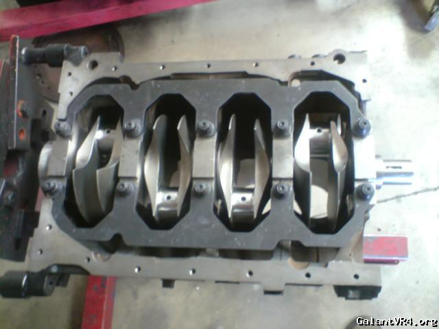

I might of went overboard on the amount of pics sorry guys, so mods feel free to delete a few if you like.

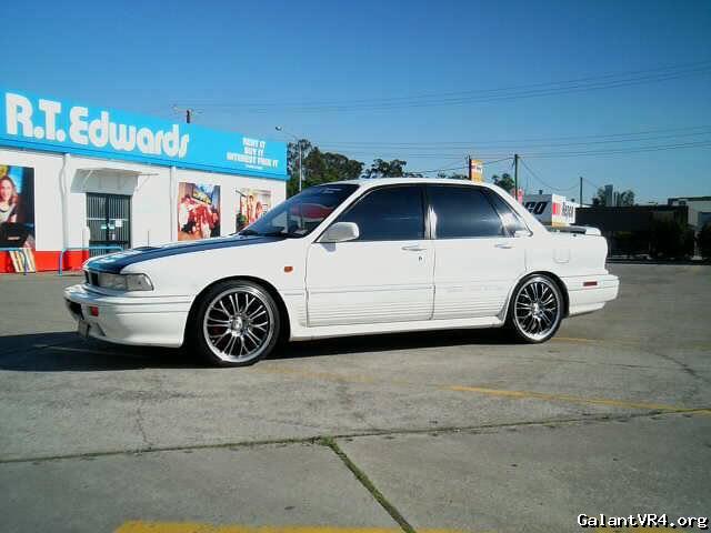

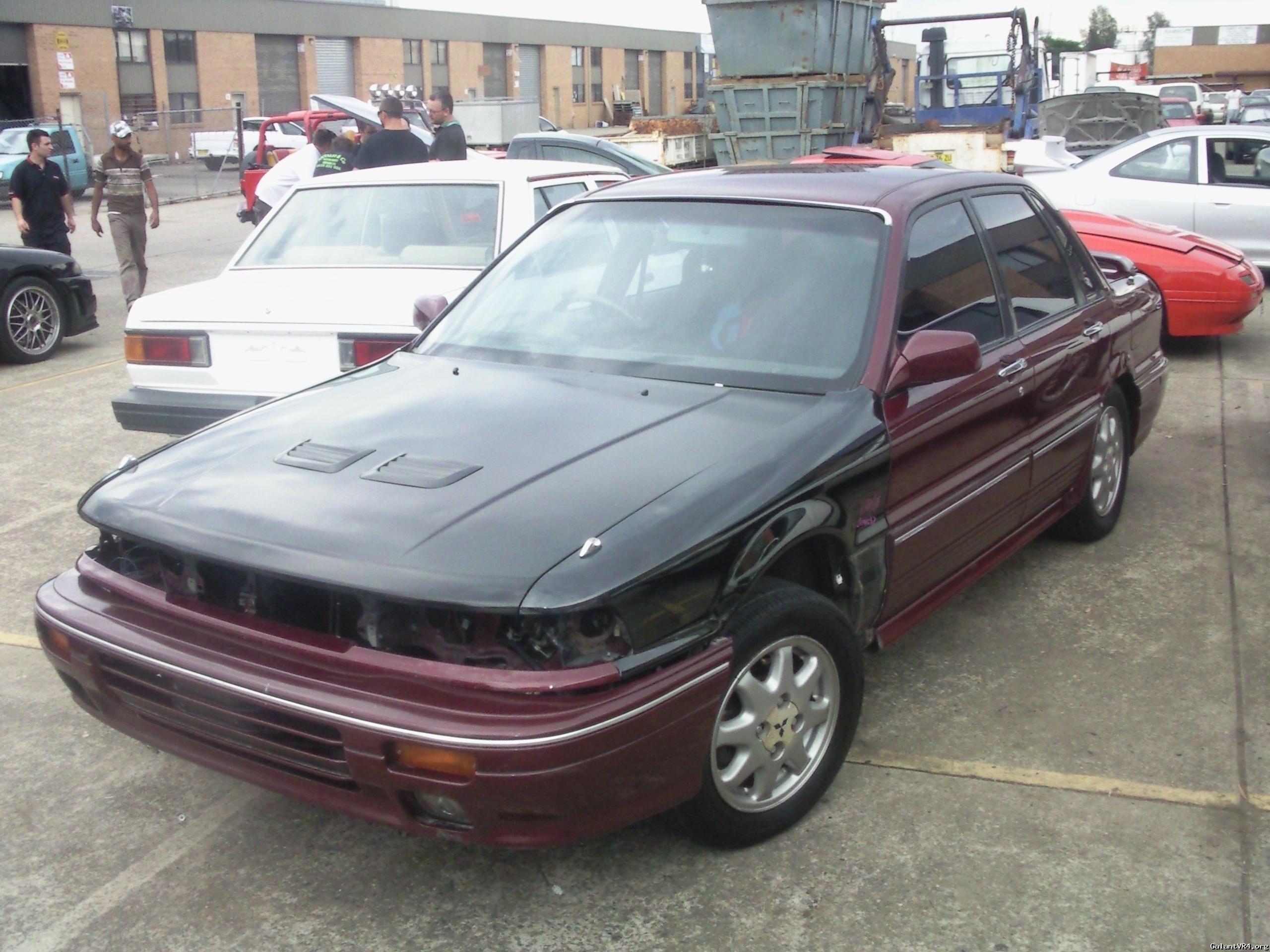

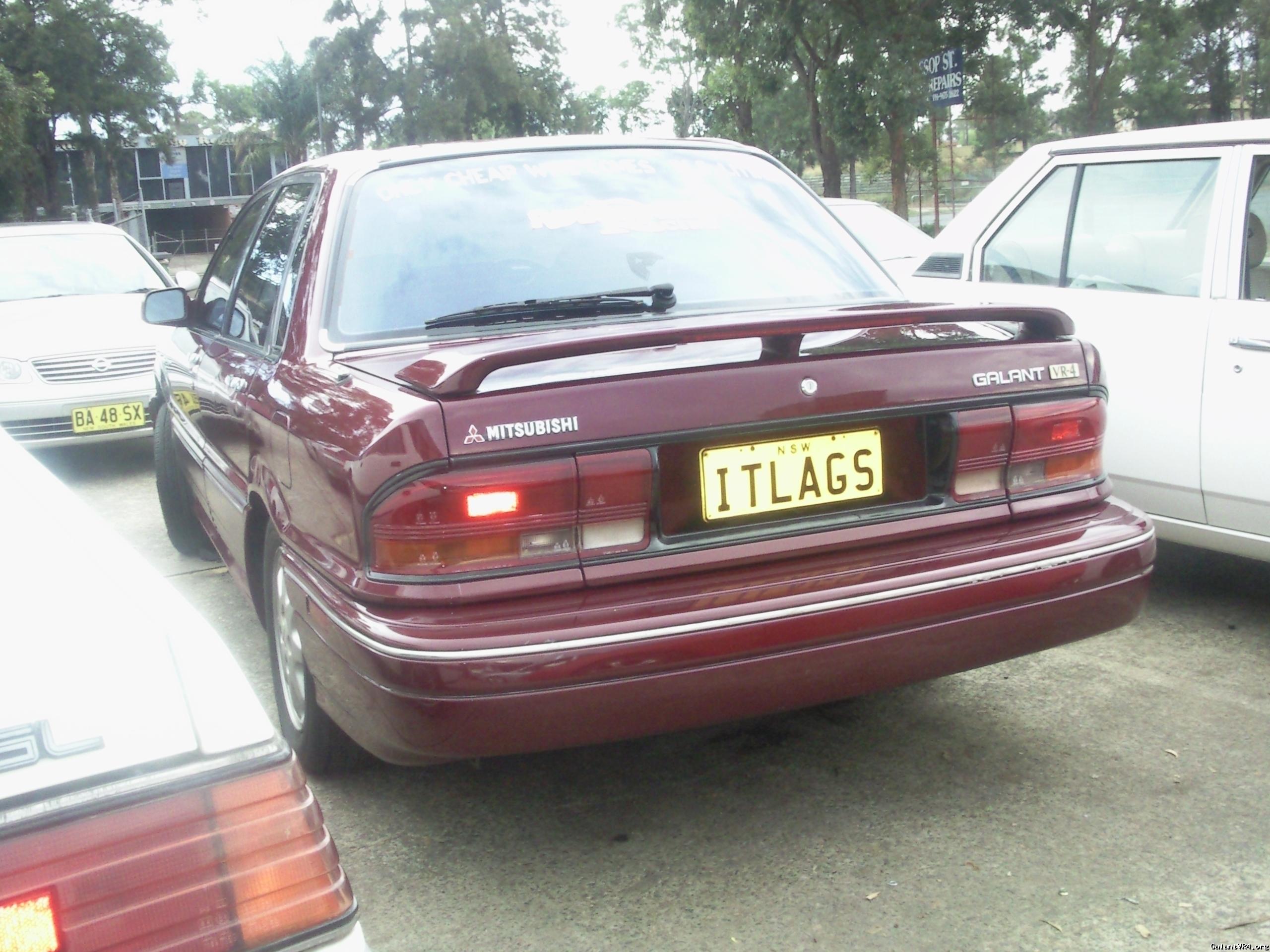

Needs abit of tidy up with the pannel beater and sprayer painter

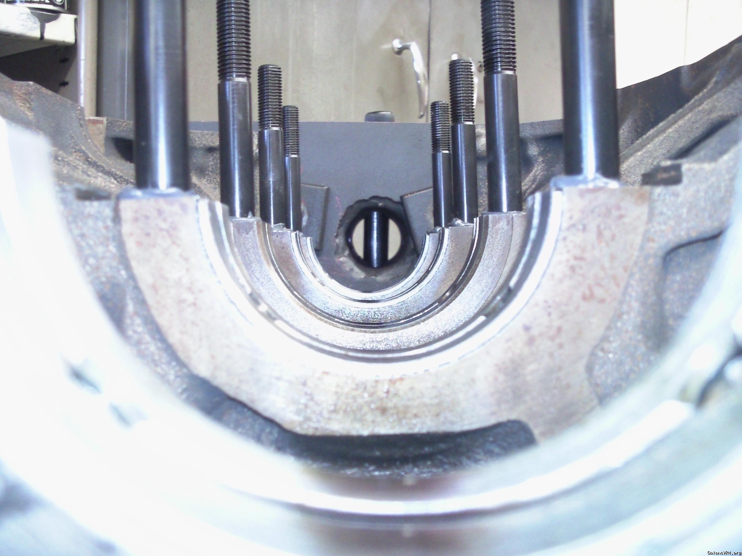

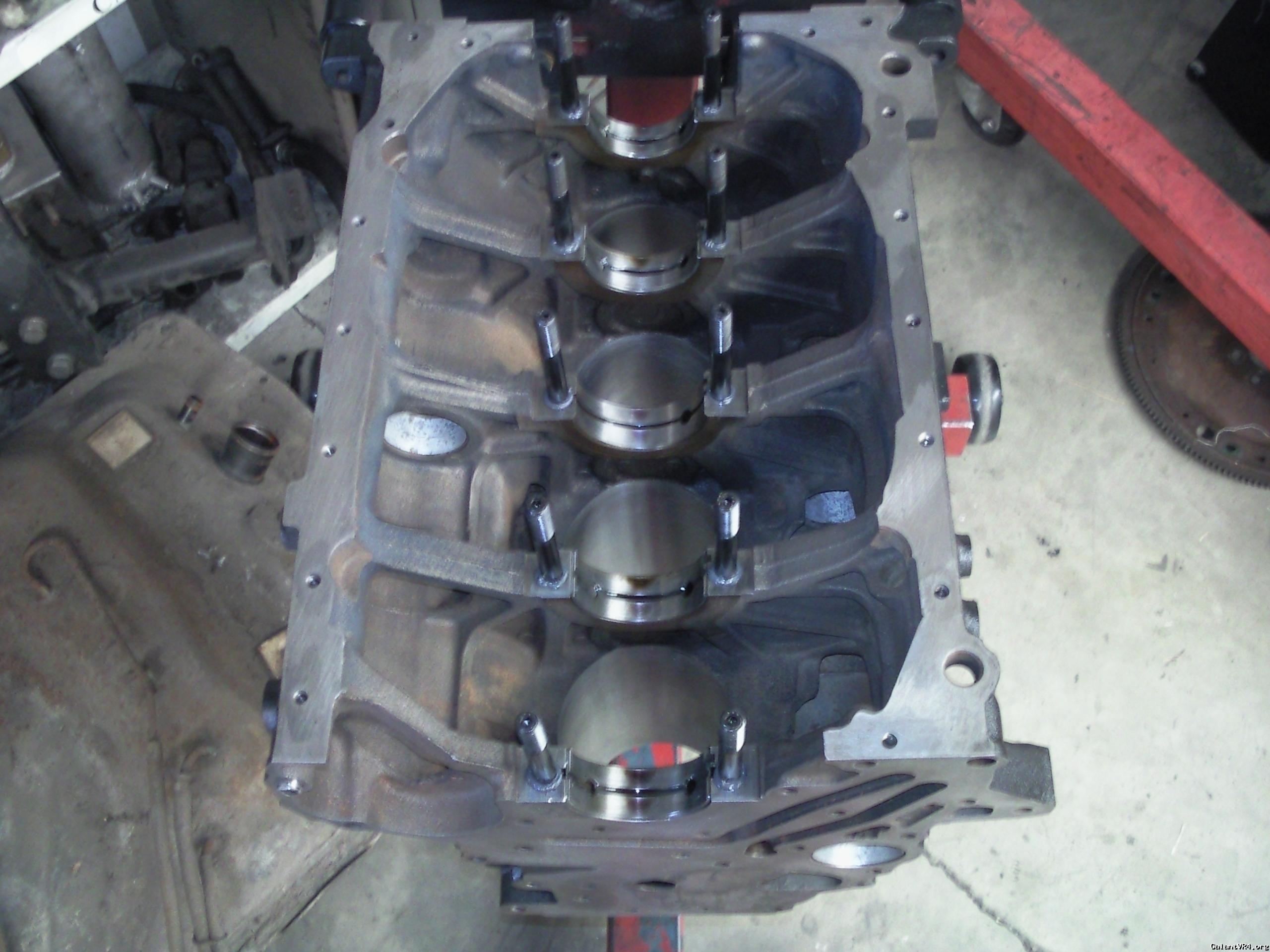

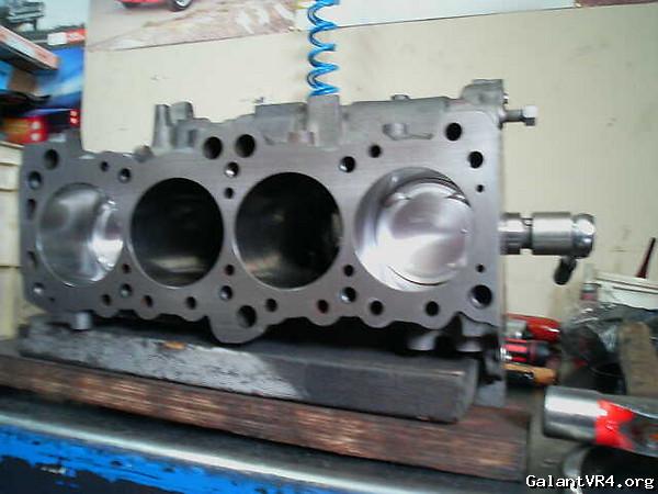

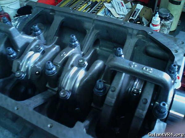

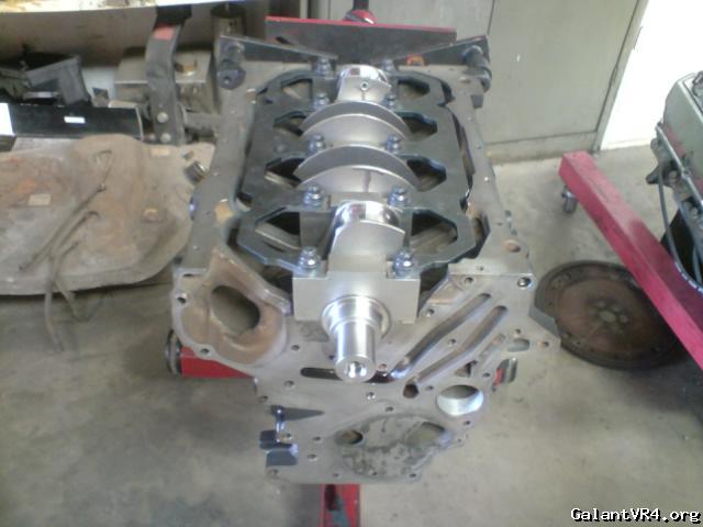

ACL race bearings and ARP main studs

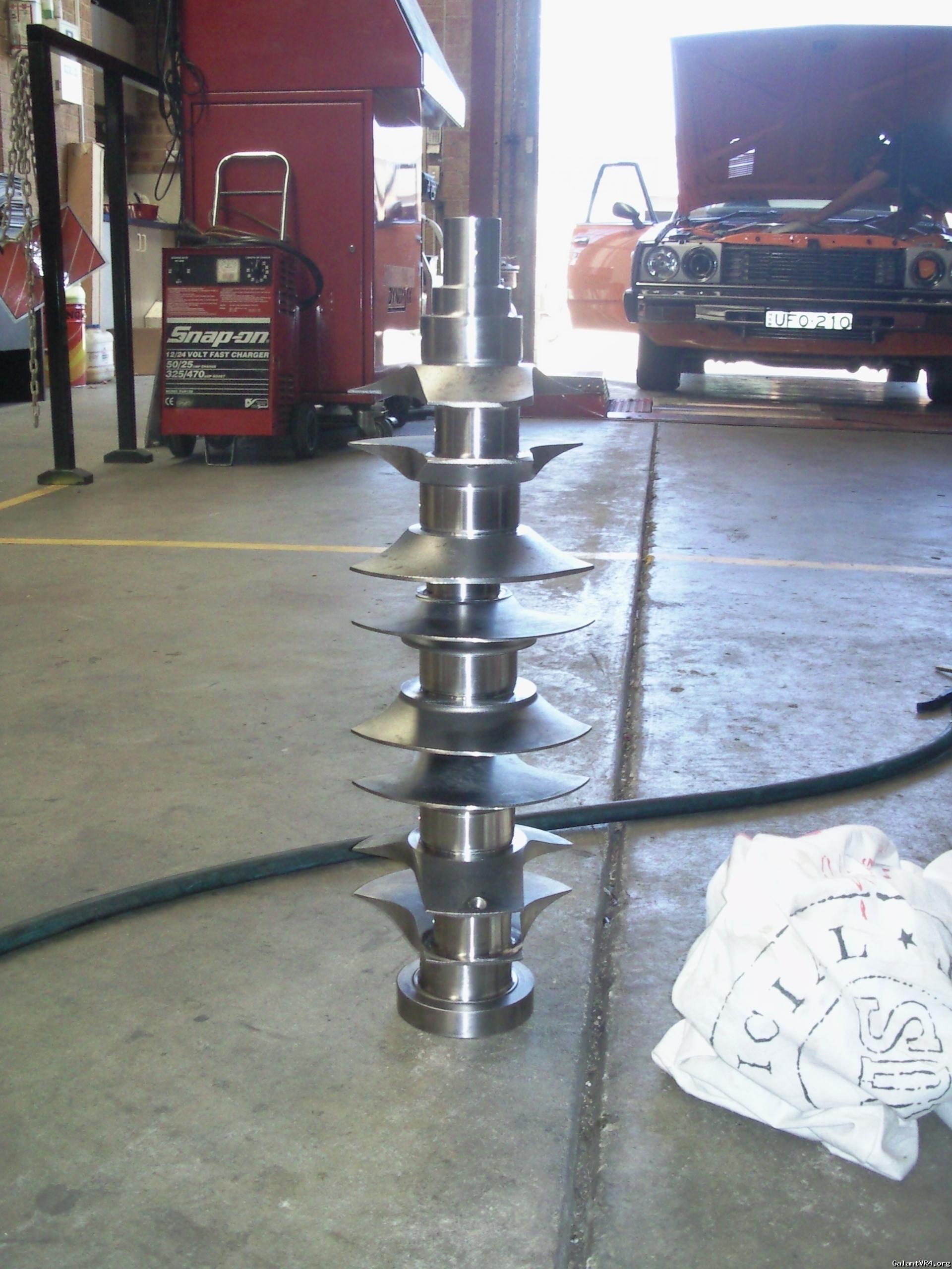

Magnus crank

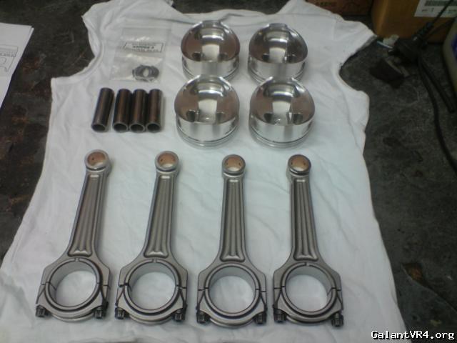

PAR rods and ROSS pistons
Main girdle
Billet main caps

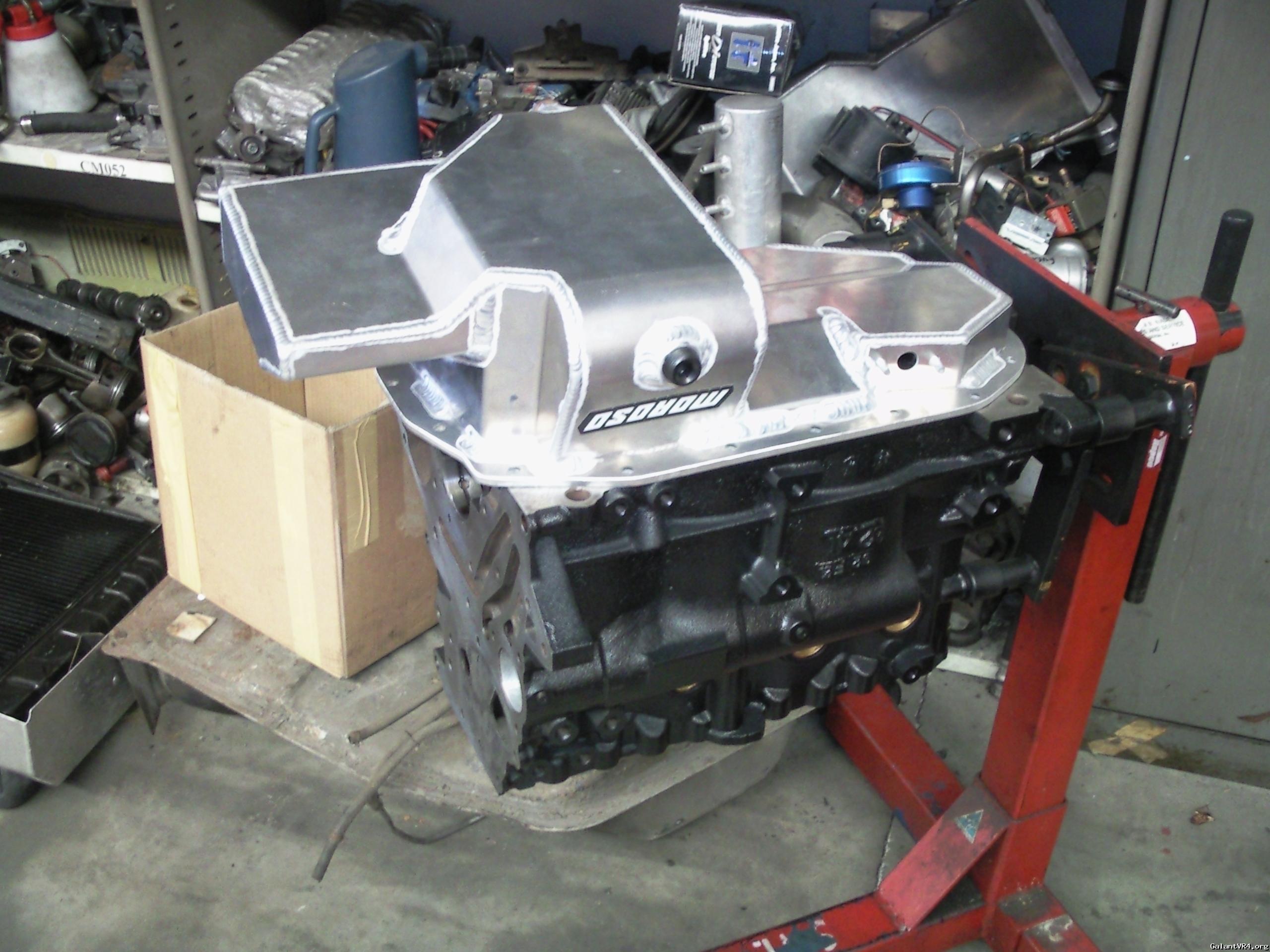

MOROSO sump

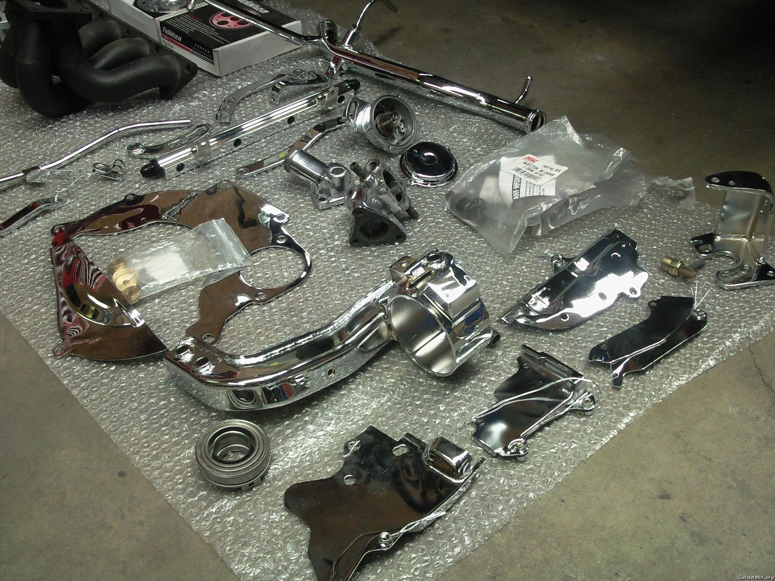

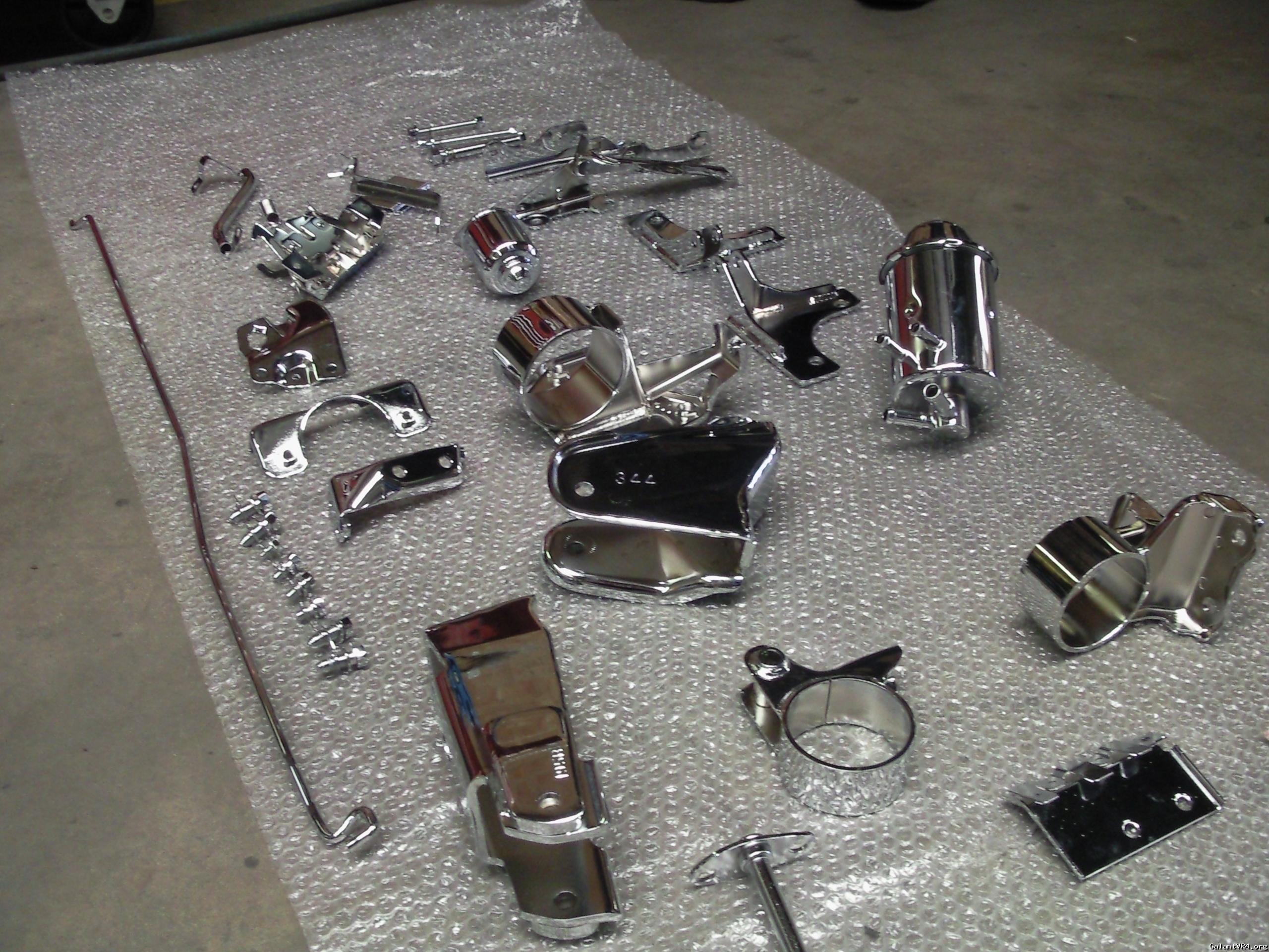

chrome
Chrome

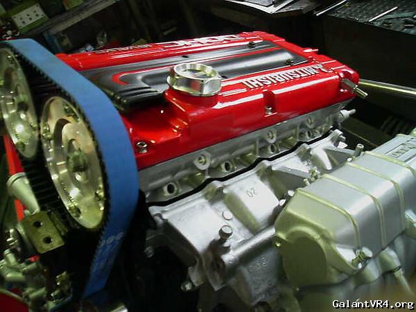

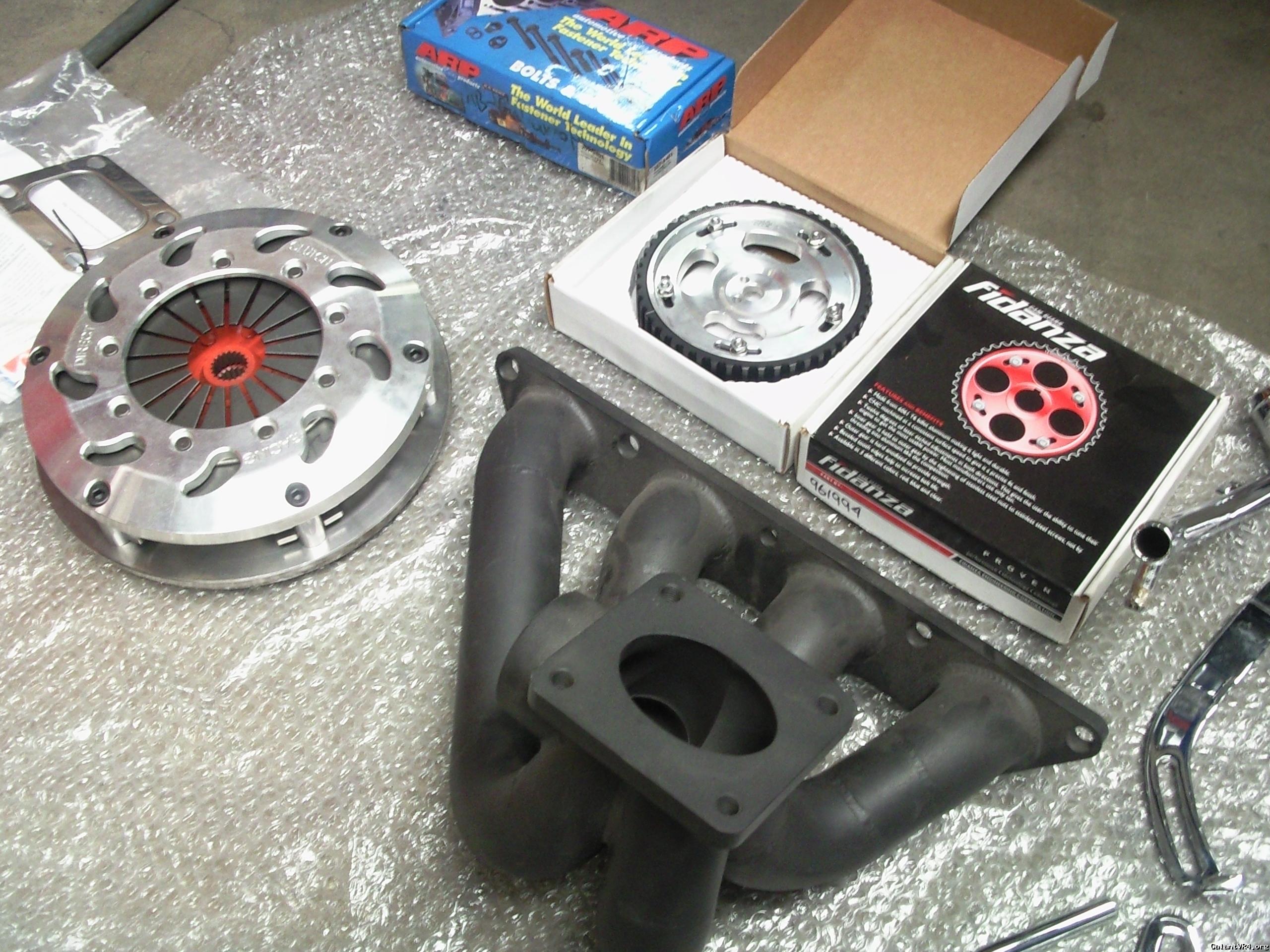

Twin plate clutch, ARP 1/2 inch head studs and cam gears

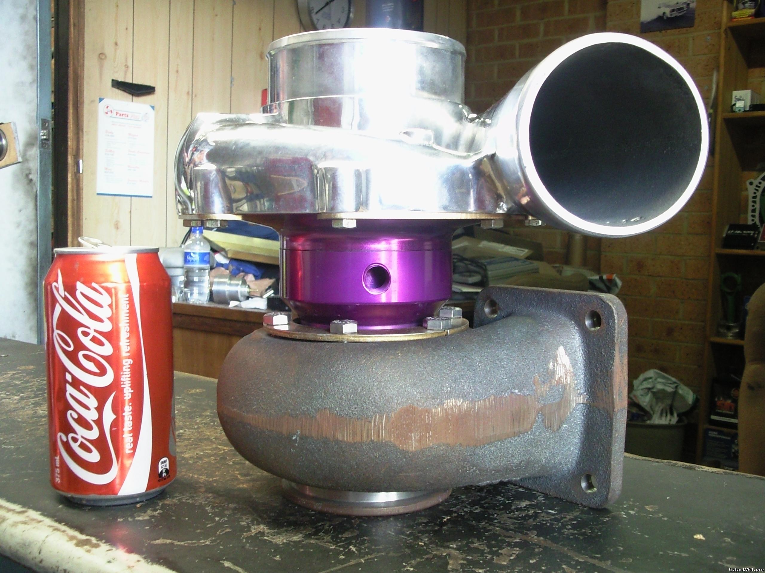

BILLET turbo from MR TURBO

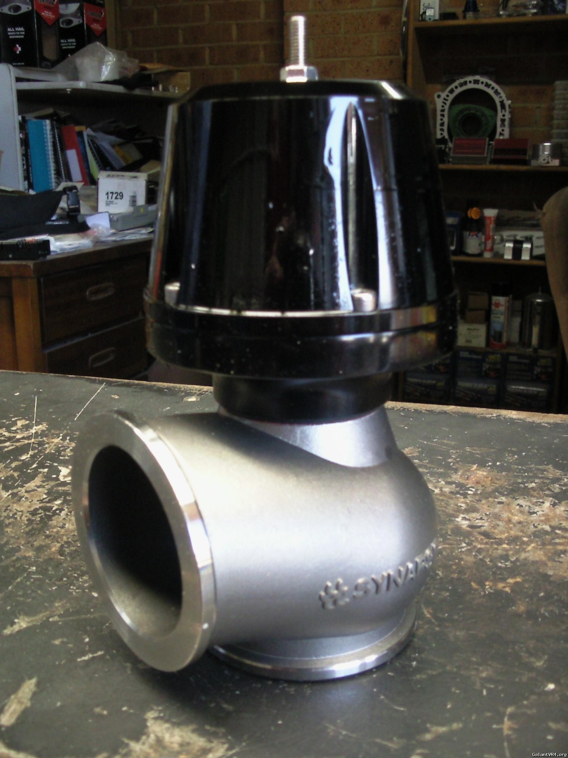

SYNCHRONIC 50mm external wastegate

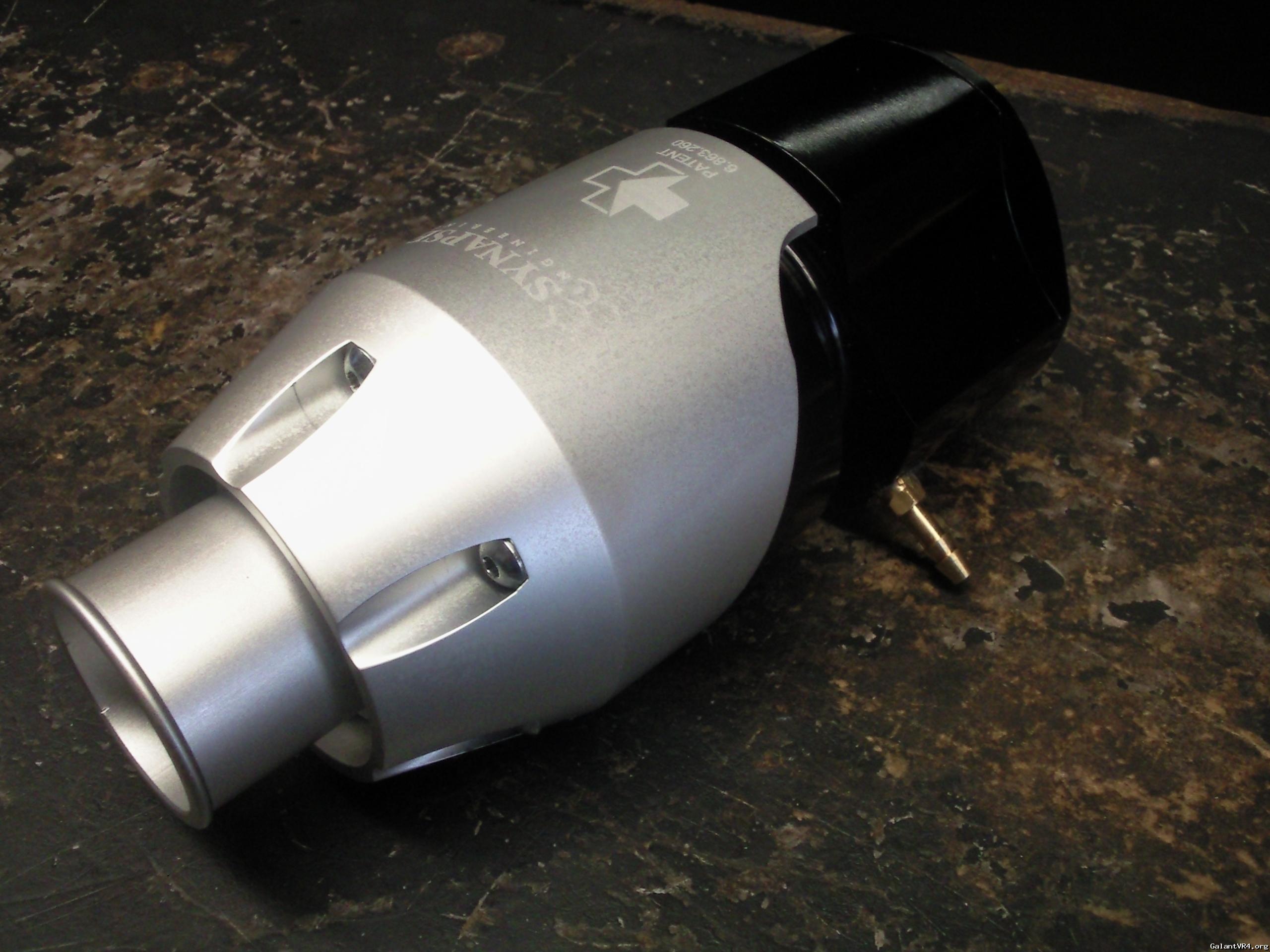

SYNCHRONIC blow off valve

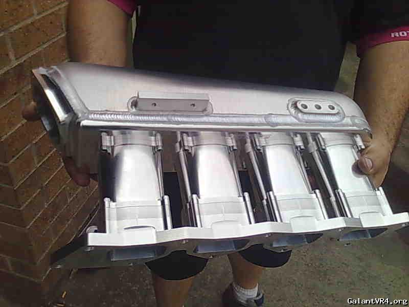

HYPERTUNE race intake manifold

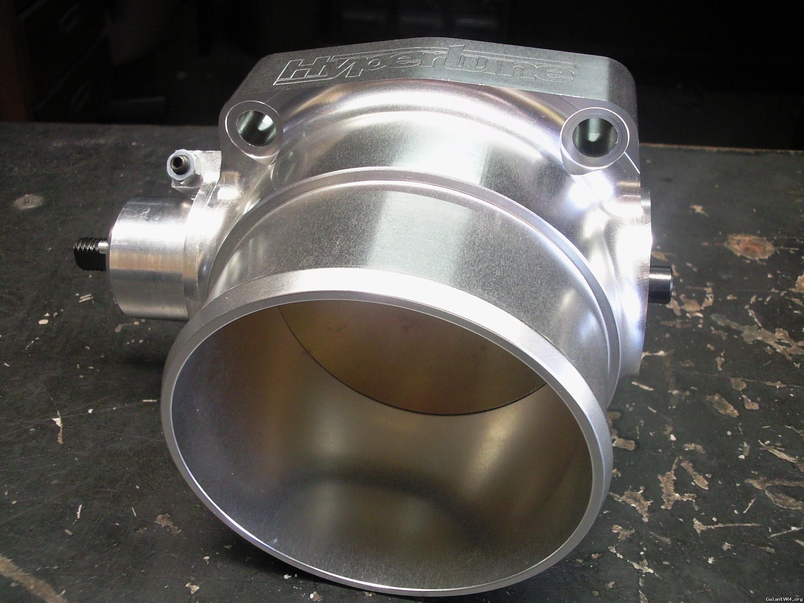

HYPERTUNE throtle body

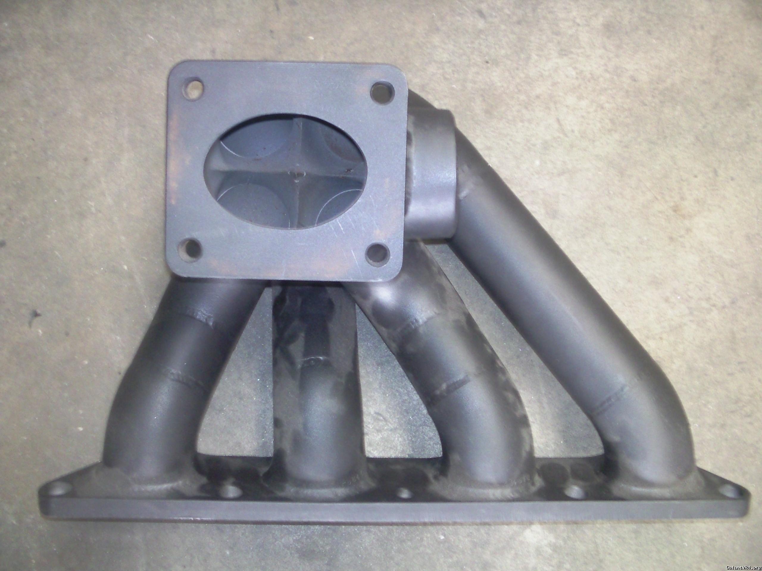

6BOOST manifold

I love that intake mani.

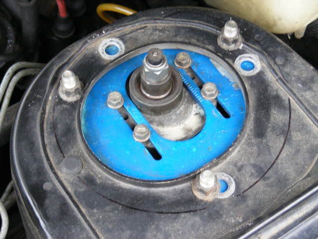

Unorthodox cam gears & Gates belt

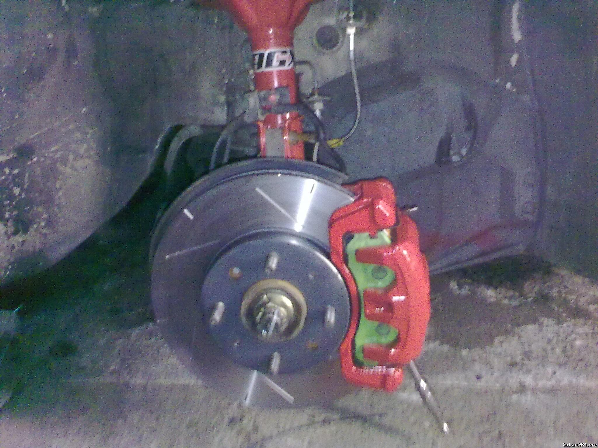

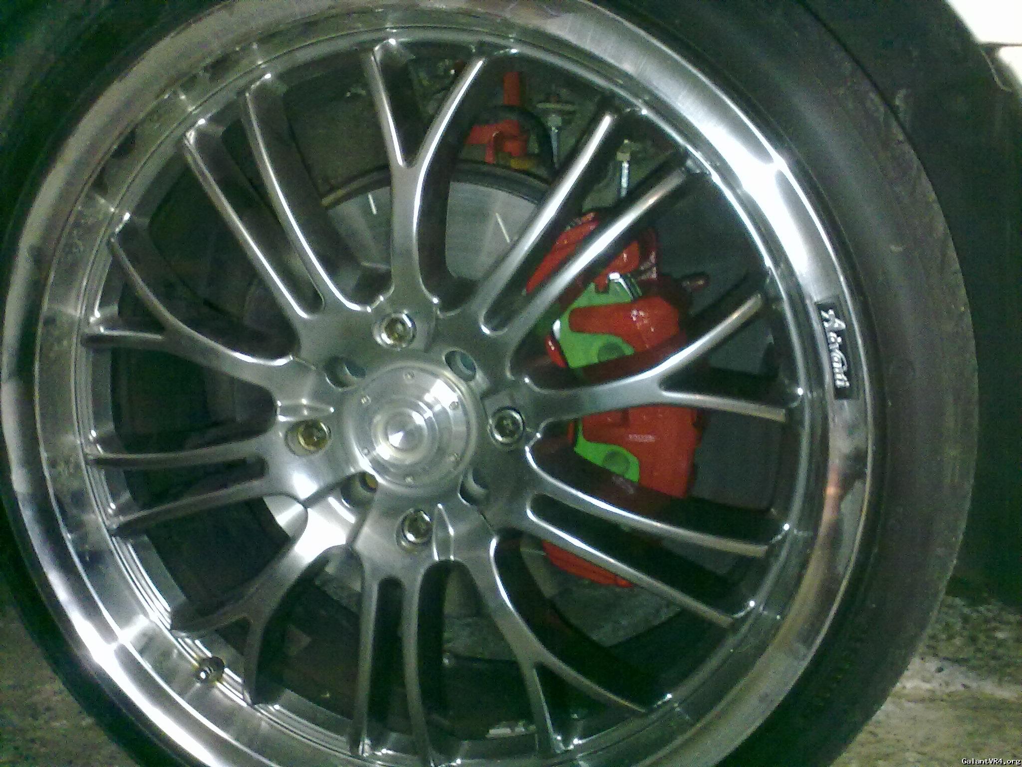

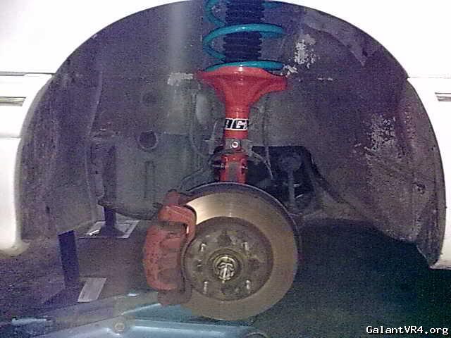

KYB AGX 1g front struts & Dobinson superlow springs
Slotted front rotor , Goodridge SS brakelines & green stuff pads

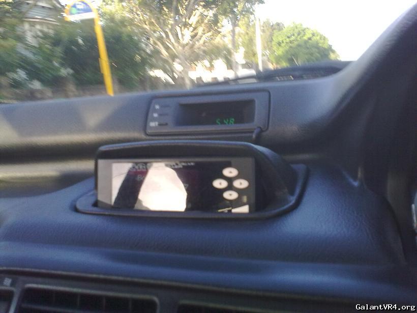

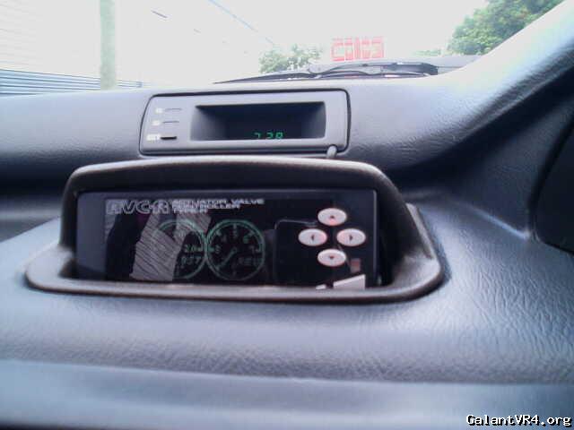

Apexi AVCR in Galant GSR dash pod

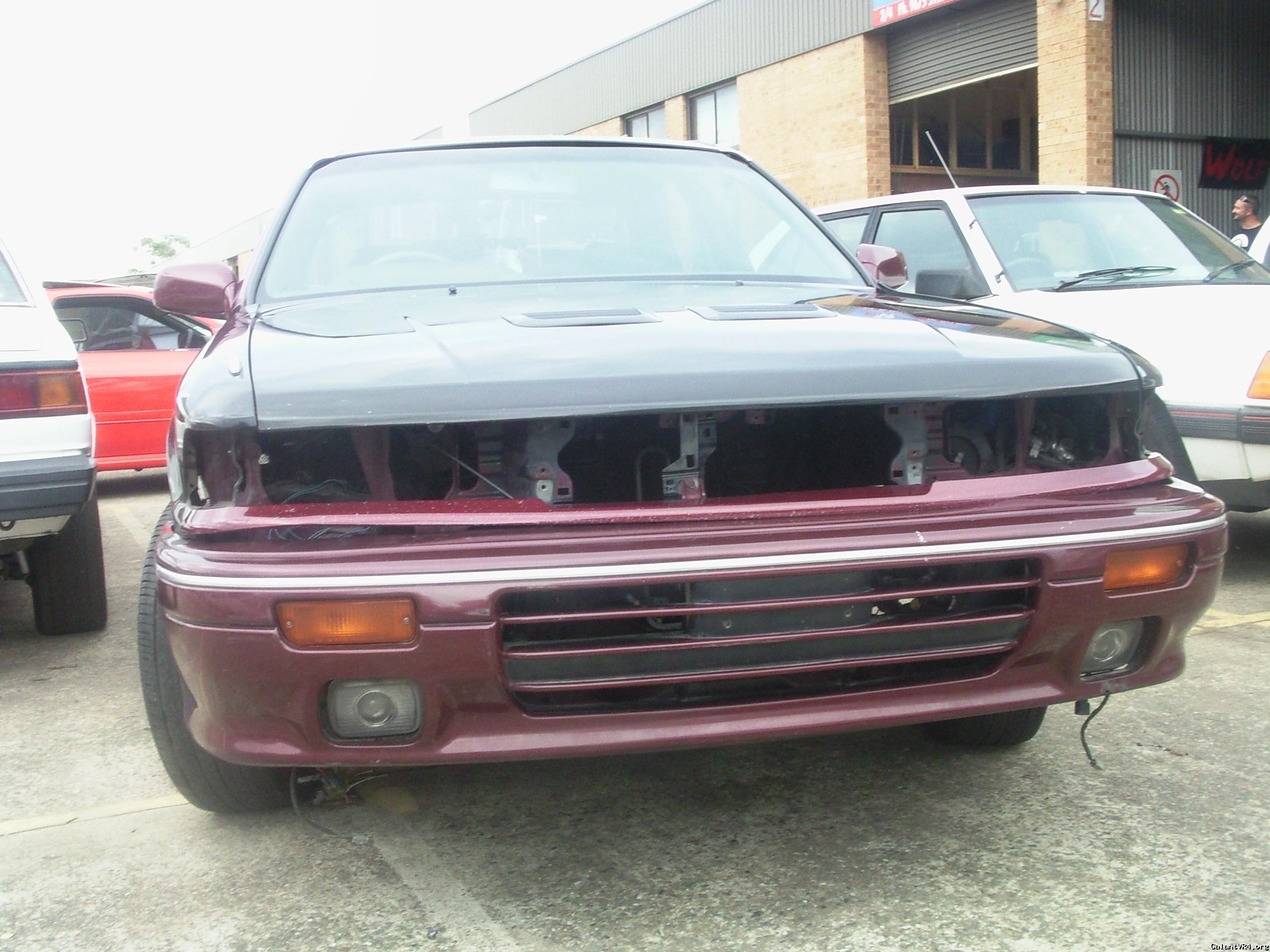

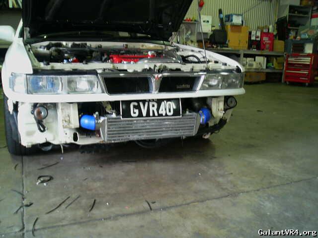

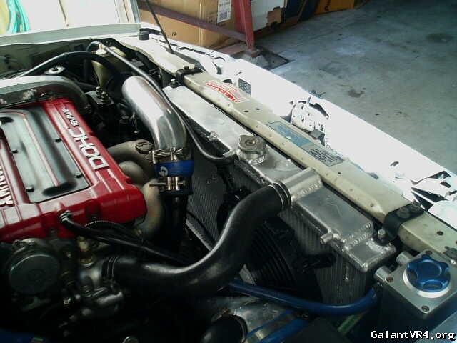

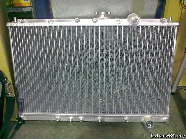

Evo 3 radiator

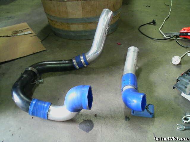

Old long IC pipe & new shorter pipe. It runs between th chasis rail & narrower radiator

ozyvr4: how wide is the evo3 radiator? does it fit the stock lower mounts? might be just what I need!

We Aussies got the same body as the US. The cars are very simular. We got cloth seats instead of leather. You got those funny front seat belts,& clear lenses for the front bar indicators.
On the Radiator width, its about 25mm short on each side. The bottom & top locating pins are the same except the top is 40mm lower than the VR4 unit. Just make some brackets that bolt to original bolts. I only use 2.5" IC piping so after you cut a little metal the silicone hose fit snuggly in between the chasis & radiator. You may have to move your power steering hoses & main harness over a touch. I try get some better pics of where the pipe goes through.
