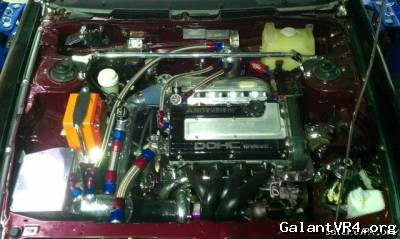

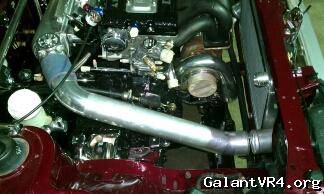

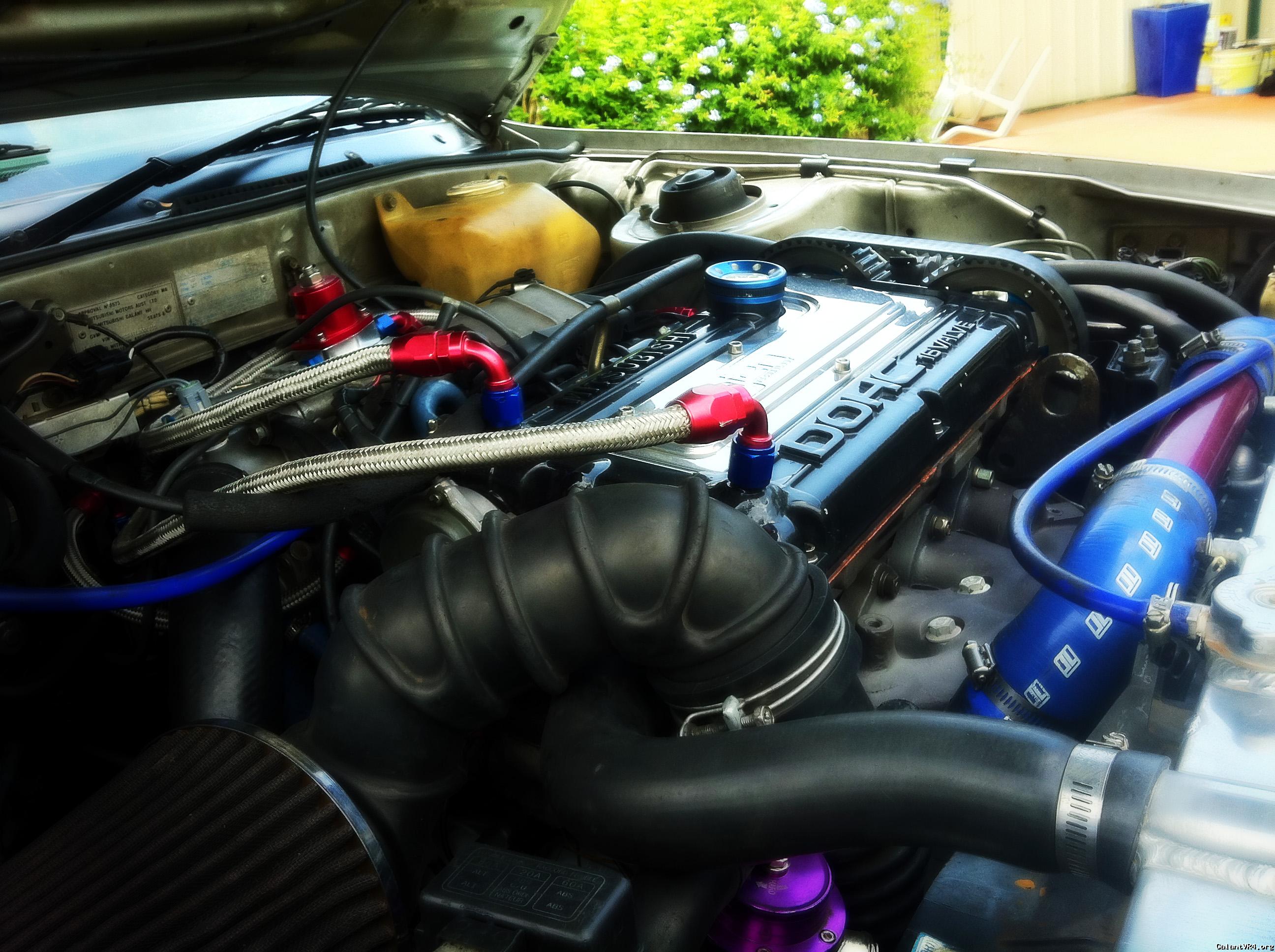

Fabrication
dump
intercooler pipes

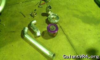

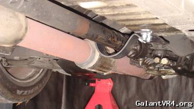

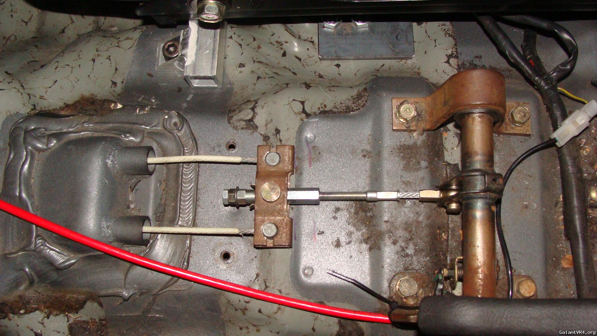

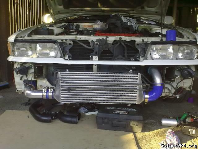

One step closer to getting back to road legal!

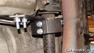

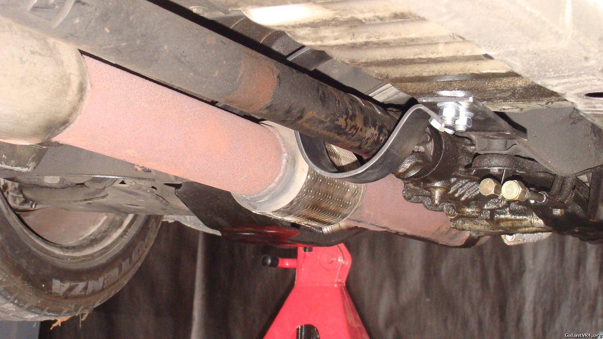

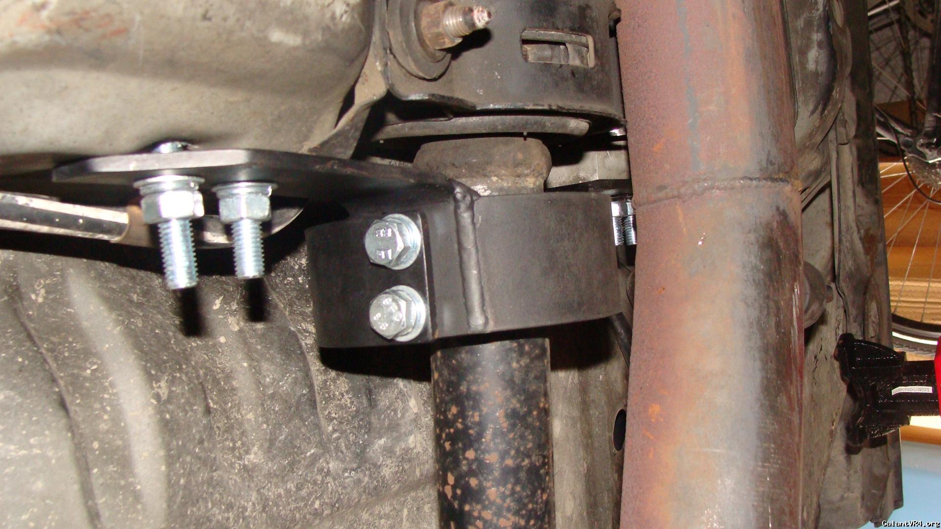

3 sets of these to keep the car from pogo-ing due to a snapped driveshaft /ubbthreads/images/graemlins/blush.gif

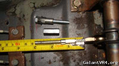

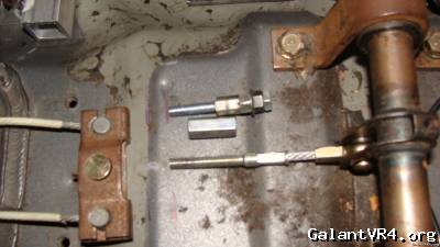

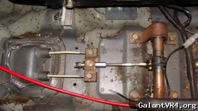

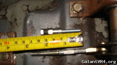

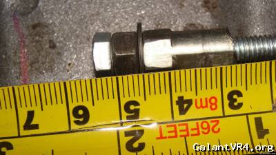

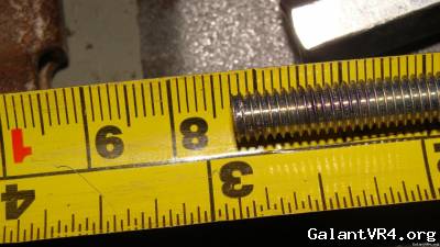

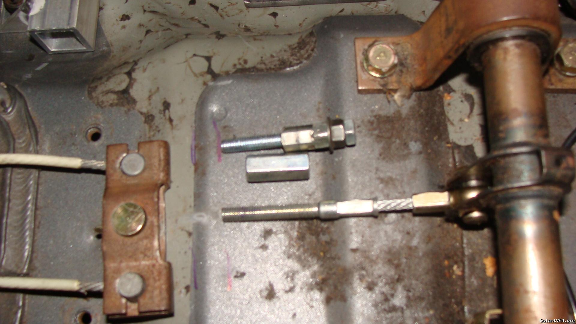

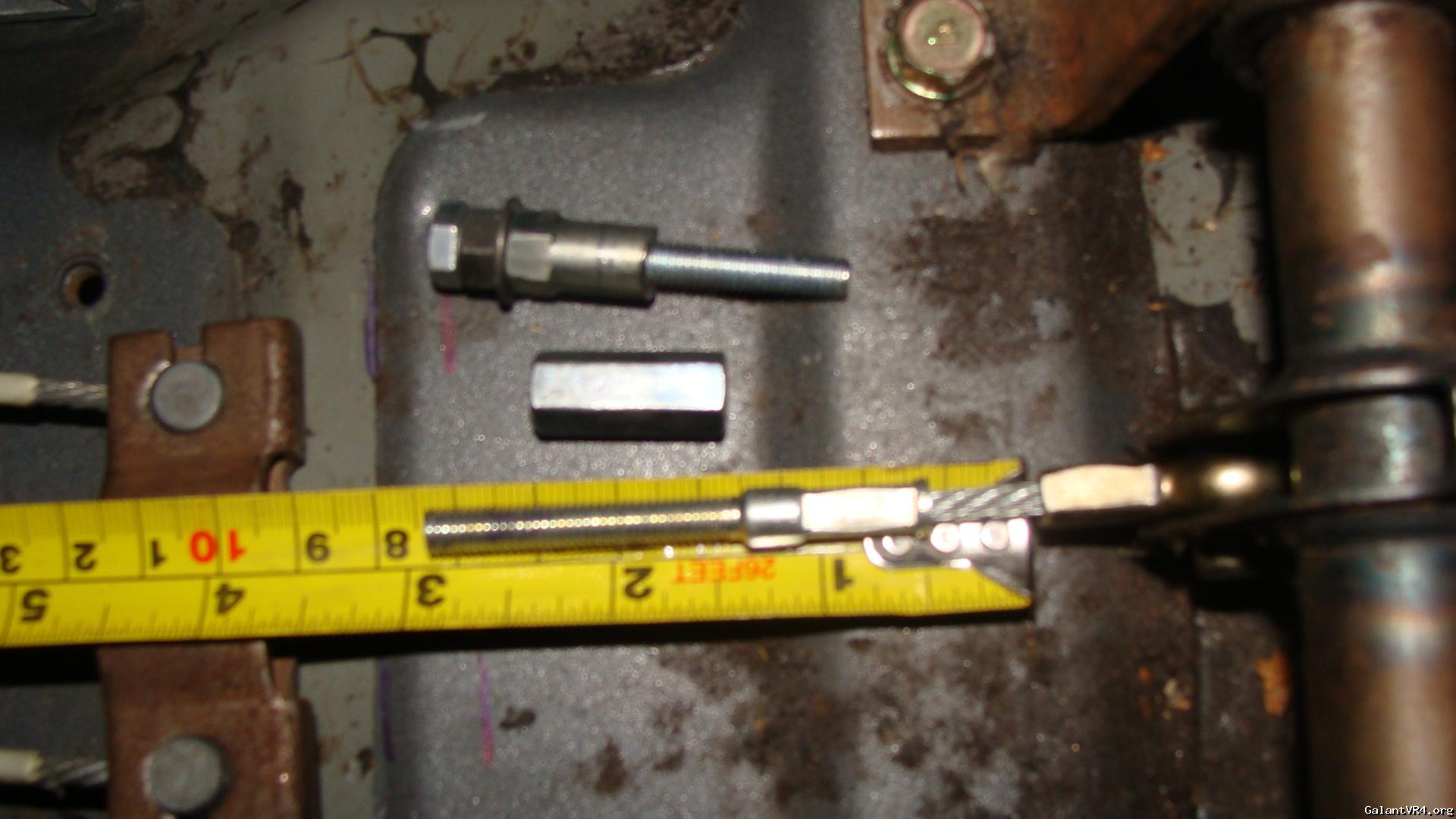

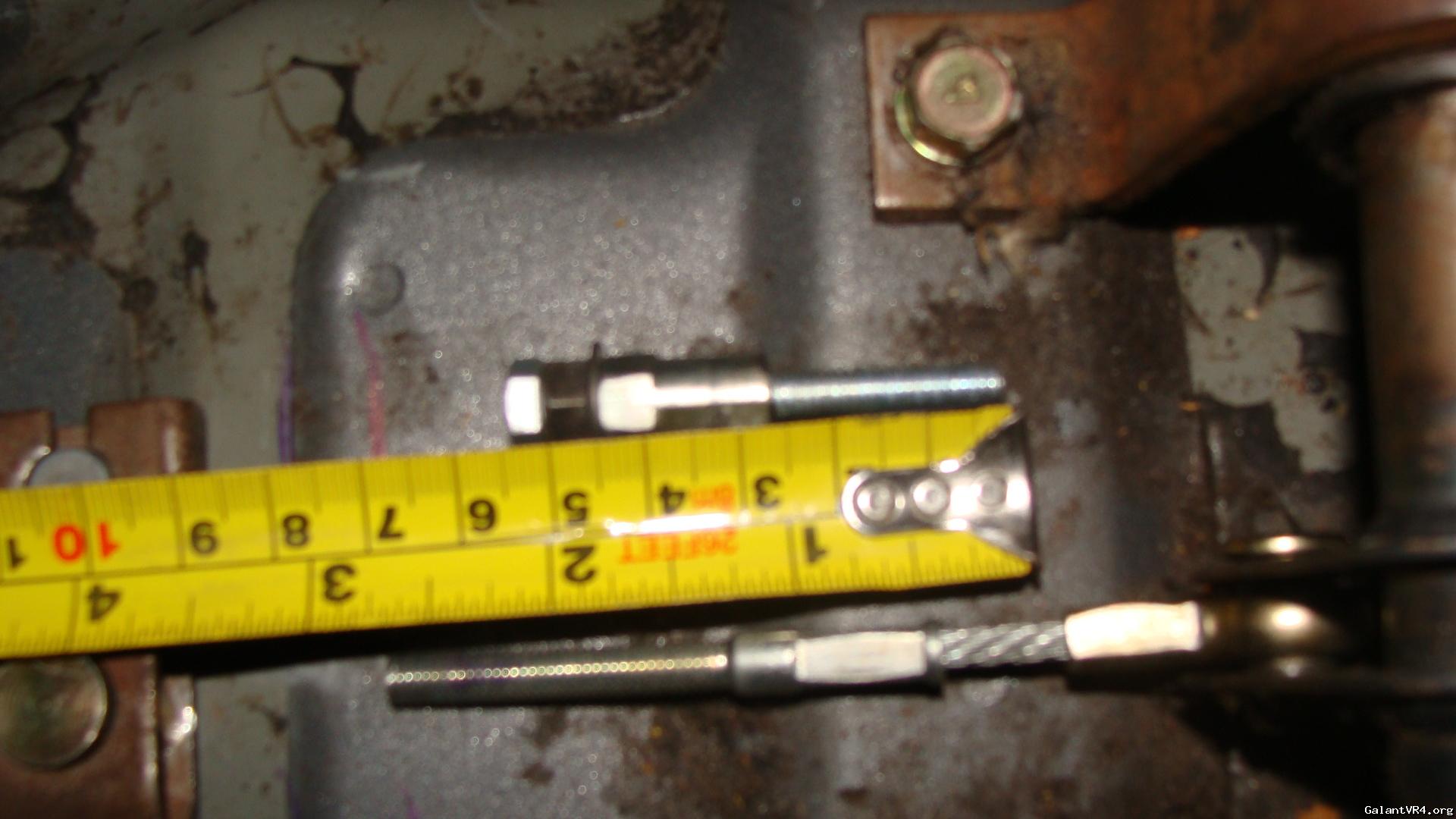

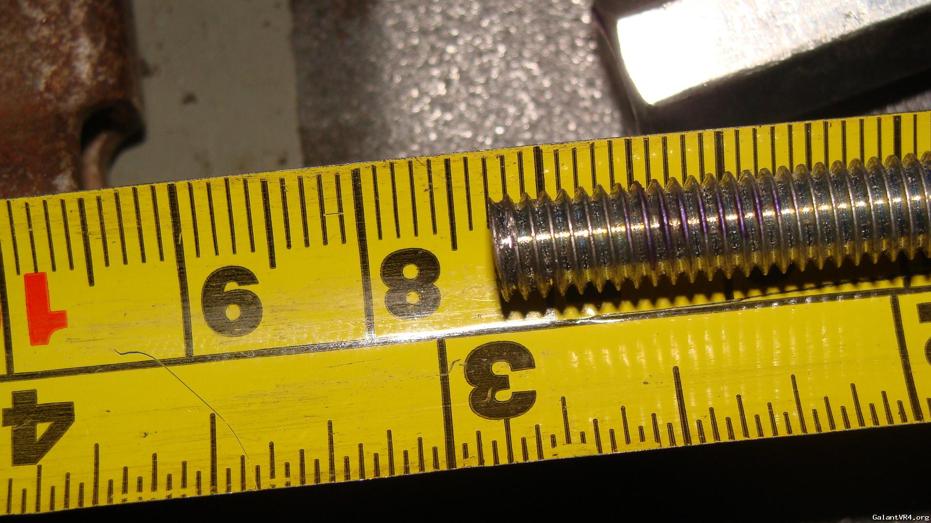

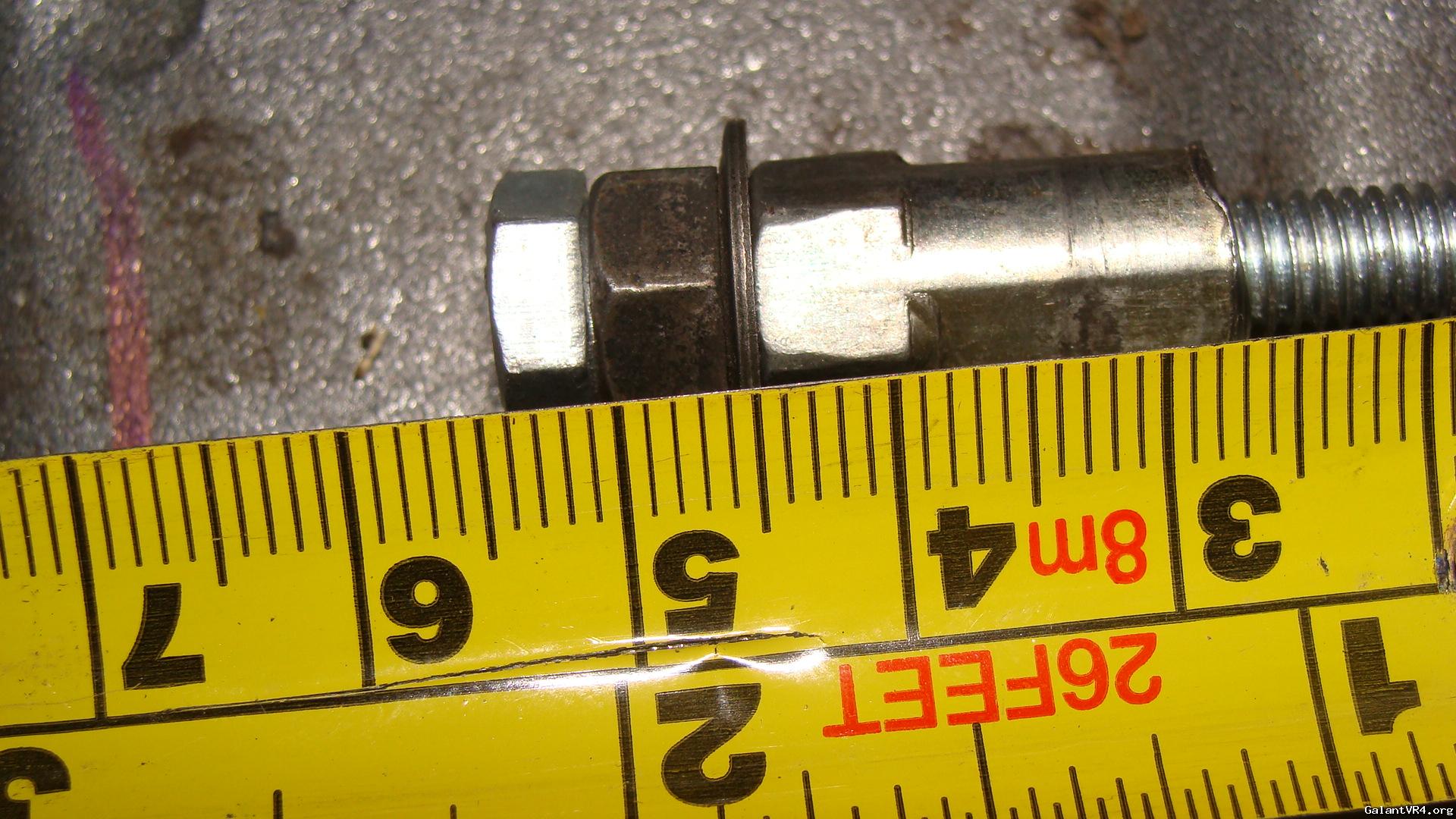

Few shots of the revised handbrake linkage - this time the throw is shorter and more effective. Not sure what size the bolts and coupling nuts are but they fit a 10mm spanner, so maybe M6 or M8?
I've cut off another 5-10mm of threads and fitted a spacer nut to the (longer) adjustment bolt. It would be better to cut the extra length from the actuator rod. Photos have come out blurrier than they appeared on the camera :/
I think cutting the rod down to 75mm or even 70mm length (from the far crimping) could be ideal. The movement of the handbrake is now about 30-45* rather than the 80-90*ish it was before /ubbthreads/images/graemlins/laugh.gif

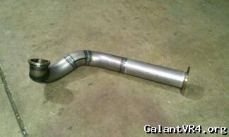

Mate if this was a race im last for sure. /ubbthreads/images/graemlins/smile.gif

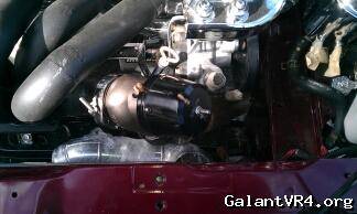

Yes that is a Vband dump

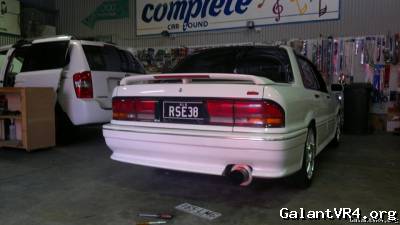

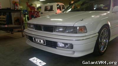

Got the car all certified and went for a warrant, expecting to fly through because there was nothing wrong in the pre-cert inspection.
I failed because the inspector believes my car was not turbocharged from the factory /ubbthreads/images/graemlins/banghead.gif /ubbthreads/images/graemlins/applause.gif I don't know weather to laugh or cry.

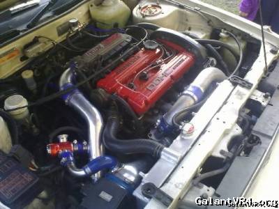

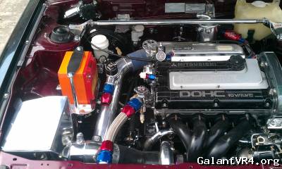

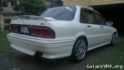

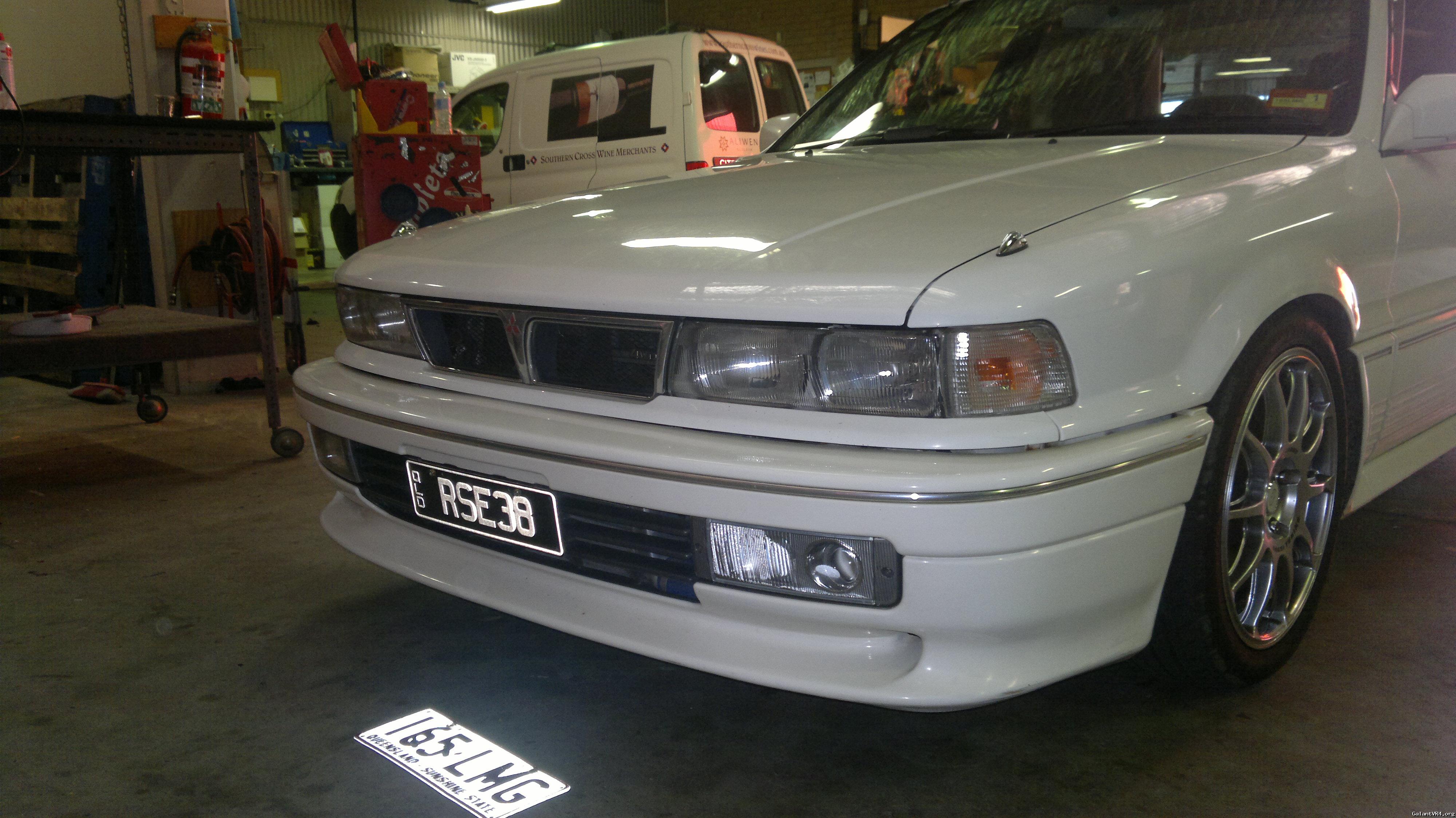

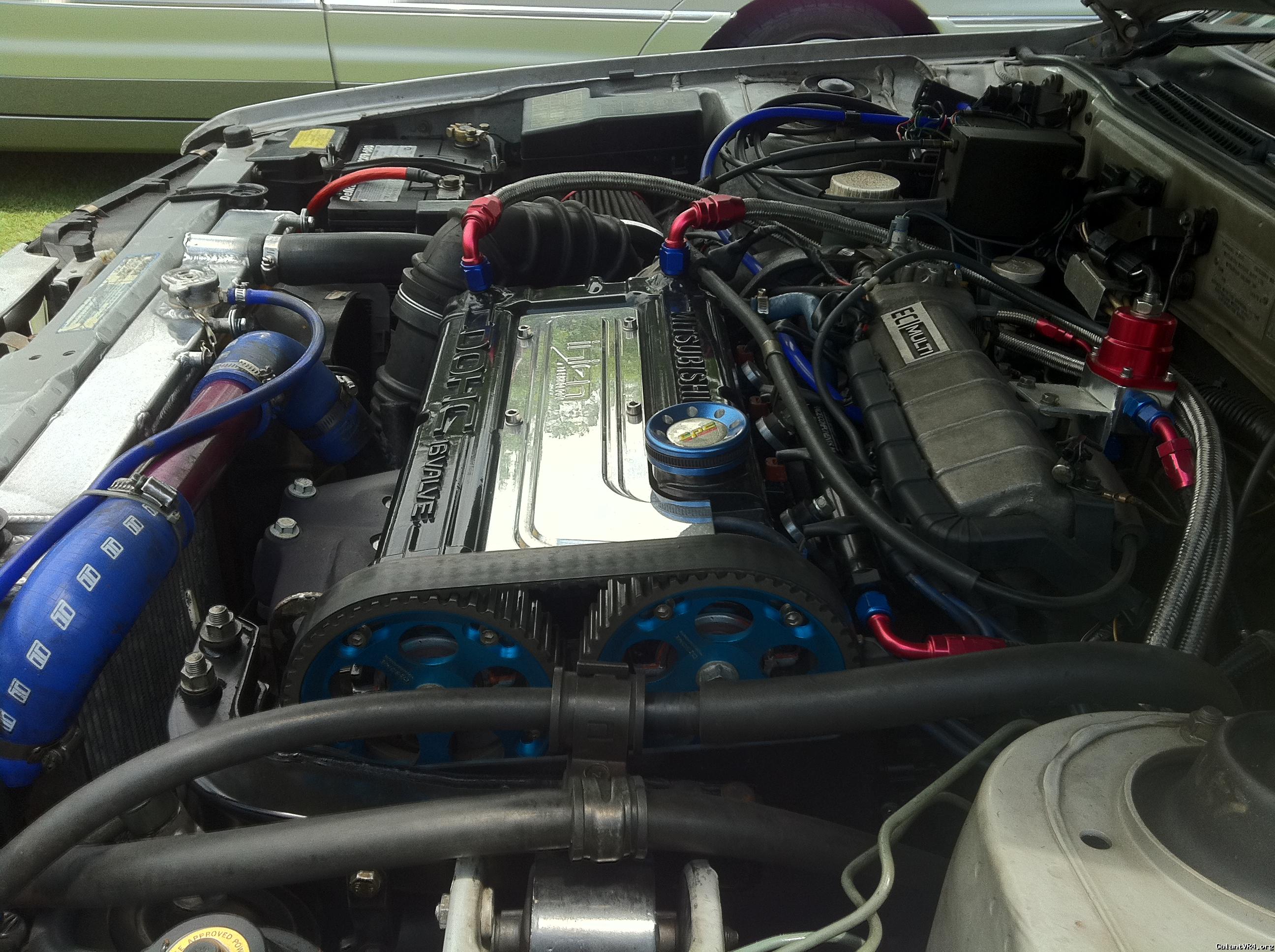

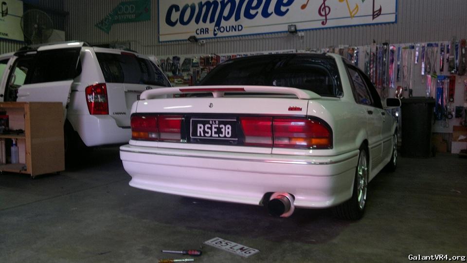

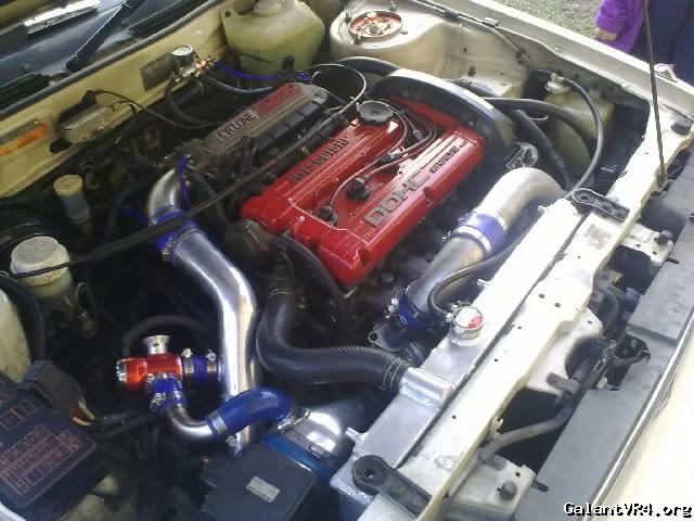

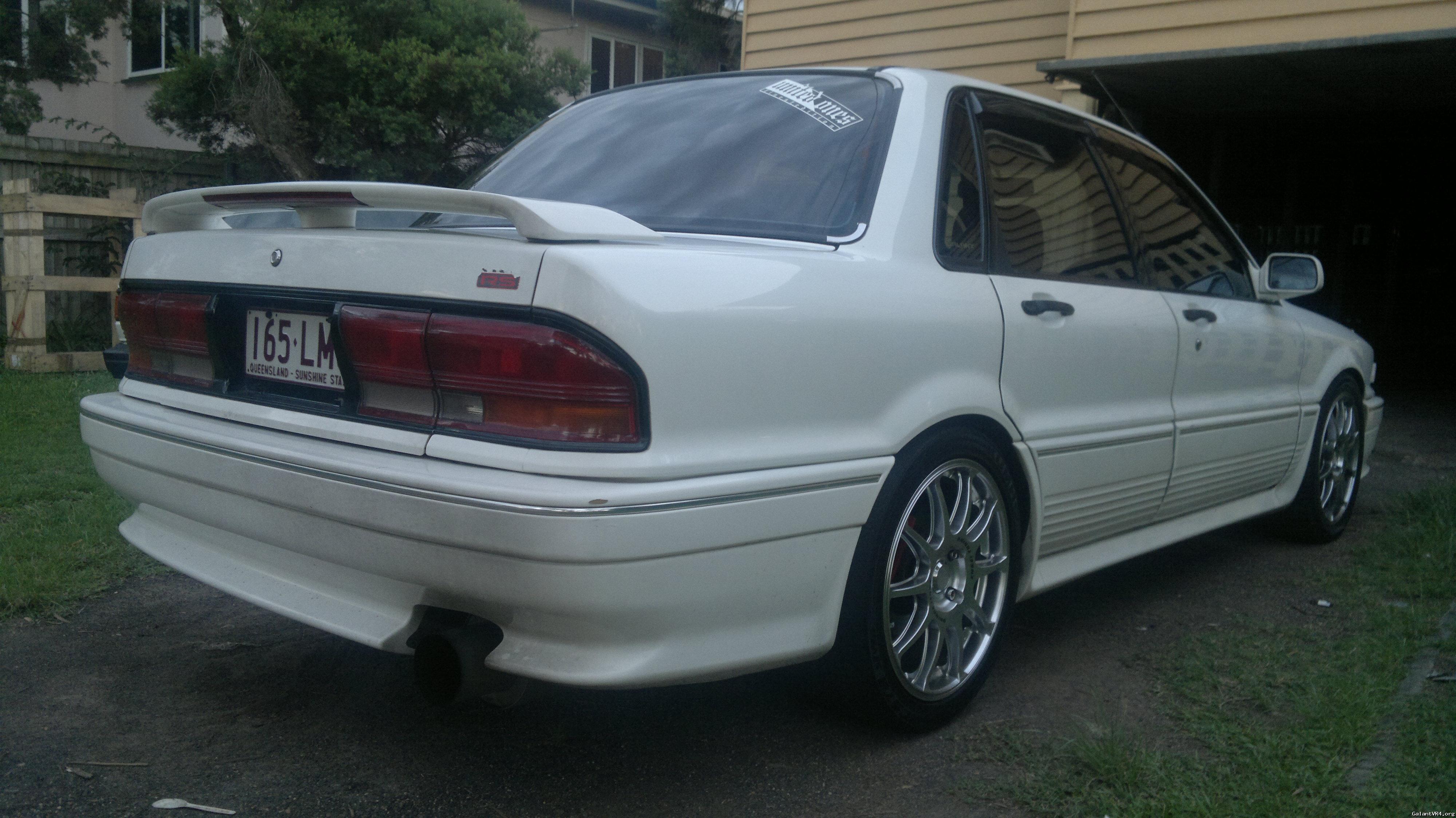

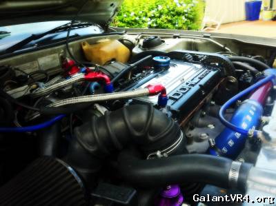

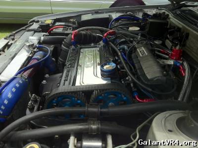

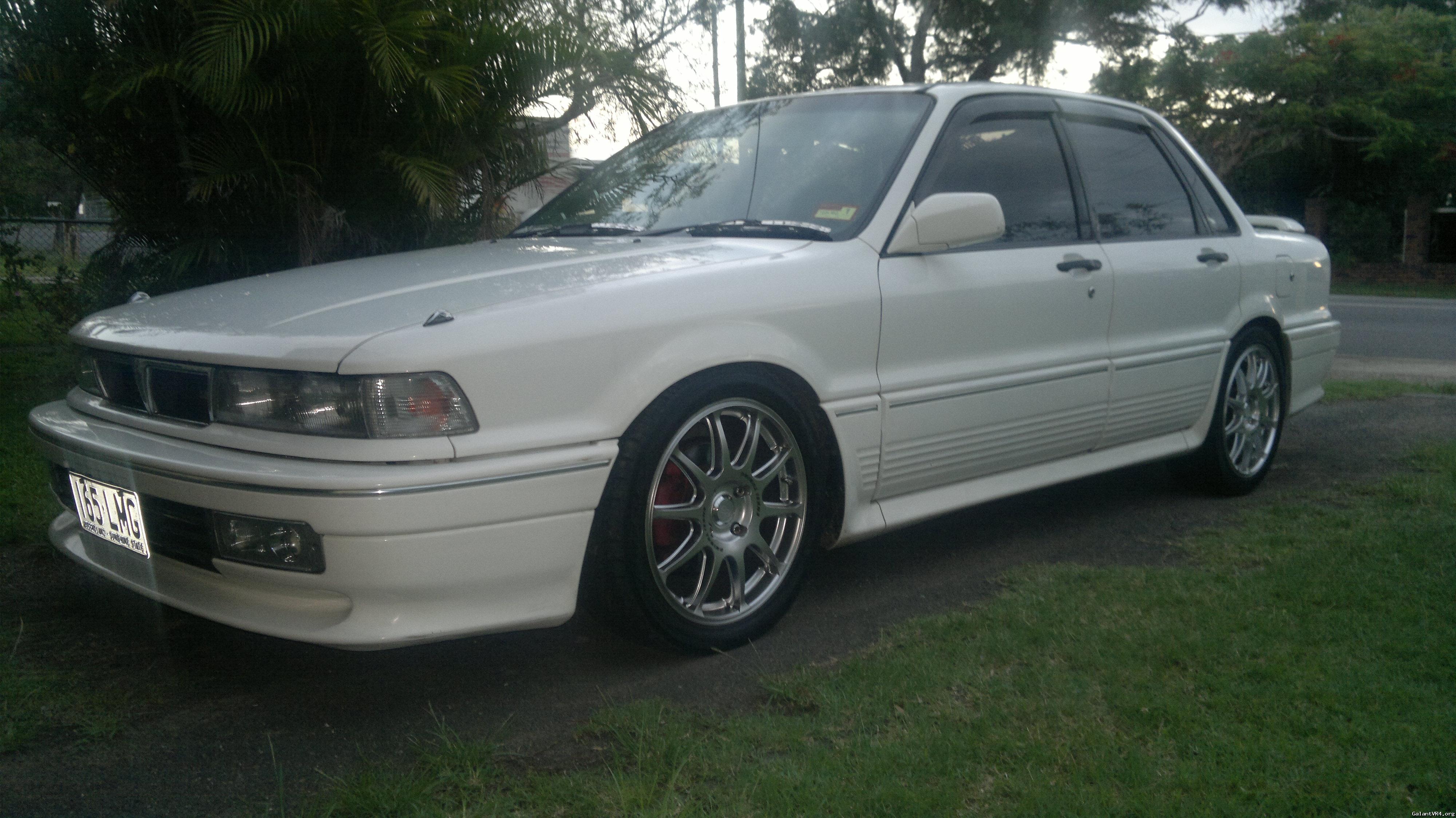

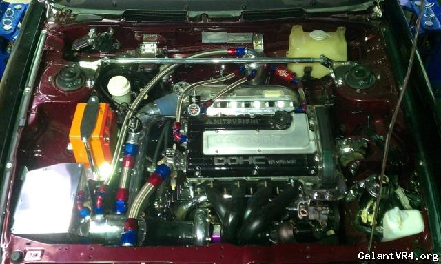

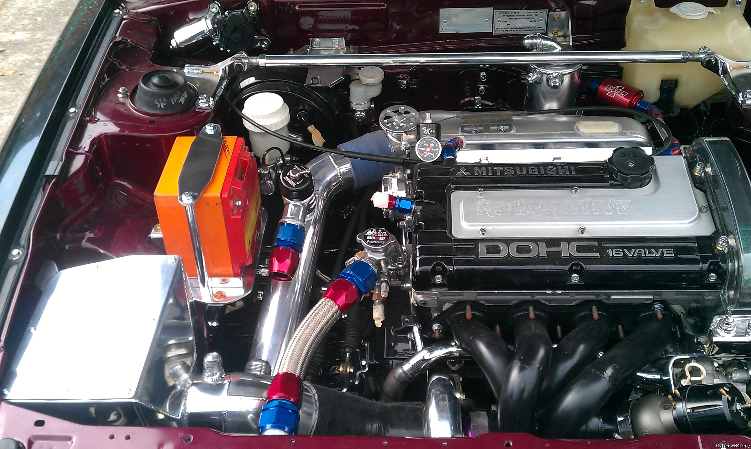

My new ride, I bought this of a mate.
1990 E38 RS. I had the job of modifing this car 18 months ago , so I knew it would a good buy for the price. It has an EVO3 turbo , manifold & dump. 3" exhaust with high flow cat Varex muffler. K-sport coilovers & ingalls rear ams, 660cc injectors with chipped ecu & 2g AFM. Sard AFPR & walbro 255 ( rewired ). 240x550x75 cooler & 2.5" pipes that I made. 2.5" TB elbow. Enkei SC12 17" wheels.I just fitted a LC1 & G4 guage this week & am in the middle of fitting a boost controller. Will play with 15psi this weekend.
This will be the daily and my FP3052 power A-spec will be the weekender.
Some pics.
