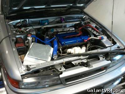

Here is an update on my ride:

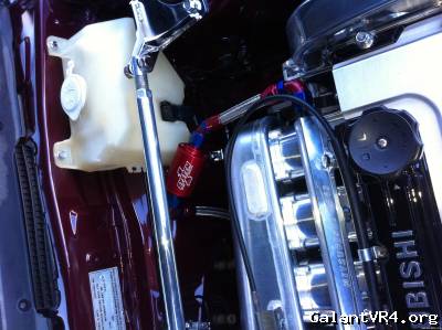

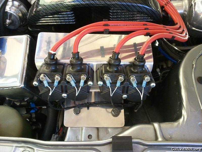

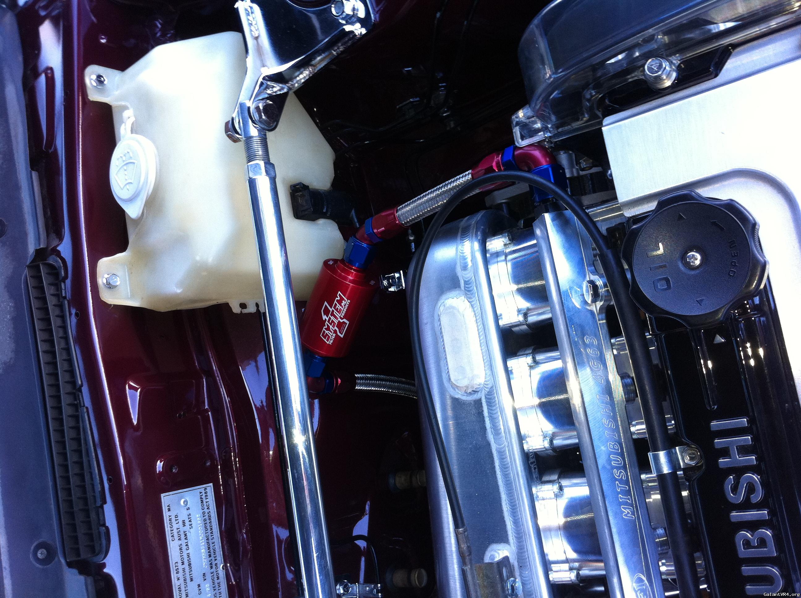

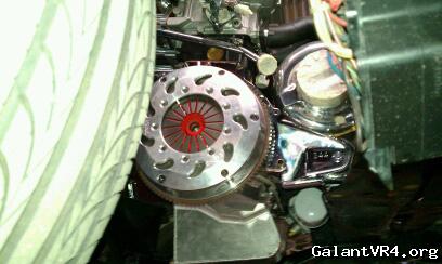

Coil remount and rewire with shielded tefzel wire to try and eliminate the miss I had when I ran the 11.08. I wasn't sure if it was heat related (it was on the rocker cover) or if it was noise related (I was running unshielded twisted wire).

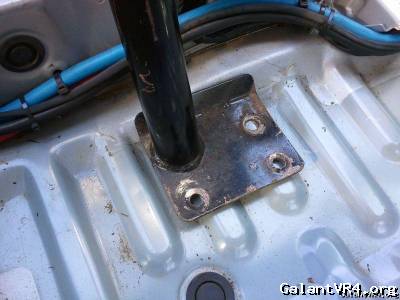

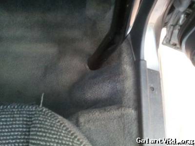

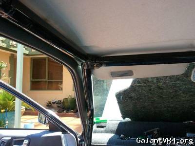

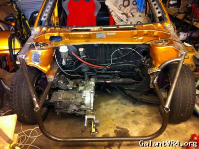

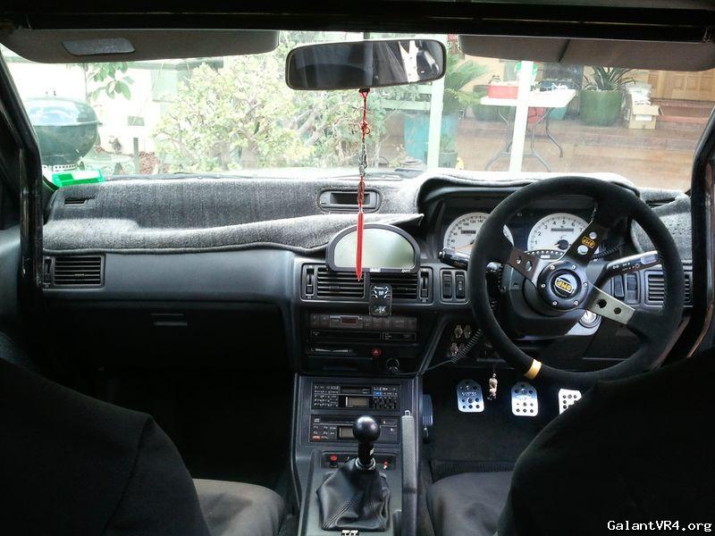

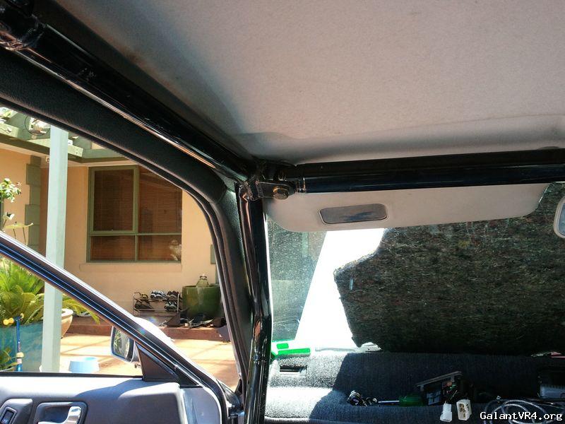

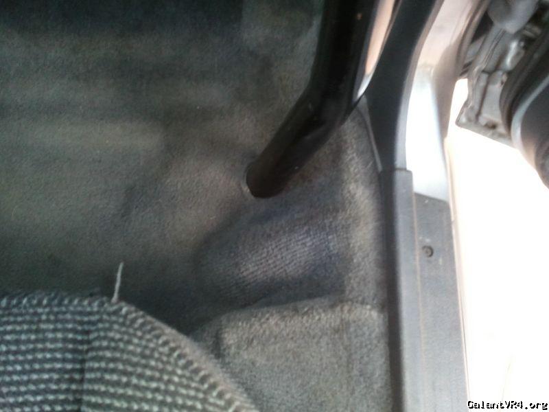

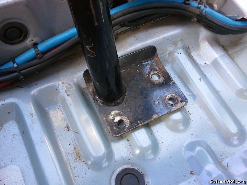

Rollcage install (bolt in 6 point safety 21)
My 2 lucky charms - bruce lee key ring on the wiper arm and a chinese lucky thing that has been with the car since I have owned it.

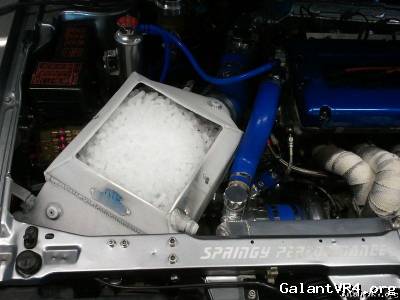

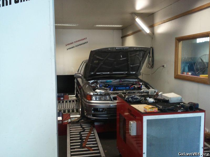

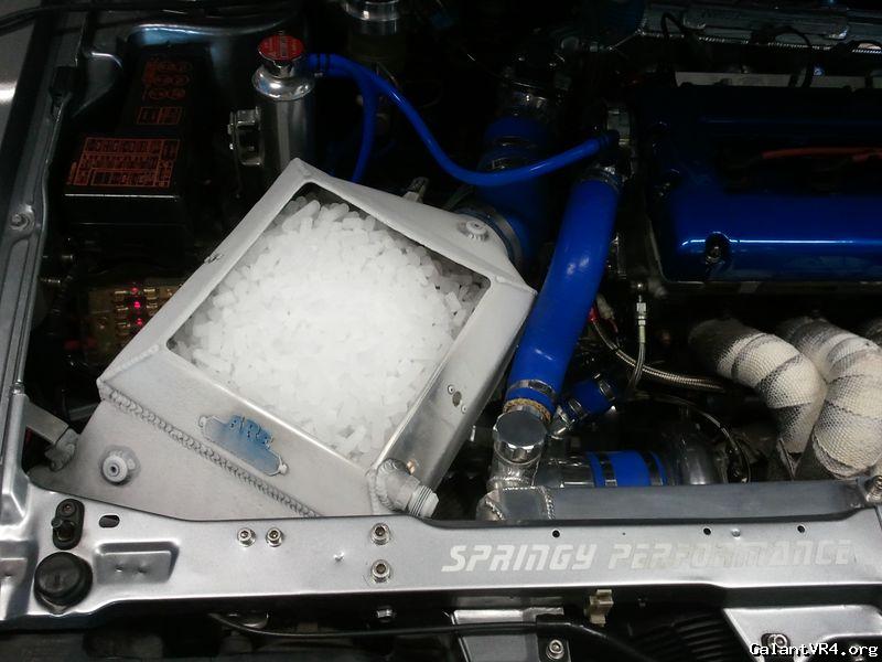

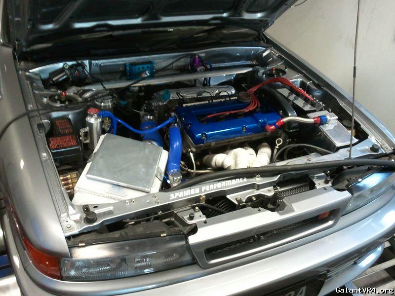

On the dyno - retune with dry ice and bigger injectors (1600cc)
With dry ice in the box.

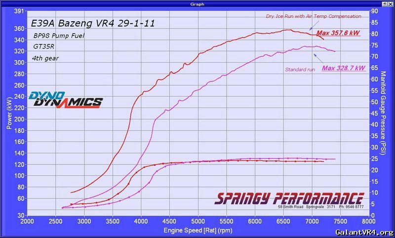

Dyno graph comparison
328 kw = 440 hp at the wheels (it was 350kw when I was running the 3.9 rs box which is 470hp at the wheels)
357 kw = 478 hp at the wheels (just guessing it would be approx 380 kw with the 3.9 rs box which is 510 hp at the wheels) with the dry ice
What I like about the dry ice is the gain down low. About 100hp of power gained down low!!!!

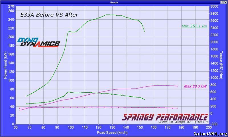

The E33A AMG GALANT
Before and after dyno graph.
253 kilowatt = 339 horsepower at the front wheels.
Plenty more in her but we didn't want to push her just yet.
Now sporting 272 cams and 1000cc injectors

Wow that's a huge difference! It's making boost and power ~1000 rpm earlier just because it's that cold? /ubbthreads/images/graemlins/worthy.gif

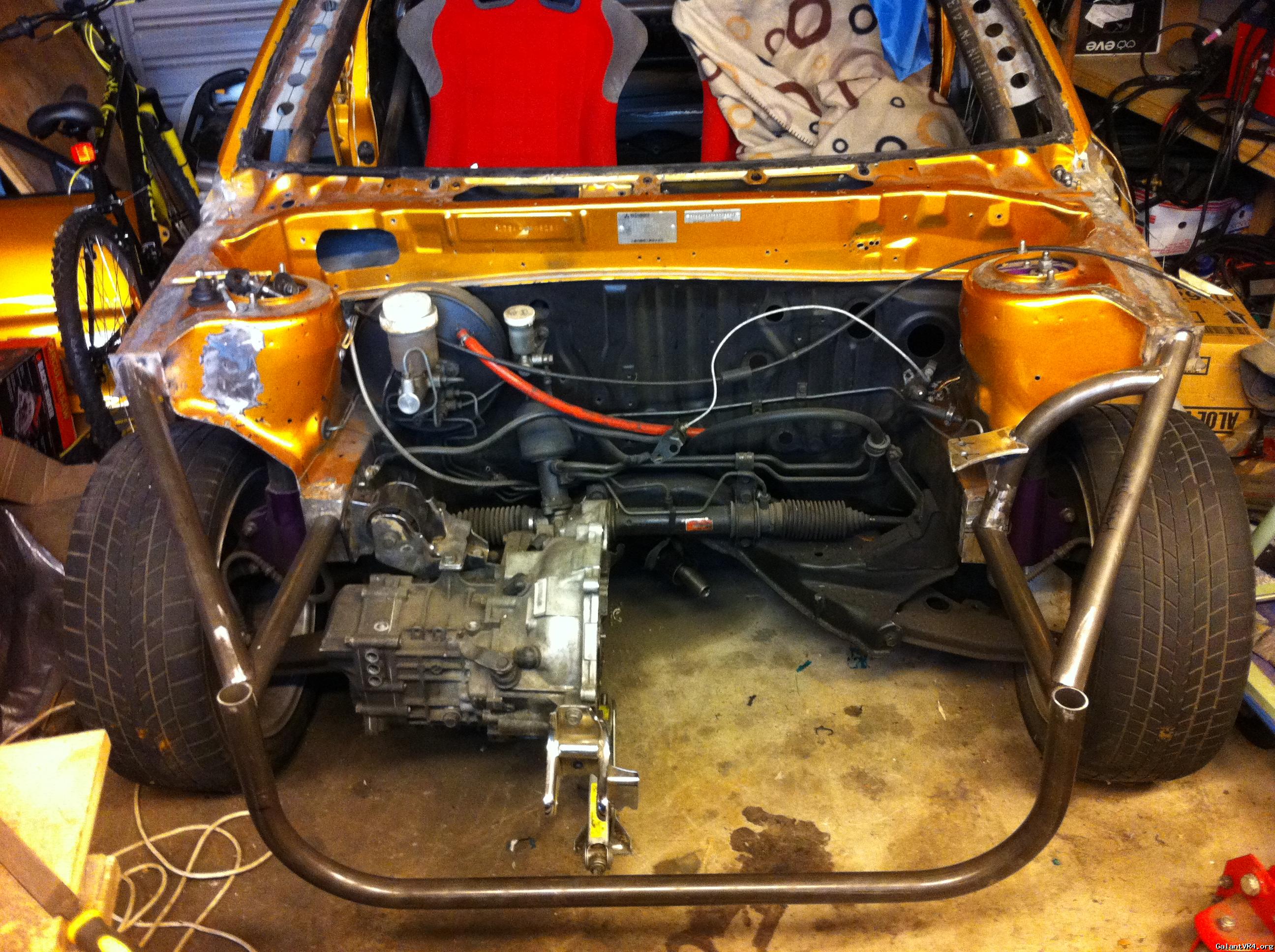

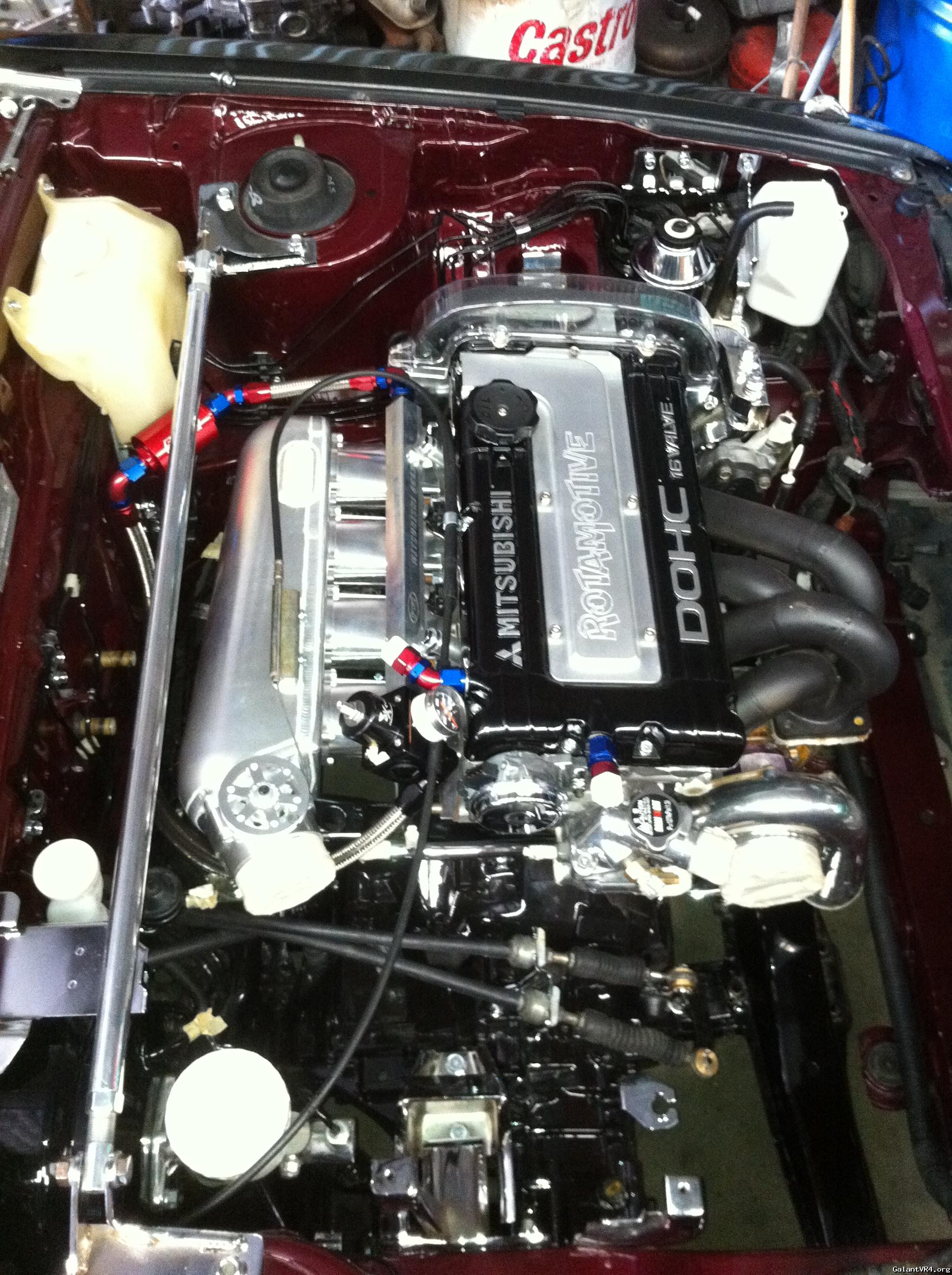

thought I should put some pics up of my current build and where it is at.
car just after I bought it

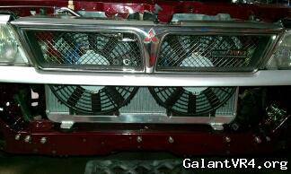

New rotors and hotbits coilovers fitted
some of the parts going into it

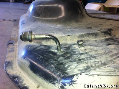

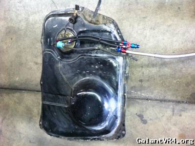

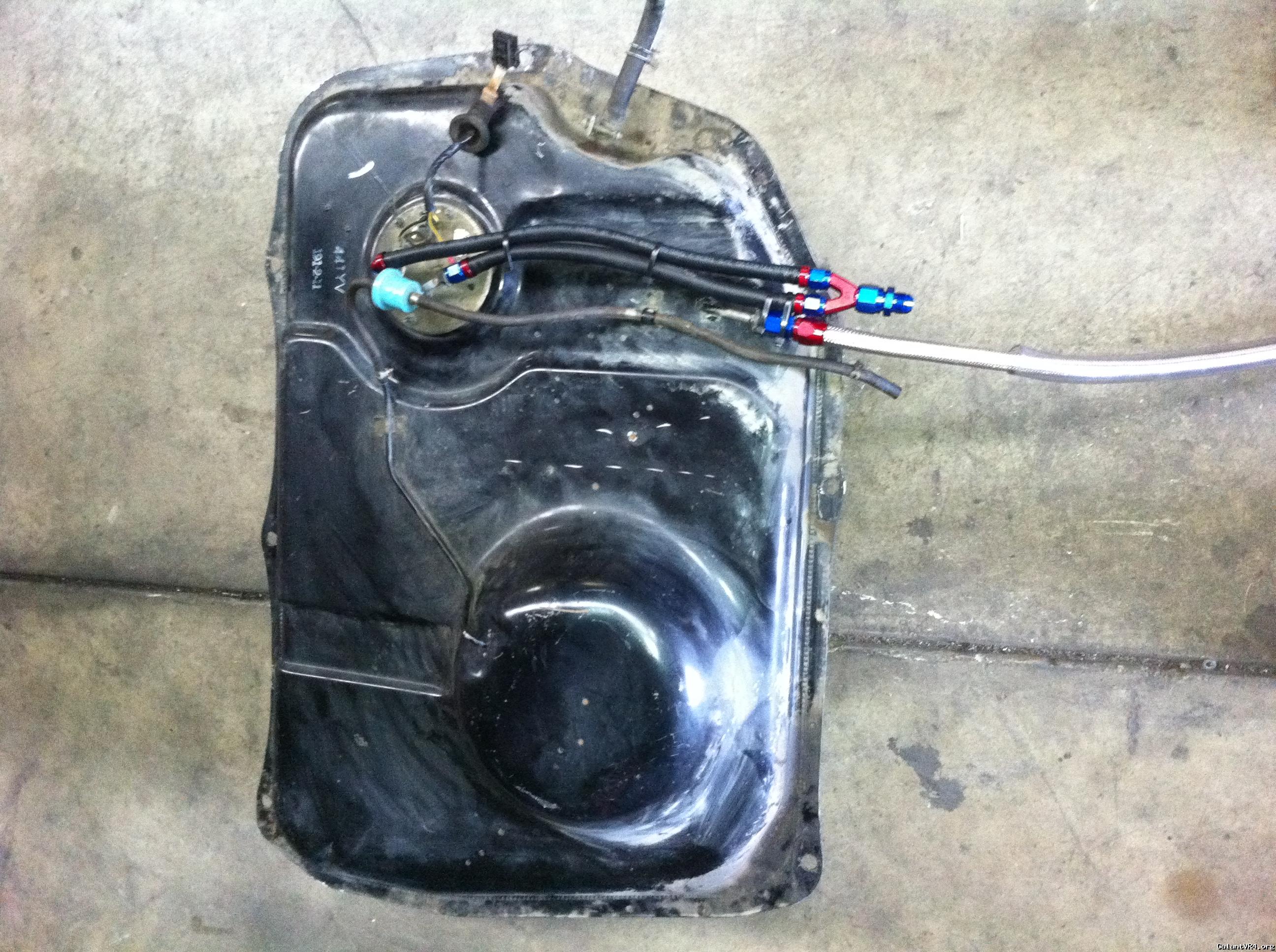

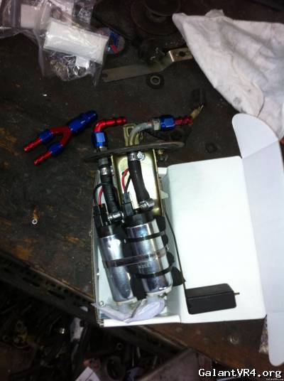

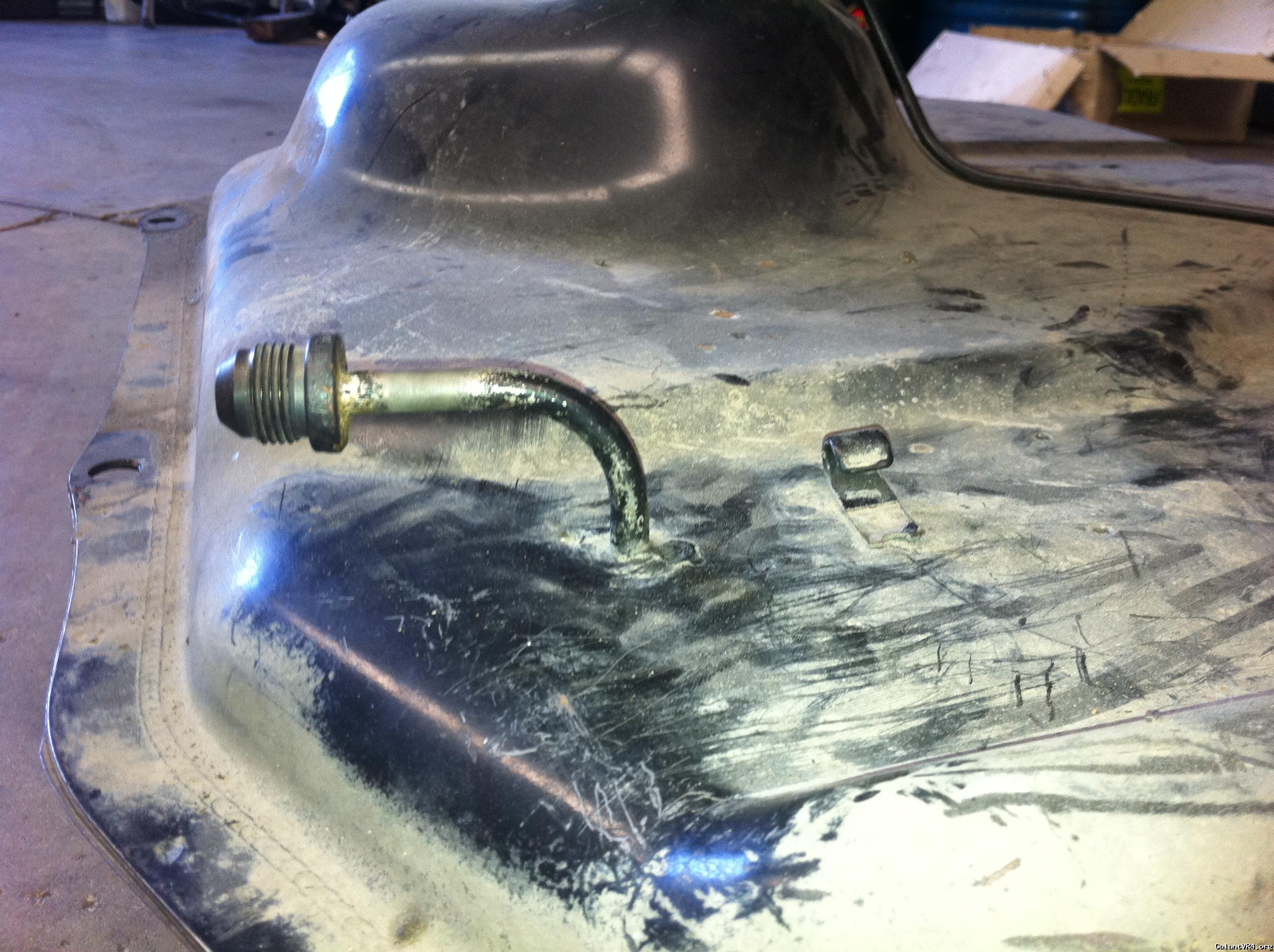

surge tank with 044 bosch pump

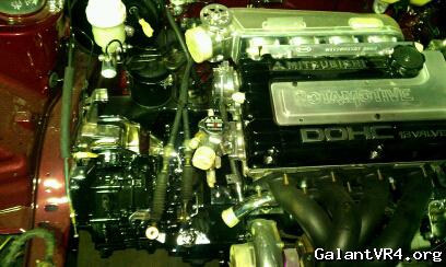

we started assembling the block today

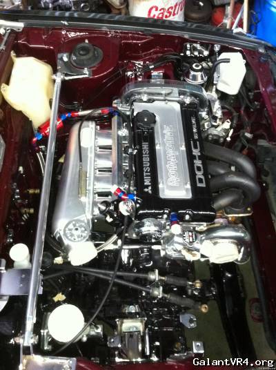

a couple more pics of where mine is up to.
motor will be ready to drop in this weekend. just have the rest of the car to do now /ubbthreads/images/graemlins/smile.gif

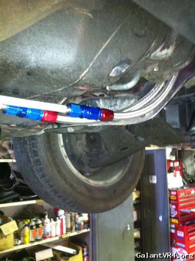

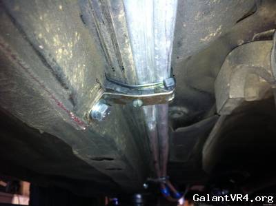

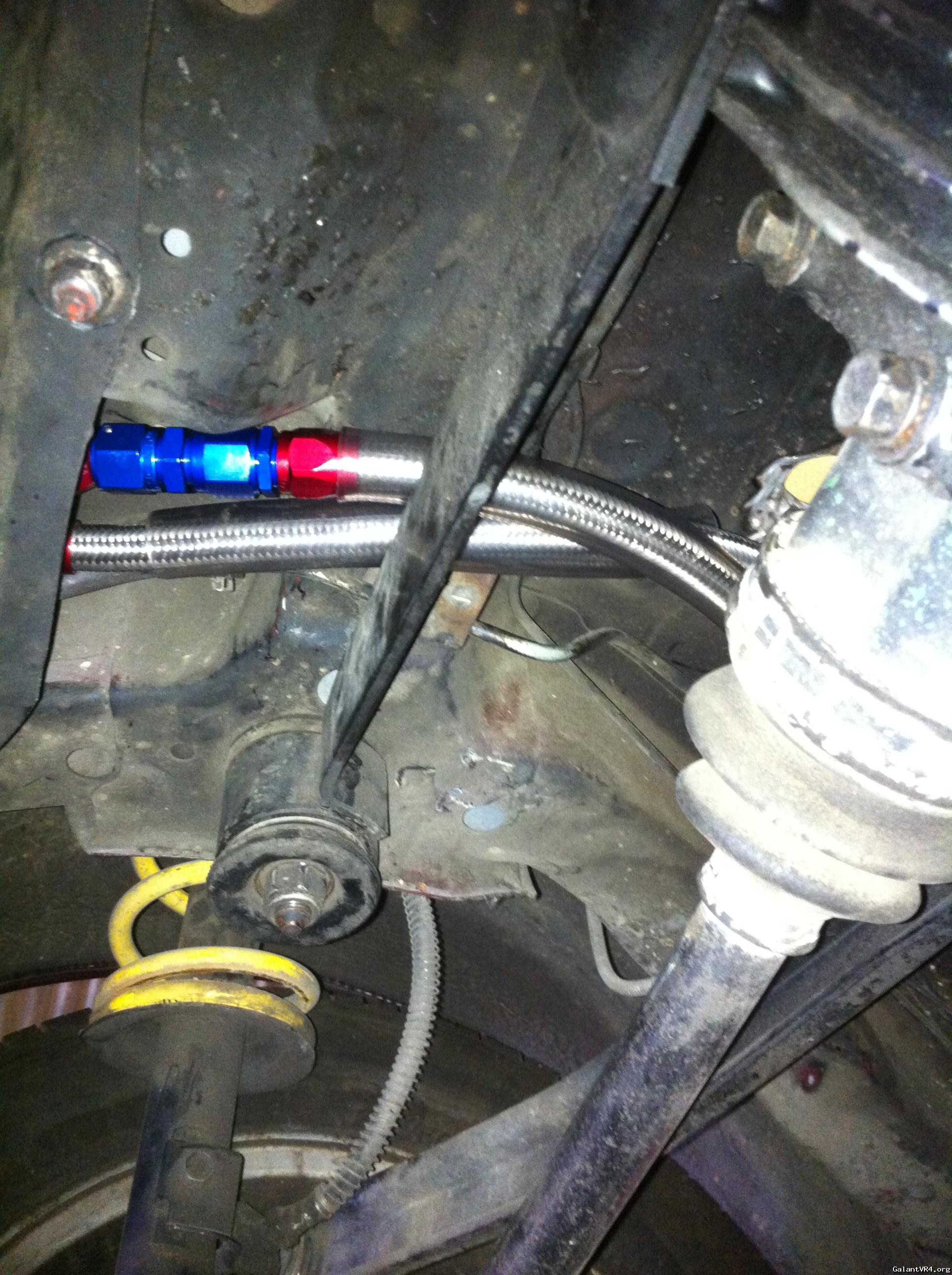

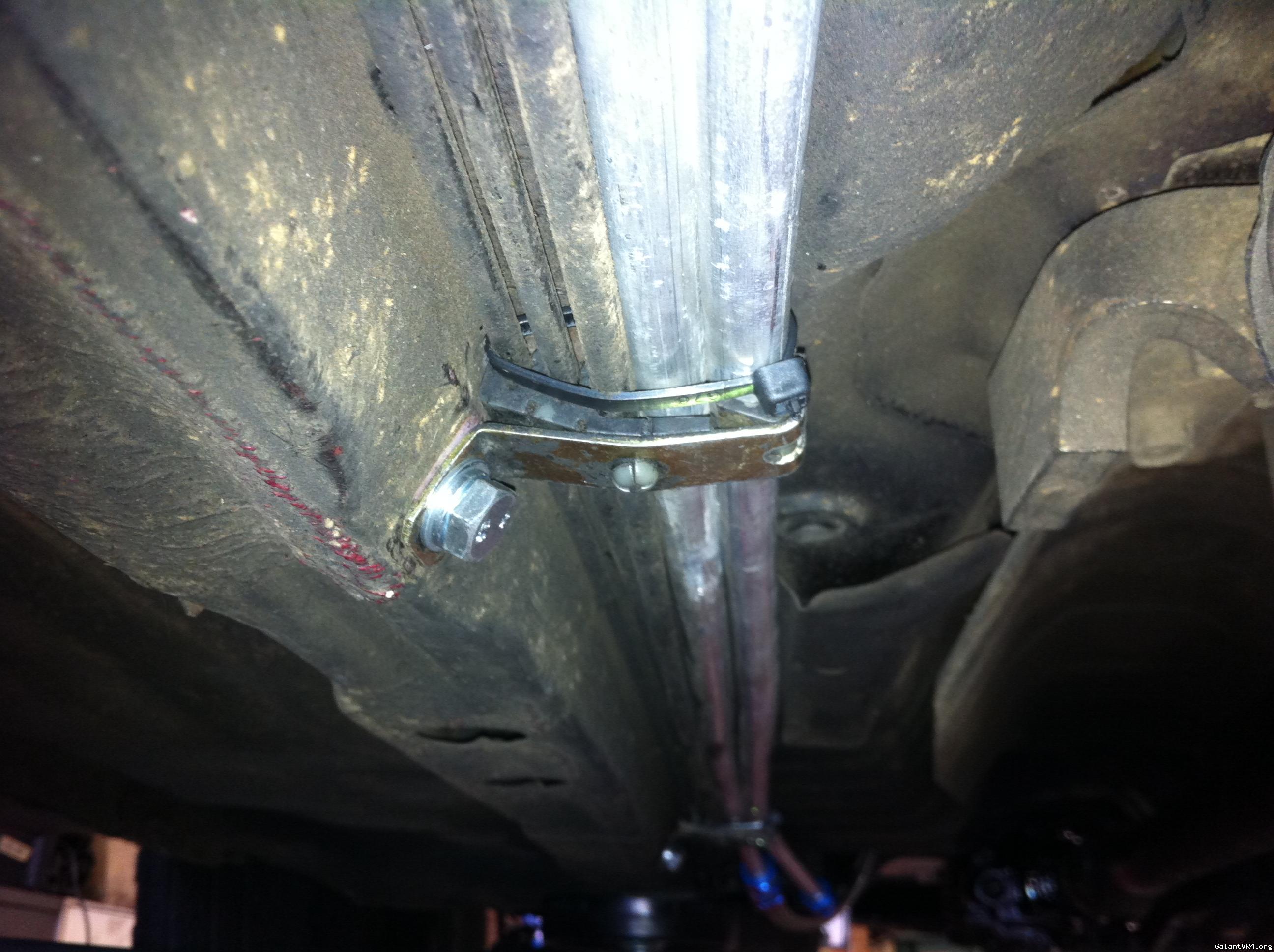

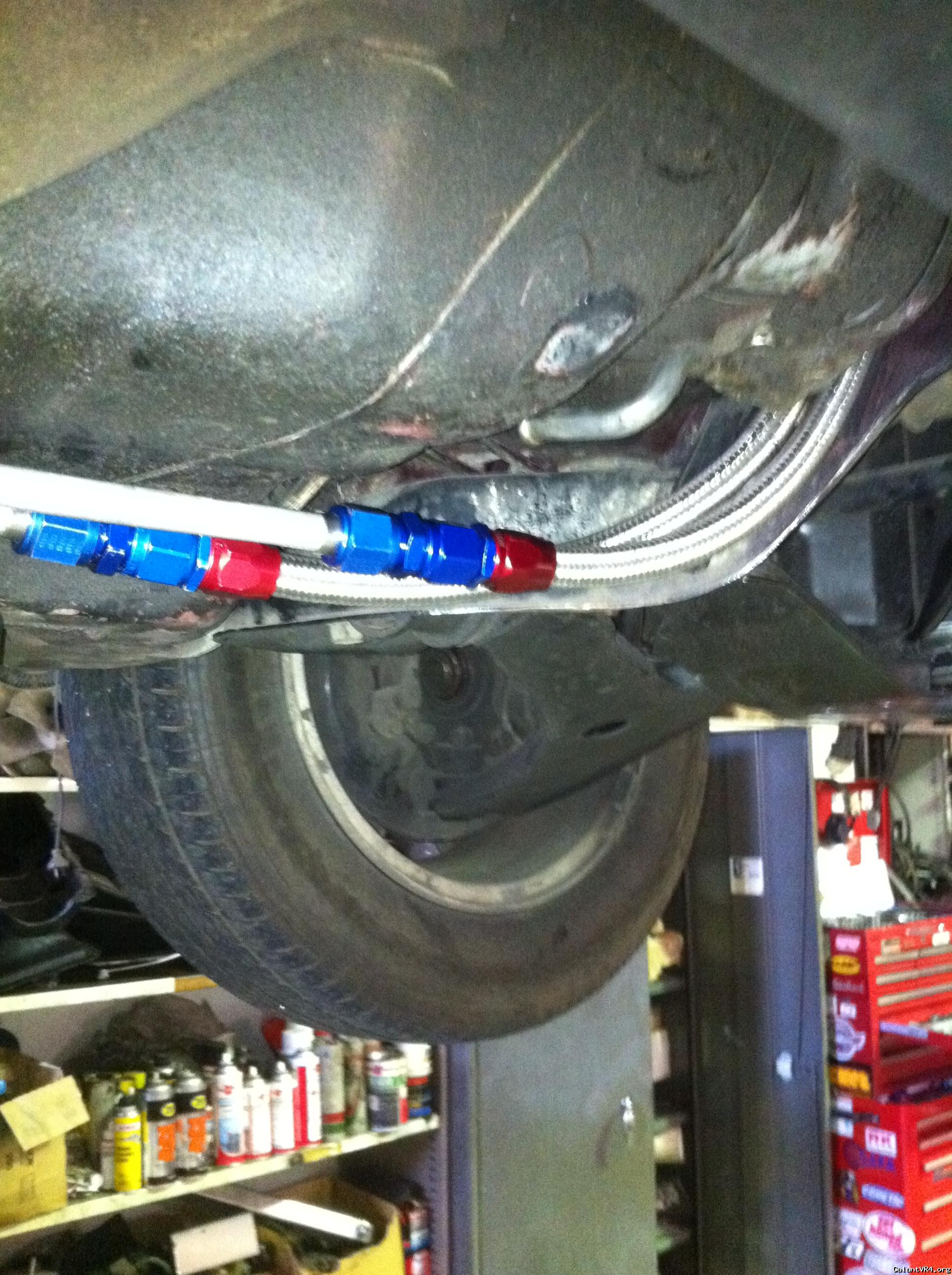

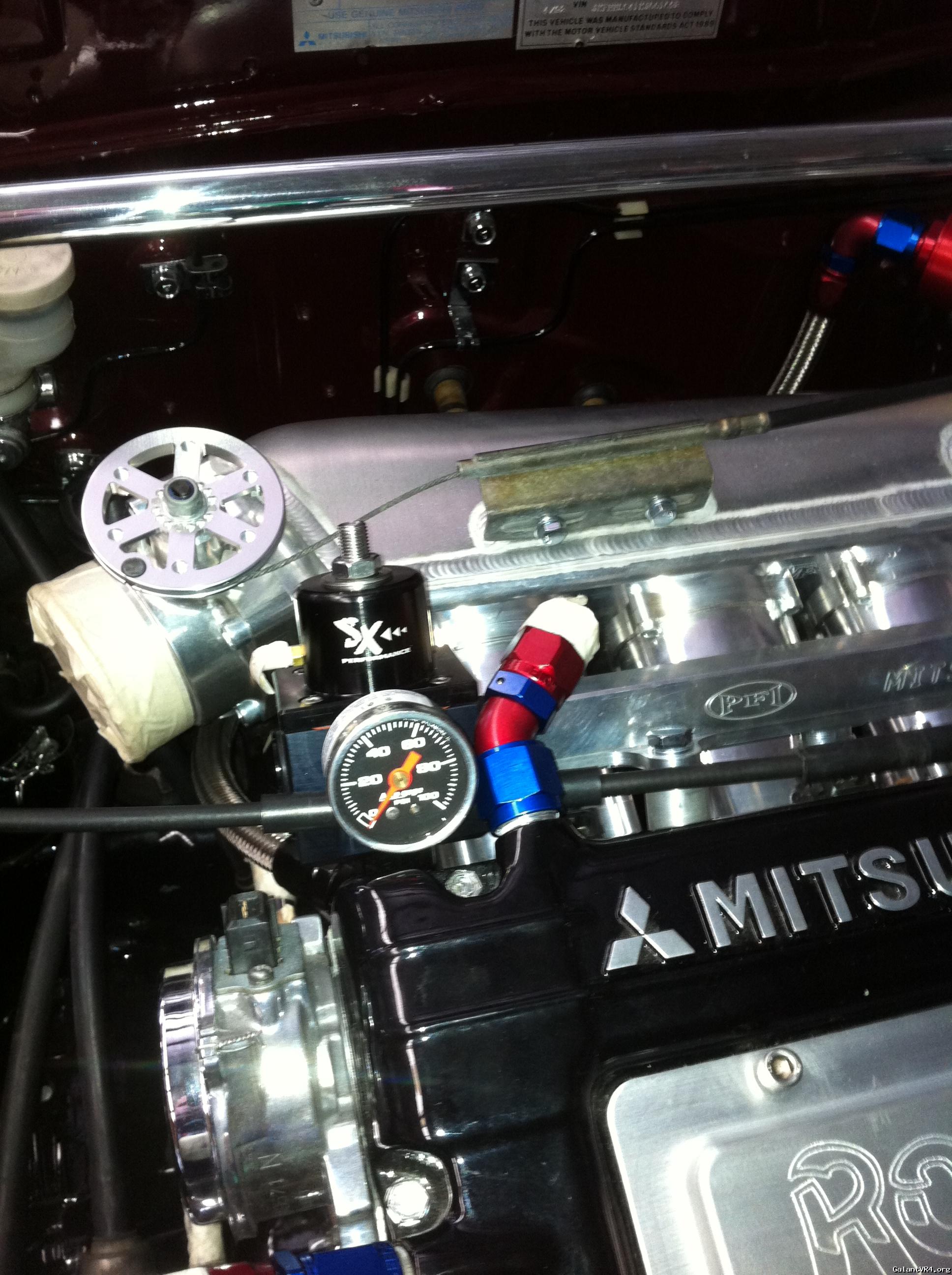

very productive day yesterday, got the rear swaybar changed, rear diff changed, ran -8/-6 fuel lines, made a bracket for the FPR and got some work done on the motor
old v new sway bar
where the fuel lines come through to the boot

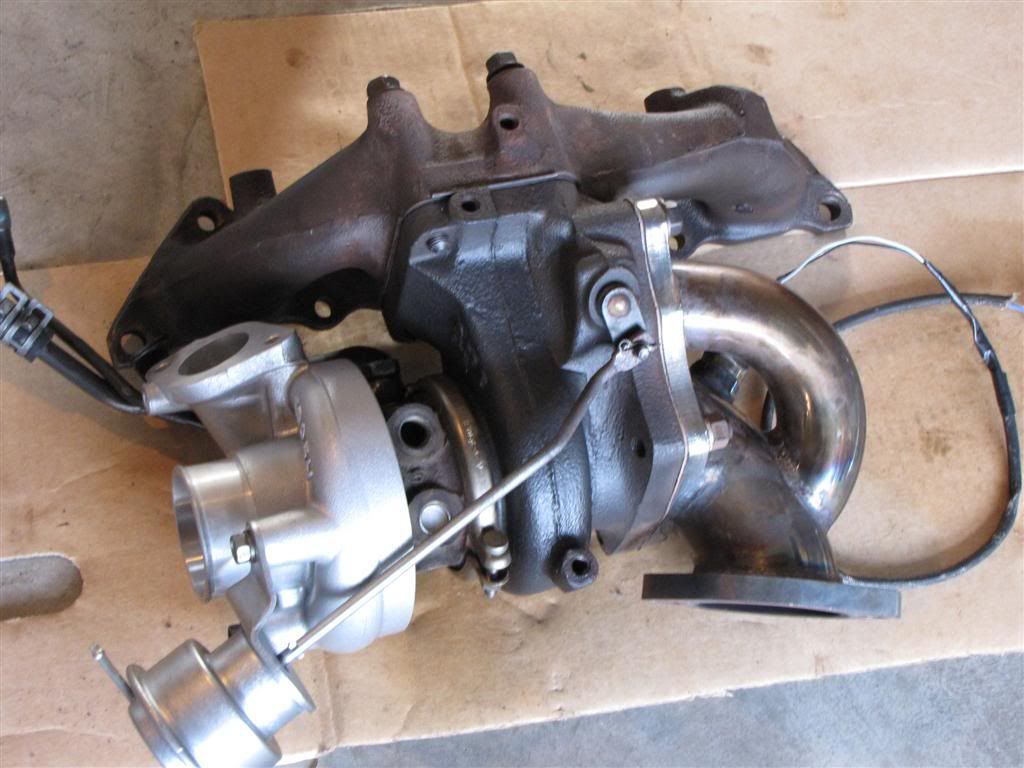

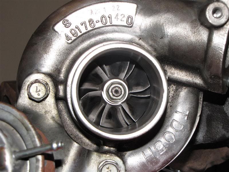

my existing 16G turbo managed to do this:

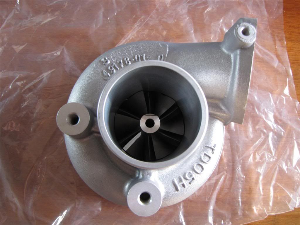

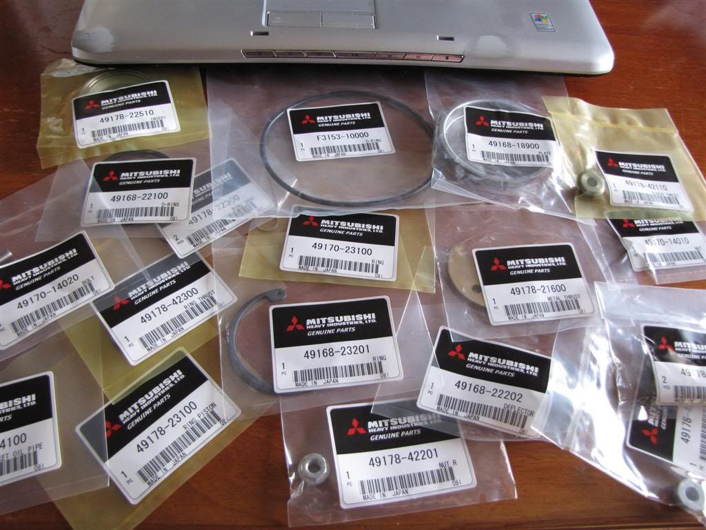

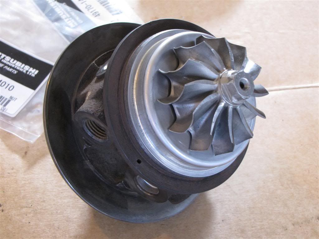

so I bought this (20G wheel and machined Evo III housing):
along with these:
Will get exhaust wheel back cut and the whole lot balanced and then hopefully back together soon, my whale of a VR-4 may be slightly less slow now!

turbo came back, turbine wheel back cut 7 degrees
ready for fitment

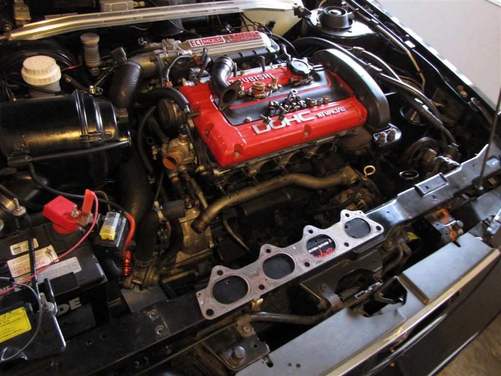

hopefully engine bay wont look like this for too much longer
