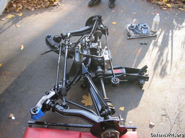

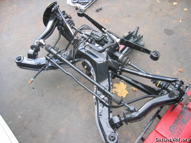

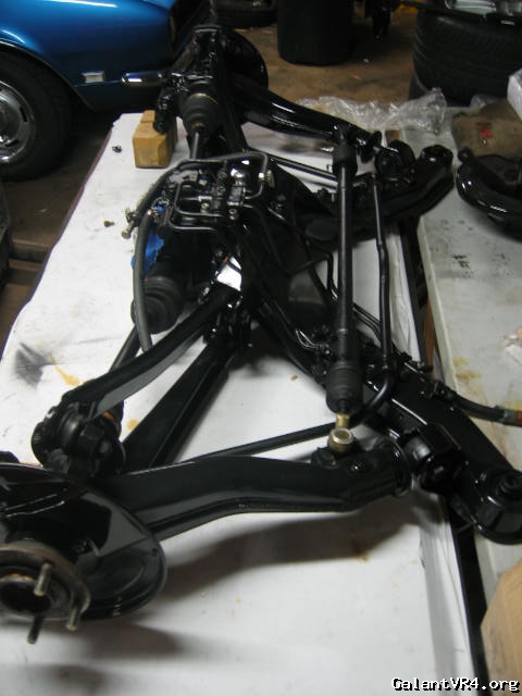

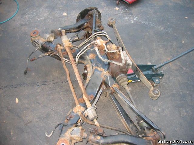

Subframe assembled!!!! Finished blasting/painting Sunday(big thanks to my friend SE-r Eric for blasting), installed new ball joints on lower control arms, refinished the AWS stuff, replaced one rear tie-rod, new sway bar end links. NEED to get my rear end cover so I can glass bead and install it with mustach brace. 4 bolt installed with 5-lug hubs. ALMOST THERE!!!!
Once I get the rear cover, I will install rear, frt hubs/brakes, put on wheels. Push her in the garage and finish install of trans, change out ABS prop/lines and bleed rear steer/brakes INSIDE as its getting cold here. Have to purchase frt and rear rotors to complete 381. This w/e is going to be shitty and I have a ton of work so.... stay tuned for install.

I can send you a pic of what is still avail. from Mitsu. It was only 3 lines!!!! I was lucky and my lines were able to be saved. The other option is doing stainless and be done with it!!! Maybe next time. I used rust disolver/rust encaps/RUST tough finish. Only AWS part I replaced was the rt tie-rod which was shot. Should be good for 5 years or so I hope with NE winters.
I used MOOG ball joints I picked up off ebay cheap. TEL/G frts are whats used in the rear, top and bottom.

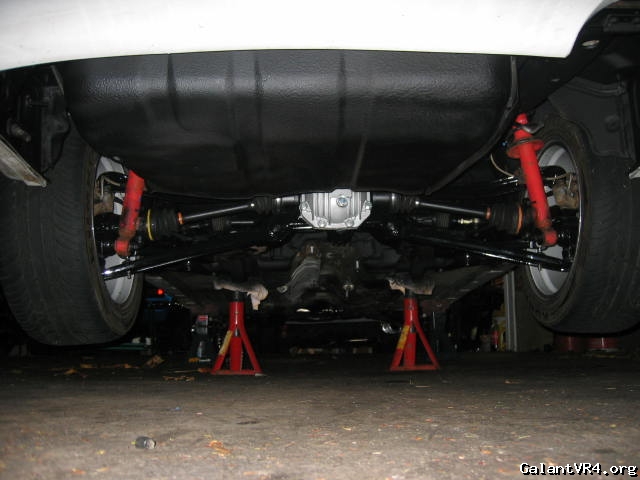

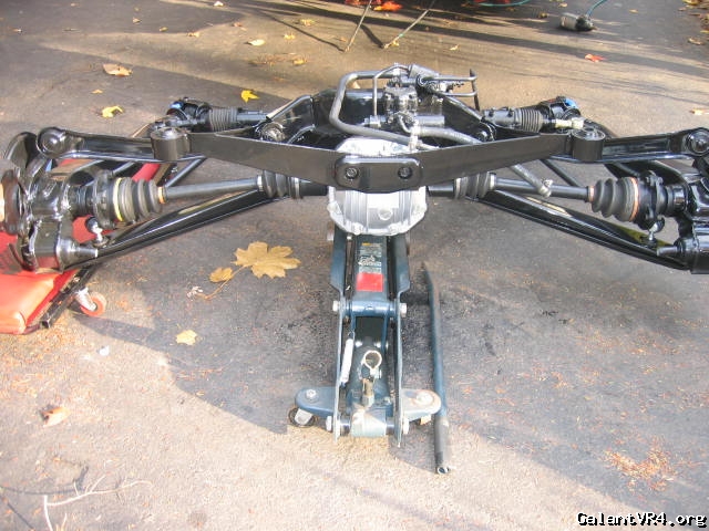

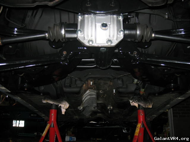

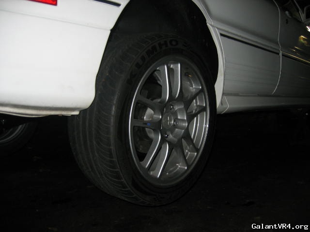

The sub is back on!!! Got the cover, had my buddy blast and bead it, got the rear breather, new hardware and finished assembly. My buddy Matt and Darryl gave me a hand on getting her out of the garage and onto the jack. We lined her up and finished all the little stuff. Was excite to get the rear Evo9's on there. Doesn't look great obviously being in the air... need to slam it down. TEINS anyone??? FUTURE PLANS= Evo rear brakes, TEINS and SS exhaust. Have KYB's and 3" but will change them when time is right.

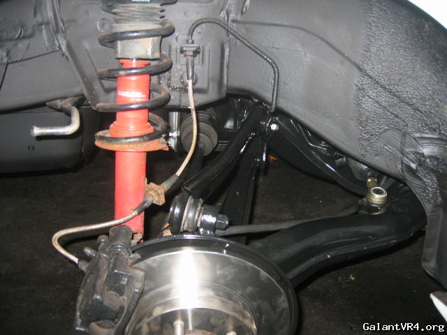

Little bit more to do. I'm rebuilding the DS before final assembly. Ordered the front 3kgt rotors, replaced ball joint boots up front. Had to decide if I was going to pull the front subframe for paint but ended up using the RAT ROD technique of used motor oil rub on rust spots to prevent more damage thru this winter. This coming spring I will finish the rest of the undercarage resto.
Looks good thou.... Need to install front hubs and brakes, then bleed. Install trans, axles, DS, and transfer case. Install the exhaust and bleed the rear steer- "FUN AT 55 ON JACKSTANDS BIATCH!!!!" /ubbthreads/images/graemlins/rofl.gif
Almost there. I CAN'T WAIT for DD duties to begin!! /ubbthreads/images/graemlins/devil.gif
Can see the cleanliness ends at the DS hump.....
Tires remind me of my old Mustang. That had 245's but these 235's look big on this small car.....

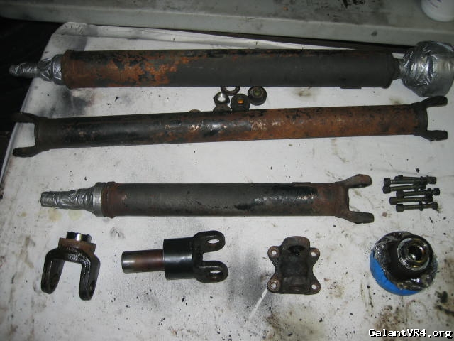

Took the DS apart.... which took a few hours!!! Lots of heat and patience. Called Napa and they carry Federal Mogul u-joints. I'm going to check them out as they are instock at the warehouse which is 15mins from my house.
