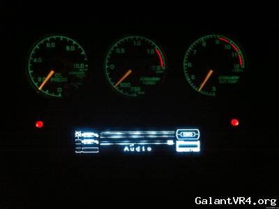

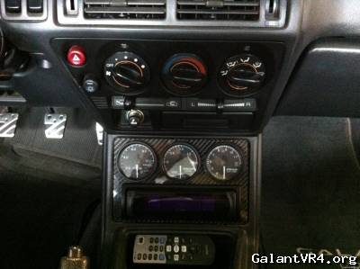

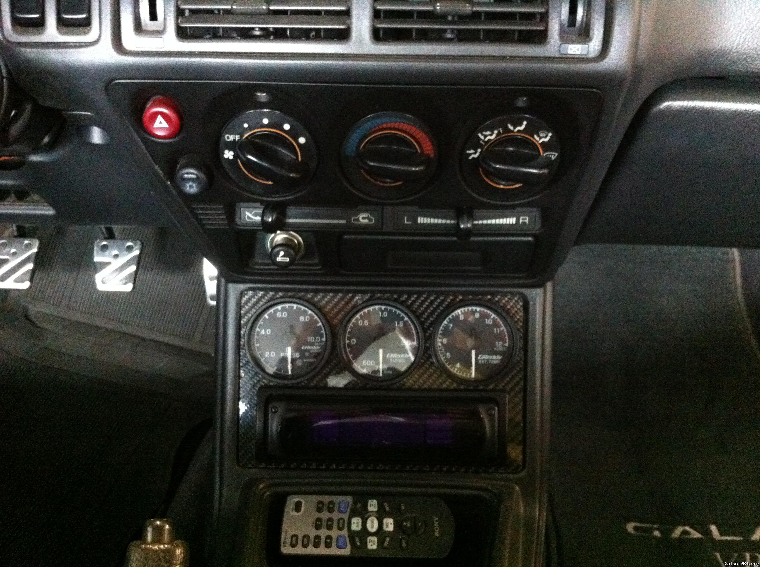

So the gauges have been moved. No more ricey pillar....
During tuning on Oct16th I was unable to get the car over 17psi and boost was dropping thru the pulls. We tested the WGA and found it was not holding vacuum. I ordered one from Garrett that was "sure to fit" and guess what, IT DIDN'T!!! I have ordered another which will be at my shop in CT tomorrow. I'm going there Saturday night to throw it on and be ready for another go at 24psi this coming Sunday morning.

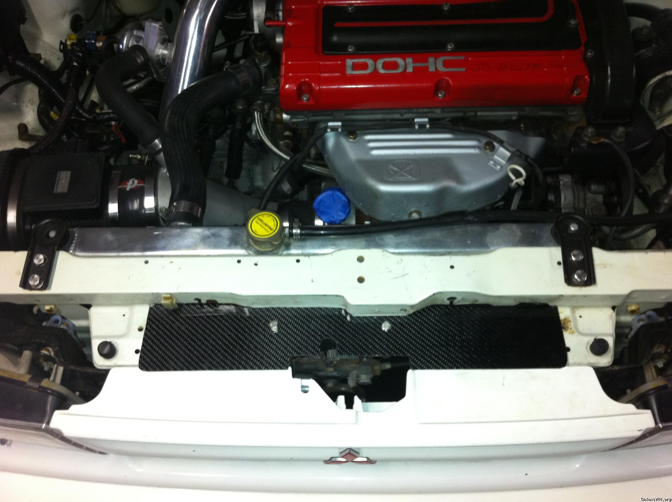

Once I realized that my efforts of getting the replacement WGA back and piping back on was not going to happen, I focused my time on something I had been wanting to do for some time now. I am referring to this as ver.1 as I plan on getting a much larger piece of CF and making a much larger cooling plate. My longest piece of CF was 19" so I worked with what I had....
This is what I got. This is more function over form.
Thanks for looking!

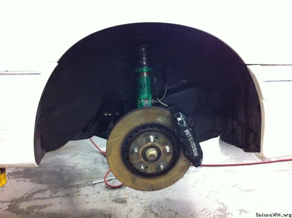

Shop pic after axle swap, still on KYB AGX's and 1g H&R's......

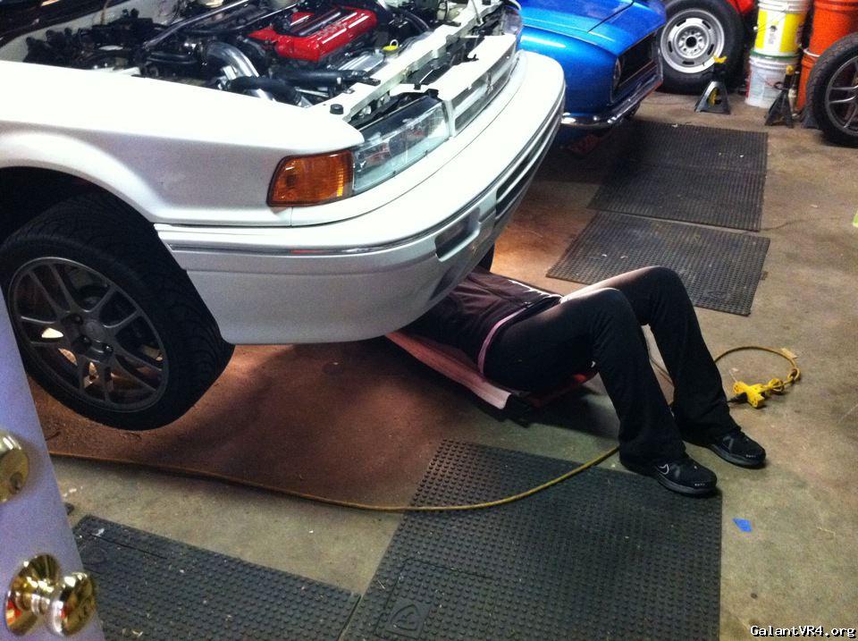

So my last tuning session in October ended with finding a vacuum leak at the WGA. I ordered one on Oct25 and through the event of an awesome snow storm, it finally arrived on Nov 14th!!!!
That being said, I took off the original WGA on the car and thought to myself how difficult it would be to get it back on. With a very small amount of modifications, it lined up perfect. I then recruited my GF and her baby hands and had it all set in about 10mins!

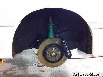

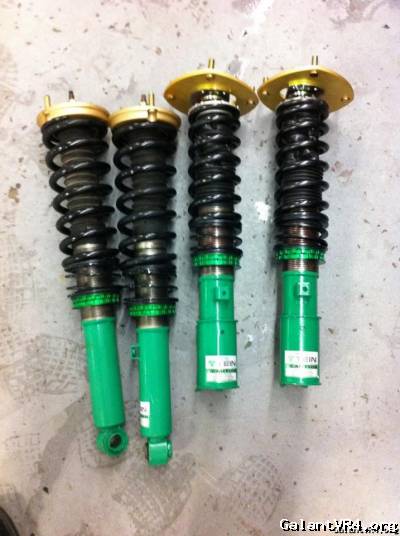

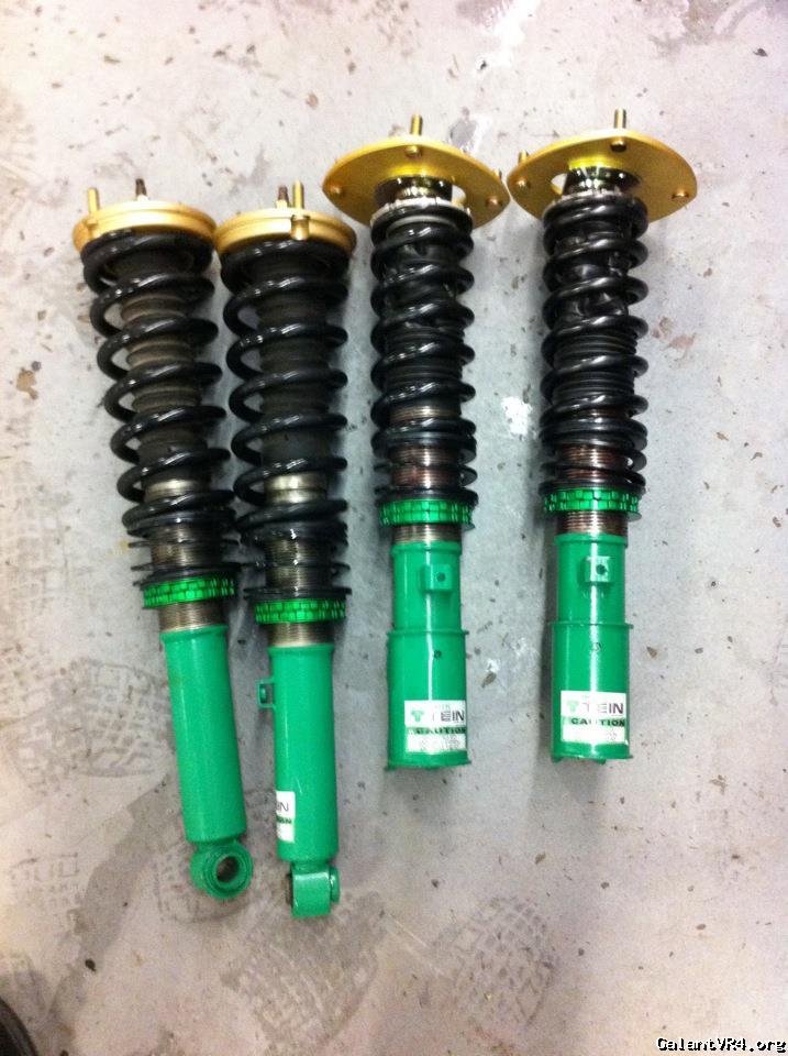

Also last tuning trip, I did notice some vibration above 100 and found the D/S outer CV open. I brought the car back to RI to my work for some repair. I swapped the D/S axle, indexed the driveshaft to eliminate a slight decel noise I was getting and FINALLY INSTALLED my Teins!
I let the car settle overnight. I'm going to set the height this afternoon after work, drive it the night and align it tomorrow.
The sway bars still need to go on but what a pain. Also I have Jon Visconti from THE SHOP in Stamford, CT lined up for a street tune and dyno run the weekend after Thanksgiving. Thanks for looking....Stay tuned!

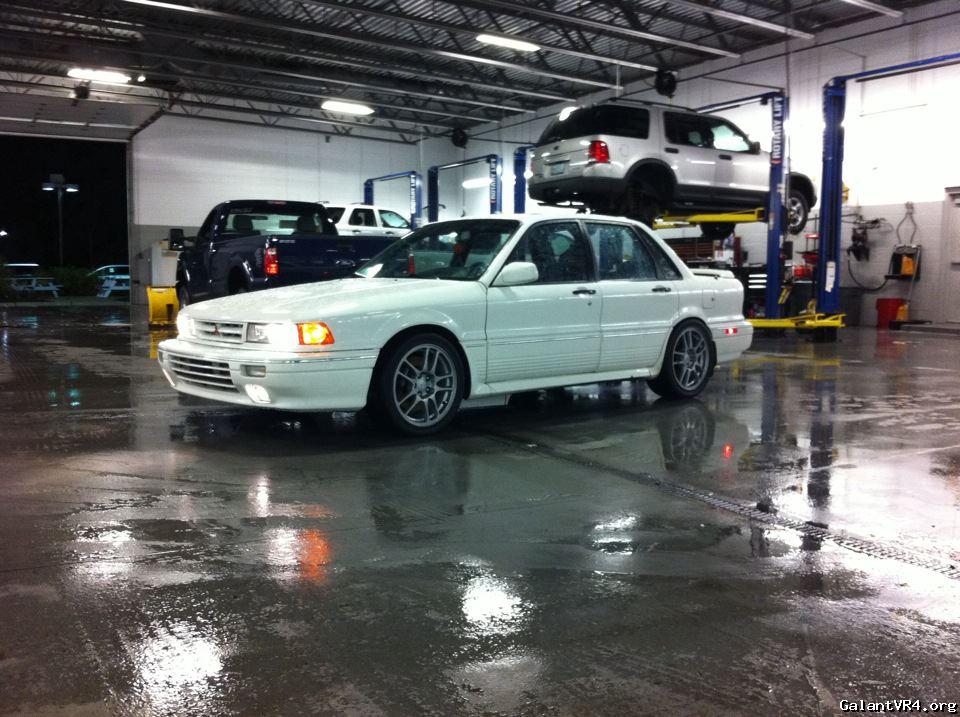

Yesterday I was soooo excited! It was the 4 yr anniversary of 381 and I and the damn site was down! /ubbthreads/images/graemlins/rofl.gif /ubbthreads/images/graemlins/rofl.gif /ubbthreads/images/graemlins/rofl.gif I cant believe I have had this thing for 4yrs. I finally hit 100,000miles which means I drove 2k miles per year.....

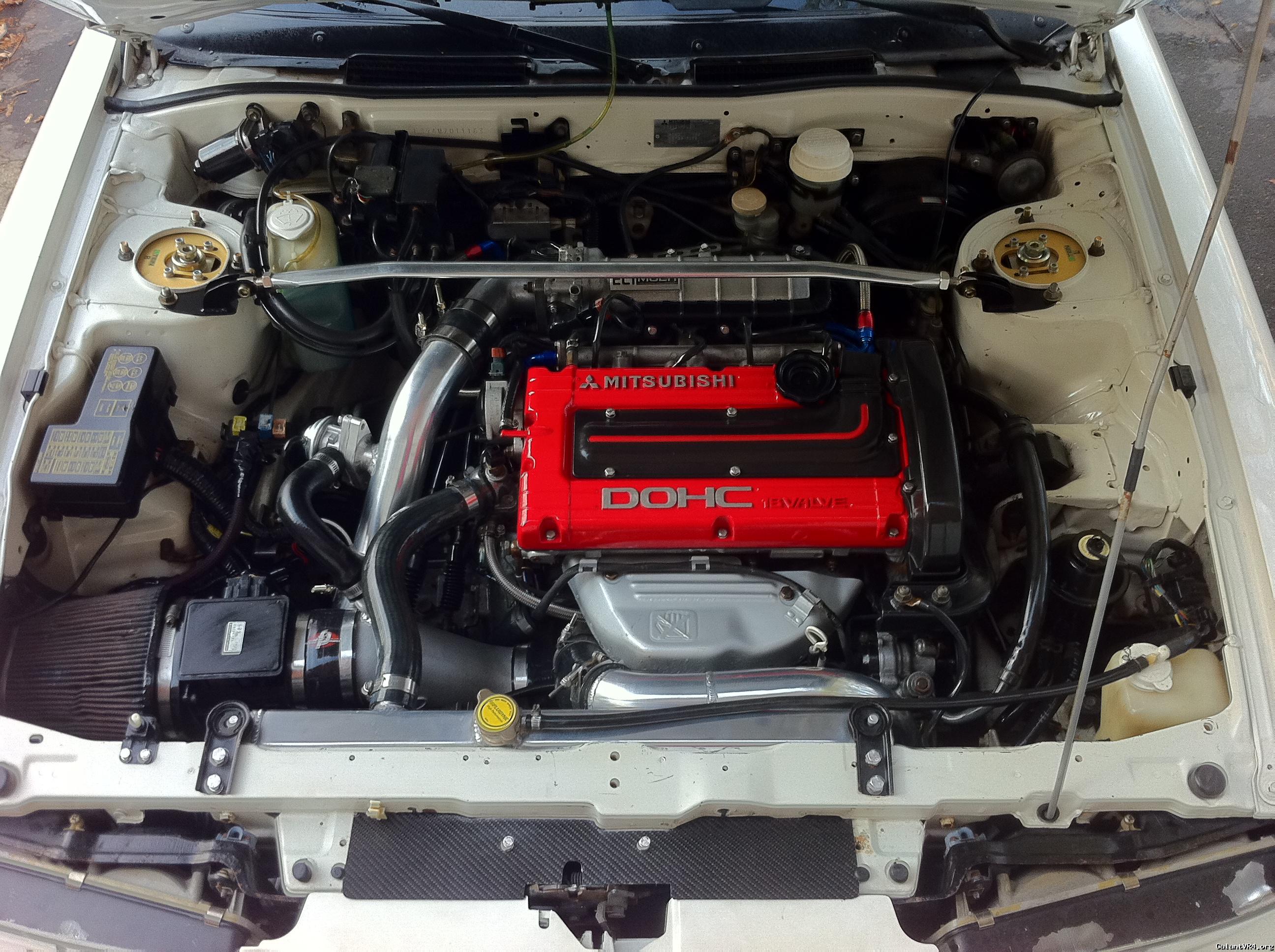

So Sunday I finally got back on the street to finish tuning. The WGA was suppose to have a 18psi spring but it was 8psi! Boost is far easier to control and comes on MUCH sooner when compared to the failing unit. That being said, I could only hit and hold 20psi! The simulated dyno on the laptop says the car is aprox 430hp +/- 10%. It finally feels fast! Next step is another WGA, straight 3" SS catless DP and aluminum exhaust with Vibrant aluminum muffler. Then strap it to a AWD dyno for a true figure. If I'm still shy of 500awhp a FP exhaust manifold and SMIM are in order. The goal to complete this is May then turn my attention to the body.

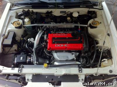

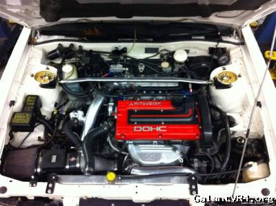

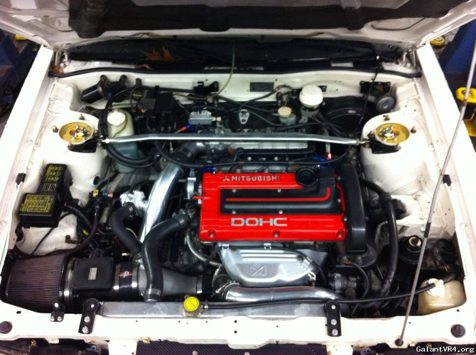

On Sunday before I met up with Mario I found time to clean my engine bay and tuck my throttle cable.

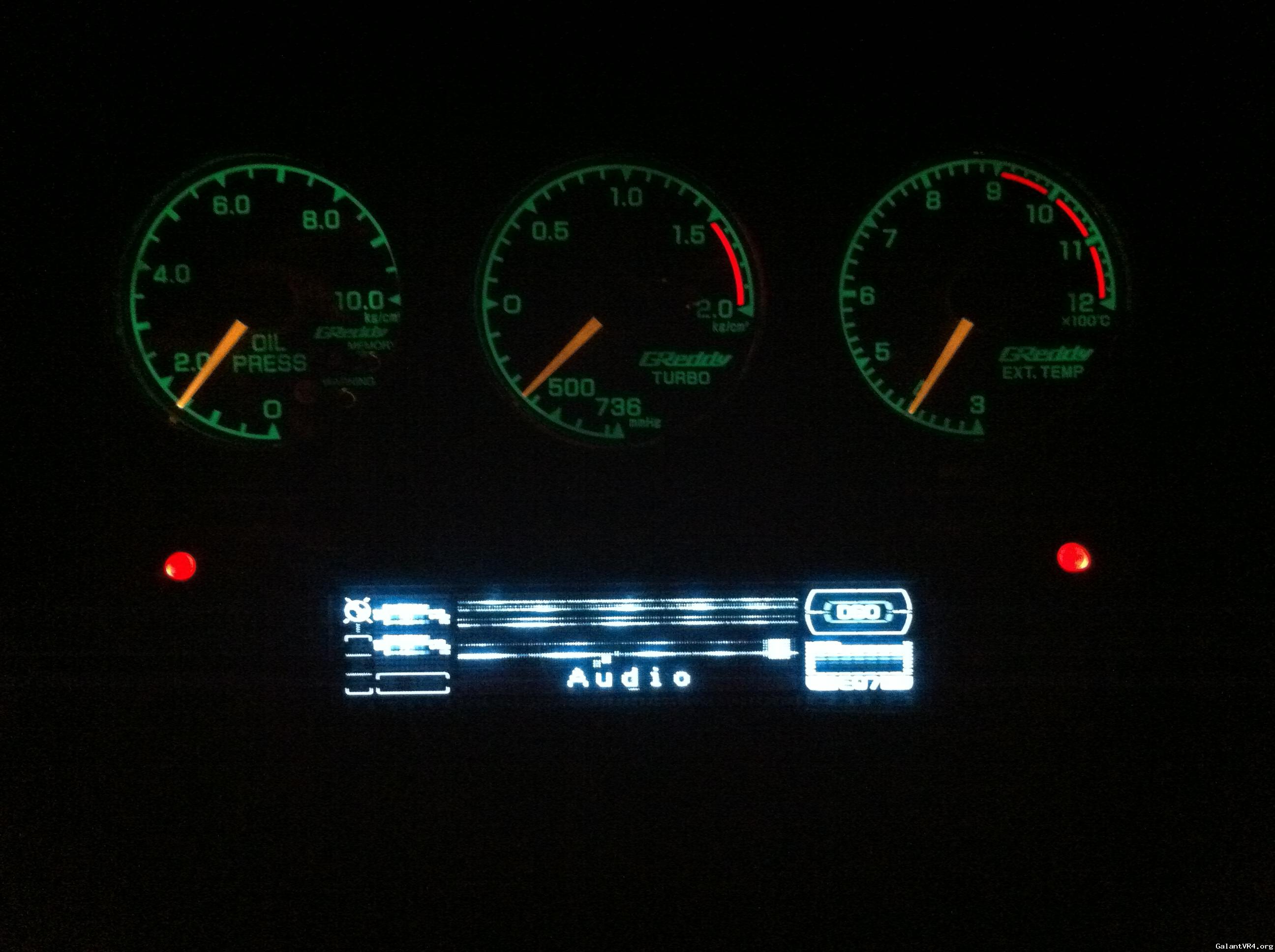

Night version of gauges. I'm happy to have them off the pillar....

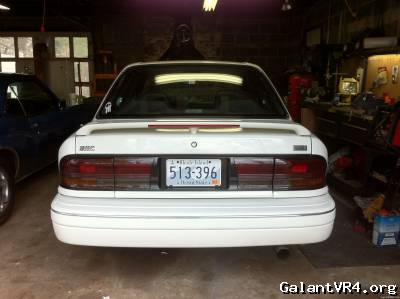

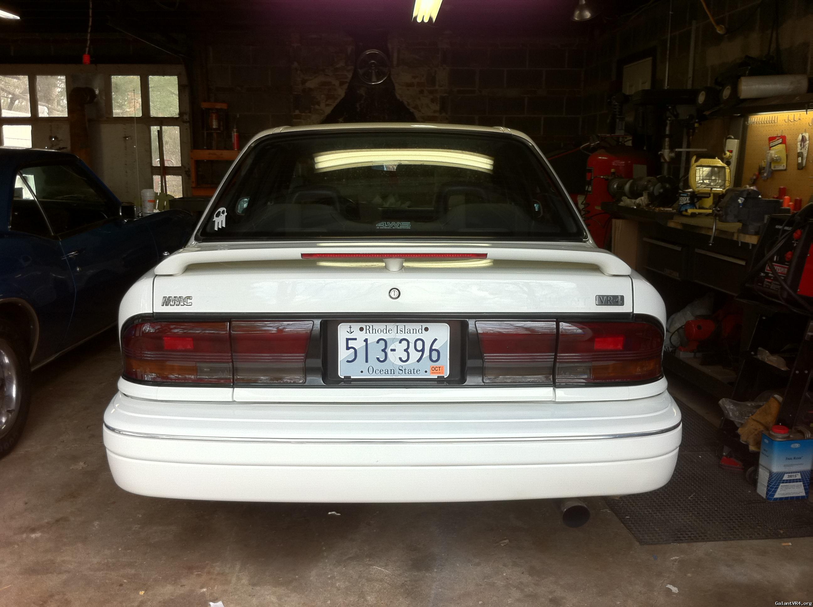

And through the board I was able to purchase a factory sealed 4WS decal for the rear window. I went out of my way to preserve the system to keep the 4WS on the car. Future plans are to redo all the lines in SS when I do the sway bars and front subrafe resto.

Looks good. Where did you get a sheet of carbon fiber?
I'd like to make a plate like that because I'm sure I'm losing a lot of air through that opening.
381gvr4
Nov 5, 2007
568
Wakefield, RI/Meriden, CT
I searched EBAY "carbon fiber sheet" and I sorted thru listings until I found a supplier that would take orders outside ebay for custom sizes. I just searched my ebay account and cant locate the supplier I ended up using.
No worries I'll check out egay and look around. Thanks.
Edit: I forgot about these guys, they sell carbon fiber sheets.
Or search "carbontrix" if that link doesn't work.
