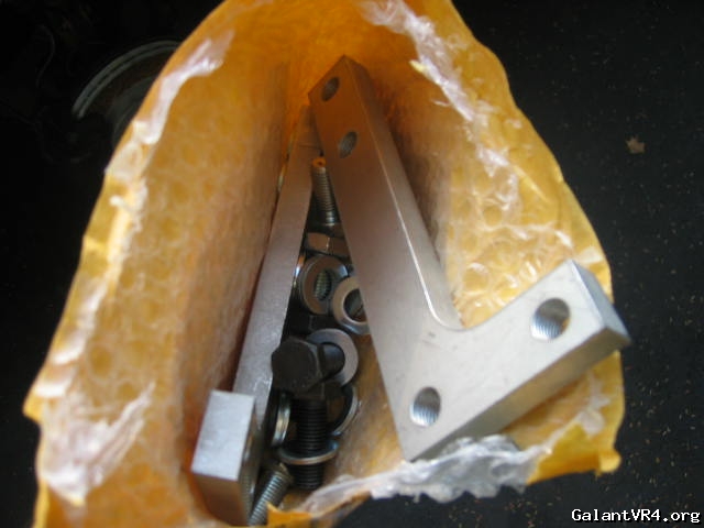

Very nice Russ /ubbthreads/images/graemlins/applause.gif. Brackets were shipped today.

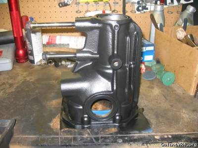

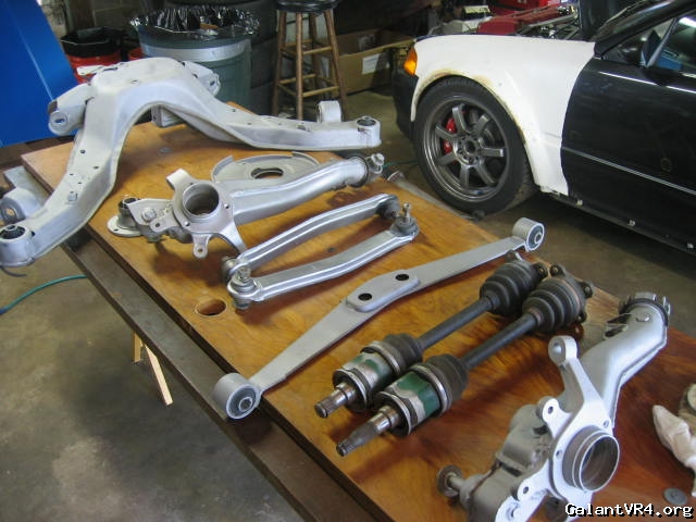

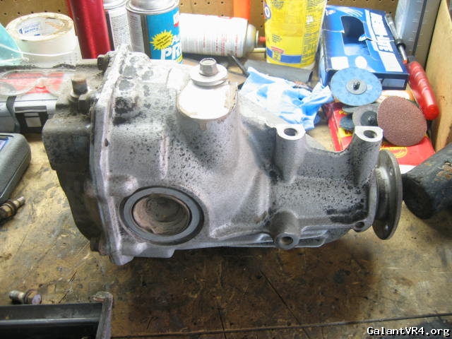

Went down to my buddies shop and he gave me a hand or sand with the cleanup.... Made some sheetmetal block offs for pump and axles. Only the rear p/s pump gear and the case is going to be used so I'm not worried about media as its now going to be washed before paint. More later....

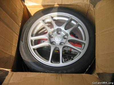

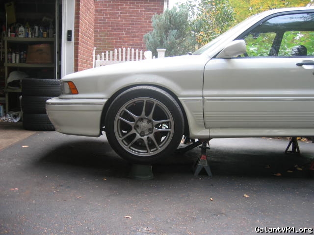

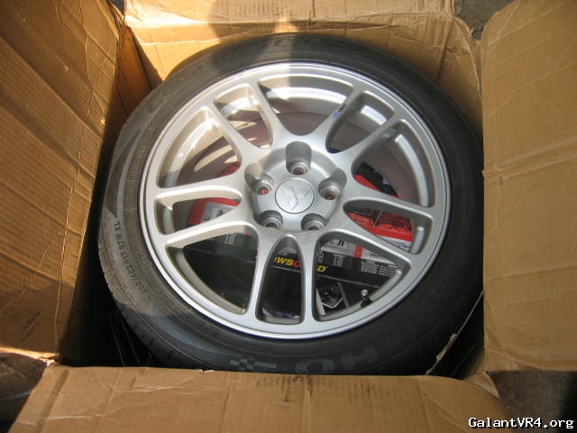

The wheels are here!!! More camber wear than described but should be good for more abuse with an alignment.

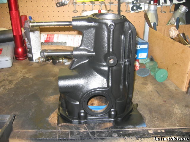

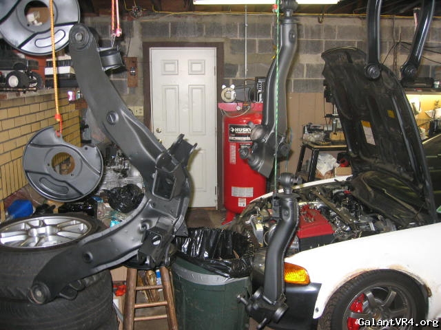

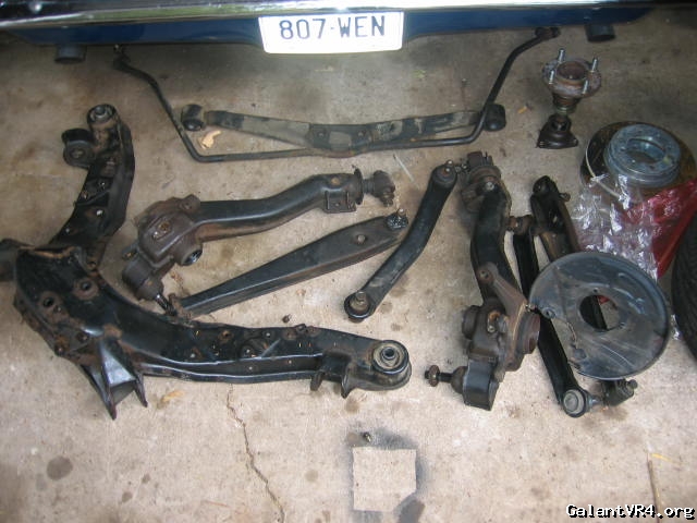

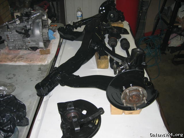

Broke down rear subframe and put final coat on rear steer housing. Now it will take 48hrs to cure. Felt a little, WTF last night when I realized how much more is left before all comes back together. The ceramic frame paint takes 72hrs to dry too. Hopefully my buddy Mark can blast some spots on rear subframe to save time. Going to clean and degrease that tonight in preperation.
I have not even started to restore rear steering stuff. May just make stainless lines for rear but going to findout pricing from MITSU first. May be $8-15 per line.
Heres some MORE pics.....
striped sub...
Wheel teaser....
Rear housing with final coat of paint. Hopefully parts are here for Saturday so I can put it back together.
Any locals want to help with paint prep???? /ubbthreads/images/graemlins/dunno.gif Thats how the brotherhood works out West!!!! /ubbthreads/images/graemlins/rofl.gif Later.
Wheels should look great with camber and assuming it's ran that low /ubbthreads/images/graemlins/smile.gif

W/E update.

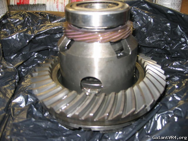

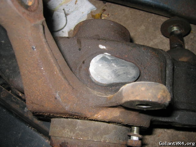

Pressed off/on rear steering pump gear onto LSD rear diff. Still waiting for parts to put rear end back together.

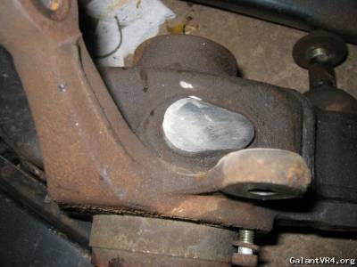

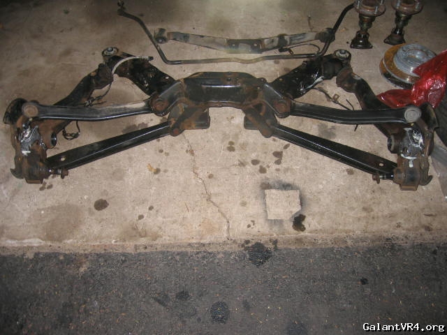

Plugged rear abs sensor hole on rear trailing arms. Found lug stud ends pressed right in. Then I welded and ground flat.
I'm at the merchy of my friend Mark to get this stuff blasted. Started to clean up rear sub, but most rust is in places where only sand blasting can get. Once rear sub is painted/cured, it should come together quick. Hoping for assembly next w/e.

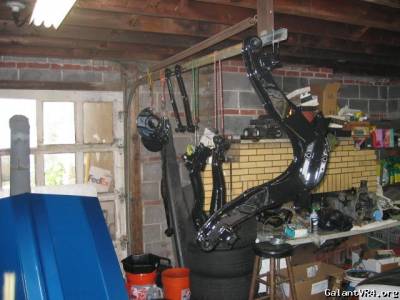

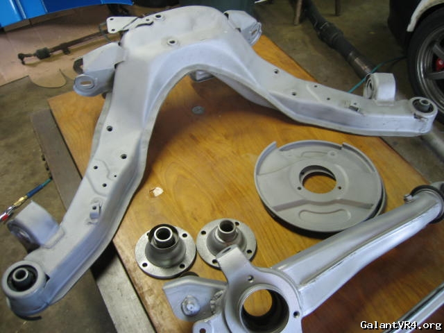

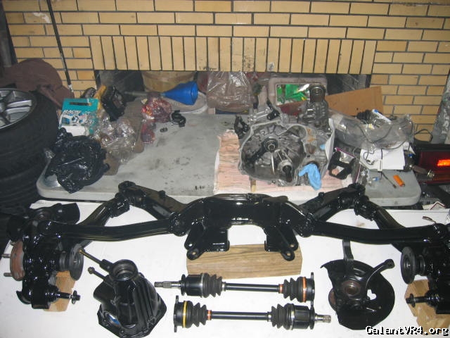

My friend Eric called Mark(original guy blasting)and I yesterday to say come to his work and use the "real" blasters. This thing was 10ft in diam. and blasted this stuff in about a hour!!!! Put some primer on and tomorrow the ceramic gloss chassis paint goes on!!!! Parts here Monday or Tuesday. Have no rear end cover because NLA and thru mine out as I thought a new one was on its way. Oh well..... This week will be the time to assemble and next w/e install. More to come.....
My drying spot......

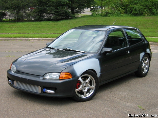

Eg with B16B Civic Type r motor- turbo. That WAS my on going 5yr project thats now on the back burner. Has ALOT of parts thrown at it!!!!!! Interior is all ITR including dash and custom door panels. 5-lug, 13" Brembos, custom wide front fenders(1 of 4 sets). Fully built head for 9700rpm shifts when driven. Polished EVERYTHING- rad., intake maniofld, piping, distributor, motor mounts...blah,blah,blah. I literally put on like 3k a year. She may be up for sale someday soon /ubbthreads/images/graemlins/bawling.gif.... I need to finish tune with Neptune RTP setup and paint exterior. I had already bought paint for her but got side tracked. Some OLD pics from 05'.....
Back when rolled on S2g's and my custom hand rolled fenders....
Can see my old WRB 2.5rs rollin' on fctory goldies in reflection on door..... I miss that car.....
Finished interior from this year....

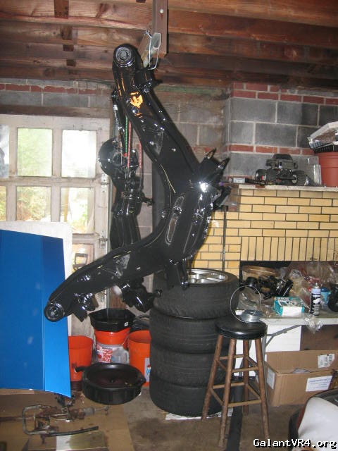

Glossin'....... Took my lunch break to put the chassis paint on as it take 3 days to cure!!!! Glossy......
No UPS yet with parts..... more when I finish work for the day and head out to the garage.....

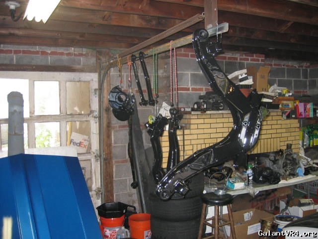

Reassembly has begun. Need to blast and paint lower control arms, press in Ball joints and get a rear end cover for it to be ready to go back on the car. Still need to assemle rear end and install on subframe, too. Progress has slowed waiting on parts. Maybe NEXT WEEKEND it will be ready for reinstallation..... more to come this w/e.........
Before...
After... rust "TERMINATED"....
