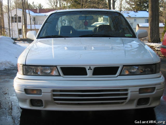

Factory JDM would be the star and MMC badges. Someone on here sourced some all-chrome stars which I intend to use in place of the red badge.
381gvr4
Nov 5, 2007
568
Wakefield, RI/Meriden, CT
^^ I think I'm going to use (MMC VR4) as no one will know what kind of car it is. Used fishing line to "cut" adhesive yesterday. It petrified on there. Need some goo-gone and a heat gun to finish.

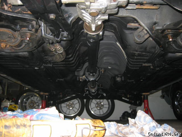

/ubbthreads/images/graemlins/ooo.gifOuch... thank you for the heads up. I still didn't get the DS back from my freind Eric who sandblasting for me. He isn't charging me so I can't complain. Will call Mitsu tomorrow /ubbthreads/images/graemlins/wink.gif
Mitsu is going to be between $68-$91 for a ujoint. But if you order a slip yoke for the tcase its like 48 and comes with the ujoint so just order 3 slip yokes the ujoint is the same for all 3.

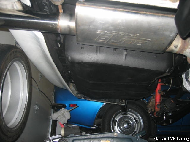

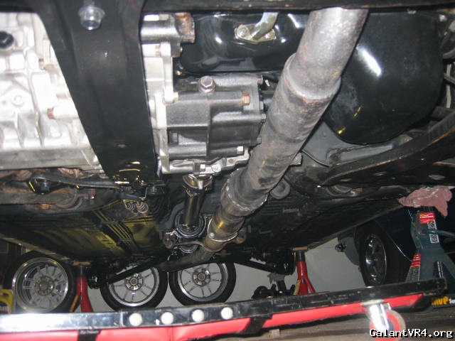

All back together. Need to bleed the AWS and get it aligned then DD will begin. Took some more pics. Muffler that was on the car, got cleaned up and polished. Will take some action pics when I detail her again.
The front subframe and lower control arms will be blasted and painted next spring/summer. WANT but will wait for a deal I can't pass up will be coilovers and SS exhaust.

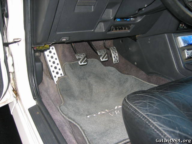

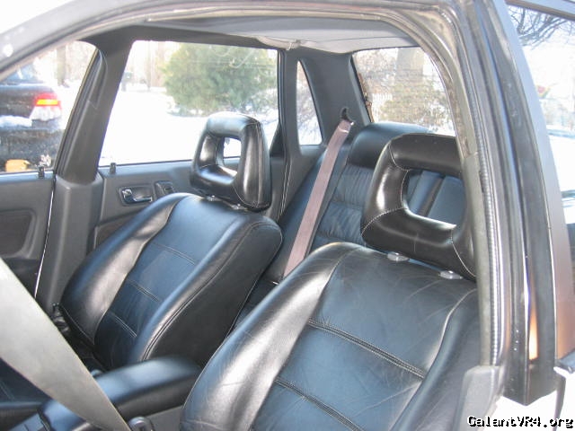

Aftermarket WRX dead pedal that I had for YEARS (for my 2.5rs back when I had it-just never installed).
Starion Headrests...... craigshelper.com FTW $50 shipped /ubbthreads/images/graemlins/grin.gif

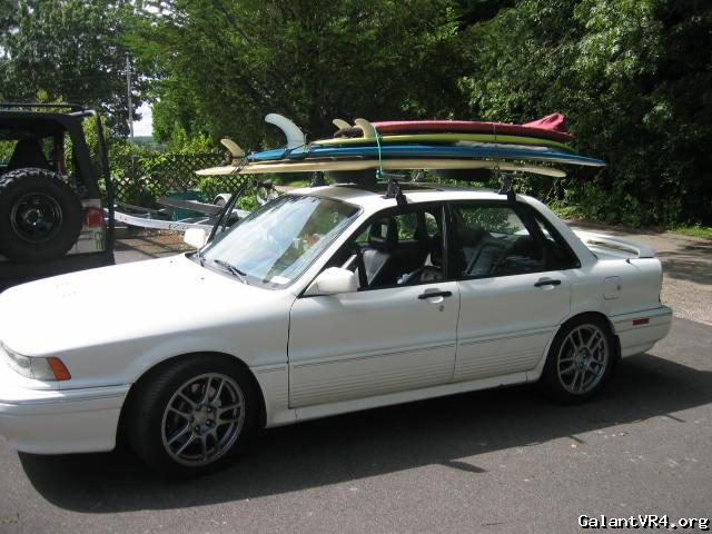

I took 381 on its first mission to R.I. for a surf trip. No problems and awesome on the highway cruising. Real quiet and well manored. I haven't even had it alighned yet, just done with bubble level at home. I got great gas milage and didn't have one issue.
