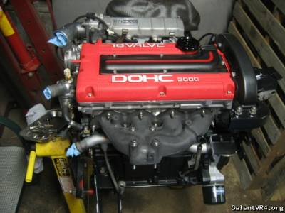

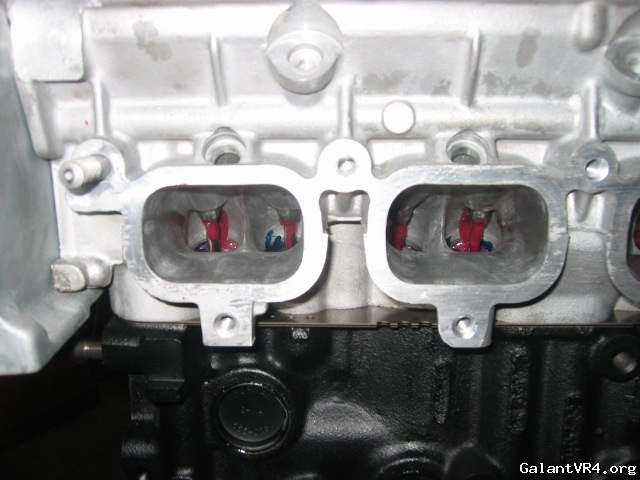

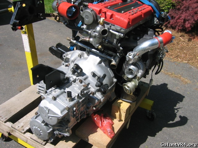

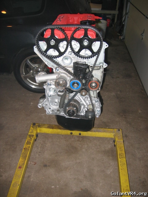

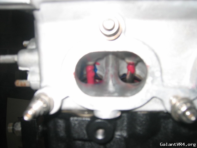

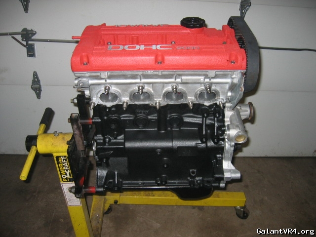

Full rebuild(old block I had out of DSM). Just about done. Weisco,9.0:1 .20 over, eagle rods, polished unground crank,B/S eliminated, spun balanced to 10K, fluidamper balancer, mild ported head by myself, manley springs/retainers/keepers, BC272's, 3g lifters, ferrea valves with 3-angle, Mitsu gasket, Hondata intake gasket($.99 on epay), 2g ported manifold, tdo5h 20g w/ bullseye exhaust side/clipped wheel/coated(NOW gt3076r /ubbthreads/images/graemlins/devil.gif), EvoIII ported o2. Oh.... Arp everything!!! Mains, head, exhaust manifold, crank, exhaust studs, turbo bolts. New Mitsu oil pump/cover, mitsu waterpump, new mitsu tensioner, idle pulleys, new waterpump/oil pump cover/tensionor hardware. New oilpan, knock sensor, ALL GASKETS/SEALS, all painted and pretty like!!!!!!
Waiting for my turbo to come back so I can drop it in.

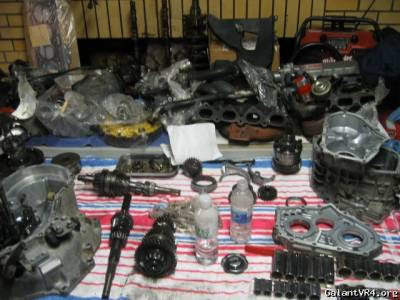

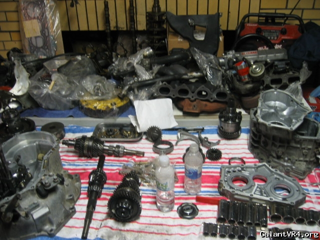

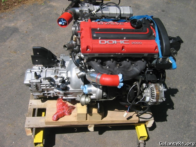

To go along with setup, I have a tre trans with dual syncs in 2-3, filter, new forks, bearings, seals, etc.... 2g shift fork and throwout bearing upgrade,ACT 2600 w/ Streetlight Flywheel, 2g MAF with intake pipe,K&N, 2" i/c piping off turbo/2.5 to T/B with spearco core(don't know dimentions as it was the on car), 2.5 to 3" ext.(was on there).
Car had seen better days when I bought it. It was running but had a history of bad luck!! Blown motors, bad turbos, FIREi!i!i!, BOLTS COMING OUT EVERYWHERE. To play it safe and facilitate my OCD, I pulled out the CyClone motor and sold it. Started fresh and here it is. Still have much to do to get her perfect, but when the motor drops hopefully next week, its full steam ahead. A little paint and body work, little cleaning and she'll be a nice part of the forum.

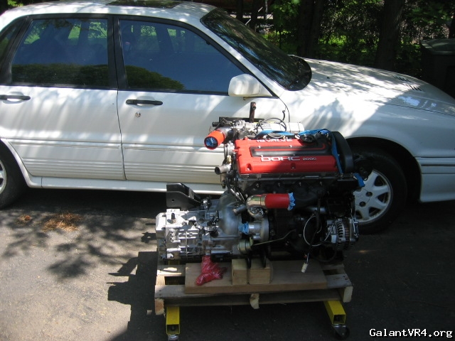

Some Random pics.....
Tranny rebuild

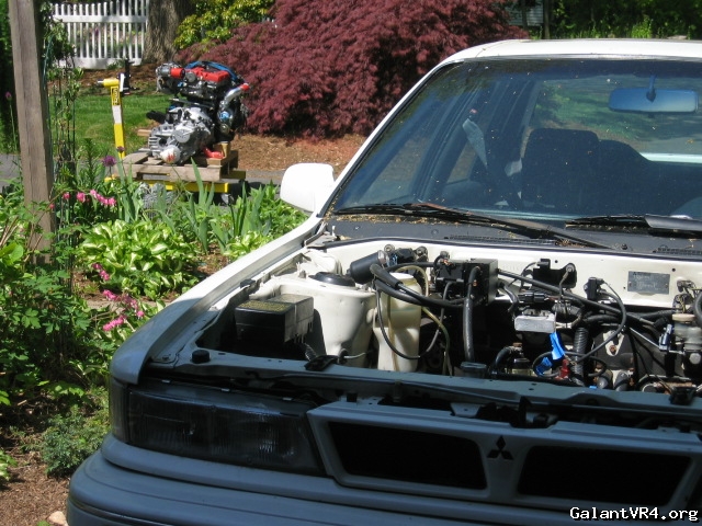

Before..... (only pic I could find on the board)

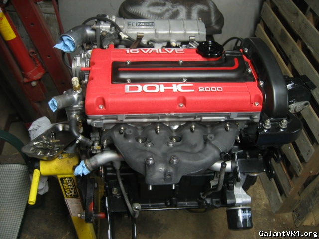

After...THIS IS NOT NEW MOTOR... JUST CLEANED UP AND DEBUGGED BEFORE RIPPING AND SELLING LONGBLOCK.

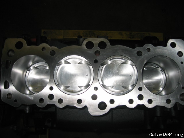

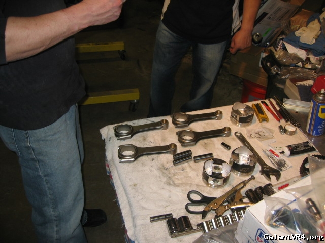

New Motor Pics....Dr. Mario making his famous magic happen.....
More to come when I have more time!!!

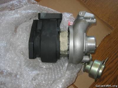

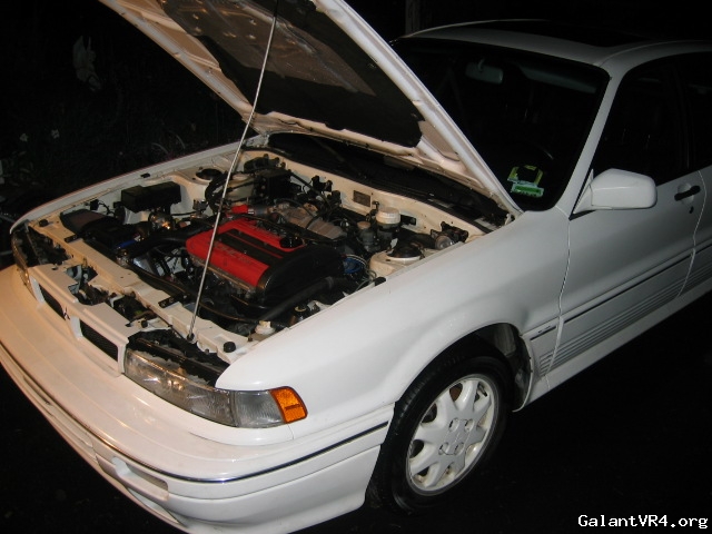

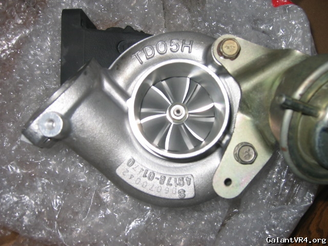

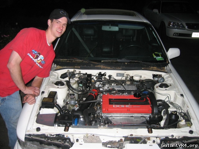

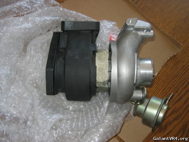

Finished up some stuff over this week. Finaly got my tdo5h Hybrid 20G back. Thru it on, put on flywheel and clutch, finished cleaning up harness and today was the day!!!!!! Along with blowing my back out yesterday just flopping the tranny over to put in the 2g fork. Felt like crap but my friend Skiffy was there to lend a tremendous helping hand. My other friend Dr. Mario was here to drink my beer and motivate us along!!!! Have little stuff to finish like clutch slave bleeding, radiator hoses, final clamp down on all the I/C pipes, fluids, radiator burping and a little mod on the downpipe to fit evo3 o2. A 30-pack and a few swizzles later and here she is.
Finish up little things this week and fire her up by this w/e.
More to come!!!
My friend Skiffy(matt) after job well done!!!!

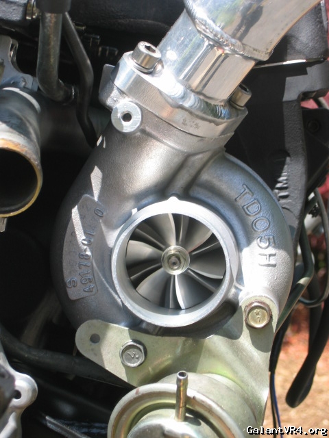

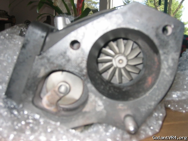

Nice build but why the Bullseye exhaust housing /ubbthreads/images/graemlins/dunno.gif /ubbthreads/images/graemlins/bawling.gif
381gvr4
Nov 5, 2007
568
Wakefield, RI/Meriden, CT
It actually was on the 16G that came with the car and its HUGE!!!!!!!
The turbo is:
Tdo5h 20g wheel/housing
fully rebuilt center
"Monster" Exhaust side w/38mm flapper
Clipped turbine wheel(tdo5 not tdo6)
Xtreme coating
why /ubbthreads/images/graemlins/bawling.gif, you don't like?? /ubbthreads/images/graemlins/grin.gif

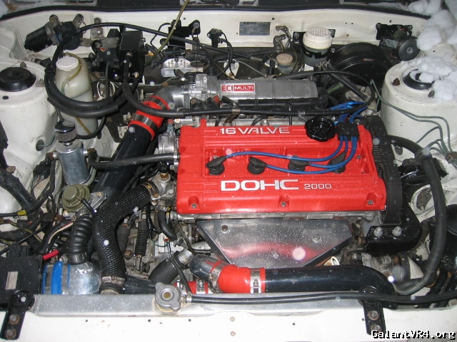

Nice build. Did you use "wrinkle" paint on the valve cover or is it like "flat" red?

HUGE=AWESOME
Just so you know. Those housing don't flow for sh*t. Just because they are big does not mean flow. But good luck with the new set up.

Yup, it's wrinkle. The secret is the prep!!! I did one on the old motor and thought it wouldn't last but is SUPER durable. Also, use a paint prep product to ensure good adhesion.
Then I used a sanding block to hit the letters for a brushed look.

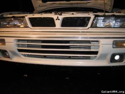

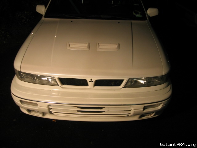

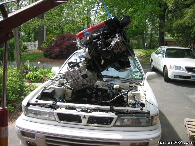

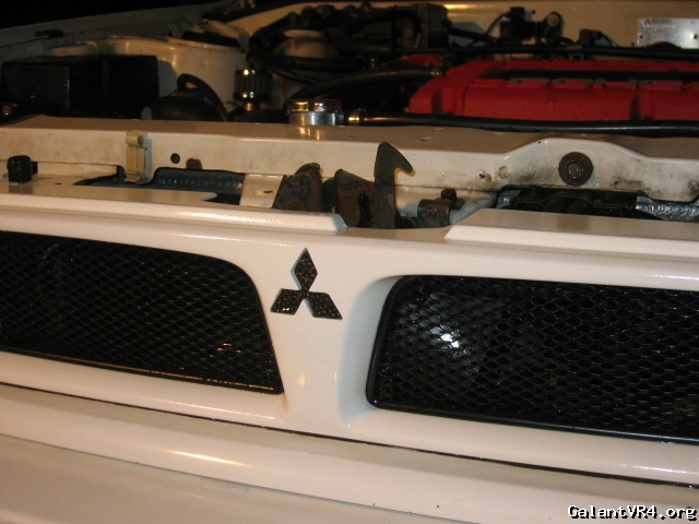

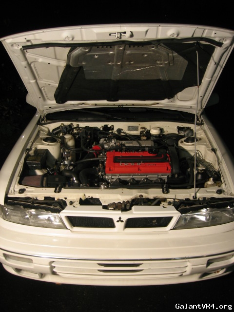

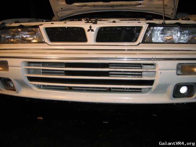

Also, in pic with engine hanging above engine bay, I DID convert to a 92 grill.Cut out fins and used wire mesh. COOL part is my hand crafted carbon fiber emblem /ubbthreads/images/graemlins/wink.gif Will add pic after I wash it.

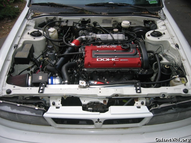

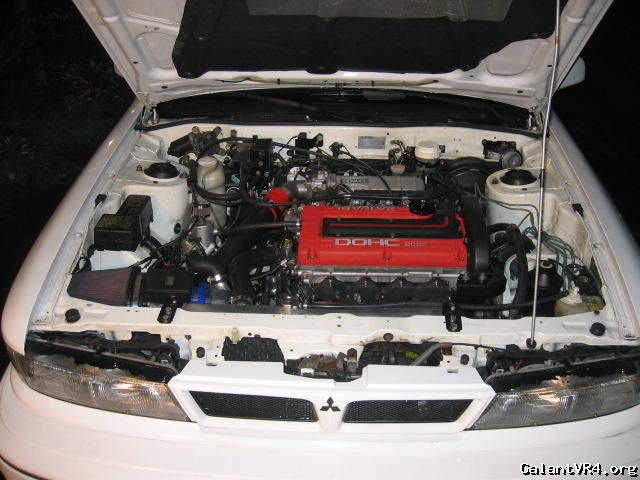

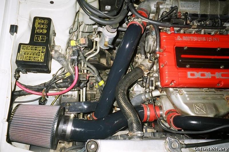

New pics!!!
Finished little details. All I/C piping set, radiator and hoses in, slave in and finally washed her. Needs a good buff and some chips filled but I'm happy. Going to start up in the next few days when I get time.
Let me know what you think so far....
(sorry if they seem like doubles but I'm happy my winter project is coming together)
Still Dirty...
Intercooler...
Modified 92 grill w/ fabbed carbon fiber emblem...
JDM hood...
/ubbthreads/images/graemlins/devil.gif /ubbthreads/images/graemlins/devil.gif /ubbthreads/images/graemlins/devil.gif
