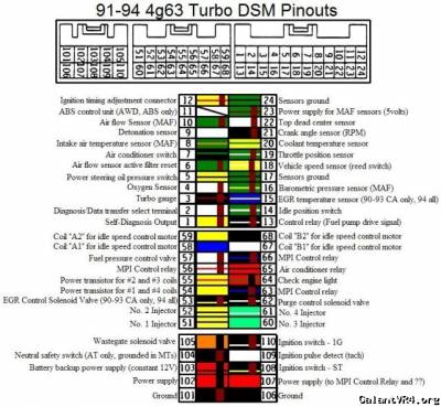

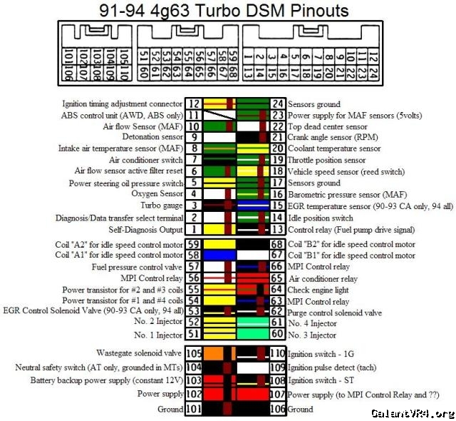

Ok guys, my car won't idle correctly or rev high if it's all hooked up. If I disconnect the sensor with the vac line attached, it runs about 80% better (It will rev higher and idle at 1300rpm). I tried switching wires around, thinking I had one backwards, but no change. Is the sensor bad?
My logger is dead, new one is supposed to be here any day.

Are you sure the idle-closed switch is working?
BTW, I would never think of running a fresh engine install with anything but a factory MAS, unless the system was previously tuned and tested OK. As someone suggested in your other link, you should find some way to install a factory MAS for now, until you work all the bugs out of your wiring. It almost sounds like the ECU isn't getting any Karman Hz input, but without a logger there is no way to verify that.
