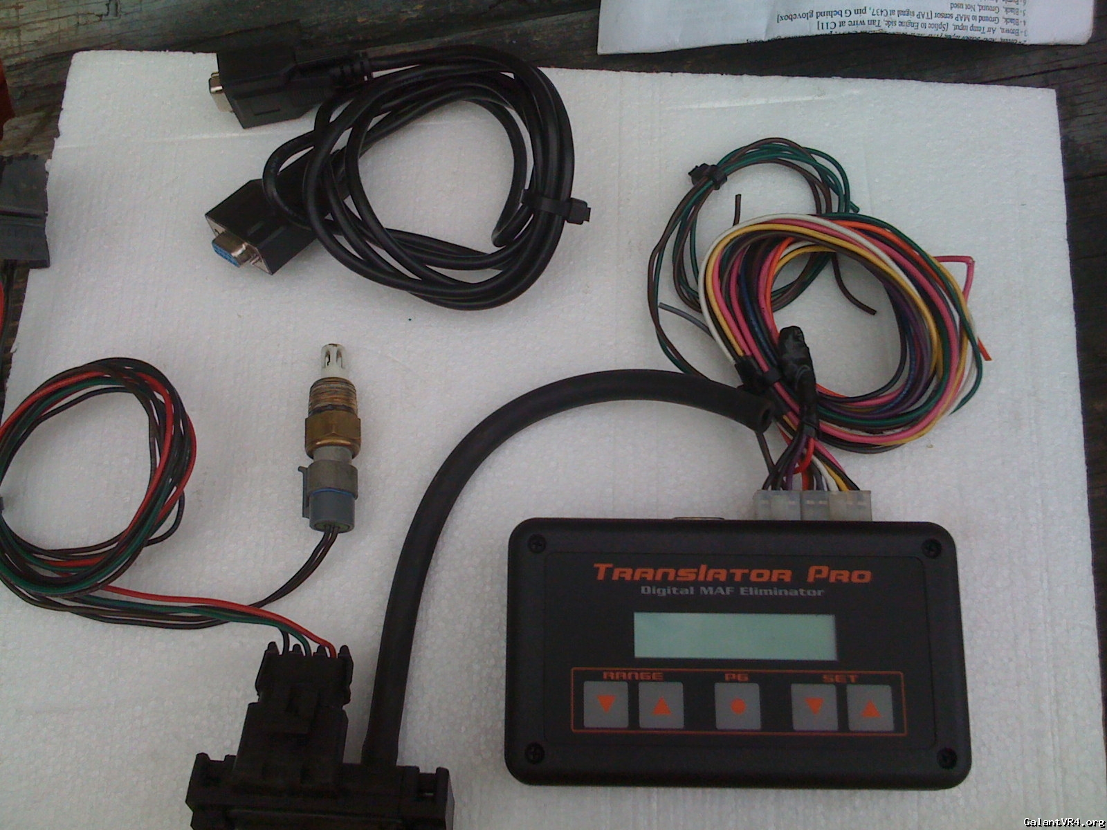

Now we'll see if I can figure it all out. Anyone had one? Does that sensor replace my stock o2 or is this seperate? what chip will my ecu need now? Still dependent on my injector choice?

Your o2? Isnt that the same speed density setup that turbowop is running? That is most likely a map sensor that would need to be added to your intercooler piping.
11,983
Yes, that is the system I've been using for a couple of years now.
That is the GM intake air temperature sensor. It goes in the upper intercooler pipe. The one with the vacuum hose attached is the map sensor.

lol had to throw a couple noob questions in there. I do have a lot of questions with it though. If all goes well I'll be installing it this weekend. Am I missing anything with it? This replaces the stock mas correct, are there any other intake sensors I will need? How do I hook up the wideband part of it? I really wish one of you that knows more about this than me was closer.

It looks like you have all the sensors you need, but I would wait to install it until you get a Keydiver chip to compensate for injectors, etc. It'll just make it easier to set up.
I don't use the wideband tracking feature with it on my car, so I can be of no help to you in that department.

Ok find a vacuum port on the intake manifold not used.
The 3 bar GM map hooks up there.
The GM air temp sensor goes in the IC pipe somewhere Try and find a place that is straight and put it half way so it gets a steady stream of air.
Now place the controller where you want. Bracket in the glove box etc. You'll want to be able to see it easy or hide it easy.
Remove the air meter ...You don't need that sh*t anymore. Filter, pipe and your done with that.
Now wide band O2 you need one of those, Not the wide band and a gauge just the wide band sensor and lamda cable. The cable attaches to the pro translator box. You can monitor the wideband from the pro translator screen if you really want one do it but its really not nessesary.
Now the beautiful thing about these is the wideband tracking. If you set the wideband tracking at 11.8 you'll always be 11.8, it samples like 128 times a second and it dead nuts accurate, spray meth, juice, race gas, more boost etc it will compensate. No more screwed up idle, perfect tune always baro pressure humitity and temp doesn't effect the car anymore drives like a new car from the dealer.
Now for computer chip Jeff does them and I still need to get him to do mine but that will be the last thing I buy for it, Looks like my combination is set unless I say screw it and do a 2.6 I've really been looking at the BC stroker kit. /ubbthreads/images/graemlins/devil.gif
As for tuning it and getting it dialed in research the full throttle network website theres alot of info there. Also I'm sure theres a dyno close to you that has tuned one of these in. I plan on getting mine baselined then loading up on a trailer and go to ATL for dyno time. I figure I can learn more in two hours on a dyno than 2 monthes raping it up and down the street beside my house.
Now I'm not sure which release you have but the software is a free upgrade and they have downloads for the current set-up and also the timing tables etc. Also you can buy for like 100 dollars the boost controller that ties into the box. But I'm use to mine and like the overtake button and its easy to set so I'll stick to my old profec A

No doesn't matter plus its cool to mess with and see how fast they react ...You can hook a ohm meter to it and just change the temp fast by sticking an air hose to it or dipping in hot or cold water and watch the resistance change. Its almost real time it changes so fast ....GM has there sensors figured out.

The IAT sensor is nice for seeing how well your intercooler is working. If you're just a tad above ambient on a WOT pull, you know it's working well.
Curtis, I didn't know you were using the Maftpro setup also? Have you had good luck with the wideband tracking? I'm a bit leary of trying it since I'm using methanol injection on my car and I built the failsafe into the accessory 12volt input wire on the Maftpro. The Maftpro will only pull fuel if it sees +12volts on that wire, which is signaled by a Hobbs switch that is looking for pressure at the meth nozzle. That wire also ties into my dual stage boost controller and runs high boost if it sees meth pressure as well. If that Hobbs switch doesn't see pressure, or if I just turn the system off, the Maftpro doesn't pull fuel and the boost controller stays at low boost, protecting the engine from an overlean/overboost condition.
I'd be willing to try wideband tracking, but I'd have to do a little wiring change and some reconfiguration of the Maftpro box.
